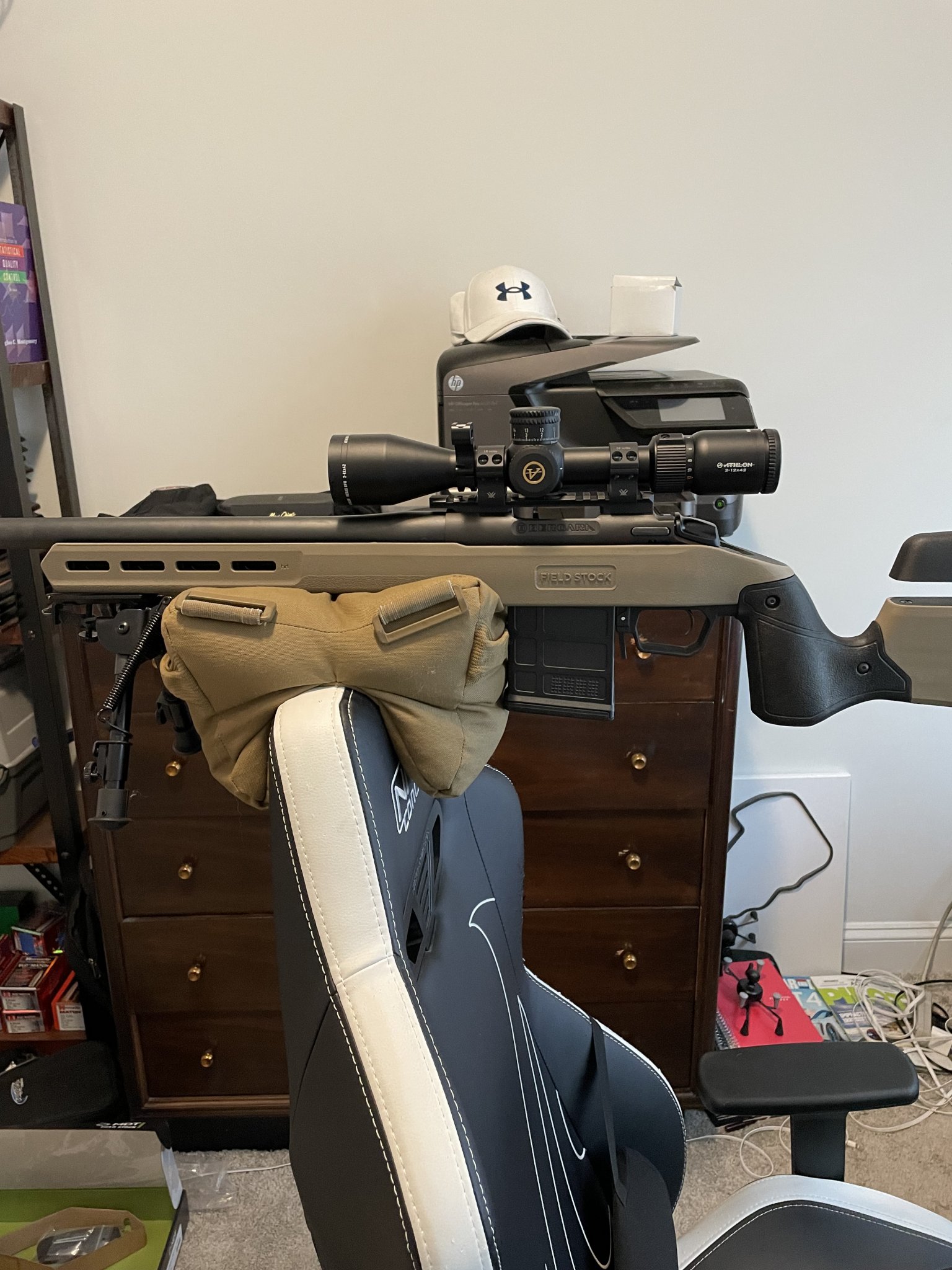

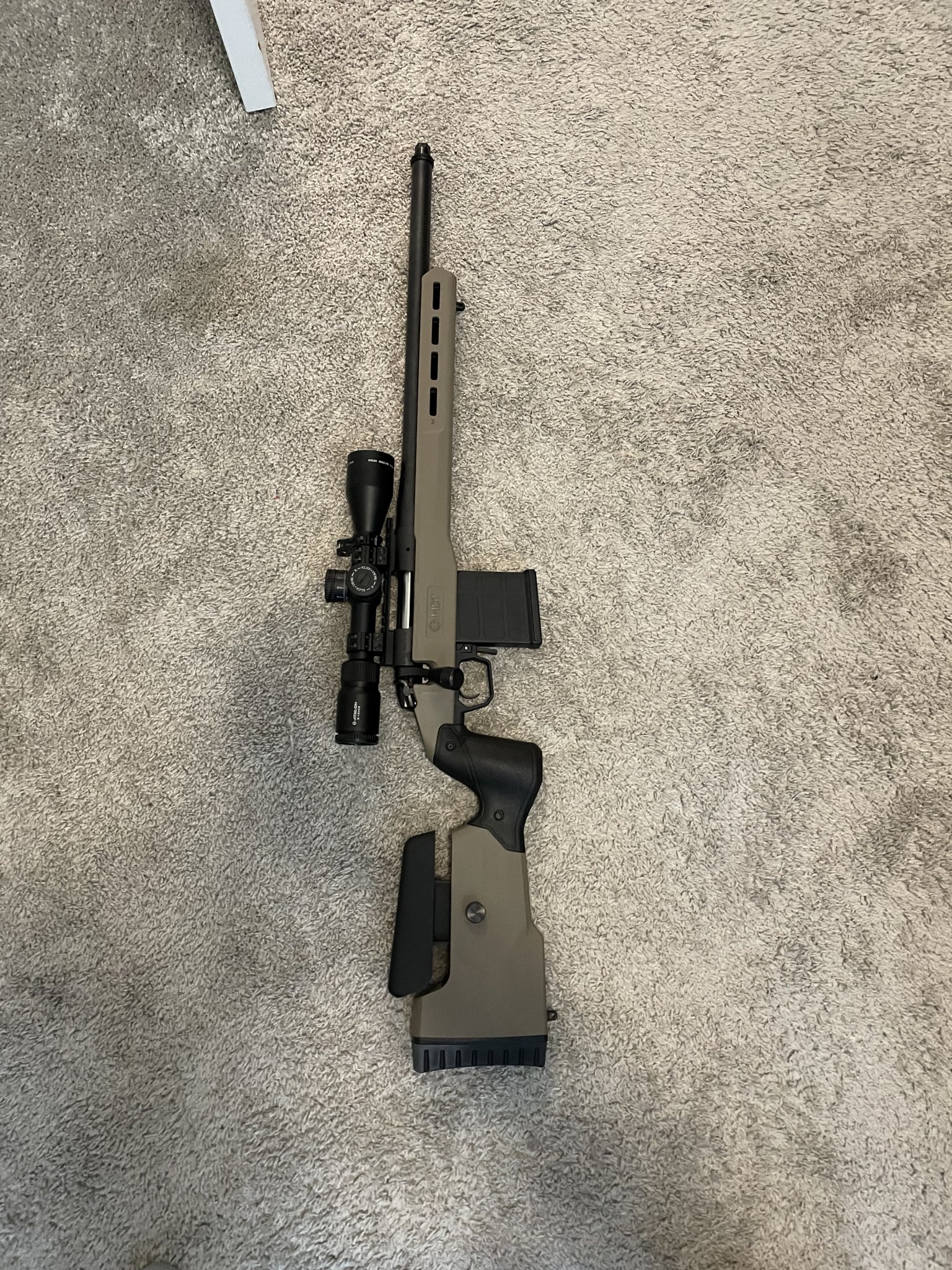

I put a Savage 110 Switchback in 6 ARC into a Field Stock. Install was super easy, of course. Took it to the range on Friday and saw groups of about the same size as when this rifle was installed in the MDT LSS I took it out of. Difference is I can now remove my bolt, damn bottom bolt release, without having to remove the action from the stock. The stock is very stiff for only being polymer. Came with enough spacers to get a very comfortable length of pull. Cheek riser works good enough considering it has that weird shape. Overall, for the less than $200 it was on Black Friday, I think it’s a winner. I have Magpul Hunters for other cheapy rifles and I think I prefer the field stock to them so far. Not sure either is worth the normal $300-ish they are the rest of the year though when I can get a Trybe ROC chassis for about the same price. The Trybe blows both the Magpul and Field Stock out of the water. But, it’s a chassis so the feel is completely different than that of a traditional stock.

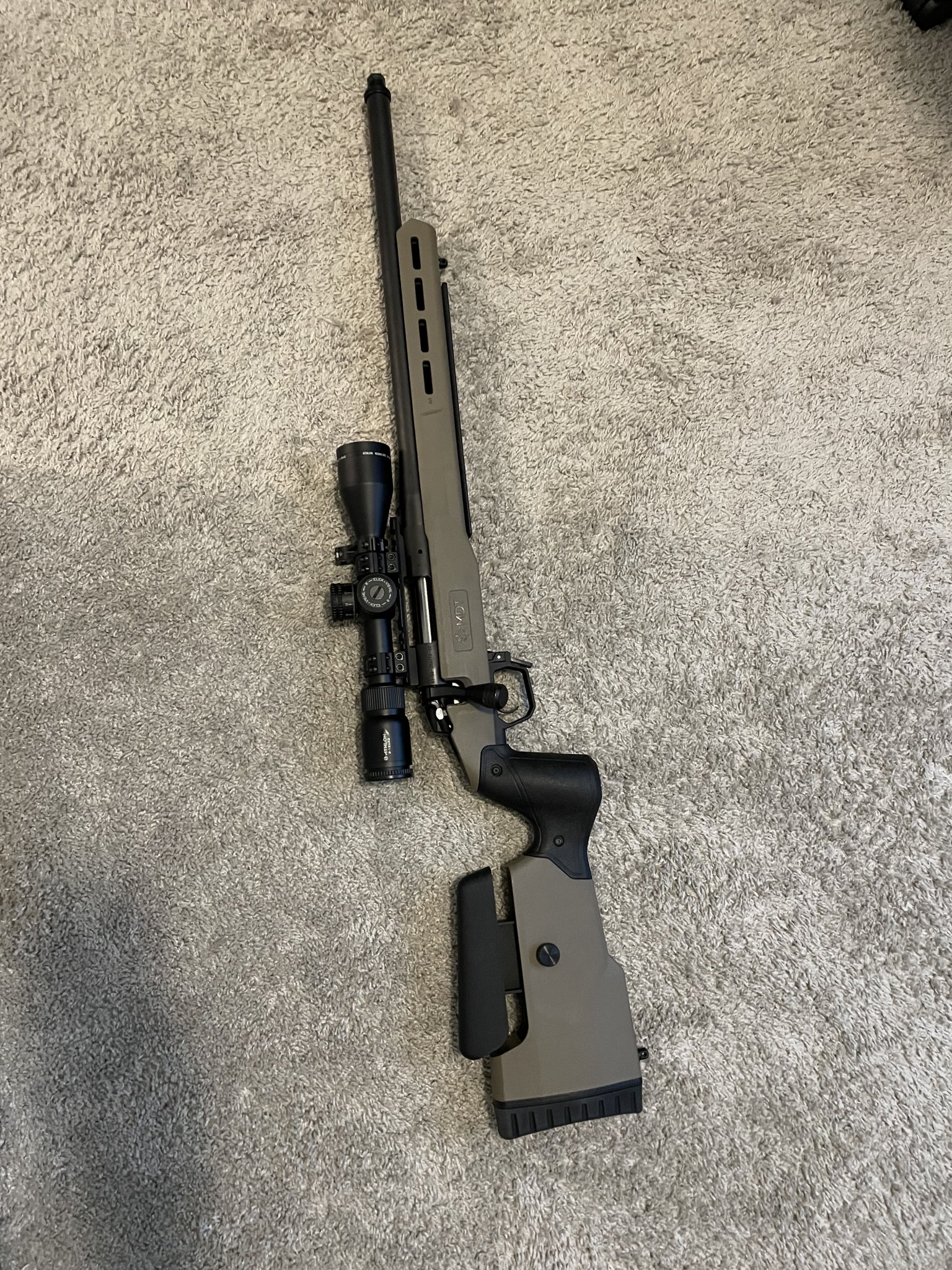

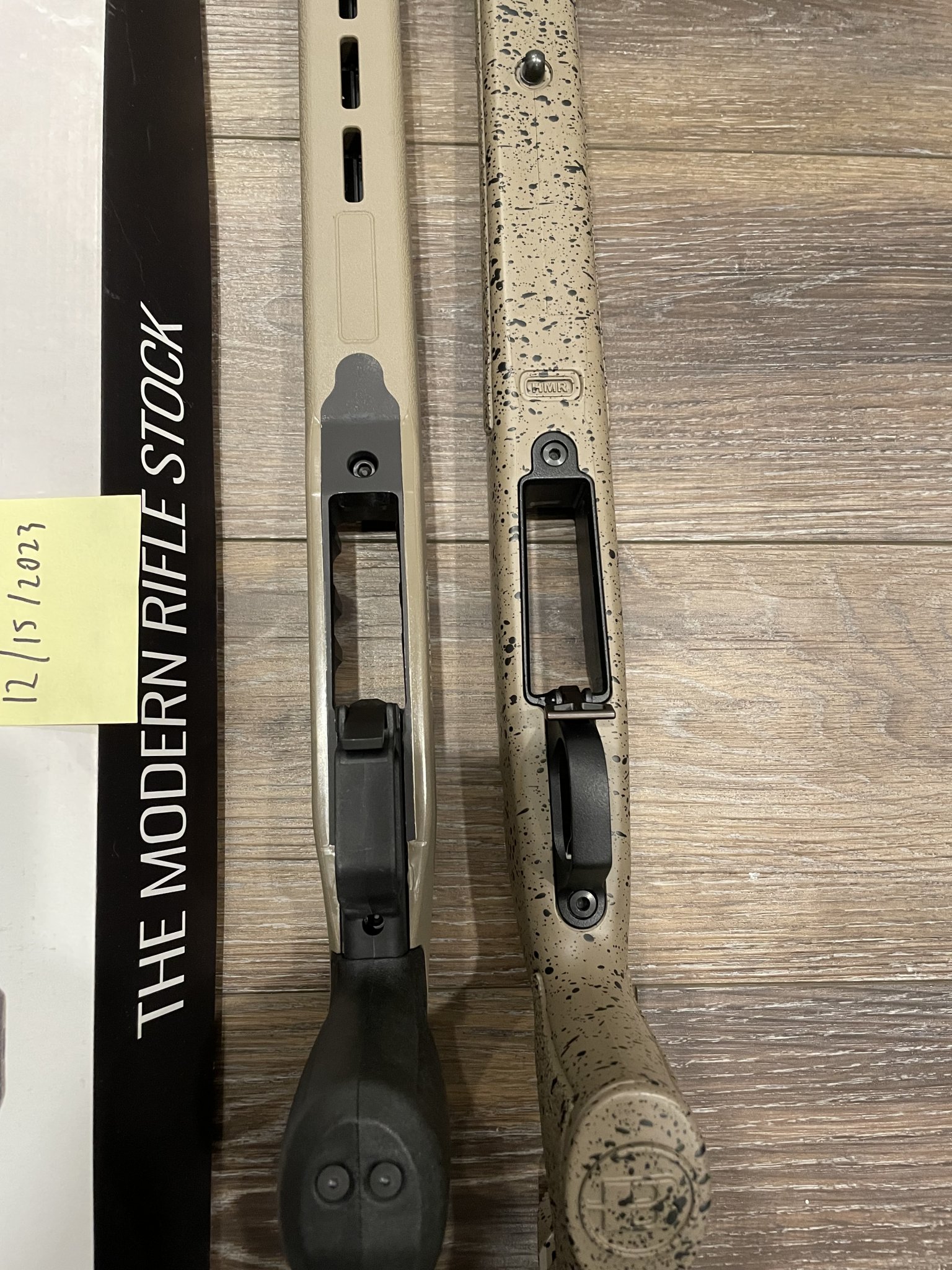

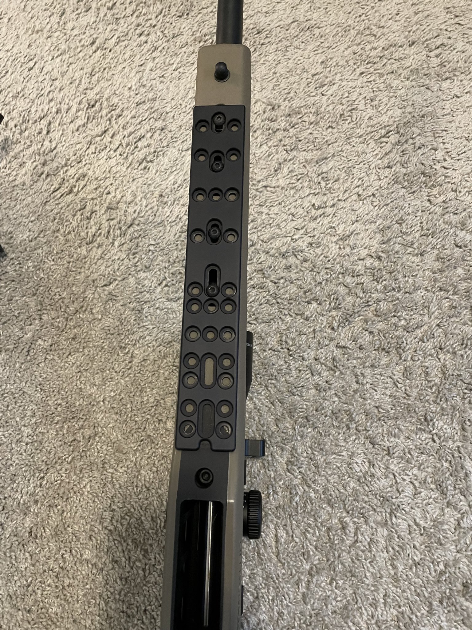

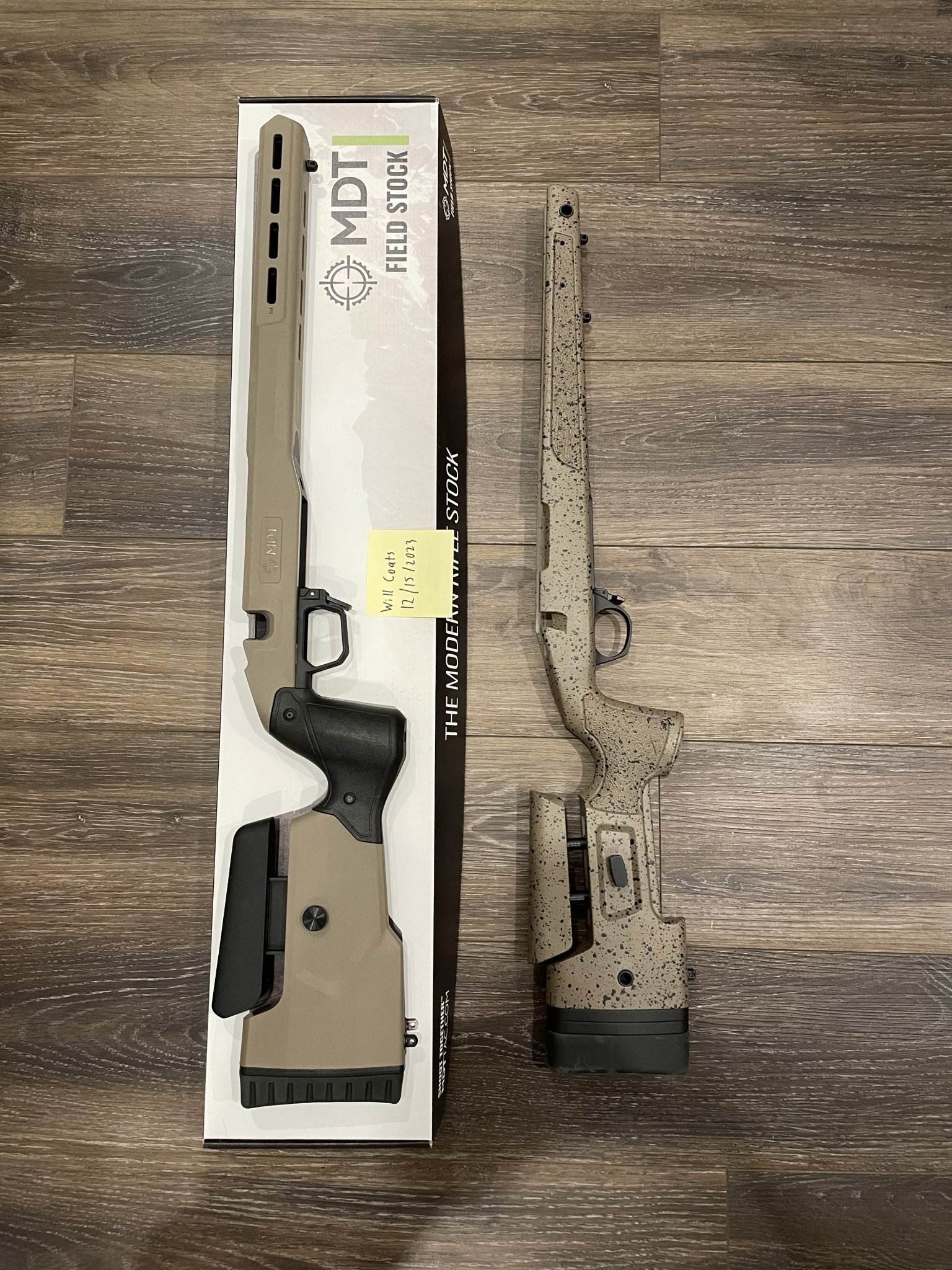

I ended up picking up an MDT Field stock and I am very impressed with it for the price point. I put it a Bergara B14 HMR barreled action that I cut down to 18" in it and had an HMR and a Grayboe Phoenix stock and the HMR stock to compare it to. I've previously owned a KRG Bravo but don't have one on hand for a direct comparison. The main thing I was worried about was the forend being rigid enough because the mini-chassis doesn't go the full length. Based on what I can see it is plenty rigid and I would have no concerns loading a bipod.
I think it's a great stock and I would actually choose it over a KRG bravo for my use. Sure it is 3.1 lbs vs 2.9 lbs but the forend of the stock is longer and to get the bipod as far forward on the bravo you would have to add a spigot which would probably result in a stock that weighs about the same. With the field stock I can actually mount a bipod on the front sling swivel stud and fit the rifle on a full-size OG game changer back between the bipod and the mag which I can't do on a KRG bravo. I mounted an Arca rail from a KRG bravo to the bottom of the stock and you can see how much longer the forfend is than the rail as a comparison.
Weight: It is 3 lbs 3 oz on my scale which is 9 oz lighter than the HMR stock which is enough to be noticeable carrying the rifle round. I think it is a good weight for a general-purpose rifle but not a light as a dedicated light weight stock like the phoenix. The phoenix is 2 lbs 3 oz on my scale so a full 1 lb lighter than the MDT Field.
One thing that stood out to me is that mags fit tighter in the mag well than they do in the HMR bottom metal, a Grayboe bottom metal and my MDT ACC chassis. I tried both MDT metal mags and Magpul AICS polymer mags and they both fit fine but the polymer mags aren't quite drop free. One benefit of this is that is feeds very well. I loaded up mags with dummy rounds and couldn't get any malfunctions running the bolt as fast as I could pushing against the front of the mag.(This would cause some feeding issues on a lot of other set ups). I'd feel comfortable pushing against a barricade for positional shooting without any barricade stop in front of the mag well.
Minor complaints:
-No QD flush cups. There should at least be a QD flush cup on the sides of the rear of the stock since you can add one to the m-lok section on the front. I think this would be very inexpensive for MDT to add compared to the extra usability it would add.
-Mag release latch doesn't stick out to the sides of the trigger guard so it can't be pushed by the trigger finger to drop the mag. Most other bottom metals and chassis I have I can drop the mag with my trigger finger while grabbing a mag with my other hand.

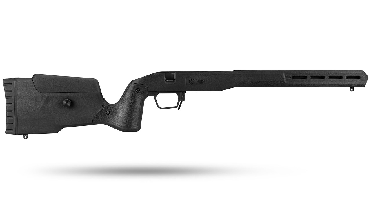

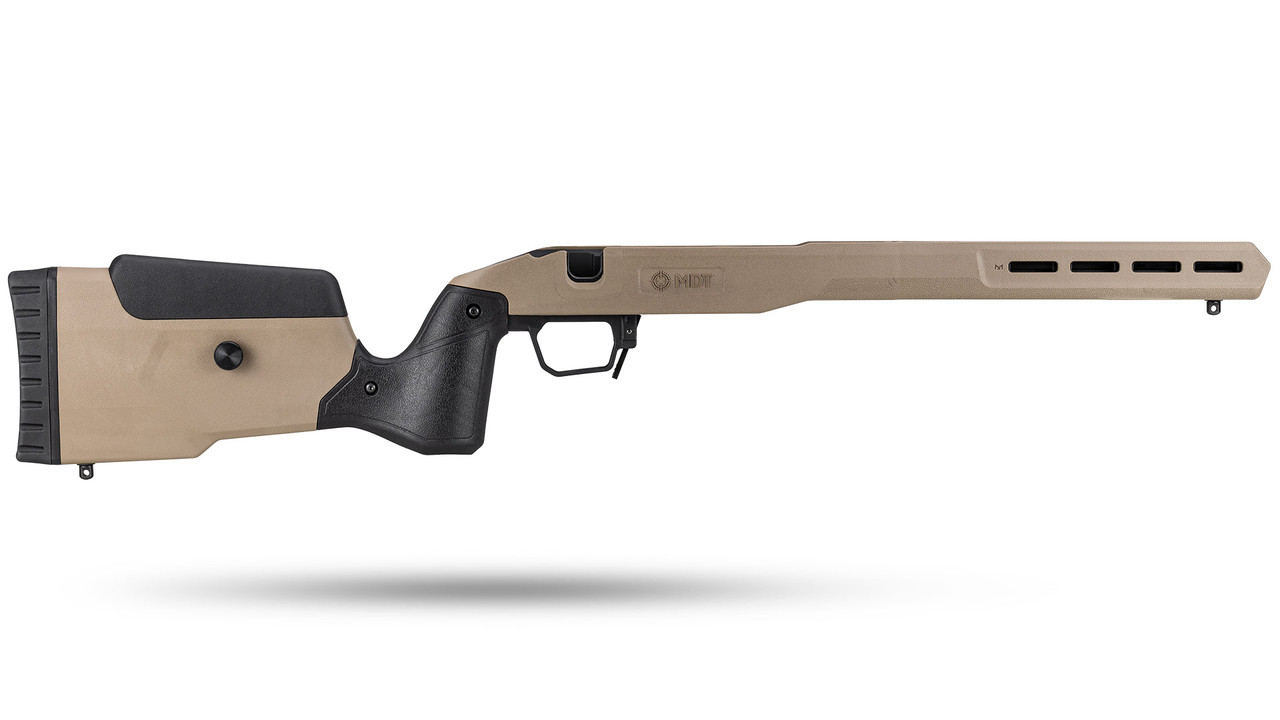

MDT Sporting Goods Ltd. Announces Their New Field Stock.​
We are excited to announce the launch of the new MDT Field Stock. This entry-level stock with aluminum v-block bedding offers incredible improvements, providing accuracy for your action. An injection-molded polymer body creates a warm-to-the-touch grip in any condition.
The MDT Field Stock was built for any situation; range days, hunting, or competition. It features M-LOK slots on the bottom and sides of the forend, a toolless adjustable cheek riser for a perfect cheek weld, and Length of Pull spacers for optimized fit. Sling studs on the forend and buttstock provide mounting options for slings or bipods. It also converts your rifle to use AICS magazines.
Launching in the Remington 700 SA inlet, in Black and FDE.
The MDT Field Stock is now available with a starting price of $299.95 USD and can be found at https://mdttac.com/mdt-field-stock/
