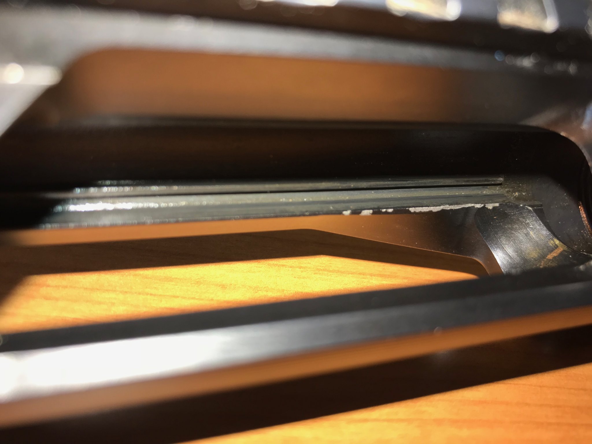

Which action is pictured here, nbutze? The port angle looks like a BAT but with such a close up I can’t tell. (And others might like to know as well)DLC may feel smooth at first, but remember the downfall is that it can chip. The metal under the DLC (paint) is not hardened. Once it starts chipping it will keep going and the metal under has no treatment.
This action was bought new in July. 1500 rounds through it.
The BAT TR is melonited (nitride) (QPQ) (case hardened) It will stay smooth forever.
The new Bat Tactical actions, the Elites I believe, are apparently DLC coated. Hence, why I asked. ThanksIt is NOT a BAT as BAT only comes in Melonite.
I would rather not throw the manufacturer of this action under the bus because it is the coating's fault not the action builder's.
How does nitride usually hold up?
Nitride is a hardening process and the black color is a bi-product of the process. The color wearing off is completely normal.I think I had about 4k rounds through my nitrided Tikka when I sold it and it had been used hard in dusty conditions. In the high wear areas in the bolt raceway, it had started to get some grey areas where it was wearing thin, but was still hardened there, did not rust and ran smooth. If you want an example look at a well used Glock. It's pretty easy to put several 10 thousand rounds on one and they don't show much wear at all.
