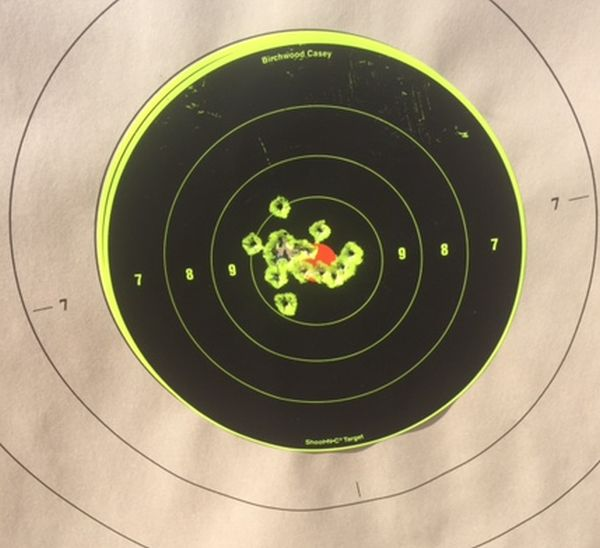

The whole box at 100 yards
The pic was taken at the Olympic Training Center in Colorado Springs.
Pretty much a standard 40X Elrod repeater in an AI stock with a S&B 5-25 on top. The ammo is a magic lot of old Eley Blue. They dont make it anymore. It was graded below Match and TenX but above Edge. It shot better than any other lot I have tried in that rifle. I bought 3 cases of it from Cathy at Good Shooting. I should have bought 3 pallets.
I later switched to a S&B 12-50 as the 1/8 MOA clicks enabled me to center up the group a bit better. MIL clicks were just a touch too coarse. I would go from one side of the X-ring to the other in one click.
Being electronic targets there are no scoring rings, it is just a black blob of rubber to aim at. It took a while, but I figured out how to hold center of mass and get decent scores.
I have shot several 600s with my 40Xs and Vudoos. But the picture above was my first.

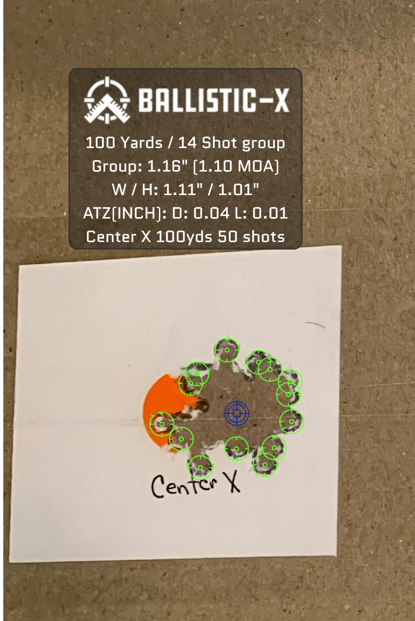

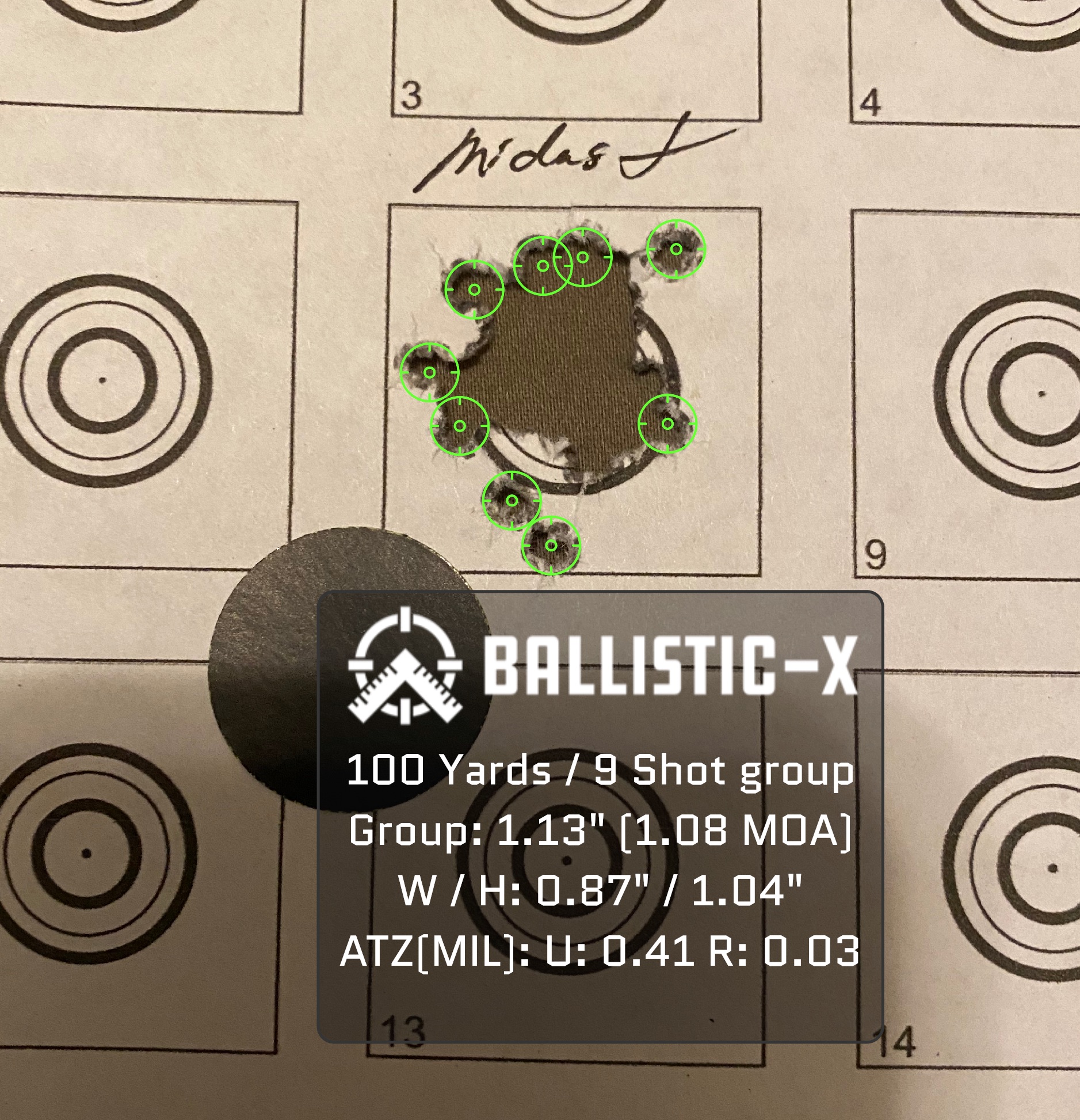

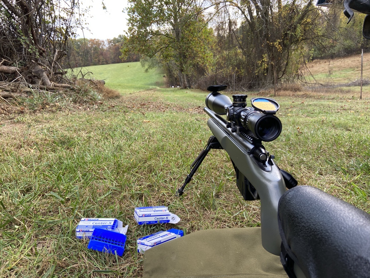

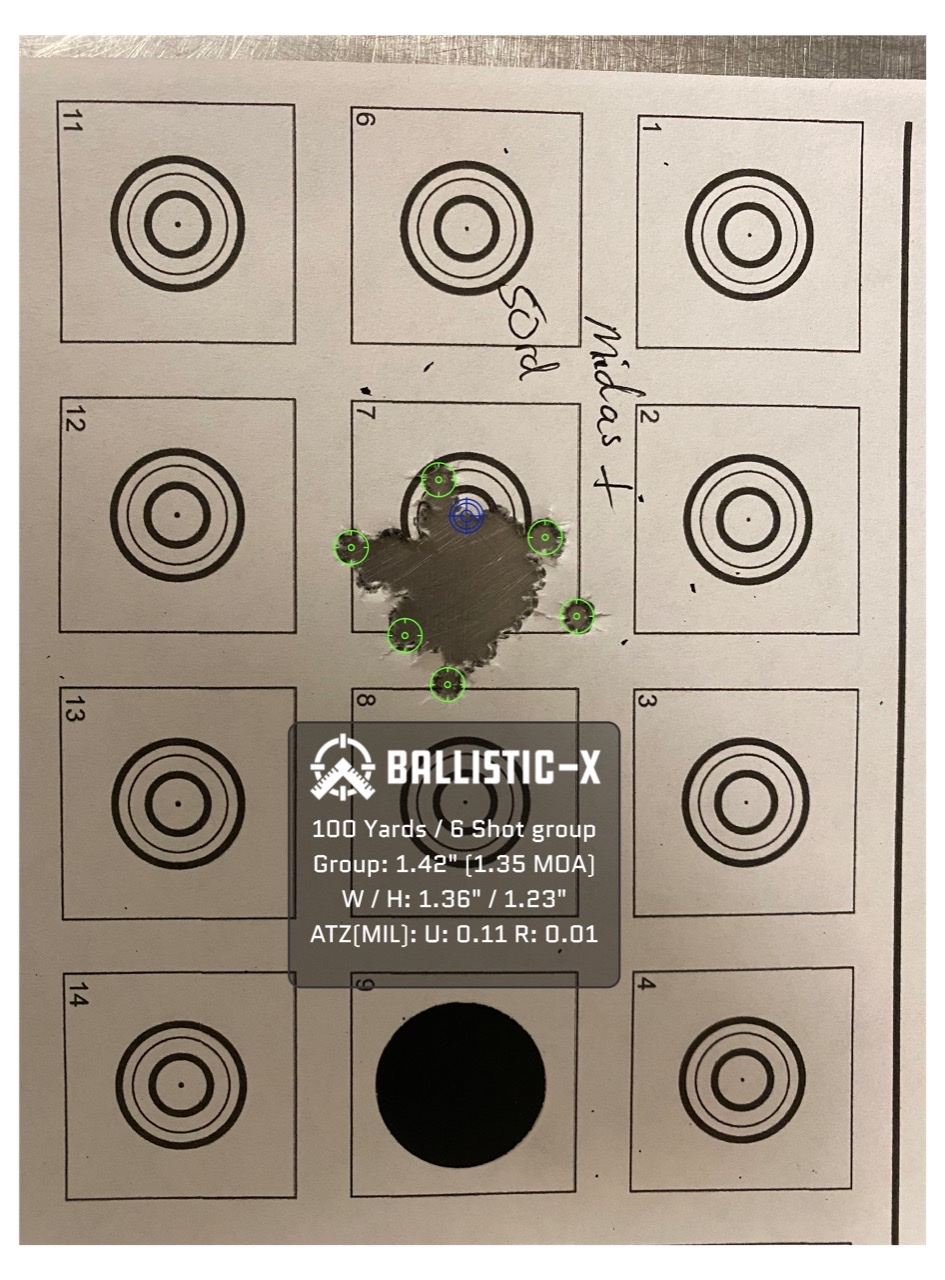

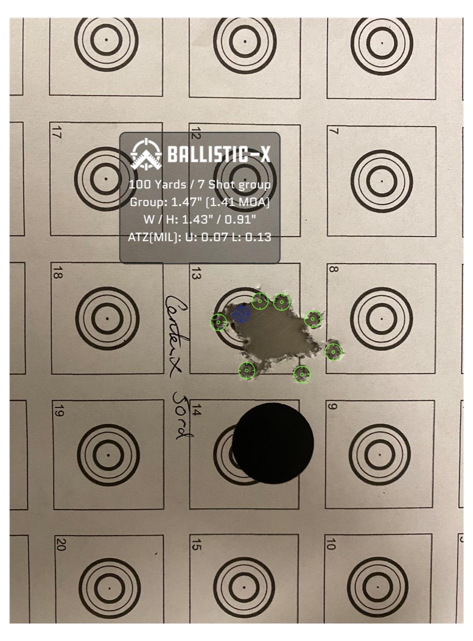

Well, i wasn't very happy with my results yesterday, so i tried to do better today .... at least i tried !
What i did learn was that Center-X is very temperature sensitive - much more so than i would have expected and much more so than Eley Match.
The top right hand target was shot first, with ammo from the house that had a powder temp (initially ) of about 18C (65F). Avg vel 1040 f/s, ES 42.
The Top left hand target was shot about 90 mins later when the powder(and gun) temp had fallen - probably closer to the 6.8 C (44F) air temperature. The POI change is rather obvious. Avg Vel 1012 f/s, ES 44.
Strelok gives me 0.5 mil drop with this temp change - very close to what i see. Lapua Ballistics gives me 0.3 mil so this dosent quite fit my DOPE ...
What are other peoples experiences with temperature sensitivity ?? Do you leave your ammo outside to acclimatize ? Or do you try and keep it warm ?

And here is 50 Eley Match shot right after the 100 Center-X. Avg Vel 1076 f/s, ES 33 (or 25 if you remove the two extreme values).

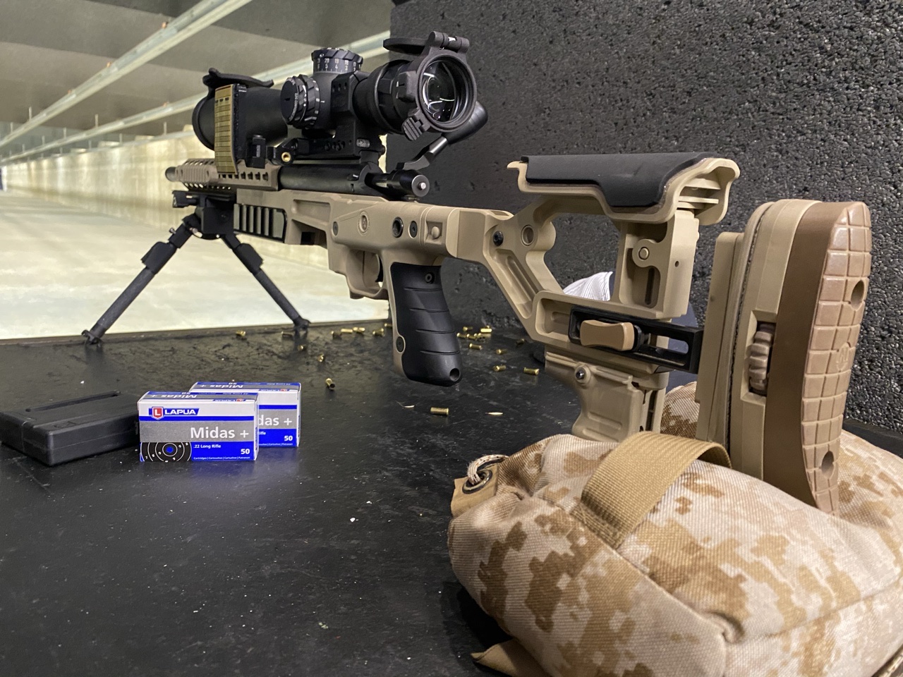

This time I shot the targets with a Tangent Theta 5-25 Gen2XR with the dot above the big hole being my point of aim. Rifle had approx 500rds on it since last cleaning before this. Now it has 650.
Thinking I am going to scrub the barrel and chamber really well, foul it back in with 20rds or so, then do this one more time. Adding a bonus brand of ammo to the mix as well for science.

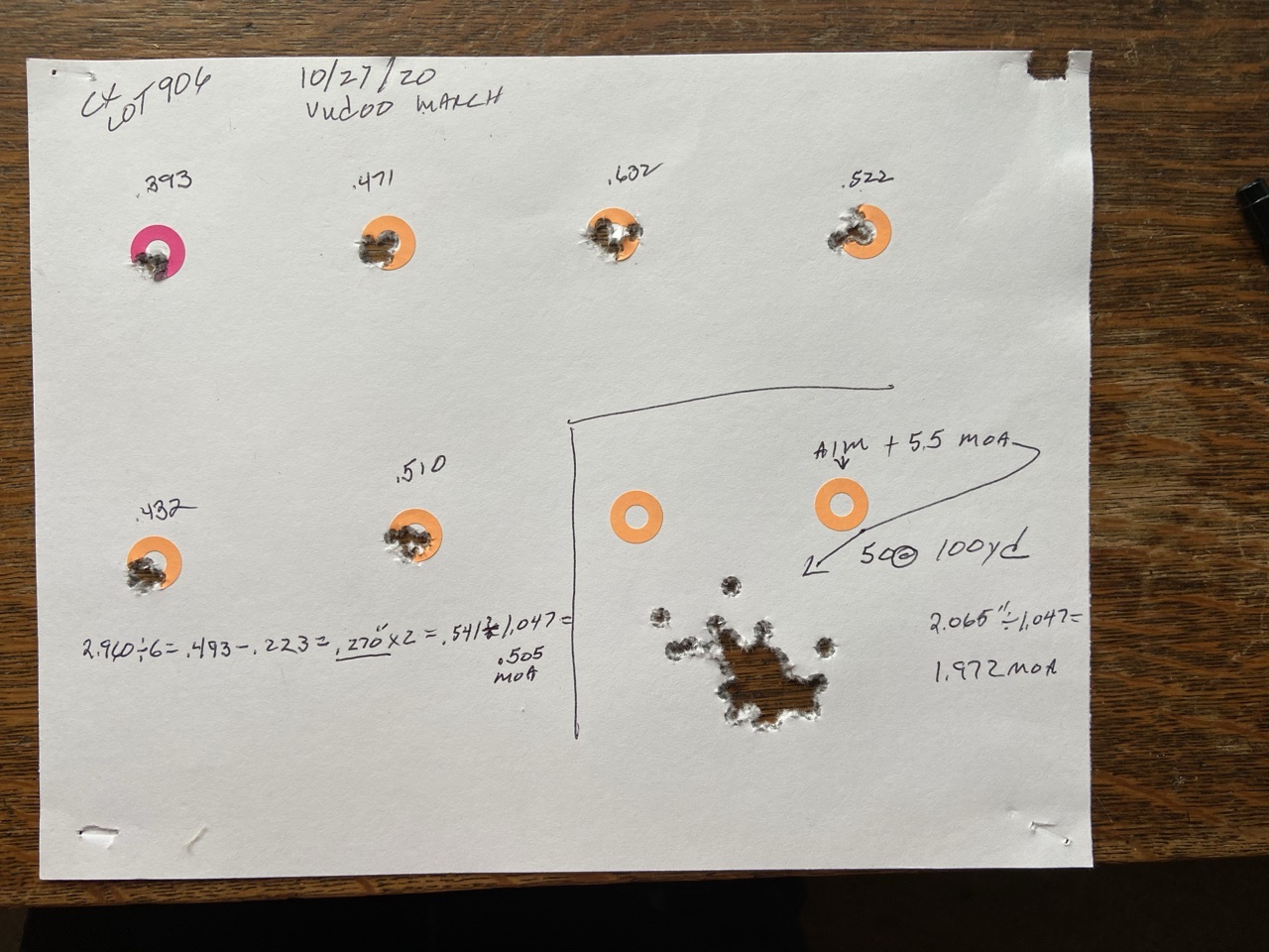

I really want to break 1 moa for a 50rd group at 100yds. This is quite the challenge for sure!

Because the machines and their measurements are reset with every new run which corresponds with a lot number, and are using the same powder, lead, brass, etc. through the whole run. The lots stop when either a component runs out, the machines are stopped for any reason, or a shift has finished. So there are slight variations from lot to lot, or you can think of it from machine stoppage to machine stoppage.
To buy from the same lot you generally have to purchase from a reseller who keeps track of that and you ask for a specific lot number. I'm not 100% sure if the bargain brand plinking rounds have the lot numbers readily available but I do know that SK has them printed on the boxes at least.

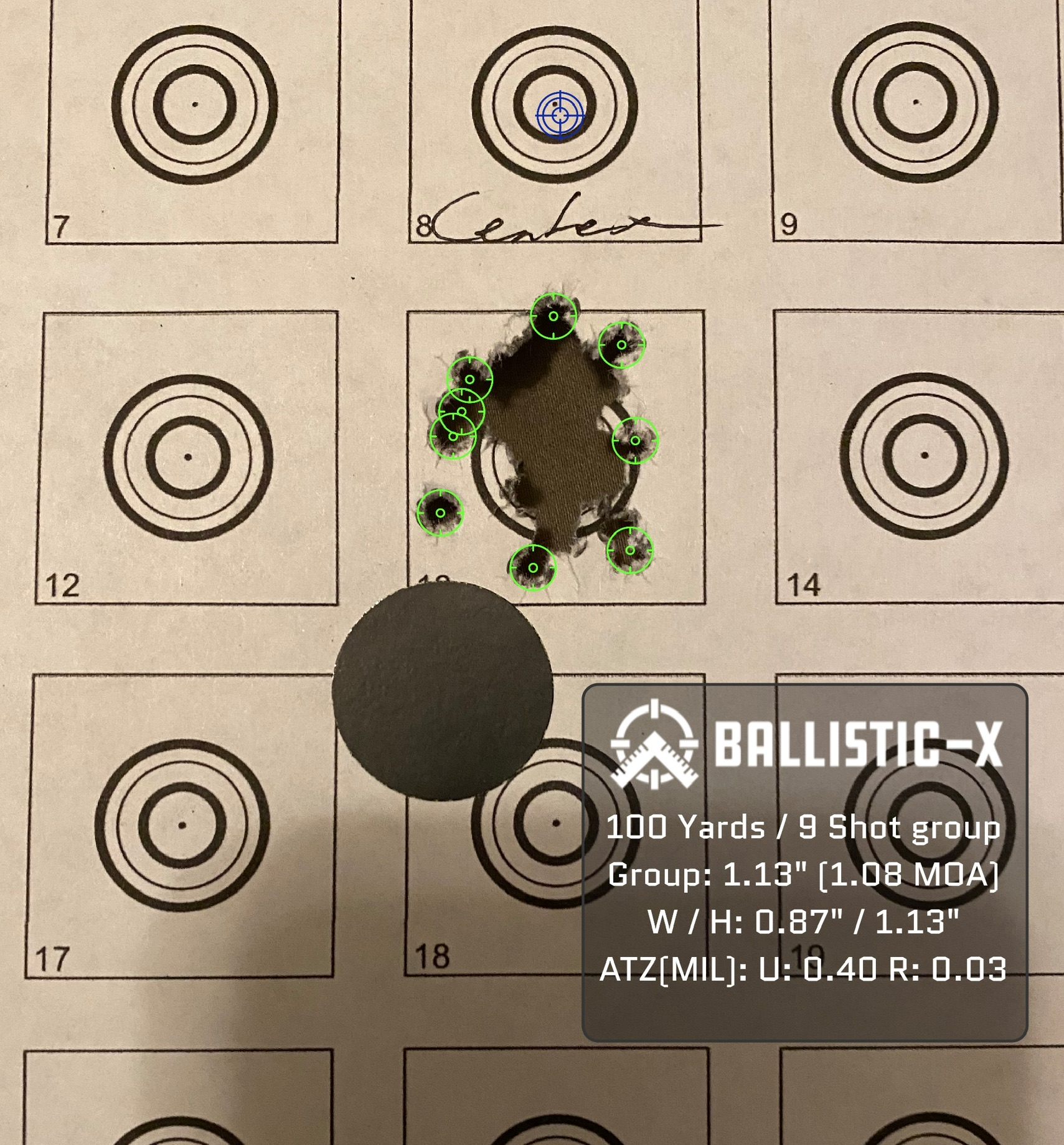

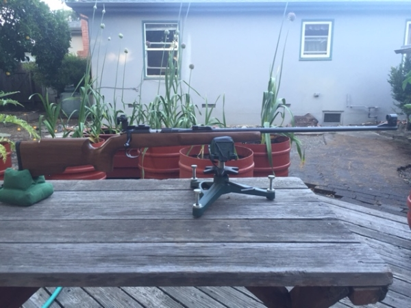

CZ 455 Feddersen Fuglie on the bench at the 100 yard range.

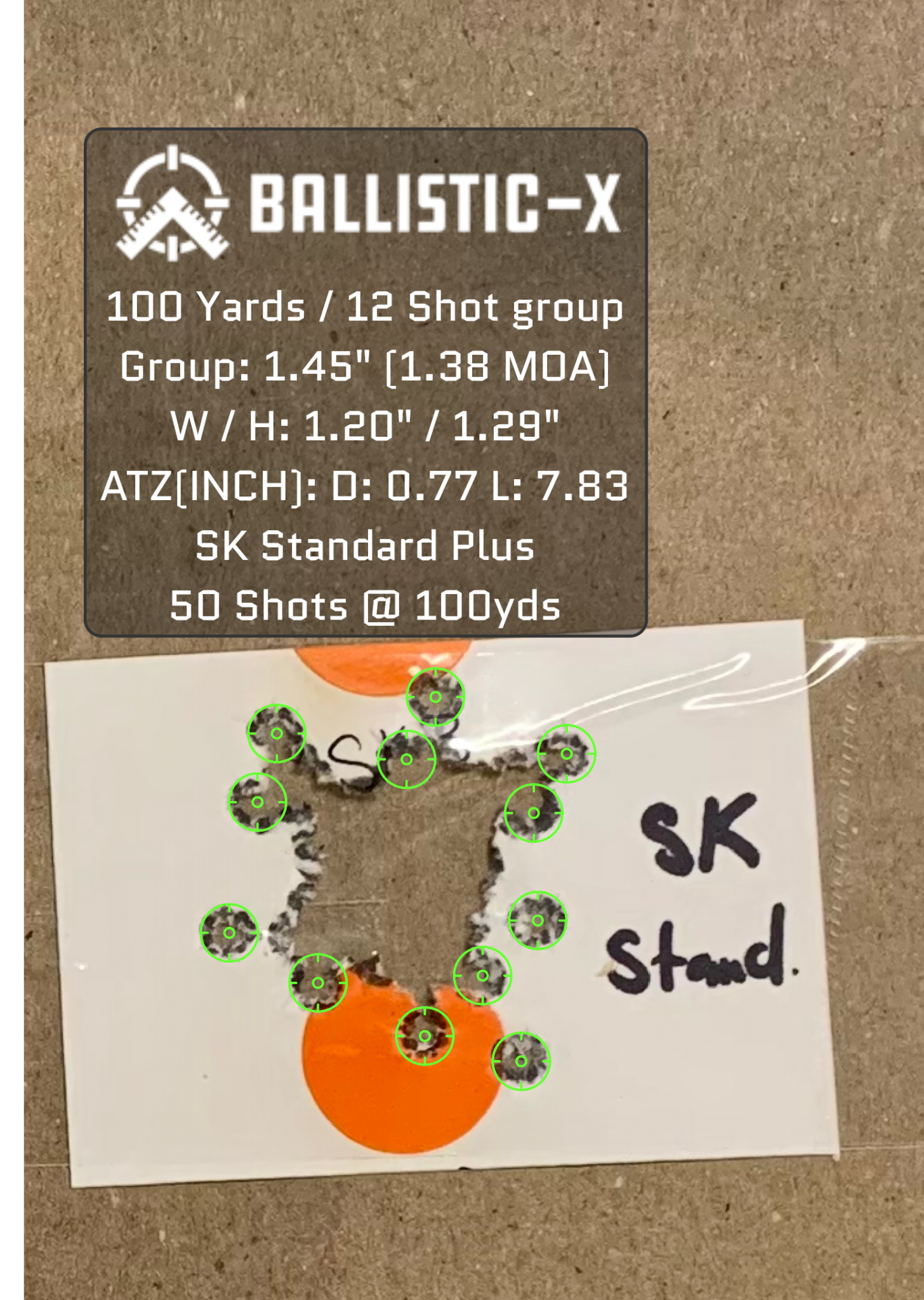

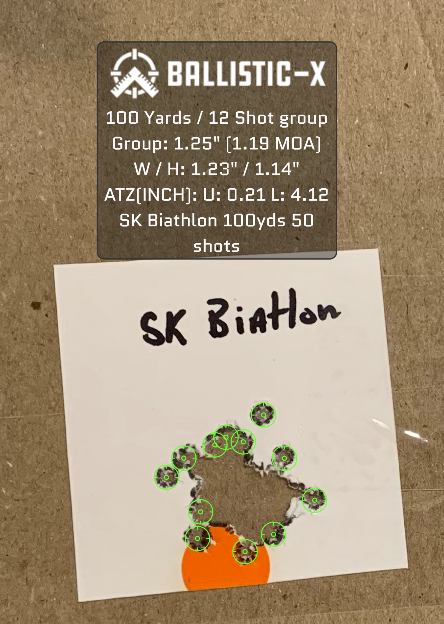

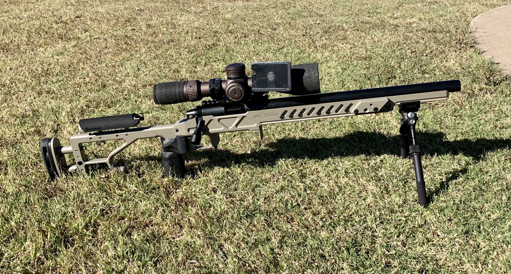

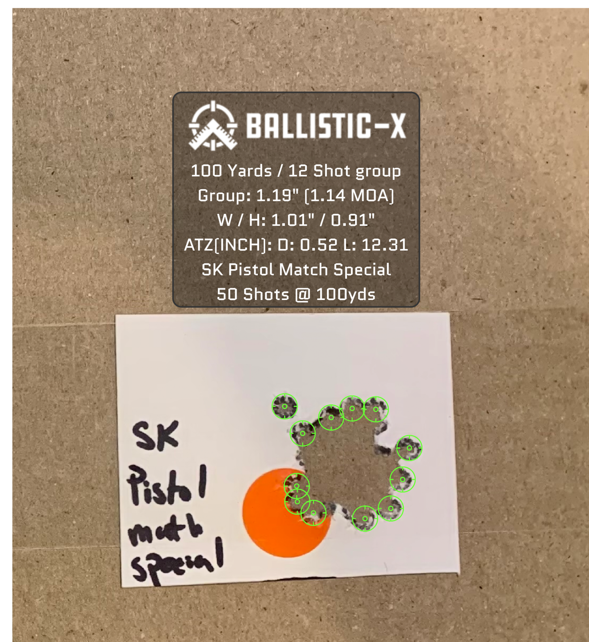

Well, i tried again. If it wasn't for all the slow rounds on target 2 i would have made 50 inside 1 MOA... Always useful to have an excuse
Target 3 is just to show what a 5 shot group looks like with this setup and ammo. Nice visual impression of the statistical difference between a 5 shot group and a 50 shot group.
The highest POI on target 1 was NOT the highest velocity, it was actually in the middle of the ES.
All of the low POIs in target 2 were under 1065 f/s.
Velocities, ES, etc are written on the targets.

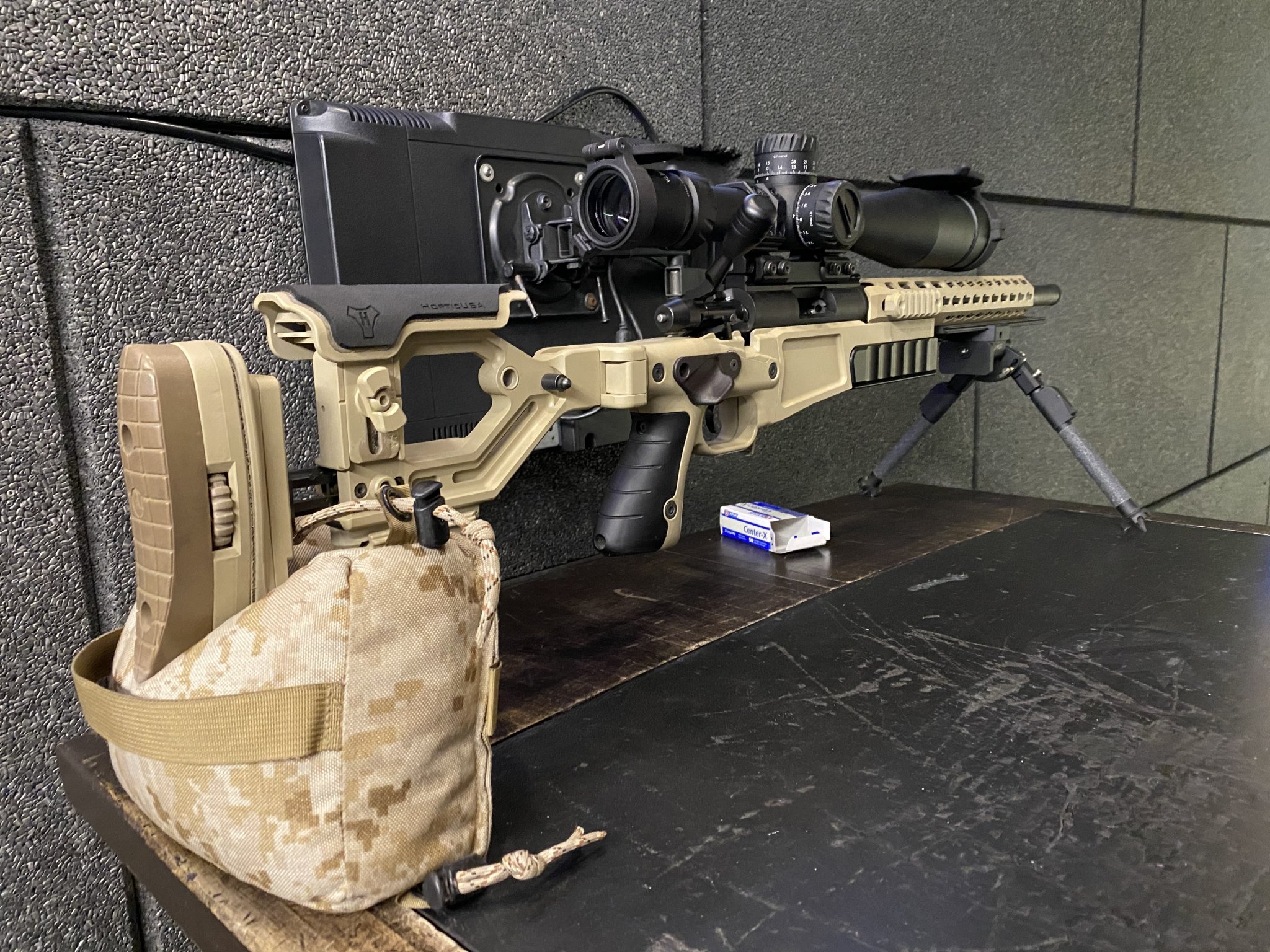

This was the setup:
Beautiful set up and excellent write up.
I'd appreciate it if you could comment on the following:
Is it the original barrel from Sauer?

Yes, it is the original 710mm (27.95") barrel from Sauer. . I dont know of anyone else who makes .22 barrels for the STR. These are rather 'special' since the barrel and half of the action are one piece. The bolt lugs engage with the 'barrel'.
There is a slight change of POI with the Magnetospeed on and a very, very slight change in accuracy - so slight that it takes thousands of rounds to get a statistically valid proof of the difference.

Unfortunately the Eley test range is on the other side of the country from me so i havent been there yet.
I cant get Center-X to work for me in either of my guns (STR 200 and CZ 455) when the temperature is below about 10C. I posted a comparrison a bit earlier in this thread.
heres my attempt using a mediocre lot of CX. This lot has averaged just over .55 moa, but i havent gotten anything new lately thatll do better. I have afew old lots im hoarding, maybe next time, anyways i shot a 6x5 at 50 which measured a bit better than this lots average, then i went out to 100... very humbling lol!
Reactions: ChrisFetter
So disclaimer on the below pictures. I had pulled a couple shots high on both the center x and midas plus groups due to breaking shots with someone shooting next to me. My point of aim was also destroyed due to shooting it out so if I do another 50 rd group I am going to dial a false zero so I have a consistent POA.
I only counted the outer most shots to get a good idea of overall spread. If you guys think I should count more please let me know and I will. With out further ado, here are the groups. (I ran 50rds midas plus prior to the 50rd group to let the barrel acclimate to the change in ammo if needed)
Rifle specs are as follows:
Vudoo V22 Gen 1.2 w/ 18” Proof Carbon fiber barrel
TriggerTech Diamond 2 stage
Accuracy International AIAX chassis
Zero Compromise 5-27x MPCT2 in a Spuhr 6002 mount
MDT Ckye Pod
OG Str8Laced bag with heavy fill
Center x
Midas plus
View attachment 7444963View attachment 7444964View attachment 7444965
(Black stickers are 1” for reference)
