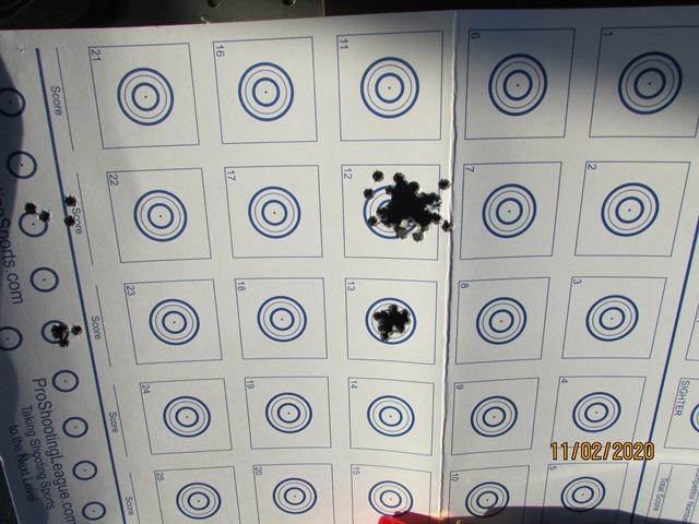

The whole box at 100 yards

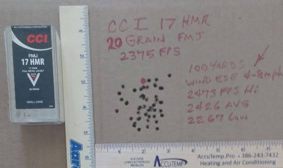

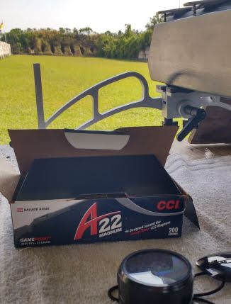

CCI 17hmr 20 grain fmj Gamepoint rated 2375 fps
CZ 455 Barrel block Fuglie with Lilja 20 inch heavy barrel
ACtC-3f1rmsE8RkLDfbN9Ht0FYx279YncAGhk3aL5frXDxUj3T_6h9tRMlfXw9ubNa6NtOfoXuh44iEKWFrIRWFIKfoRxgejJYQwKN8u1rSXxKtB7g37tDWkPZ3gmSHtR6kPsj4L6XWJarI5KAvP-2O1-aIu=w339-h556-no
Visual check showed variations in seating depth and angle.
Roll the cartridges on a flat surface and visible tip wobble.
Brass dimensions varied as well. Some chambered easily,
others required extra oomph to seat and close the bolt.
ES in excess of 200 fps.
Cartridge defects explain the spread on target.
ACtC-3copNIcPzJ-XfBUiYmYUnz4JF-dDxmEk8DHjSaY7sLqiK6YOWg0ibMxb7Wsx7MX_0Xg_06OKT3iOBEgR_mHNp4e4htANM8DSw4K9mu2-IjarE9-_5Lt0XgcOd4LpKocU6uX6ocK4uYTw8kcmpC3uVQn=w566-h337-no
2.5 inch spread for 50 shots at 100 yards
Reactions: sparkyv and drglock

1-3/8 inch spread for 50 shots in a quartering headwind.
Did a quick run thru of 50 shot groups at 50 yds and 100 yds. Didn't hold off for wind shift, just held center and pulled the trigger. The wind was about 3 - 4 mph. The rifle is my home made version of a MKIII with home made breech block and tuner.
Edited to say the target squares are 1.75" and the bulls are 1" diameter.

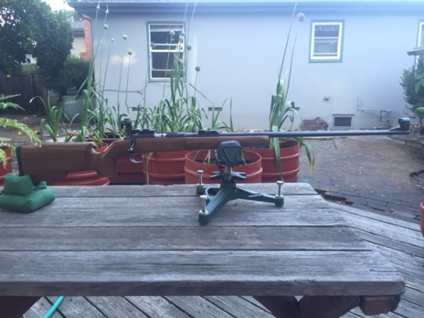

CZ 455 Varmint, Lilja sporter barrel, Sinclair bipod, Mueller 8-32X44 target scope

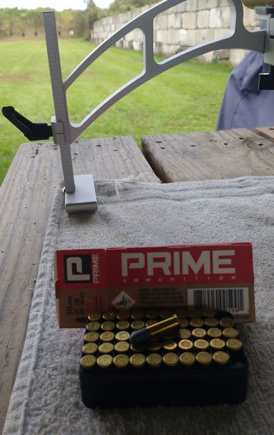

Prime SemiAuto manufactured by RWS, 40 grain 22lr rated 1148 fps
ACtC-3dyxBEjWsHoMeN7DmiZgjR-hS6Qd4edtTILql5uyCrOxf-1oykg7q0a7949saHGB6kihgHSjtFl28FoakO2yYFC3eV2Nes7o1_jccMVH555HkSof8UxmGrtsnDOxwjJgucosFZ7FGlqH4dFLIoMXmXU=w395-h626-no
CZ 455 Varmint, Lilja, Sinclair
ACtC-3f7v_uD_yncsrulCSVuxJWrCzRlQIHwt4D13ZHuZAax0j8SiKaEcWE5SVMoR6a6PhccqN6GS6uMTP-QSy8ySrQQq1t07Nk9612cK3uAalCzfHf15Dx6mHe-a0Uxl_KI9gb_ekCPK2ul1DE8lbPlkGty=w576-h621-no
Much more uniform in appearance than the Fed AM and Remmy TB
but still had a couple of strays show up. Probable cause is uneven seating.
Crimp to drive bands on a few cartridges showed a slight angle.
Reactions: camocorvette

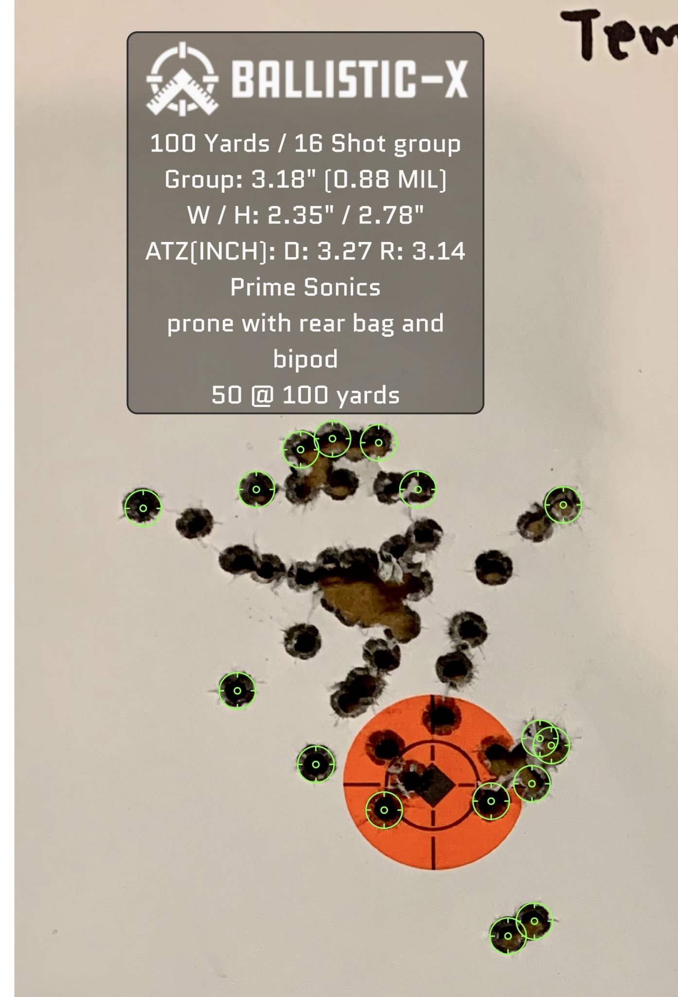

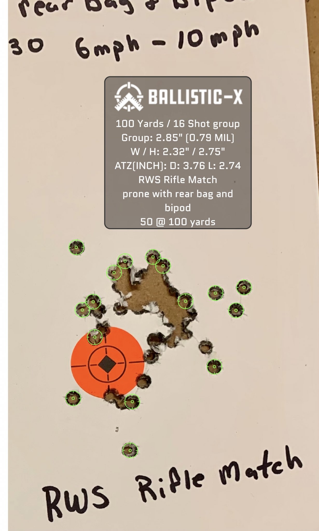

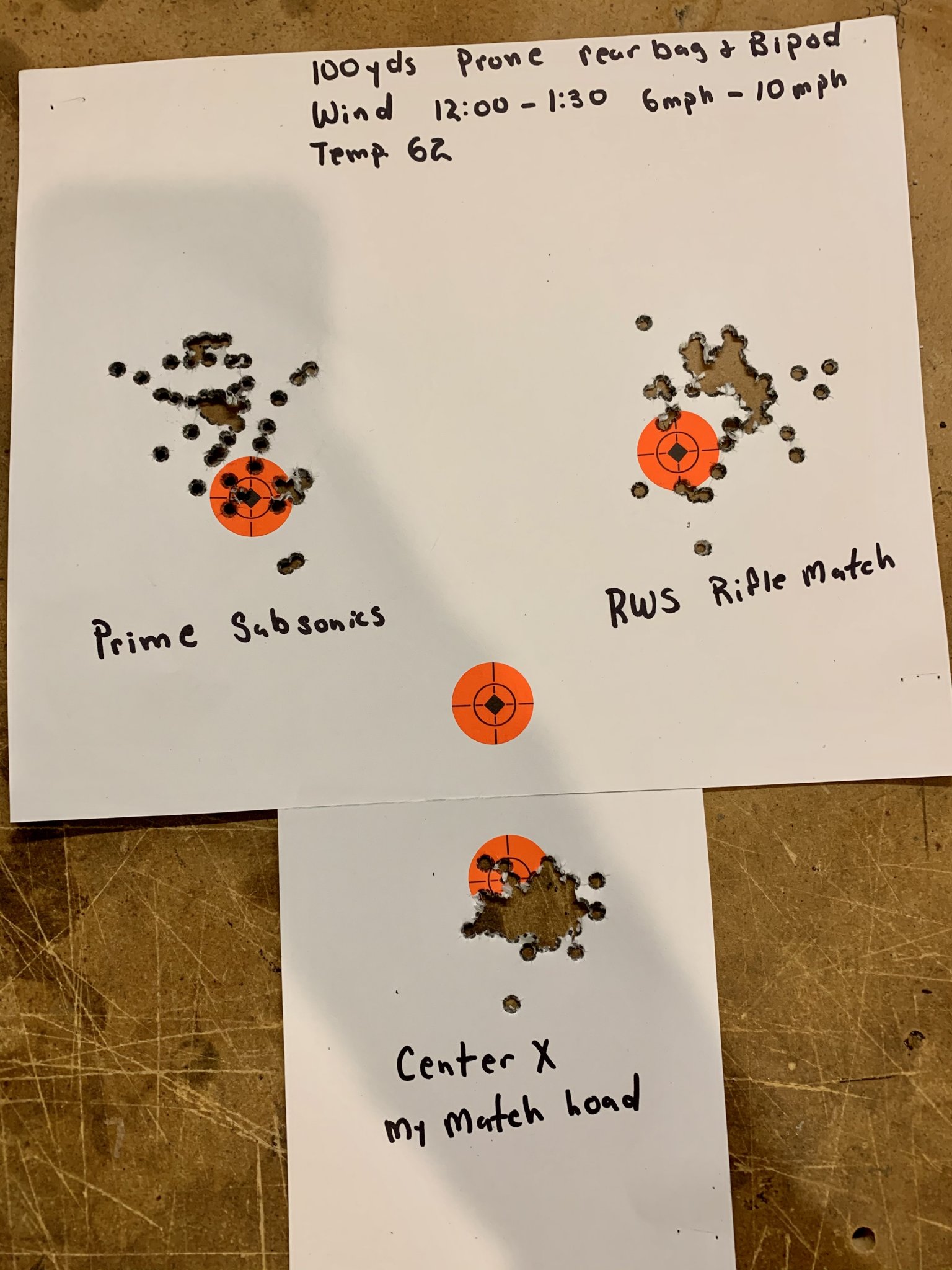

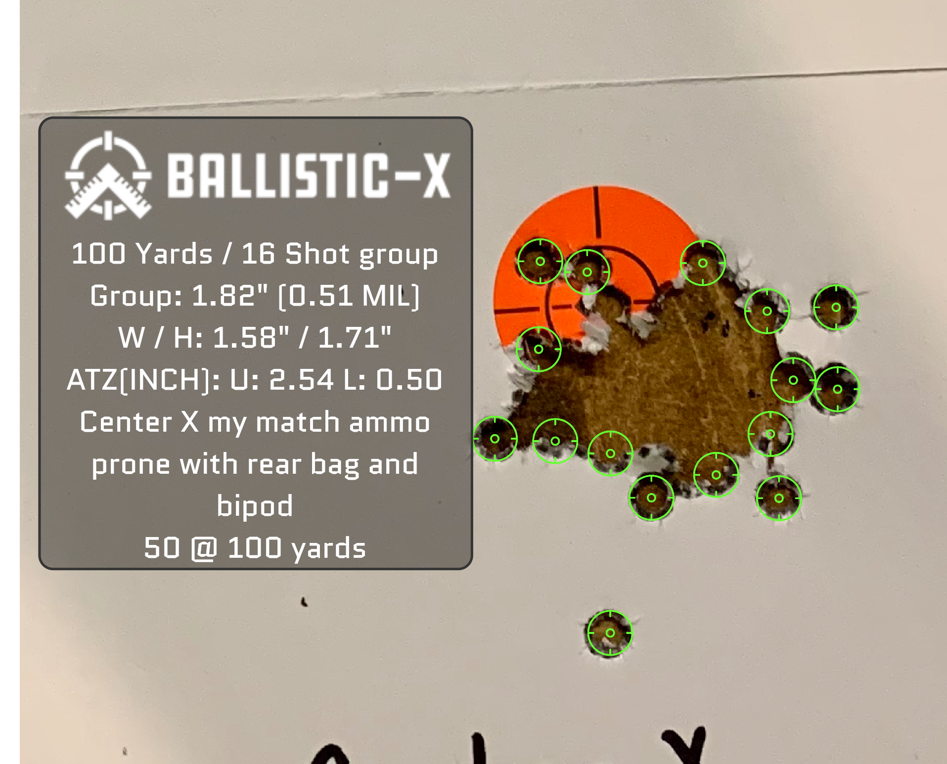

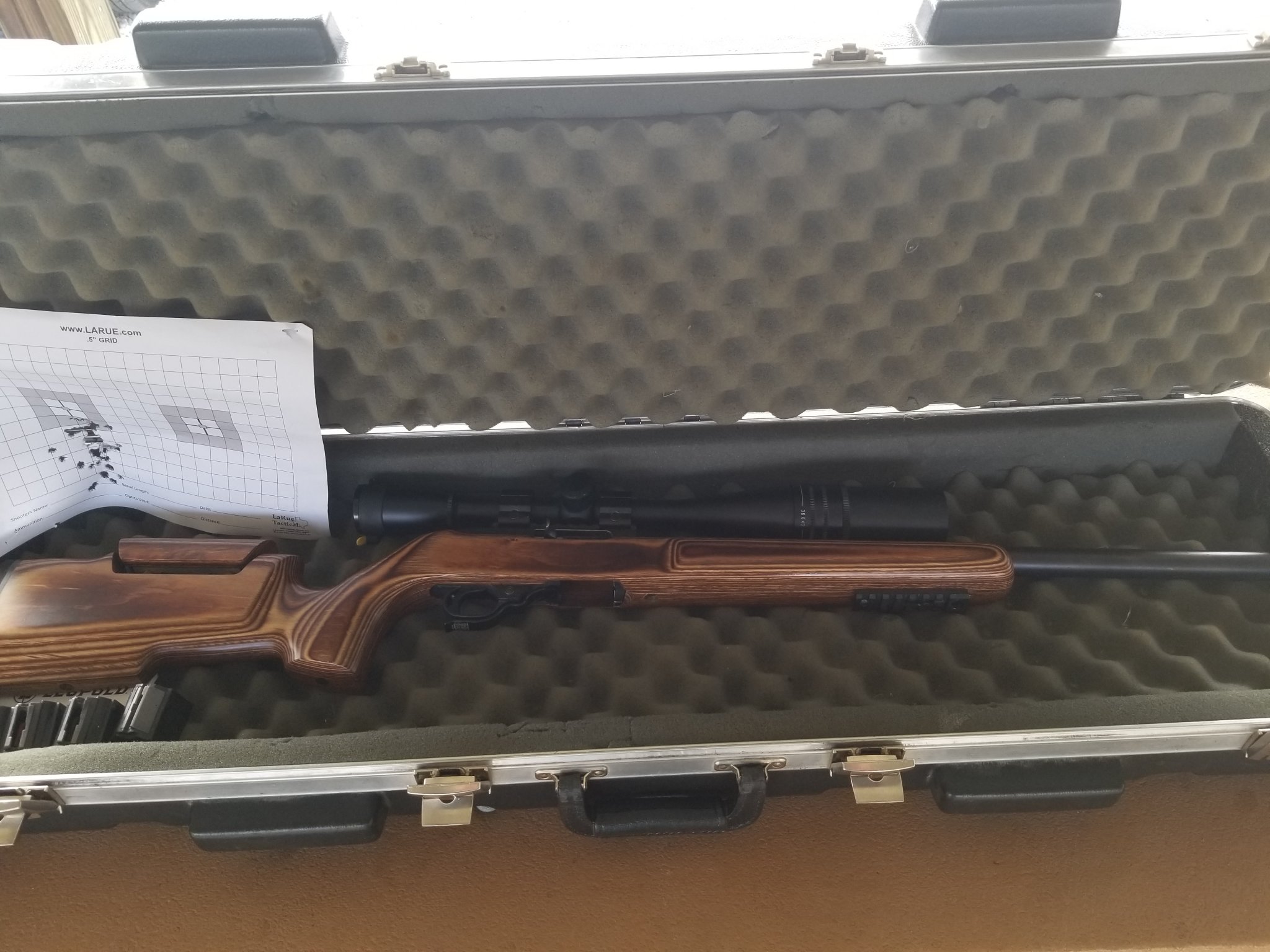

I wanted to play too.
Sk Match was quite disappointing for ES
H-1084
L-906
Avg-1040
ES-178
SD-29
68 degrees Farenheit
POA=center, POI= -1inch
The 906fps round dropped clear off the paper.
Ruger 10/22, Houge barrel.
Bolt face machined to minimum Headspace.
Kidd trigger
Boyds stock
Sightron 36x
I want a Vudoo.

I wouldn't mind having a vudoo too, HN.
Only problem is, I'd have to spend more money on better ammo
in order to take advantage of the difference in rifle quality.
Even a vudoo can't fix an ES of 178 fps. :(

^True, but it would give me a reason to buy better ammo.😁
I bought that ruger in stock form, used 31 years ago. It has been in the original birch stock, a Choate folding stock, then a Houge overmold with a new barrel, now bedded in the Boyds. Had a trigger job, multiple scopes. I've machined the bolt face, radiused the rear of the bolt, polished it to a mirror finish along with the firing pin, guide rod and installed the kidd trigger, buffer pin, mag release, and God knows what else. It finally runs like a sewing machine but alas it is still a Ruger. I have spent enough on it to buy a Vudoo. I consider it the cost of education. I'm hesitant to sour a Lapua in it. This proves I can blame it on ammo😁 I've used it as a trainer, shot in our local indoor 4 position, outdoor 50m offhand, and bechrest leagues.
Next trials will be some Norma, Wolf, FGMM, and maybe Auto match and CCI SV just to see the results.

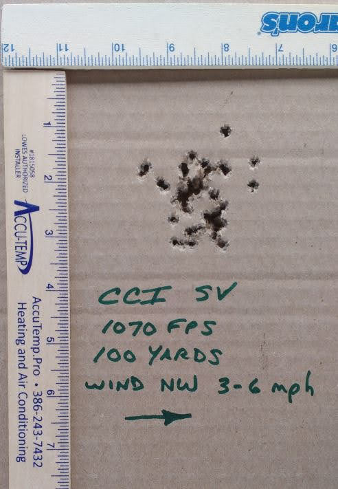

Fiocchi-USA 40 grain TMJ rated 1900 fps
Made by CCI for Fiocchi-USA...same cartridge as the CCI TMJ
ACtC-3f3zhRpGjuF5AN4Fk8MkUSBCKPPCGr-kmVvG2FTGSKxaHR_z5jl6lmm7HXLoRlr2TrS4pS6_nvOxI3yT9dB3iZCNNljM7EKbCTUdzXpj7w5Gg13d7heCvcVoddgY7UM417ysOq2Z7muWl2X-1LoZtdE=w356-h626-no
455 Feddersen Fuglie
ACtC-3cYhmdjlVDWsF_vsprVhQEGkEjYsm49jJELmDy4on_uXH3_eK_boBhNR-N6dhAcXcI9kgyH8sn3zxNrcSwVXwgzgYyMp3X9EqqfuAo7r84enezfg21fRT8AN5eQy4mQRmZnHPf8Vp7kV3B7Hyx6yx8D=w547-h626-no
ACtC-3dRl2rBipB61gAdomolU8IhgBfBql-BOt_xiDbwFVa00unEMY4EyED2XlyPbBpXSsc9AKTrhtTq4UGxyMnRF4CMncA8N1c2uv074hFL-cJPsinJ97xKM1w3C6uP2qnmMJoByyV5nyGtIpCNNF6zHg08=w752-h527-no
Those droppers sounded different and a quick look at the chrony verified slower mv.
That's CCI hunting ammo. Good enough for center of critter out to about 75 yards.

By the way, a shooter posted results of a 50 at 100, accomplished with a Vudoo.
0.86 inch group for 50 shots...so it is possible to get it done.
Check the bottom group...

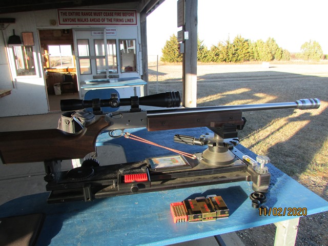

CCI A22 35 grain jsp 22wmr rated 2100 fps
Wind from my 3 o'clock at 5 to 8 mph
CZ 455 Son of Fuglie, Sinclair bipod and bag
-cqBFFPLGkM6N-mDqL88d-y72ceGOIbiHmpp-xc8I55BsyI1lVVIGgbNwgpd08QjSPJJfXt-g38x8aGuOeYuuDOSPzZMZt8c39MFE0u2G35EOVOGz7u-0FZ9ao-PTNKHCQ2XYouWWjJvAe7MfuGRTZ_IojmG2LXMGrgbEInRrrOOaPCRF6Y6I4M6QXX8pAF00GnxPxsA9uoeXR1isyHYPwkoM-Z7NlYJL3rWQZdg_ETuq8PLaBJkx6DU0EVVBjAdTI82S9lFxwFDWOBF_Vp5UAf29pYyNUYDnlrdVB_wLp4CMi_gfaKwUWCHfjiyVEcWByDV4TgvOMuDwAjHl-dOWOPp8pBFG7ZIcBFC2bjBoBh6ryWTuoiMbAAufFvHbKOxla9ZlKGGY_ZMRVV4yKyOXdbm5nNwP3-0tKIyigzPn6nmASFtlP49jWqDcFgKbcBl1ppffUfhVndi9TSYAZtmPkoUIcUlC7GDEaNKQLV4uOdRK724SUz0rIaejz1l99W0PtLlp54IBVBH8AjFaOq7K-n9bUh9QBF1gqdGu_Xvl5rgeOVzLKqZDjTzASBTS4reuaZjQ6JxWzTLsRq0ZCdj9jC38hcd8z95Ki6TyLypz9XNl7OWVQp556HECuT89cP7-hVGVhzIE7ACjtHPD1zKCWr13sVWmzgTqxoTq0IRpe0pNUkrPsb99H_Veav8tL-TZVev9rByiYxudBjyyIgotSBk=w326-h429-no
ACtC-3eiXFgyLBId118T3khS-j19JFEMNY26iPet-HTBQ4W9Vz5OVc2HzH3vx7xEXdcmDM9AyljKUkUinvYfwUcGrNr-a0fpjBXl4Y4OdZMZabEsglgq7TrqVM3amnWIs40euiZhPE2wpZrmVGJk2mHcLbRu=w763-h549-no
3.3 inches horizontal spread, 2.3 inches of vertical.
Look at how those group centers shift.
That's why I test by sending all 50 at a single aim point

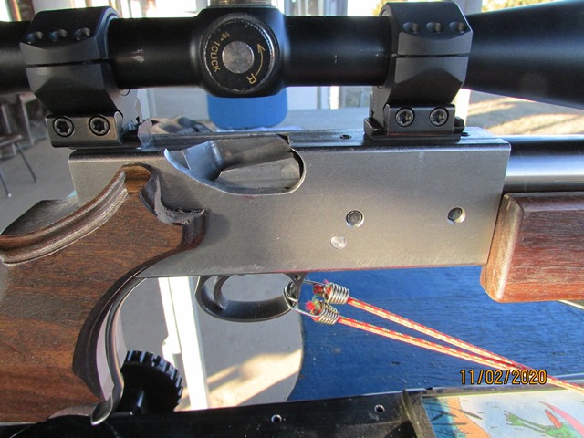

Hey...why are there only 27 holes y'er asking? :confused:
Well, there's a good reason for that...
ACtC-3f6ha4M-yjYNGafQQwgdHQnVAAH64RFq711fOIe1yZ43RfbzGBF1tx2b2NK-OPOxrwhT0IcUtXhTxHw_bfWc-U7GPWswaO-OW04GbZQJ9D-Ie9qujf2v6f252gZcqUkf0bsc-vC8QevB2ZR79PxtjXJ=w382-h626-no
That's what's left of the magazine and mag well. :(
Case rupture/head separation blew out the bottom of the receiver.
Put an end to my morning of shooting while I picked up the pieces.
Bits of mag well and magazine all over the deck and bench.
Yes, the cartridge was fully seated.
Yes, the bolt was completely closed.
No, there was nothing on the bolt face to change the head space.
The head simply blew off either due to a weakness in the brass
or, as the chronograph history showed, an overcharged cartridge.
These cartridges are rated 2050 fps.
The chrony showed a high of 2406 fps, 350 fps higher than the rated mv.
That 1907 fps low, was the last shot fired, the case rupture.
Even with the loss of seal, it still exited the muzzle at almost the rated mv.
Daaaayyyyuuuuummmm! :eek:

Trigger no longer functions, something is inside the bolt jamming the firing pin.
The head separated right at the rim flare
No bulge on the chambered brass, only the rim failed.
