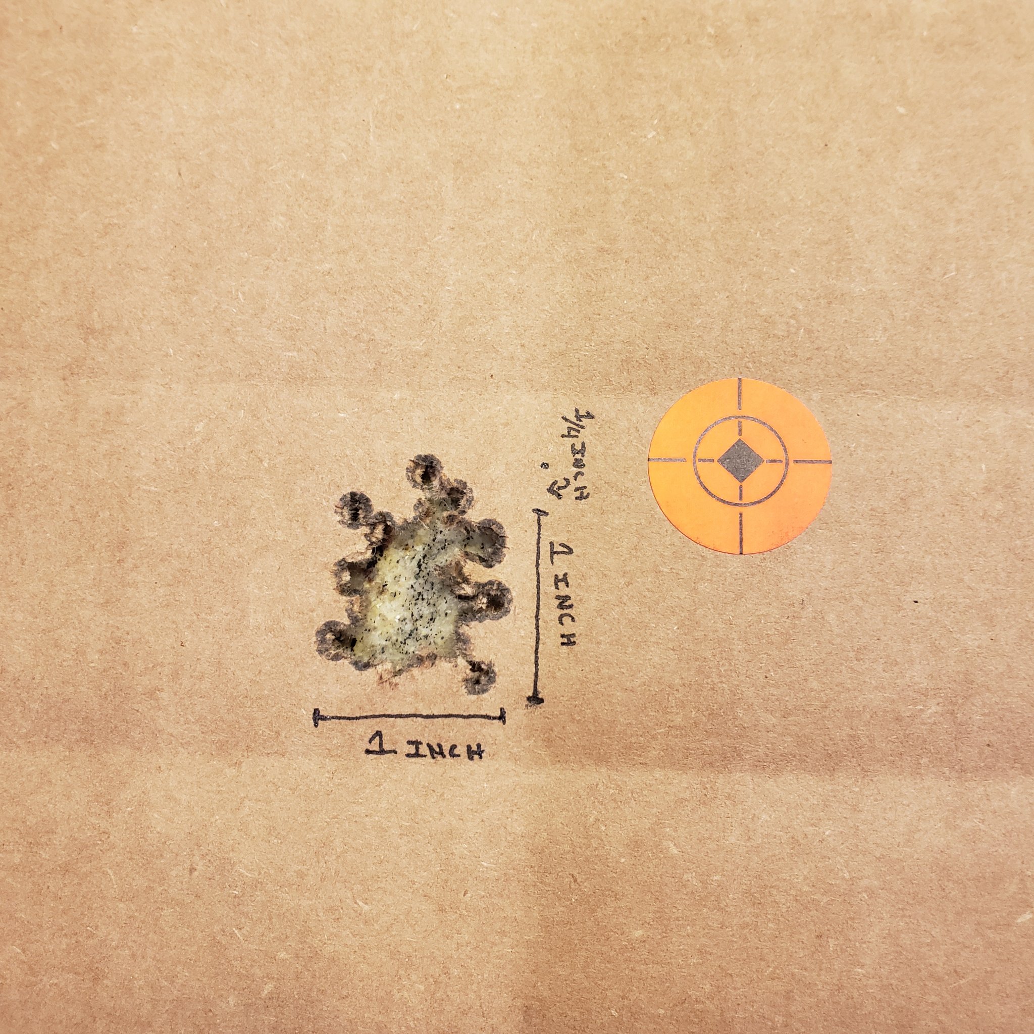

The whole box at 100 yards
CCI TNT Green 30 grain jhp 22wmr rated 2050 fps
CZ 455 Feddersen Fuglie
ACtC-3dO5_Qh7defGTYMQVtnbeV6KutTrTIxO8qrtl0613hvsdhN0eRw4R4PgrJsMxsjdz7eXY2vQ524ih4cBcFzkCd8lX4IMEpFq4tN1x4smok0UB_nkTQ5ELbtFNVOv7fNbdt2BgQWc_HFTm1EXTMVJY_Z=w349-h626-no
ACtC-3dZ7EtXSLJbaJdGeWUqHPPQc-v8KU91kGgu7wd4q6Cl9rA_Qjn2c0lIwiRlnohEAcFWt2V8EFYOrWfbp5HemAXvrPYA41mJF1p6jMUkjzrkw5dSVbZV453E3YLh_dpxRHGW3AAuHD3UlbfdPeZUSWP4=w404-h626-no
Hey...why are there only 27 holes y'er asking? :confused:
Well, there's a good reason for that...

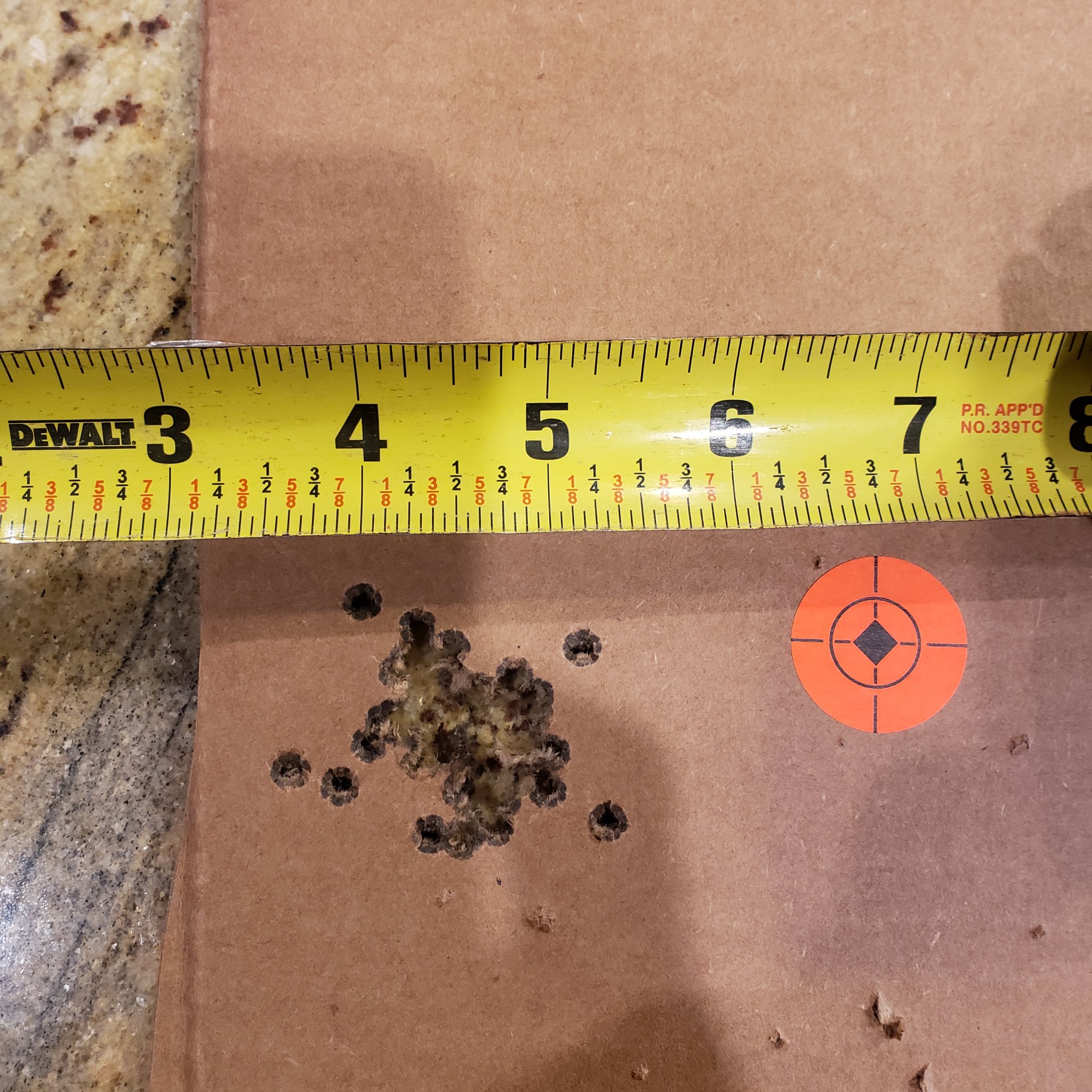

Remington CBee 33 grain cphp 22lr rated 740 fps
ACtC-3fwXomZg_HuFa921oZUvO3rYJzT4OPxS5OAZIyXeY_f4WiJMeIRa_hDXdwnwgALP1KhO_Sn022PDqY5q3x5WLT-HWe4qqbhT0Sk9UkYRQNpjQ6WLwPENxpaIlOHD05pl2A-sDDGmj2R3d4IKh80Ql4d=w455-h626-no
CZ 455 Lilja, Sinclair bipod
ACtC-3fkffEtnNCT7RhRHGKap56OtPY_jmzvhuFVmBG__NK5q76jbUCCCiyzrWYUC58jrBA8V_8c5RC41n8mUa0LjT7ZtQpsiVytyCR_gkcBqmLXR-MIOiVF7cS6CS2blDVbUZfj9KTR96QNSfVbh56wf8vP=w438-h626-no
Visual check of the cartridges shows multiple problems.
Deformed bullets, dents, dings, peeling copper wash, irregular seating.
Not expecting anything worthwhile from these cartridges, that's what I got.
ACtC-3cebnOjCjCPV72fcGmiH2qAkwk0ysCTL7PN6iajS1-V-0Tm1wg7Ec7GDWSOd0NHPCpNXI05pCzVNiKZ4tMQUMoU6YUju-NwBk6ADLveTl7k1Qfg69FoL7F4SsmhlQfuWQU-LfKKi-TEmuqP910WqxjG=w525-h626-no
Those 18 cartridges left in the tray would not chamber.
That's 18 out of 100 that wouldn't meet saami specs.
Those deformed bullets would not seat, too large a diameter. :(

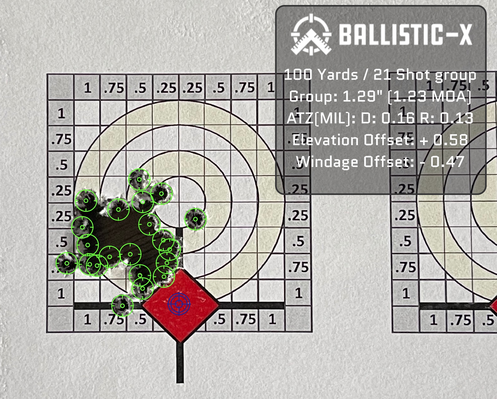

Vudoo 22, Ace barrel, Center-X. 100 yards, no wind, 31° F.
I am curious how centerfire rifles would do on this test. Better, I’m sure, but probably not as well as most think.
I’d take this all day long every day for what I do. I mostly shoot NRL22 type of matches. I try to shoot at least 2 matches a month but I also love to get to the range with just me and my 22 and shoot groups just to see what I and my setup can do. Anyone can go out and post up a group here and there that are in the .5-.6” range at 100yds and even get a good 6x5 now and then but doing the 50 at 100yds is a whole different animal. Anyone thinking they can go out and shoot 50 rounds under an inch every time is going to learn a cold hard lesson.

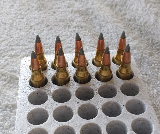

Eley SemiAuto Benchrest Precision 40 grain 22lr rated 1080 fps
Couple minor dents and dings, clean crimp, some minor variations in bullet/brass dimensions

Visual check of cartridges shows multiple problems.
Bent polymer tips, uneven seating depths, varying cartridge lengths, varying brass lengths,
uneven case mouths, sloppy crimp, varying brass diameters - some tight in the chamber - some wobble.
Results, as expected, less than desirable

gBzfA0DbPYnL6MT9w2A8-nf3QjN4GRnF5u5kpR6R41k3R_zi5USdZOawgcAbw98C8Wipk-TnUTmg6FTI6ZtJyYWVkbvxHVlhjNeq7gQJuZ_9d1QDr18ob8Bn1NQ-KfhKmlTjqRcSi4Ly93DrENjIkcRECubcemwH_KE2v5GFSGsw3Bdpf4gz65UItgyNbxM5lowFzIuqdOmPvEzQWeUXCi0aMeaALbughwXzDEgFqyJOE5e2_uiaIV0bQcUI9aZi8mc0UYBzbwEANiO7dPz9XQiPglKJrCPDH_3TSUj98KVxQnIeeRWIOx7e1PE-QJHByMuqZBS9354fTs1ypK2UVDjWuy-kuqrh0vnzO40VdJAlXnGNNYYL9nC90dDWgeJKHyPoJONeXn3Fn9x5jbgQjbvFlM4CE3uxKX50pjM7hHdfaK28-aVH-0LTjTxsP0J2t-xqnSoE9FwNvcdxj55e8yaM9PuGW1zXs-3hvunLYgS8mdPjgxnVKq8rzxfPO7yDUqCIYBH1o7IGRaX4pfp5Isf_6IZZT5bPUEpfjKP8c8gjAQSbv-yUkgTHhRg6Dt0IEASKX2DbjqbAsTwD3TdTGnta7WTnYczI1oZt9bmatJTSjBcnhLzh9kkr1kVg_ZlVIhEHAqhIADR82pCpAMoUGdzGulxVTS8K7Jzgmk8by2hPr5XZ-ZJuuVuKk4HZ=w468-h553-no
That's the group aggregate from the ammo test done in 2010.
25 shots at 100 yards.
Link to original test below...
I haven't put calipers on it but 1st glance looks like it's a hair outside 1 moa.
Reactions: Dr. Strangelove_207
Daaayyyyuuuumm HS, that's almost as tight as the results from a Bleiker in a test tunnel!
With twice the number of rounds sent!
Just over 1 MOA... like I thought. 1.099 vertical. Well just .052 to go. Imma wait until it warms up and try again.
