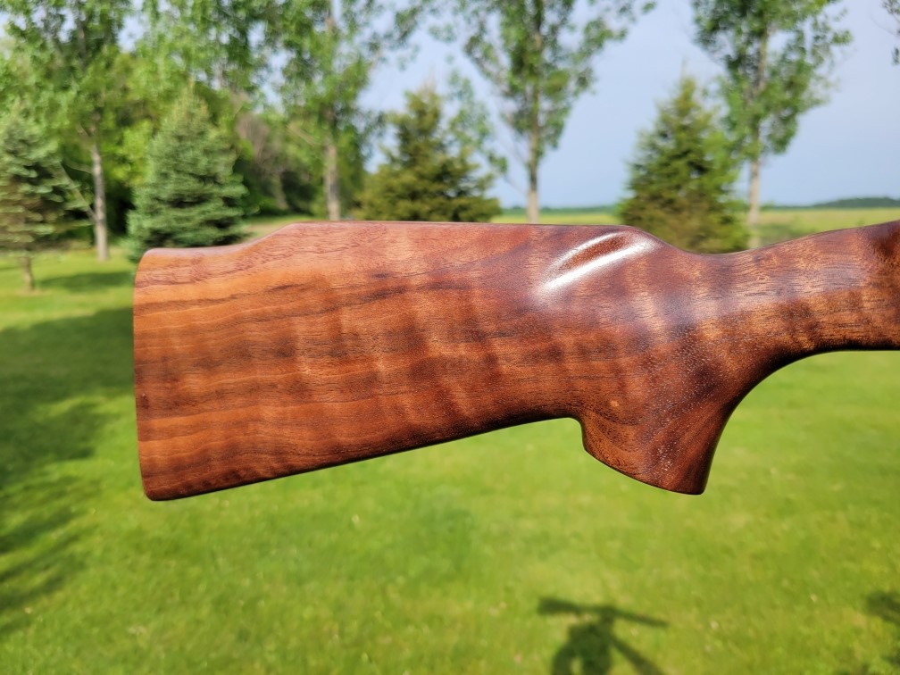

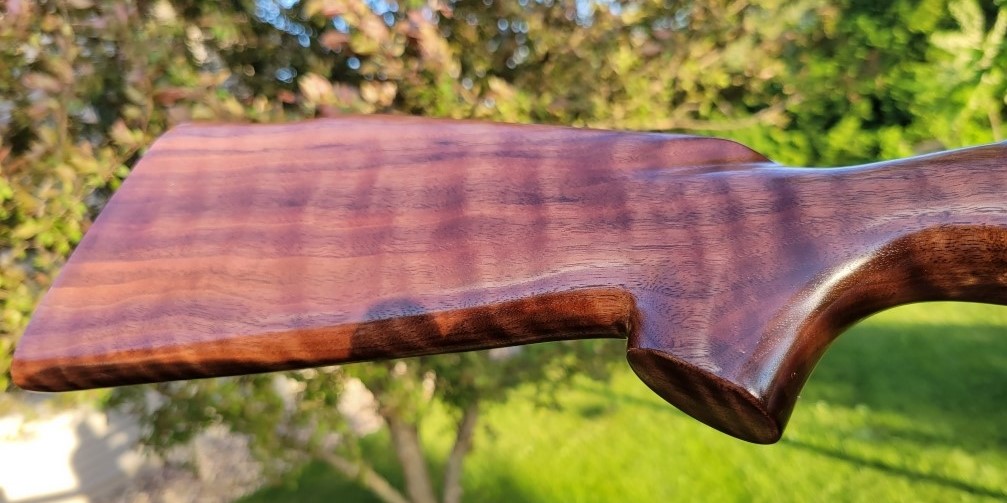

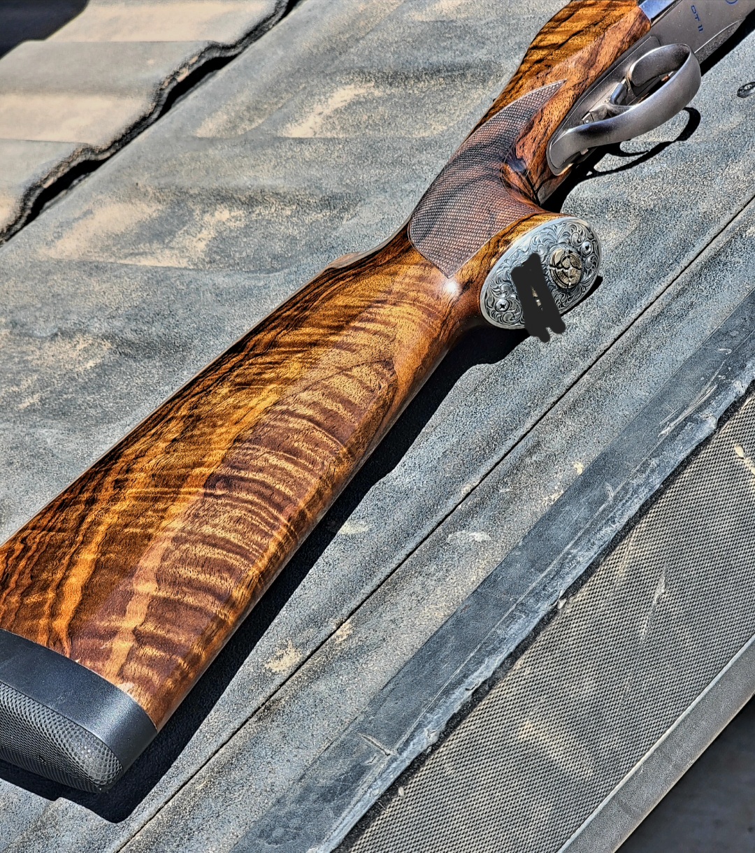

Good man on the site, @deltawiskey , is expecting some sweet M40 wood in any day now.
He was aksing me about oils.
I suggested unless he has my sickness he aughts to be speaking to you regards your finishing oils if he wants something spectacular.
For pure beauty, Timberluxe. For a M40, can’t fault what you use!
I plan on giving that a try, thank you very much for the suggestion!
DW
Rub it in good. It’ll really start to come alive after a couple coats. Keep in mind that it won’t have the same wood feel as linseed oil, but more of a hard shell depending on how many coats.
I’d get 2-3 of the small bottles over the larger jar. The shelf life once opened isn’t very long. Lasts a little longer in the fridge, but you get about two weeks after opening before it gels.
I’ve used timberluxe regular and the #2 formula. They both work equally well. Both work over cyrstalac grain filler.
Reactions: deltawiskey
I appreciate the tip on ordering multiple small bottles, I had one large bottle in my cart...ordered 3 small bottles instead.
I will let you know how it turns out
DW
Reactions: pmclaine
DW
No worries, and I think you’ll like it. It really does bring out the chatoyance extremely well. To me, it’s worth the price.
It’s definitely a use or lose finish though. Once you open a bottle, that’s it. Use that bottle up because it’s going to gel.
And the best application method really is with your hand and fingers.

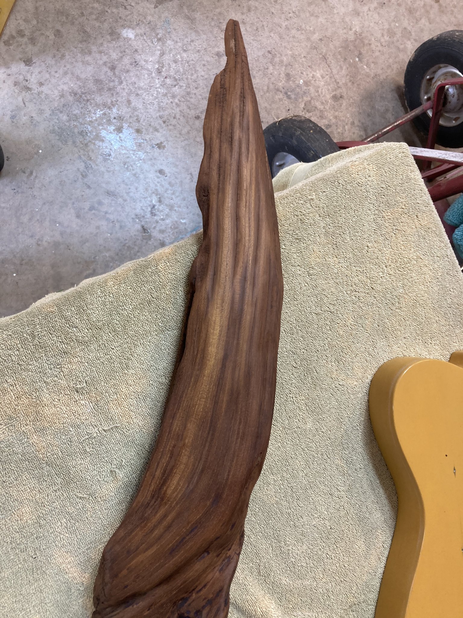

I'm cutting down a chokecherry tree that is slowly dying of some disease that's running rampant through this city. All the chokecherry tree's are 'kaput'. BUT, it's looking like a nice interesting color for that which I've cut so-far.
Anyone ever used this stuff, for doing anything? Make some grips for My Lady's 1911? Some of my Smith's?

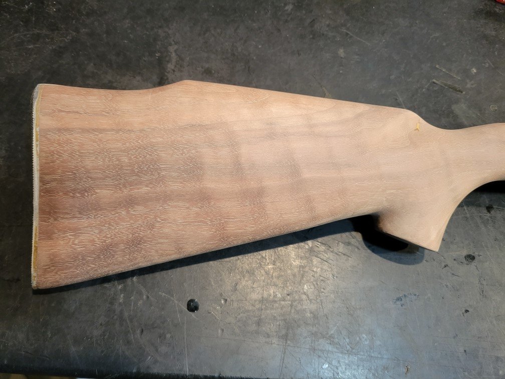

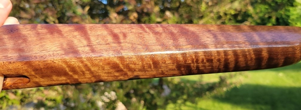

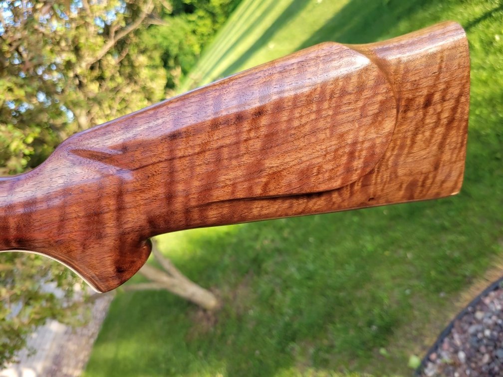

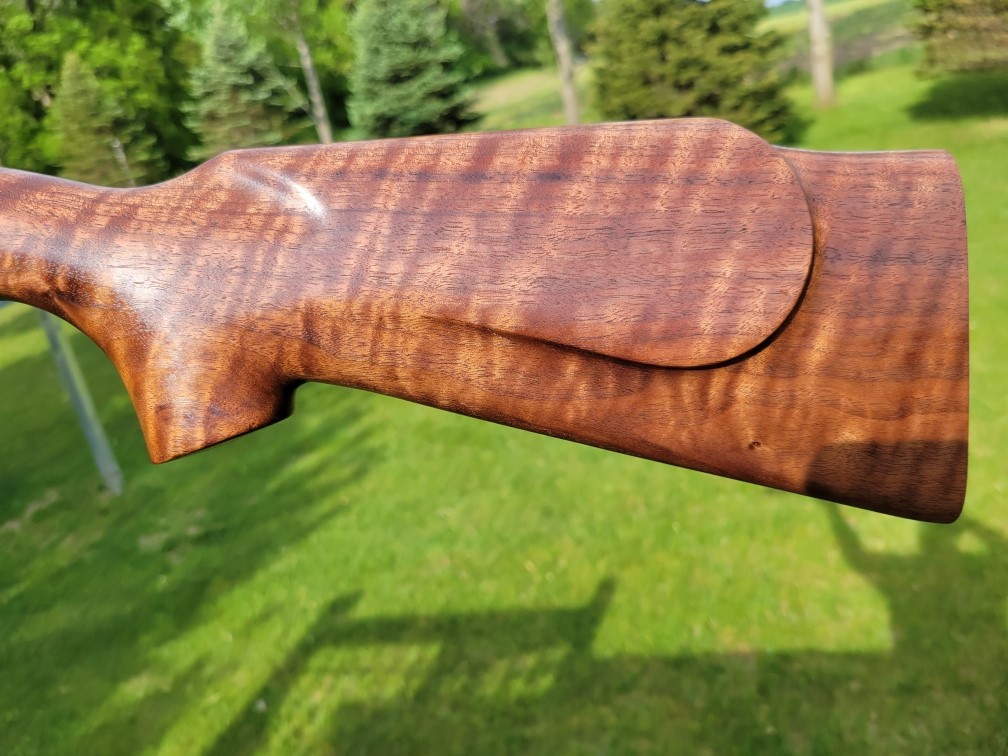

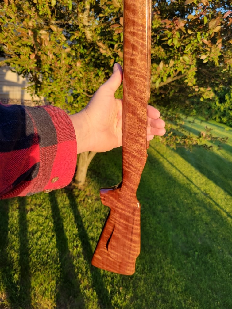

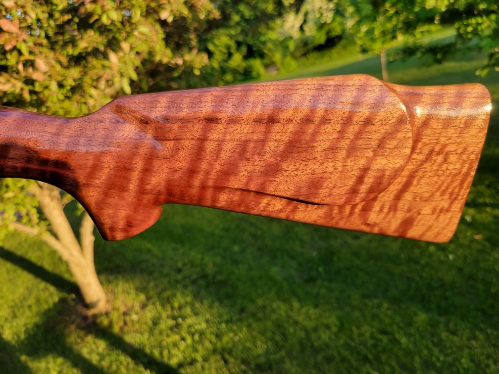

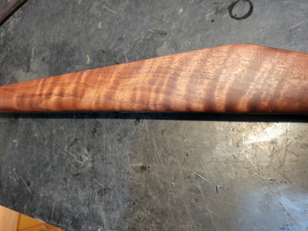

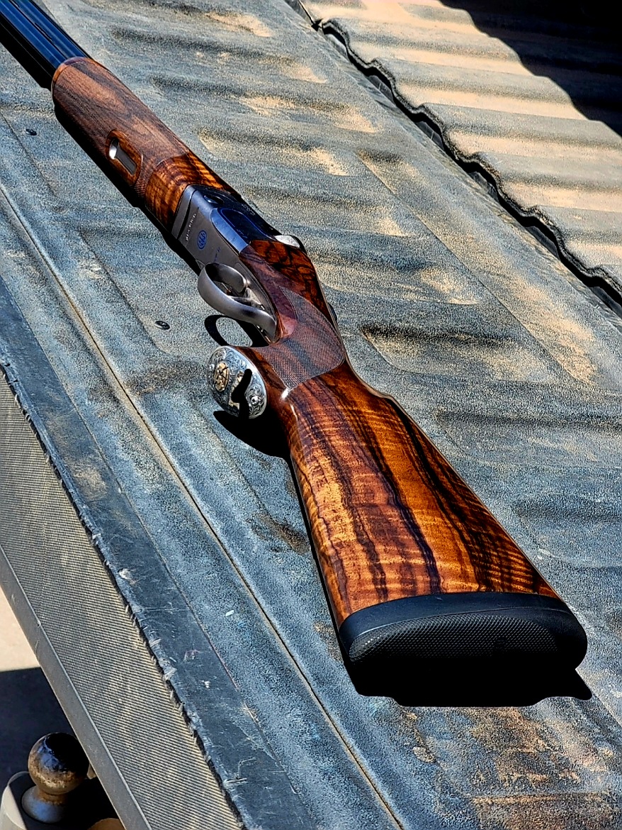

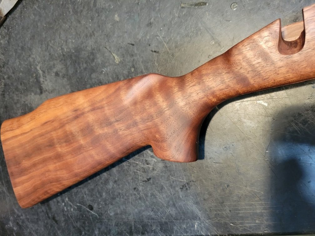

After alot of sanding and fitting, I was able to get the first coat of the Timberluxe on today... thank you very much for the suggestion!
I'm going to end up having to build another M40 now so I can make use of this stock...
DW
No poly in Timberluxe as far as I know. I rarely grain fill with slurry anymore, and use crystalac. Fills very well, and no worries of adding sanding marks while trying to slurry. Dries clear, and really helps add a 3D depth.
Stock looks amazing by the way. Can’t wait to see the finished product!

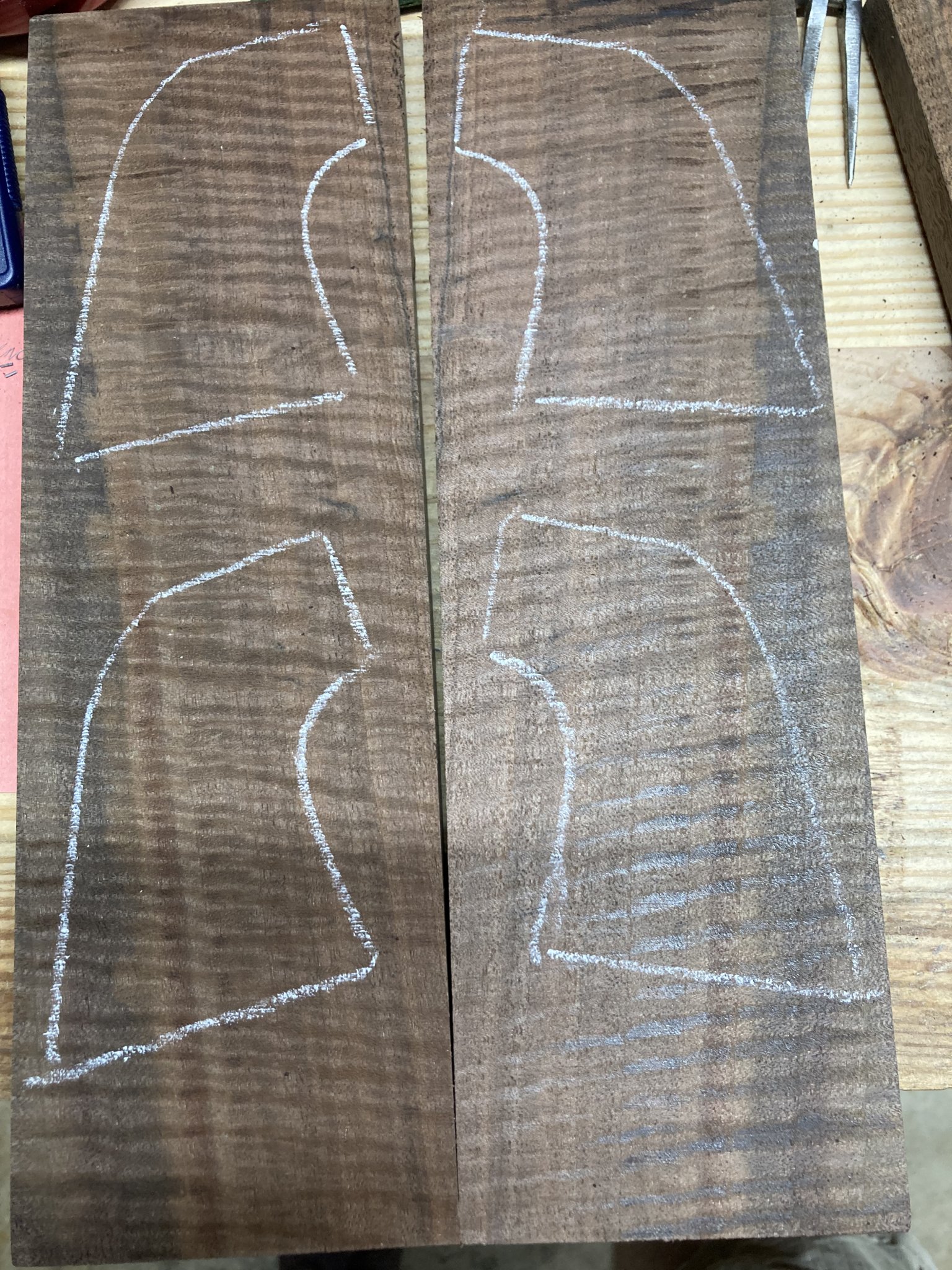

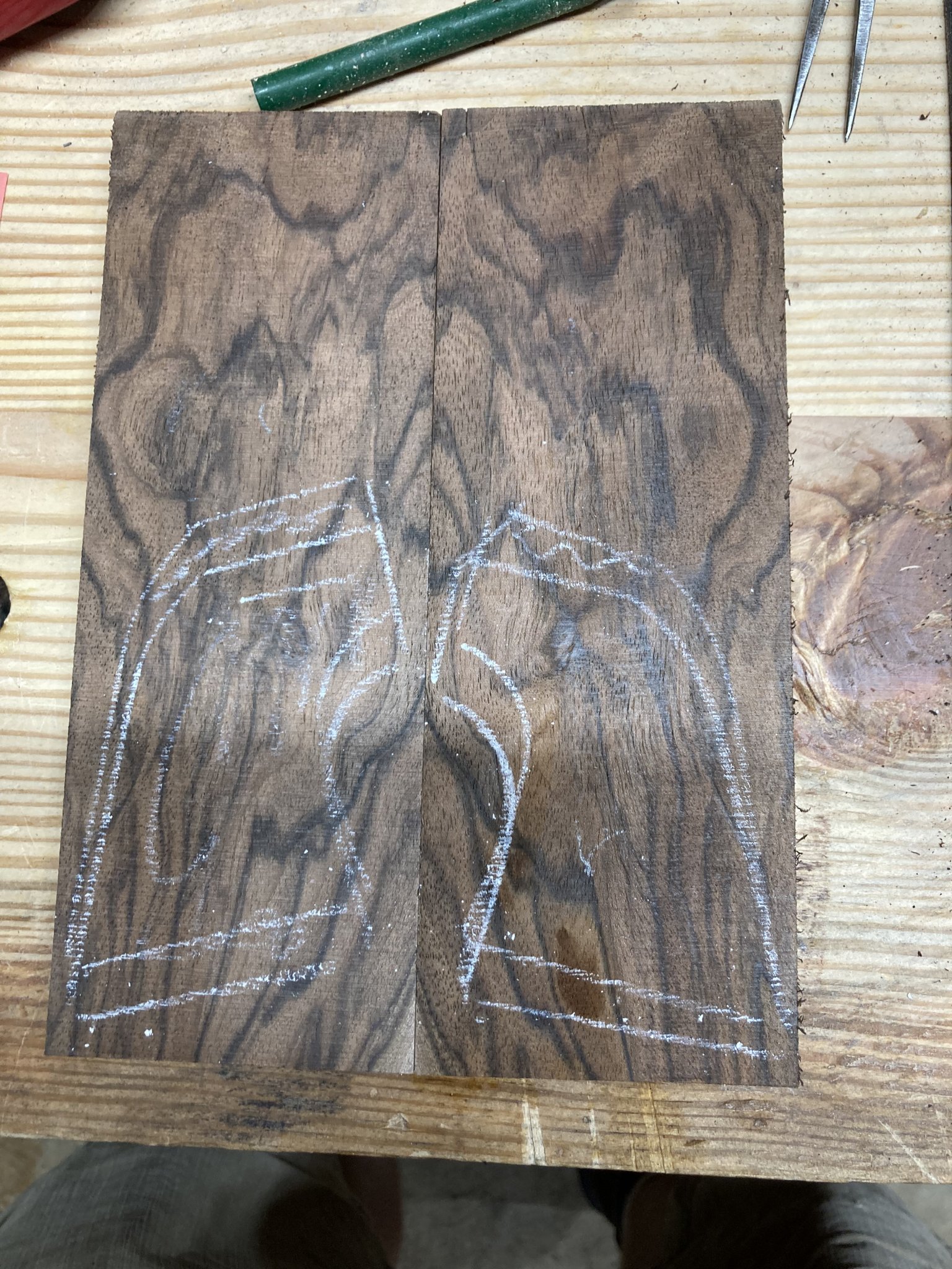

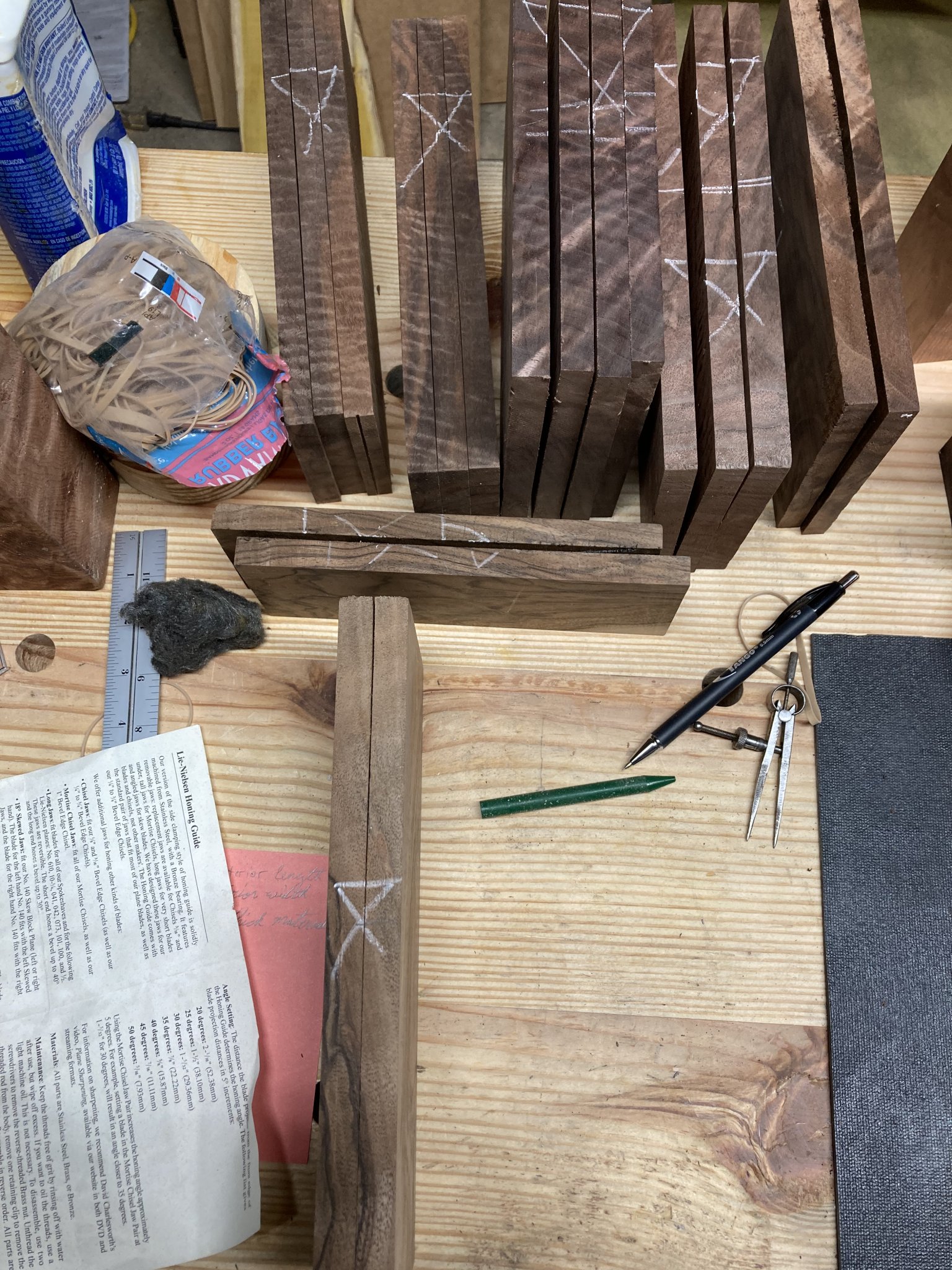

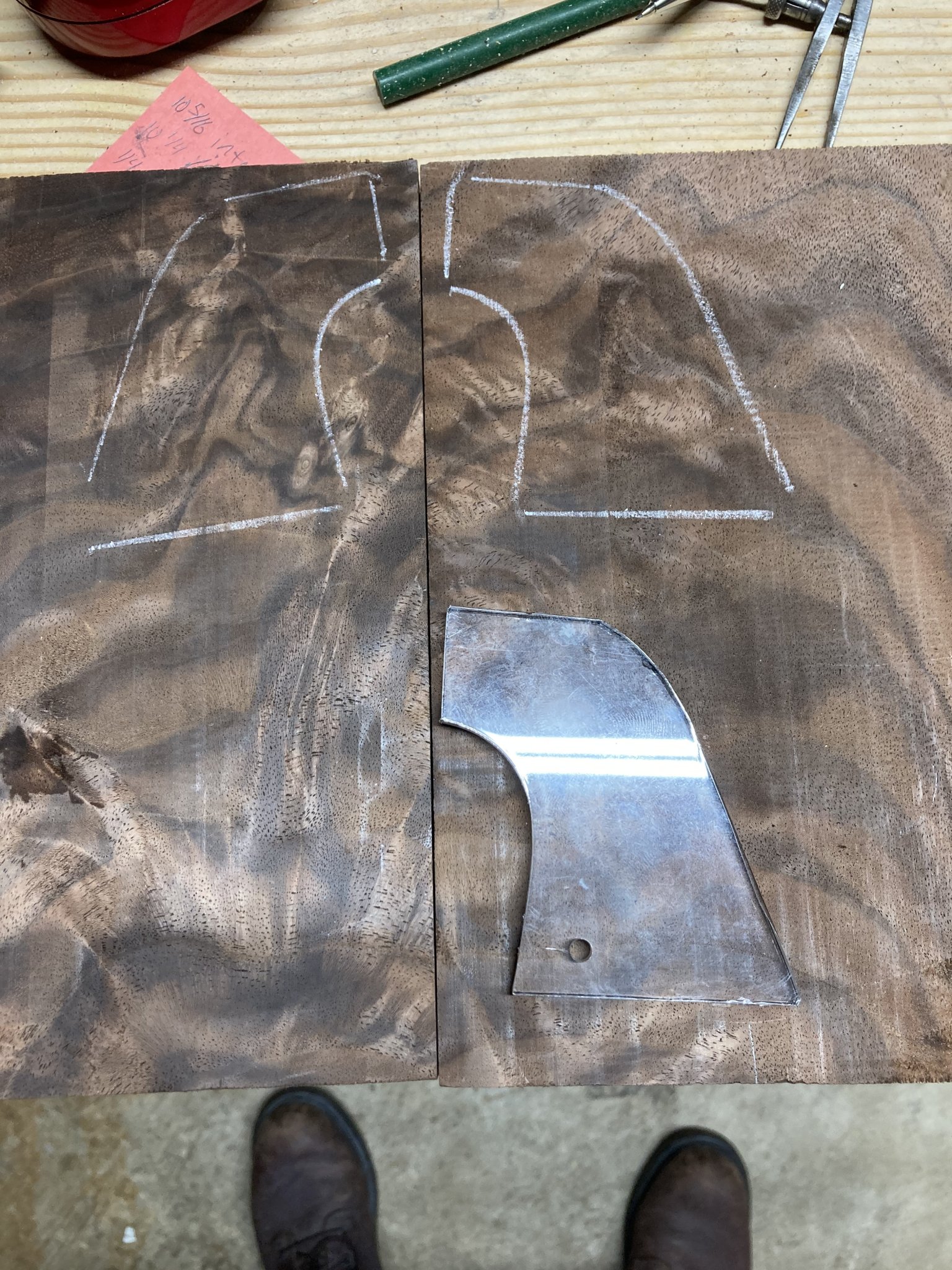

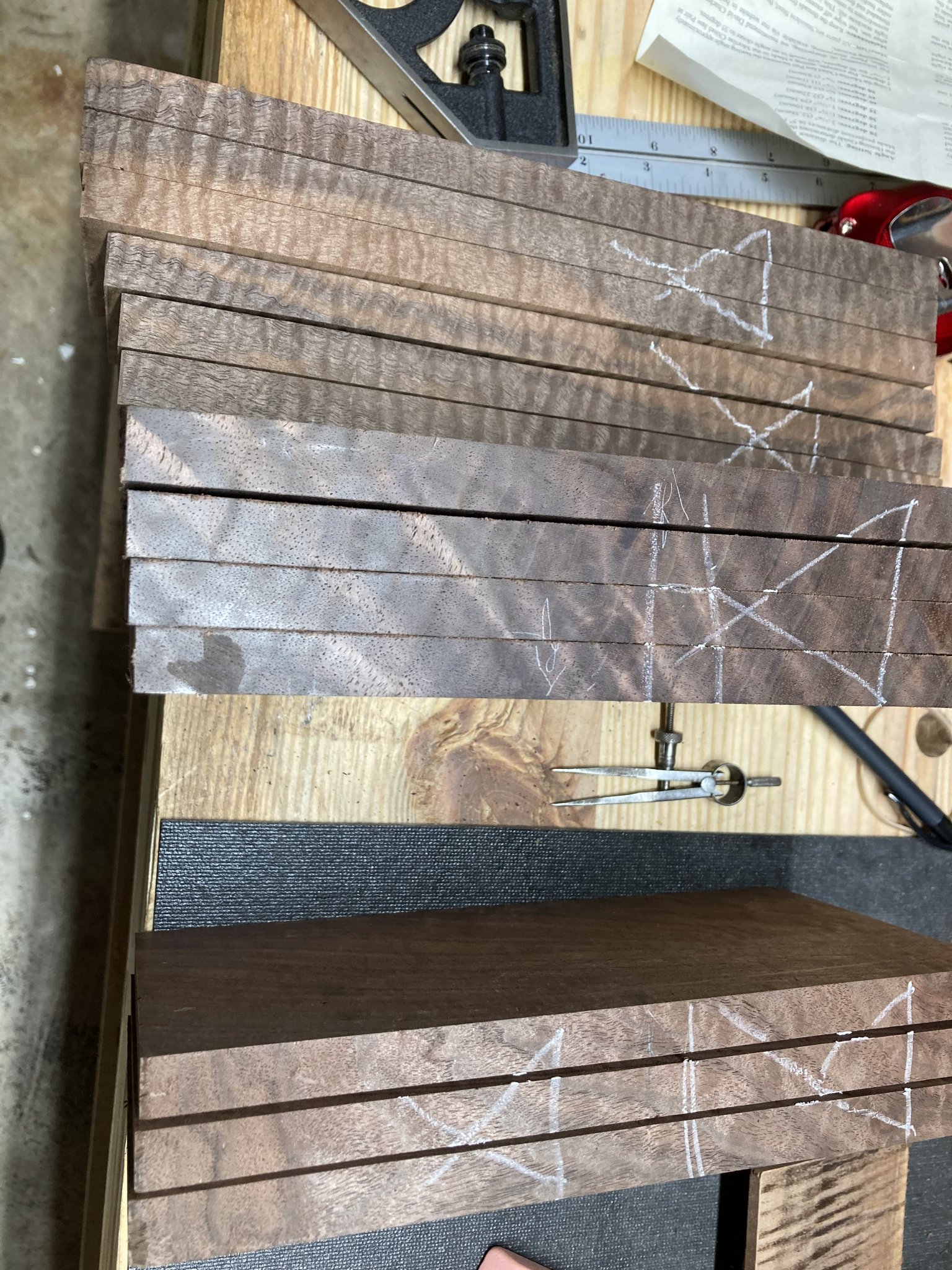

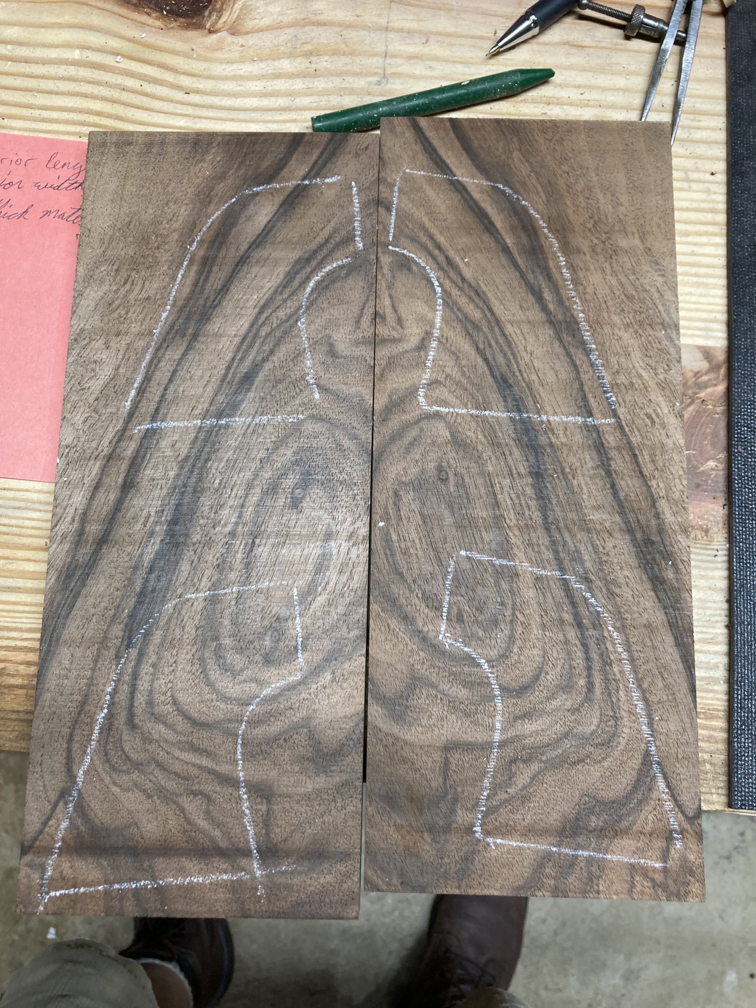

Back on the bandsaw today. Got a 1/4 of my blocks cut into blanks. Got some good book matches, and my favorite, stuff good enough to make matched sets of grips for revolver pairs.
Claro walnut. I can get a set of matched grips from here:
Claro walnut:
Some nice English walnut:
Next sets of blocks will have a lot of waste since I’ll be cutting blanks for N-Frames.

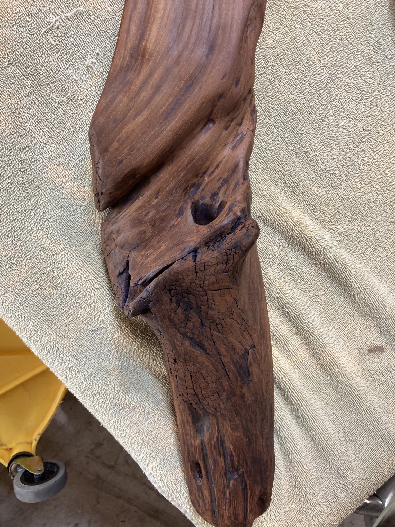

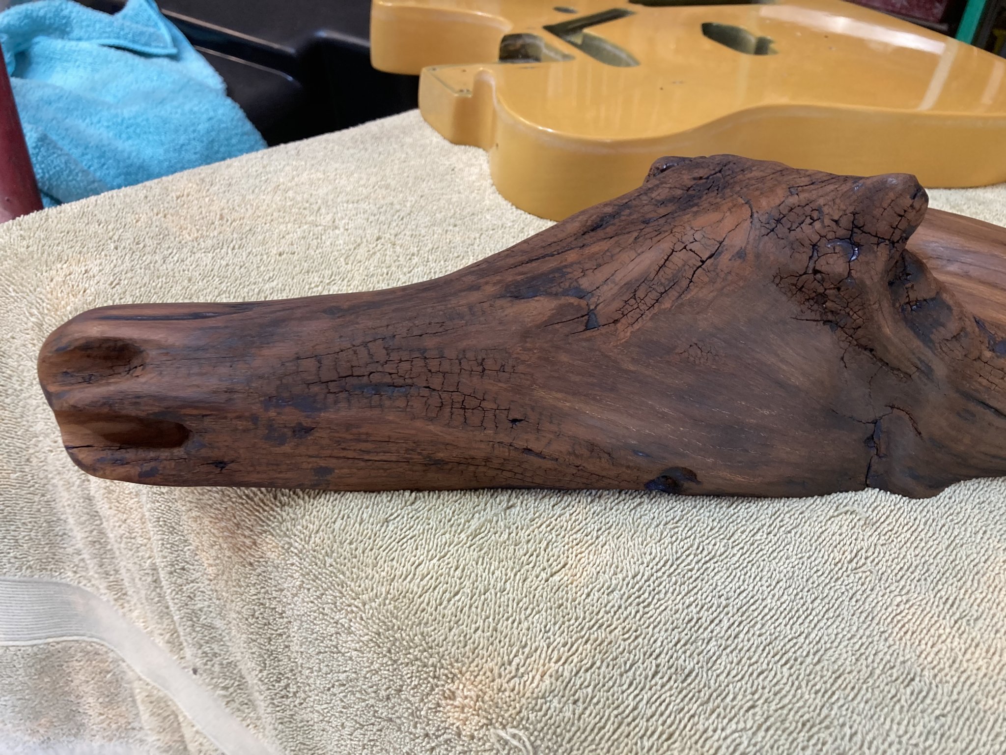

I’ve recently been hunting the woods here in Texas for interesting chunks of Mesquite. Never done anything but grill with it. Stuff actually has some beautiful grain. But man, it is hard as metal. 80 grit on an orbital just burnishes it.
Here’s a chunk I’ve been grinding on. Not sure where I’m going with this. The more I grind the better it gets .

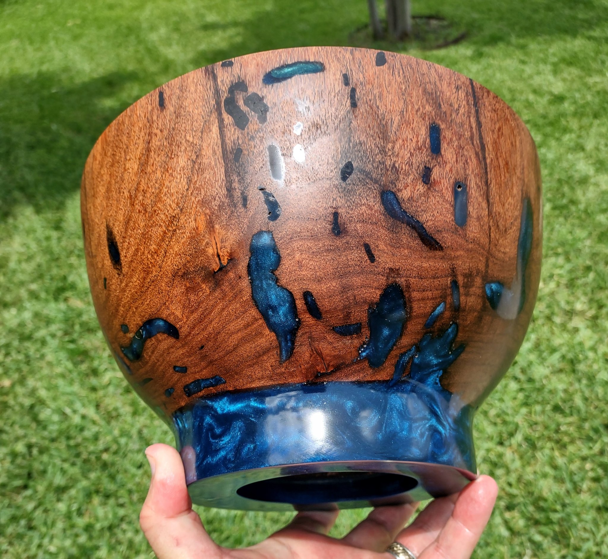

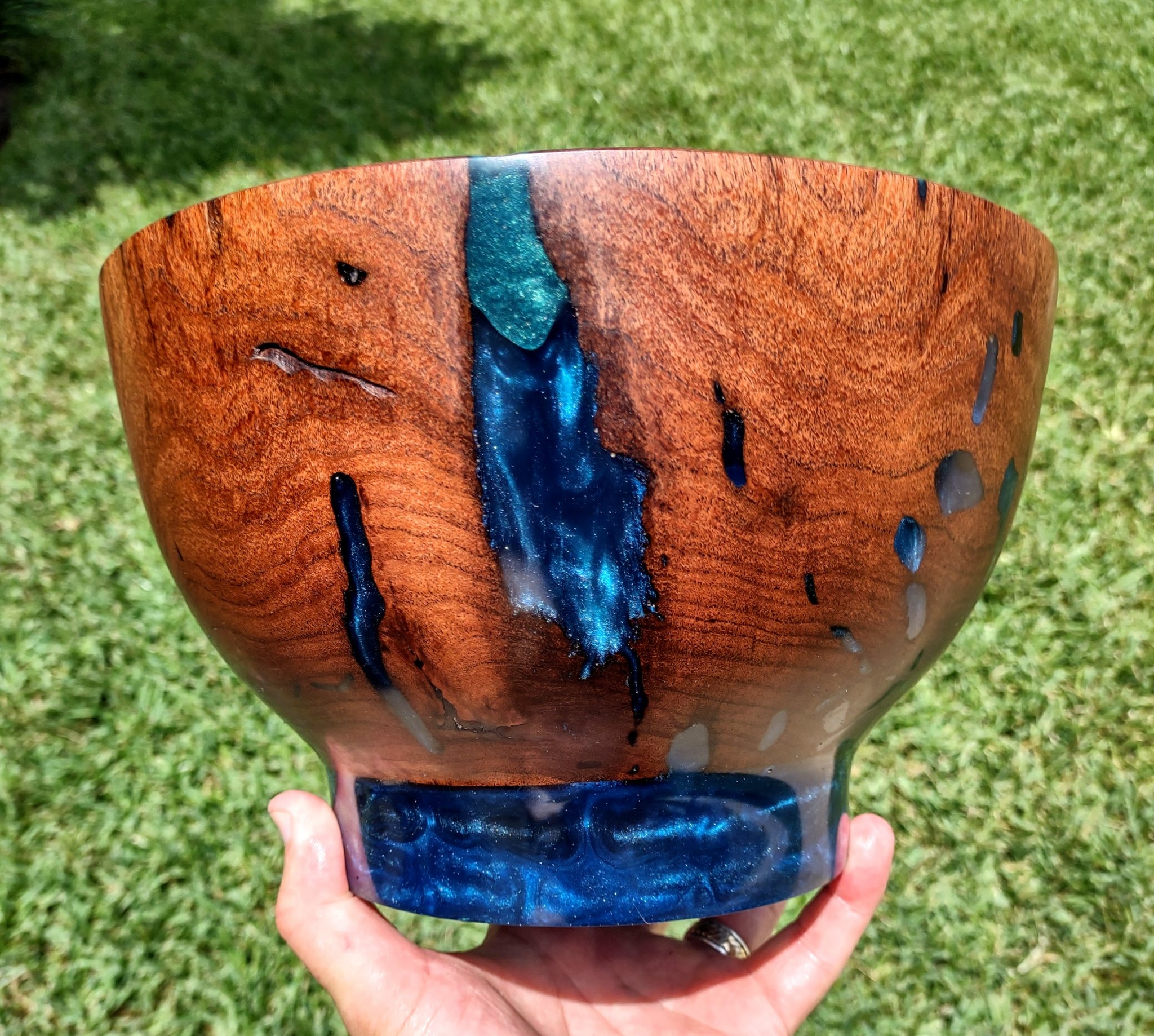

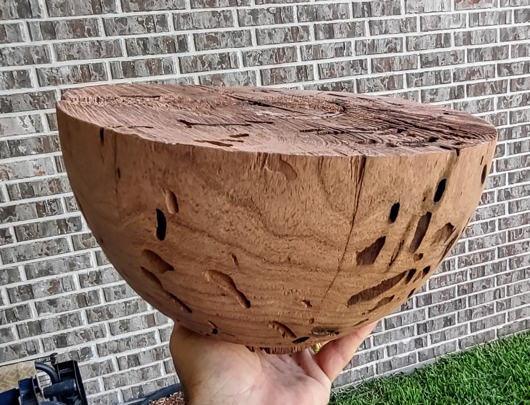

I'm trying my hand at woodturning. I've had some success with mesquite and epoxy. This bowl is not finished (all I have on it at this point is one coat of danish oil) but I'm pleased with it. The wood is some that my dad and I cut maybe 25 years ago. It is full of bore holes and the ants were flying out of it as it turned. The base was deteriorated so badly that I had to use epoxy. If I tried to chuck it up with the bare wood it would have crushed it.

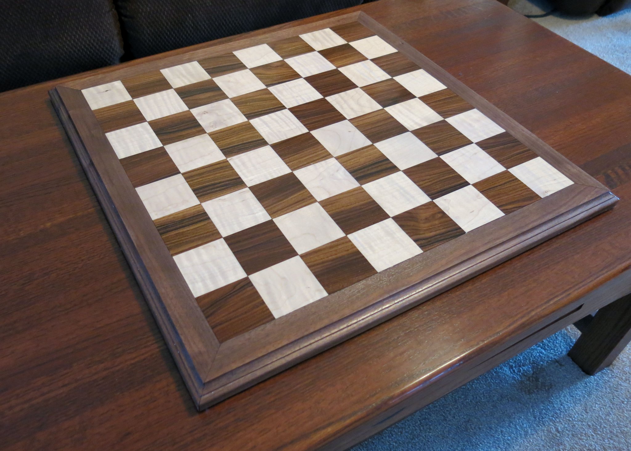

This is rosewood and curly maple with 150 year old walnut border I made for my wife. I used a jig to size the squares individually and they are glued down with marine epoxy. The surface was then sanded down to remove the epoxy and finished with instrument lacquer to a low gloss.

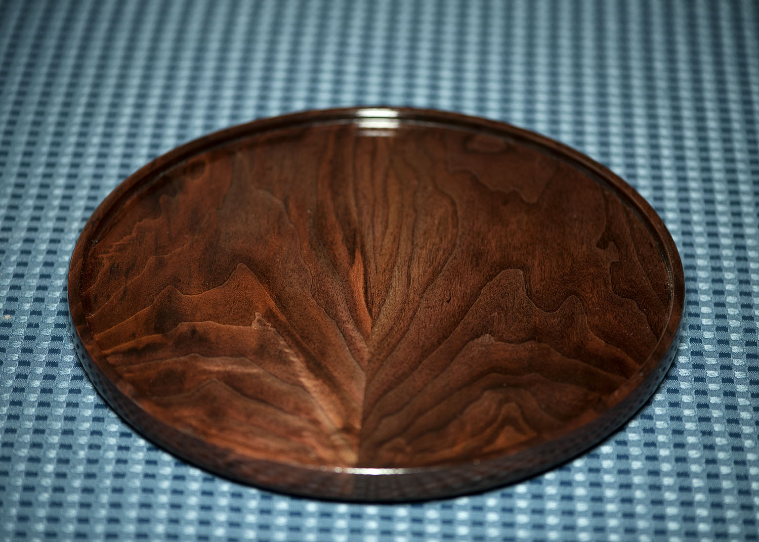

This is another piece of the 150 year old walnut with a book-matched glue up. It has a machined lazy Susan base and is finished in natural Danish oil. The chatoyance on this piece is amazing.

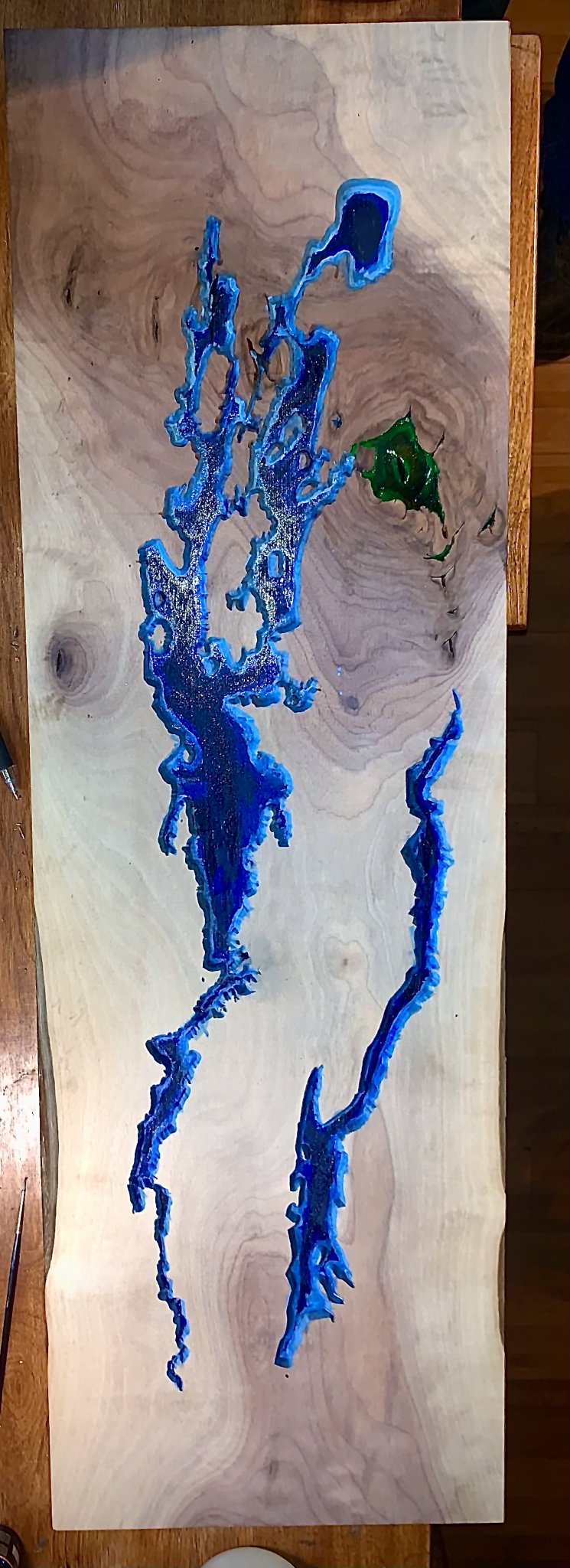

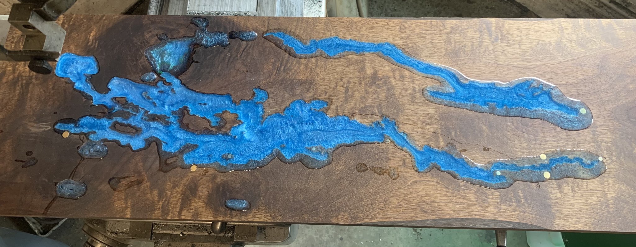

Been wanting to make a Lake Table so have done Lake Champlain and Lake George. Will be putting in brass and German Silver pins for the forts and battles.
Painted the lake floor with enamel and will pour the resin over it…. With light tint. Should make a cool depth map!
Next… stain then pour epoxy resin.
