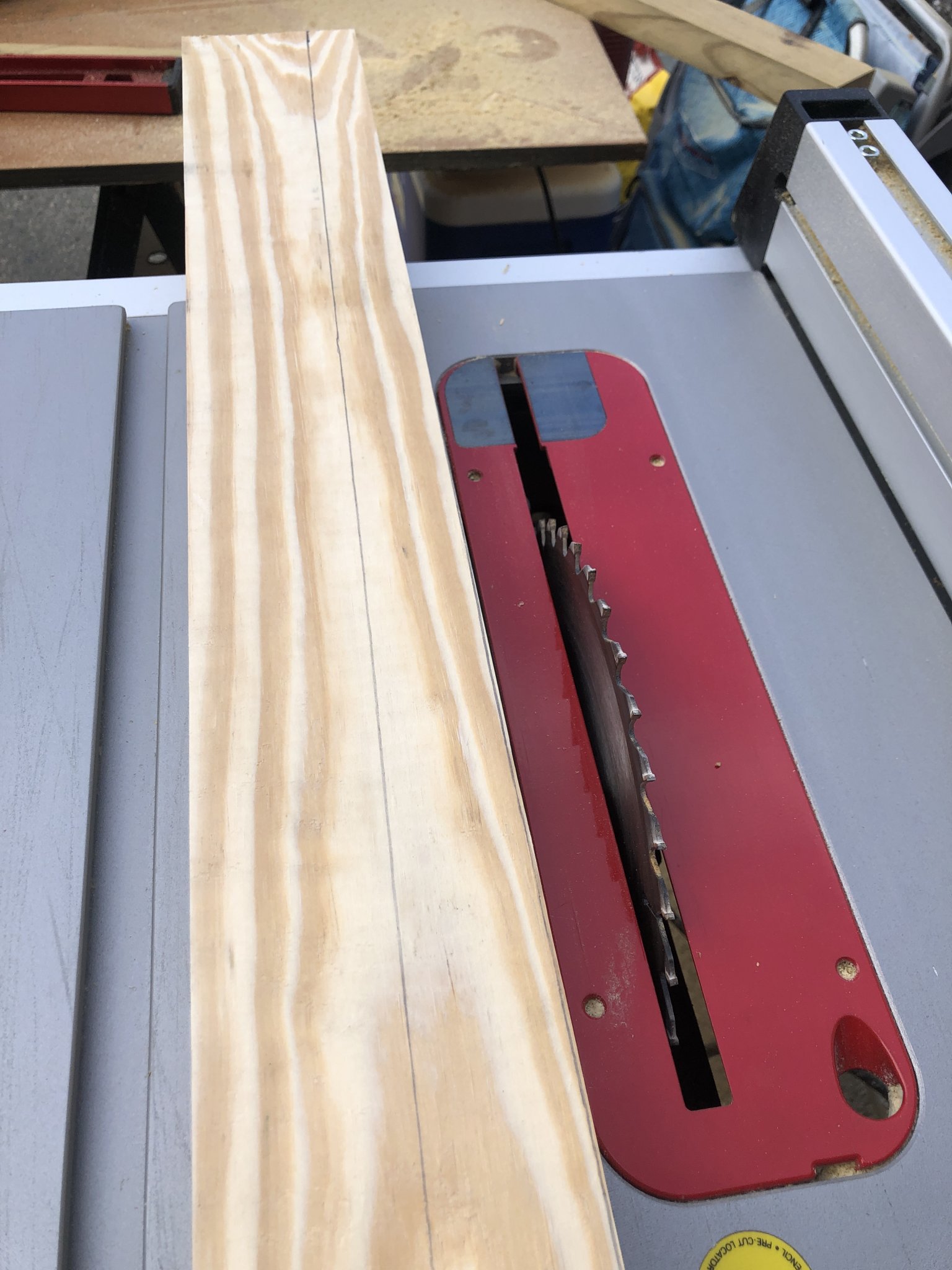

How do I accurately cut this angled cut woodworker Gods?

Attache the piece that you DON'T want, to a separate piece of scrap the same length. When you DO attach that piece, offset IT so that your desired cut-line is parallel with the fence. Run the scrap up against the fence, and you'll get the cut you want with the angle on the desired piece.
Now if you're specifically wanting to keep BOTH pieces, then you'll have to shim-the-blade by adjusting the feet of the motor.
(That second part was a joke.... and hoping that the 'Taper Jig' suggested above, is more fitting)
You can make a taper jig using a hinge. I'm not home to take a pic but i made mine from plans found on the internet.
EDIT: You can cut just off the line with a circular saw and then sand or plane to the line.

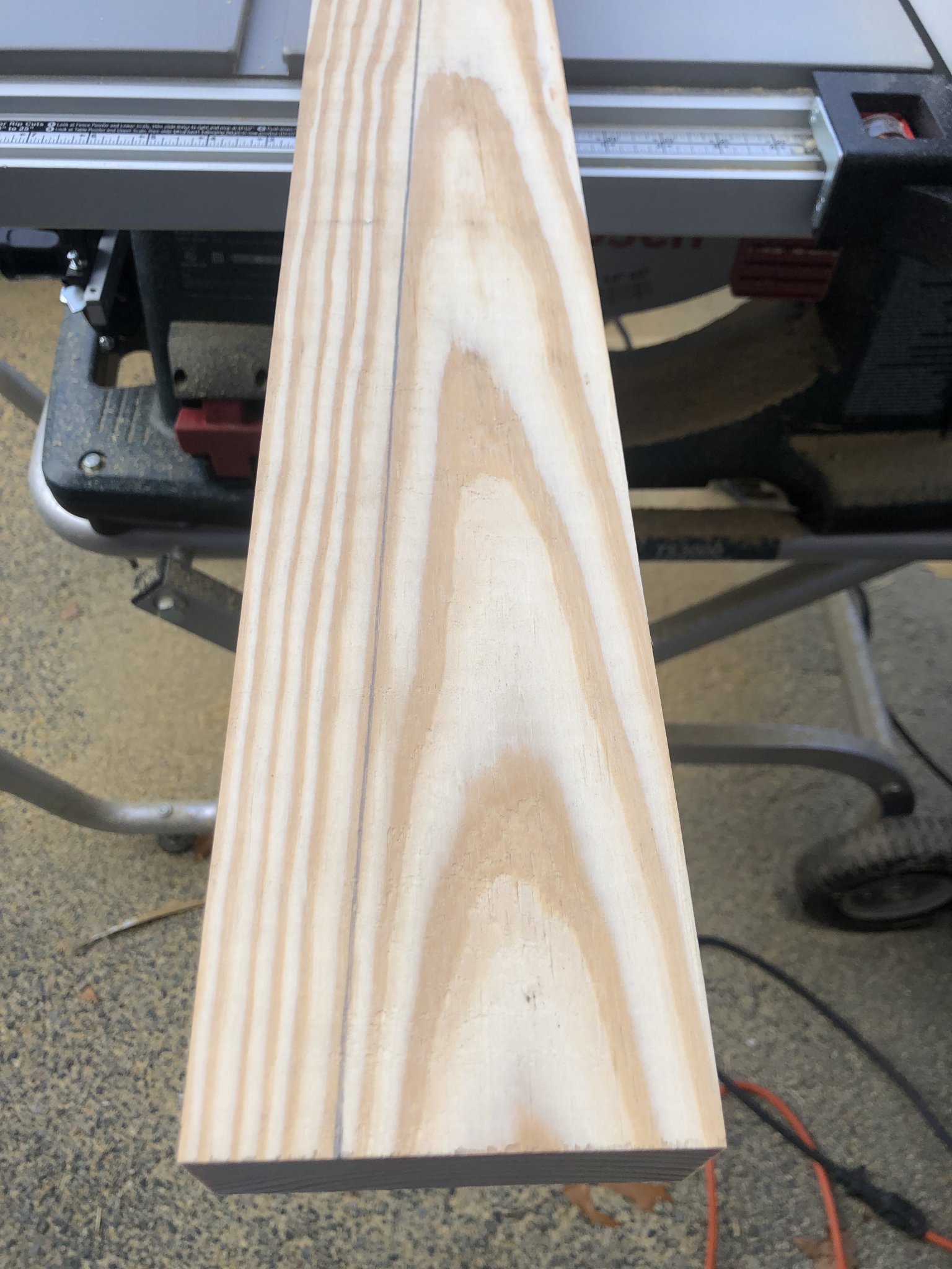

How do I accurately cut this angled cut woodworker Gods?View attachment 7996762
First thing you need to do is look into replacing that blade or at the very least clean it.
You can free hand a cut like that, just remove the fence and cut down the line. But you have to be willing to take the additional risk associated with that, I don't see a blade guard so most of your safety devices have already been removed.
The best way may be to take a piece of plywood a little longer than your work piece and run it through the saw to get a straight cut edge. Align your pencil line with that cut edge on both ends, attach your board to the plywood and run it through. It will or should cut right down that line for you.

Saw @Bigfatcock answer and went down to local ace hardware looking for an angle jig. No Bueno.
Went to the famed Arlington Coal and Lumber where the guys from this old house buy their lumber- attitude from those dudes every time a non contractor goes in there. They didnt even know what a taper jig is. Guess they mount their stuff to plywood all the time.
There is a Rockler in Cambridge but I was trying to beat the rain and didn’t want to come home smelling like pot and communism.
I want the right tool I will need to buy a taper jig.
Now do these mount and just provide a temporary stationary angled fence you set to be parallel with your cut line?
The cut I have to make is 52 inches. I want both sides. Looks like most people using the taper jig to also push the material through. I can’t do that with the length of cut.

The cut I have to make is 52 inches. Looks like most people using the taper jig to also push the material through. I can’t do that with the length of cut.
For a cut that long you want the piece of plywood method. 6” ripper same length as your piece. Screw piece to plywood with the required offset. Run edge of plywood against fence easy-peasey.

Seriously the answer here to go to Home Depot, buy a sheet of 1/2 plywood and a roll of carpet tape. rip 6” off the long side of the plywood and leave the fence on that setting. Put carpet tape along your 6” strip. Now set your work piece on it with your angle cut lined up on the straight edge of the plywood. Rip it through the table saw with same fence setting. I’ve used this method a lot. Work very well. Also use same method to rip a straight edge on a board before I had a jointer.

Raise the blade a little higher than what you normally would set it and free hand, like suggested above.
Front to rear on the blade is a tad longer and will help you from drifting.
Easier than what you are considering, if you cut below your line a little and it doesn't look good on the floor, cover it w a shoe moulding, now it'll look fancy on porpoise.

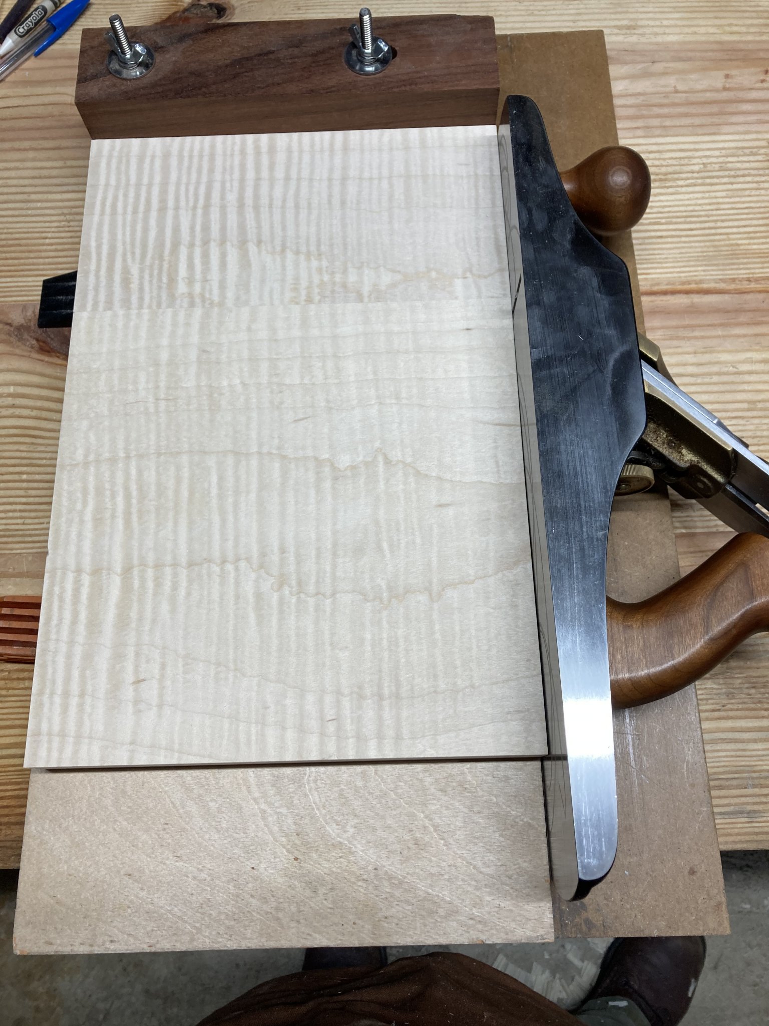

Another work holding thing that I've seen is masking tape on both pieces with cyanoacrelate glue in between the tape.
A quick short
The spray is activator for the CA glue.
First learned about it from nyccnc. More details.

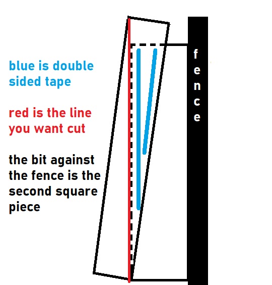

why not use another piece thats square and carpet tape it (thats what its called here, ultra thin double sided tape) along the line you want to cut then just adjust your fence, straight edge to straight edge with the job stuck at the angle you want to cut. for a once off its quick and easy without making a jig.

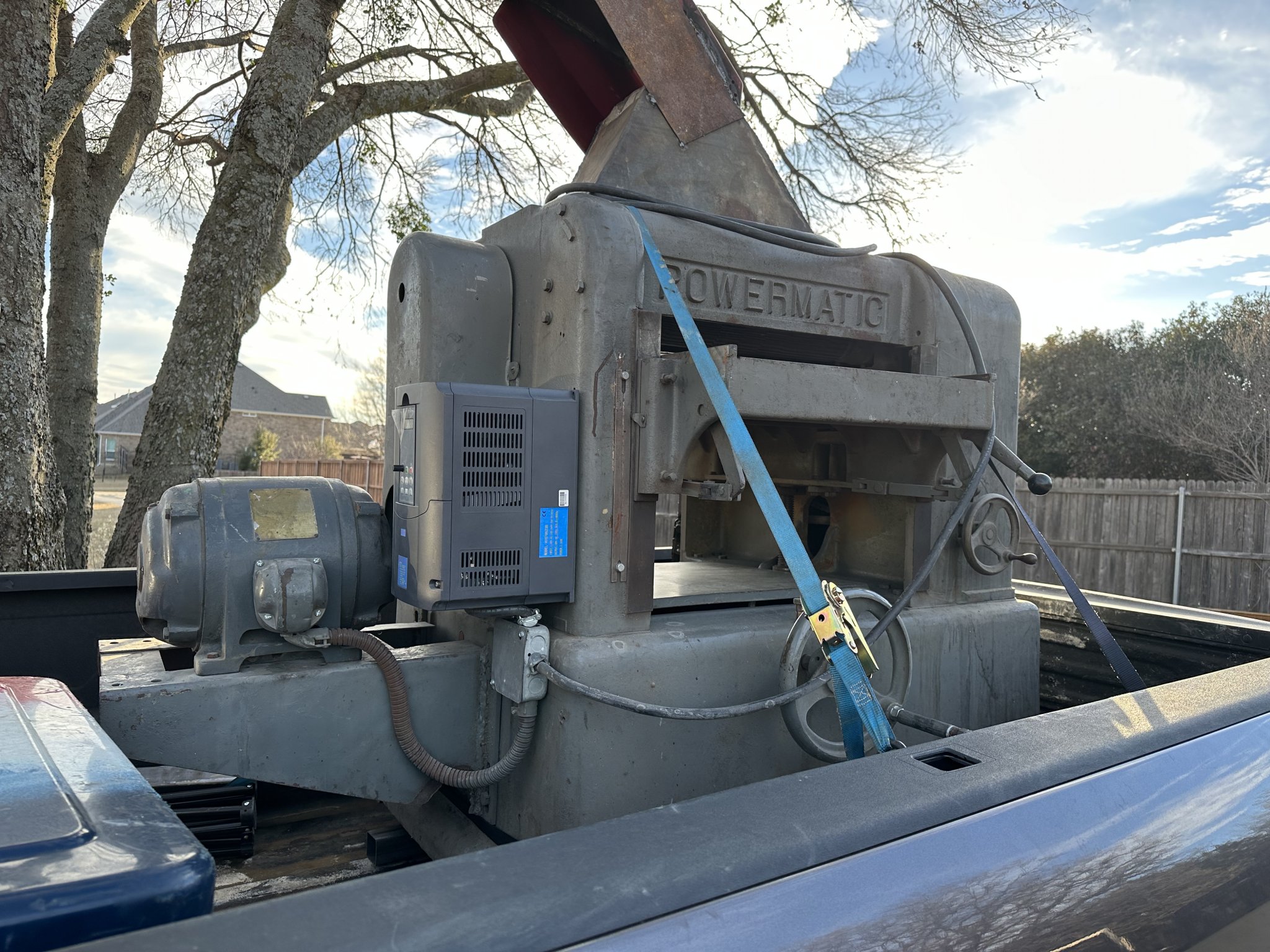

Newest addition. About to built a mobile base for it, then rent a forklift to get this beast out of the truckView attachment 8038239
Awesome planer and what is the width? Assuming you will hook it up to a dust collector since it will throw off a serous amount of chips. Powermatic makes some excellent woodworking equipment. Have an old Model 86 Bandsaw in my shop that I rebuilt as well as a 3520B Lathe. The bandsaw is a beast and had my riggers move it into my shop since it weighs nearly 1,600lbs. Has a transmission in it and will run from 100fpm to 4,000 fpm as well as a blade welder.
Reactions: camocorvette
It’s a 20” width, yes I’m going to rip that hunk o shit off the top and have a new collector/hood made up to hook to my dust collector

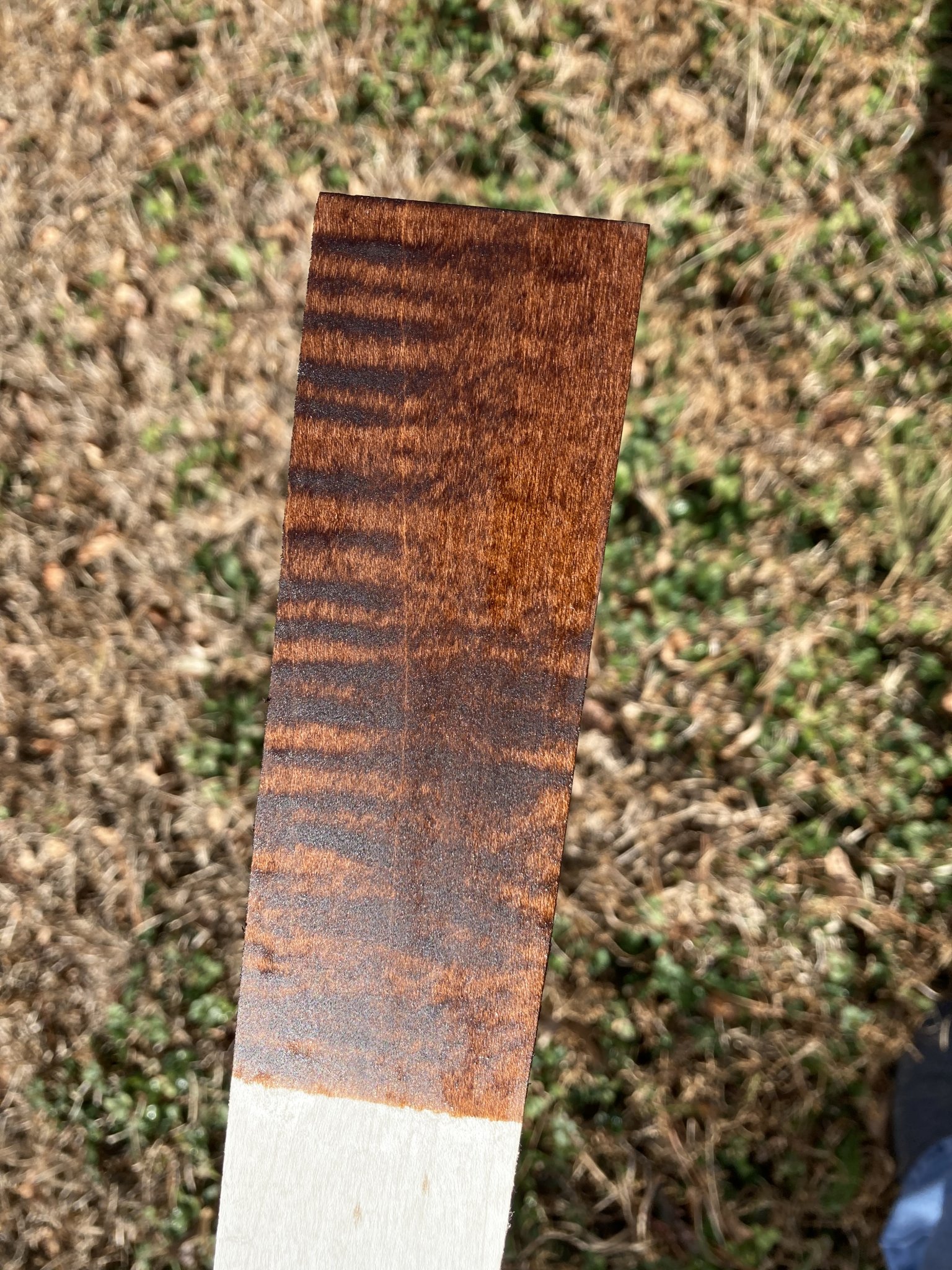

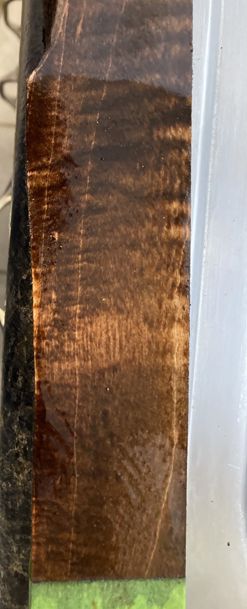

Working on color mixing too. The goal is to get the coloration of Aqua Fortis Reagent (AFR) on maple, without having to use the AFR.
Why would I want this? To avoid the heating/blushing process, and it causes grain raise in the curl regardless of how many times you raise the grain and cut back prior to application. Also, it turns wood glue green.
For homogeneous pieces of wood like gun stocks, AFR really does not cause any issues aside from the grain raising.
However, for panels, the heating/blushing process can cause warp. For laminates and glue joints, the heating process can cause delaminating or failure of the joint due to heat. If the AFR comes into contact with wet glue, it turns it green. Also, trying to heat/blush a large chest or panel is a pain in the ass.
Here is a piece of maple stained with AFR:
Here is the same board with my water based stain concoction:
So close! @sirhrmechanic
I think yours looks better.
Thank you. I have to do some more testing on ratios in case a lighter or darker red is called for. It’s a two part application due to being water based.
I could probably create one where it would work with one coat using oil based stain due to the heavier pigments in an oil based stain.
Reactions: Average guy
Aqua Faux-tis achieved!!
2 coats of a dark water based stain/dye followed by 4 coats of the reddish/brown water based stain/dye.
Really easy process and being water based dries really fast in between coats. I can modify from here if needed with more brown or red.
You could make this with an alcohol base and not have any grain rise, but the evaporation rate of alcohol is not what I want. The dark base has to be able to soak in.

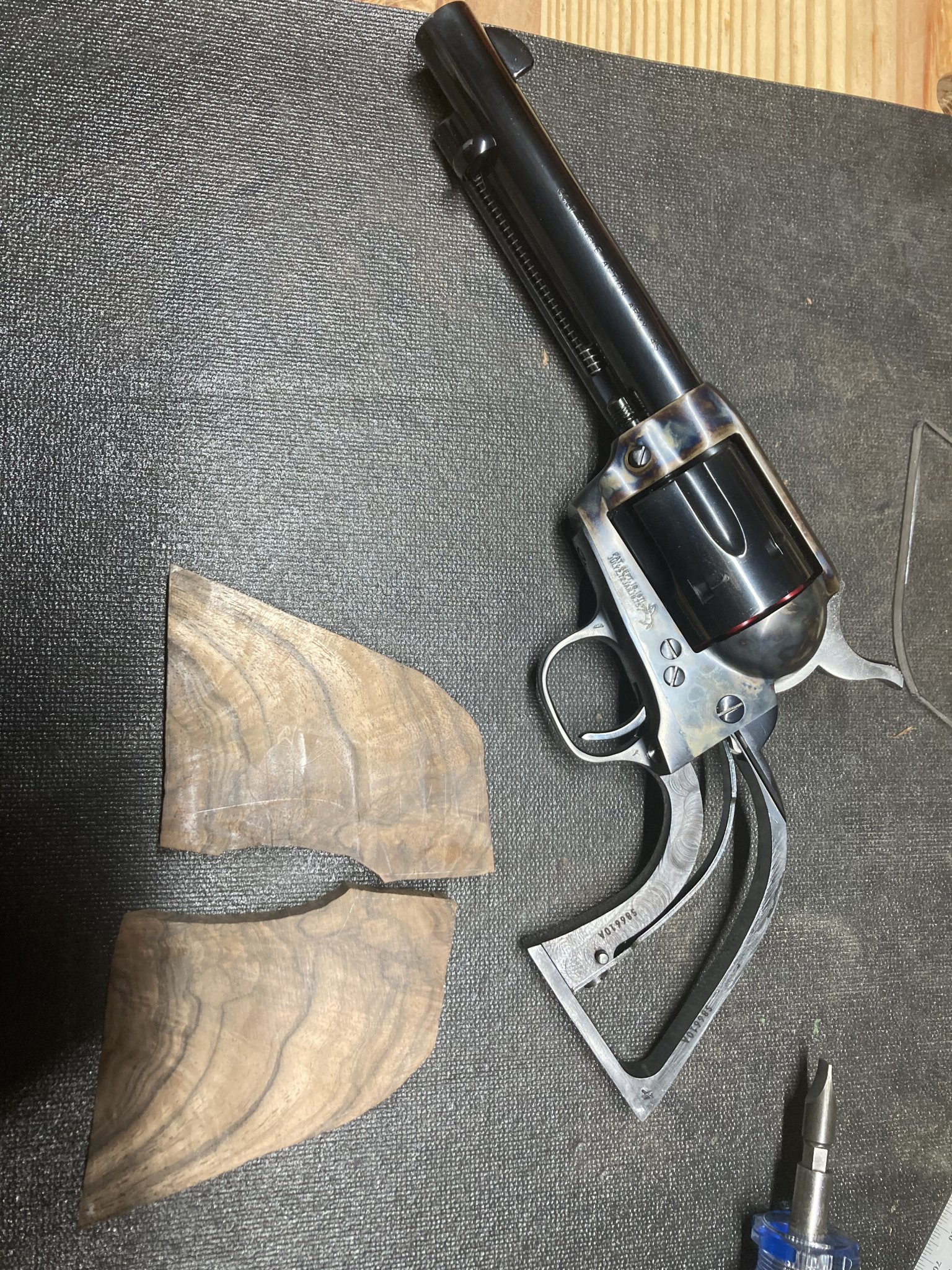

Hey sir, do you or anyone you know make slightly, fatter oversized grips for a SAA? I have pretty large hands and my .357 Uberti feel too small to me. Would also prefer some sort of checkering for a better grip.
Do you have one or two piece grips on it right now?
Are the grips too small in the back, the front, or all around?
