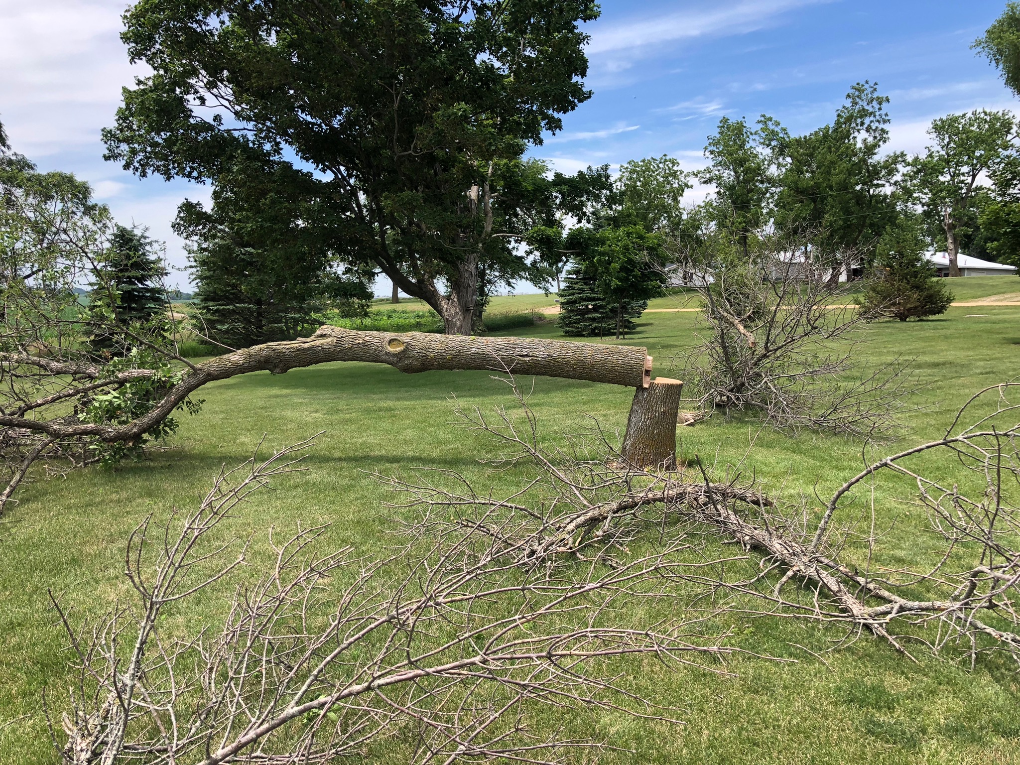

Our last Ash succumbed to EAB (after plugging twice) this spring. So much for the late afternoon shade it provided to the house and deck 😔.

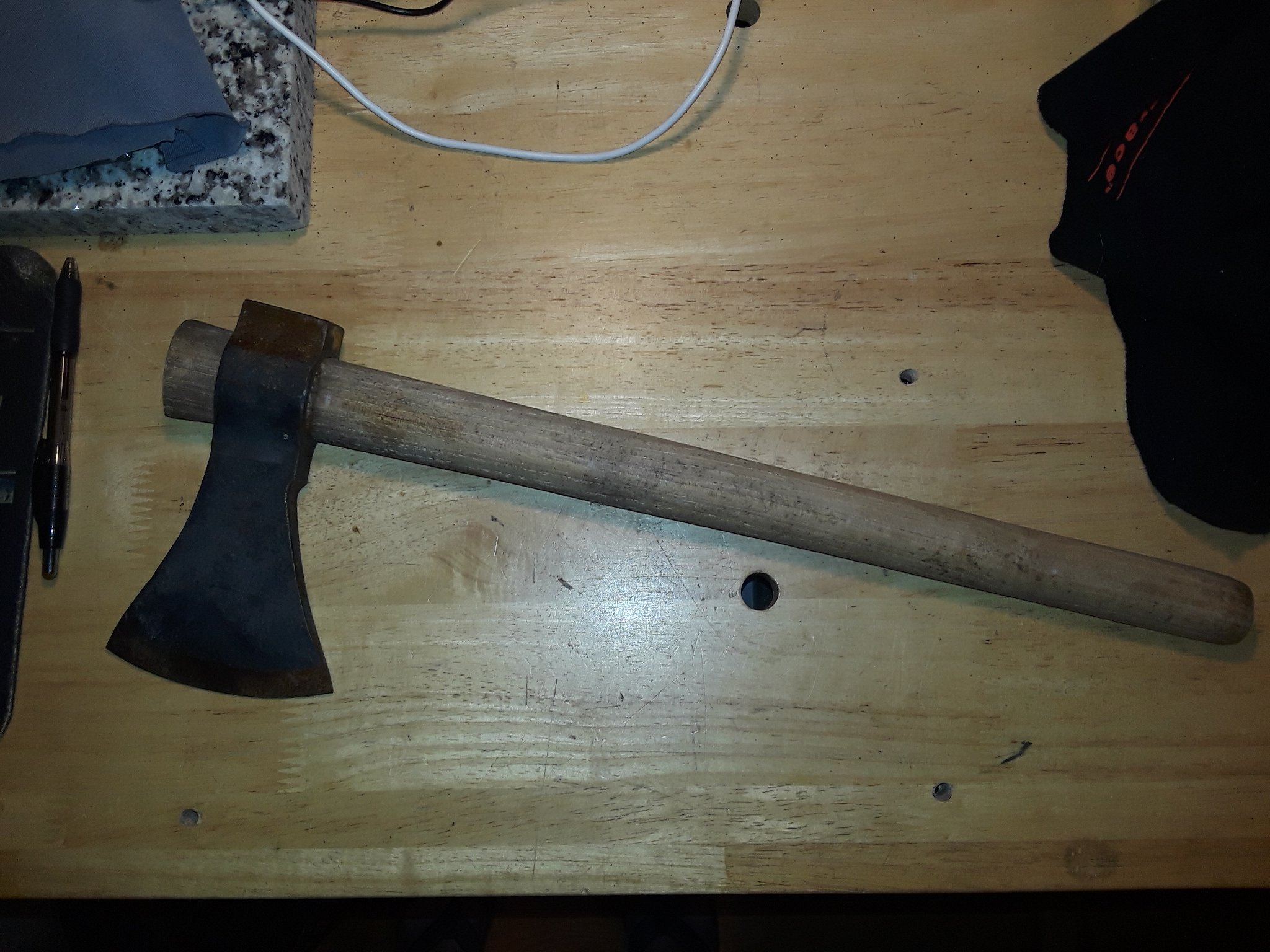

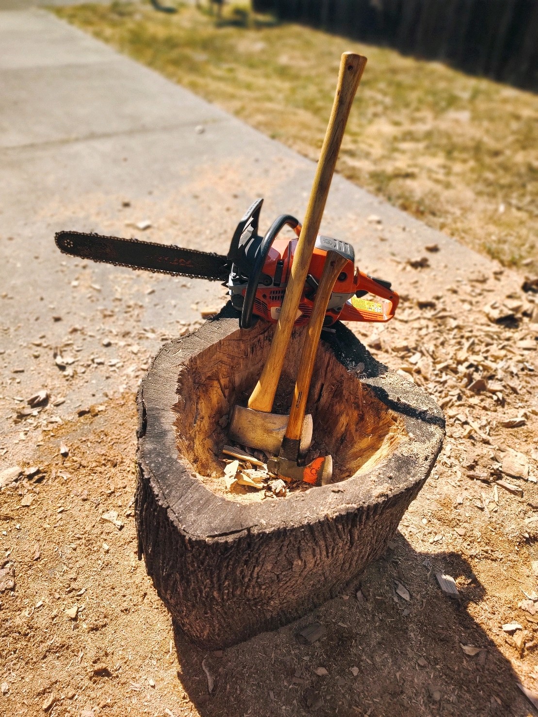

Came up with this, needs cleaned up / sharpened.
Has a quality look to it and will be the grandsons prize possesion.
Any guesses as to brand ?
Not a single mark found.

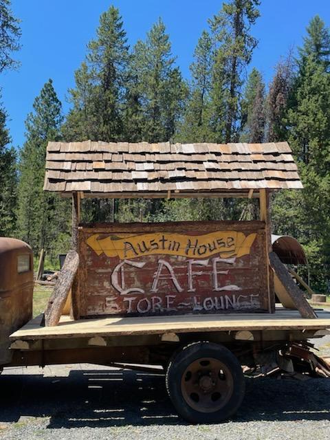

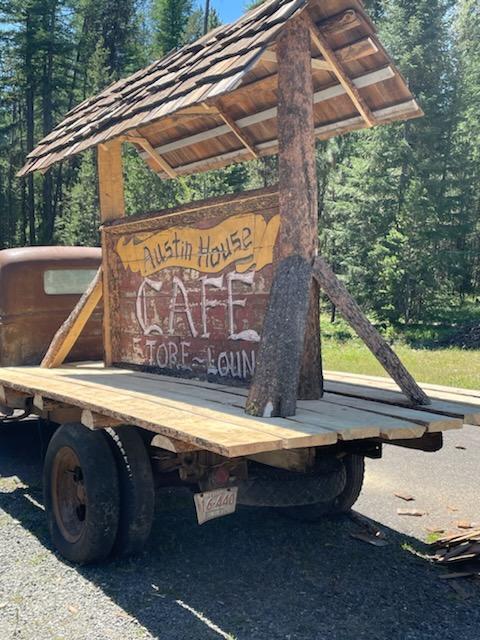

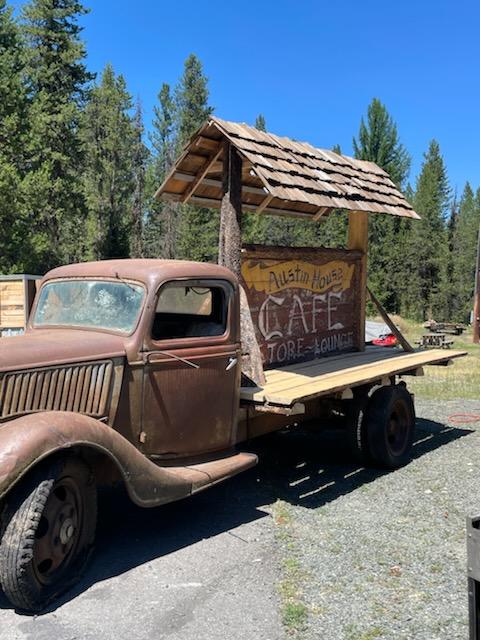

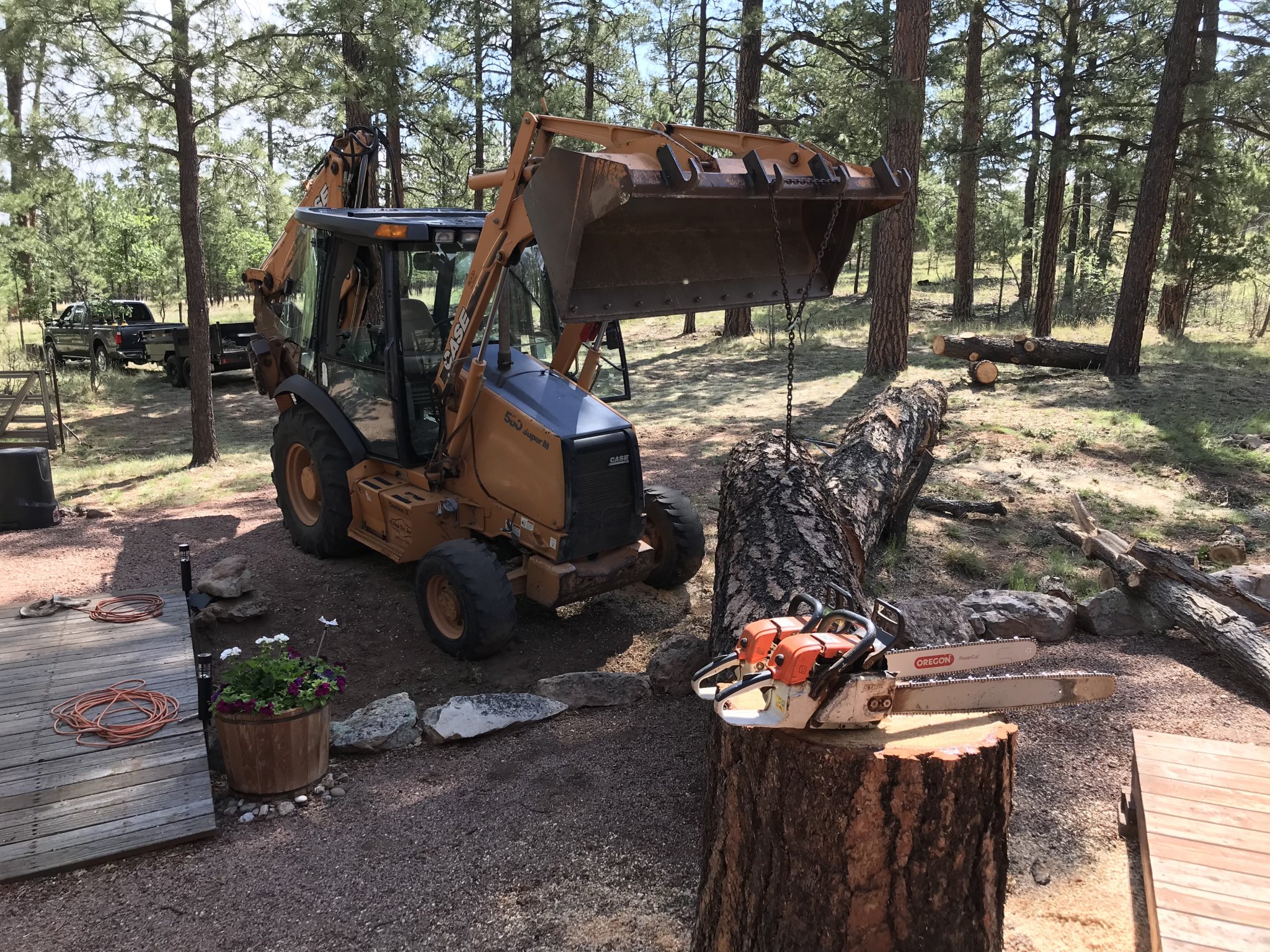

Buddy bought old restaurant/bar/campground and needed some signage. He still had his grandfather's truck and had some trees to drop. So out came the chainsaw, Alaskan mill, skilsaw and a screw gun. Flatbeded the truck then framed in the sign. I think it turned out pretty cool.

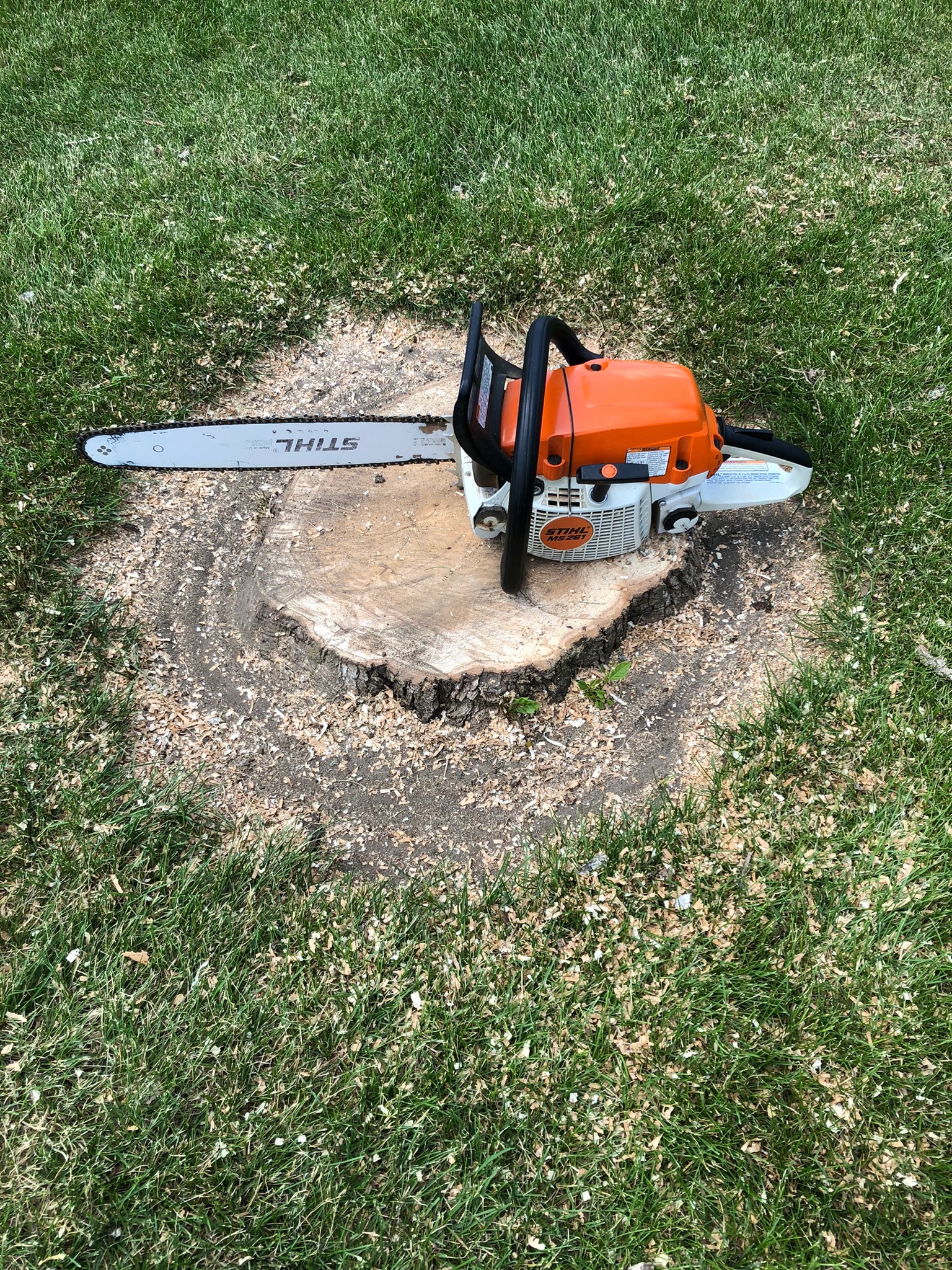

Looks like a 362 ?
Man I want a 261 so bad but I'm already knee deep in chainsaws. Almost as many saws as rifles.
The 261 is a great saw. Mine is now 4 years old and has cut a fair amount of firewood. Handy for smaller work. I’ll let @oneshot86 provide the correct answer.

261, this is my second 261. We process firewood commercially, and the saws run alot. This saw will work like a bastard.

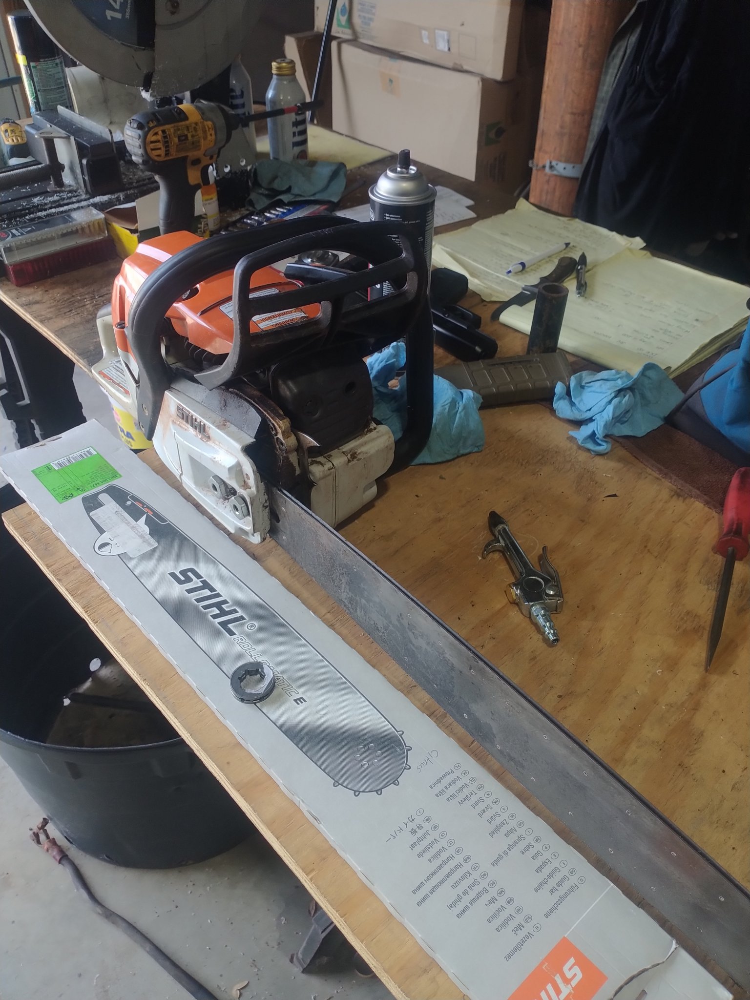

The lite bar and chain should be dropped off Monday, I'm interested in the difference in the weight between the 36 and chain to the 28 lite and chain.
Stihl lite ? My 28" tsumura weighs the same as a regular 20" stihl es. The stihl es lite is supposed to be a few ounces less. The tsumura runs one more driver than the stihl though.

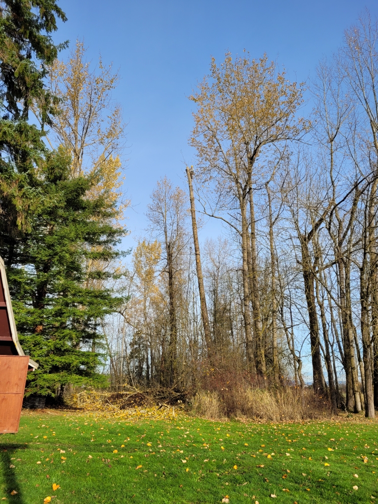

Next project I have lined up is a removal of a 120’ fir from a coworkers property in exchange for a Fort Knox safe. Based on quotes he received I think we are both going to be happy with the barter.

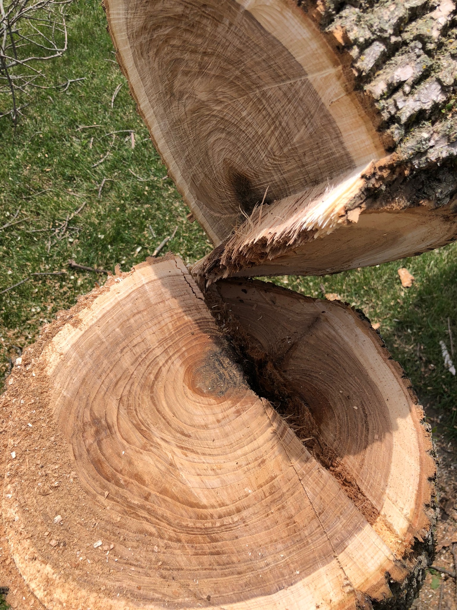

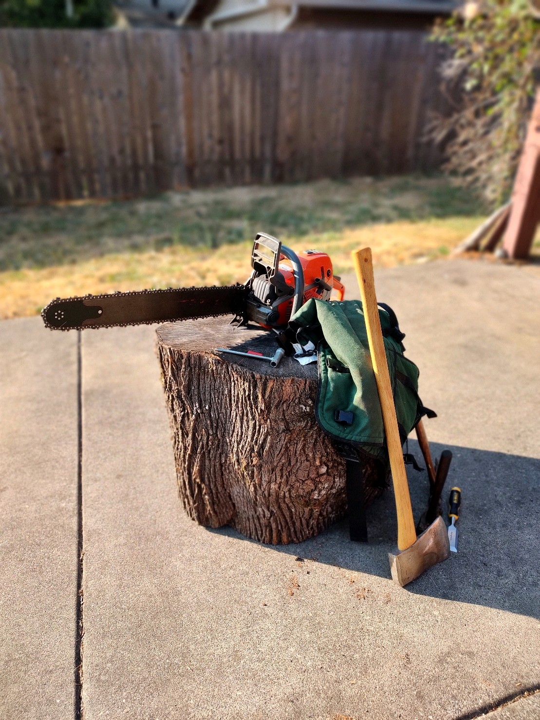

I have a stupid new guy chainsaw question - when I'm cutting, I seem to be making curved cuts. If the cut was vertically downwards, it looks like a c from the side. Then the saw struggles because (I assume) side loading on the bar.
It's an old-ish husky 141, with a newish chain. No idea on bar age, I assume pretty old.
Can someone help me understand what I'm doing wrong or how to get back to blasting through firewood please?

Most likely improperly sharpened chain. Check for consistent angles and tooth length on both sides of your chain. Pick up a new chain and give it a go while you are having the used one professionally sharpened. It never hurts to have extra chains, especially when cutting remotely and/or in very dirty conditions.
If a new chain doesn’t correct the situation then look to your bar for excess wear or pinched or folded channel. Flip your bar over and see if the cuts improve. Flipping your bar periodically is good practice anyway to avoid uneven wear and tear.

Crescent moon 🌙 cuts I call those. The bar is worn where one side of the rail is higher than the other. Several ways to true one up or at least make it better. File, belt sander, etc... is what I’ve heard. Or, just put a new bar on and flip it periodically and it will typically stay pretty even.

I'll list a few things that I have found on saws that "run out" one way or the other.
In no special order:
Groove in bar is worn. Try flipping the bar over
Chain is not properly sharpened. Take the chain to a local chainsaw shop and have it professionally sharpened
How are you holding the saw ? Think of looking through the saope of your rifle with the weapon "canted" to one side or the other. If you start crooked it will run crooked. Pay attention to how you start the cut.
Lubrication on chain. Check the hole in the bar and make sure both sides are getting equal oil.
