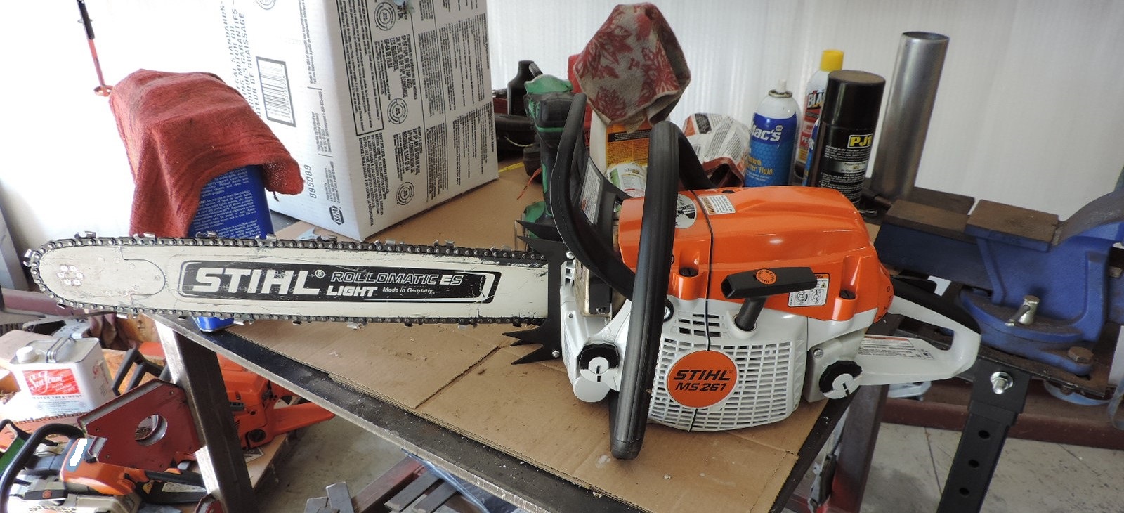

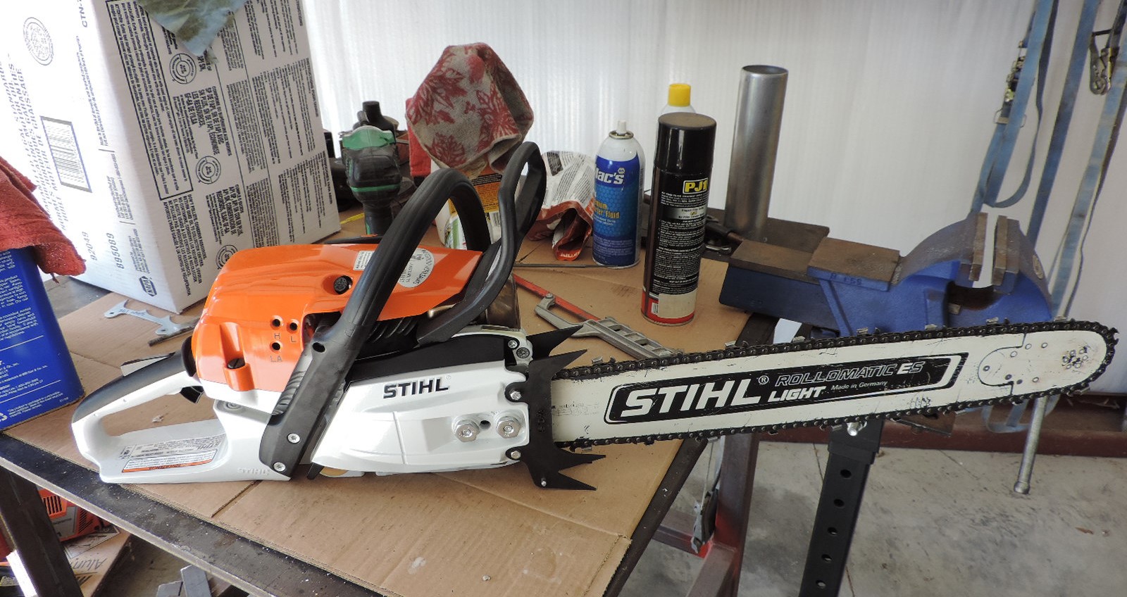

New addition, my first ported 261 and a gen 2. I really like my muff modded gen 1 so this one should rip. Just got the WCS spikes on also.
How do you like the new 261? I have been looking at getting one with a 16" bar to replace my old 024. Was originally looking at the 250 but I think I would like to get a commercial grade, as it is overall better built and more power compared to the 250.
The 261 (4.0bhp @ 10.8lbs) has power between the 291 (3.76bhp @ 12.3lbs) and 311 (4.2bhp @ 13.67lbs) at the weight of the 251 (3.0bhp @ 10.8lbs). Numbers are as stock posted by Stihl.
I bought my 261 based on recommendations from others here.
They are a very smooth saw vs the 024/026 series. Air filtration is much better. Power is impressive for a 50cc saw, I keep a 20" es light on mine for limbing. I haven't ran the husky 550xp yet but for now I believe it and the 261 are top tier.
The older 346xp saws ruled the roost for a long time, if you could find one of those in good shape, jump on it.

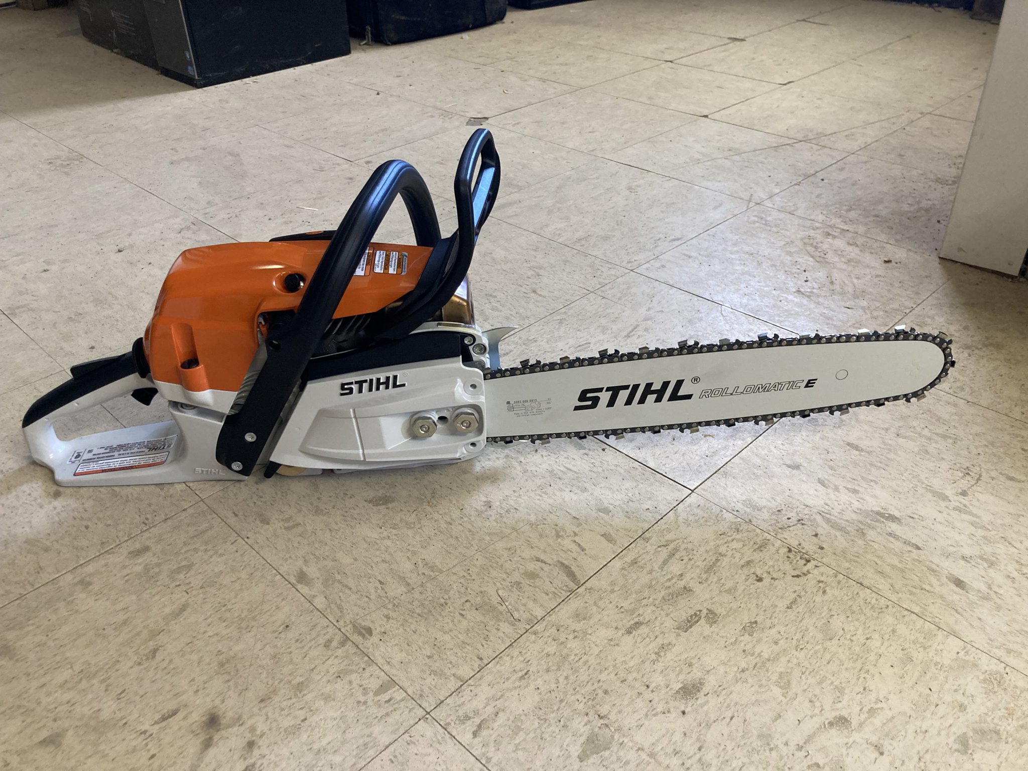

You guys were the final decision for me. My new saw. This is my first brand new saw, and first time with a commercial model. This will replace my old 024 AV my dad bought new back in 1992. Went with the 16" bar, as my other saw has a 25" for the bigger stuff. But I will probably use this one 70% of the time.
Congrats!

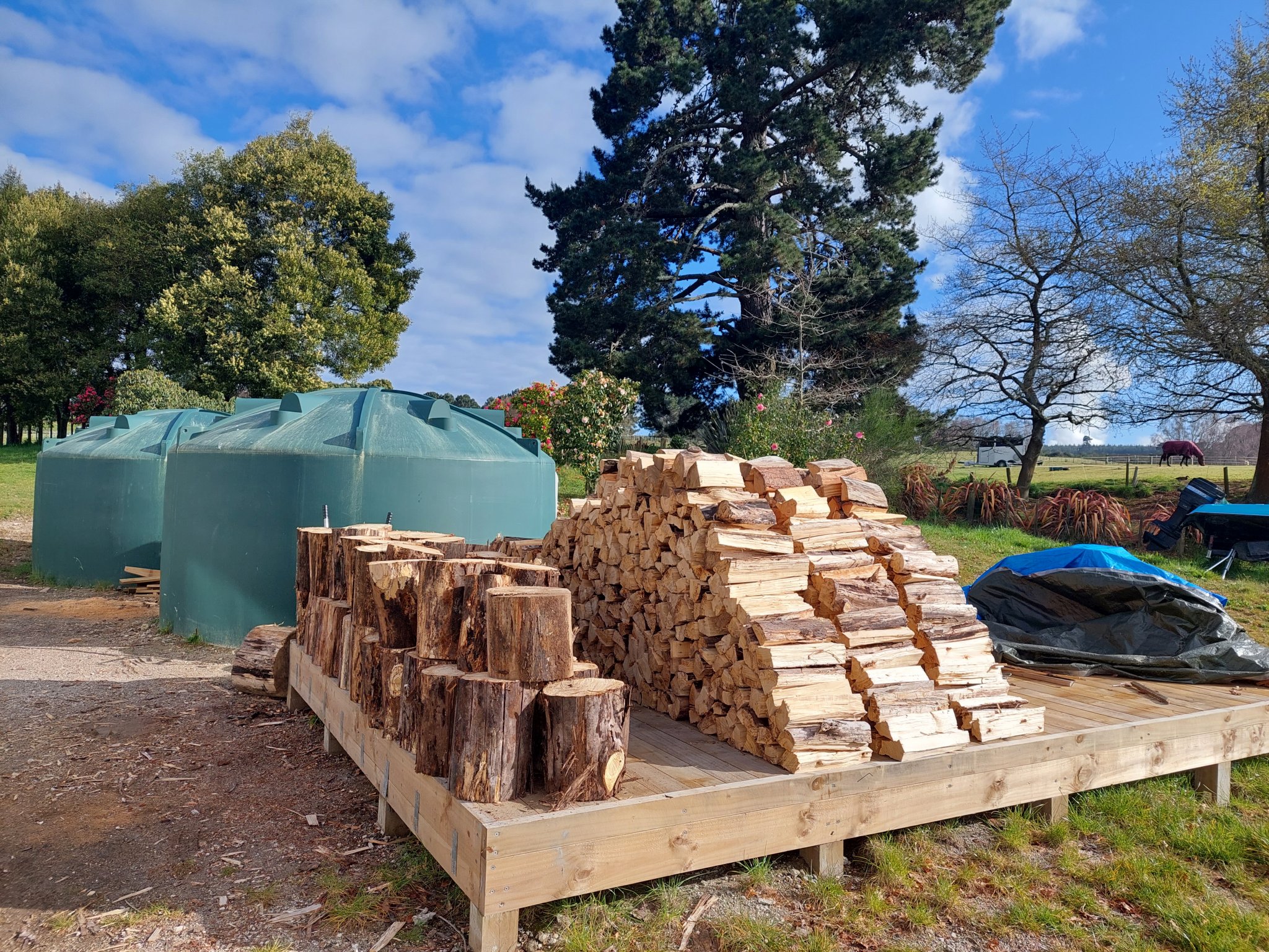

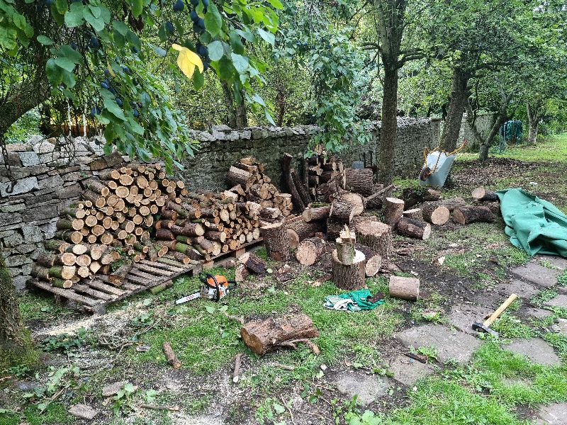

Getting there. All hand split, I enjoy it still. I'll have the rounds done and stacked on Saturday.
We burn about 10 cubes (about 2 3/4 chords) a year, this is all gum. I'll cut some pine and maybe a little Manuka later.
Edit. The pine in the background is the neighbours... I'm waiting for it to fall over and block his driveway. There are years of firewood in that bastard.

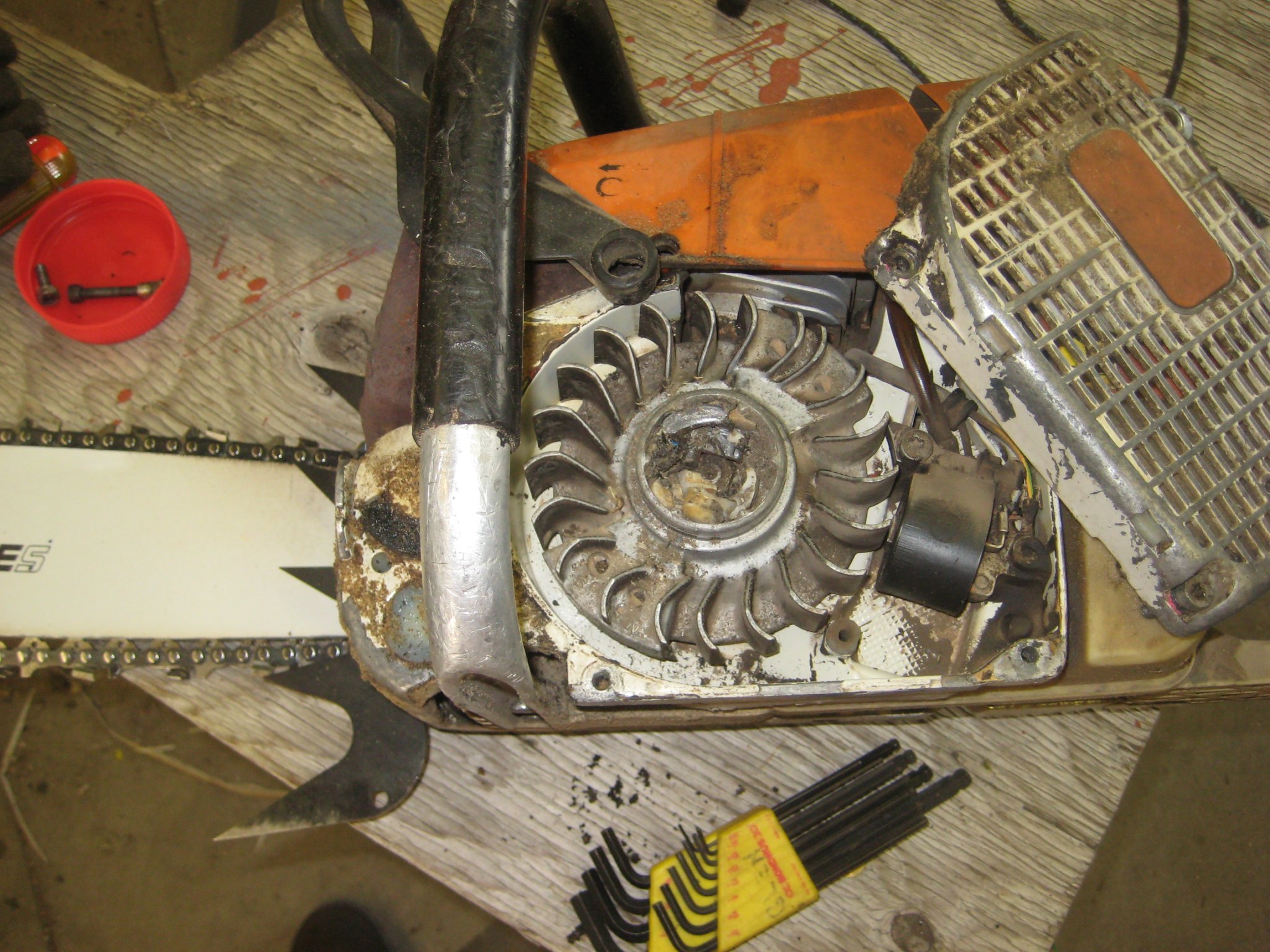

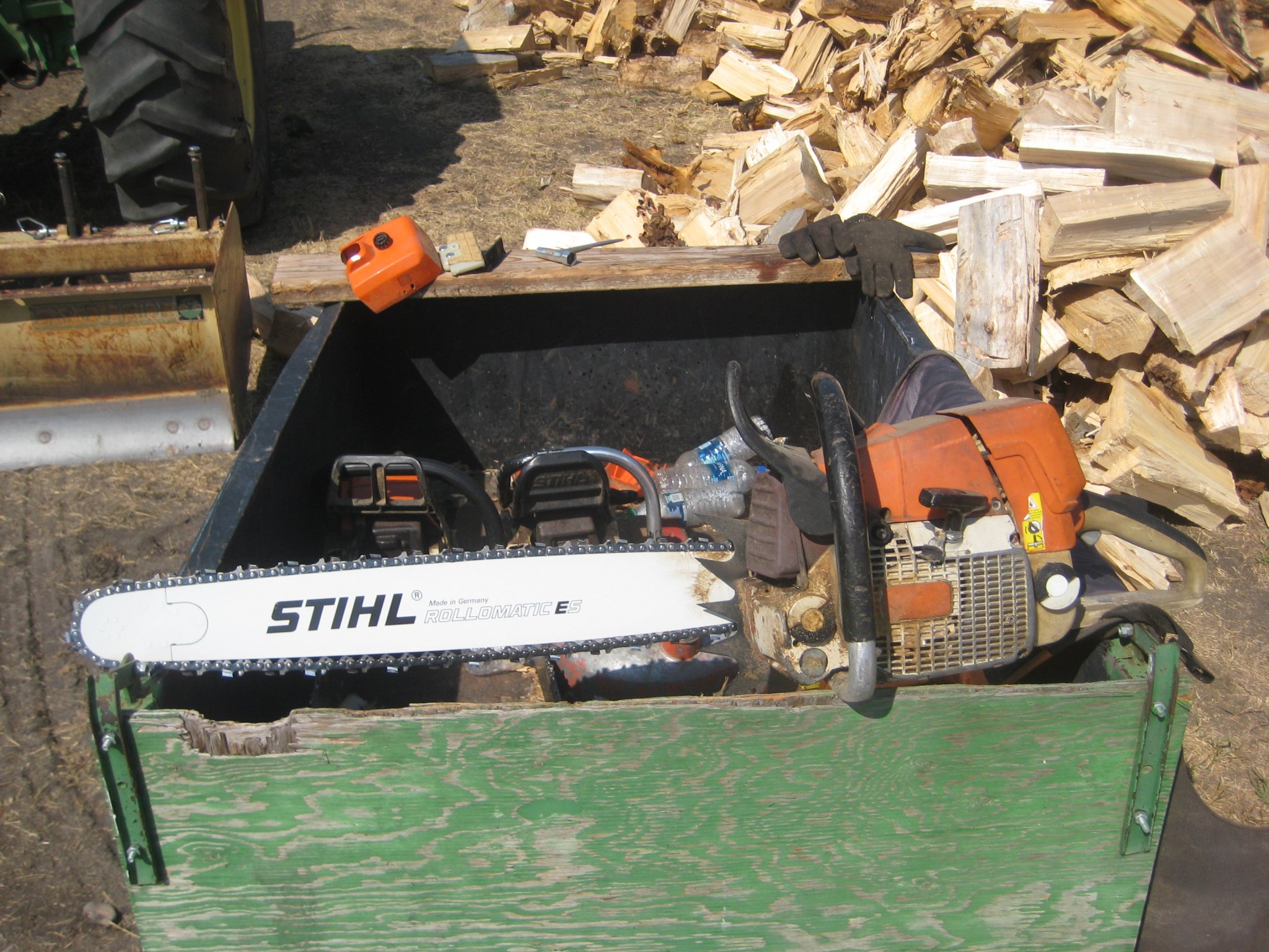

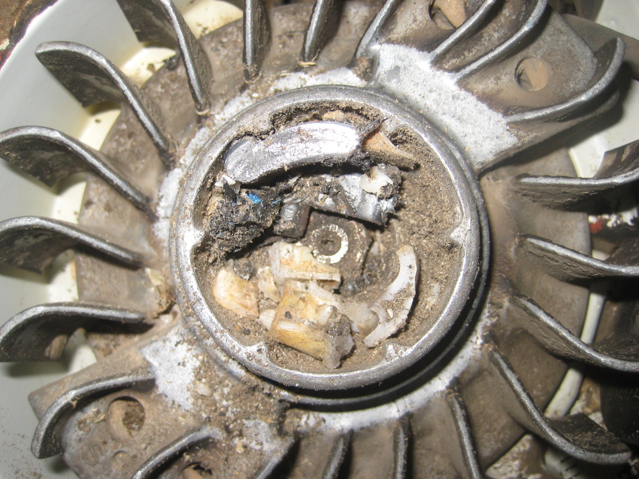

Photo of my 440 that ate the recoil starter this morning.
Getting gun shy of aftermarket stuff.

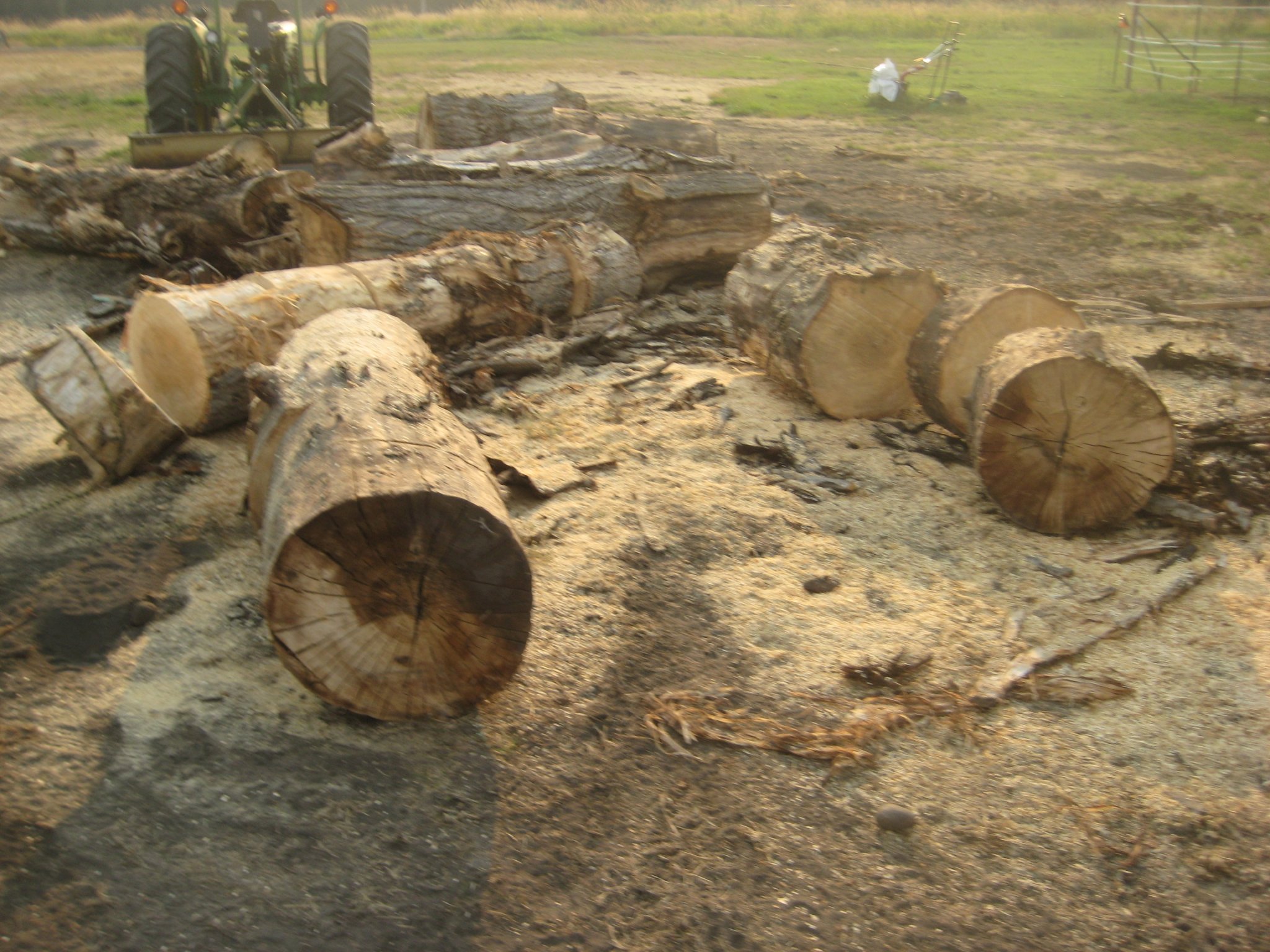

Still going! I need to get better at estimating log lengths before I cut. All the sections are about 1.5x the length I want/need and this elm is a bastard to split.
Measure and mark before you cut. Big Dewalt crayon and a stick at length you want does the trick.

Yeah exactly, the shorter circles bust open pretty easily. This elm is kind of stringy though, it doesn't cleave as nicely as maple or oak. Except for the Dutch elm and dry rot sections which fly apart.
I deliberately cut the fallen tree to double lengths though because I had to carry it by hand a hundred yards and I wanted to make fewer trips. Now I'm thinking about erring on the side of short rounds, just to be able to get the rest split and put away.
