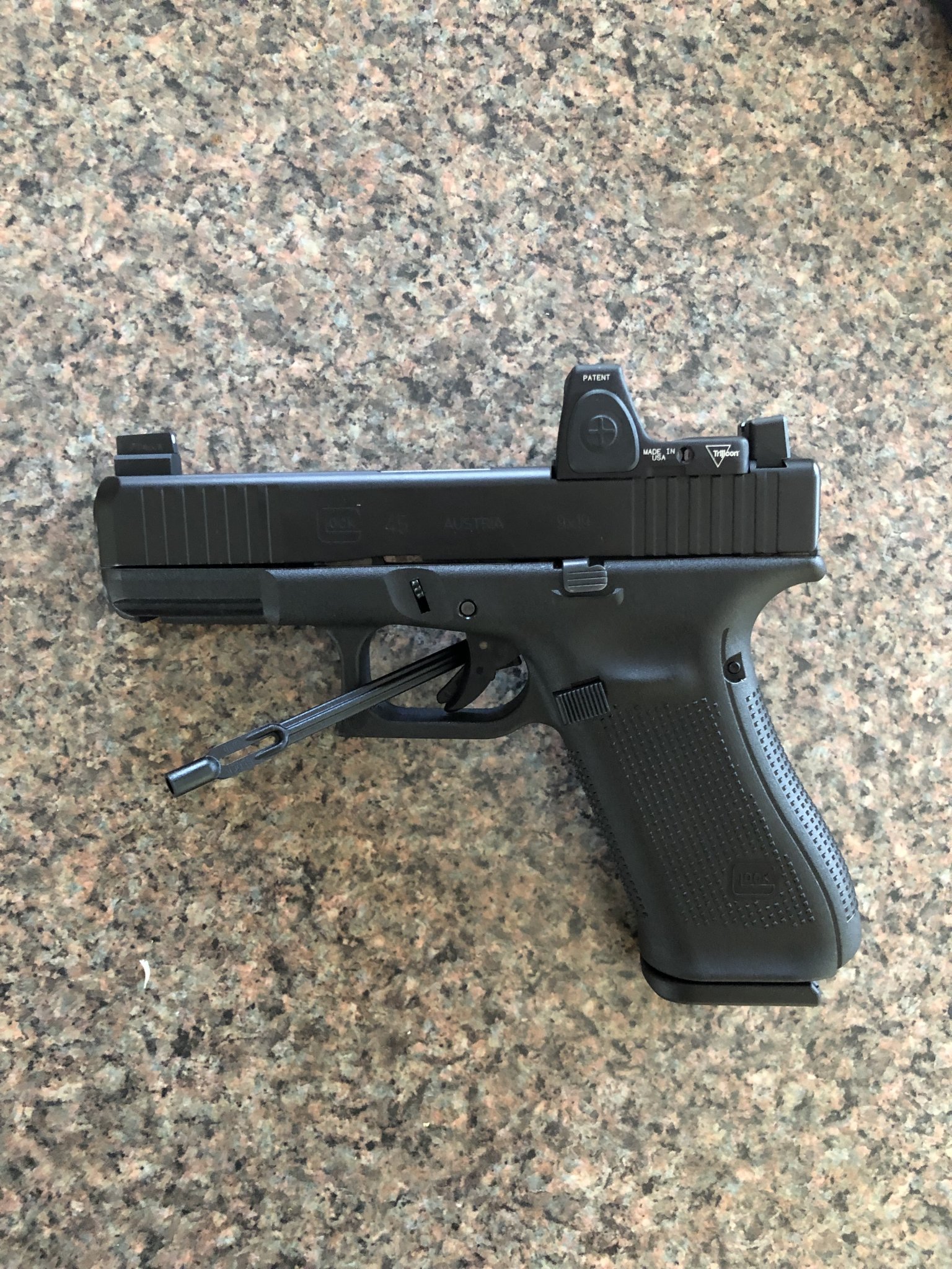

Well got rid of almost all my personally owned .40 stuff, and got this together yesterday ?86A0DCA9-7916-43F2-97AC-A17D6890B8AA.jpeg

OP, nice G45. Now go shoot it. :cool:

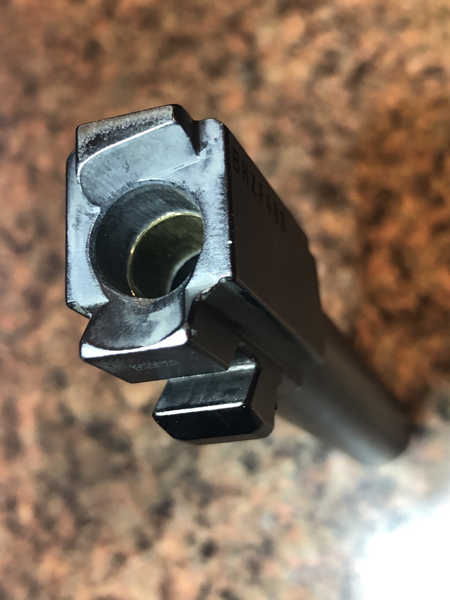

Got to shoot the new Glock 45 yesterday, but it didn’t go so hot. Used some reloaded 9mm ammo that I was given, and about three rounds in I was getting a bad fail to feed. Striped the gun real quick to check everything and make sure no barrel blockage and found this. Looks like the brass casing somehow split in half, leaving half in the damn barrel. Any ideas on getting it out without maring up the barrel?
Over size bore brush pushed into the case from the chamber end an pulled out from the rear. Or a tap that just engages the brass but does not touch the chamber, then tap that out with a punch from the muzzle. Last resort take a very sharp ctr punch an ease between the chamber an case collapsing the broken case.
I’ve been lightly trying to get in between the case and the chamber with no luck. Oversized bore brush may be the ticket.
What causes something like this? I don’t reload ammo and this is the only time I’ve ever shot any

Someone reloaded using OLD cases (probably a range pickup) reloaded one (or 10) too many times. Probably didn’t do good enough QC on brass prep when they loaded the rounds and the case was already compromised/cracked or stressed. Full case head separation when you fired the round and the extractor yanked the case head out of the chamber, leaving the rest stuck in there.
Over Pressure + over worked brass, most of the time. Were the cases you shot ever shot, in a none fully supported Glock chamber? There is a tool that takes the bulge out so the Glock bulged case will rechamber in a tight chamber of anything, but it works the brass hard over time.
Some penetrating oil might help loosen it from the chamber wall. I've used taps before on other chambers with a head separation.
I’ve wrapped the barrel in leather and secured it in the vise then tapped out the broken case from the bore end with a wooden dowel.
