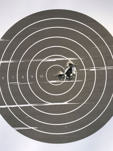

Mission accomplished!
The gun is shooting in the 0.3s at 50Y.
This is indoor and yes there is a noticeable airflow.
Also, as you can see, my shooting position is not very stable with no rear rest. That explains the vertical strings. With this setup I simply can’t group better than this with any rifle.
It likes the JSB 15.89 gr at 880 FPS.
The FX 18.1 gr pellets (made by JSB for FX) didn’t shoot any better.
The 22 gr hybrid slugs didn’t shoot that well (around 1”). But those slugs need to be pushed at +900fps and with the factory setting I can’t get more than 800 FSP

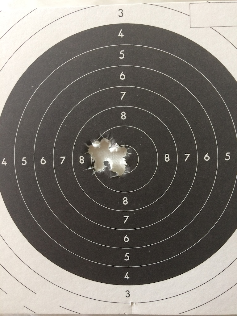

First outing with the rifle at 50Y in an indoor range. I bough a tank so I can refill at the range. The Huma regulator won't be here before next week, so to get more shot to shot consistency I'm refilling every 20 pellets (with the tank it just takes a few seconds).
I tested many pellets from 8.4 to 13.43 gr. Almost all pellets shot pretty well (typically below 1" at 50Y).
The best pellet was the JSB Monster Redesigned 13.43 gr. I shot a 4 five shot groups that was pretty good. I did it again just to make sure it's not pure luck.
I'm still figuring out the rifle, but it's clearly shooting on par with your typical CZ 455 at 50Y.

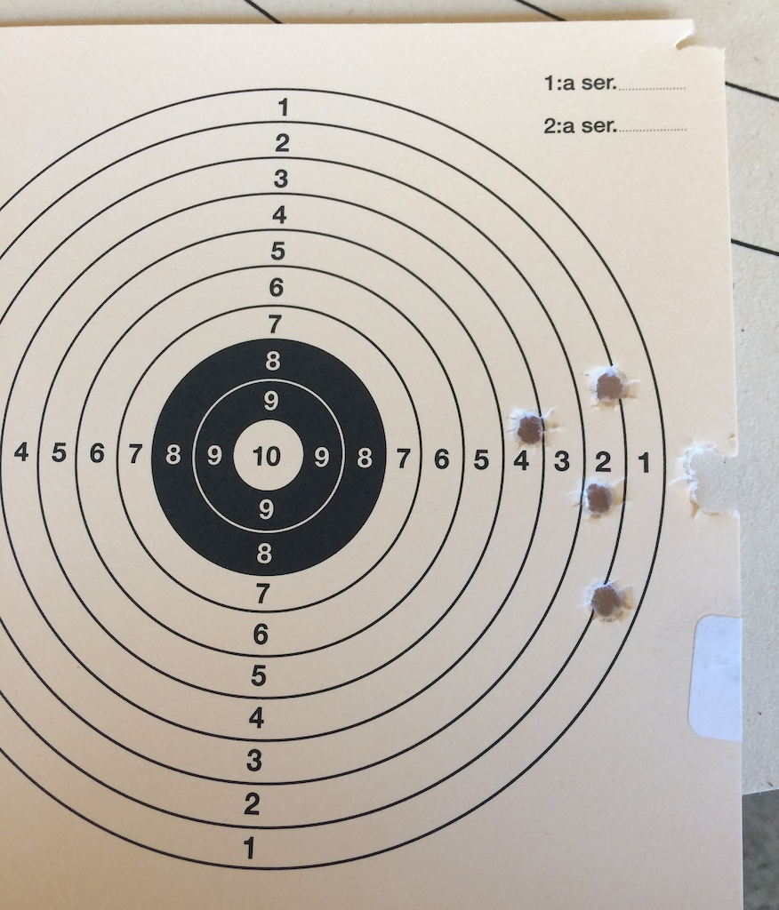

Nice rig. I have been shooting big boy air rifles for a few years now. I have a springer and a PCP which is a 22 cal Benjamin Maurader. It shoots good and out to 35y it is pretty close to one hole groups all the time from a bench on a calm day. I don't shoot indoors but I would expect it to be competitive with a low budget 22 with budget bulk ammo in an indoor range. PCP's are not cheap. I bought mine used with scope, hand pump and aux tank all for $400. New retail that whole pkg today is closer to $900. A true match grade PCP is going to be closer to $2k or more depending on your choice of flavor. PCP's are not light weight either. I hunt with mine some. It is heavier than a heavy bbl tacticool 22 due to the big heavy air tank attached. What they doo well is they are quiet and usually legal to shoot in urban environment. No recoil either so great for training new shooters who may be sensitive or fearful at first.
Some of the match quality PCP's like from Walther or Anscutz or others would be tough to beat. But out at 50y and outdoor, they are not going to stack up very good with even a factory CZ if the shooter knows what he is doing and spends the time to choose a lot that works well with his rifle. For example I have attached a tgt from lot testing of a new CZ457 which is bone stock first session out of the box shot from a simple sandbag rest. The bench was indoors but the range was outdoors adding a mirage element as well. The tgt in the pic has about five lots of Lapua CX ammo or others represented but the two best lots were in the upper left at 50y in gusty wind that was hard enough to move the tgt stand at times. Even so, the groups are one ragged hole. Did not measure yet but they are about two bullet diam edge to edge and the larger groups were stringing vertically opening to about 1/2" on most. I too learned that wind will affect the vertical displacement of 22's and pellet rifles depending on the wind direction and speed. Since I was lot testing I did not hold off for wind on any of these. While the PCP has a tighter ES the lighter pellet is affected more by wind than the 22lr so, the longer the shot the worse the result unless it is dead calm. Many indoor ranges have swirls and eddy currents which while slow can be very difficult to read and diabolical to shoot in. Ask some of the indoor benchrest shooters about it. Most agree that shooting a 22 indoors may be harder than outdoors. At least outdoors the flags help with the read. My opinion, PCP is not the be all end all but if ammo supplies do not improve soon we may all be reduced to shooting air guns.

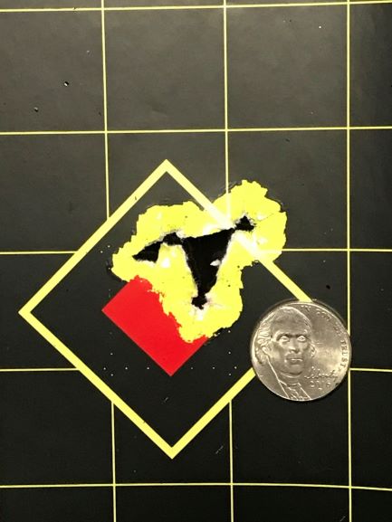

I got myself an FX Impact in .25 caliber 2 years ago. I got it for several reasons but the main thing was to have a good pratice tool and have fun shooting with my son. Do to legeslation it is also much easier to shoot an airgun outside of shooting ranges here, like at my moms and friends houses and farms and similar. So I got the FX and it has been awesome. We have shot about 5000 pellets with it so far. It is the most accurate rifle I have and it is a joy to shoot it.
Here it is with my Delta Stryker before I moved it to my TRG.
Here is what 6 shots looks like from 50 meters:
And here is what 6 shots looks like at 100 meters. I did not hold/dial for wind, as you can tell.

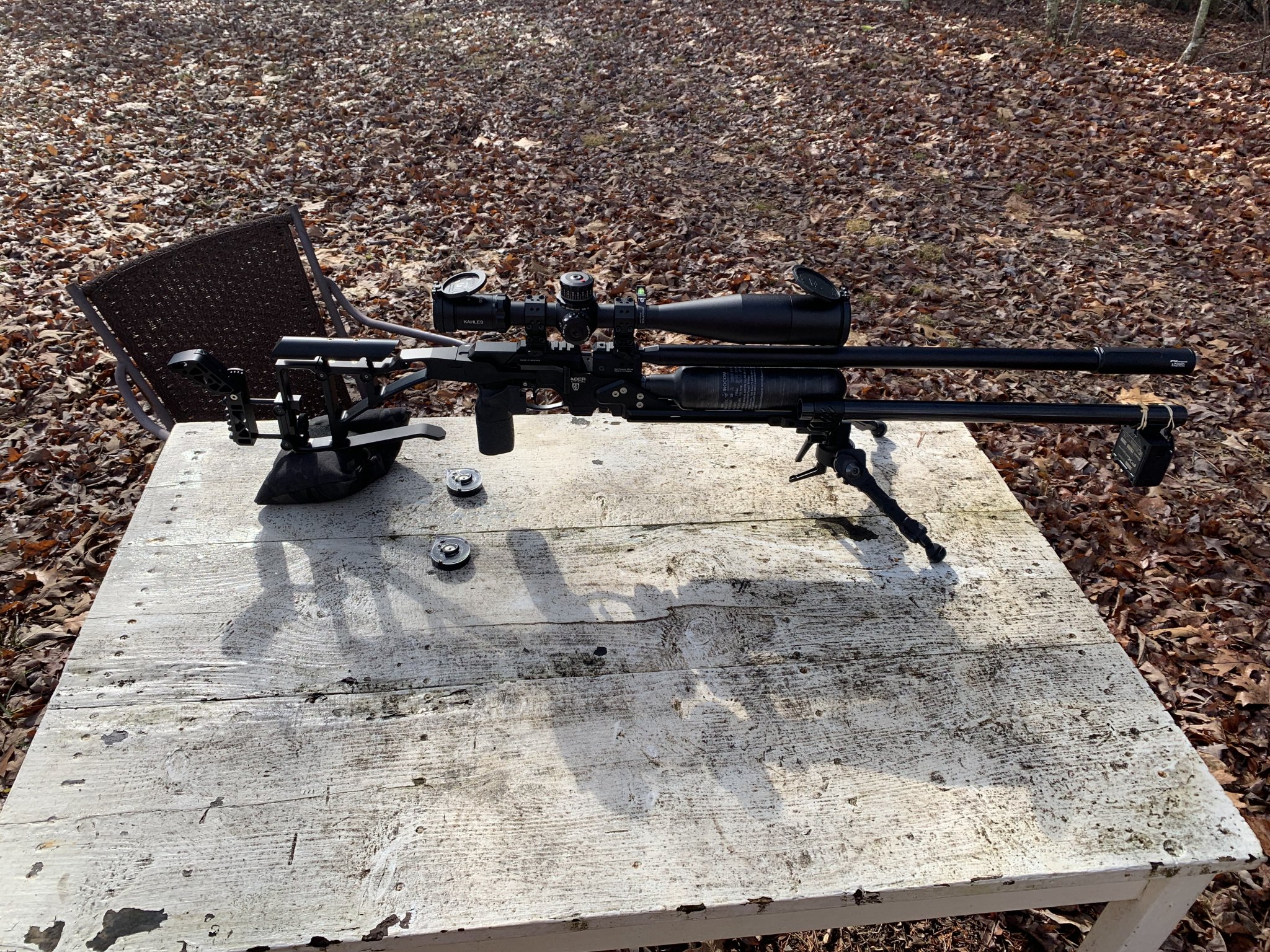

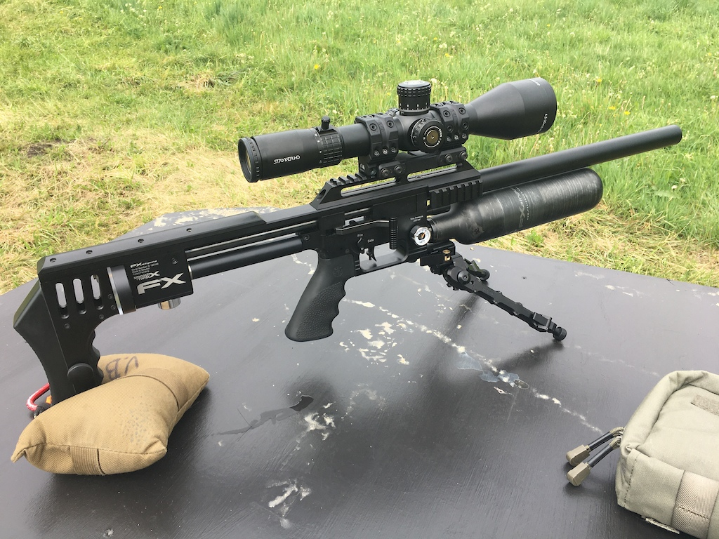

Shot the FX at 50Y outdoor.
I also took my Anschutz 1710 HB to compare against the FX. The Anschutz is a proven shooter and can do in the mid 0.2s with Center X on a calm day.
The FX shoots better outdoor with the heavier 18.1 gr on max power (indoor it didn’t shoot any better than the lighter pellets)
With a 5 mph wind, the FX shot an average of 0.4527”
Then the wind picked up. With a variable wind of 5-7 mph:
The FX shot an average of 0.5372”
The Anschutz shot an average of 0.5248” with Wolf Match (made by Eley) and 0.4667” with SK Match
While the group size is pretty similar between the 22lr and the FX, the wind shifts the the pellets more. This also means that the FX is a great tool to practice and read the wind (what Steave123 was also saying earlier in this thread)
I’m very happy and impressed with the first outdoor results of the FX.

I bough my FX Dreamline Tac from Utah Airguns. Had I seen your recommendation, I would have probably give Ken a call.
Having said that, I'm pretty happy with Utah Airguns. They installed a power plenum on the rifle (wasn't specified on the order nor their site) and did do a function/chrono test (900 fps with JSP 18.1 at max power). The regulator is also set at only 110 bars (which is good).
The rifle did come with a couple of loose screws that I had to tighten (not a big deal).
I really hesitated between the Crow, the Impact and the Dreamline.
I went with the Dreamilne after doing some reading. The only benefit of the Crown/Impact vs Dreamline, seems to be the potential to get additional power. But that additional power seems to be only necessary if you're shooting 30 cal slugs. If you go with a 0.22 or 0.25 caliber, the Dreamline has plenty of power (and it's cheaper and more versatile as you can change the overall configuration pretty easily).
What I really like about FX is the ability to change the barrel liner. I'm not planning to do that, but you basically have the grantee to not be concerned by a bad barrel (worse case scenario, you can change your barrel liner for only a 100 bucks).
