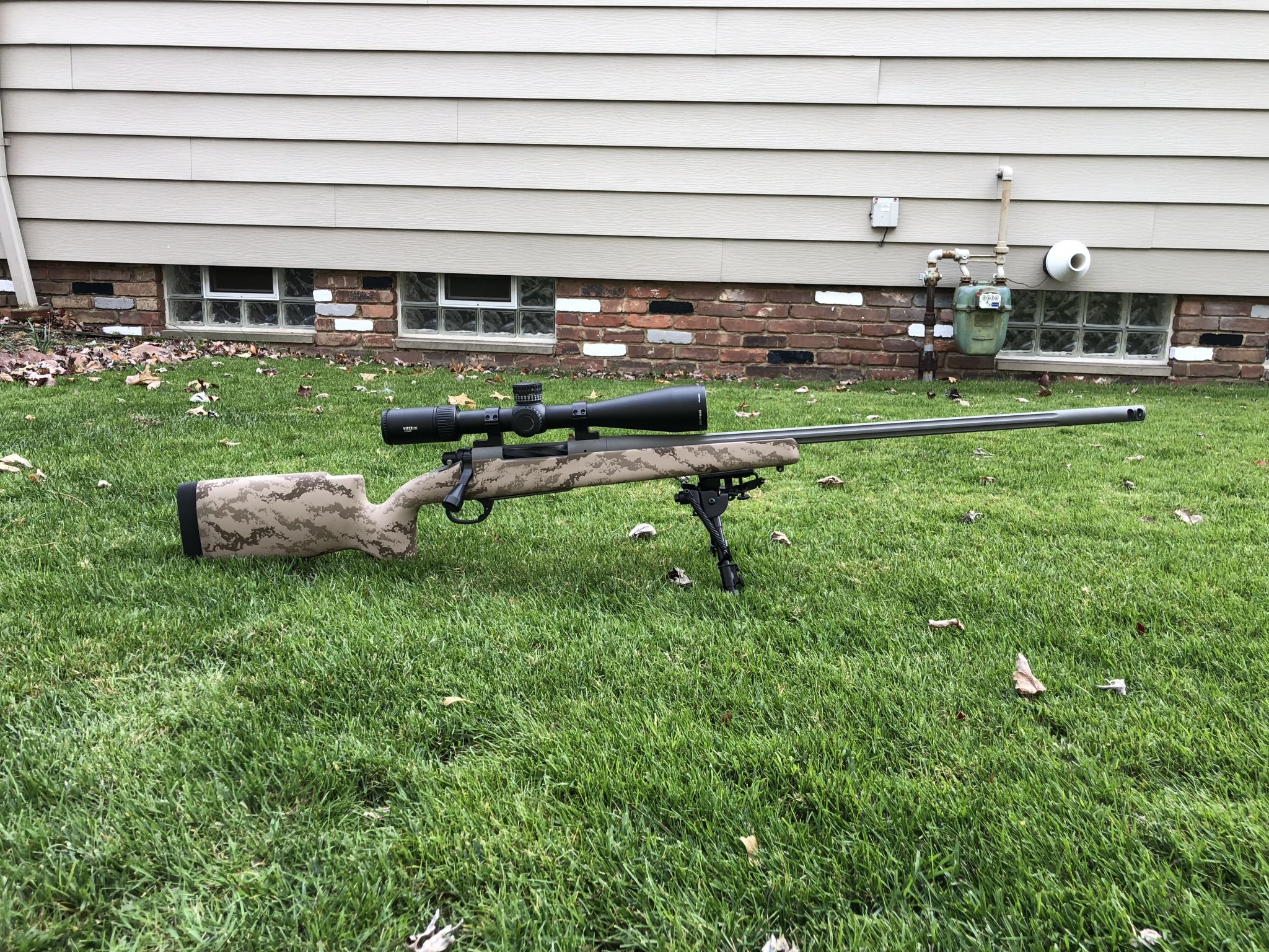

I just threw an AG Alpine Hunter on my 6.5 Sherman. Haven't had the chance to shoot it as is yet, but plan to do so soon. I'll see how it shoots and make a decision. I had a Stocky's VG2 (made by AG) and it shot great without any bedding.
Awsome looking set up. Keep us posted. Would love to know how it shoots as is. And if you decide to bed it would like to hear your opinion on the difference it's made. Good luck. Awsome rifle.
