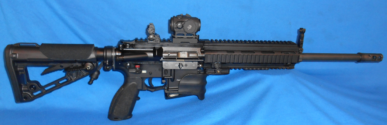

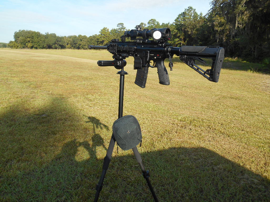

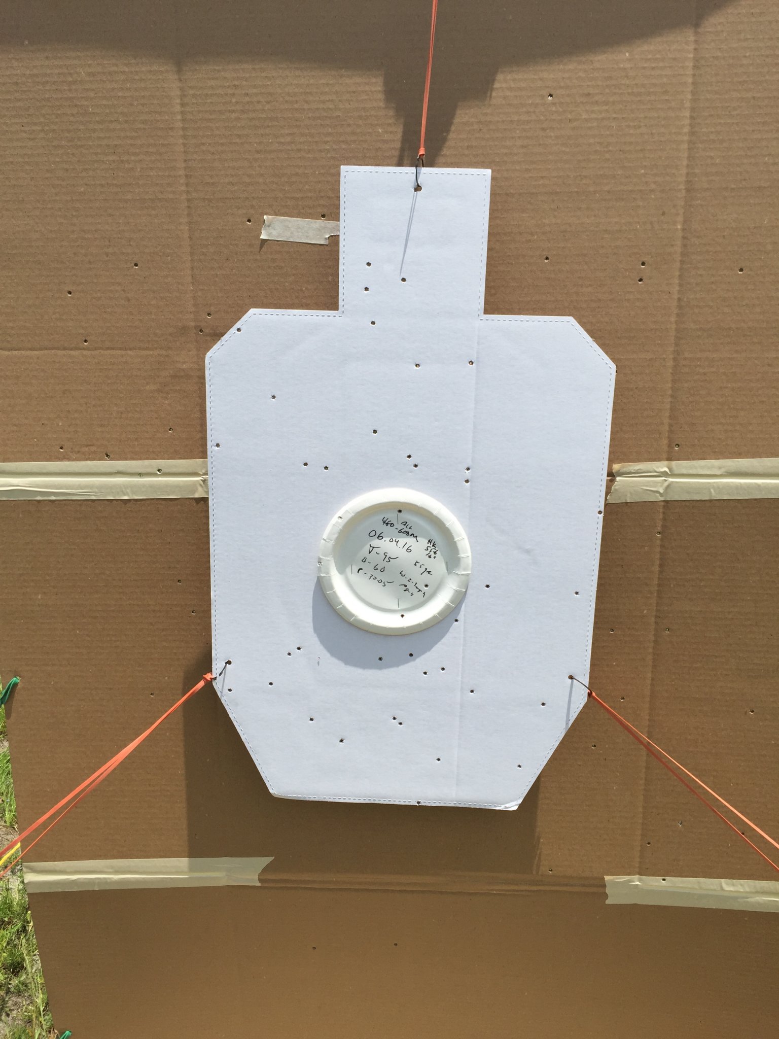

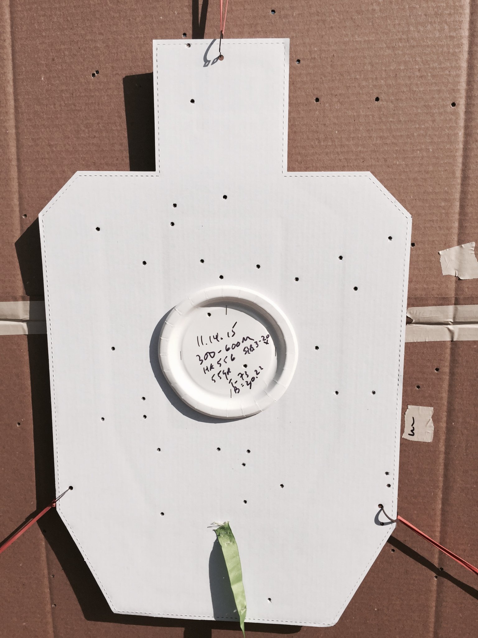

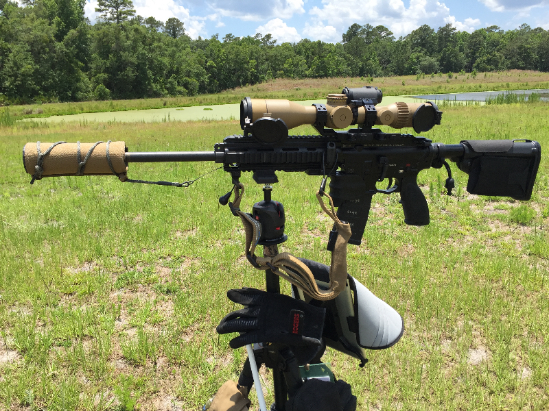

I have been pretty satisfied with the HK556A1 using both S&B 1-4 Short Dot and 3-20 Ultra Short out to 600 meters with simple ammunition. It's been good enough to qualify with Advanced Rating at the elite Roger's Shooting School @ 150 meters with a Aimpoint red dot.

It shot OK. I could hold a 20-round mag in a 2 MOA or better group with 77gr SMK 5.56 Black Hills. Shot it out to 770 and 800y on a few occasions with a 1.1-4x Short Dot. Tried it with a 5-20 Ultra Short but it was about as heavy as a shorty AIAX so...might as well just shoot that.
Going with a longer rail than the factory quad helped a lot with mirage. The 14.5 and longer barrels get hot forward the gas block. There's a purge/bleed-off valve that pushes hot gas forward on to the barrel in front of the gas block. Not a problem with the 10.5, but longer barrels get hot and can show some thick mirage without a longer rail.
