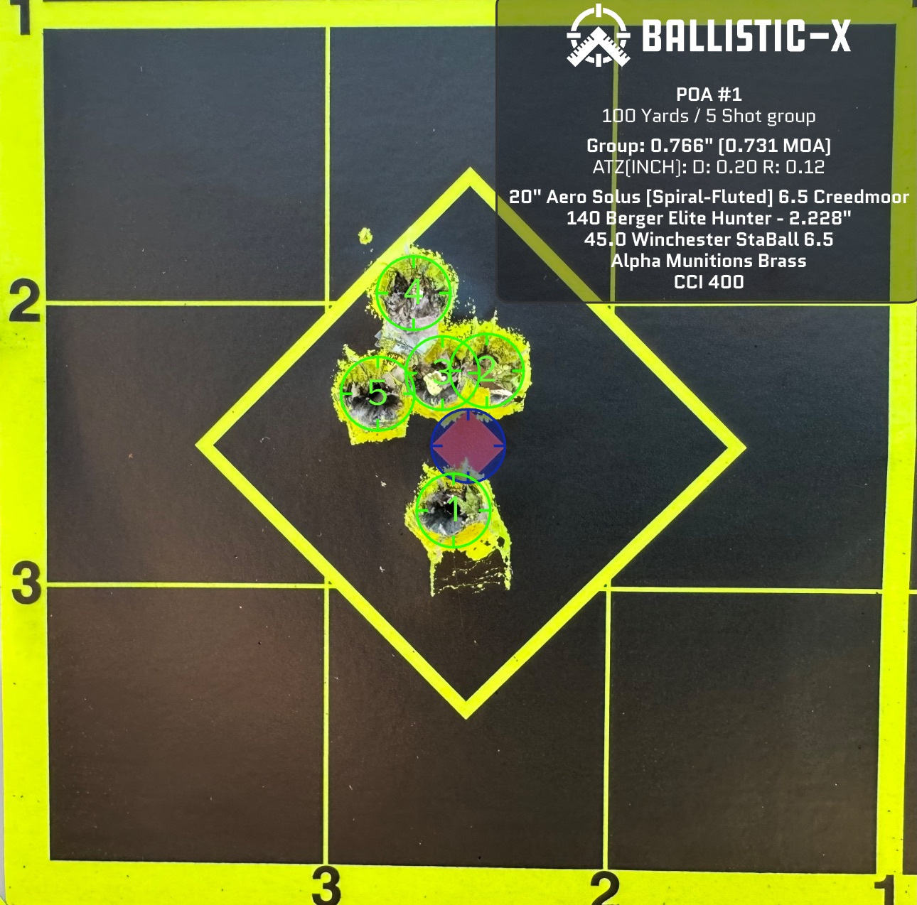

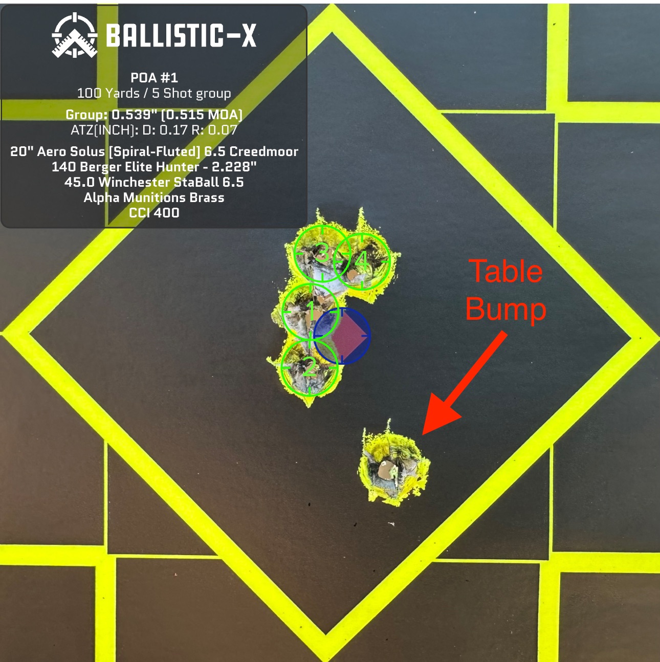

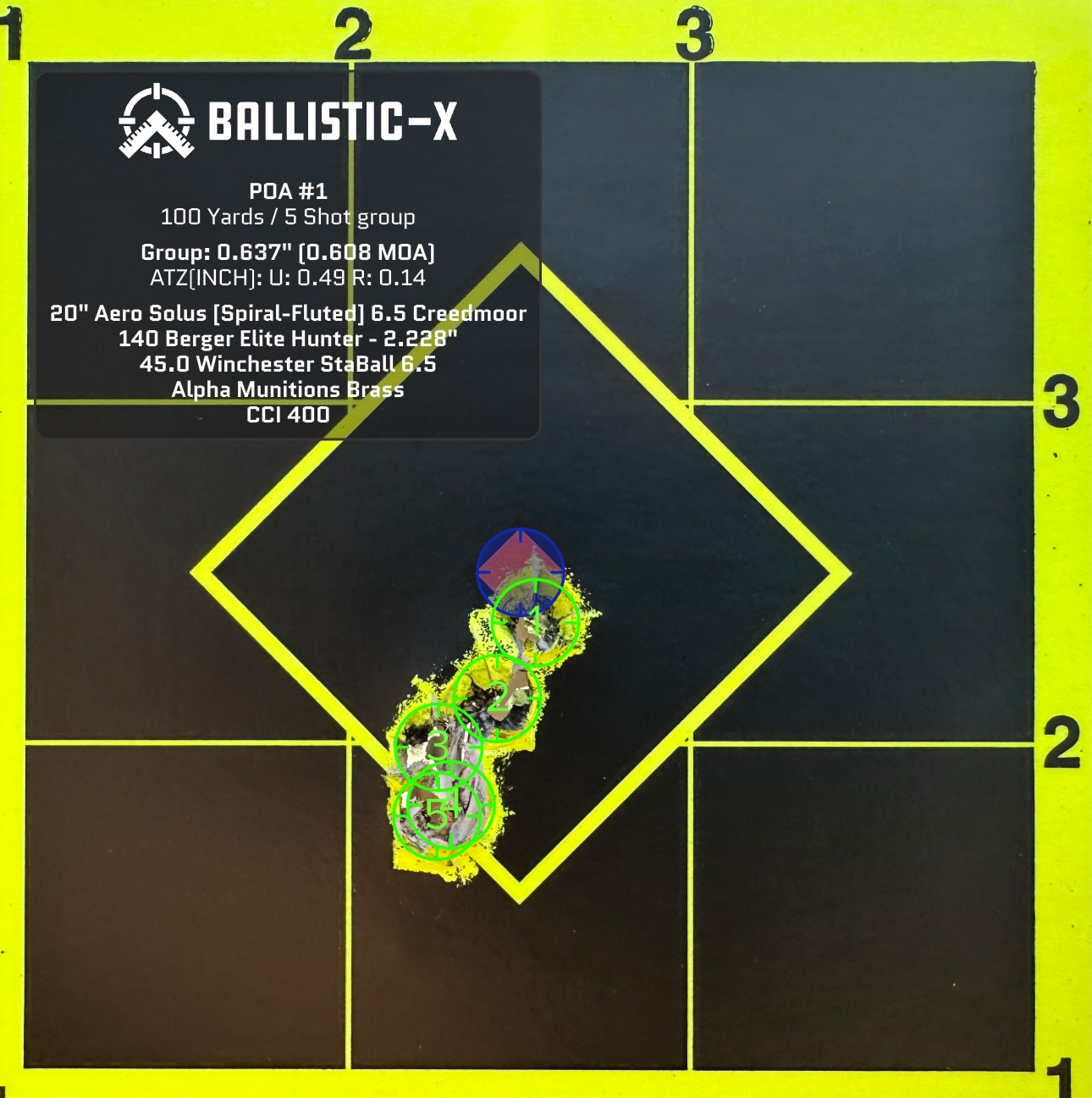

Decided that since I wanted to hunt with the spiral-fluted 20” 6.5CM Solus rifle next year, that I would test some loads with the Berger 140 Elite Hunter bullets. So, I used the same Alpha SRP brass, same CCI 400 primers, same 45.0gr of StaBall 6.5, but seated the bullets about 0.072” jump to get the bearing surface sitting fully in the neck, with just the boat tail protruding into the case body. Using 0.003” neck tension with SAC bushings in my Redding Elite Series comp dies, my average runout is 0.0005”. Ironically, they were leaving the muzzle at the same rough MV as the 140 RDF's... Right around the 2,740 FPS range.
So, having done zero load development, just threw them in there after measuring the chamber with them…I chose to jump them 0.072”.
Here's the results… For a hunting rifle, I'm satisfied with these results, having done nothing more than scrubbing the barrel out, adjusting the scope and changing the bullet to a proper hunting bullet.
image_cropper_0476EE5B-7E35-424E-A207-EF2BA2C138CA-12336-0000099CC9D943AB.jpegimage_cropper_6CDC59A1-47AF-4E61-ACBF-D1DF7C6F4CD8-12336-000009A1A53E44AB.jpegimage_cropper_79341300-A7D8-478C-9193-742D3842044B-12336-000009A29E7234C3.jpeg
View attachment 8631064View attachment 8631065View attachment 8631066
View attachment 8631059View attachment 8631060View attachment 8631061
What's your OAL on that round?
I have some Berger 140 grain Hybrids that I CANNOT get to group in my Solus guns. I've tried it across three different barrels, including the 20 inch spiral fluted variant and yeah...shotgun.
I measure base to ogive, 2.228” for my chamber is 0.072” jump. Unless your chamber is relatively similar in length, then it might not work in your’s. Also Berger Hybrids are not the same as Elite Hunters, they’re shaped slightly different. So, measure your own chamber, and then work your numbers from there.
If you can't get 140hyb to shoot going mid 2700s jumping 50-70k at least 3/4 minute, you have a bunch of super picky barrels.

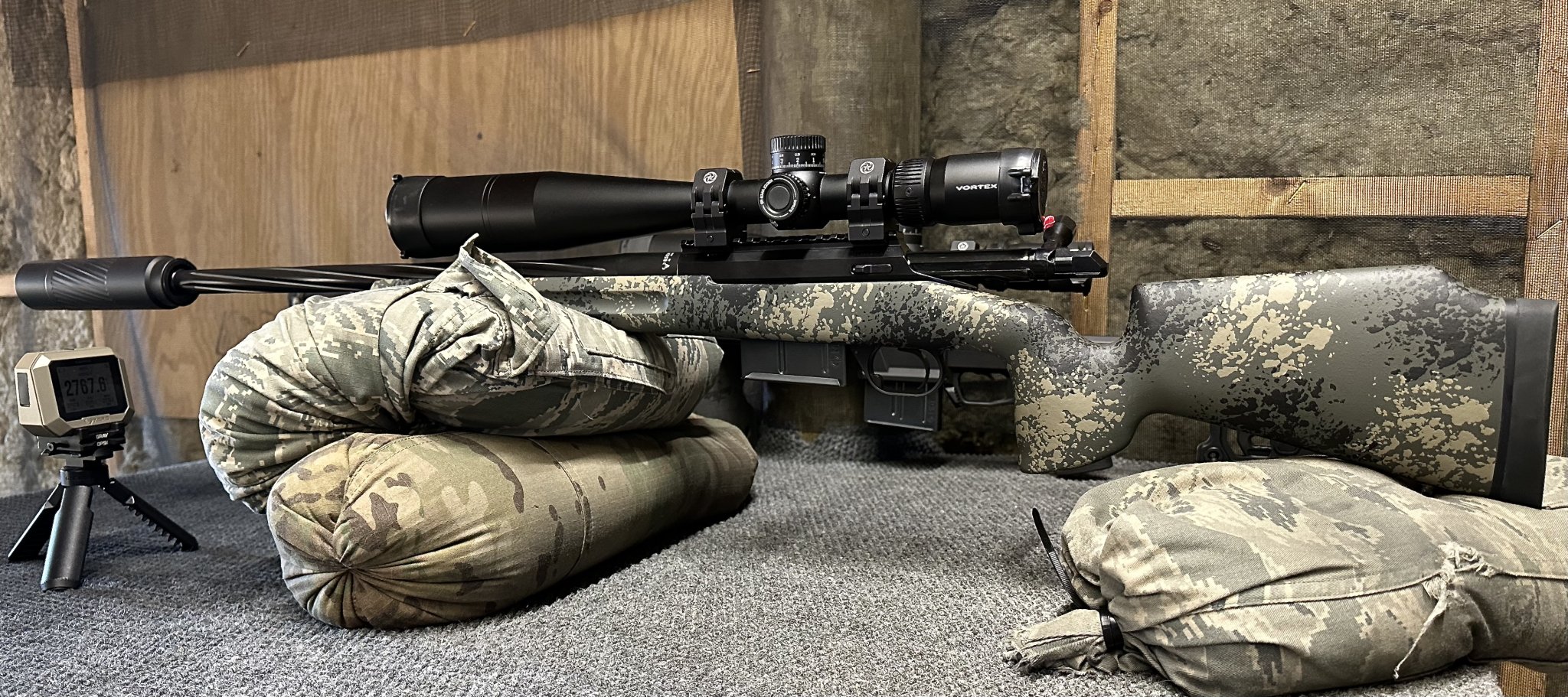

The weather's so foul here today (wind with gusts to 60+MPH, 30* with snow) that I might as well get the 6XC bbl pulled from the 1st Solus and get the chamfer cut on it. I entertained the thought that the rifle might still feed the 105 Scenars out of an AIAW magazine instead of AICS, but why not cut the chamfer first and find out if it fixes the problem? Only found one place that usually has AW mags in stock; might wait to see if Accurate Mag ever comes out with the AW mags...
ETA - photo of the PVD FDE 223AI in a B&C #2015 stock. Scope is probably overkill, but have been looking for an excuse to get the big Sightron SVIII mounted on something so I can try it out....

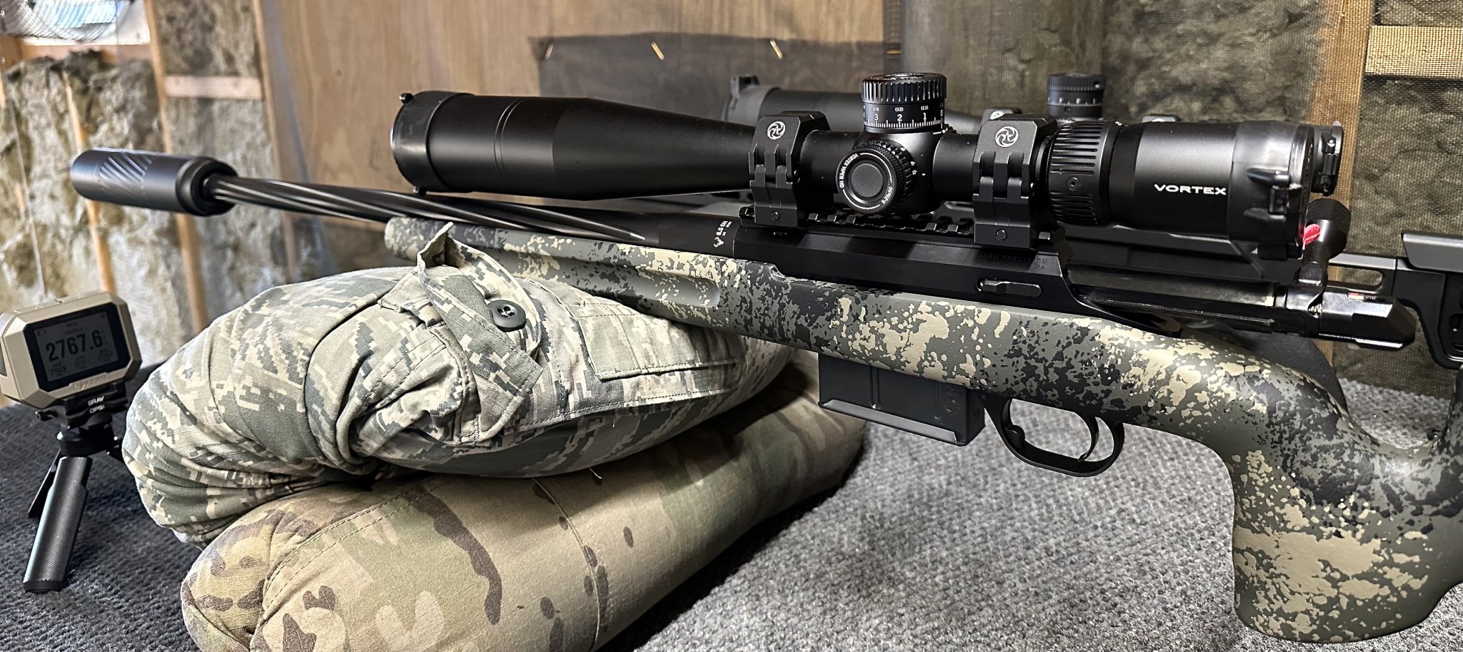

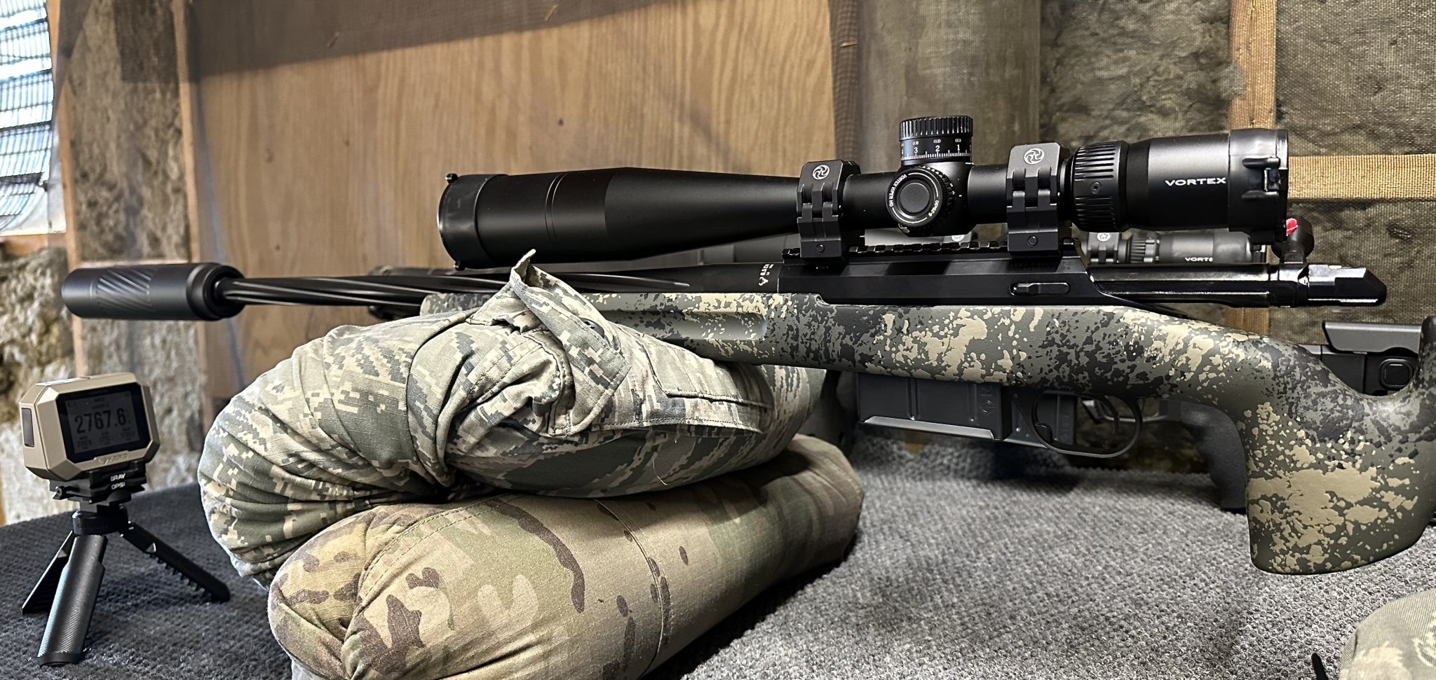

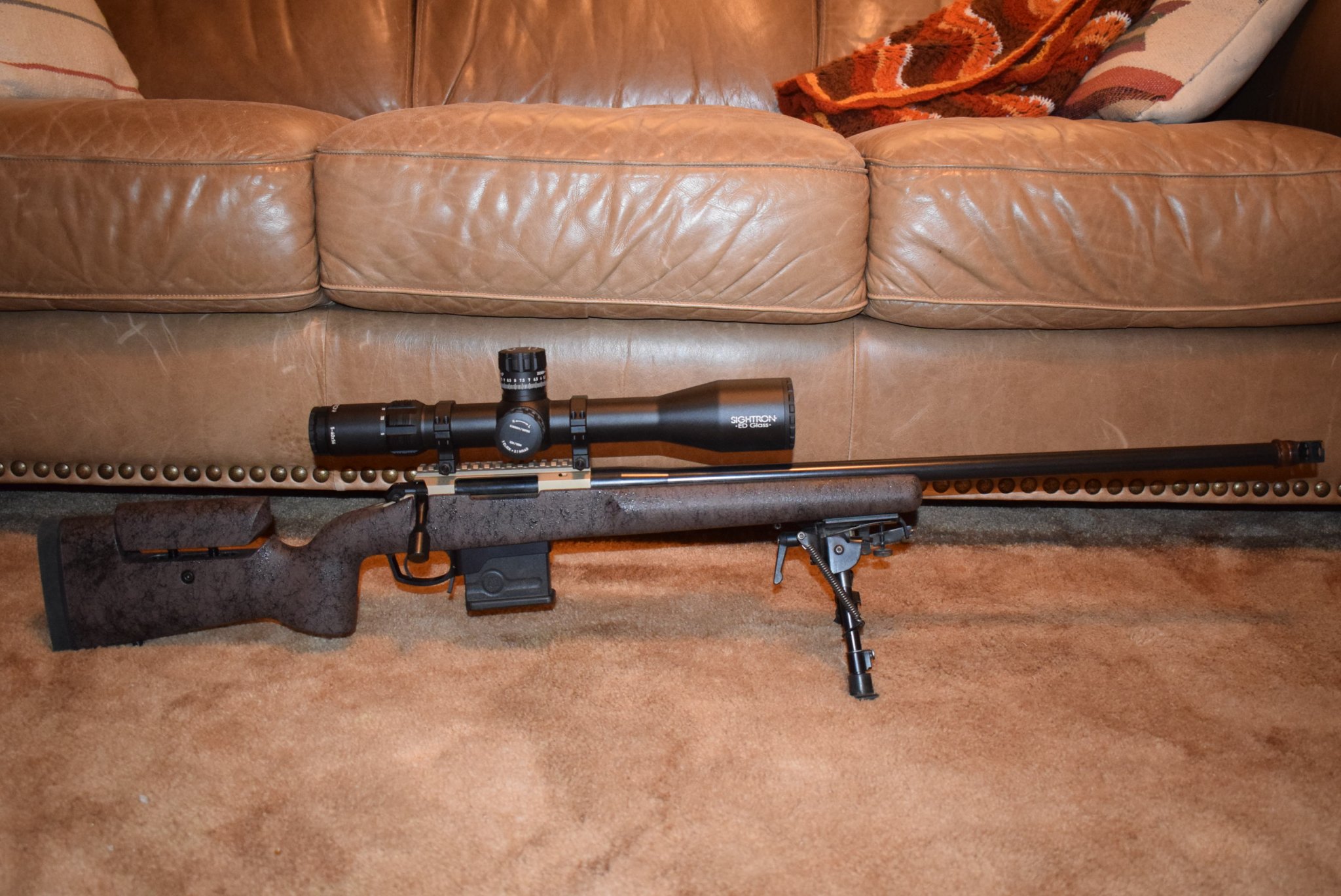

I've done a little bit of shooting with the Bartlein gain twist (1-8 to 1-6.5) bbl that I chambered for 223AI since my last post. Have had unusually heavy rains for a few weeks on end, so too muddy to even make it to my 600-1000yd range in our pasture. But the few times that I was able to shoot at 600, the gain twist is showing some good potential, even with very windy conditions. I was shooting S80MK, Berger 85.5 Hybrid, and Berger 90VLD bullets - the Sierra 80s & Berger 90s have shot very consistently - as they usually do in my 223AI rifles - but the 85.5s are hit or miss so far.
The ejector springs are way over-powered in this bolt, flinging 223 brass out with excess force. Even shooting prone off bipod & rear bag, I wind up looking for ejected brass - not ready to take this rifle to a precision rifle match until I get the ejection springs trimmed. We've had 3"+ of rain over the Memorial Day weekend, so I'm going to have some spare time to work on the ejector springs before I can get back into the field to do any spraying.
I'm also enjoying shooting behind the Sightron SVIII 5-40x56 scope. It's very clear & sharp, I like the turrets, just a huge scope. The floating dot in the reticle doesn't really become visible for my 73yr old eyes until I run the magnification up to 20x +, so will have to try illumination when shooting close range movers at lower power to see if that helps.
Forgot to mention that the chamfer I cut on the breechface of the 6XC's barrel took care of the feeding issue I was having with Lapua 105 Scenars in the first Solus I built. Like these actions, just hoping that Aero gets themselves back up to par where CS & parts availability are concerned. Haven't needed to deal with them on anything recently, so perhaps they're making progress in that respect....?
When you trim your springs can you pls post back here to let me know how many coils you trimmed off? It would save me some time bc ive been meaning to do the same.
Forgot to address the question about cleaning rod guide - over the years, when building rifles on slightly oddball actions (BAT 3L, Howa Mini, etc) I usually make my own rod guides, as I keep a small supply of aluminum tubing & delrin rod on hand so I can make a guide that fits. Been too lazy to get anything made for either of my Solus rifles, but when I do, I will need different delrin chamber plugs for the 6XC & 223AI barrels. Would be the same for any other action...
