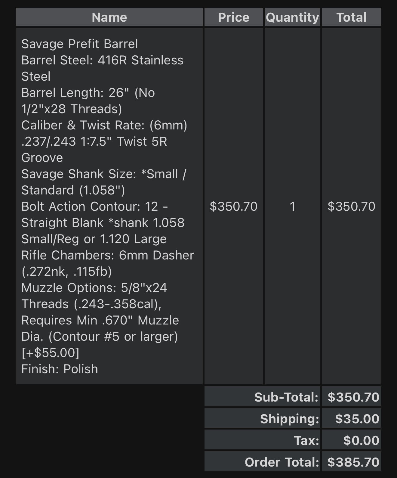

I ordered a 308 barrel from them during their Memorial Day sale last Friday. Received tracking info the same day. Fed Ex shows that it will be delivered Friday.
Barrel arrived a day early, and I slapped it on my Origin last night. This weekend we’ll find out if it shoots or not.
