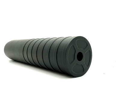

For the TBAC guys, is the 338SR suppression worth the size increase over the magnus? The video seems to suggest the answer is no…
The SR mount is sort of an independent variable, IE, it adds a pretty much constant amount of weight and length to any "base" model, IE, to the Magnus-CB or the regular 338 ULTRA (BA mount).
If you're asking is the 338 Ultra worth it in suppression over the Magnus, for .30 caliber and smaller, probably not as it gets another about inch and a half longer. The difference is about 2 dB. But it is quieter.
As far as SR mount vs. CB/BA/HUB mount and the size implications, it mainly depends on what kinds of mounts you want to run and what interoperability of cans you want across the rifles. That you can throw your Magnus-SR or 338-Ultra-SR on your MK18 and run through a combat load is a bonus..

Really depends on how big you want to go. I'm really happy with the size, weight and sound of my ultra 7. Small and light enough for hunting and sounds great. The magnus will be quite a bit bigger but also quieter. Need to decide whats most important to you. Don't have a magnus, but I have a 338 ultra and it sounds amazing but I never put it on if I'm going to be humping the rifle very far.

Just got mine recently. Only had a chance to shoot it on my AR so far but I'm very impressed. I have a video but it doesn't do it justice. No reason to go ultra 9 with the Magnus out unless you really need a 1.5" diameter can.
