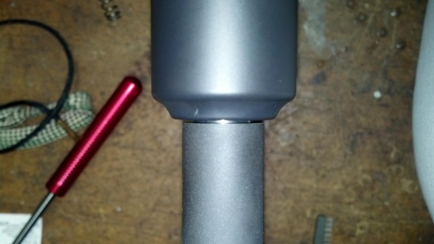

I trust the smith that did the work. Is there something specific I should check? The shoulder seems to fit flush with the can and the threads are fairly tight before the can is fully tightened. My smith said that he could have gotten the theads tighter if he had the can when he'd threaded it but I didn't have that option. The brake that he threaded it to match fits very tight to the threads before the brake is tight. I've attached a picture of the installed brake which fits very nice and flush to the barrel with a smooth transition.
I remember being surprised by how much of a change there was from the brake to nothing installed at all. Looking back at my notes I zeroed my rifle a few months back (when I got the brake) with the brake installed. I then took the brake off and shot with no thread protector (just exposed threads) and my group was 3.5" high at 100 yards. Thats a full mil difference. Seems odd that the thread protector which is just a light weight knurled off the shelf thing would make a .5 mil difference. Perhaps I need to head to the range again tomorrow and revalidate this data. But like I mentioned all groups were sub MOA (even with pulled shots) ones where I didn't pull a shot were sub half MOA.
~Brett

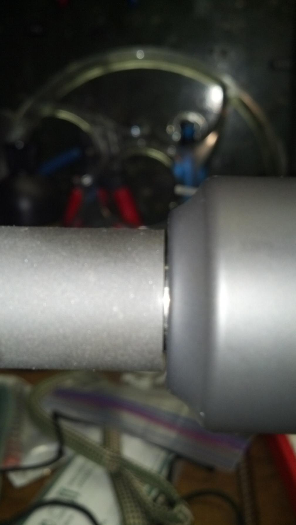

I went and checked things out and the shoulder looks pretty good. Able to get a feeler gauge all the way around and things are fairly close. The only imperfection is because the threads don't hold perfectly tight before you're up against the shoulder. I did find that the area around the crown was fairly dirty and I've cleaned the hell out of that. Also cleaning the hell out of the bore tonight. I'll head to the range again tomorrow and see if anything changes. Still though I remember being amazed that the brake would drop the round 3.5" at 100 yards when I first got it so I wasn't that surprised that the suppressor was a somewhat large change. When i go tomorrow I'll shoot in 4 different manners. Threads open, threads protected, brake, and suppressed. I'd like to see if the thread protector has a half mil change which would align with my range notes.
~Brett

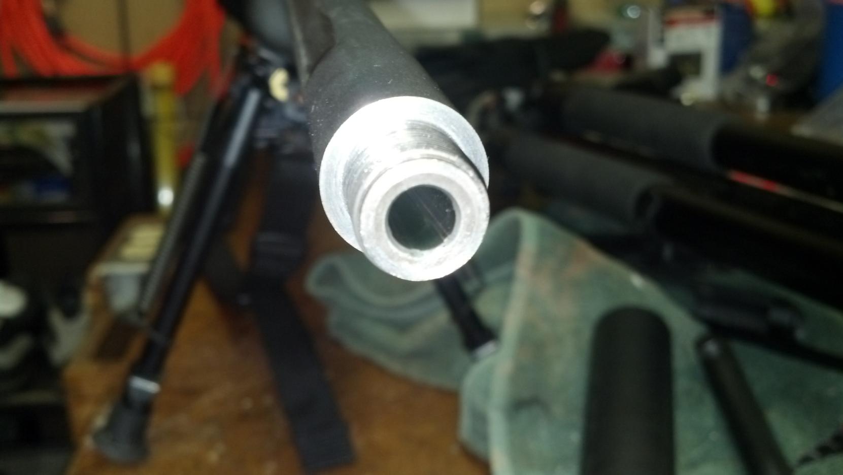

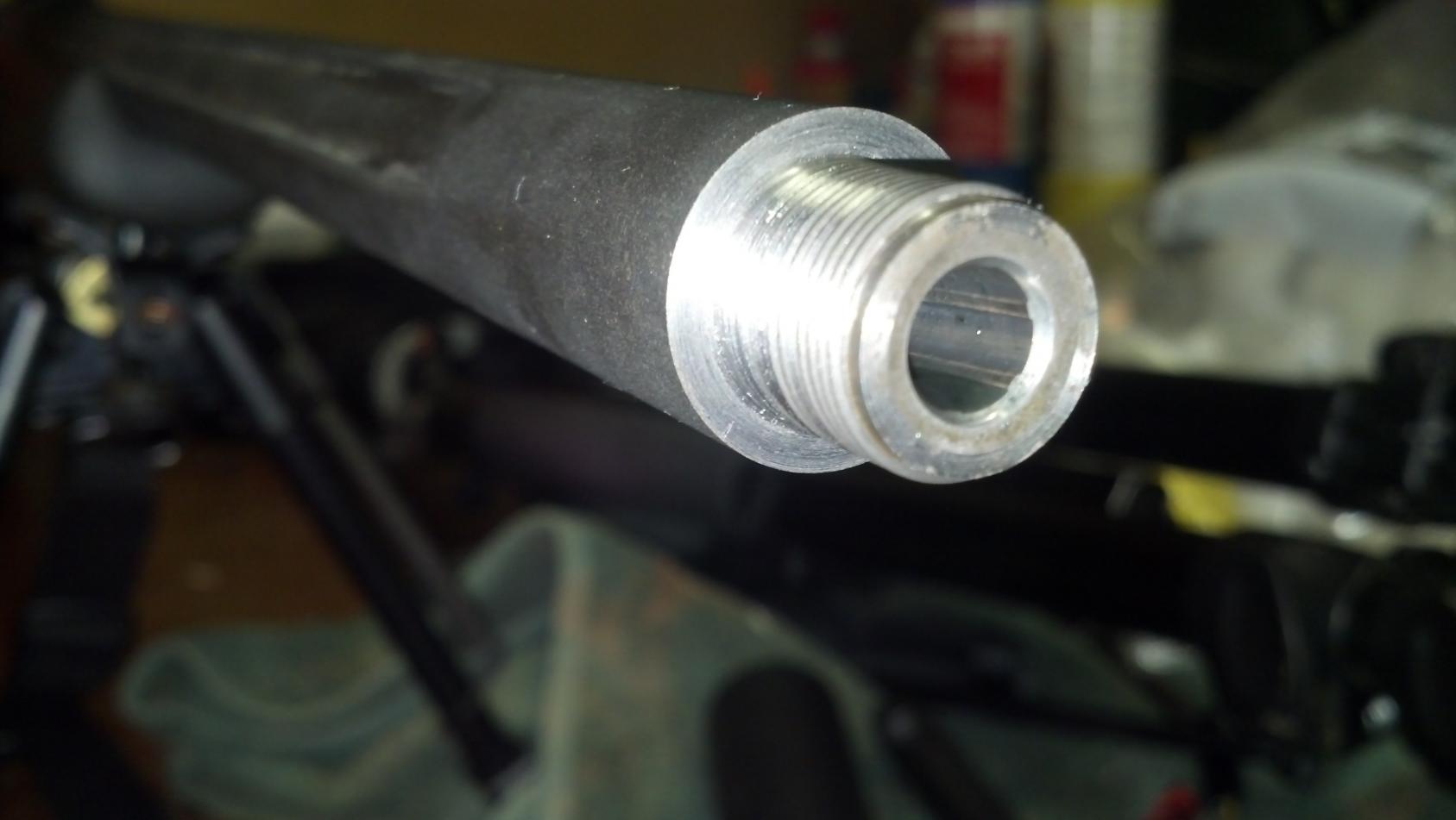

I gave this to the smith when I asked him to thread it. I'm .0035 short on the .6" length. The threads are good but I dont have the .06" non threaded section just before the shoulder. Not sure if he did that for his brake or what but I can't imagine that that would make a huge difference.
~Brett
In the second and third photos in the last post, the suppressor is not shouldered. Is this how it is when you are shooting it, or did you take the photo this way to illustrate something else?
The threads should not be super tight and the threads are not what holds the can straight- the shoulder does. If the shoulder is not at exactly a 90 degree angle to the bore you will likely have problems.
However... If you are seeing a mil difference by just adding a few ounces of thread protector to an otherwise bare muzzle, your load is probably hitting just the "wrong" spot in the vibration of your barrel/action.
~Brett
Your can should "bottom out" against the shoulder. You should have a gap between the can and shoulder. It sounds like you can is tightening up against the threads themselves where the tooling was coming out of or into the cut.
Picture was taken to illustrate that the shoulder was an equal gap all the way around. When shooting the suppressor does bottom out on the shoulder. There is only a small bit of thread movement until it hits the shoulder and then once its solid on the shoulder everything is solid.

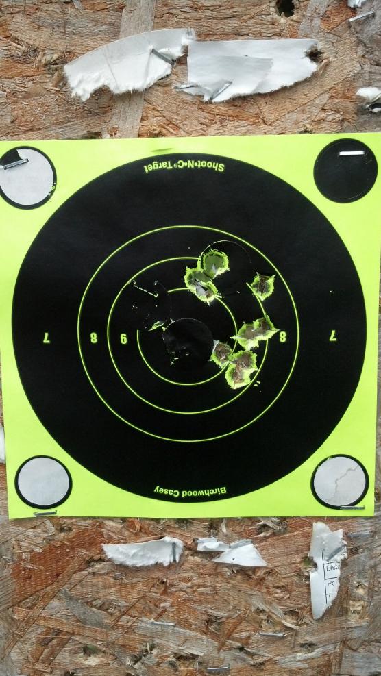

Not sure how well you'll be able to see the picture it looks good if you can zoom in on it. There were a bunch of people at the range today and I didn't want to cease fire to walk down and take a pic of the target. So what I got was a through the scope pic.
The first target was shot at the top right corner. This was to quickly rezero even though it was off by a bit when i stopped could have come down another tenth (last night I losened my caps and retightened them to get the gaps even on both sides). Then the bottom right target was shot with open threads. Then the bottom left target was shot with the thread protector. Then the top left target was shot with the suppressor. That hole is actually 4 shots through the suppressor and they all fell into a single hole. So whatever the shift is its very consistent.
Perhaps its time to do a ladder test rather than OCW for load development. Probably also time to redo the load development again with the muzzle brake in place.

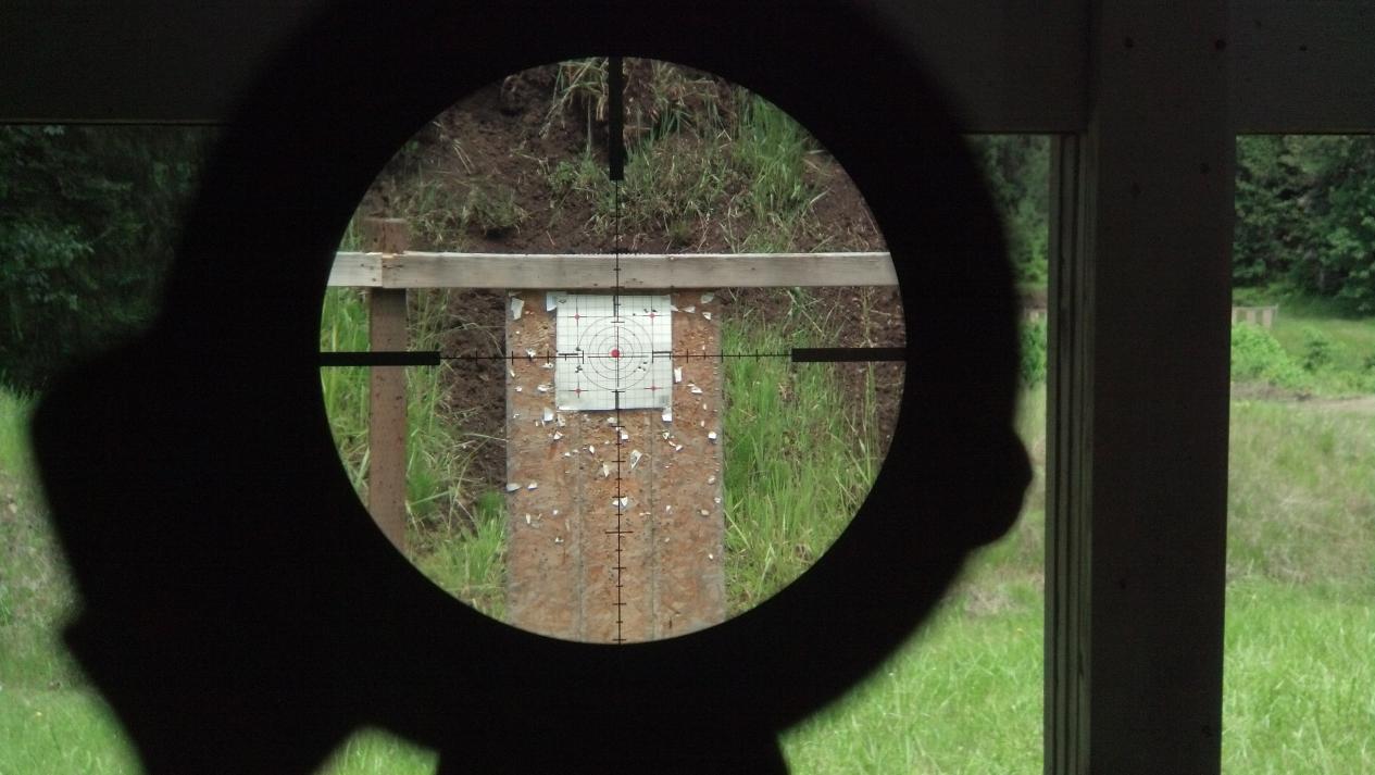

I did get a chance also to shoot a suppressed 10 shot group at 200y. Took a picture of the target but don't know the size references here so can't really get group size. Not my finest work but not terrible for 10 shots.
If you assume that those patch stickers are 1" stickers then using On-Target this measures out as a max spread center to center of 2.050 inches or 0.979 MOA. Thats not bad considering that it was shot somewhat quickly and I was fighting barrel mirage pretty bad at the end. Not to mention that its just a factory barreled LTR.
Lame. The forum seems to really shrink up and muck with the images as they're uploaded.

You can't mic that gap with you eyeballs..... you need a professional with the correct tools to check it out or you could damage your suppressor.
I used a feeler gauge and it was the same on the left and right side. Its different on the top and bottom however if you simply turn the gun over the side that is off changes sides which tells me that the difference is because of thread tolerance. The setup will put 5 rounds touching one another with the suppressor on at 200 yards if I do my part.
~Brett
~Brett
Exterior measurements dont mean anything if the threads are not concentric to the bore.
