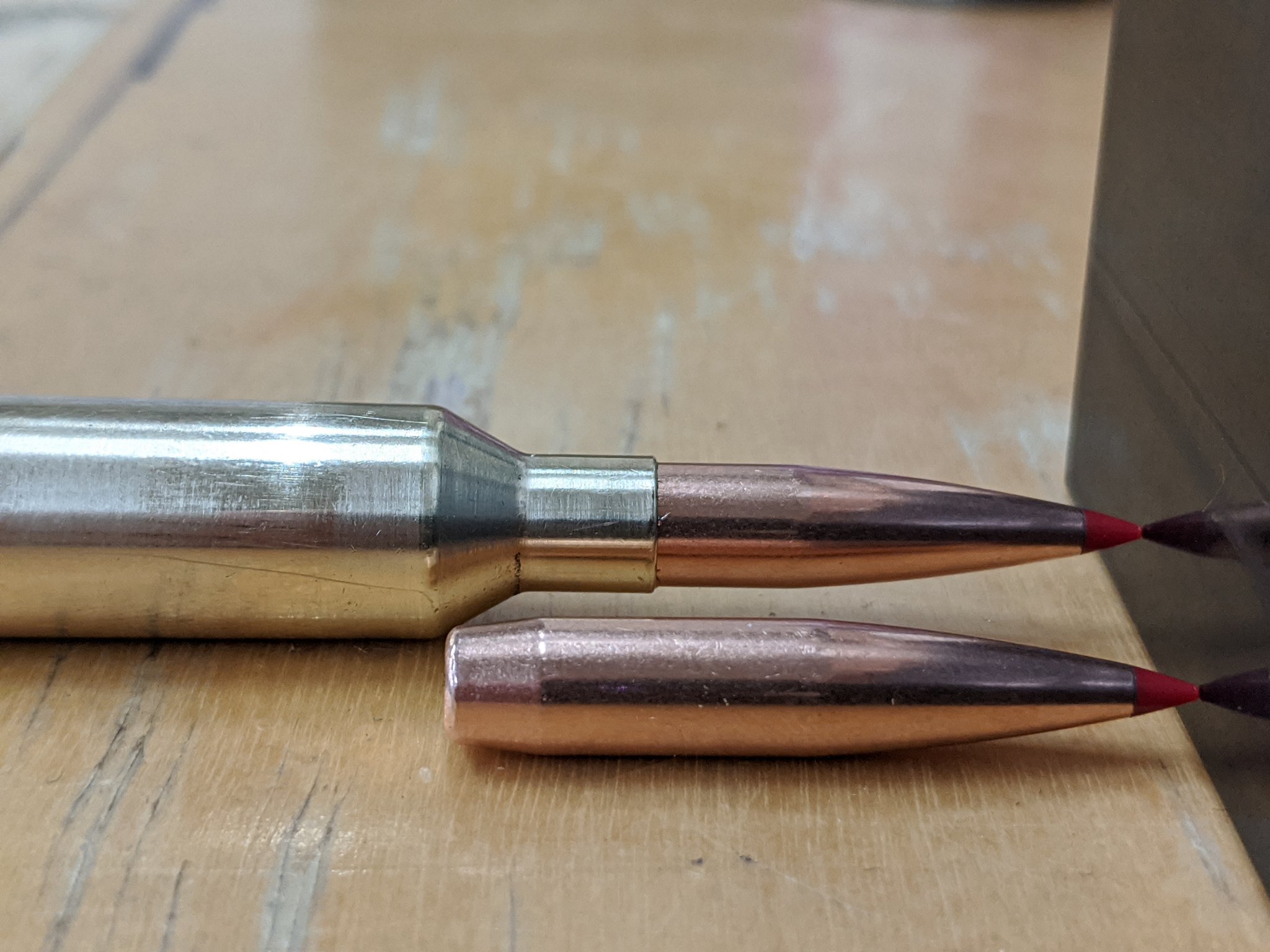

Working on a dummy round. I listened to the podcast.
This is 3.141 COAL.

Looks good
Not sure why your neck junction OAL is different than mine, double checked my measurements and they repeated.
Looks like your possible a bit further out.

I am just a tiny bit outside the neck junction, I'm not sure if I should seat them slightly more or not. Never done this before and the Smith is chambering off this dummy. So does he chamber it to this exact length so this load would be just kissing the lands? Or does he add some freebore? I'm a newb at how this is done.

Personally I’d put the base right at the junction and call for .02-.03 extra jump.
Reasons being your possibly gonna wear some throat quickly then it will settle in with steady growth( sometimes you just get steady growth) and secondly if you keep it tight if you have to switch to a Berger Hybrid 180 or 190 or A tip 190 it should absolutely work out fine without running out of neck.

Base of bearing surface just above the neck/shoulder junction.
