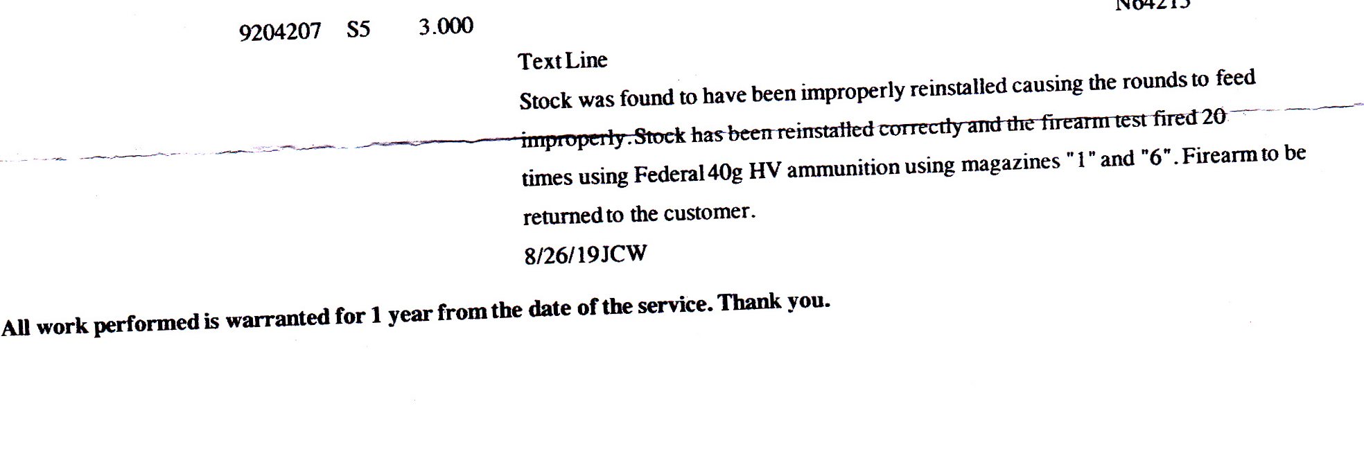

Got the T1x back and notes on the invoice said the stock was improperly installed. It was correctly installed and tested for 20 rounds. I will call next Tuesday and try to get more detail on the installation. Not sure if that is a torque problem with action screws or what.
Wow, what a waste of time. I wouldn’t expect anything else from Beretta Service though.

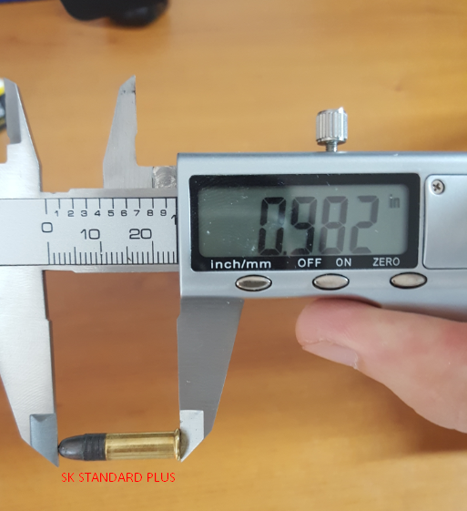

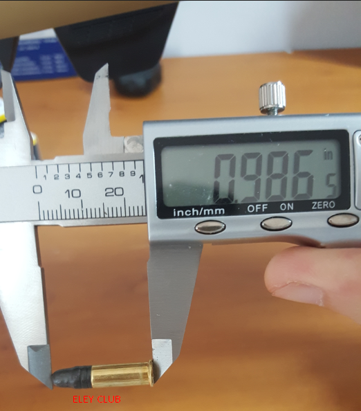

Hello my shooter friends. Excuse me for my bad English, I'm french .. @Just Chuck & @poke_53 I have the same problem as you, I have a GRS bifrost butt and I never try to shoot with the original stock. I tried several ammo, ELEY club, CCI SV, SK RM, SK standard plus. I noticed that I have problems only with the SK RM is SK standard plus. No problem with the CCI SV is ELEY club. I find that the SK are slightly shorter than the other ammunition and I am convinced that this is the cause of the problem. But I do not understand why other tikka t1x owners have no problem with SK ammo. I tried in 2 different chargers, I try to type the back of the chargers but no change, I usually have 1 cartridge out of 10 that gets stuck.There must be a cause for our problem ... Just Chuck the answer of beretta and completely stupid, too bad ... I will try to send you photos. Good day to you
Here's a copy of the exact statement.
Trying to think how or what was contacting the mags and maybe pushing them out of alignment. I don't know.
I'm putting it all back together now - rail, scope, cheek rest and will shoot it exactly as it was returned to see if the jamming is truly fixed.
@Alex266 you might want to consider taking a close look at any contact or interference of the mags in your set up. By the way - that is a really nice looking stock you have!

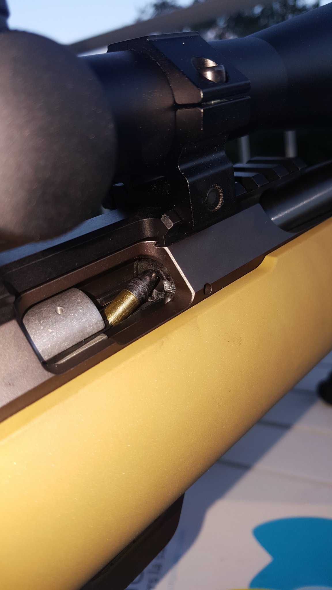

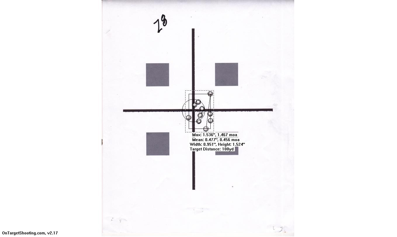

Got to the range this morning with Tikka T1X that was in repair and really no improvement on in feed jams. I had one jam for each of the six mags using SK Std + ammo. I did run two mags of Center X and had no jams with that ammo. I had a couple the felt like they were close to jamming, but no full out jams with Center X. So I'm back to square one.
Here's my 100yard target with the Center X. Not great - but good, IMO.
I had the FTE issue that was "repaired" by Beretta service, but not so much. I bent the spring myself and that seems to have cured the issue. Too bad, as I was considering a T3 for longer range, but since such a small service issue wasn't really resolved, it will cost them
View attachment 7139582View attachment 7139583View attachment 7139584View attachment 7139585
without seeing the boltface and extractor, my guess is that the rim of the cartridge is having trouble getting into position to be fed into the chamber. my rifle had an extremely tight extractor pivot pin which would allow only limited extractor movement. it may also be a rough boltface, or a rough extractor. best course of action is sending the rifle to an authorized repair facility for repair. I'm not very happy with the quality of the tech sometimes, but I know when something is working right and when it isn't. I ended up repairing my rifle myself because Stoeger Canada is a clown act. hope things work out for you.

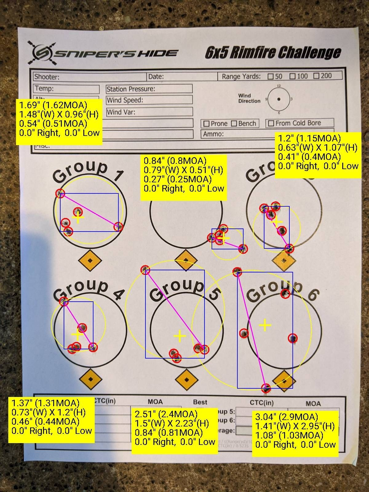

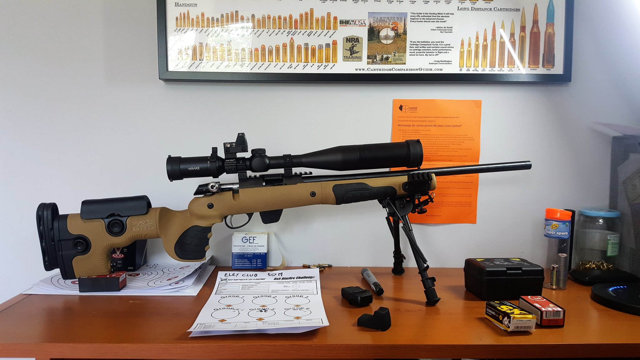

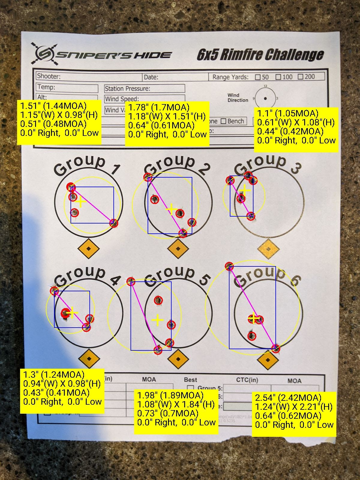

Not very good... shot a bunch at 25 yards to test out the zero. My Eley Target/Club/Match zero at the same POI, so that's good. Didn't notice anything crazy at 25 yards, but at 100, man it was not that great.
Started out with Eley Target, had 4 groups around 1-1.2 inches, which is what I'd expect. I think my lot of Target must be chrono'd really fast, because it's only about 1.9 mil up for 100 yards. Ballistics app state it should be around 2.2. Tested this for 30 or so rounds just to make sure, and it was pretty clear.
Next up, went out to Eley Club. First two rounds through, had basically the same impact as my Eley Target. Interesting. Next 8 rounds, all grouped about 1 inch low. I went to the 25 yard line to see the zero, and it was the same zero, so that's good. Dialed up to 2.2mil and it's spot on. This is great... my Eley Club actually matches my Ballistics app, at the 1085 fps.
Went and did a 6x5, and it was just really odd. Occasionally get some really oddball flyers, it was really odd -- not sure the cause. When the flyers happened, the only thing that really stood out to me was I heard some sort of "spring" noise. Like a spring that reverberates. I didn't really scientific test it out enough to really make a good correlation but it was odd. Not sure what caused the random 2" flyers. It wasn't the trigger pull mechanic, it was just really weird. Would barrel harmonics sometimes just be off and shit happens? Maybe muzzle crown damage?
Next up, tested out the Eley Match Pistol. I'm happy that it had the same POI as my Eley Club, same 2.2 mil for 100 yards. The one thing to note is that the lube on the Eley Match is different than Eley Target/Club. Eley Target/Club the bullets are black, but Eley Match, even those this was the round nose, it had the same lube as my Tenex which the bullet looks silver. It feels a tiny bit dryer.
Eley Match also had the same FTE issues as Tenex, though not as bad. Out of the 50 rounds, I had 2 FTE.
So 50 rounds of Target, 0 FTE/FTF. 50 rounds of Club, 0 FTE/FTF, and then 50 rounds of Match Pistol, 2 FTE. I can't wait to put on the suppressor again, not sure why I get such weirdness when I shoot unsupressed...
