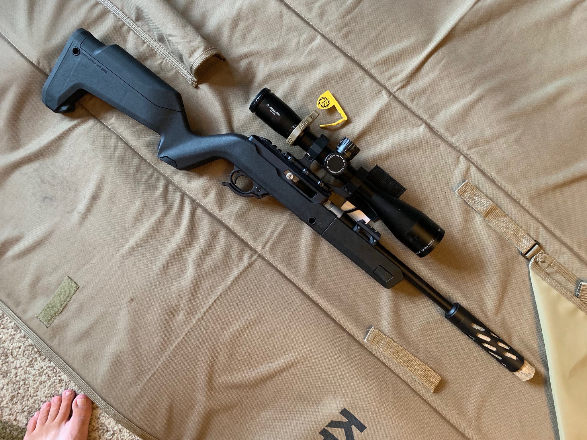

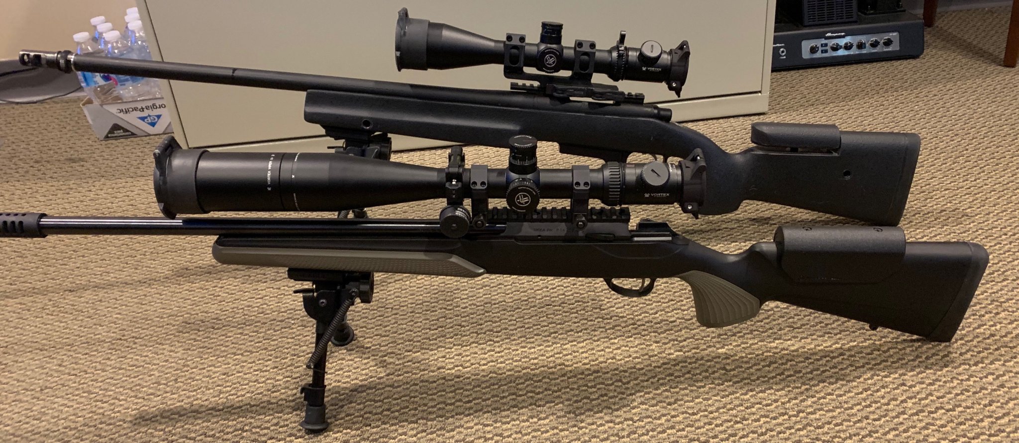

Pic of the Tikka T1X 22LR trainer with her bigger sister a Remington 700 Tactical in a Manners MCS-2A clone.
4" sunshade is already a bit much - we'll see the usefulness at the range. Vortex Viper PST 3-15x50 on the Remington, Vortex Viper PST G2 5-25x50 (with the sunshade) on the Tikka (my thinking is that 22 holes are harder to see at 250 yards). :)

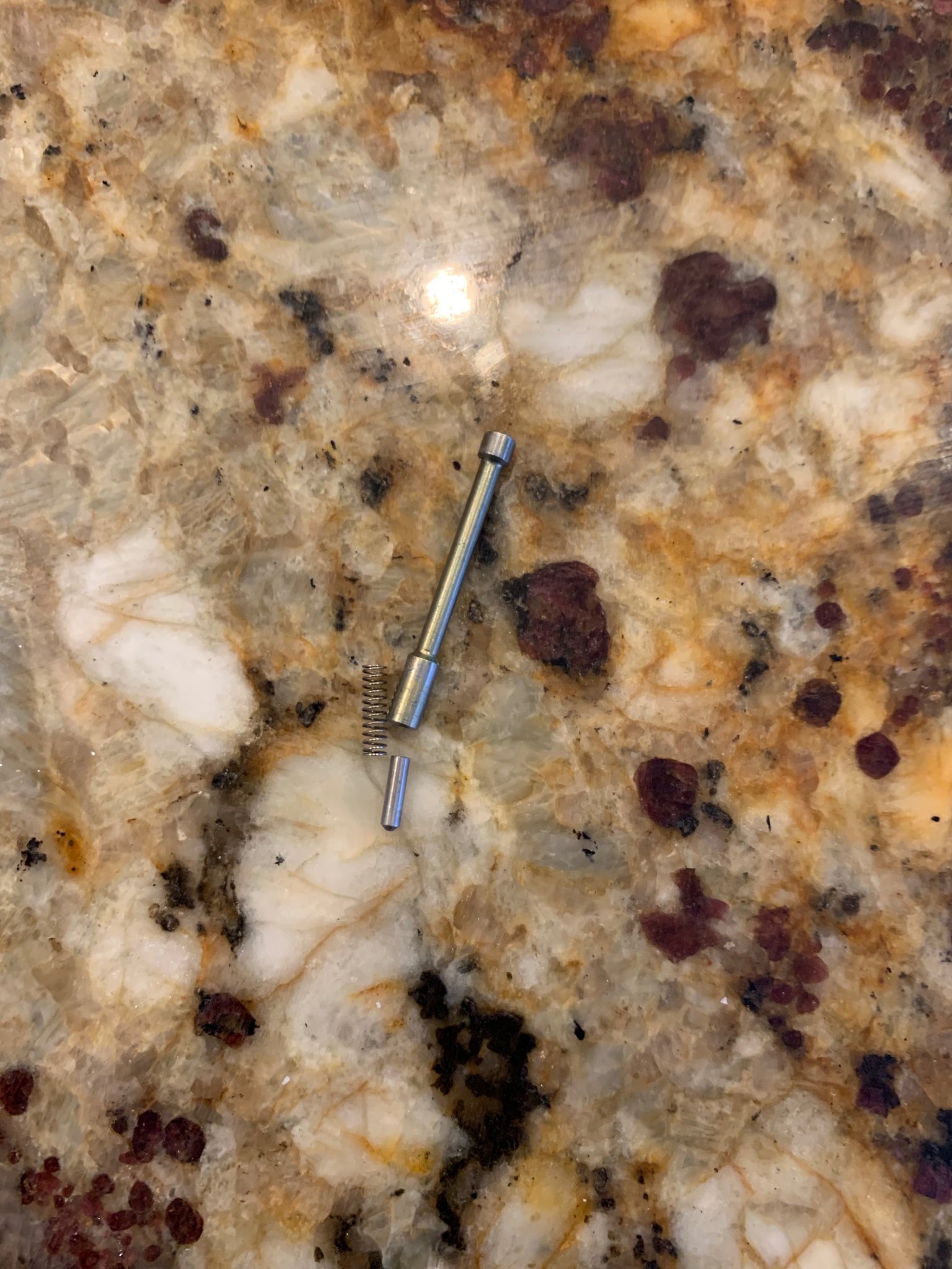

Well I'm focked. I was setting up my rifle and getting it ready for tomorrow and I did a dry fire and the firing pin broke. Half of it fell out of the magazine well when I ran the bolt. I haven't a clue where to get a firing pin for a Tikka T1x on this short of notice.
Anyone have any ideas?

Damn that SUCKS. This makes me nervous about an accidental dry fire. Your not the first person I've heard this happening to.
Yeah you’ll have to send that in for repair likely. I doubt they will send you just the firing pin
I wish you could just get the pin, I wouldn't mind having an extra
I just ordered the assembly. I don't think I'm going to waste my time w/ Tikka/Beretta over this.

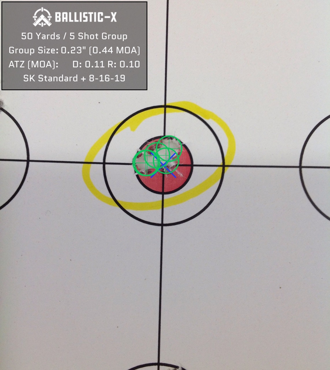

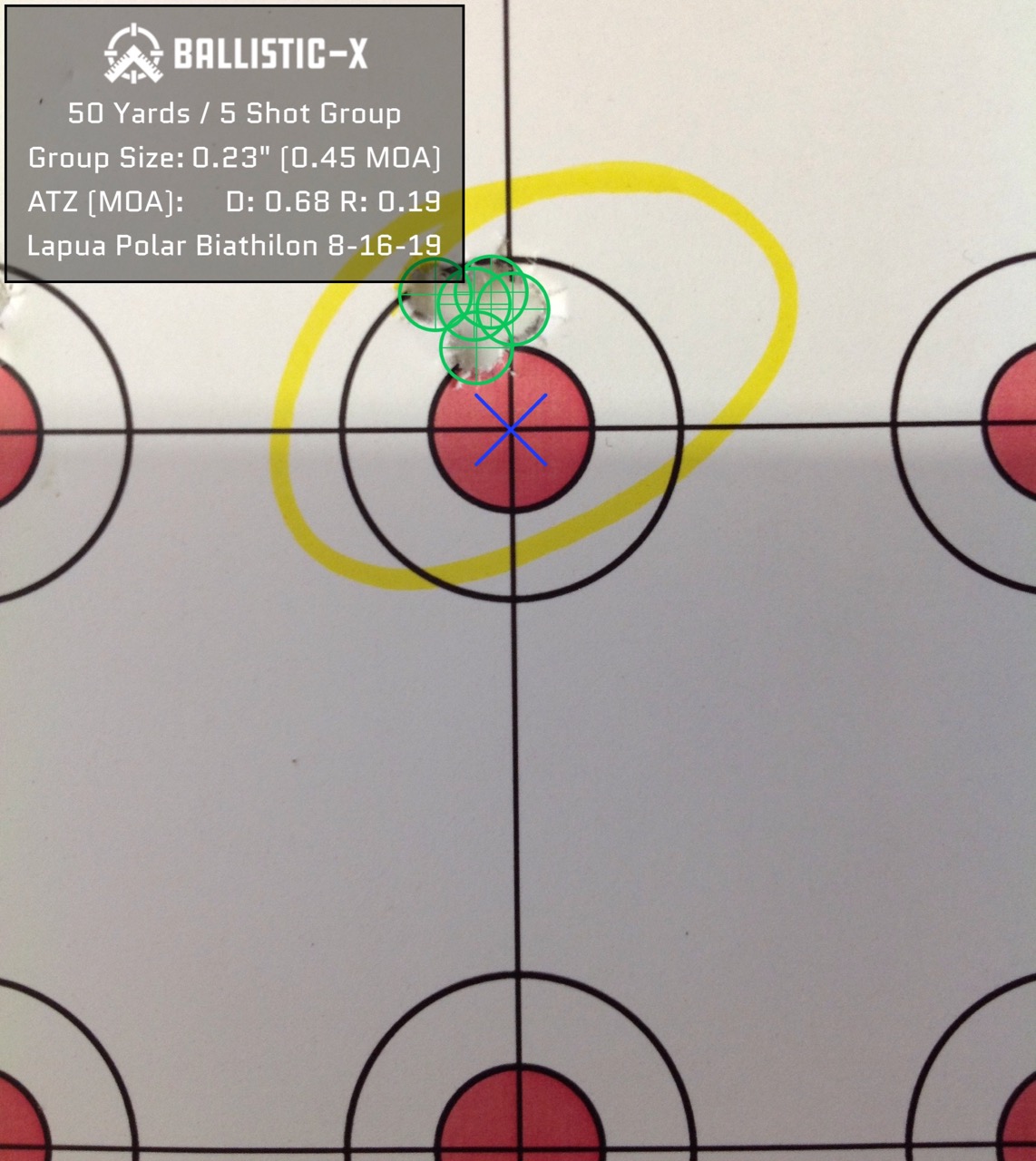

It was a little breezy, but I still had good results here and there. Keep in mind I am fairly new to this, and have a lot to improve upon in my techniques etc.
I shot the following:
Eley Contact
CCI SV
Fiocchi 320
SK Rifle
SK Pistol
SK Standard Plus
Lapua Center-X
Lapua Polar Biathilon
CCI SV Magic Lot
Here are the best cherry picked groups ...

Groups look good! I've heard great reports from polar biathlon, it's just on the expensive side.

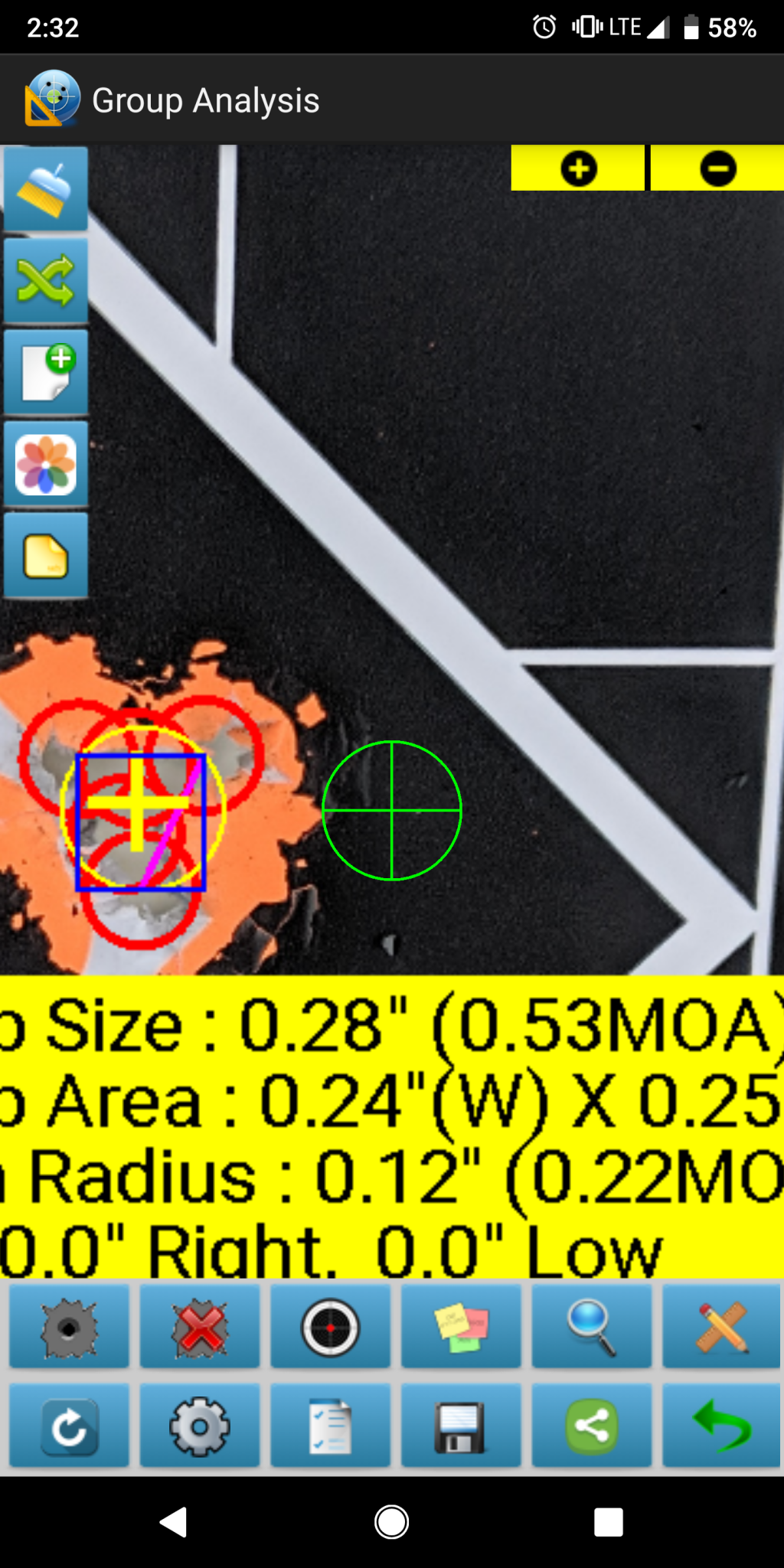

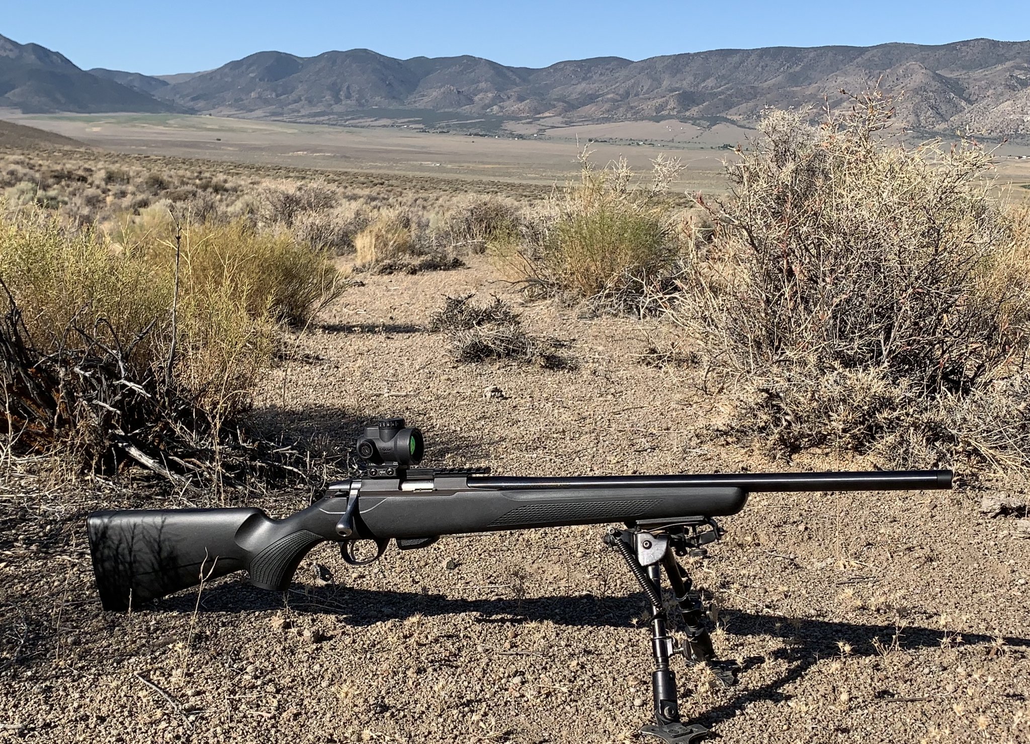

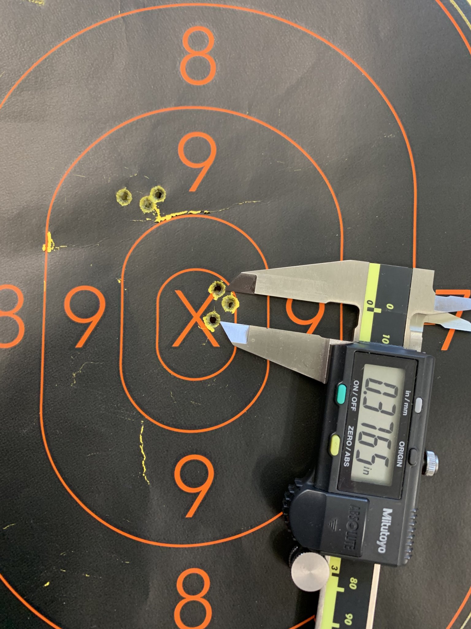

None of you will probably care about this but I finally got out to test the 17 HMR T1X. This is not a target rifle or a trainer. Just plinking and pest control.
Trijicon MRO on a DIP rail.
Fired these two groups for zeroing with federal TNT ammo The box said 2550fps, but these six shots averaged 2700 with 40 ES and 16 SD. Functions flawlessly, and I’m very happy with it.View attachment 7130656

My firing pin assembly came in Wednesday. Put it back together and took it to the range to test fire it and check out that SK Standard Plus. Rifle shoots fine. Does not like the free ammo. Bummer. Even the 10/22 shoots the CCI SV better than the SK.
And I decided to contact Tikka and try and hustle another firing pin out of them for backup. What a fucking obstacle course that is. Still haven't been able to email anyone. It appears I must call or something. What did the guys who've sent theirs in do?
