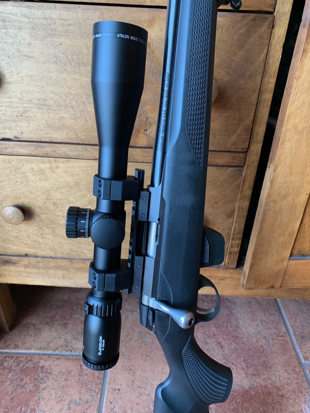

Anyone else's T1X has a gap between the bolt shroud and the receiver? ? Bolt is not cocked. Doesn't seem to be the case in T3X.

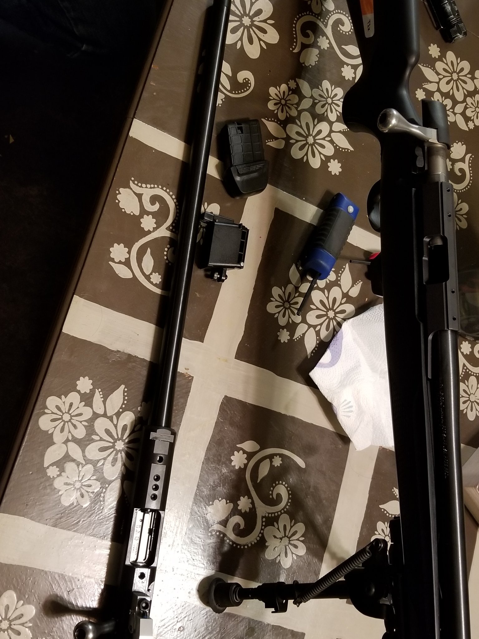

Couldn't help myself, went back and got a 22 lr T1x yesterday, so the store now has 3 22 lr T1x's left. Today I will take some measurements and call krg to discuss if I have enough room in one of their stocks to mill the magwell enough wider to fit the T1 magazine housing. Tonight , I may take off the factory barrel and start spinning up a new one....
This is my first tikka, probably not my last...
4. 'MERICA, cause I can should be reason enough
LOL, you are not even going to shoot it first and see how the factory barrel performs? :unsure::cautious:
1. The barrel in question is a more a "medium sporter" contour at approximately. 728" at the muzzle. I want to use this rifle for nrl22/PRS rimfire events and prefer more overall weight and a more muzzle heavy feel. It looks like the barrel is attached by 3 setscrews on bottom of action. Swapping barrels isn't a long term commitment...
2. I have several rimfire blanks and a takeoff annie supermatch 54 barrel that was still shooting good when a hart on it and more than one match 22 LR reamer in my toolbox, all paid for already....
3. I looked at my purchase as a donor action not a complete rifle , show me where a guy can find a full size rimfire action cheaper, a buddy looked at mine and went directly to the store and got the last one they had in 22 LR, he will probably keep his stock to play the same rimfire games....
While I prefer a good 2 stage trigger (and was originally budgeting for either a krg / Barnard / timney 2 stage) the factory trigger is super simple to adjust and I can definitely live with it

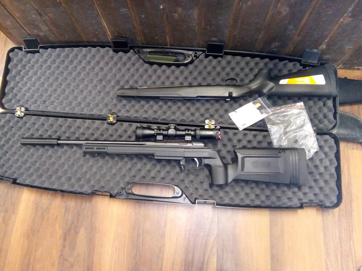

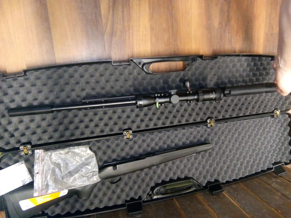

My good friend visited in my work.
We tryed how the 16" would look in the KRG Bravo chassis.
Quite goofy it is because it has so thin barrel, but in 22LR that barrel diameter has no efect in accuracy, but look and weight balance.
That AICS 22lr magazine for Tikka T1X and this will be a awesome rifle in the 22LR trainer section.

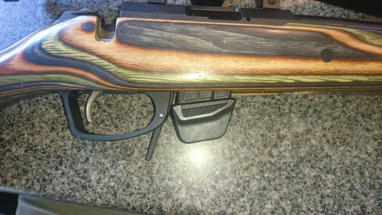

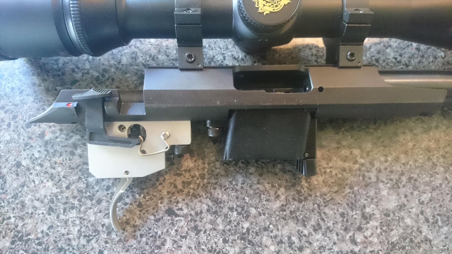

You know, some enterprising individual could probably come up with a plastic .22 LR magazine insert that fits an AICS magazine body (I think I have mentioned this before). Just like Accurate mag makes a .223 insert for a standard AICS, a .22LR magazine that fits the inside dimensions of an AICS mag shouldn't be that difficult. If I had one of these rifles, you can bet my mill would already be spinning...
I was intending to do this, but it isn't necessary as the magazine well and release is attached to the bottom of the action, so an AICS stock will fit straight on, the issue is the magazine hits the trigger guard before seating. The only work around would be to remove the magazine well and have a custom made AICS sized magazine that works in the T1x, not a simple endevour I'd imagine.
