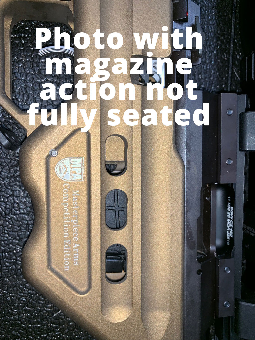

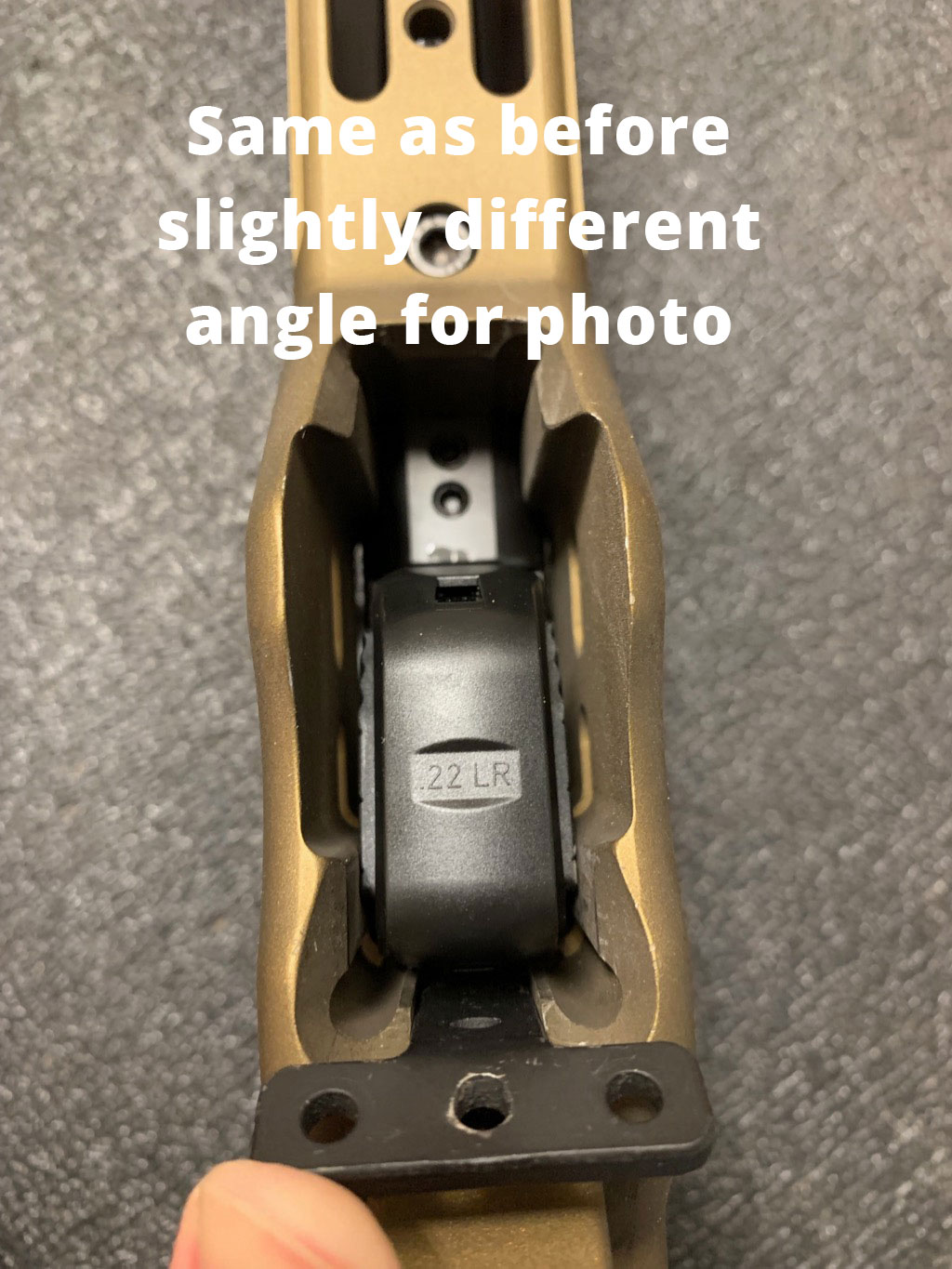

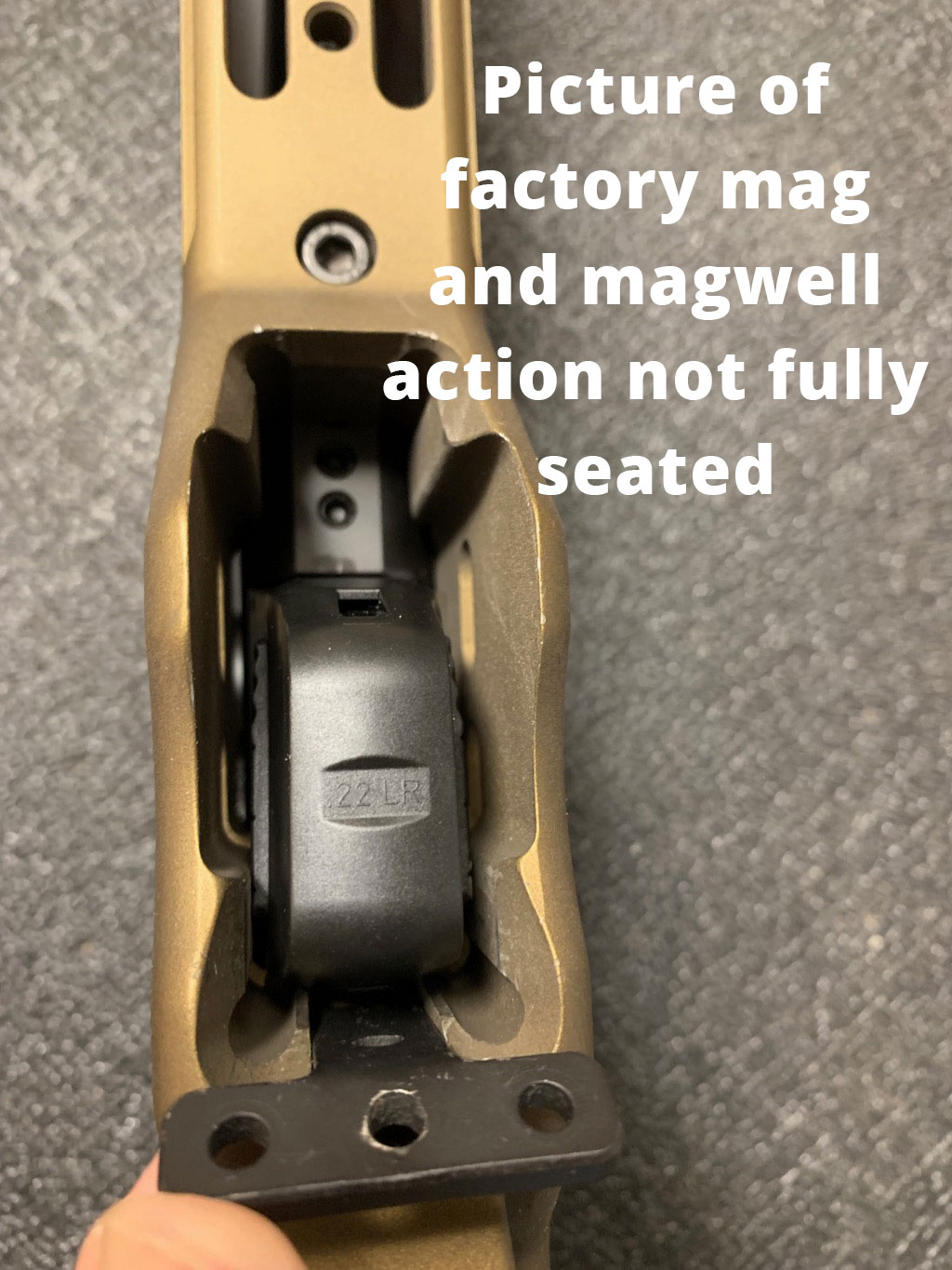

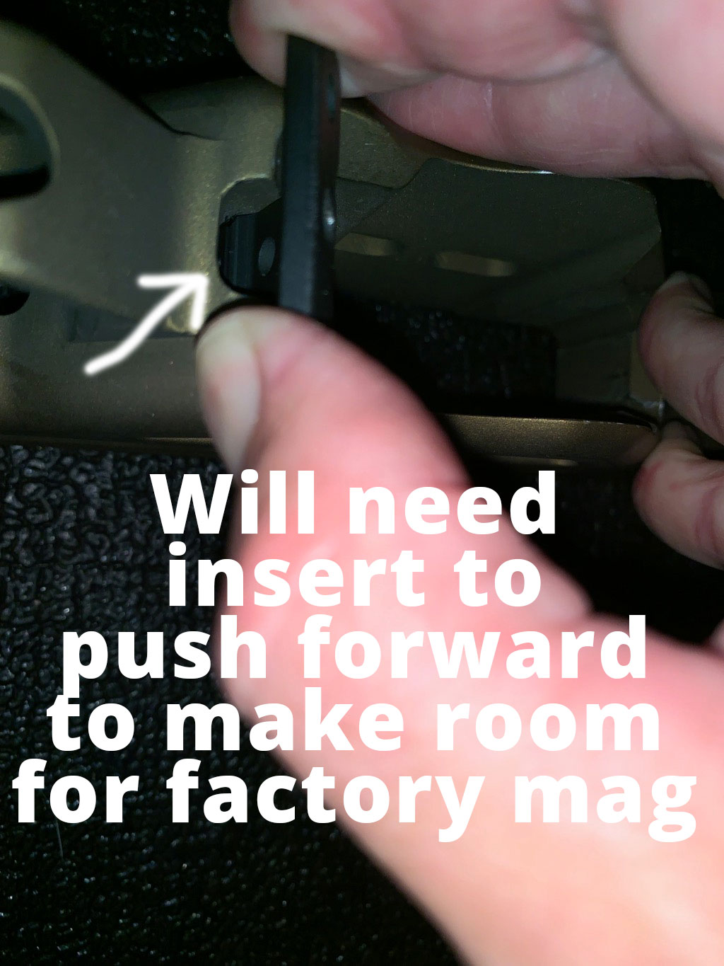

Update on the MPA (Masterpiece Arms) Competition Chassis. I tried to make notes on the images. It's definitely not a drop in fit. I'm trying to decide if I should try and get a machine shop to modify as needed or just use the chassis for a regular Tikka CTR. I'm not sure if MPA would be interested in having me send both in so they could fit it and also gather information so they could make a T1X friendly chassis. I would think they could modify it to work with both these and the CTRs.

I don’t think anything beyond what I show in the pictures will be needed. I’m kind of bummed about the clearance needed for the bolt release because that won’t look to good and I don’t want to have the expense of redoing the Cerakote for just a small area. It probably won’t be too noticeable.

if you cut on the backside just enough to allow the bolt release to work you won't really hurt the part you look at.
https://www.homedepot.com/p/Dremel-...eramics-Plastics-and-Hard-Wood-9901/202263215
Thanks, yes I think the bolt release portion would be pretty easy to do myself. The internal cut would probably be pretty difficult to keep clean doing freehand as a fair amount of material needs to be removed. I'm going to try and take it by a machine shop and see what they would charge for me to do it.

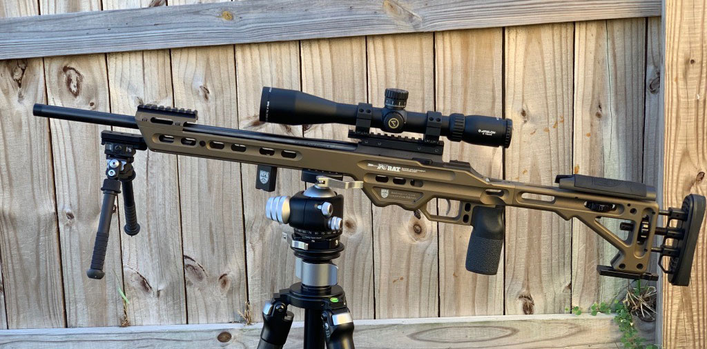

I looked at things again today regarding the chassis. Although I am working specifically with the MPA Chassis these will be things for anyone considering using a chassis to take into consideration, especially the magazine well and magazine clearance. It appears that it will just work in this chassis if the AICS magazine release is retained in it's forward position (or removed). The last picture shows what the gun will look like fully mounted. I forgot to put the bolt back in so it's missing in the picture. The magazine well had to be removed to mount it for the photo.

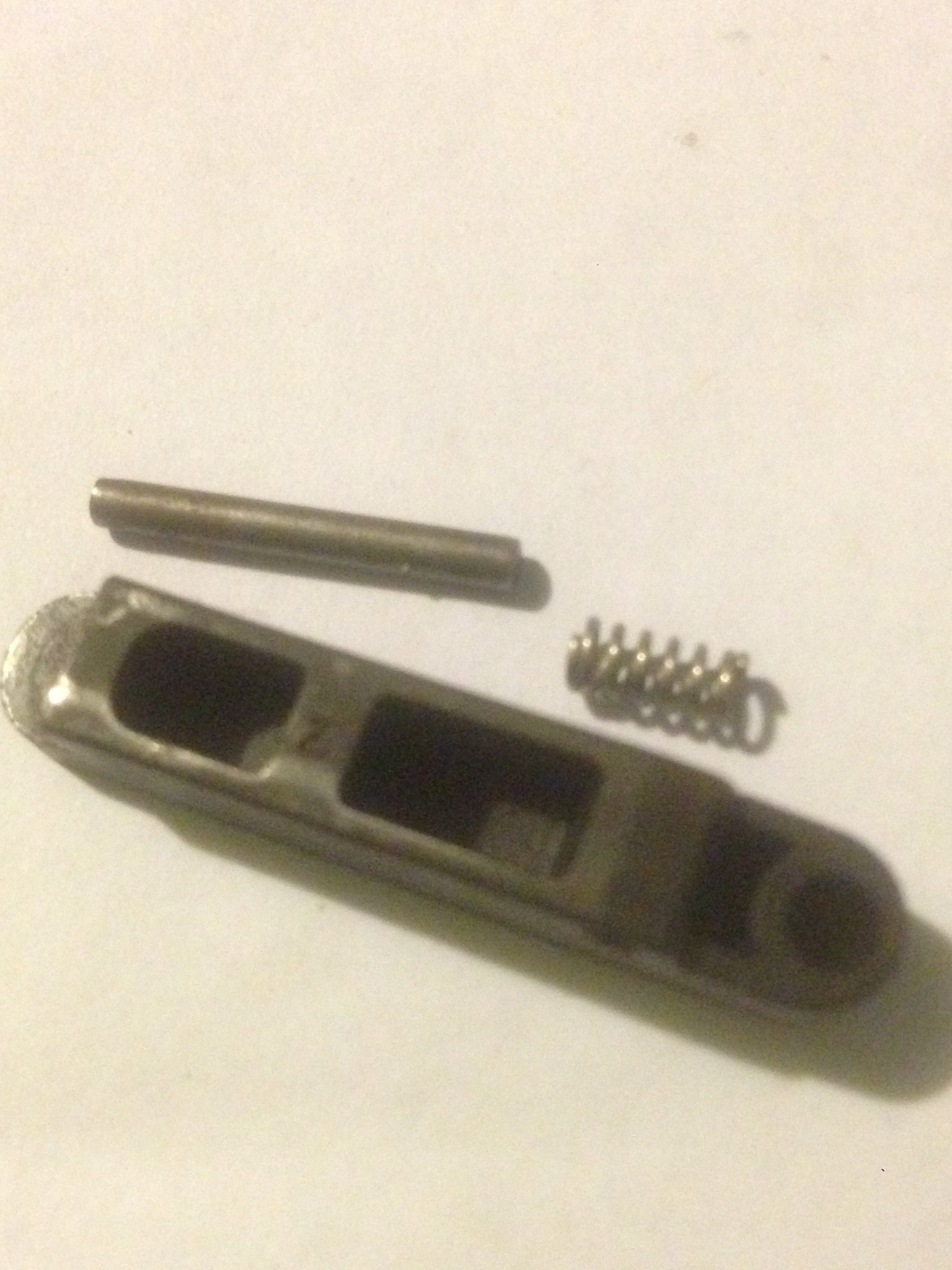

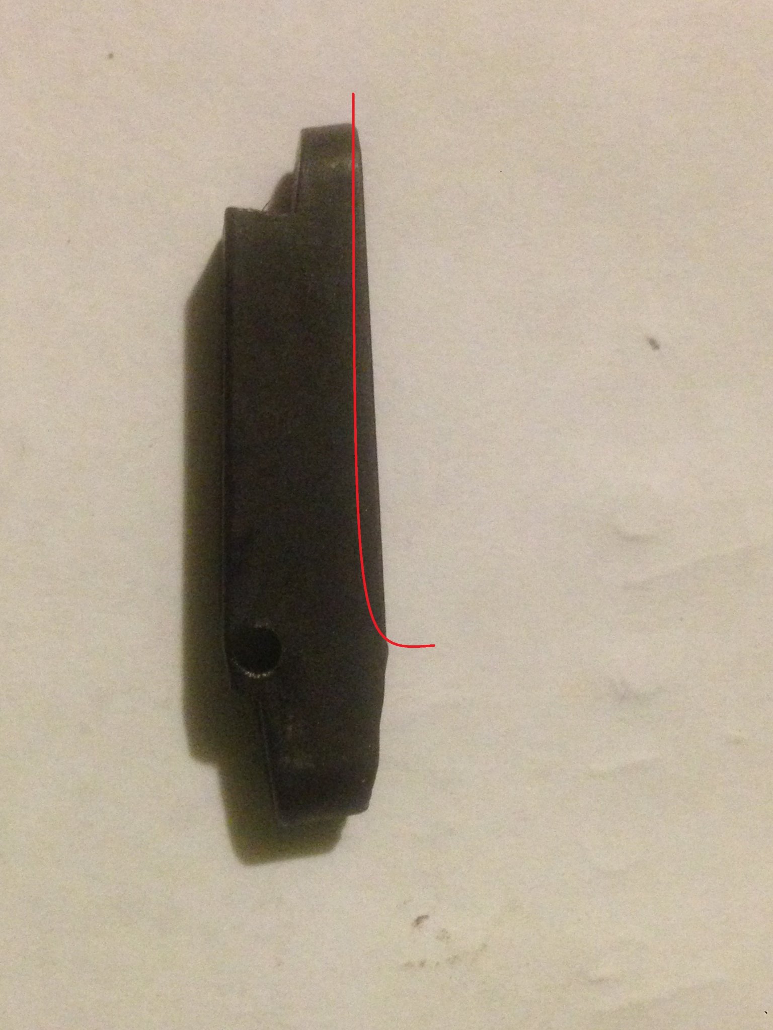

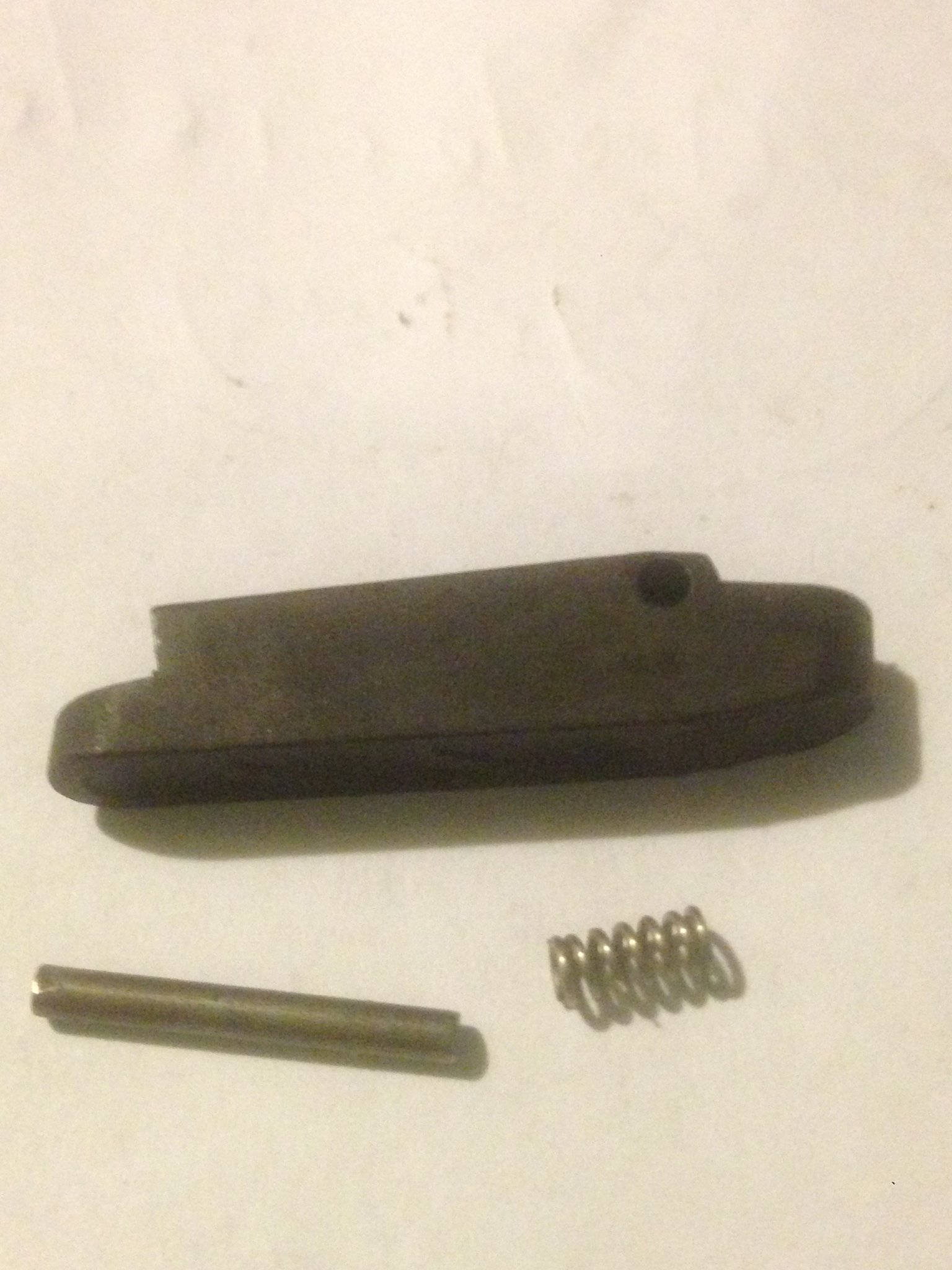

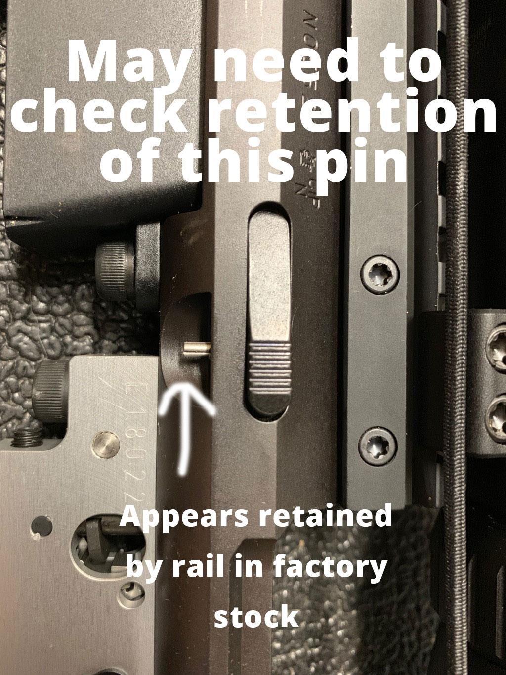

After having a look at the bolt stop, does it seem possible to remove material from the stop itself to avoid removing the finish from your chassis?
Obviously it would weaken the stop to a degree and it could also be hollow like the cf tikkas. A cf tikka bolt stop pin is normally only held in by bolt stop spring pressure when the action is out of the stock and can be pulled out pretty easily.
These are horrible photos of a cf bolt stop, hopefully the t1X is similar and this helps.

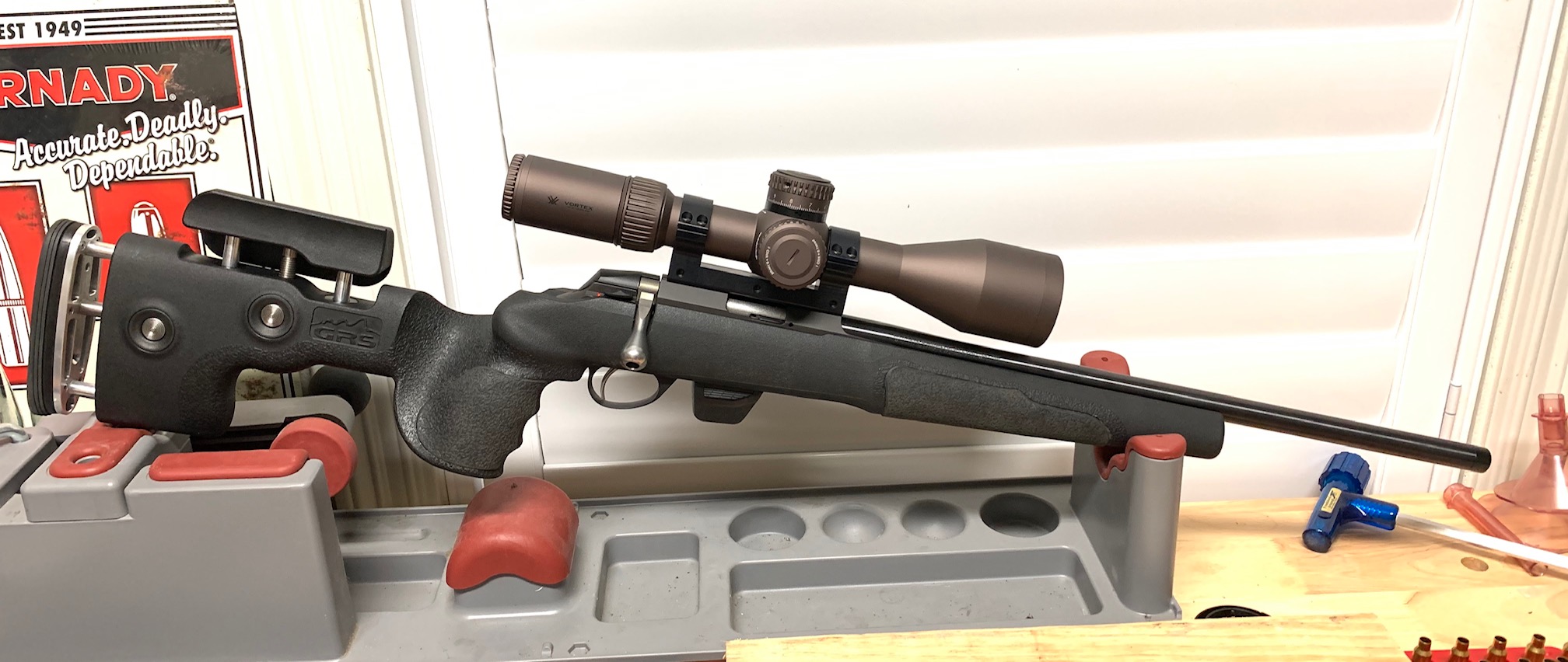

DNZ 2-pc mounts low, FDE pistol grip, Limbsaver pad , Vortex Razor HD LH 3-15x42, TBAC L-1. Adjusted the stock trigger low as it would go. No need for a lighter spring. Hope it likes Hornady 17gr as I have a case. First range session today.

If you could possibly provide a link to the bases and rings you used to get the scope that low it would be much appreciated, thanks.

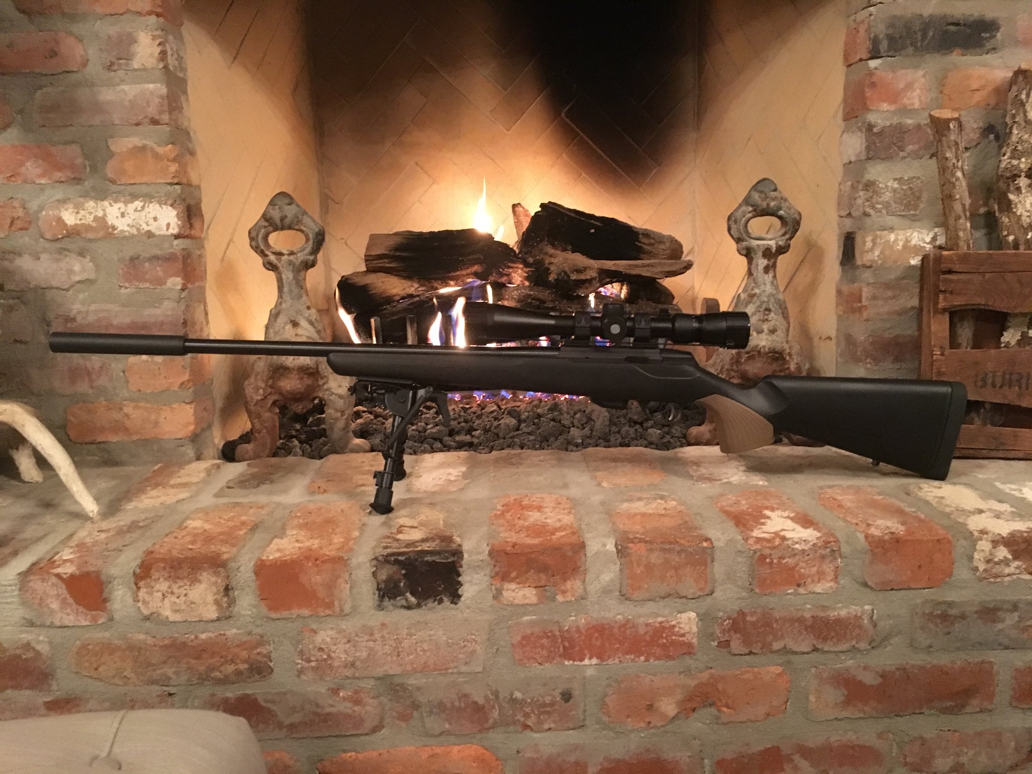

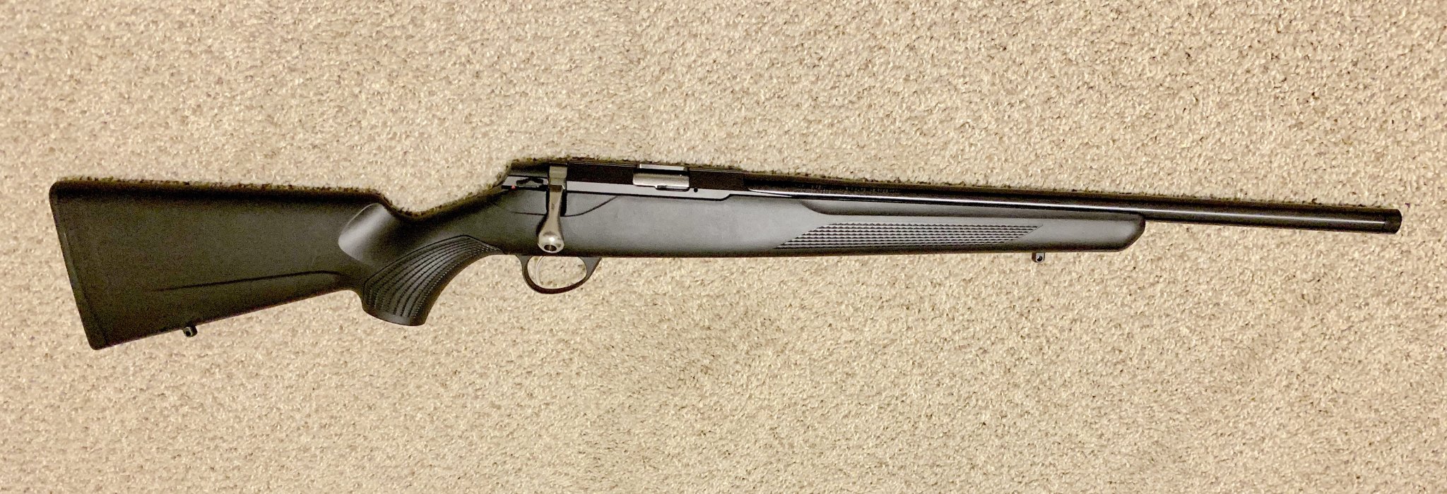

Look what showed up today. My T1X in .22lr that I ordered from a Scheels in Illinois. I was happy to find out they ship firearms to out of state FFLs.

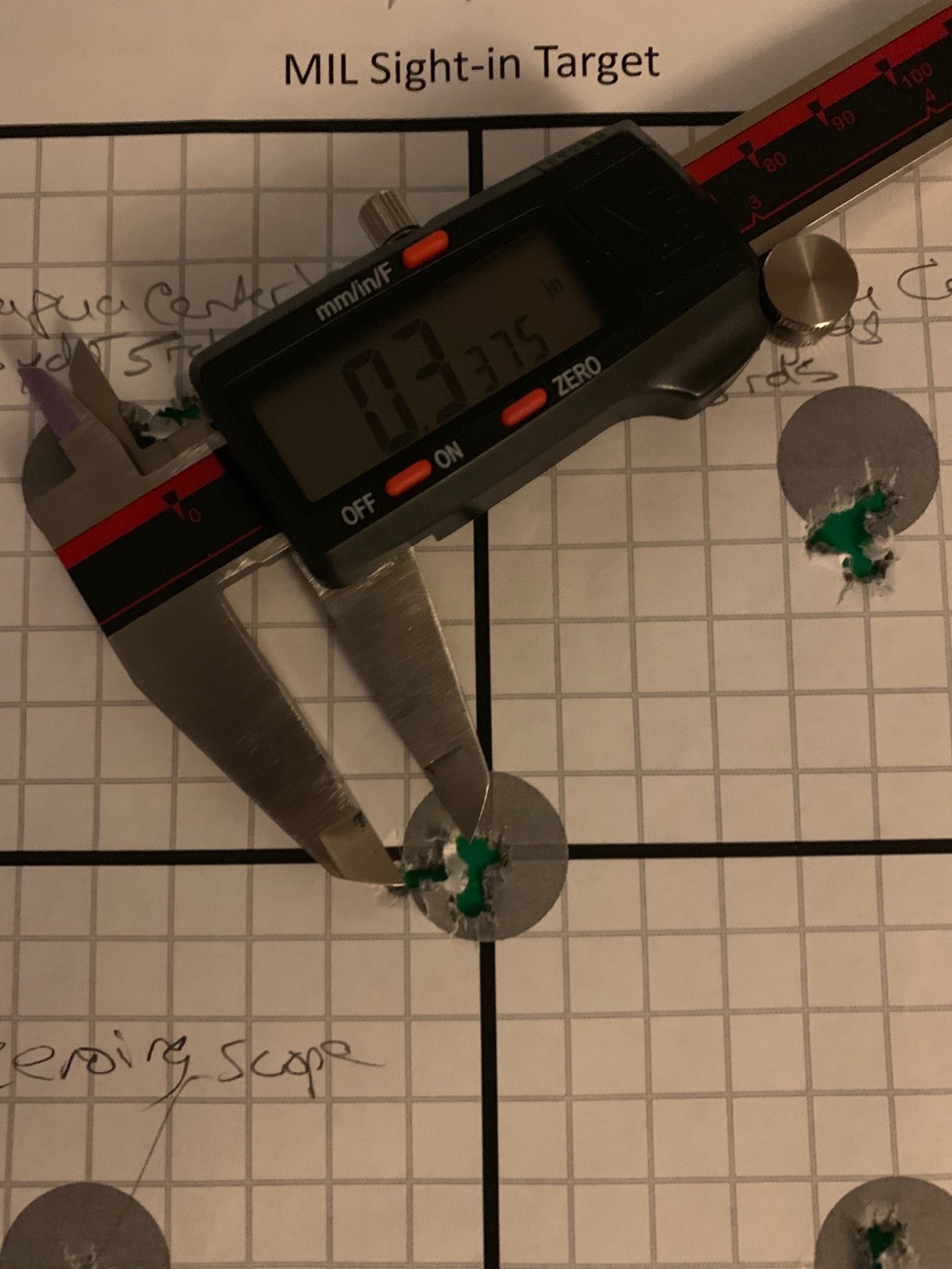

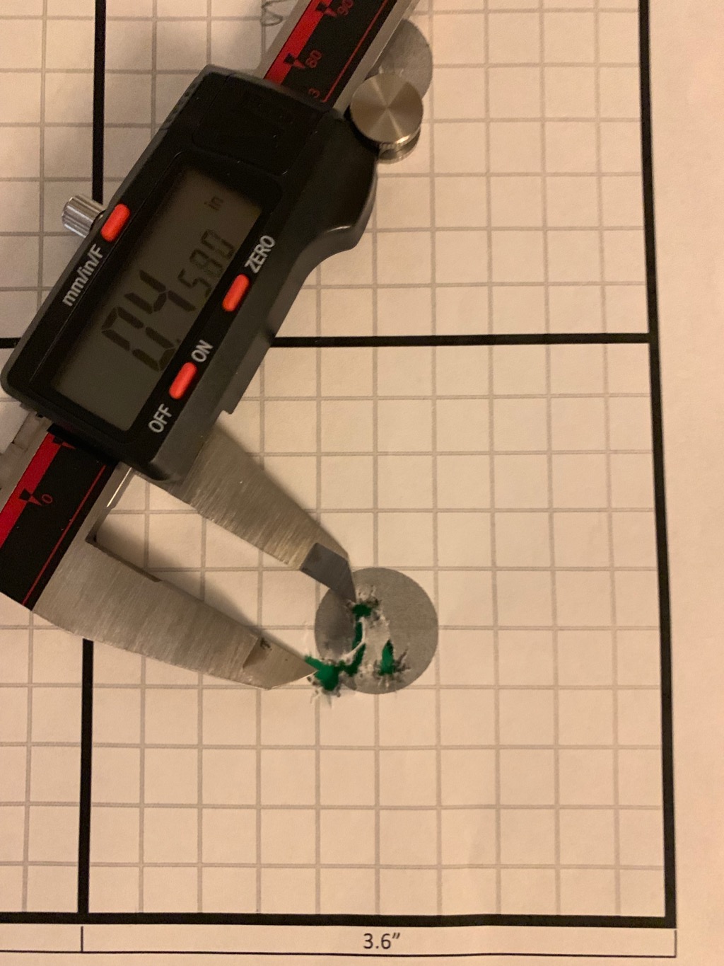

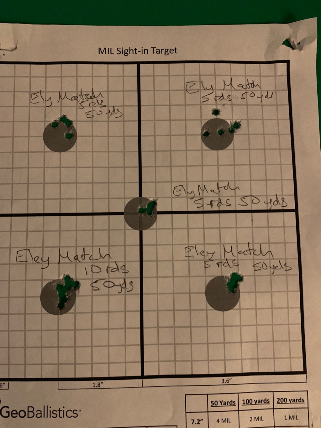

Someone had asked me to post some target on paper vs. the splatterburst targets I posted earlier. I got in some range time with the T1X 22lr again yesterday. Before heading to the range I checked the trigger pull as it shipped from the factory. Using my non-digital trigger pull gauge I measured around 4lbs as it comes from the factory. I adjusted it to a little under 2lbs. This is strictly a range gun for me so hunter might want to keep the pull weight higher than this.

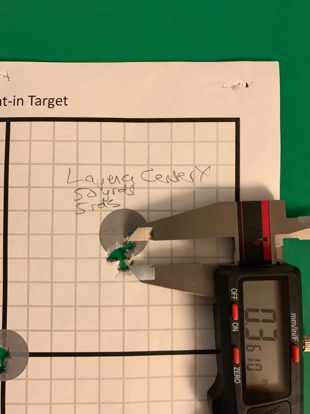

These groups are at 50 yards. I am sure the gun is more capable than I am. The Eley Match Ammo seemed to perform really well. The bottom left group is a 10 shot group, the others are 5 shot groups. There are also some groups with Lapua CenterX which seems to perform well also.
I'm looking forward to getting this in a heavier chassis. The gun is so light that it's hard to keep steady. I'm sure hunters will appreciate the light weight. I was shooting on a bench with an Atlas PRS Bipod and a rear bag. I'm using a Midas Tac 4-16.

For the mag catch latch have you looked at putting some kind of plastic spacer in to hold it in the "released" position? It looked like this might work for some chassis. See my first image in post #360 above. Not sure if this will work but might be worth a try.

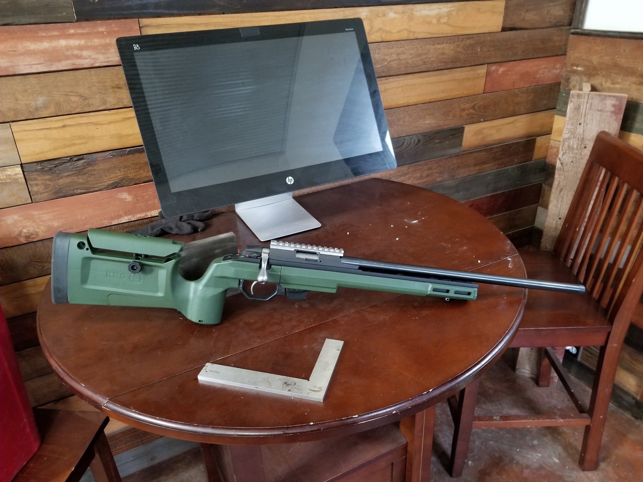

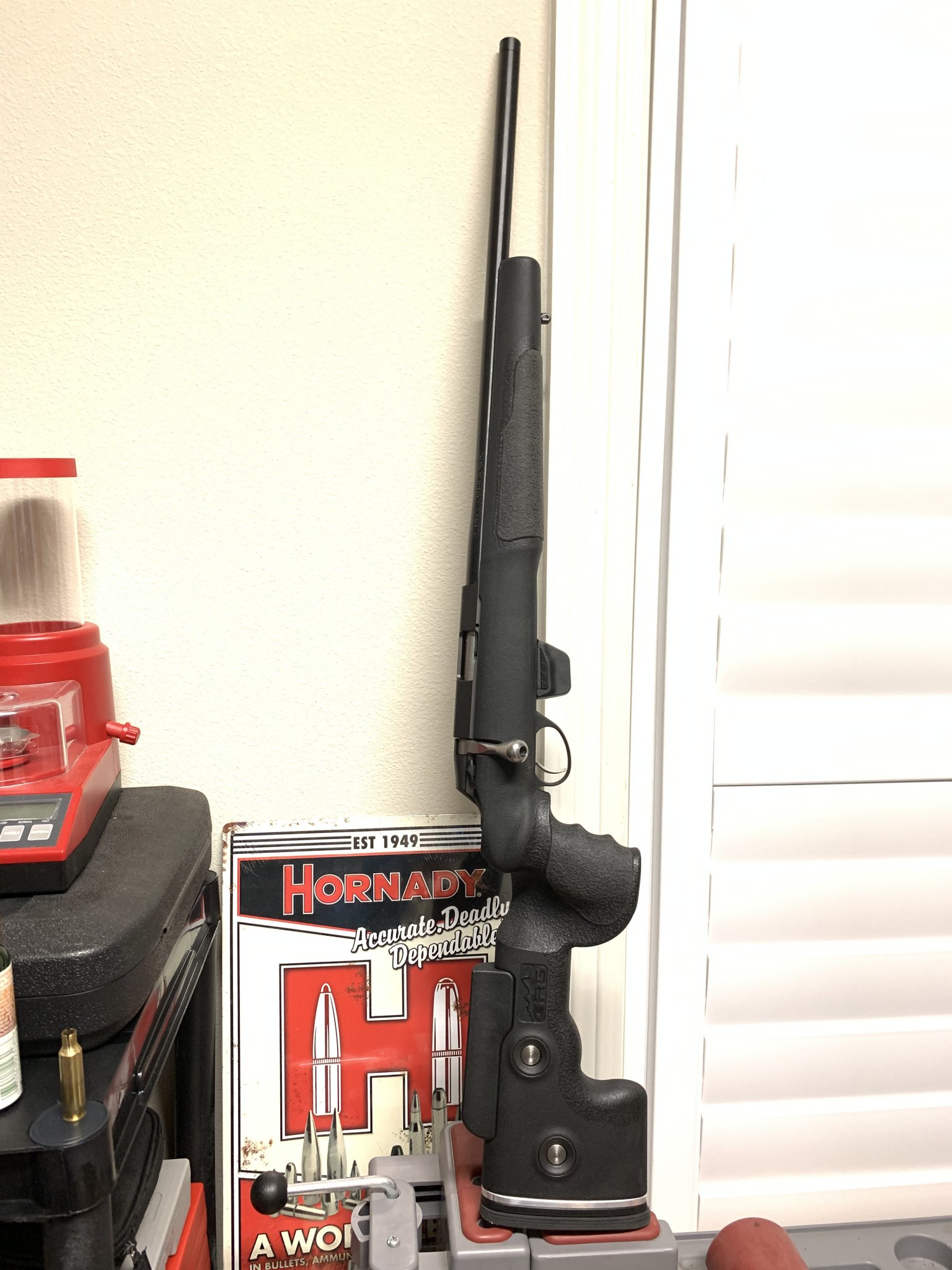

I have purchased a GRS Berzerk for it to address my main two concerns: Not enough weight in the rear, and a cheek rest that is too low.
That is sexy. I want one like that with a 16” barrel.
Any reason you didn’t go with the bifrost stock? I think it might be cheaper too.
Either way I am jealous as hell. Nice stick hope it shoots as good as it looks.
Thanks! I'm about to go mount the scope now. The Bifrost is about $80 more. But I got this one from the PX unused and saved about $125. If I was buying a new one, I would have gotten the tan Bifrost.
