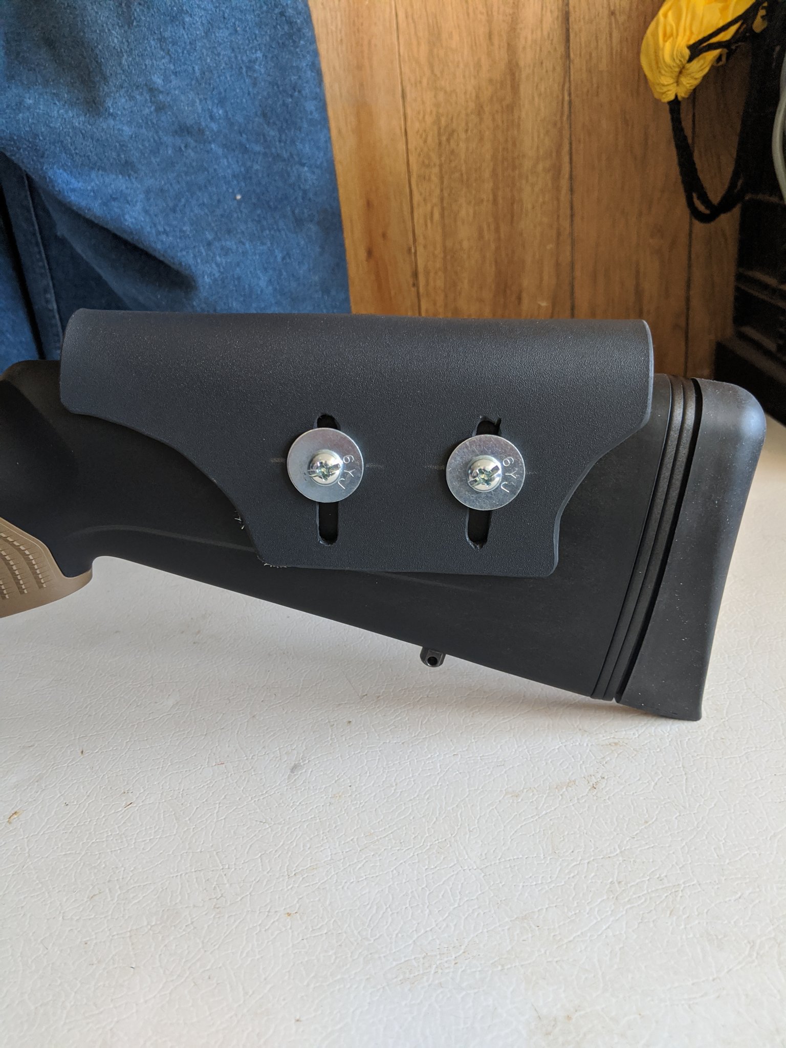

I need some sort of cheek riser to be able to just lay my head on the rifle and get a sight picture. Other thing that may have helped was having a slightly longer LOP. I'll probably get the T3 buttpad from Beretta. Debating if I should get the stock spacers from Beretta as well. Anyone order those? How thick are the spacers? Anyone that's used the beaver-tail fore-end have any issues fitting bipod with that or have it help in a match? May pick one of those up as well.

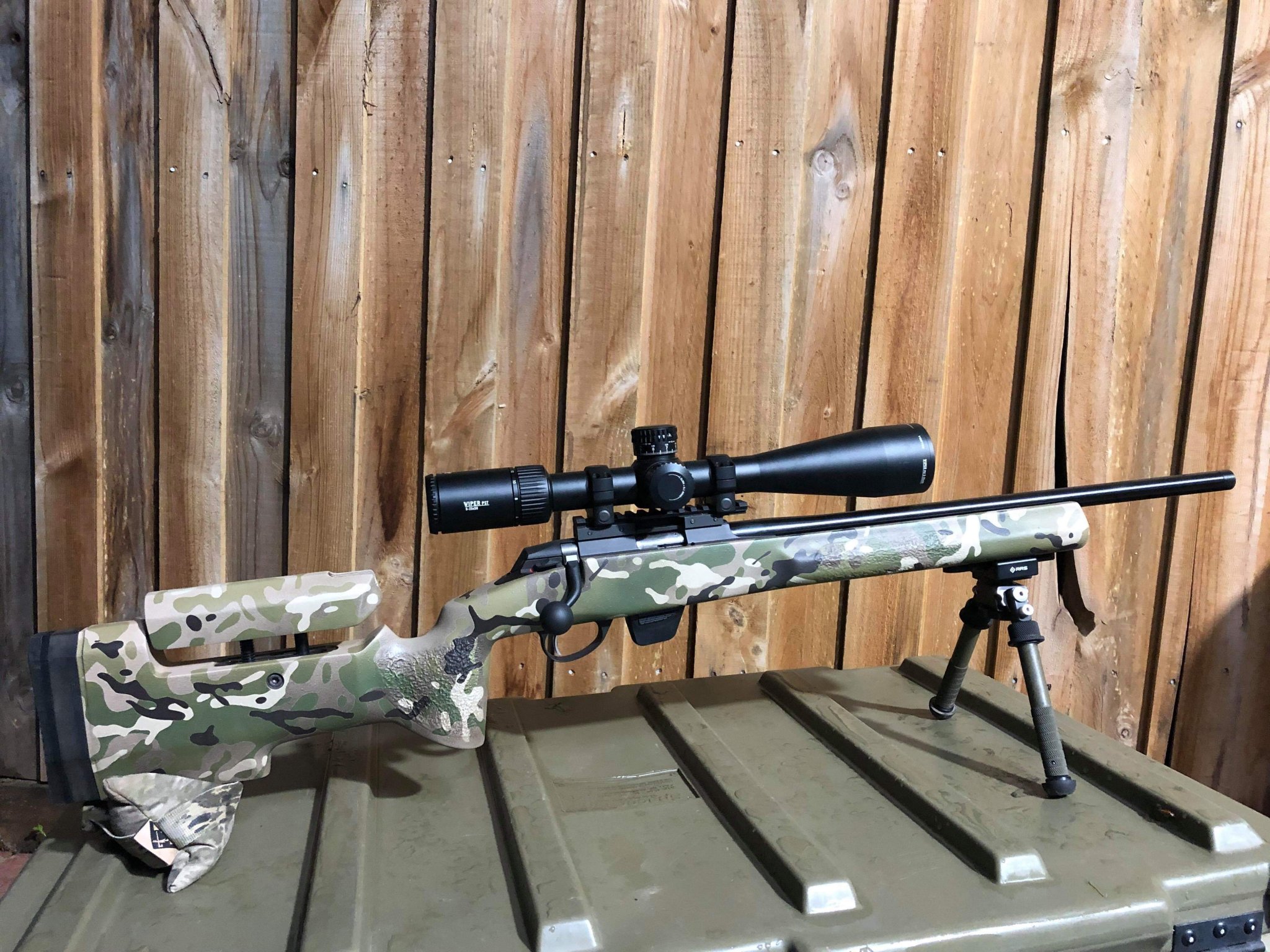

I added the straighter grip, the target forearm, the spacers and the rubber recoil pad to my base class T1x. Also removed the "barrel spacer block" to free-float the barrel.
The Caldwell Harris copy bipod fits the forearm just fine, probably a bit better than the original width forearm. The buttstock spacers add about 1/4" each and the rubber buttpad is 1" thick. Removing the stock buttplate and replacing it with these pieces added about 1" to the LOP. Now it's about 14 1/4" LOP, which fits me pretty good.
It's a little tricky to install the spacers because they don't "lock in" to either the stock or the buttpad so everything is just "smashed together" as can be seen in the picture. It works, but it could definitely be improved.
I concocted the comb riser from a sheet of kydex and backed it with duct table to keep it from slipping. I simply drilled through the stock to mount it. Not fancy, but good enough for my uses.
Is there enough space for a little velcro to help secure the cheek riser? Together with the bolts it seems like that would hold up to tactical use.

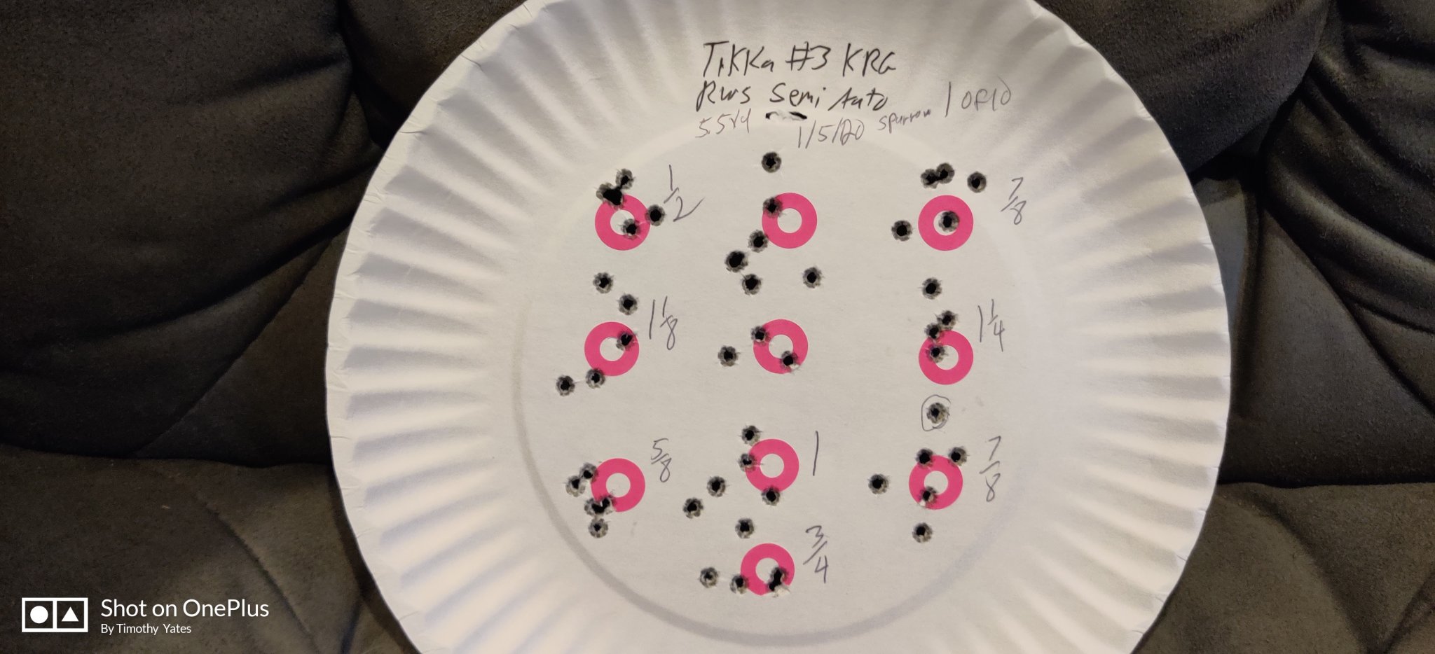

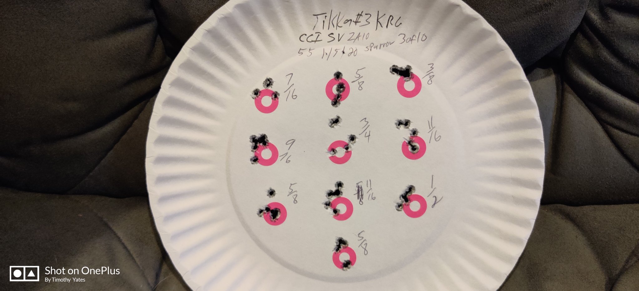

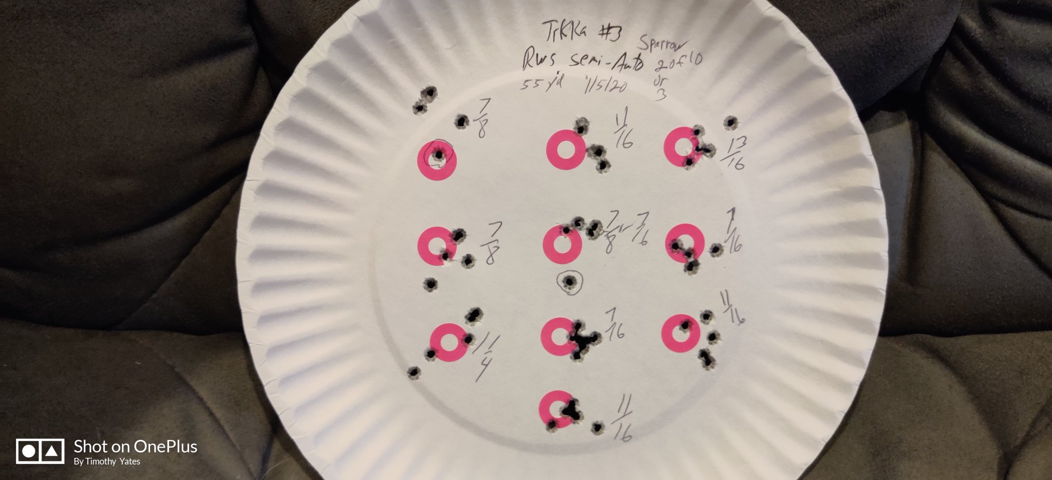

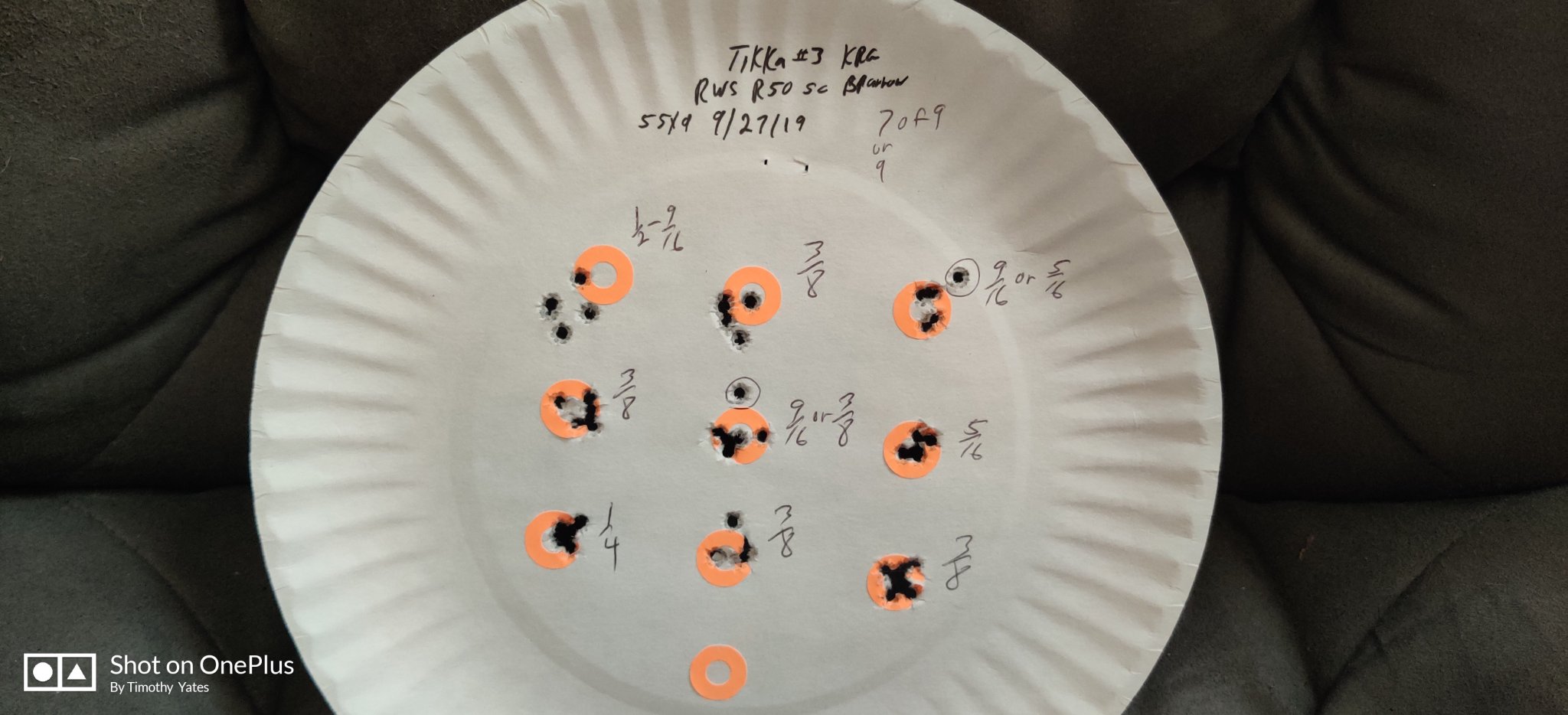

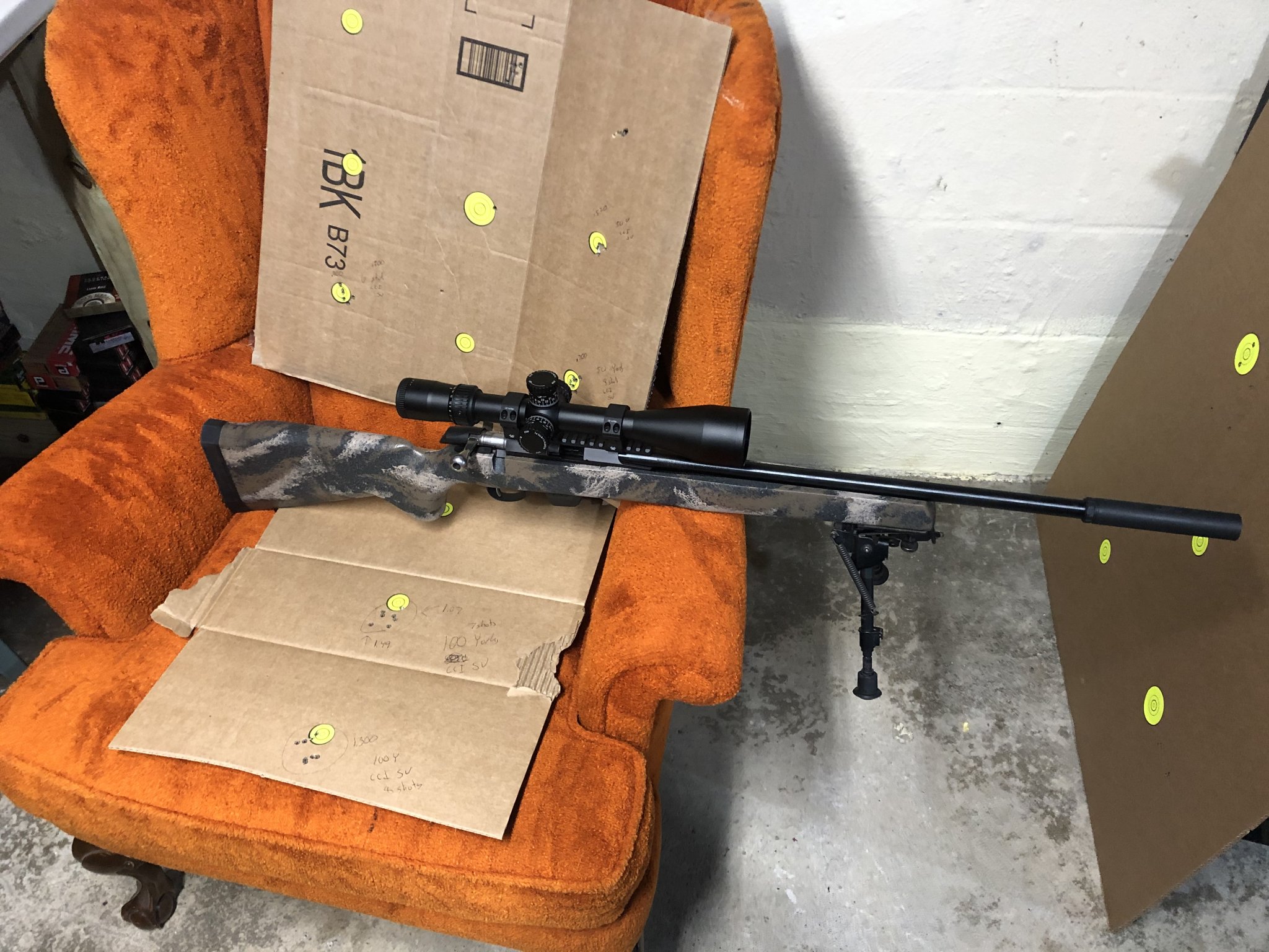

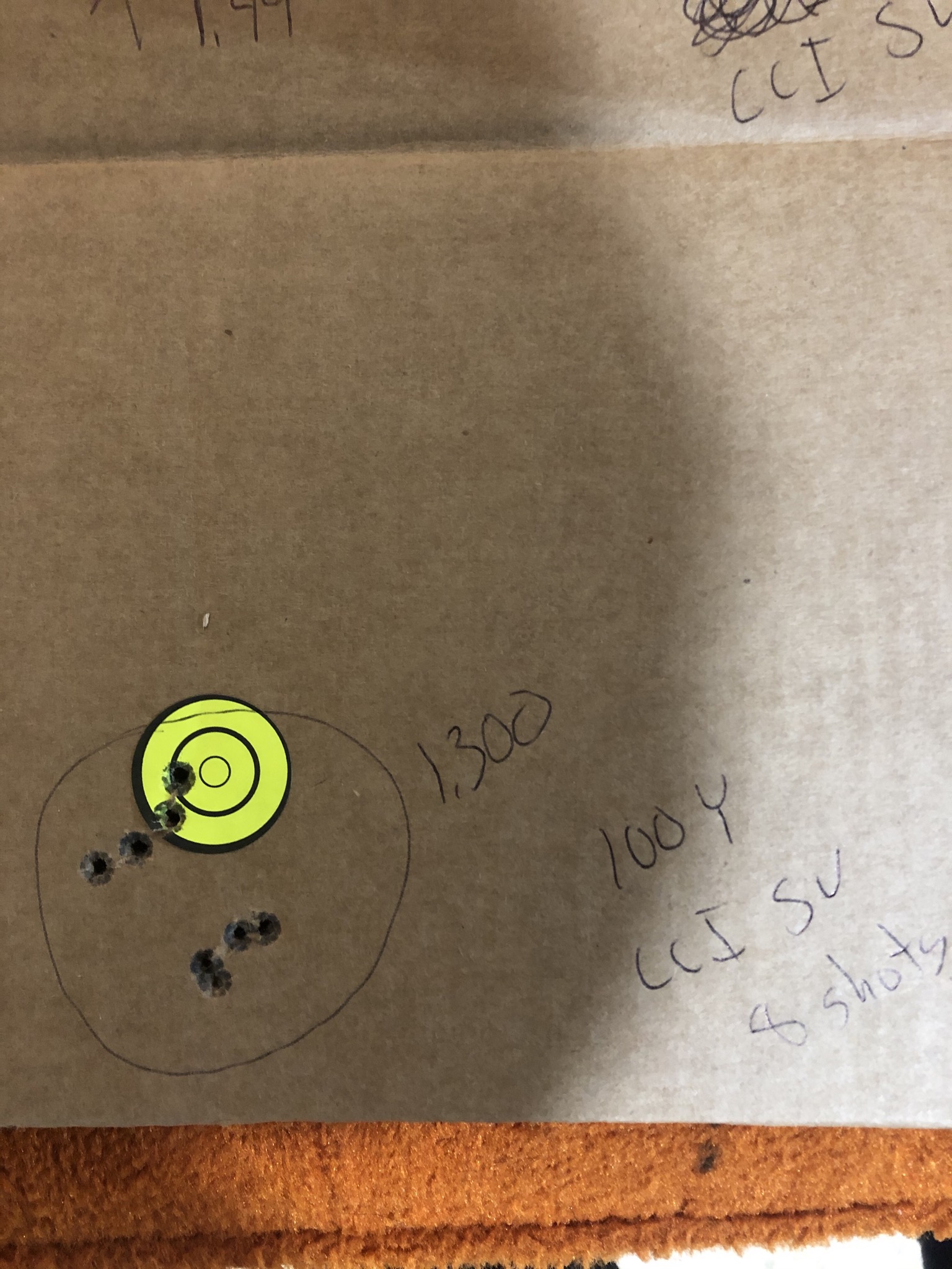

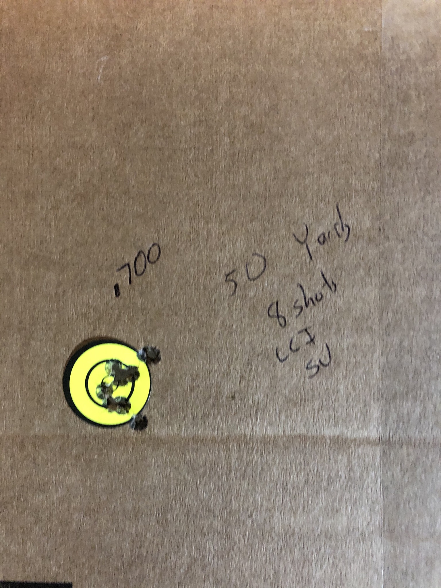

Here is the comparison for my Tikka #3 in the factory stock VS the KRG Bravo. Spoiler alert, I don't think it made a significant improvement in accuracy for me. What it did do was help me tailor the rifle to fit me better and if looks matter, to me it looks better. Honestly if I wasn't installing the IBI barrel I'm not sure I would have ever bought one. I needed it for the larger barrel channel. But, now, I'm glad I got it and was so pleased with the first one I did buy another for my T1x 17HMR.
I will post photos from today first then look for others. Just keep in mind these are results for my rifle and yours may be different. Look at the top of the plates for information. Factory stock will be on top.
Well that's ten photos but all I had for comparison anyway. Draw your own conclusion.
Tatman, can you quantify that? Not that I don't believe that there wasn't improvement, just how much was there.
That's a good idea. I'm sure there could be enough room there, the kydex is somewhat flexible and it could always be spread back out a little with some heat. I just used duct tape as backing material on the kydex to add a little bit of friction since it was what I had on hand. That seems to have done the trick well enough for NRL22 matches.

i tried a bunch of different ammo all at 50 yards and 5 shot groups and for me there was a difference in group size especially in the different ammo types. Granted there were some that it shot the same with either. I am sorry that I do not keep photo records on the Tikka T1X I only keep that info for my 2 Vudoo's. At the end of the day I would purchase the bravo all over again if I bought another T1X.
At the end of the day nothing really shot bad but when it comes to .22LR finding what your rifle likes is half the fun/battle

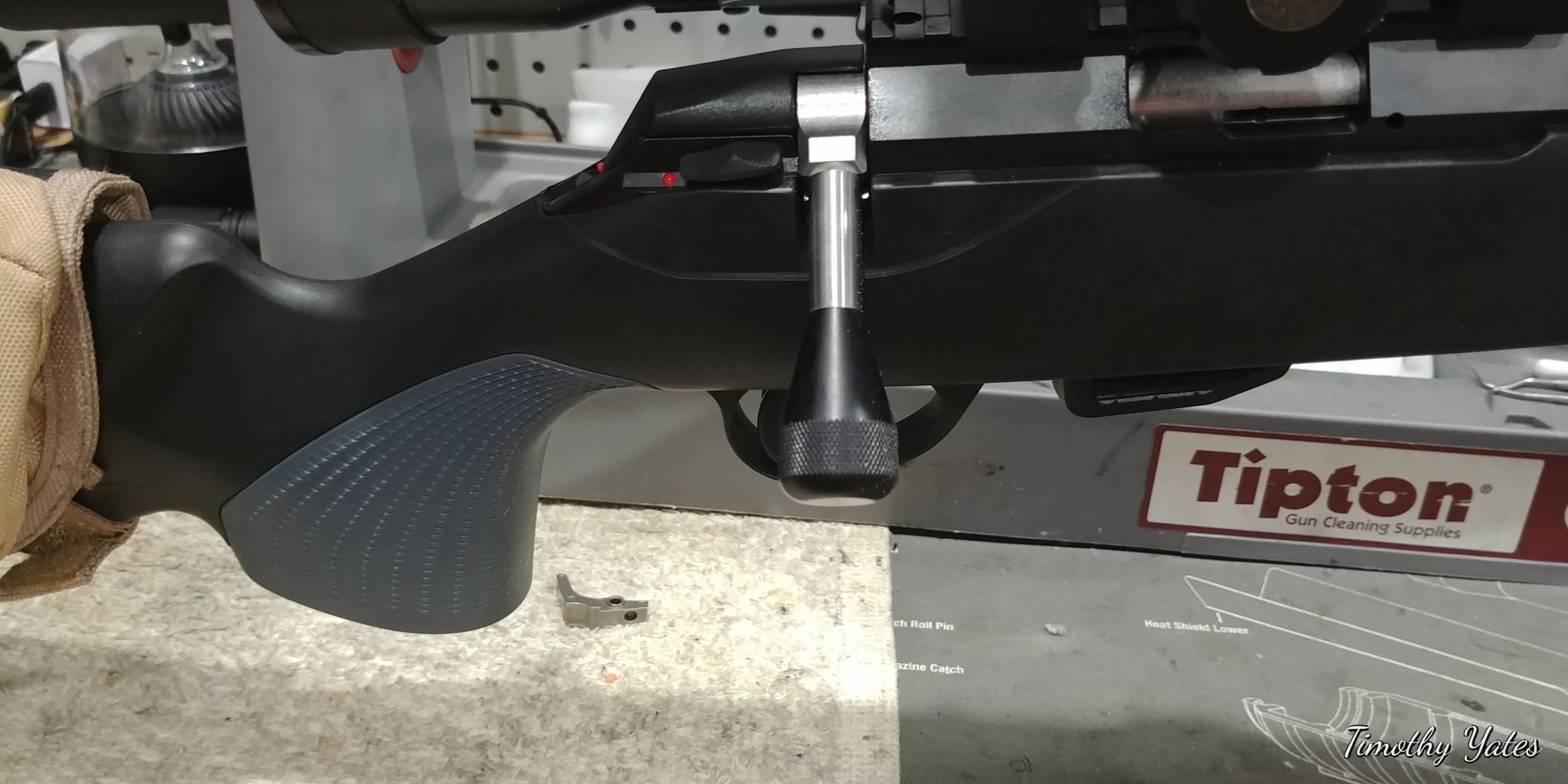

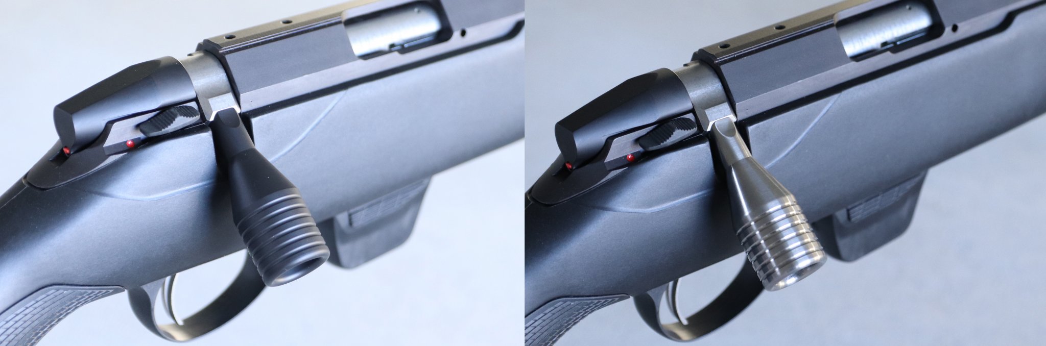

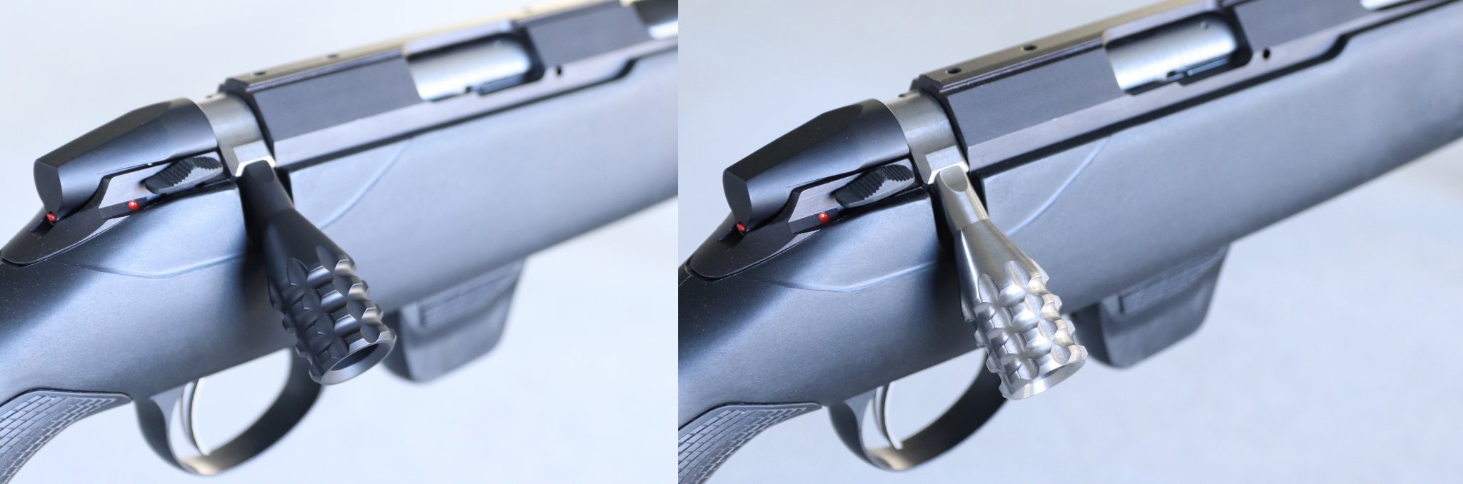

Does anyone have leads on the DIP oversized bolt handle?
I'm in Canada -
Kinsey shooting supply was recommended but they are out of stock

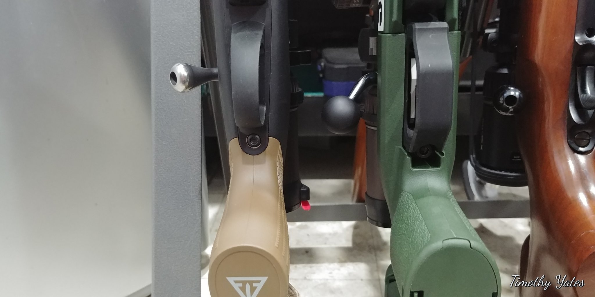

This place doesn't get any love here but I just ordered on of there handles. Might work for you.

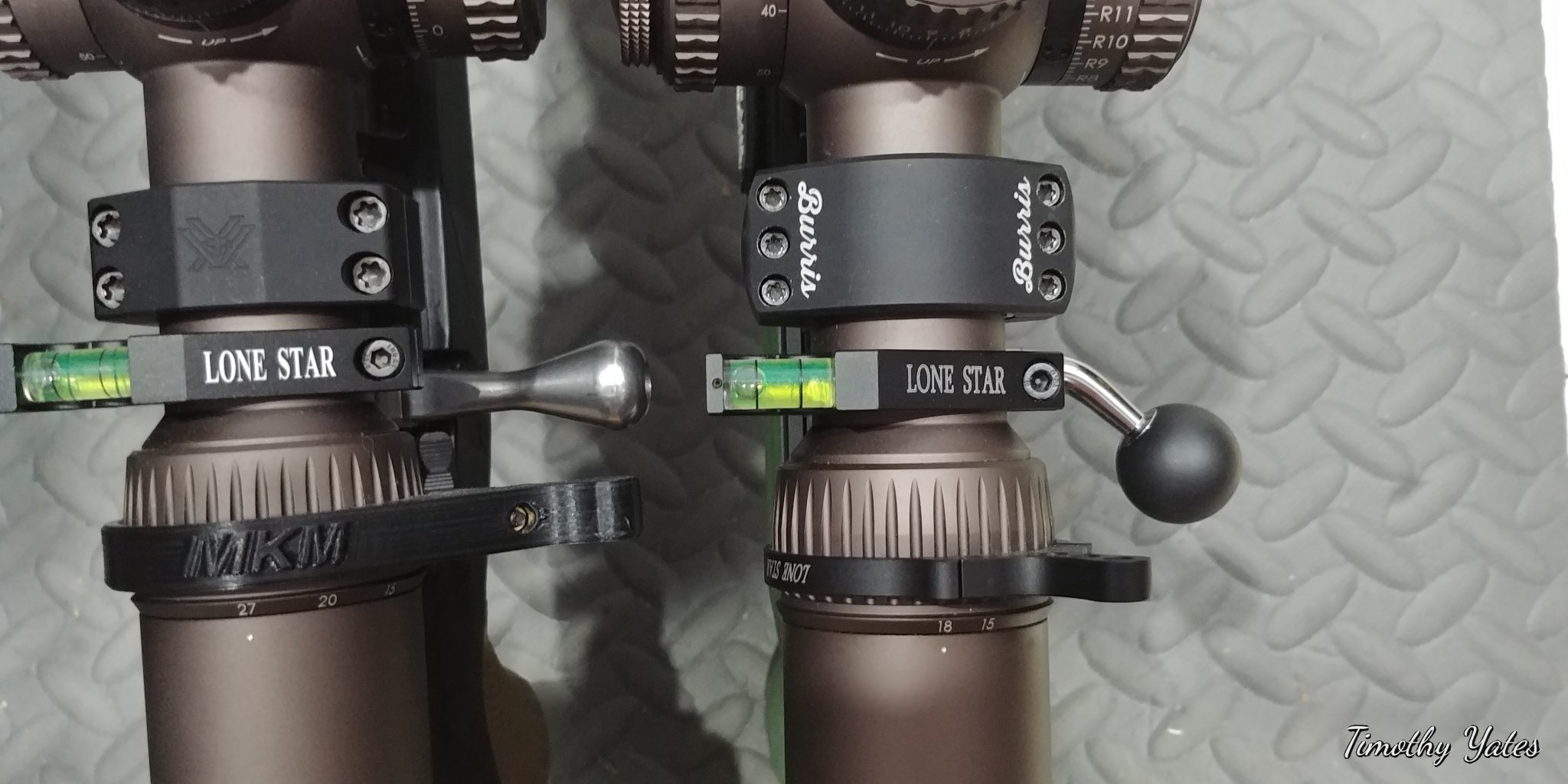

Mountain Tactical has good products. I have one of their bolt handles and one of their scope bases.
Here is the one from Mountain Tactical.
Here is one from DIP.

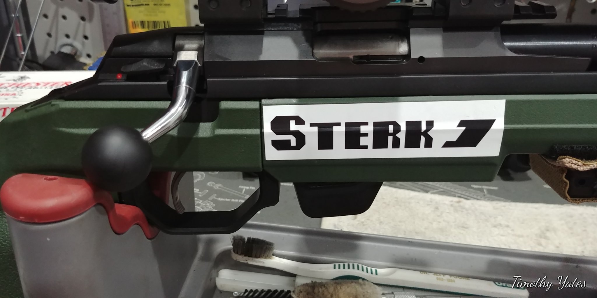

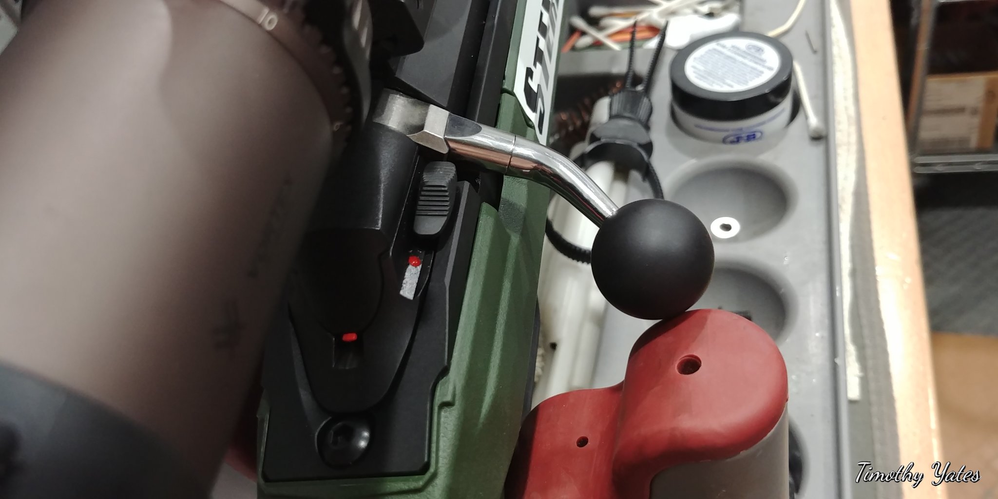

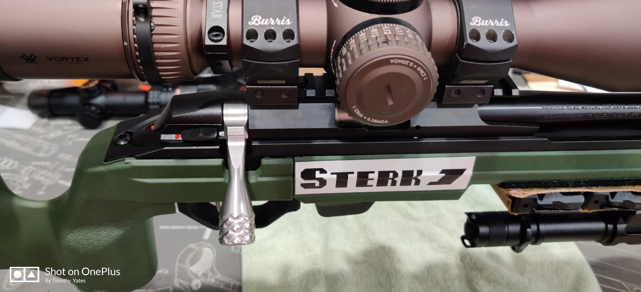

My favorite by far the Sterk swept bolt handle. This deserves more than just one photo. :)
You may ask if Sterk is my favorite why do I have the others. I just like trying different things.

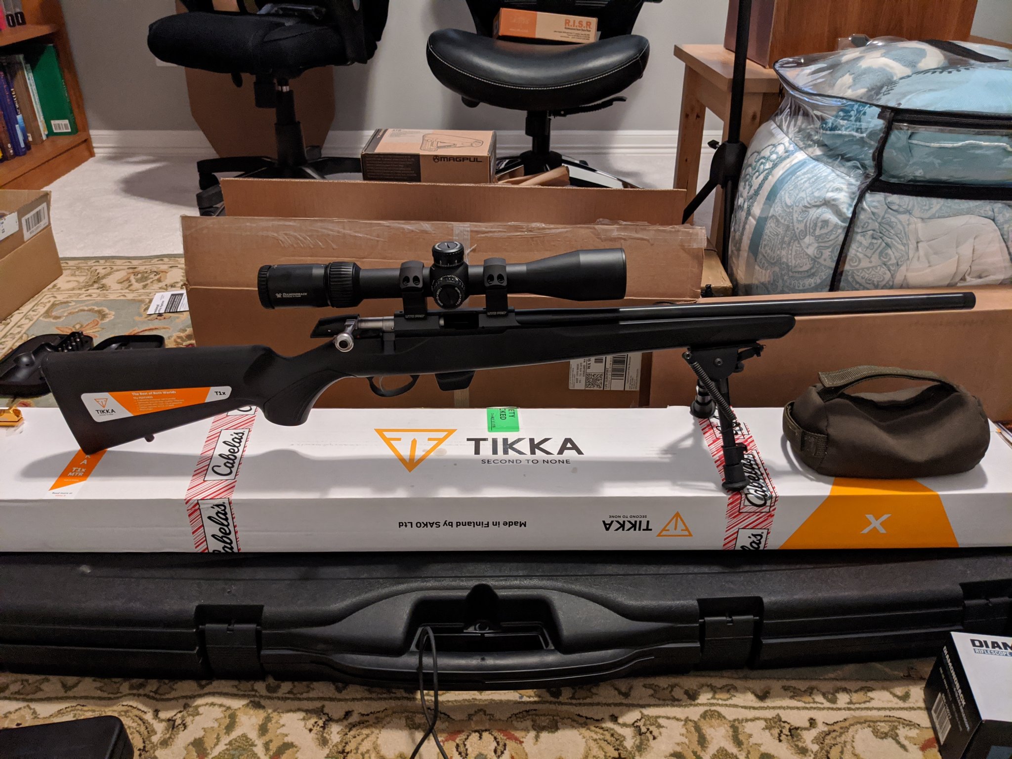

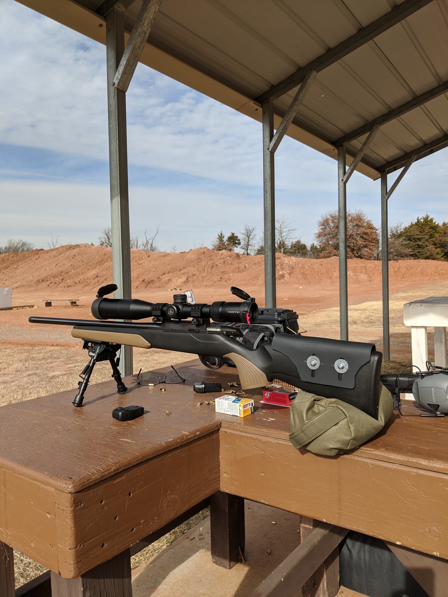

Made it to the range today for the 1st time. I put the barreled action in a stockys vg2 carbon I had laying around. Shot about 50 rounds. All CCI SV. Zero feed/extraction issues. I’m pretty happy. Was rushing because of cold/dark. Pics below. Of 50 and 100 yards.

Good job, real world results. Accuracy will get better the more you shoot it. Not that the rifle may increase in accuracy "although it could" but you will bet more accustomed to the rifle and what works best. Not talking about ammo, talking about hold, shoulder pressure, finger placement on the trigger, ect.
