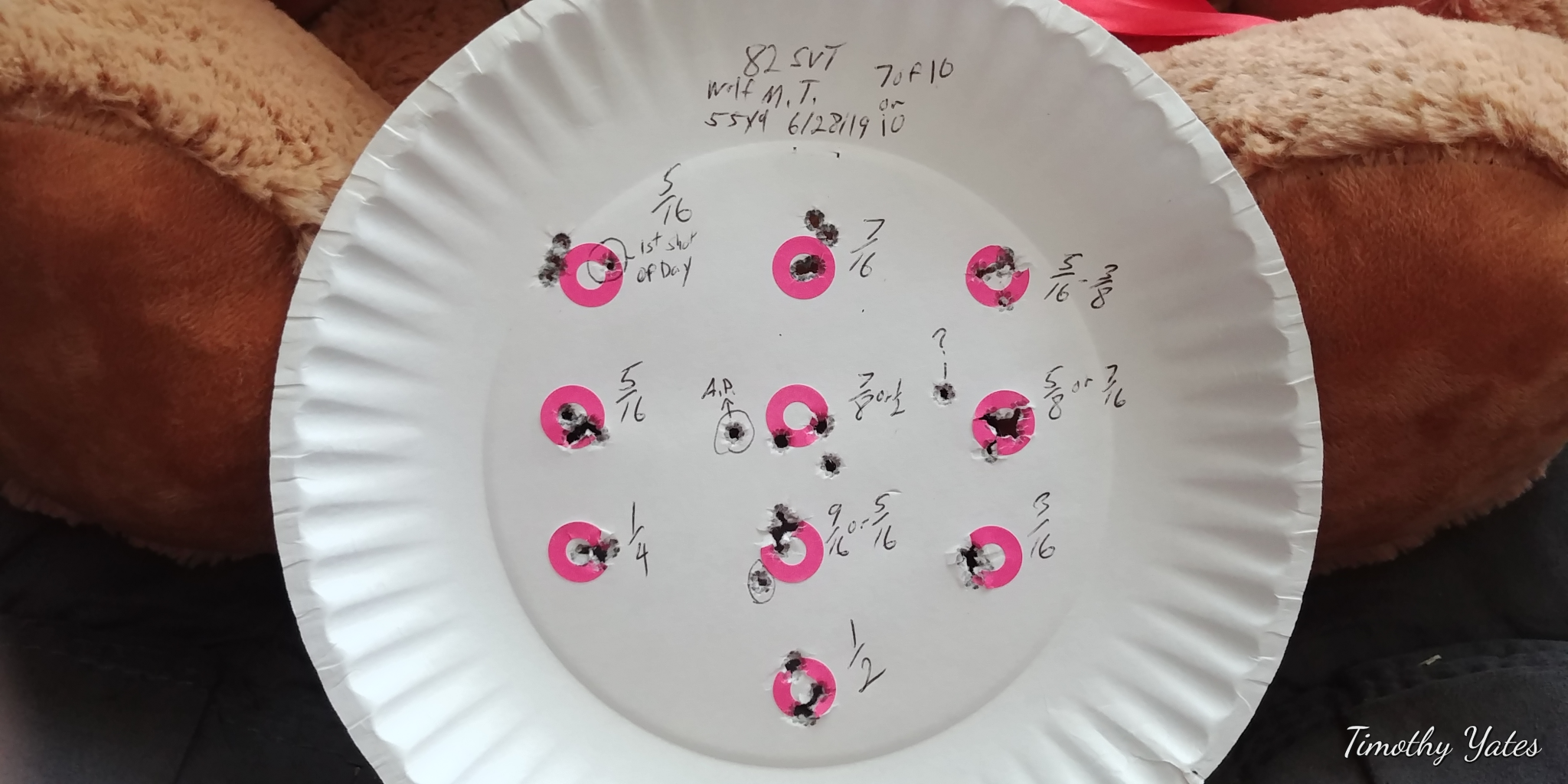

For what its worth, I recently shot 5 - 5 shot groups @ 50 yds with my all stock T1X with a random lot of Center-X , starting with a clean barrel, the average for all 5 was .324", this with a 14x scope shot from a bipod and rear bag.
Thanks Dave. I dont have much for gun smiths around here. Maybe guys with drop in barrels will chime in.

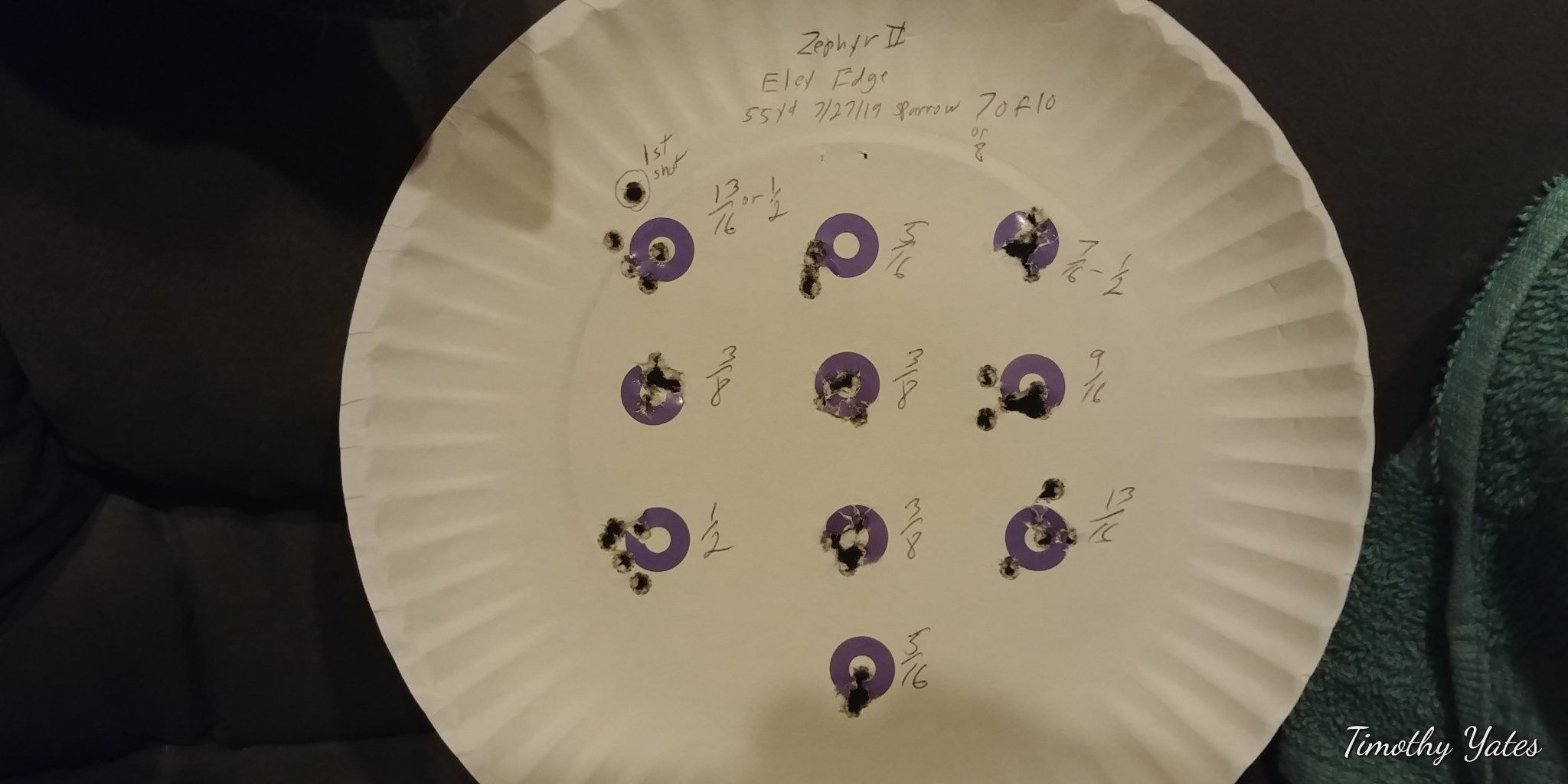

I can count on .3-.45 averages for 5x5 groups with SK rifle match. Just a bit better with fed um22. I want to try center X but it is out of stock for now.
My factory barrel shot pretty consistently right around .35 with Eley Edge or Center x. It was more than good enough for positional shooting. The biggest reason I switched barrels was because I wanted a heavier barrel and I wanted a 16“ barrel. I just decided that if I was going to spend the money on the barrel I wanted it to be as accurate as possible which meant custom fit to me.

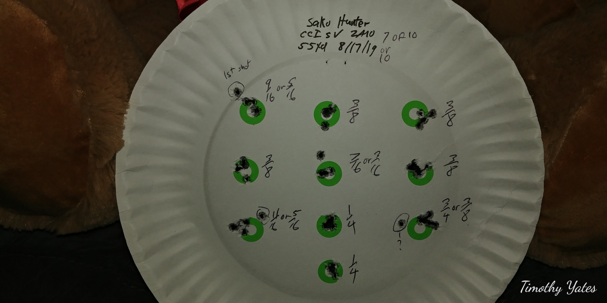

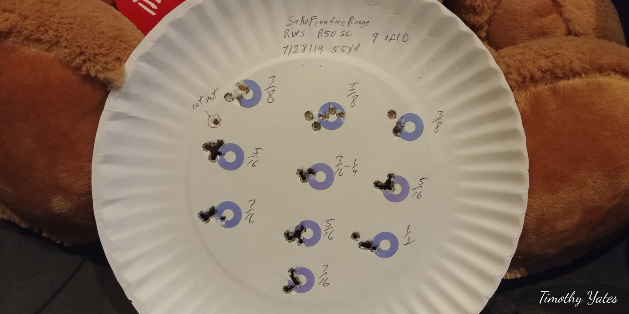

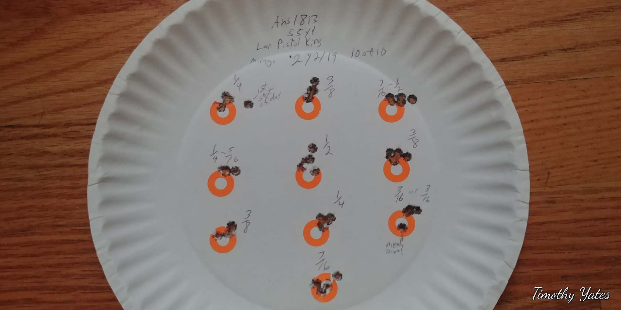

Took my T1X out for the first time yesterday for a zero and some ammo testing. Got great results from CCI MiniMag, SK rifle match, and Aguila Target Competition (this one surprised me for some reason). My rifle didn't like anything less than 40gr projectiles but it was also a bit windy.
Man, that thing is fun to shoot!
Can't beat that. Was that with Tikka #3?
Yes it was #3....heres the target, 50 yards with Center X , bottom group was cold/clean barrel, the groups were fired from bottom to top, you can see the tighten up in group 4 & 5 . I like how consistent the POI is, great little rifle that will get better I think.

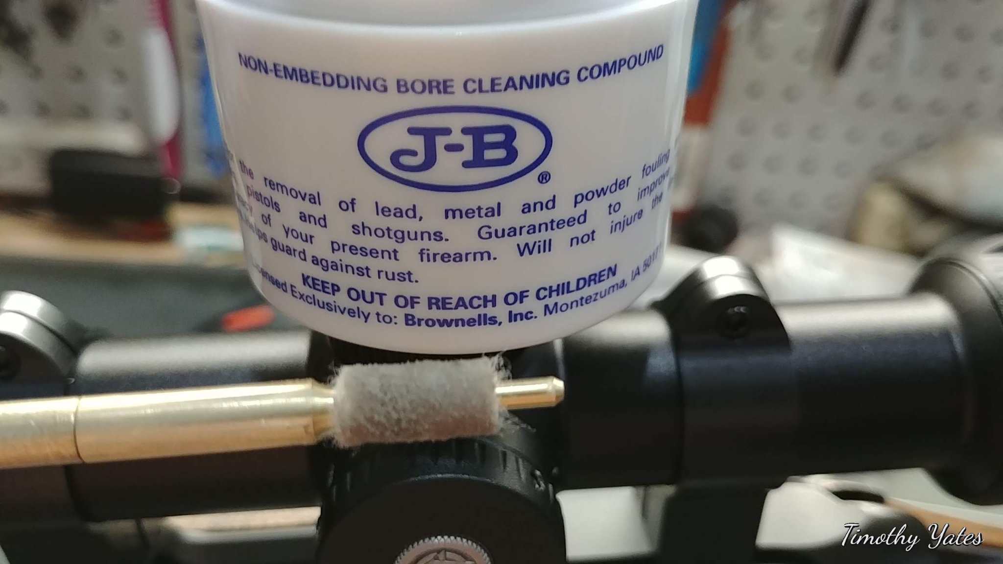

When I do clean, my cleaning regime is very simple. I run two wet patches down the bore, I remove each patch at the muzzle, never pulling back through. I then run a wet copper brush through and out the muzzle and pull back through and I do this ten times. Some may remove the brush and never pull it back through and that's fine with me, people do what they want. As for me, I have never experienced a decrease in accuracy that I could say the root cause was pulling the brush back through the barrel. There's always a possibility to damage the crown but if you have to have confidence in what you do. After the ten strokes with the brush I run as many wet patches needed to get a clean one, usually three does it. After that I run 1-2 dry patches and I'm done. Some may wonder why I only run 10 strokes with a brush and why not 50 or 15 or "pick a number". The reason is because 1, I have never gotten a clean patch right after using a brush. In the past, say 25 years ago I used to brush the hell out of a barrel and thinking this might be the one, and every single time the first patch after brushing always came out black. What I'm saying is you will get the same results if you run that brush through 10 times or 100 times or 10 times in 10 different increments. First patch after the brush will ALWAYS come out black. That is why I decided on 10 strokes with a brush a long time ago. I use two wet patches in the beginning to remove all the loose powder and fouling. Usually takes 2-3 wet patches to get a clean one after brushing. Usually it takes 2 dry patches at the end to get a dry barrel. That's my cleaning method.

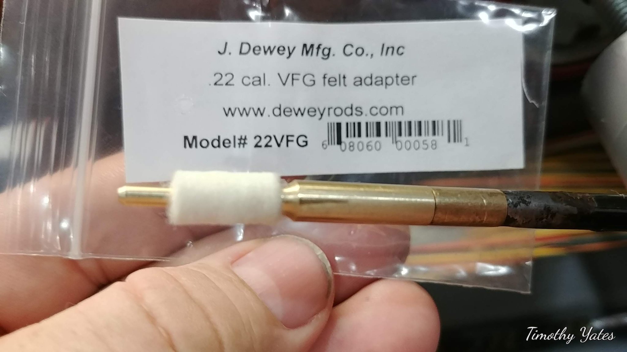

Equipment I use are Deweys one piece nylon coated rod in .17 caliber; you have to use their adapter to fit the .22 caliber jags and brushes. I use either Deweys or ProShot bronze/copper brushes, I use Parker-Hale brass jags, ProShot 1-1/8" square patches and Shooters Choice MC-7 bore cleaner and I have used it mixed 50/50 with Kroil. Another thing, I always use a rod guide if possible.

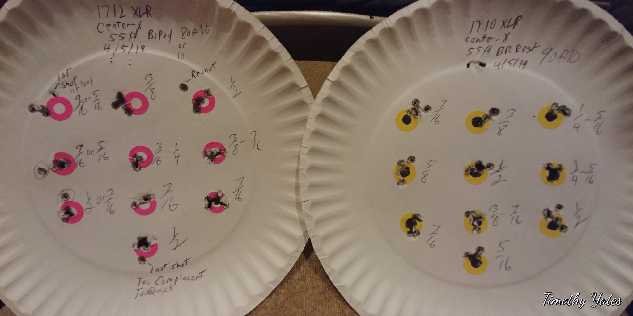

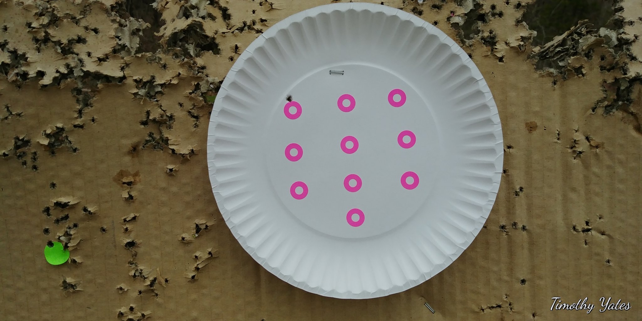

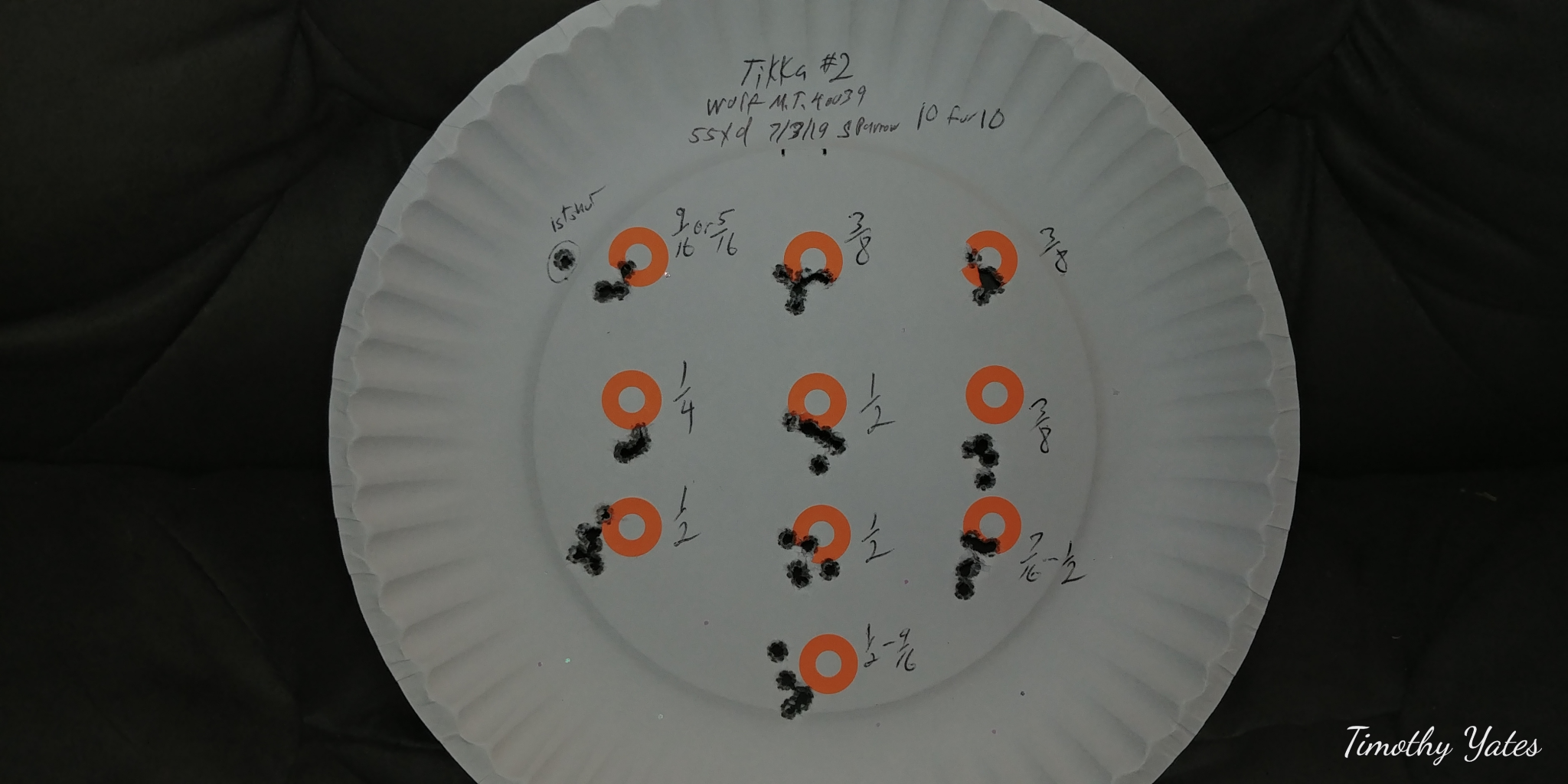

First photo simply showing first target being unshot.
Showing first shot of the cleaned barrel.
Next 4 shots.

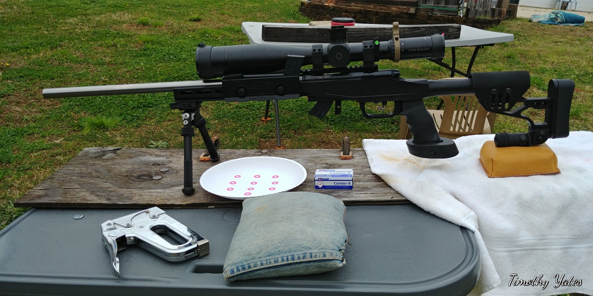

In doing this test I also tested bipod vs a front rest, rear back setup. Read the notes at the top of the targets. I guess the results show why competitors don't use bipods in a BR match.
CCI SV, notice the difference in accuracy of this vs Lapua.

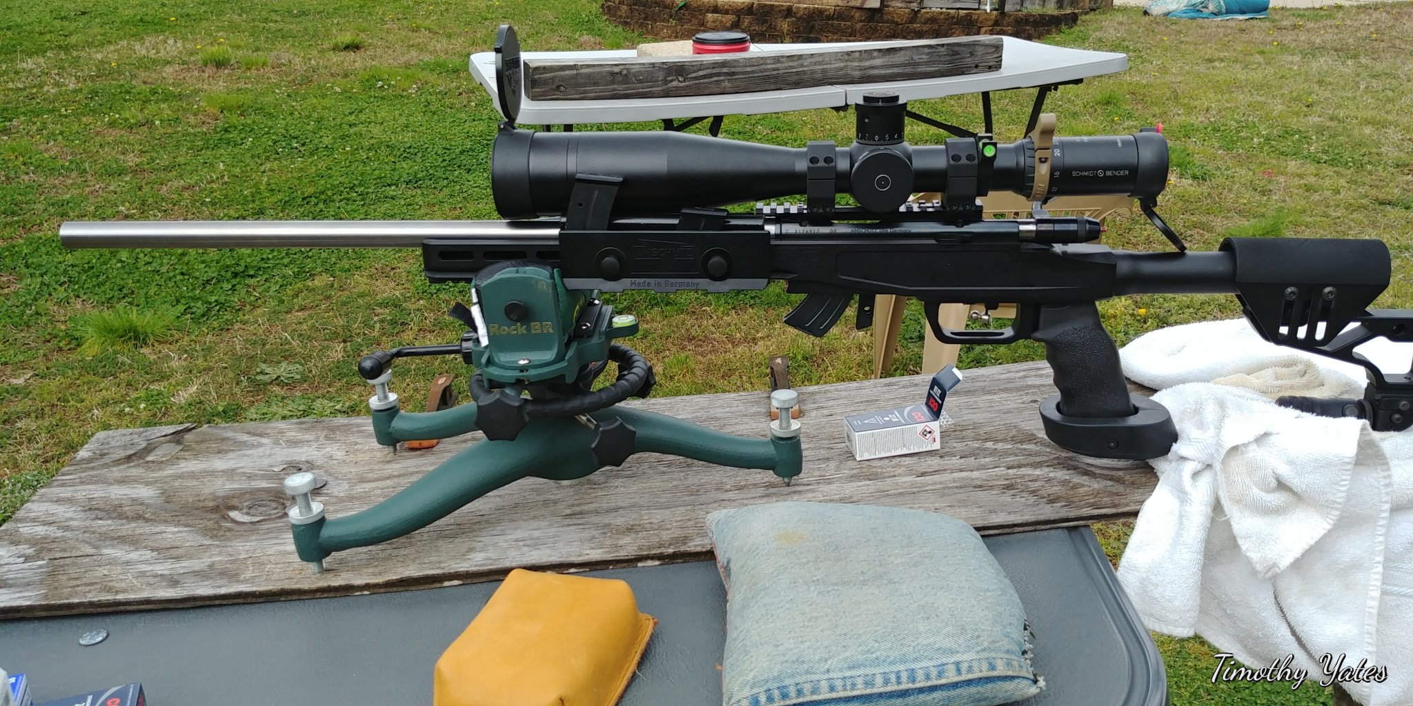

Here are the two setups used that day. The BR Rest setup was a little more accurate this day but not by much. I still prefer to shoot off bipods.

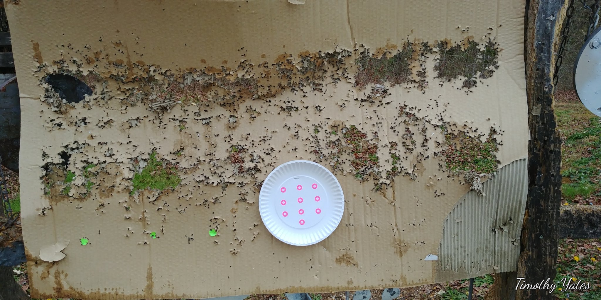

As you can see, cleaning had zero effect one way or another on accuracy. So, why clean and take a risk on damaging the barrel?? It's my belief to let the barrel tell you when it needs cleaning.
KOD - excellent commentary and practical testing.
By the looks of the cardboard back-stop, more than a few rounds have been shot at your private range.

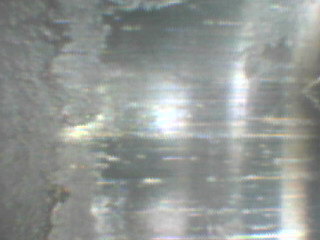

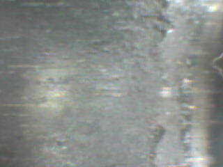

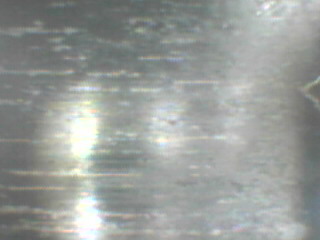

Typical carbon build up. I can't really contribute the carbon ring to any accuracy issues I have had. It did hinder reliability once on a H&R Model M12 I had once.
Start of a carbon ring. These 3 photos were taken with my Lyman borescope.
Middle of the ring.
End of the ring "next to the start of the rifling".

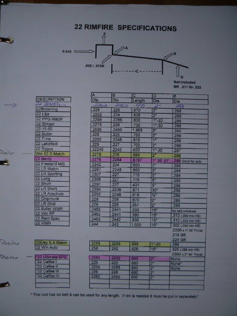

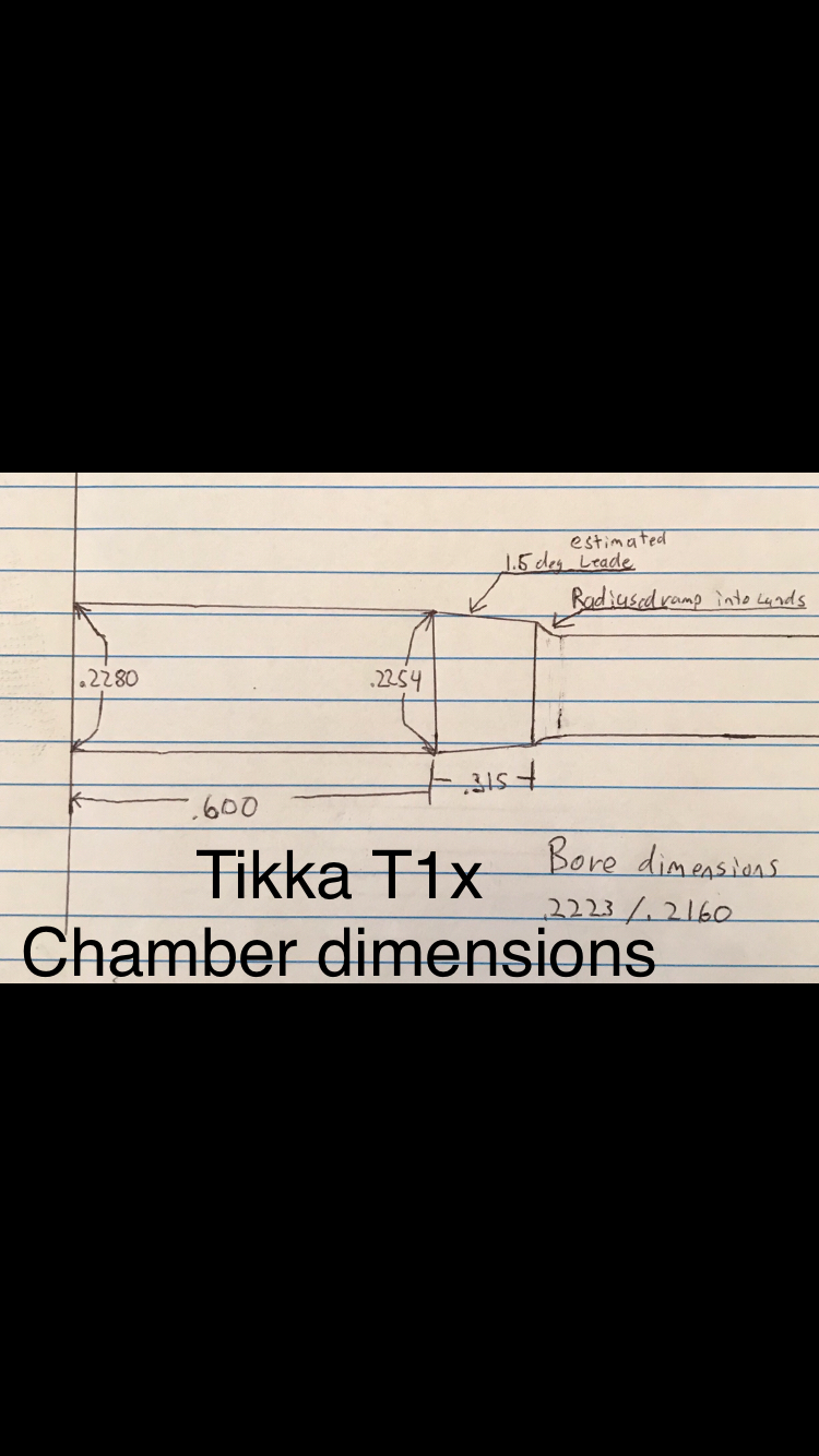

I'm about to bite the bullet and order a barrel from IBI, I like the fat 0.920" profile and so far customer service has been good.
I was not aware there is such a thing as a Calfee4 chamber. Can anyone shed more light on what that is?
TKH
Does anyone have solid info regarding the stock T1x chamber. Seems like it can’t be the Sporting...mine is sooo accurate. I thought someone slugged a T1x barrel but I can’t find that post.
I'm happy with my Calfee 4 chambered IBI barrel for my CZ 457. I'd buy another if I had a reason to.

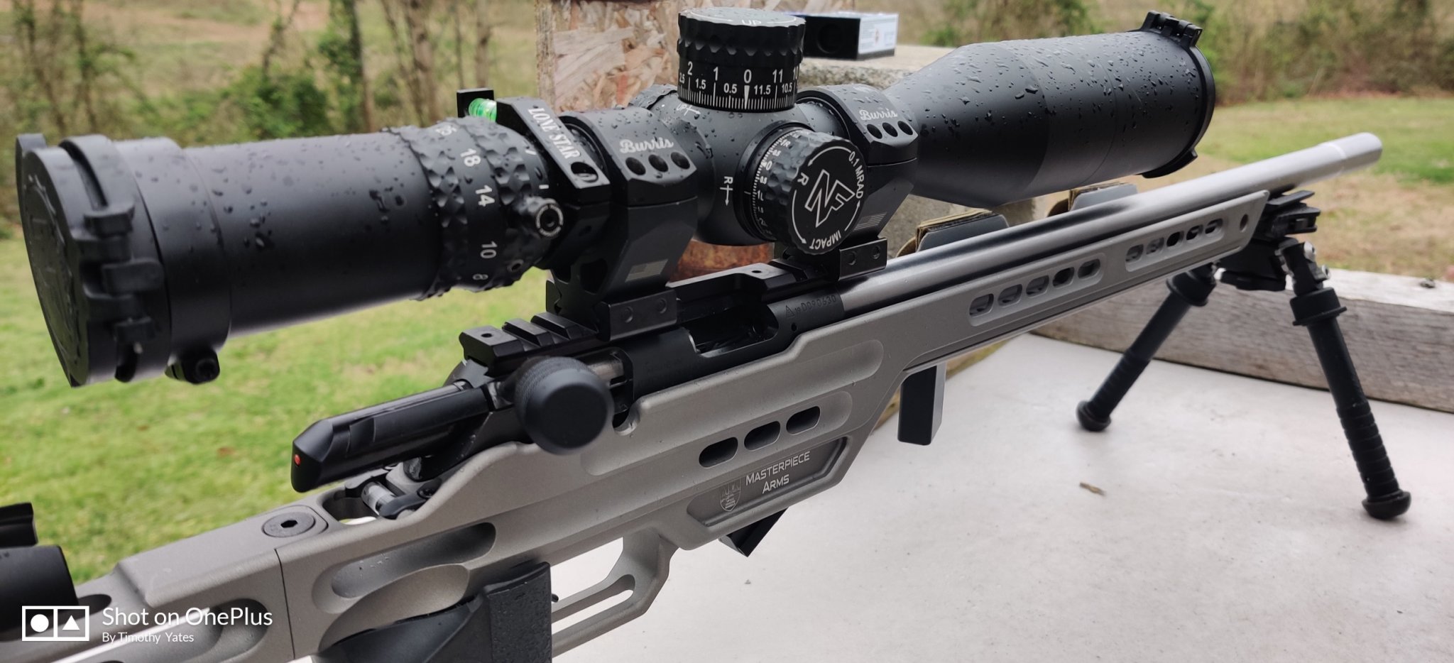

It was rainy most of the day here so i decided to swap scopes , clean guns and log assembly info. I have four 22 rifles that I shoot far more than any others. I have struggled with how I want each rifle set up and why. I think I have them how I want them now. After a fun morning of gun work/play , I went out to check on the weather. Woohoo! , the rain had stopped. I was able to head out back and enjoy the fruits. Got them all sighted in and had a little shootout. I usually avoid windy days like the plague but today it was swirling every direction at 5-15. Turns out it is awesome fun correcting for wind. It was also quite educational. I was shooting 50 yds and by the end I had a good feel for wind correction according to my flag. Good times.

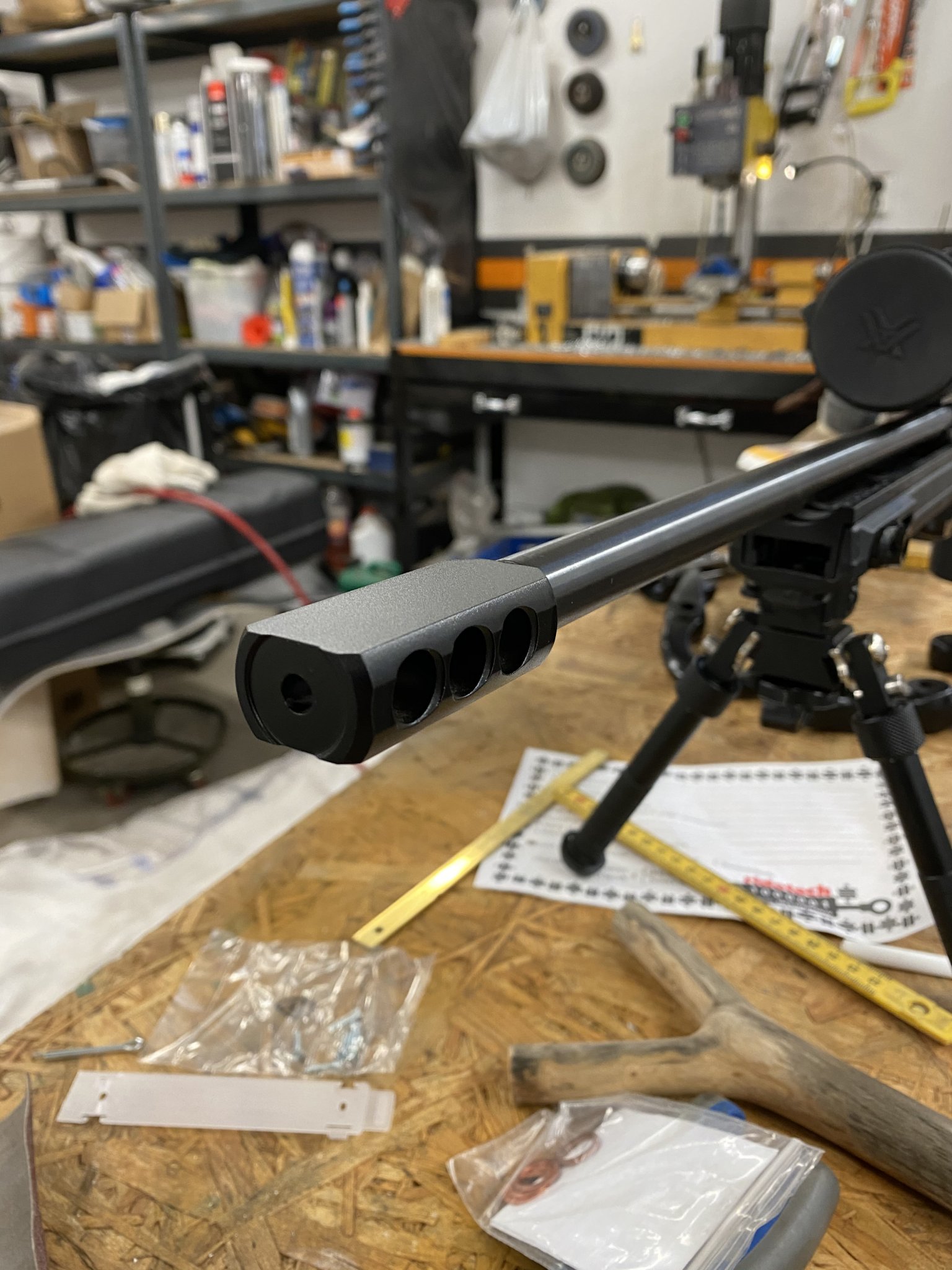

Did some testing and found out my rifle really likes SK Standard Plus. Best groups were with Standard plus and best average if I didn´t count a flyer I caused myself.
Today I will verify drop-data out to 150m to really learn how to dial for the ammo. looking forward to it!
I will also try the new muzzle brake to see if it makes a difference in grouping!

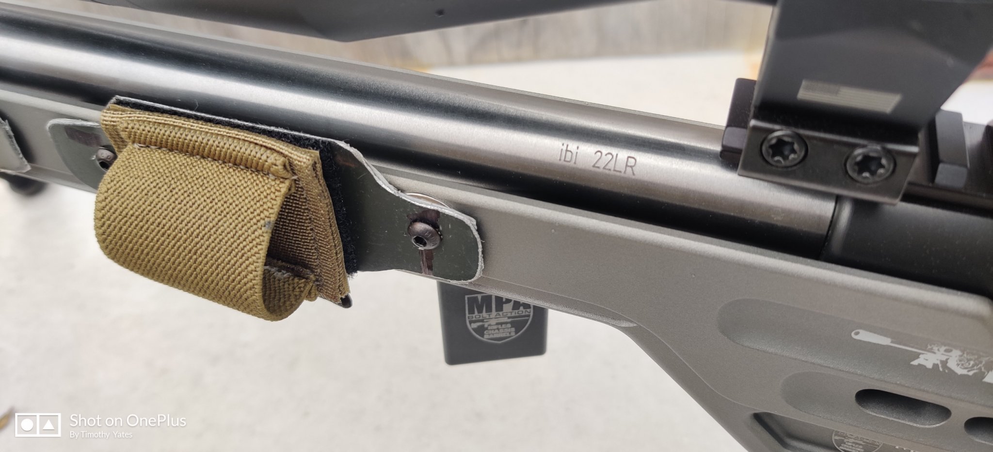

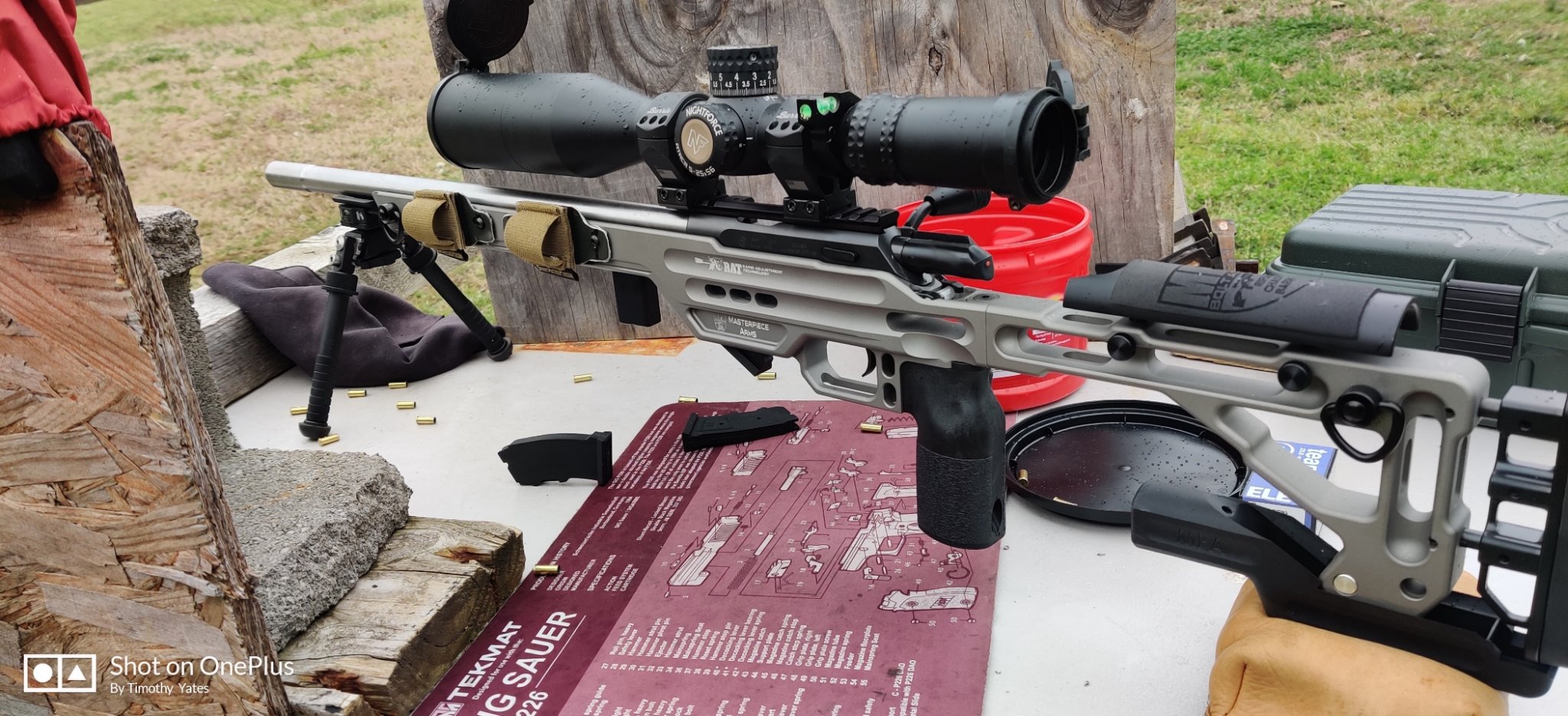

Can someone post close-up pics of T1x in Oryx chassis? In particular want to see how 22LR barrel looks near the front (gaps to chassis, proportions, etc)? Also want to know if there is space inside forehand for adding weight.
Many thanks - have been looking on internet/forum - could not find right angles.
