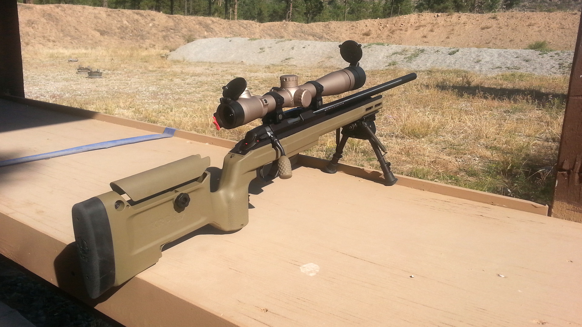

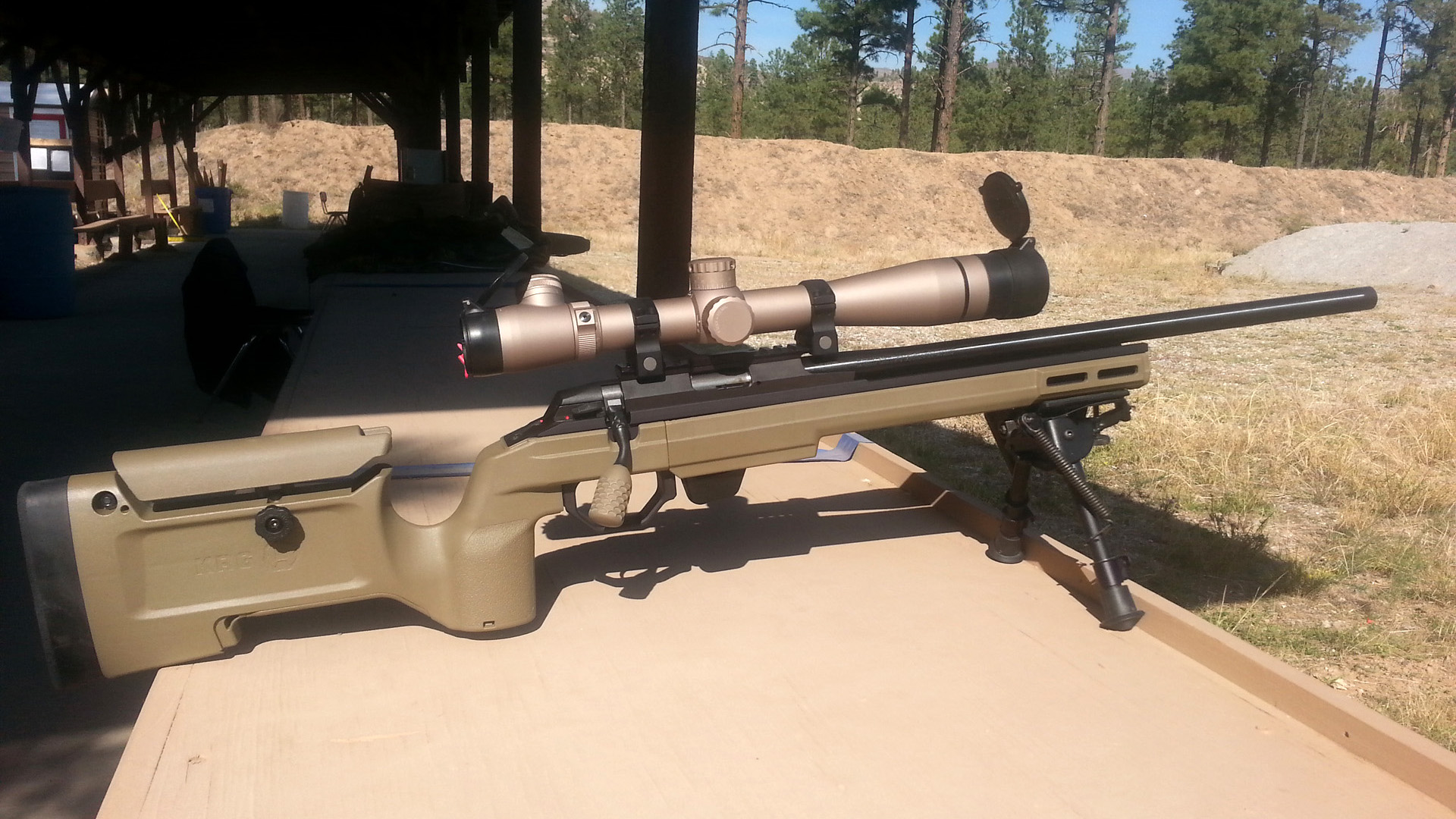

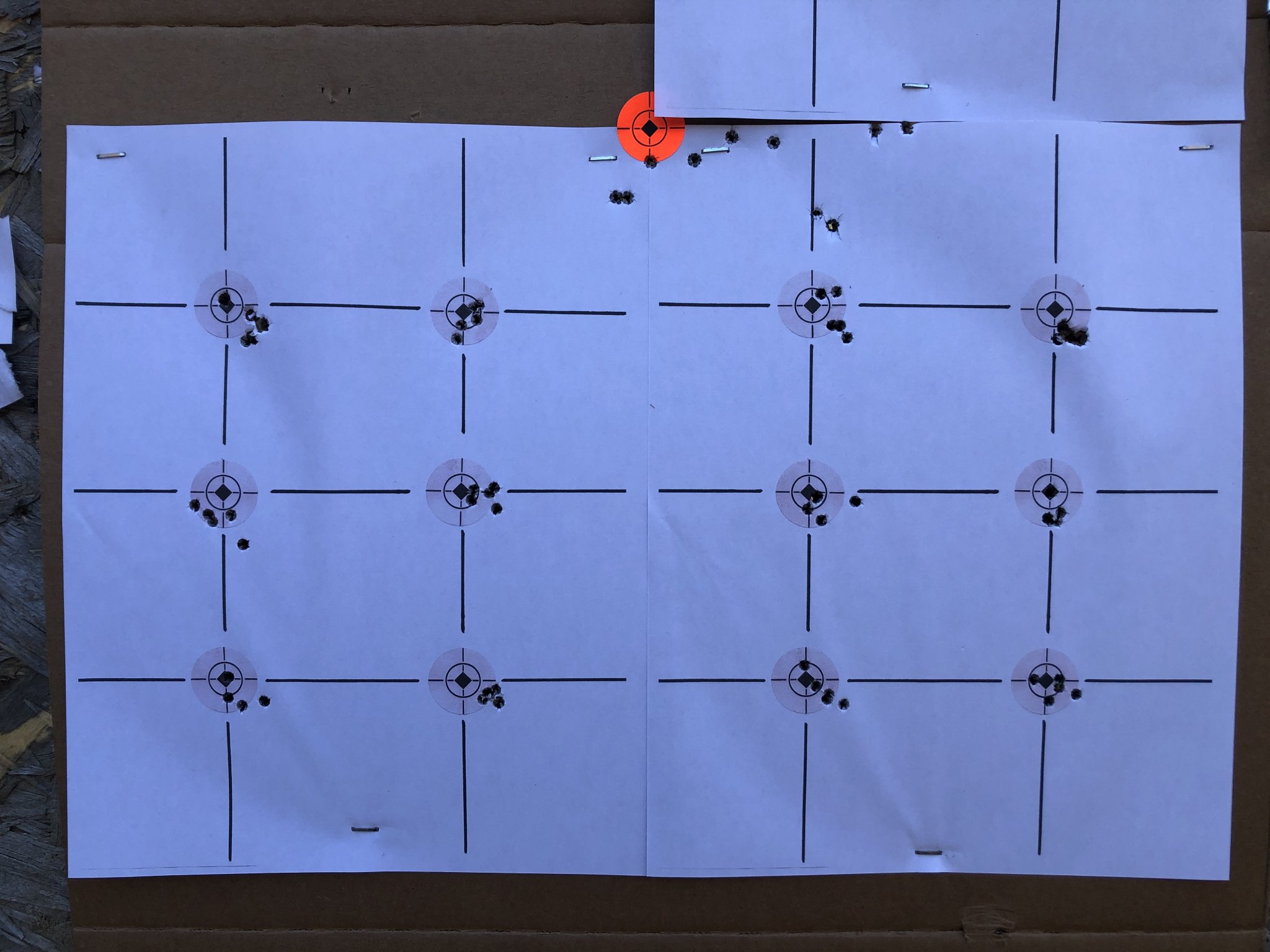

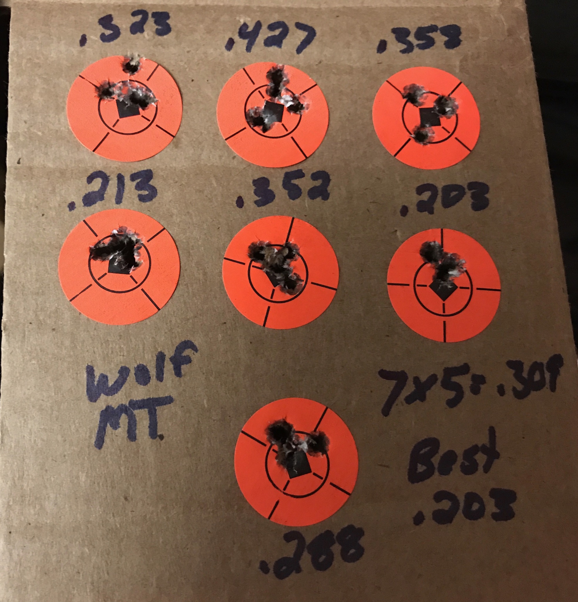

Pulled out the hi-tech bench then cut some bushes to get to 50 and shoot some groups. 10MPH swirling wind just tried to shoot when the conditions felt the same. Both of the Aguila ammo had super sonic rounds and it really killed the Eley primed groups.

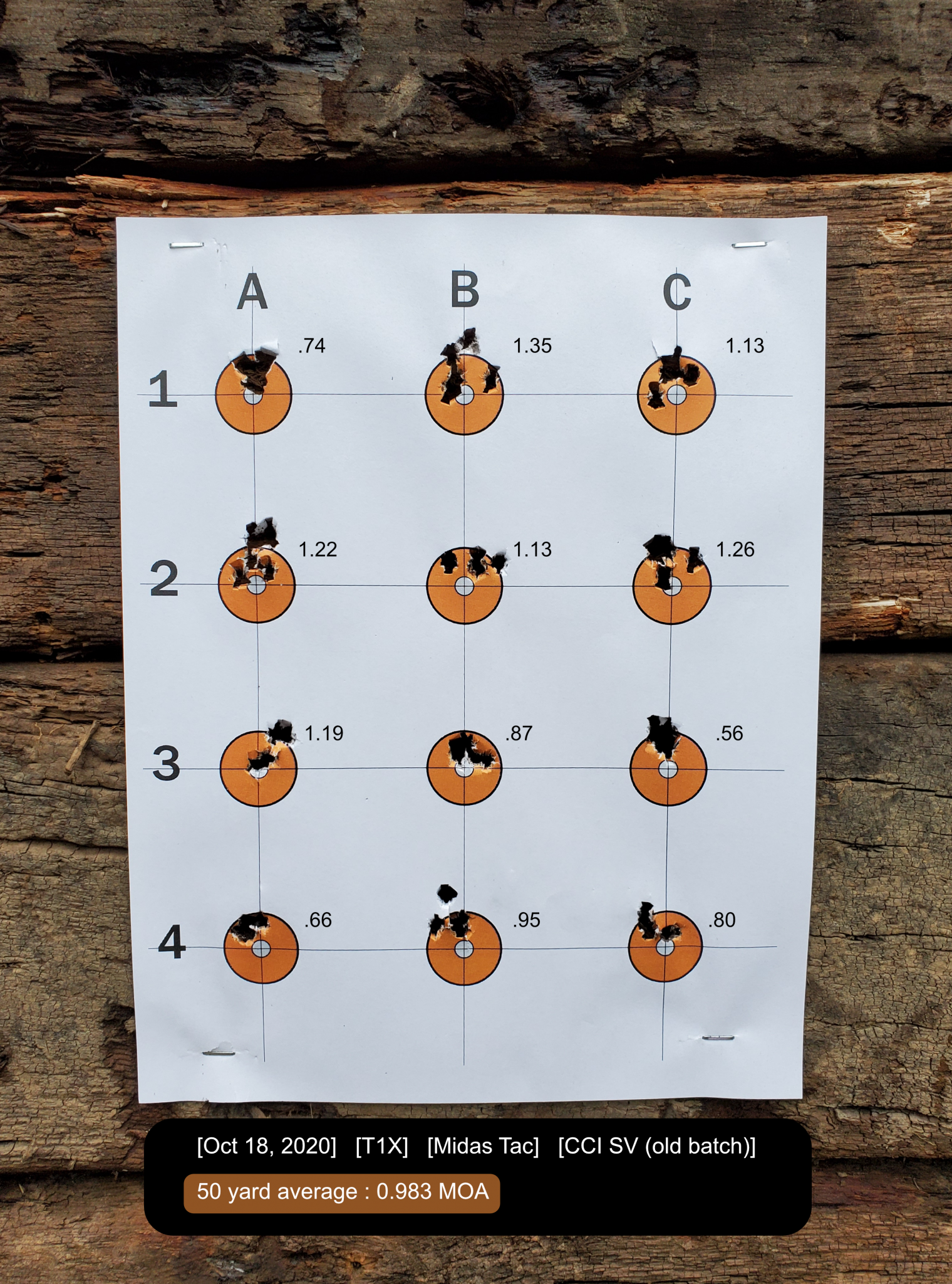

Well, after reading pages and pages and pages of this thread, I pulled the trigger on a Midas TAC 6-24×50 APRS2 FFP MIL HD scope with Warne medium rings, on top of the 30 MOA Area419 rail I already ordered. I'll stick with the stock chassis for now, at least until I get a chance to shoot the gun. As of now, looks like I'll have all the parts by Saturday. If all goes well, I'll sight it in on Sunday after my USPSA match. Thanks for the advice!

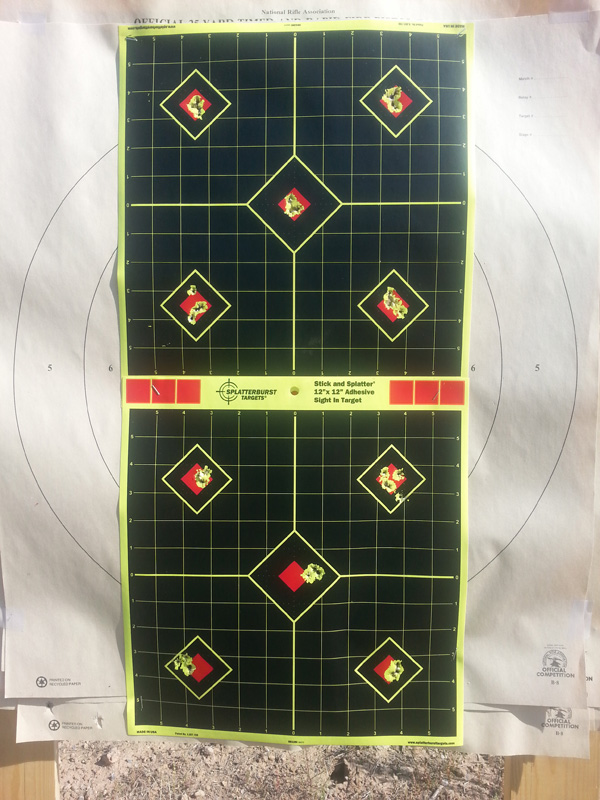

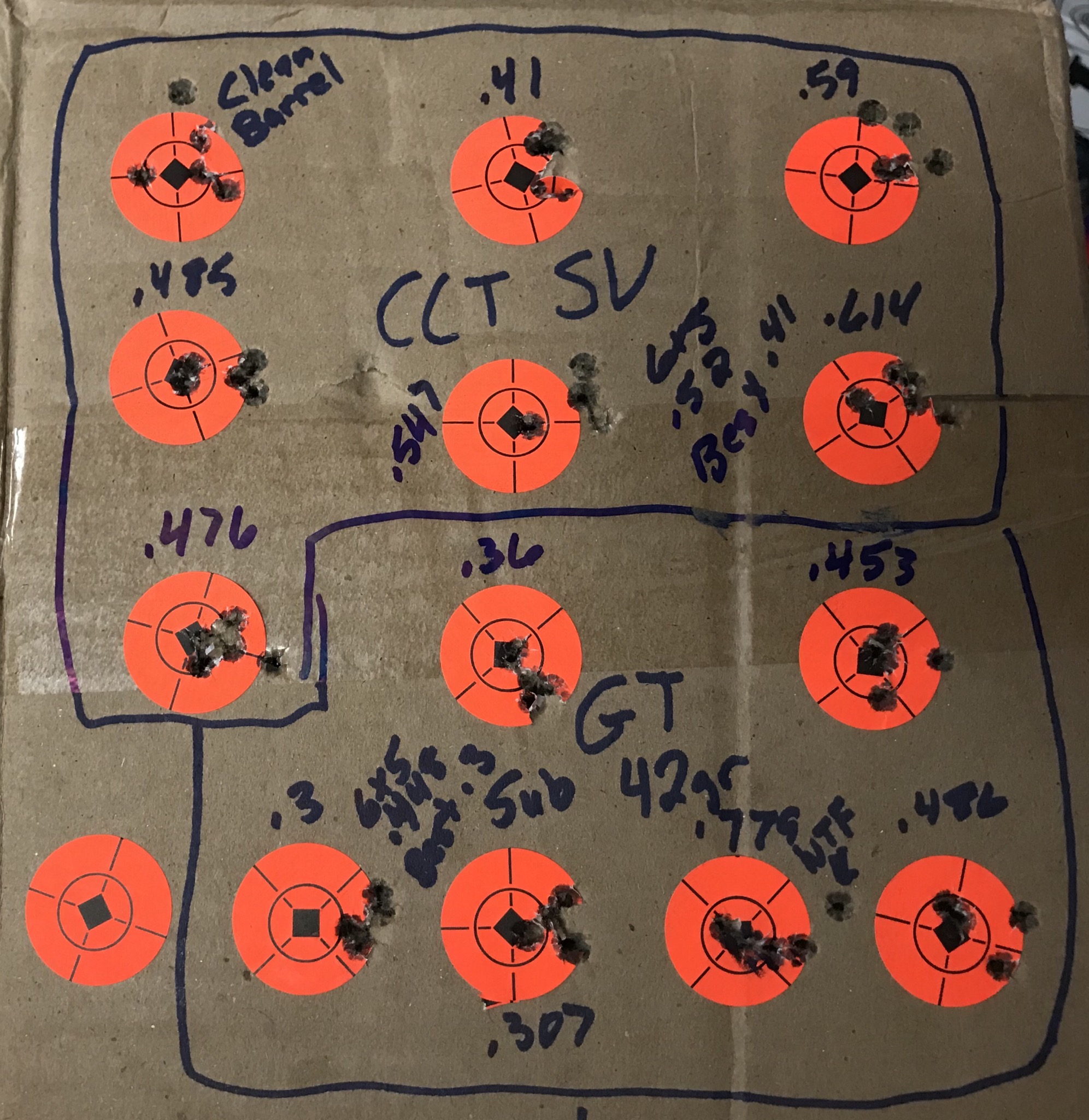

Another 50 yard target. I don’t shoot the better ammo in testing until I get about 500 rounds so still shooting various ammo that I normally just play around with. One shot I was not even settled down with the Gemtech. How the hell I let that happen with a 1.5 pound trigger I don’t know. Would Have been a decent average for that ammo. Overall I think it is a nice gun and will have no problem averaging in the .3s with an ammo it likes. Bolt lift is a little heavier than I like but set it up for a base class rifle for if I ever get to shoot NRL. After hunting season I will compare it accuracy wise to the CZ457 PV.

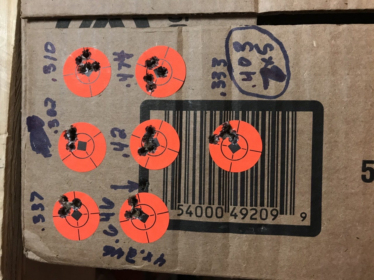

I know someone asked about the 17hmr accuracy so here's what my 16" MTR produced today during a quick range session. First group is 10 shots, 50 yards using 17grn CCI V-MAX. Group two is 10 shots, 50 yards, Remington 17grrn accutip-v boat tail. The next two are the same ammo type, same order, 10 shots each at 100yds. All of these were shot off a bench, Harris bipod and rear bag in 3-5mph wind, 90* right to left. BA sitting in a KRG Bravo instead of the plastic abomination of a stock.

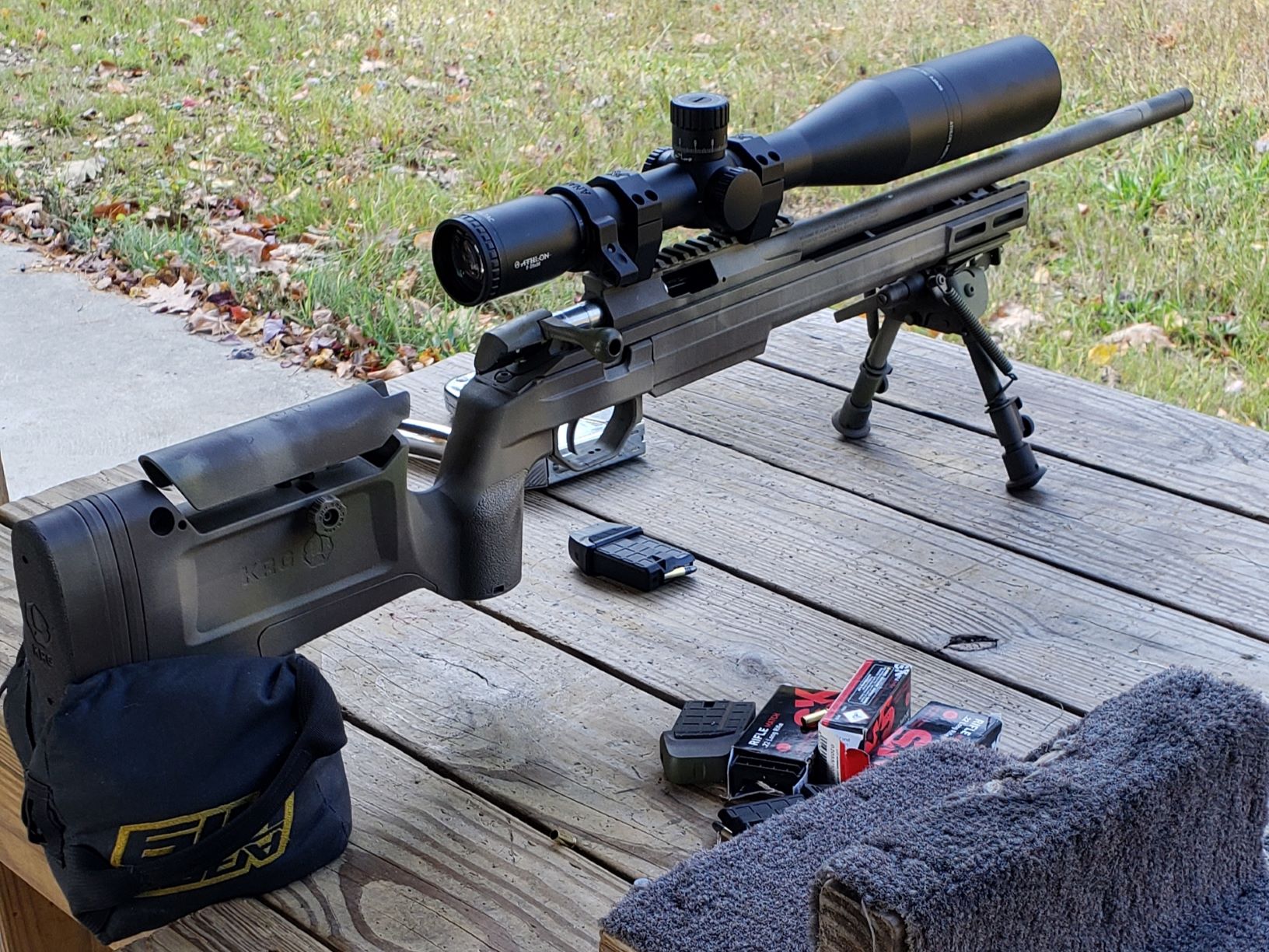

Tikka T1x MTR .22LR
KRG Bravo chassis in FDE with hook-style cover
DIP 25 MOA Picatinny rail
Anarchy Outdoors bolt handle, knob, and magazine release
Harris bipod
Leupold Mark 4 LR/T 3.5-10x40 in Nightforce Ultralite rings (yes, I borrowed this scope from another rifle of mine... because FDE)
SK Rifle Match ammo at 50 yards (all flyers were probably my fault). I was just getting sighted in on the bottom target, so the groups aren't all on the point of aim.
I have to say I really like the AO magazine release; it's the perfect width and length to fill the KRG Bravo's magazine well, which makes it super easy to operate by feel alone. I also ordered an AO trigger spring, however, after adjusting the factory trigger, I'm so pleased with it that I didn't bother changing the spring.
Eventually I'll get a new scope to devote specifically to this gun. I'm thinking maybe the Swampfox Kentucky Long.

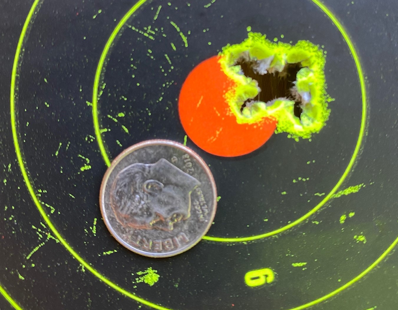

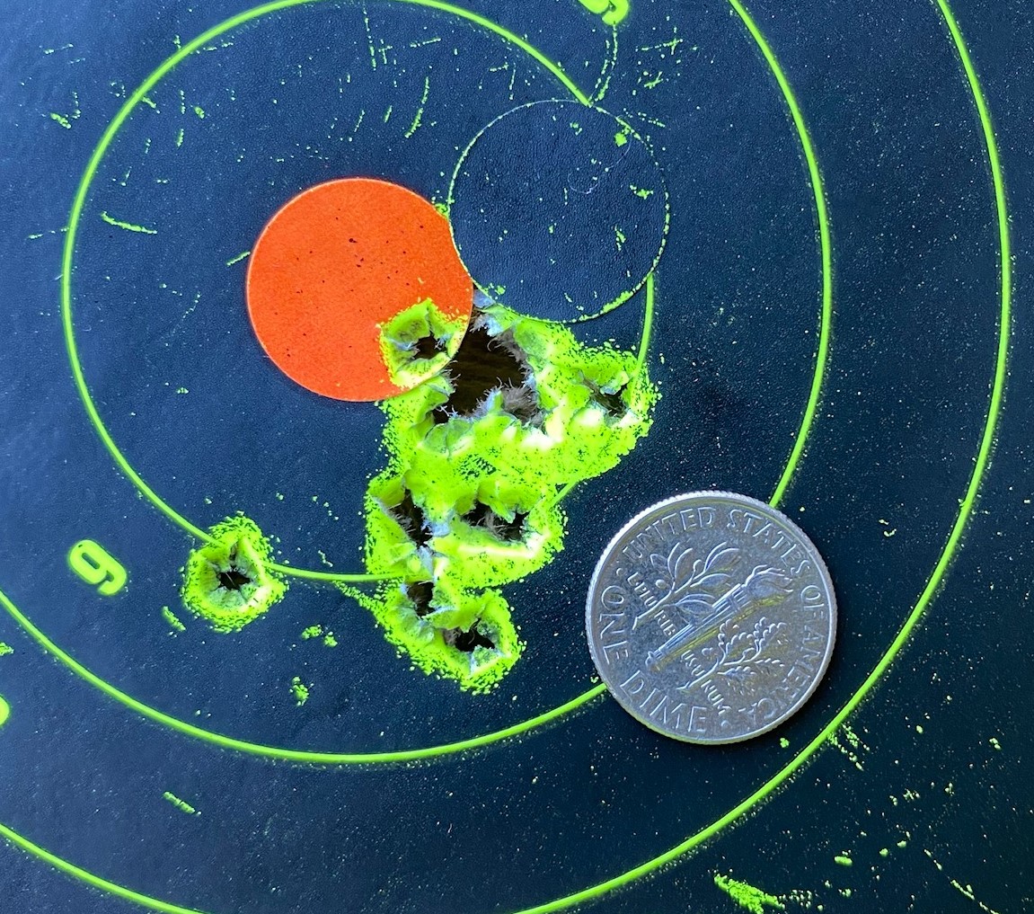

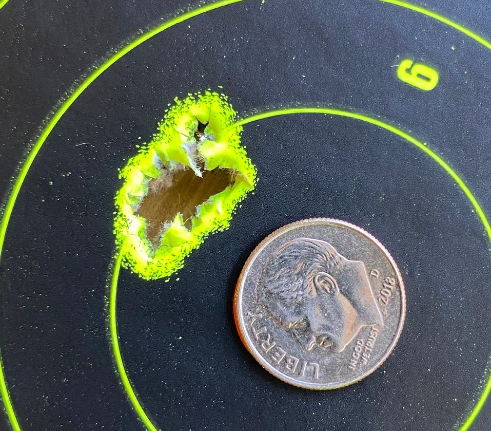

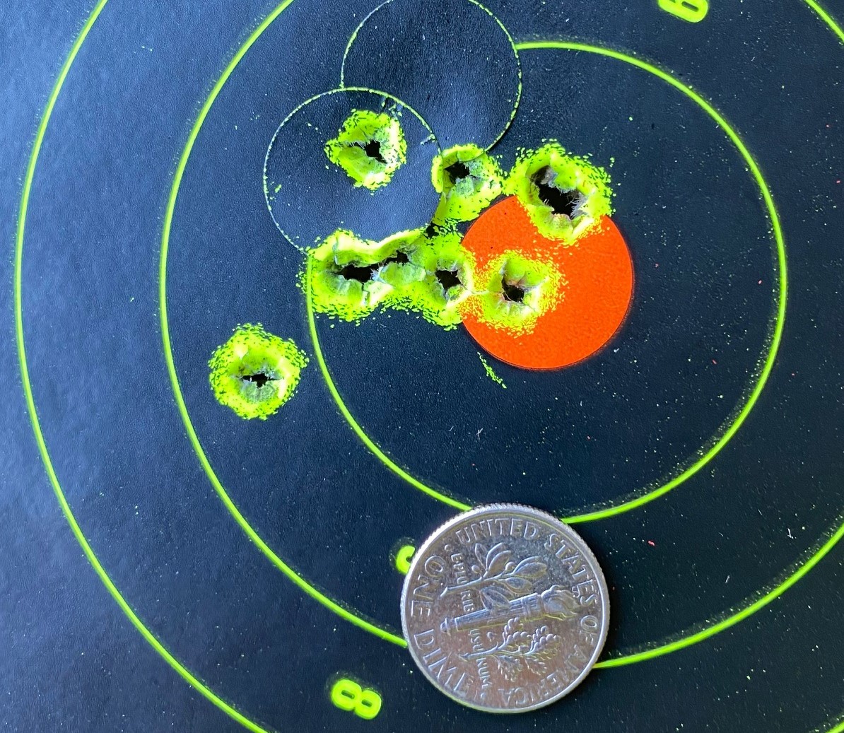

I fired off 150 rounds of 17 grain Hornady with mixed results. The target below is a series of 5 round groupings from the prone at 50 meters. Weather was cold (just above freezing) and a bit of variable wind, I was also running through the groups at a high tempo so take them with a grain of salt.

Sniperstudent - fantastic groups under the conditions at 100 yards. Really appreciate you posting. It appears that the 20" T1x really shoot many types of mid to high end ammo well.
In my limited observation, the better quality ammo seem to double in group size when the distance is doubled unlike cheap ammo that seem to triple the group size when doubling the distance. Interesting to see, in this small sample size, that some 22LR ammo shoot better @ 50 yards and others better @ 100 yards and vice-a-versa.

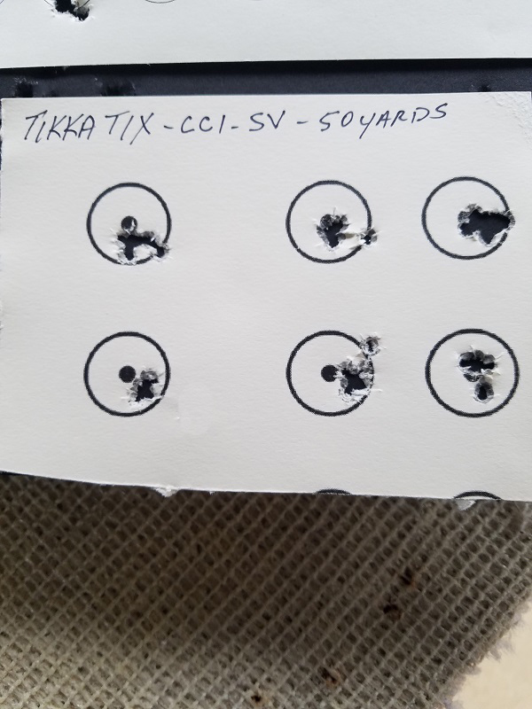

I recently got a bunch of CCI SV (new lot) that is garbage. Shot some of the old stuff today for old time's sake. I am very happy with how this old lot shoots
