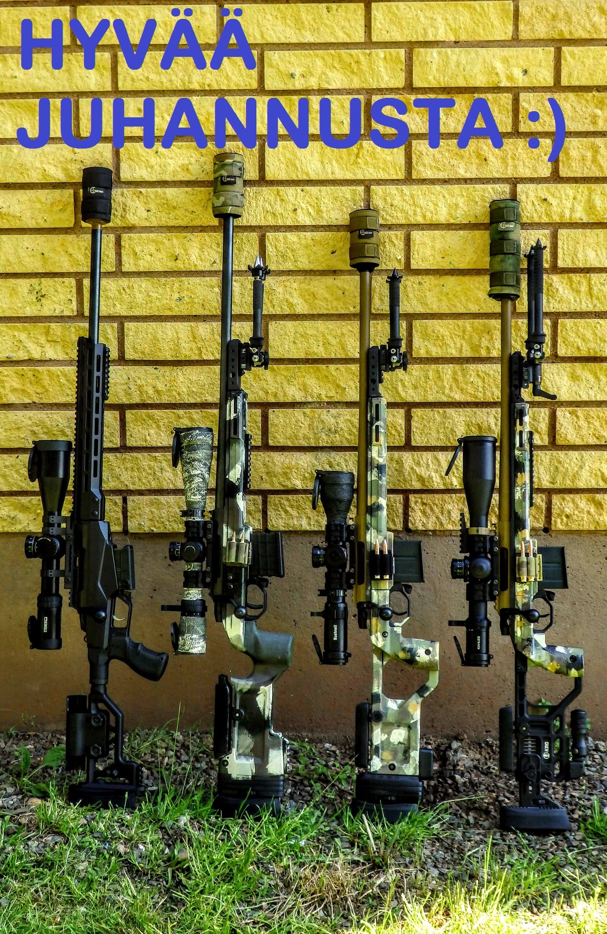

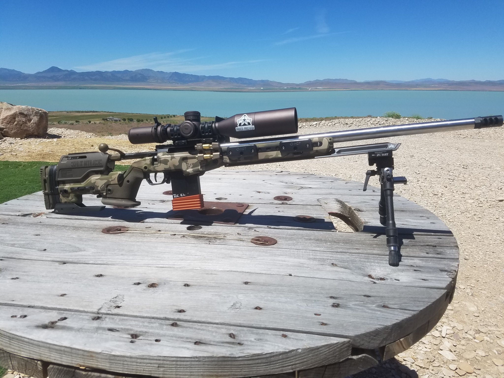

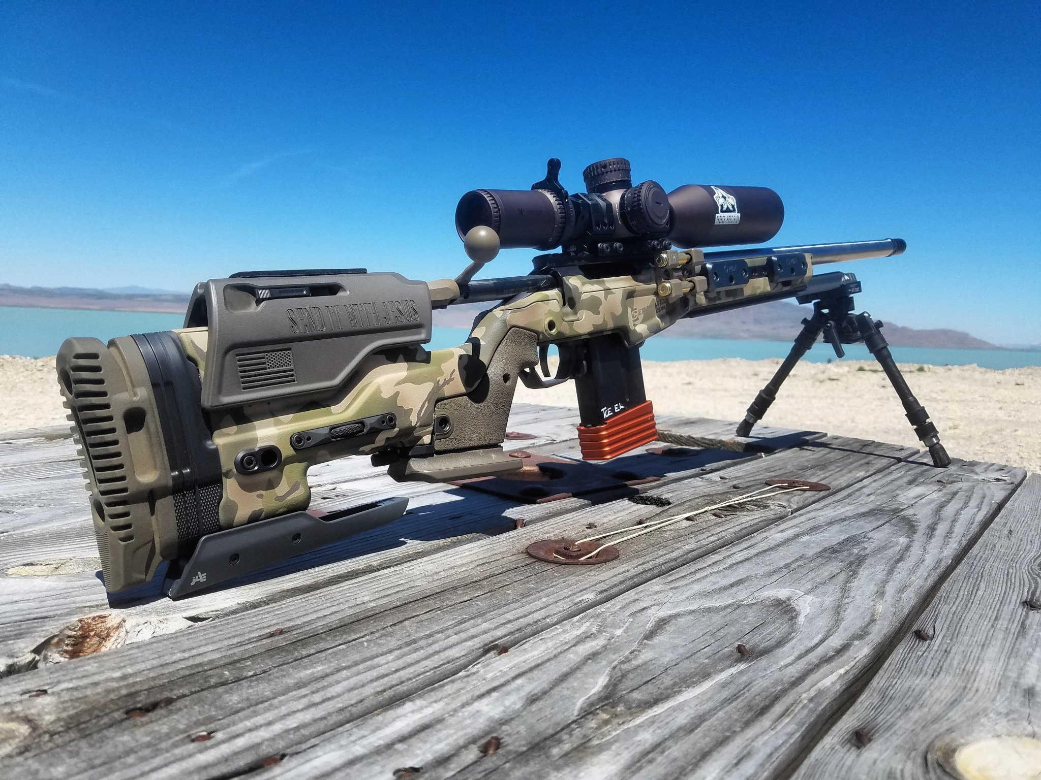

I could not hold my self, so the X-ray is now also in the camo outfit :eek:.
There is also some step by step photos, how i do that sponge camo paint.
No turning back :D
A great looking rifles! Looking at your other photos on the net, can you please tell if device at the top of the barrel is a muzzle break or silencer and if you have a link to manufacturer or a name of the model. Thanks...

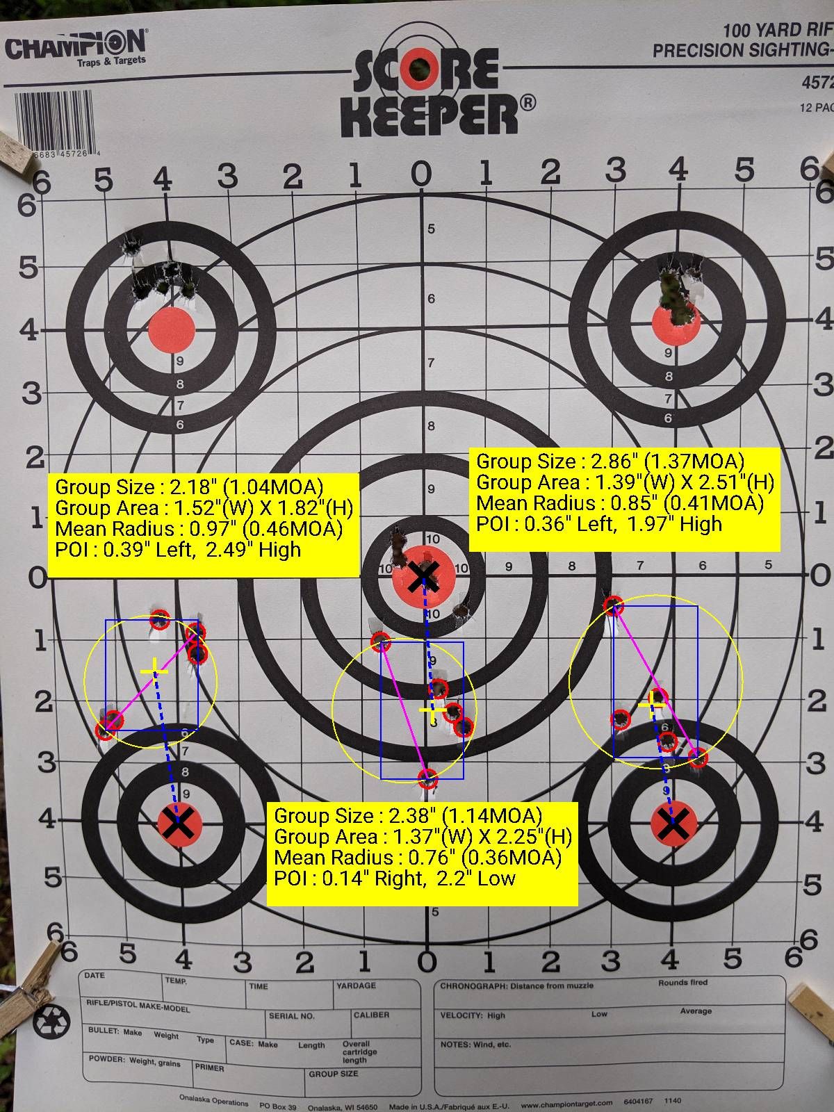

Makeshift cheek rest as I was trying to at least shoot the rifle while waiting on the KRG Bravo to come in. Right now I'm shooting my Tikka T1X actually a lot better, which is in a Bravo. I duct taped a towel around the stock to raise my cheek up which now is the perfect height.
I also took shots w/o my new Area 419 brake since there were people at the range, and when they left I put it on the first time. Having a quick detach brake is pretty darn nice. Huge difference with the brake on as I was able to stay on target and have quicker followup shots.
I do tend to shoot right a lot... even with dialing the scope left, it wasn't moving as much as it should. Now it could be the scope having tracking issues... or me. Most likely me. The dialing up & down worked as expected, 0.72 inches per 0.1 mil. I did notice that with me jogging back and forth 200 yards each way, my heartbeat was causing the rifle to move left & right, maybe that accounts for the left & right variation, vs the up & down being pretty good.
I'm looking forward to getting better! Watching / reading the snipers hide training will be really helpful.

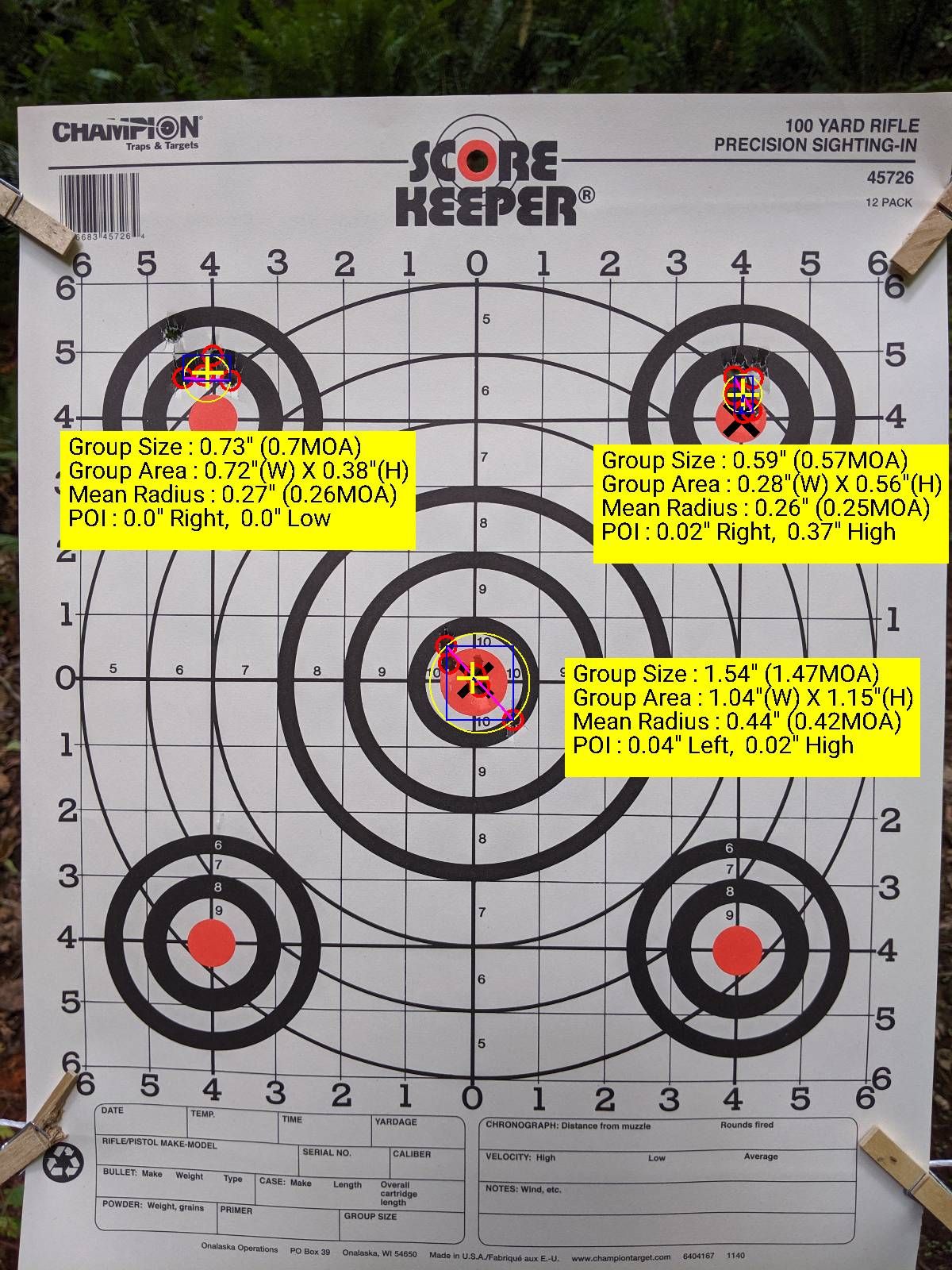

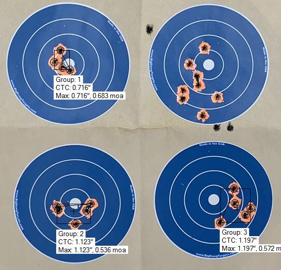

My first post here. I too just bought a CTR in 6.5CM and picked it up yesterday. I bought 200 120g SMK and loaded 25 to sight-in/break-in. I didn't even measure the loads. I merely adjusted my powder drop to a moderate Varget load and dropped right into the case. I'm assuming there was a -.2 to +.2 or greater variation. My thinking was that "I'm going to spend most of the time cleaning after sight in" Long story short, after cleaning the night before to the point of no copper indication, the barrel appeared to have already been broken in sufficiently. After the first shot at the range, no copper. Shot 4 next....no copper.
7099823
unmarked group is sight in and just getting used to it. Group 1 is 100 yds. Group 2, 200 yd, group 3 200 yd after adding muzzle brake. Trigger was very heavy, I'd say 4-5 lb.
After I got home I installed the Yodave spring in the trigger. When I looked at the instructions for doing so on Youtube I noticed that a leaf spring was under the trigger screw (on the video that is). On my rifle, there was no such spring. I also didn't get an accessory vertical handgrip.
Out of 25 rounds fired I had about 3 instances of the round not being fed from the mag resulting in a dry fire. Could that be due to missing leaf spring?

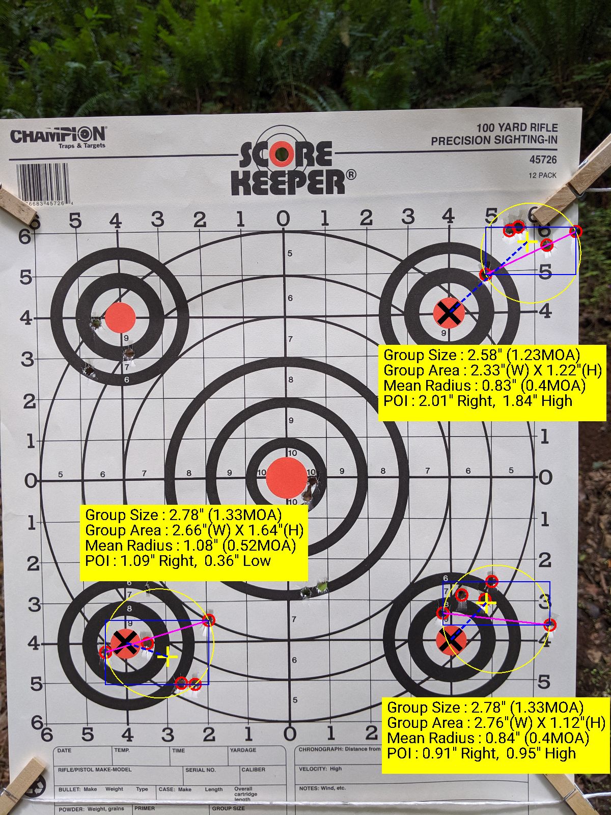

So I finally got around to mounting the scope and starting to "break in" the barrel. I'm at around the 30rd mark. Here's the latest group, 3 shot, 100yd, 1" dot .Federal 168gr. No regrets at all buying this rifle. Cheers

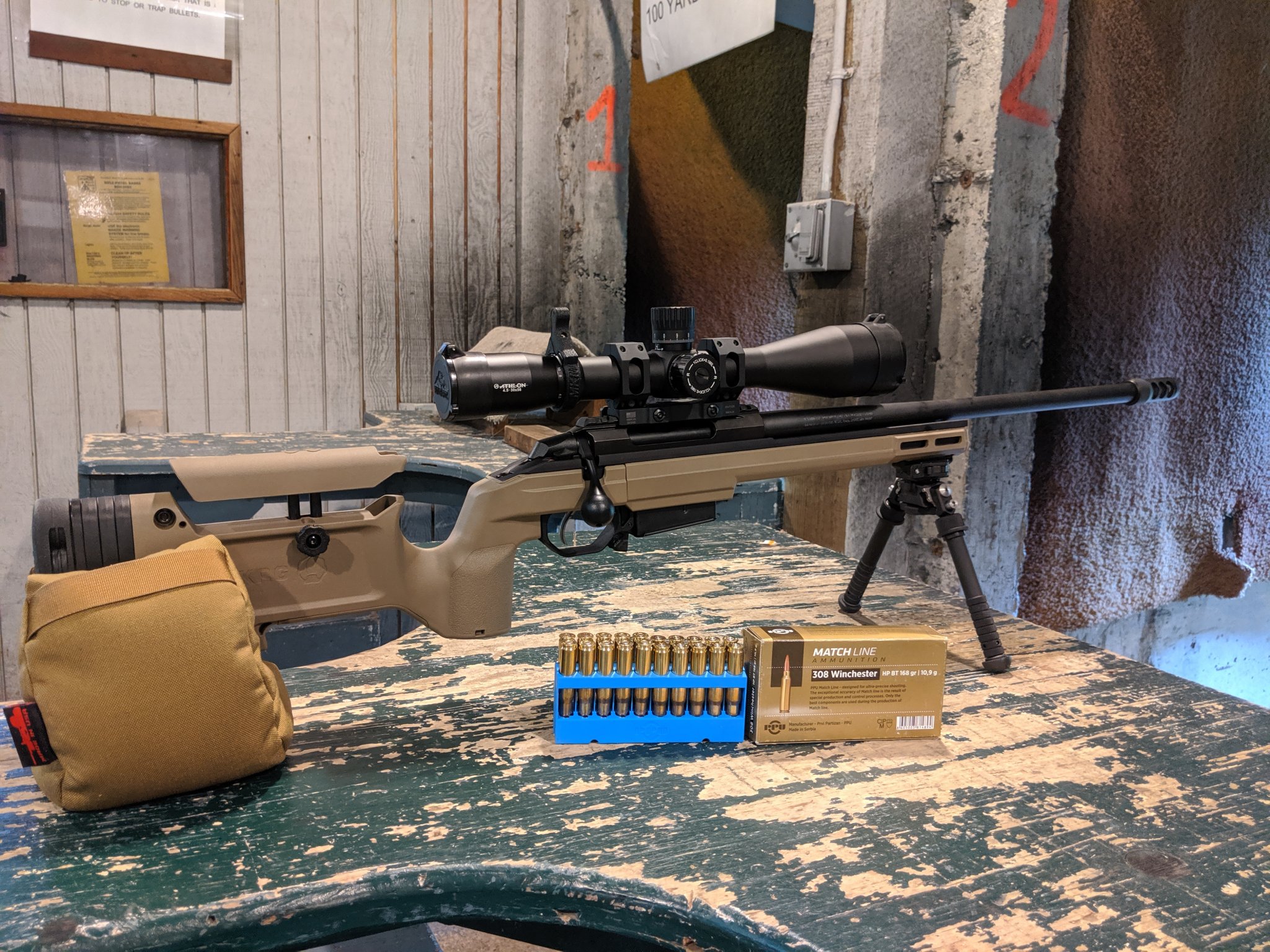

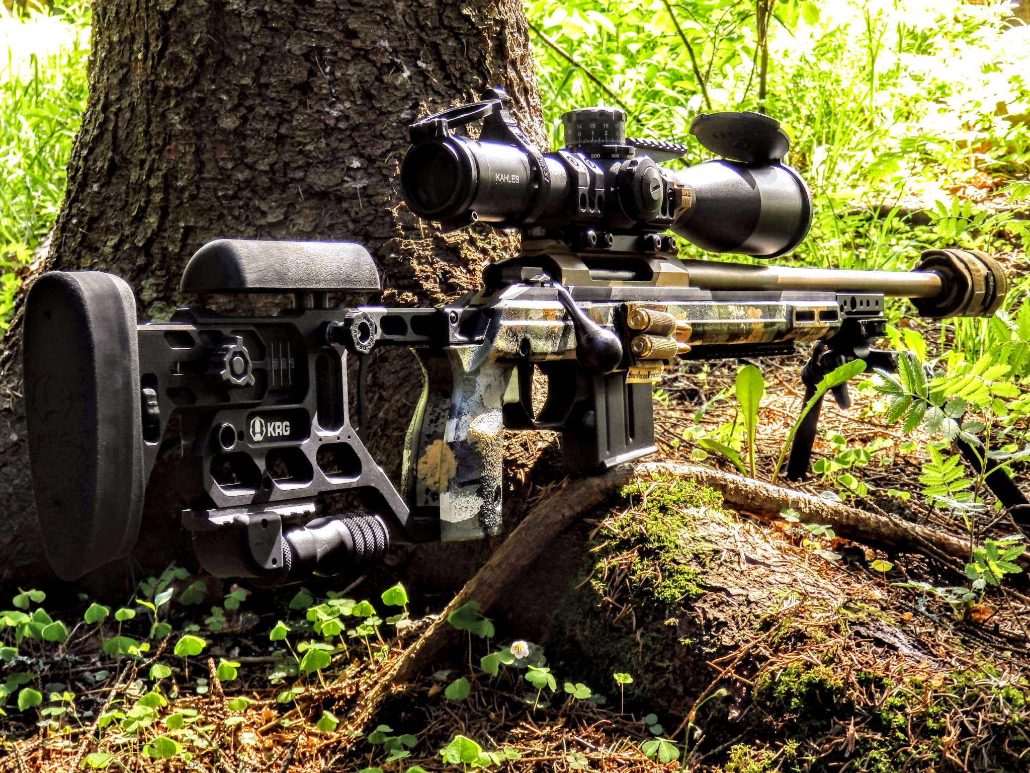

Finally got the rifle into a KRG Bravo! Ordered it yesterday morning, they shipped and it arrived today! Originally a Tikka T3X CTR. Oh the T3X Limb Saver also fits perfectly with the Bravo. I had to use some spacers to equal out the length of screw, but it's perfectly fitting which is great. I don't really need the limb saver anymore now that I put the Area 419 brake on though.
Trigger spring still stock while waiting for the Elay Precision spring to show up. The lowest I can get the weight down to is 2lb 6oz, that's when the spring hits the action screw.
First top left shot was cold bore. Then 4 shots grouped okay. Top right had a great group. Middle I pulled the last shot :(
7102752
7102753
@ 200 yards. I don't blame the rifle at all, or the ammo really. I just need to be a better shooter... It started getting breezy starting and stopping in between shots, so maybe that would affect a little, but most likely me. Looking at the charts a 5mph wind would be about 1-1.5" shift.
