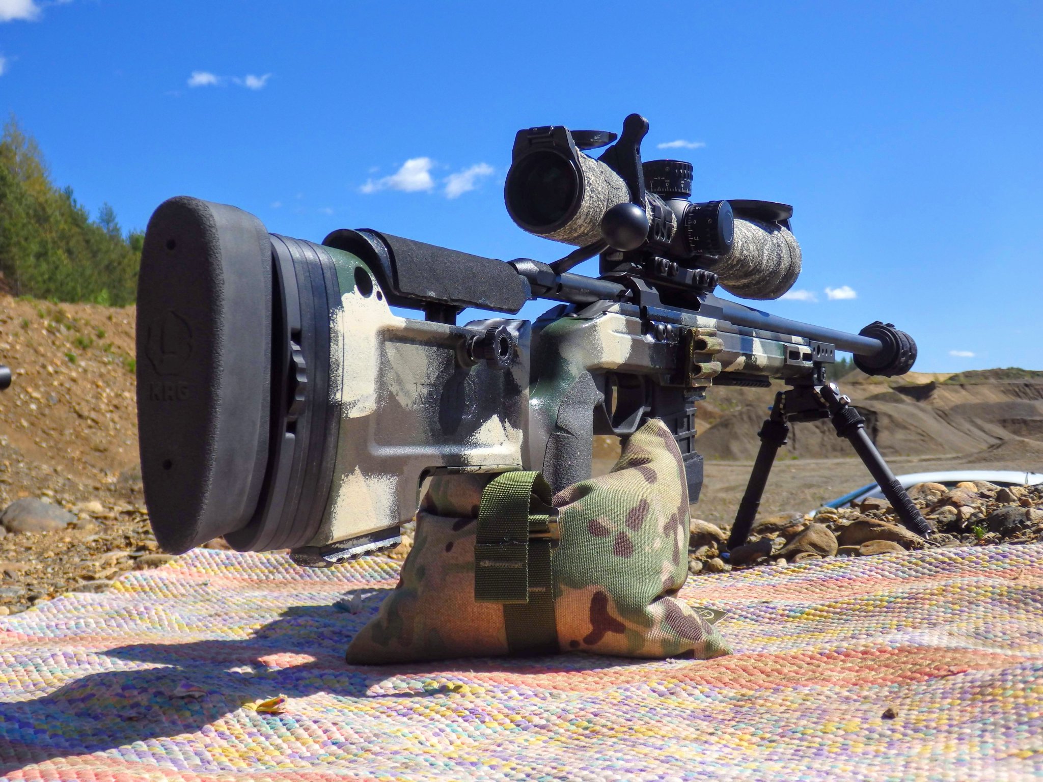

My left hand Tac A1 in the Whiskey 3.

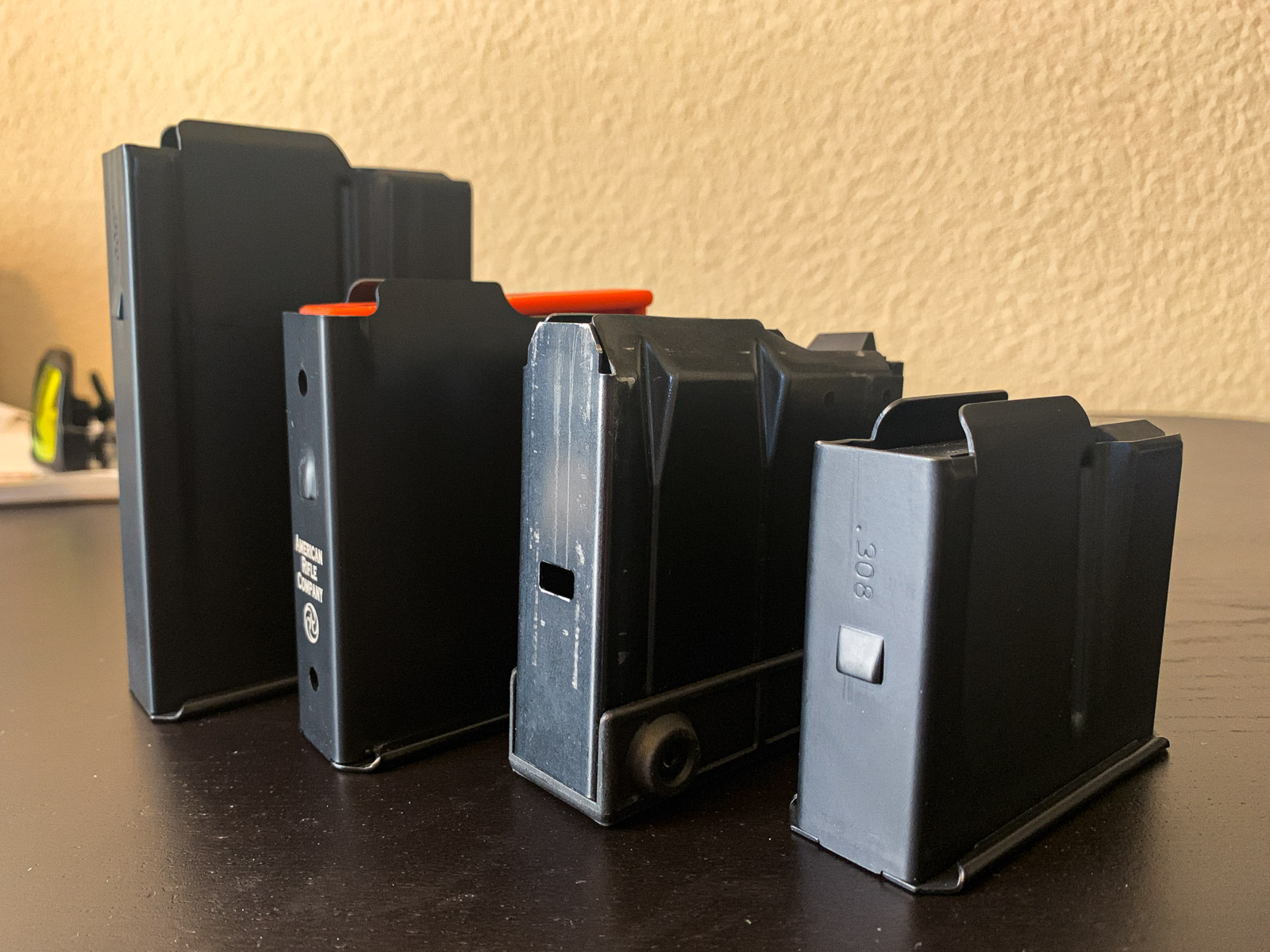

As far as I know the AICS mags should work fine if you don't want to wait. One big difference between AICS mags and the CTR ones is that the CTR ones are double stacked and much shorter. I think the 10 round CTR mag is only slightly taller than the 5 round AICS. Some people care about that and some do not.
-Stooxie
The ARC 10rnd mags will work and are nearly as short as the CTR mags.
From L to R - AICS 10rnd, ARC 10rnd, CTR 10rnd, AICS 5rnd.

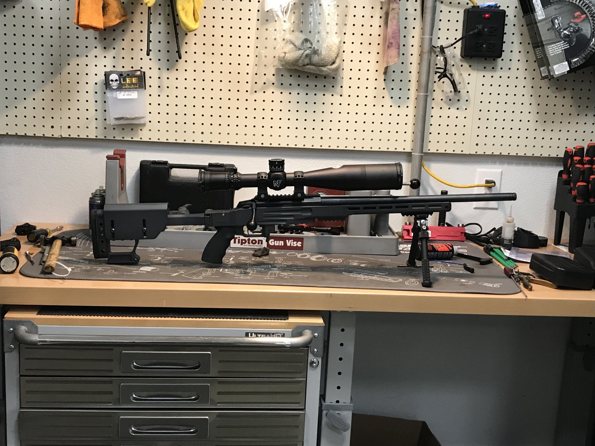

ETA: I’m diggin’ the tool storage under the workbench, what brand is that tool box ?
Not sure it’s at one of my local shops that lets me torque everything, level and boresight.

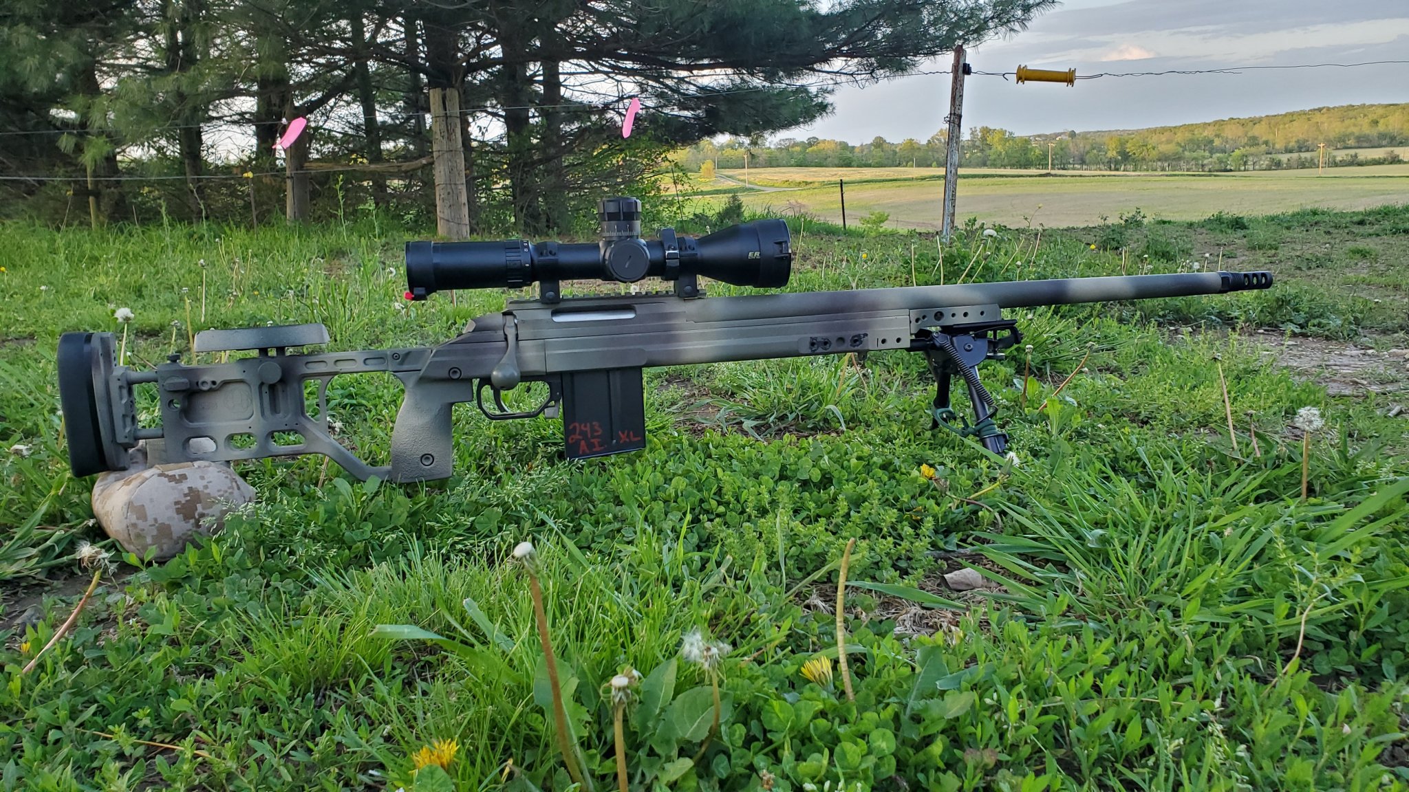

Older build, krg gen4 fixed, trued action, Krieger m24 24" 8 tw 243ai, trg22 trigger/safety/triggerguard. Old load was a mild 3125fps 105hybrid, I switched to 112 barnes and got a solid load at 3040, and .624bc is dead on. I figured I'd lose a little bc in an 8tw, but it jives out with shooter.
Had 2 loads of 112gr that shot great at 100 and had low single digit sd. Ran them both to 850. 47.0gr showed more vertical, 47.5gr did really well. Shot both on same piece of steel and I lost one of the 47.5 shots off target. It hit in line with the 3 and I called the one high when I squeezed it.

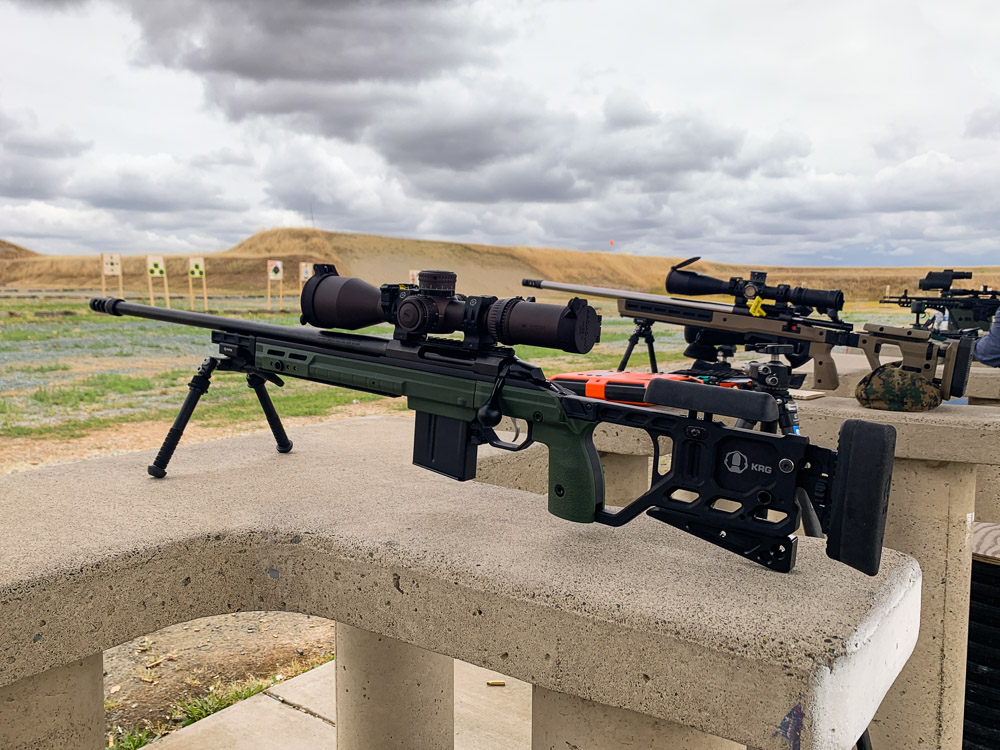

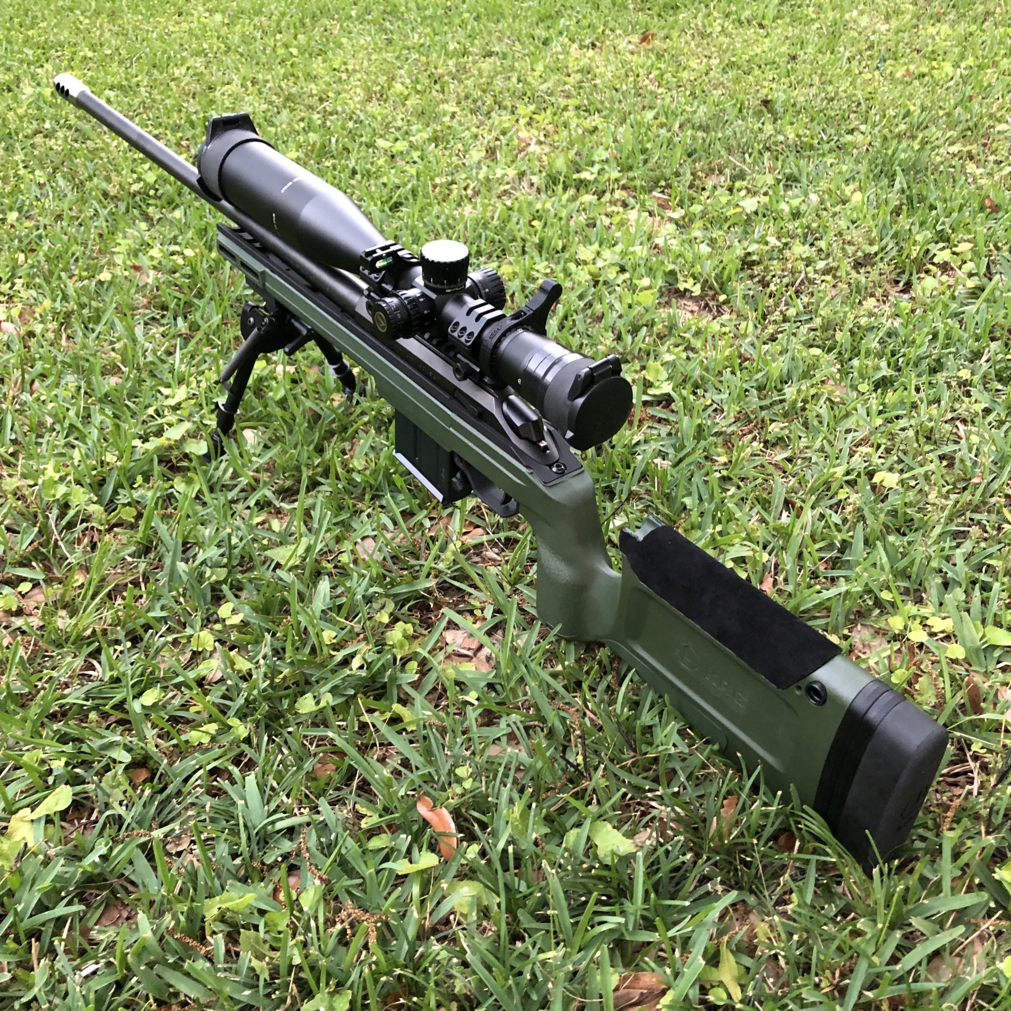

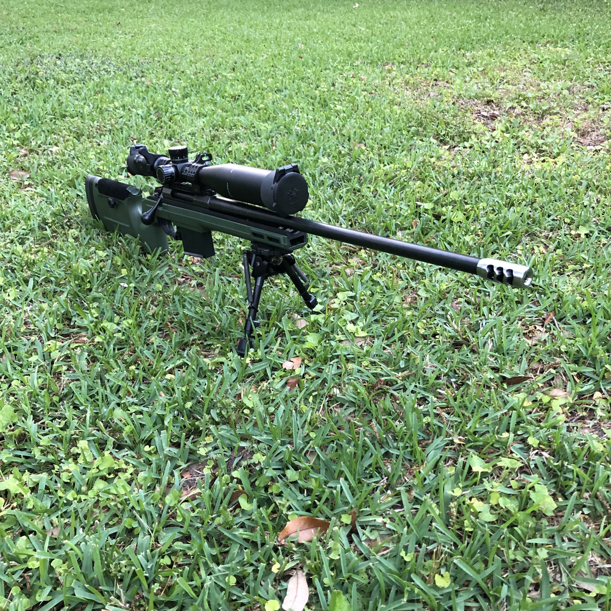

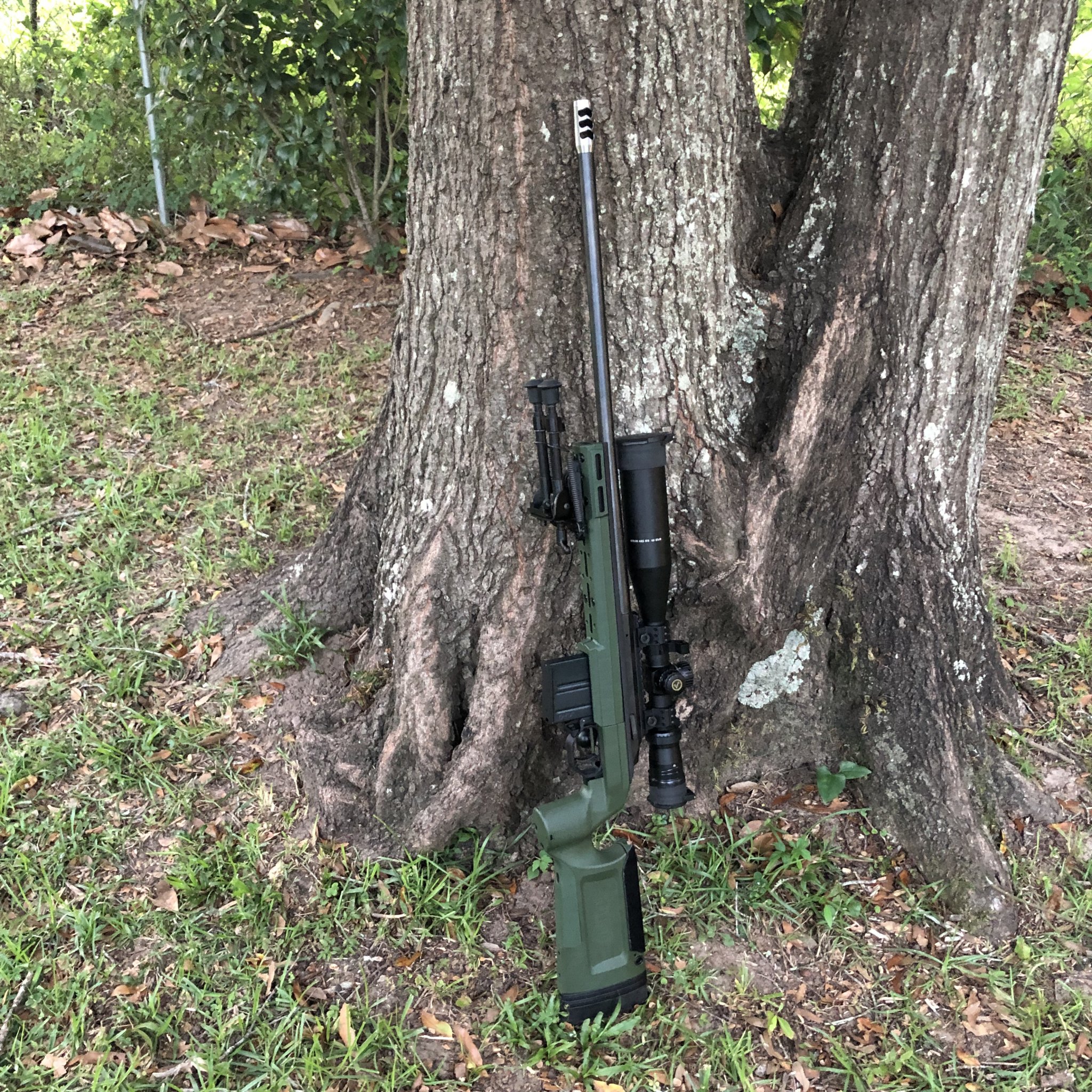

I got my @Massoud KRG Bravo last week and did some test fitting and turned it into a photo op

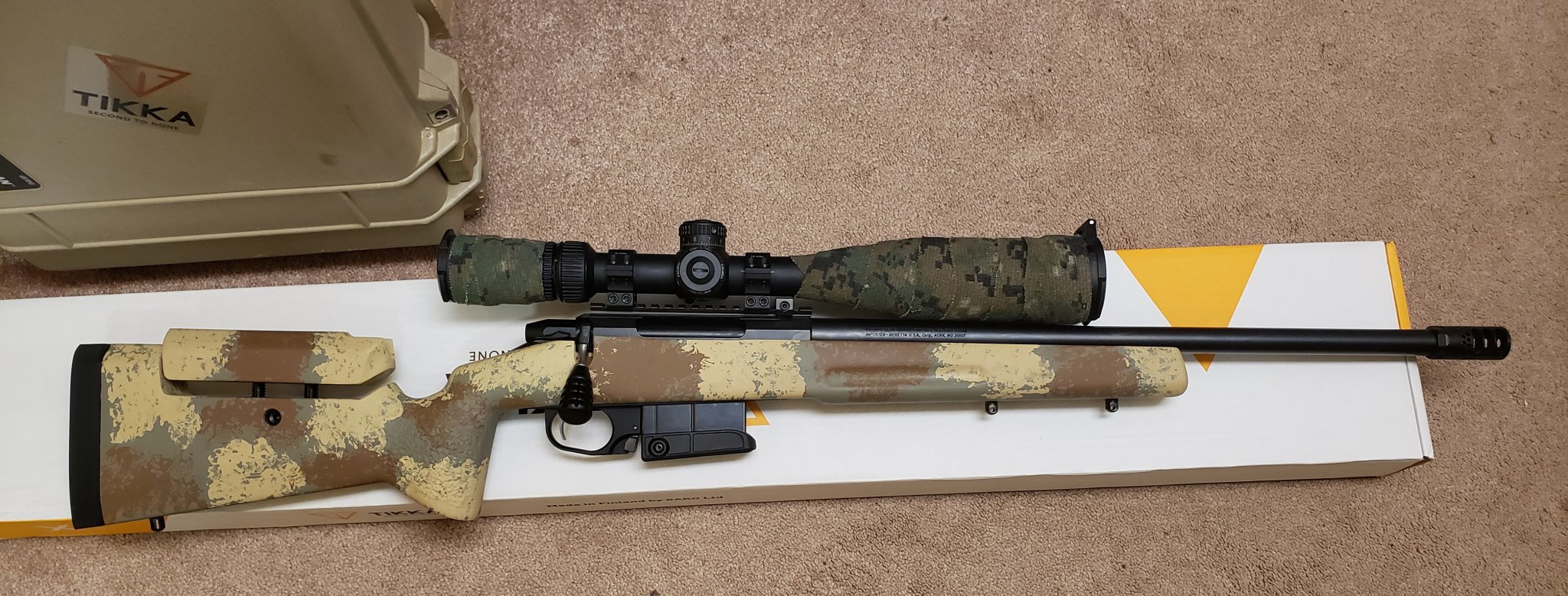

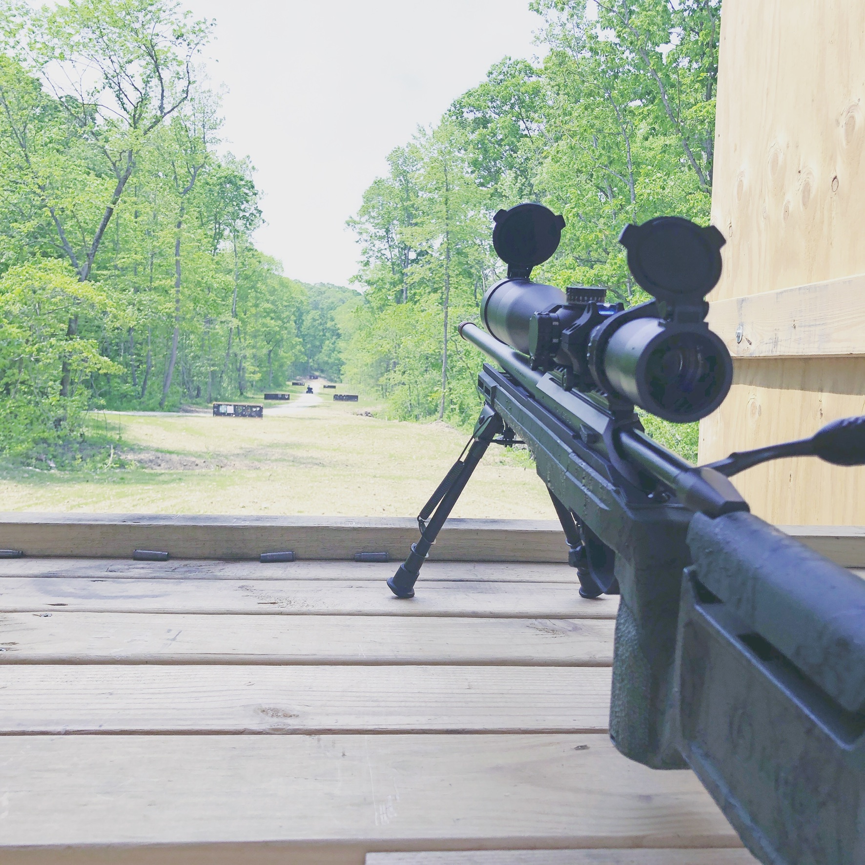

Evening All... just wanted to say that so many of you helped me without even knowing it on what rifle to step into, which it ended up being a Tikka T3 in .260 since I was able to find it locally “previously loved” for a really good price. The guy had put it in a T3X stock, that I sold and tossed into a Bravo Chassis. So Thank You to those that were super honest on good quality rifle, as I am digging it!

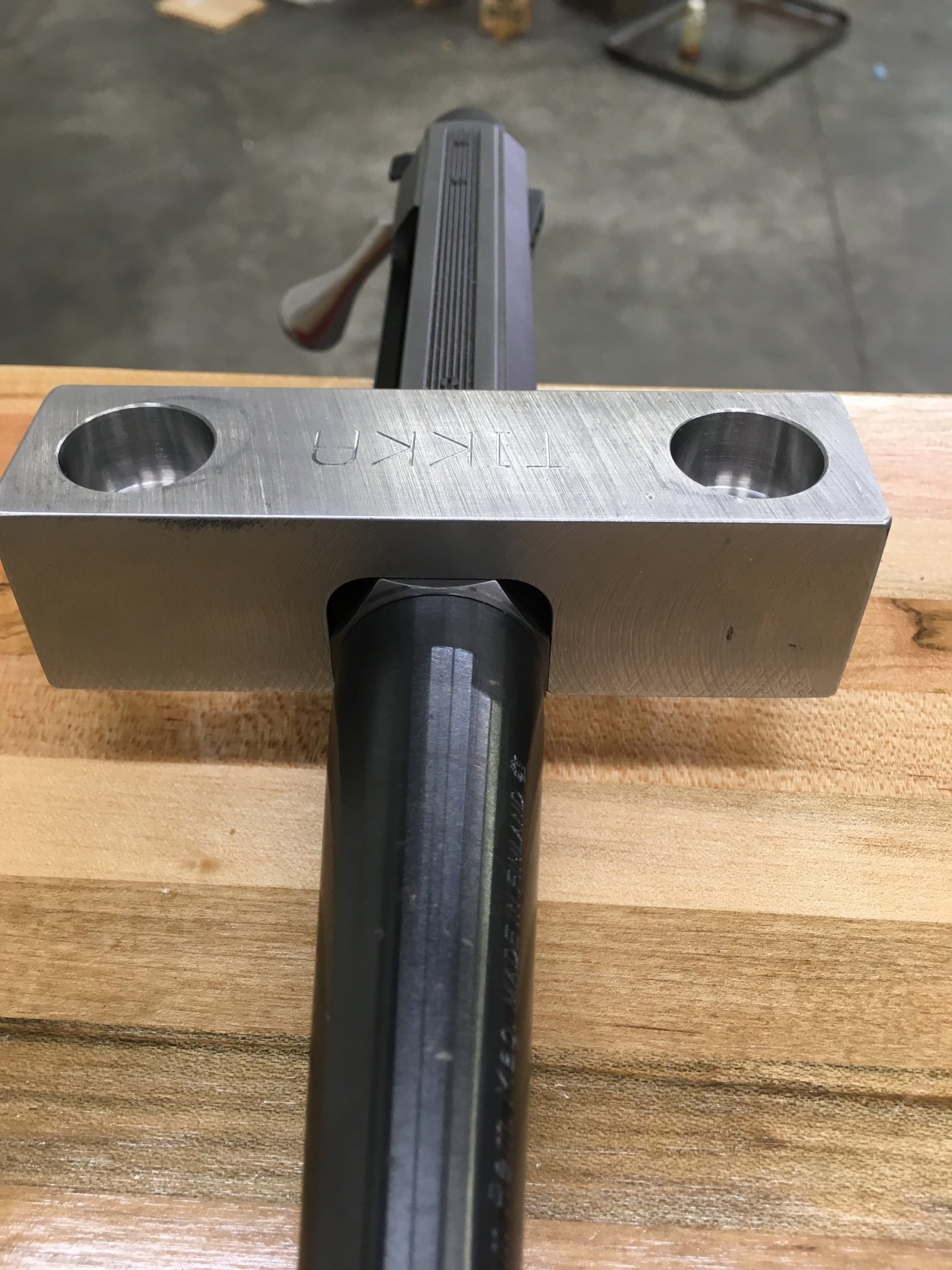

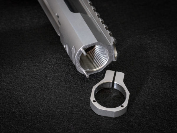

I'm not sure what is working for everyone, but this wrench has solved the sticky factory barrel removal issue. It has been a much better solution than putting the action in a vice or using a Remington wrench because it provides

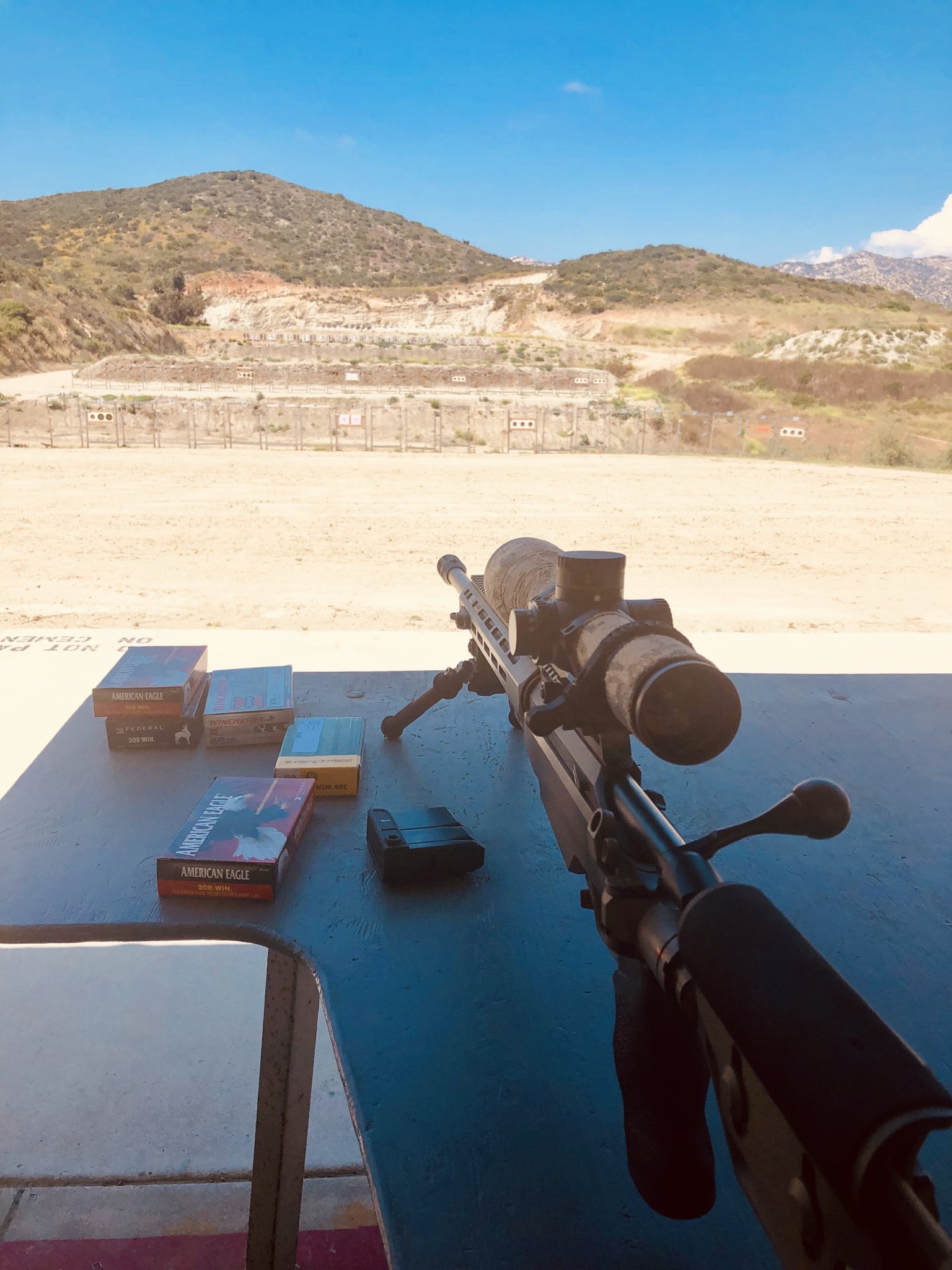

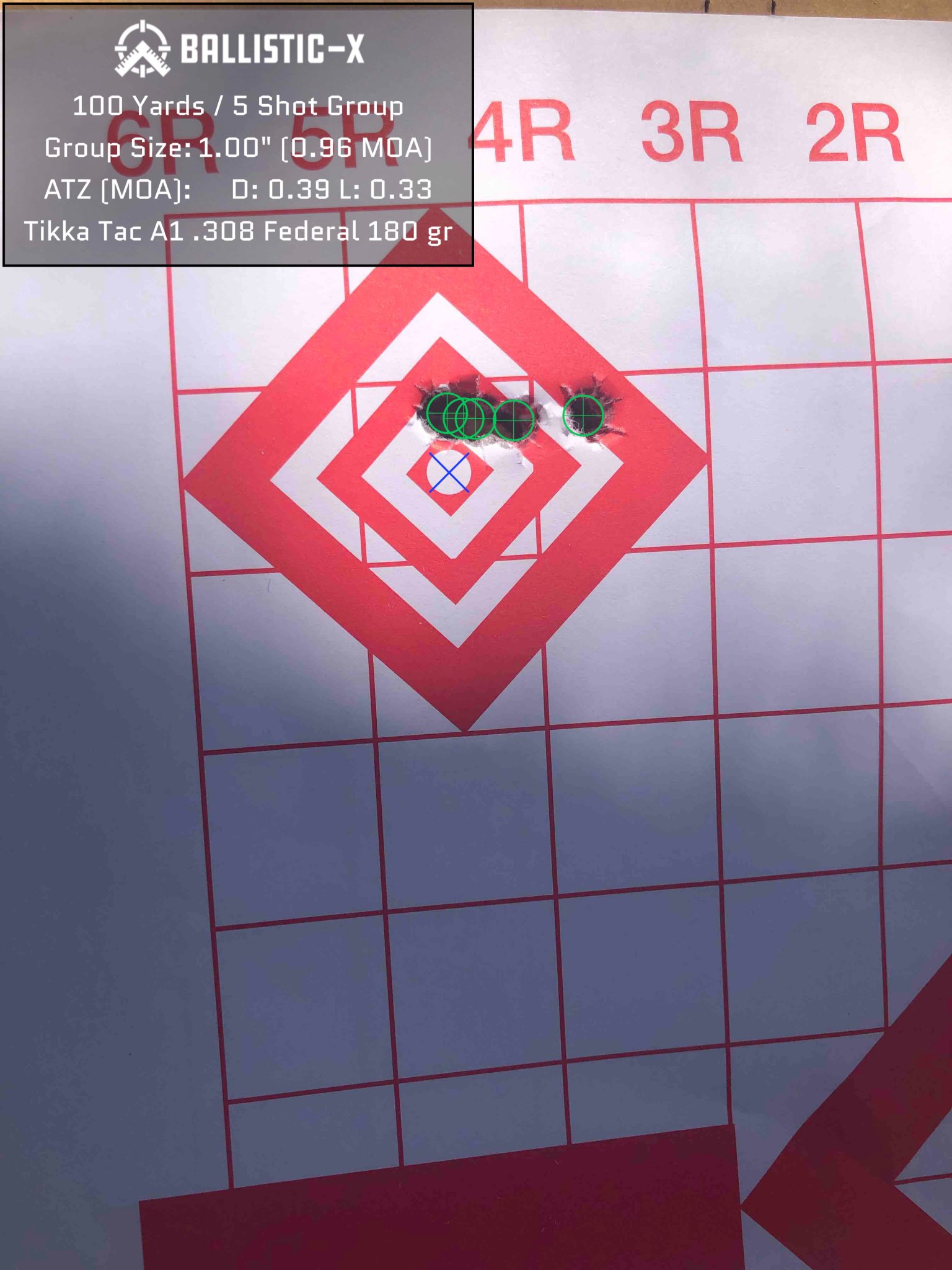

First range day out, sighting everything in and after about 30 rounds, started getting the dreaded failure to feed from the unseated magazine issue. I performed the notch mod and the mags, and they seat more firmly now. One of the better groups with crappy Federal.
What are you guys using for factory .308 loads that are grouping well?

I'm not sure what is working for everyone, but this wrench has solved the sticky factory barrel removal issue. It has been a much better solution than putting the action in a vice or using a Remington wrench because it provides View attachment 7089266purchase on the action's sides and top. I'm looking forward to WTO's tikka offereing and hearing from those who will use it. I've been very impressed with their rem 700 switch lug.
Where would one procure such hardware?

@HOLLYW00D I just spoke with Tim at Solid Accuracy about his Tikka Pre-fit barrels. He recommended the wheeler type action wrench flipped upside down so there are two flat spots. Brownell's has the same design for 39 bucks.
I appreciate the heads-up. I do have the Brownell's wrench, but would prefer to have contact on four sides of the action. If the above piece is publicly available somewhere, for a fair price, I'd love to own it.

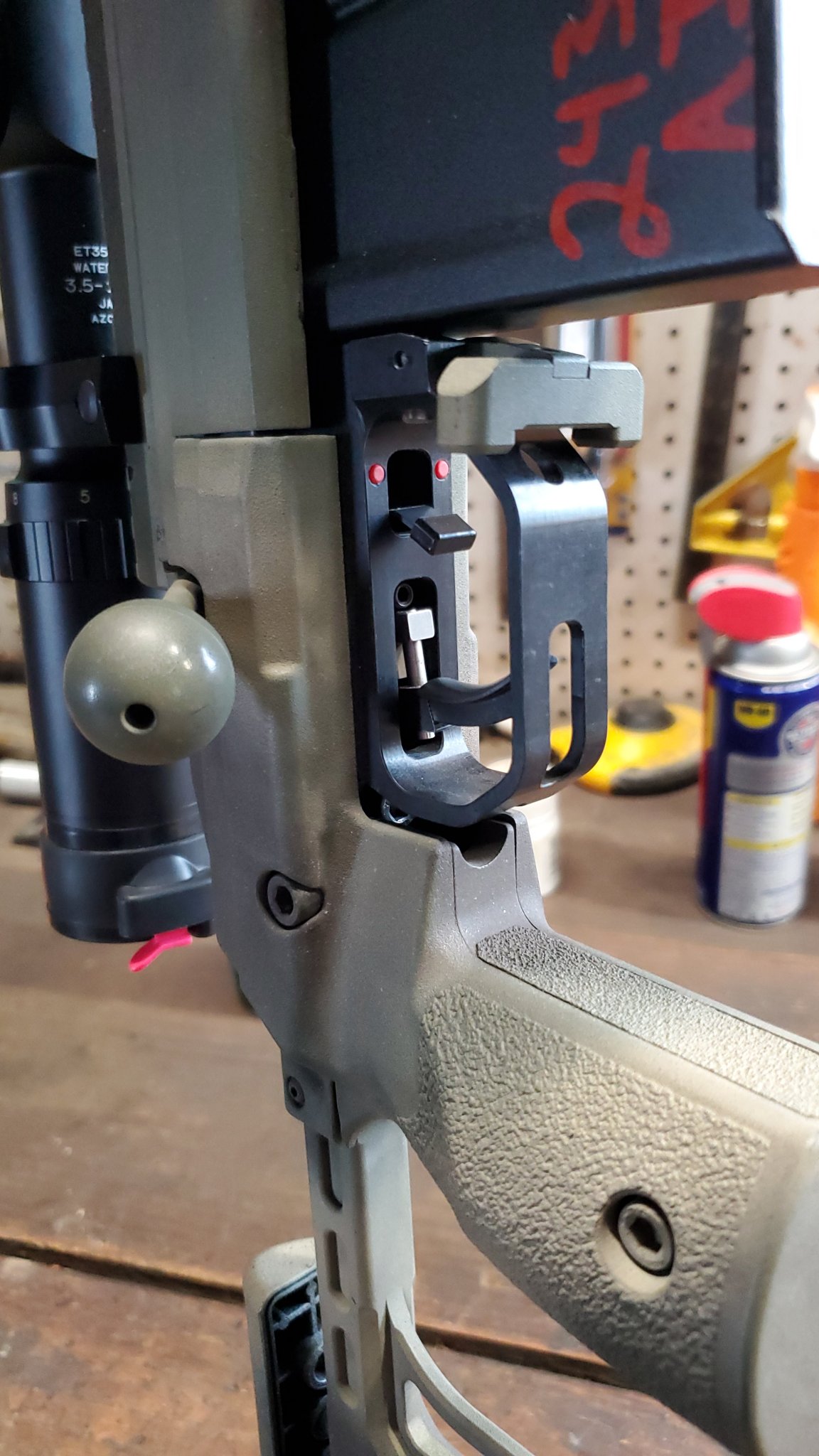

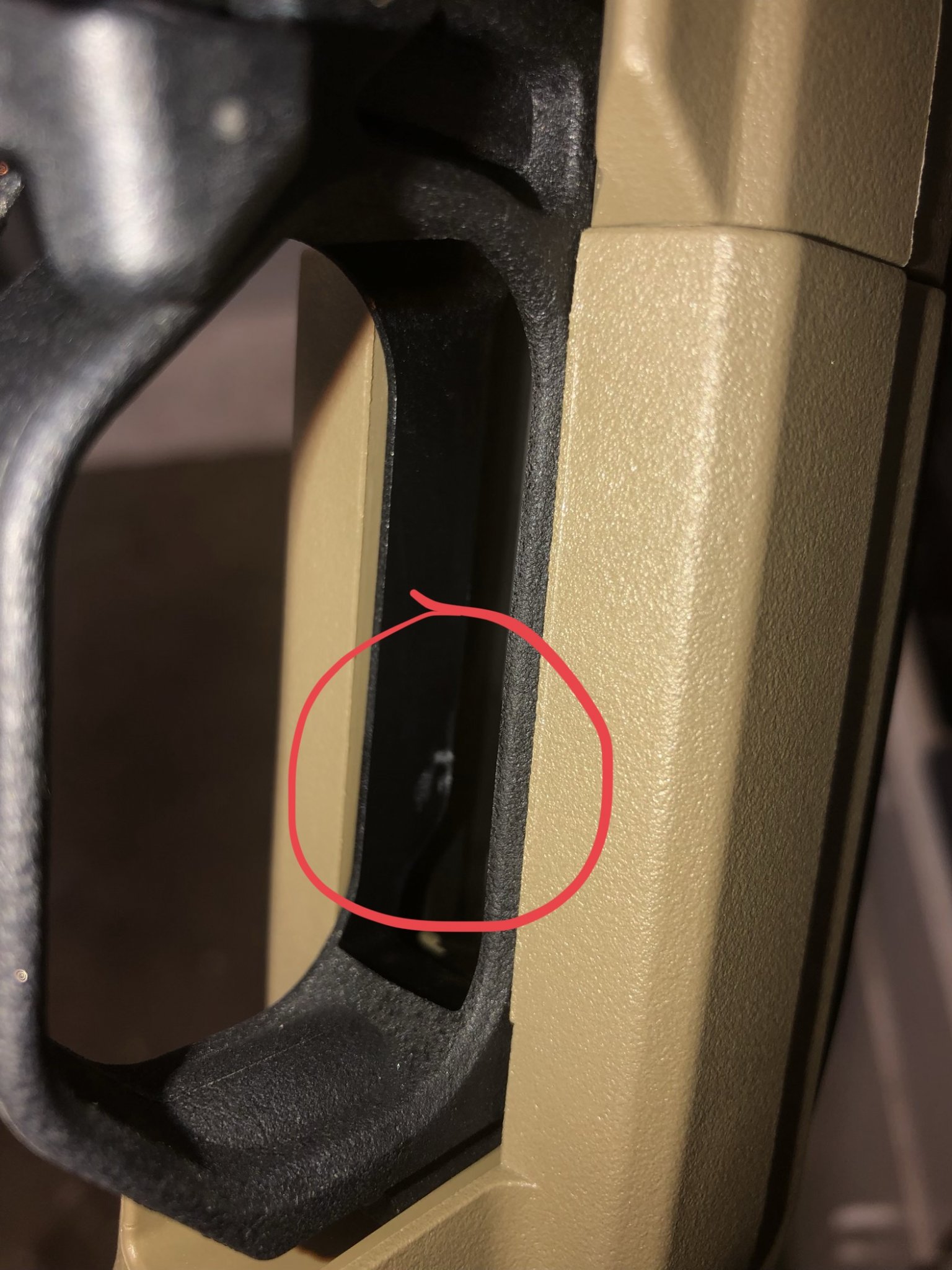

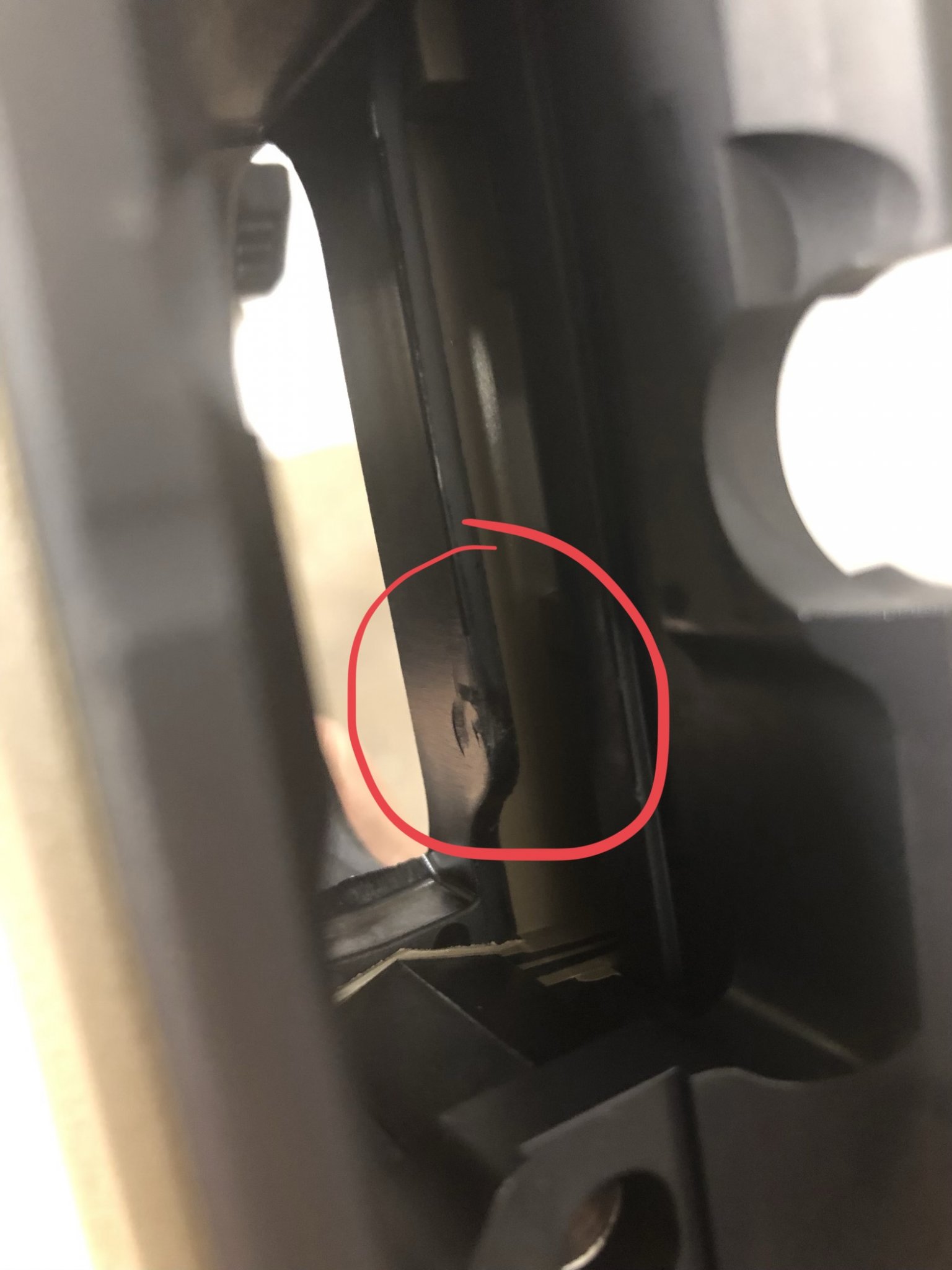

The safety is fine but the bolt release is a little sticky.
My trigger wouldn’t even fire, the safety link was binding so bad inside the Bravo trigger housing. KRG finally admitted that the Tac A1 is not compatible with any of their chassis systems, despite their website stating that “all T3” actions will fit, and an email from their CS directly.
Did they put the polymer or aluminum trigger housing on the Bravo for T3 versions? My Whiskey 3 has the aluminum trigger guard. Maybe thats the difference?
I think it’s polymer...I’m talking about the inside housing, not guard.

My entire trigger housing/guard is aluminum. I won't be back home till next week but can take some pictures to compare.
Sounds good...i had to return the KRG Bravo back to Brownells. Now I’m just running the original Tac A1 chassis, which is suitable.

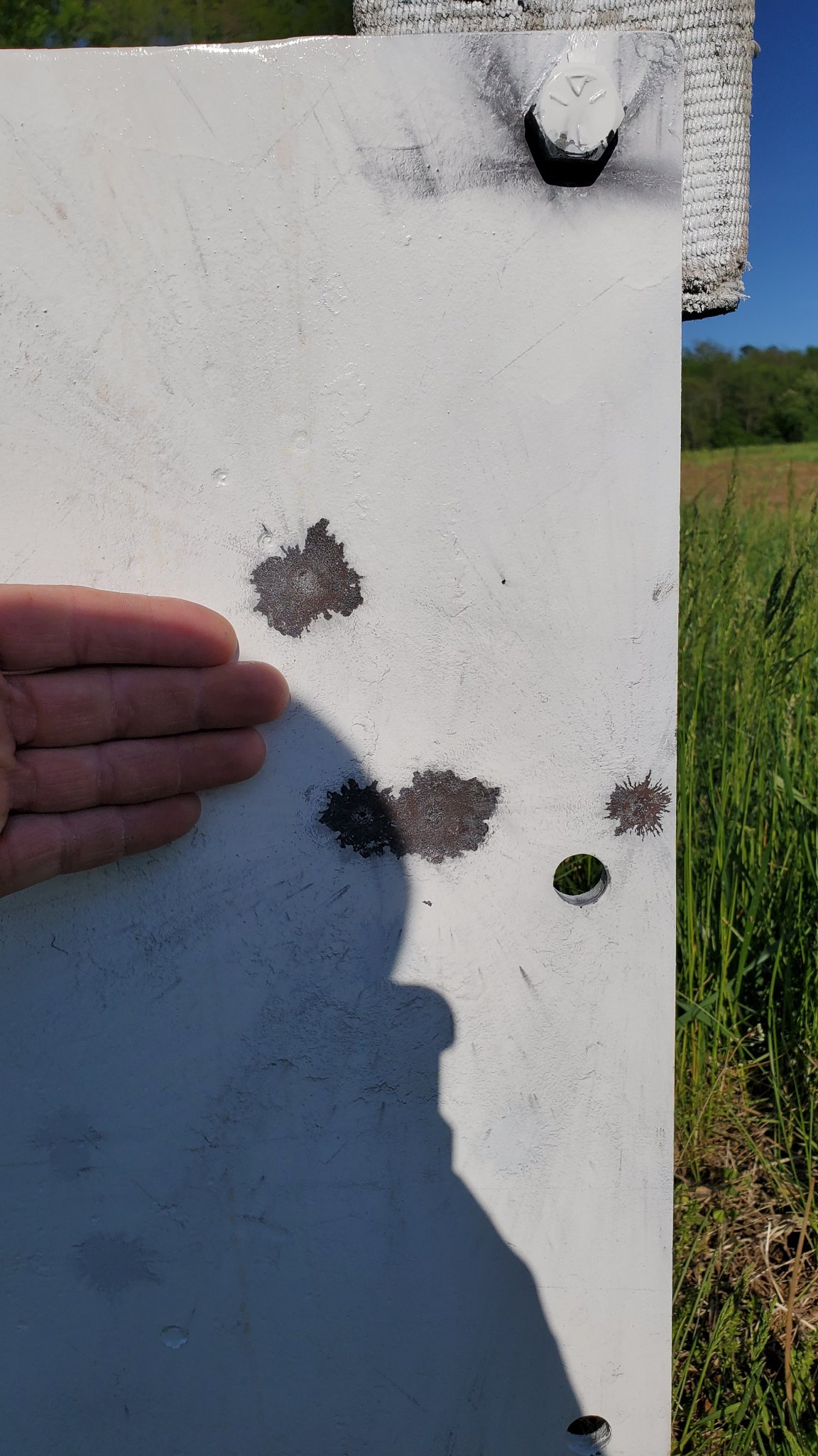

975yds, 243ai 112gr barnes at 3050fps. 6.2mils dialed up holding .5-.7mils for gusty winds. Was about .1mil above poa. First 2 shots were above my poa, so I held the same to verify dope. Last rd tagged the 6" swinger. I was happy with vertical, but i needed to tighten up my wind calls.
