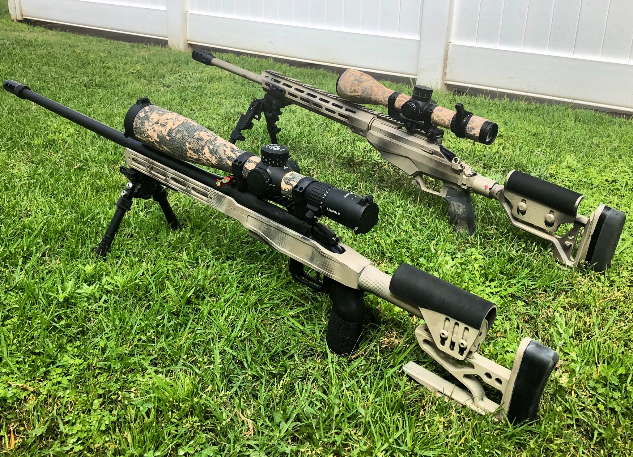

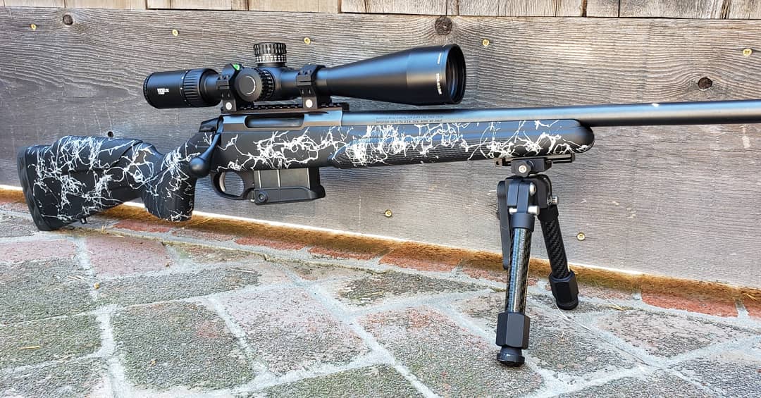

Will shoot this for the first time tomorrow but this has been awhile in the making...Manners PRS-TK1, left hand (first one in Australia), factory trigger with Yo Dave spring, Mullerworks medium palma 1:7.75 twist finished at 24" and cerakoted, Vortex AMG with MOA reticle in a Spuhr 3001 mount sitting on a Ken Farrel 30moa rail. Went with an Arca Swiss rail and picked up one of the new Atlas CAL bipods. She's chambered in 6XC and I've got a 419 Hellfire brake to go next week. Load development starts tomorrow with 105gr Lapua Scenar L, RDFs and Berger VLDs all getting a run in front of H4350. Oh yes, the action has also been cerakoted and the bolt microslicked. It has a Sterk titanium pineapple bolt handle and titanium shroud.
Will shoot this for the first time tomorrow but this has been awhile in the making...Manners PRS-TK1, left hand (first one in Australia), factory trigger with Yo Dave spring, Mullerworks medium palma 1:7.75 twist finished at 24" and cerakoted, Vortex AMG with MOA reticle in a Spuhr 3001 mount sitting on a Ken Farrel 30moa rail. Went with an Arca Swiss rail and picked up one of the new Atlas CAL bipods. She's chambered in 6XC and I've got a 419 Hellfire brake to go next week. Load development starts tomorrow with 105gr Lapua Scenar L, RDFs and Berger VLDs all getting a run in front of H4350.View attachment 7091578
Looks awesome man. Good luck with the rdf, I dont know anyone that has got them to shoot without flyers. Might want to check out the 112gr barnes and the 107smk. Pointed 107smk are same bc as 105 hybrids and shoot really well, without all the fiddling that hybrids need sometimes.
7091667
Looks awesome man. Good luck with the rdf, I dont know anyone that has got them to shoot without flyers. Might want to check out the 112gr barnes and the 107smk. Pointed 107smk are same bc as 105 hybrids and shoot really well, without all the fiddling that hybrids need sometimes.View attachment 7091667
Cheers mate. I've actually got the RDFs to shoot in another 6XC, a Kelbly Atlas in an MPA chassis. Same barrel specs as the new one above - 60 thou jump has them working alright but I did sort them by weight as Nosler has some shocking weight variation with these bullets - a 500 pack resulted in 7 batches with the lightest bullets 104.50gr and the heaviest at 105.20gr for a 0.7gr variation...

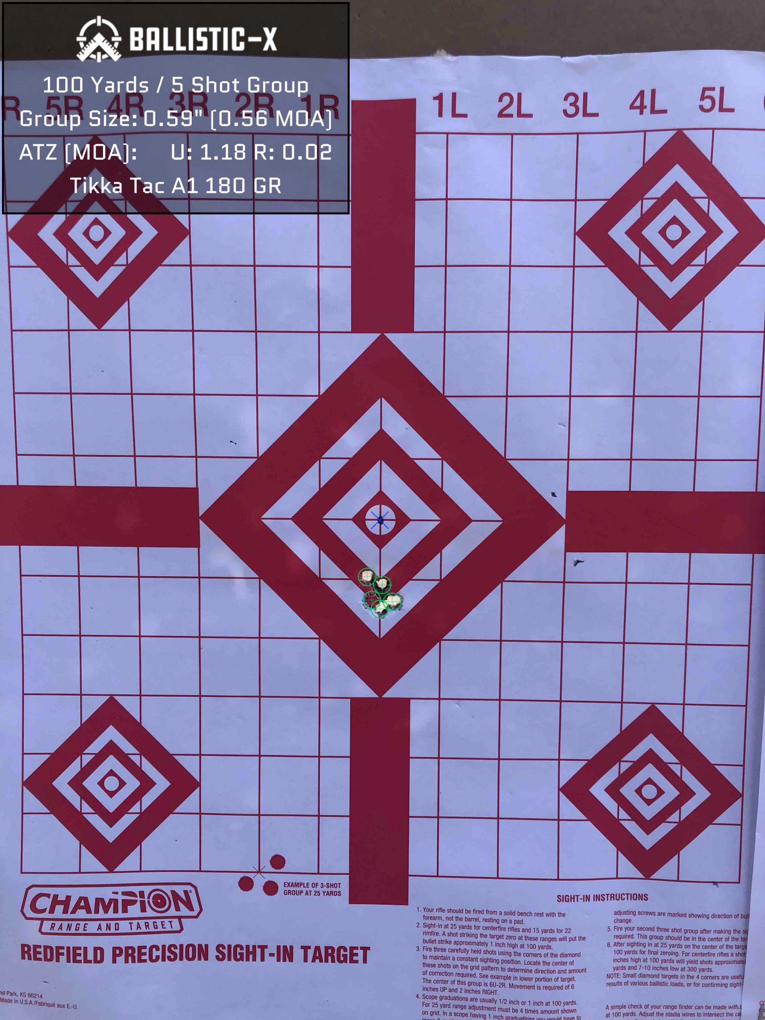

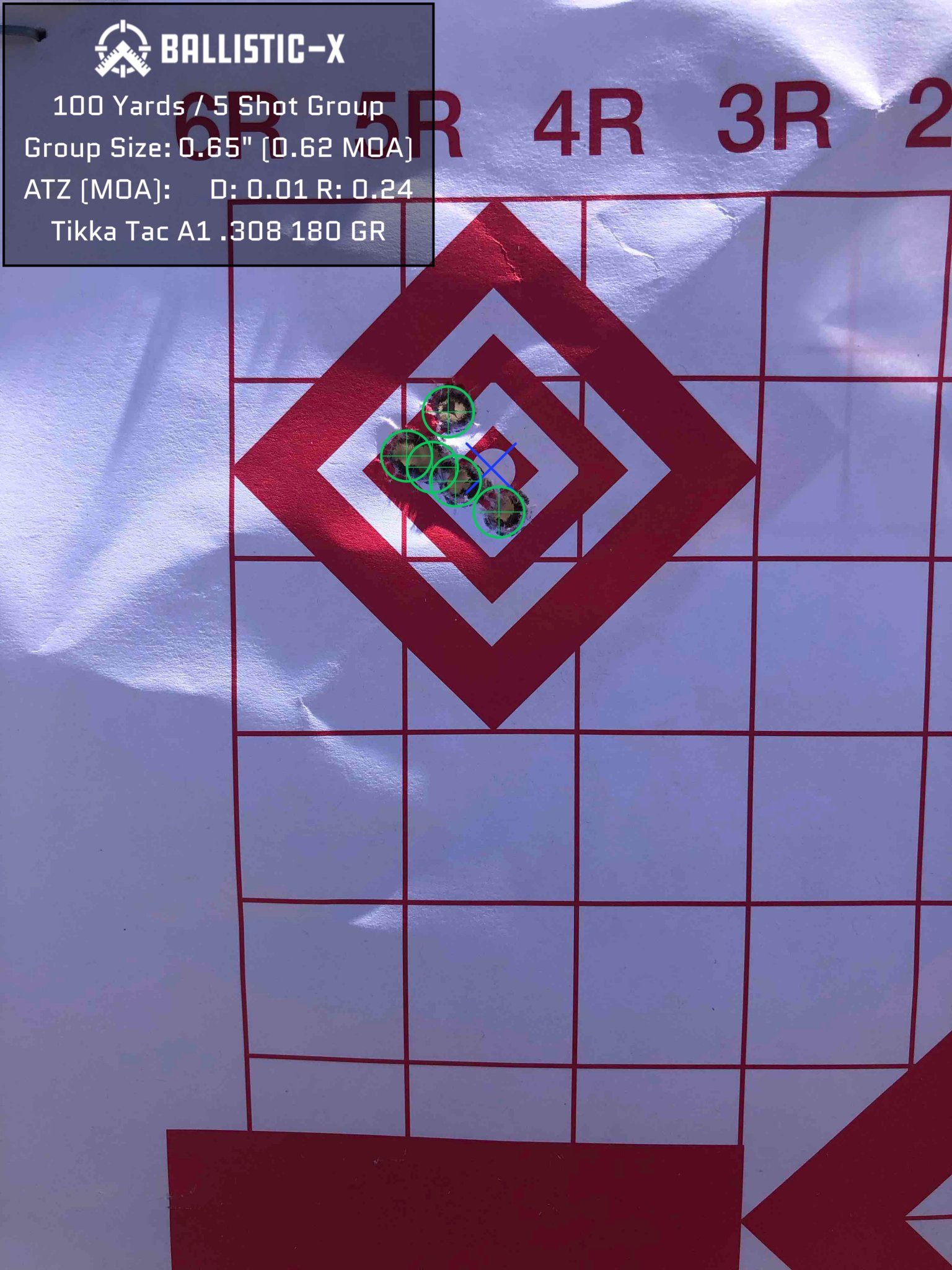

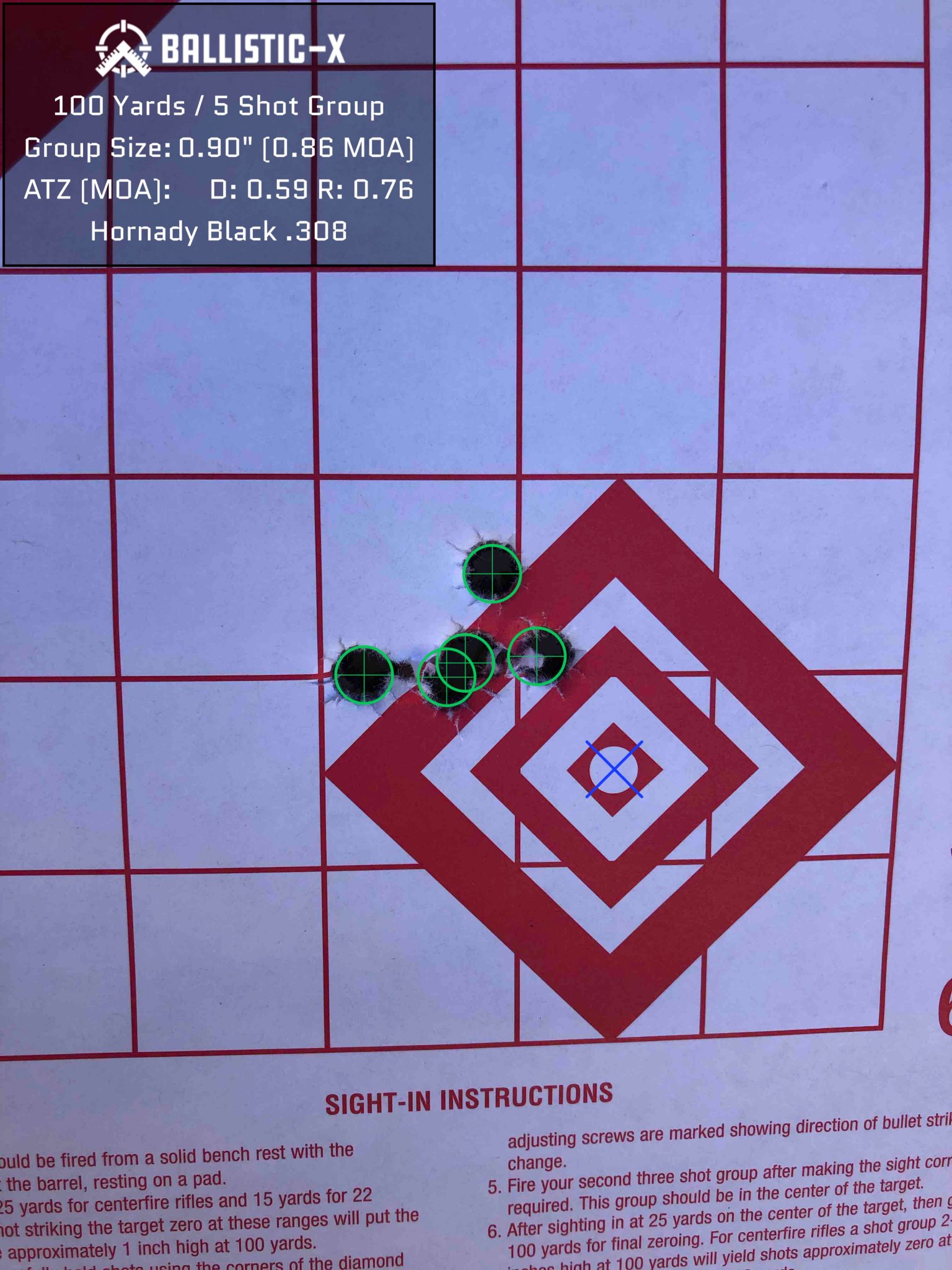

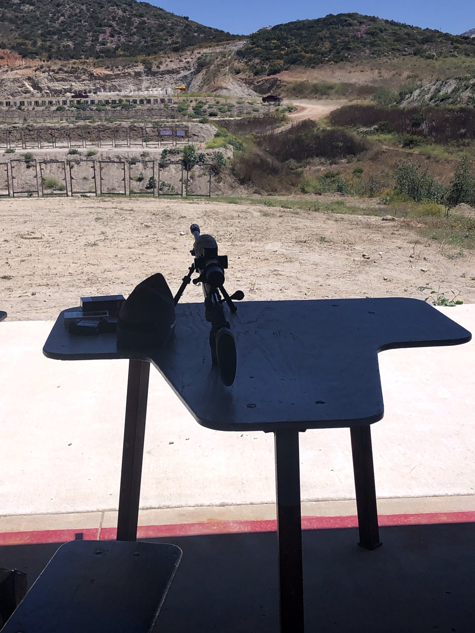

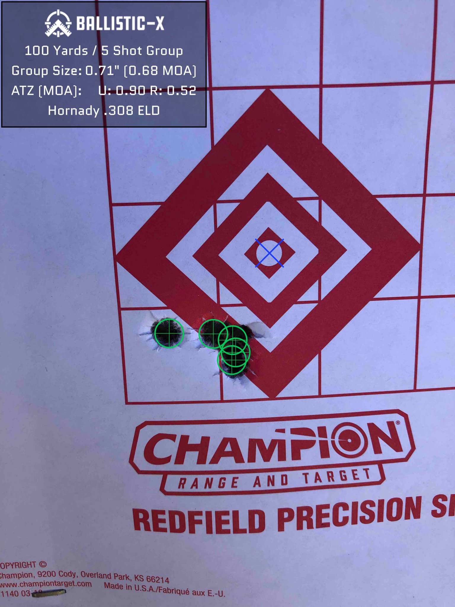

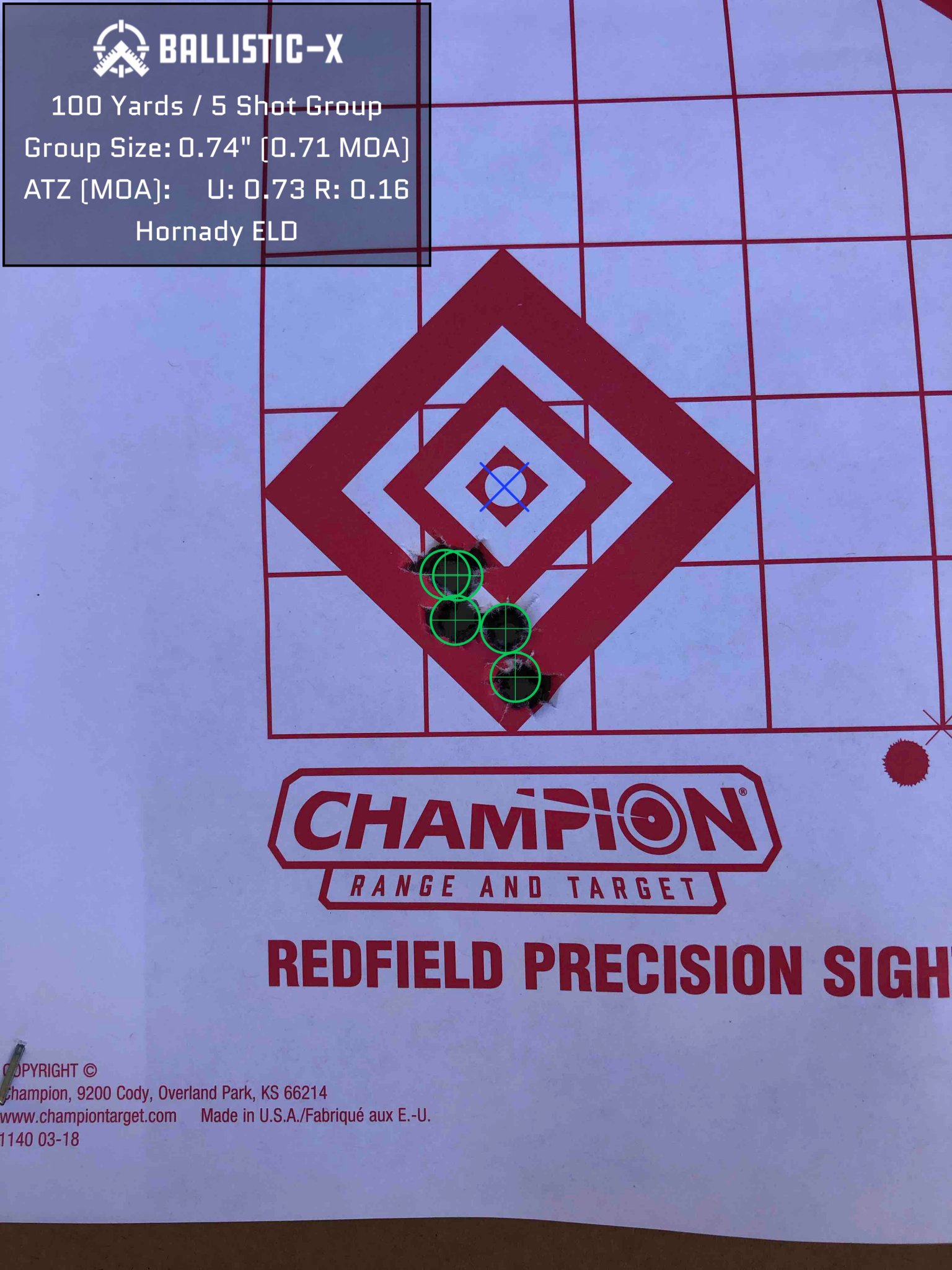

Starting to dial in the .308 Tac A1. The Hornady Black and ELD was shooting pretty close to each other. Wind was gusty as well, but not bad overall.

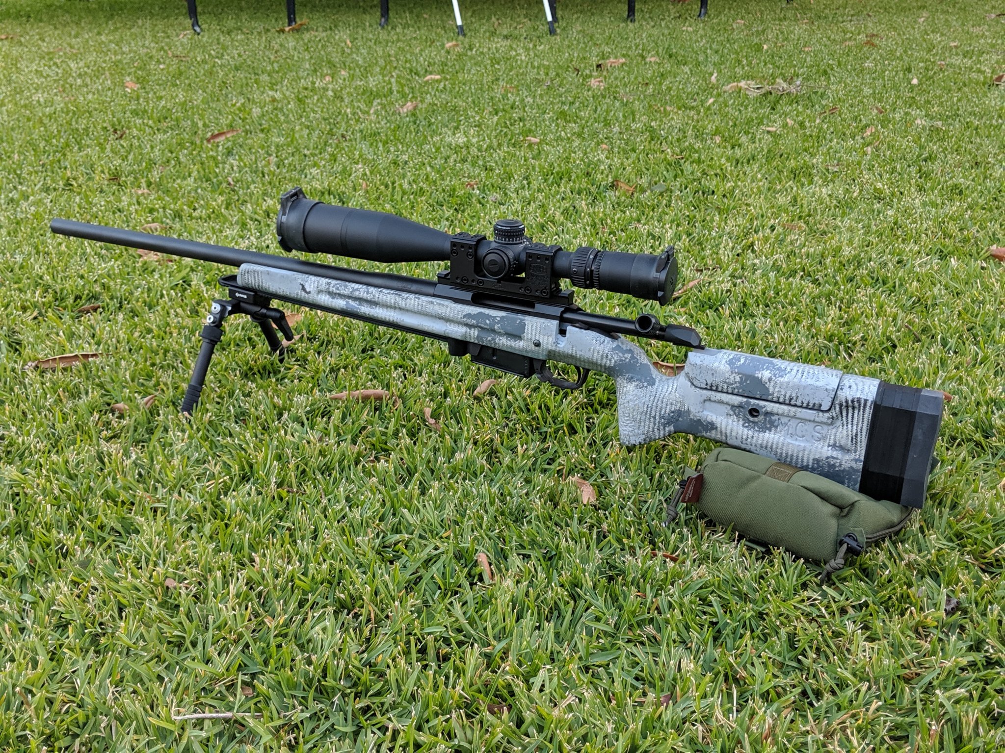

Had a Lilja 308 barrel fitted into a 25-06 T3, Atlasworx aics floor plate and PSE carbon E-Tac stock, 3 pos safety. Was a lovely setup but went to fund new projects.

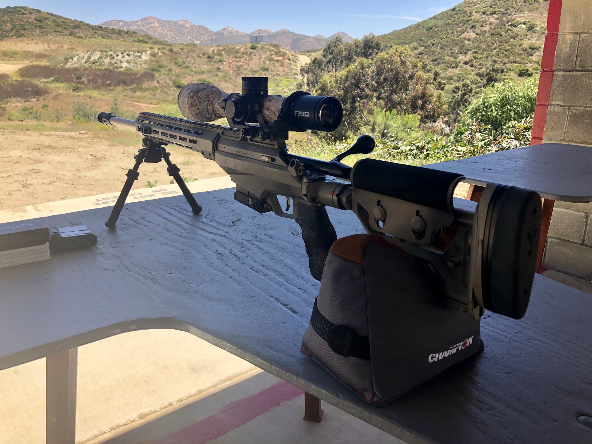

First range day out, sighting everything in and after about 30 rounds, started getting the dreaded failure to feed from the unseated magazine issue. I performed the notch mod and the mags, and they seat more firmly now. One of the better groups with crappy Federal.
What are you guys using for factory .308 loads that are grouping well?
Is that neoprene tape on the cheekpad?
Where did you get it?
