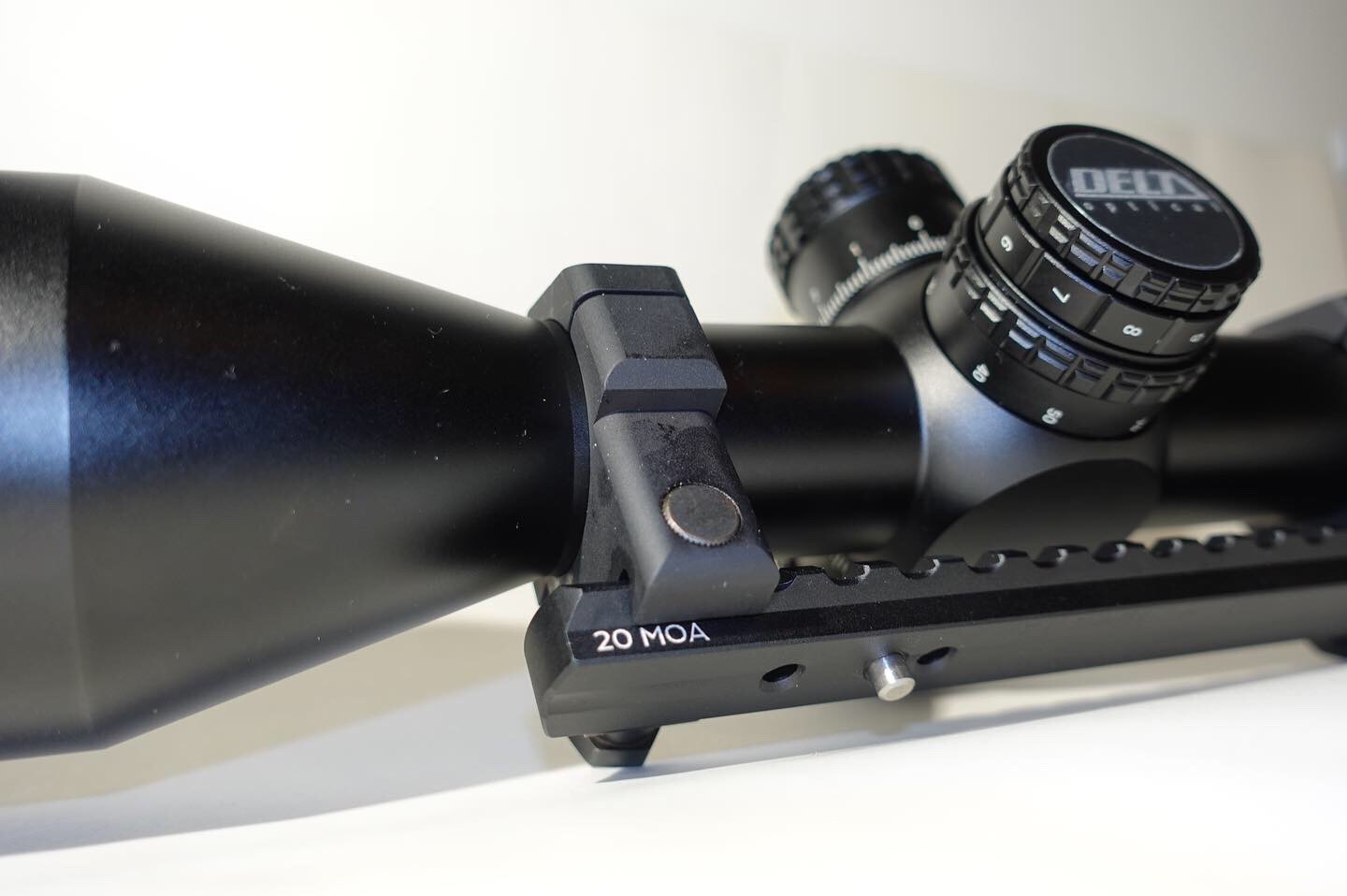

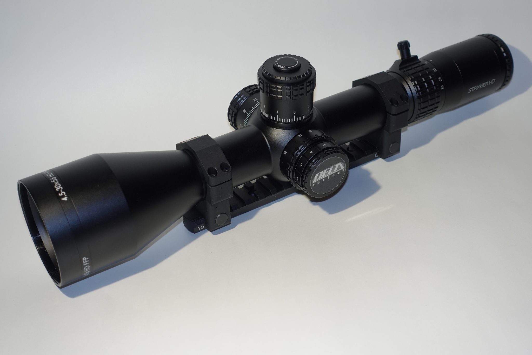

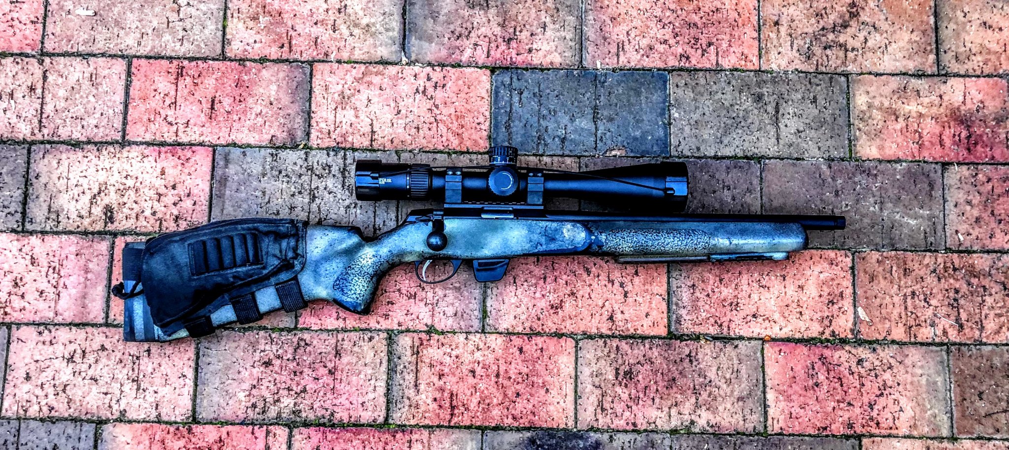

New optic for the T3 Creedmoor project.
Just posting a a few photos as a reference point for those looking for rails and rings.
Scope - Delta 4.5-30*56
Rings - Badger 34mm Alloy Medium
Rail - MDT 20 MOA with Recoil lug

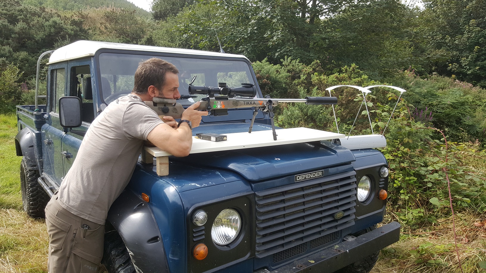

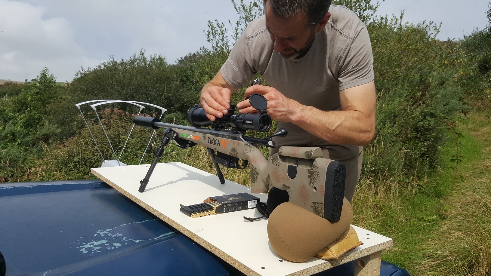

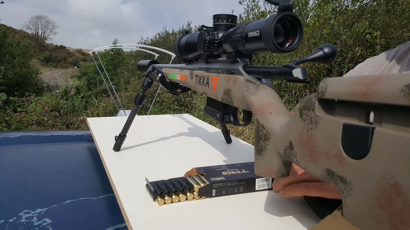

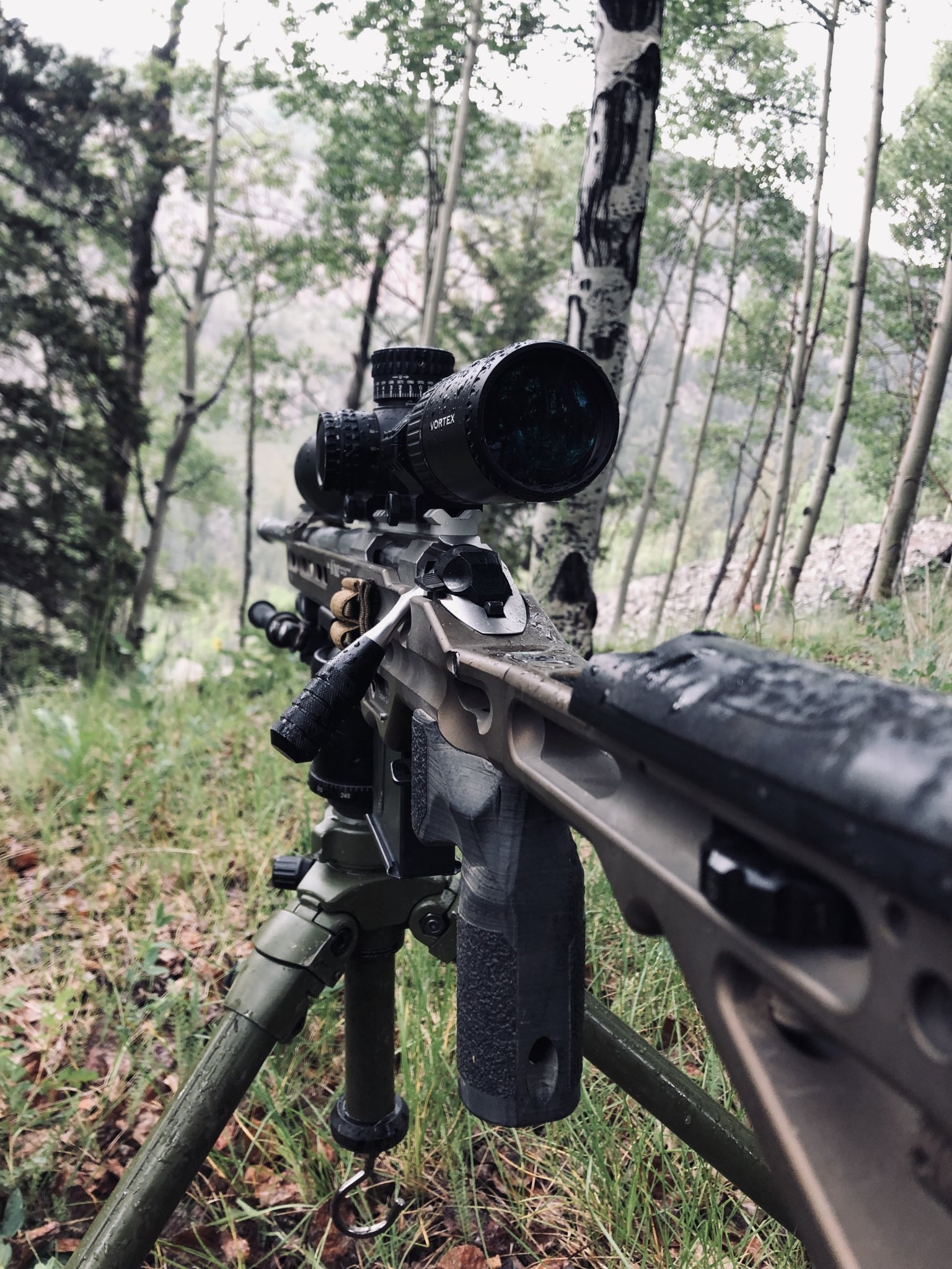

The Guardian Long Range will hold a comp in Ireland end Sept and guys here are very exited about it and prepping like mad.
This rifle is a test to see how competitive a factory rifle is once combined with an aftermarket stock and using factory ammo. The T3 CTR 6.5CM 24" is dropped in a factory bedded stock so no extra work apart from tightening 2 action screws is needed. No load development …. just using Sako factory ammo TRG 136gr (Scenar L). (av around 2750fps from the 24" CTR) New Spartan bipod on test.

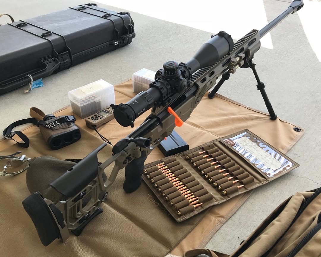

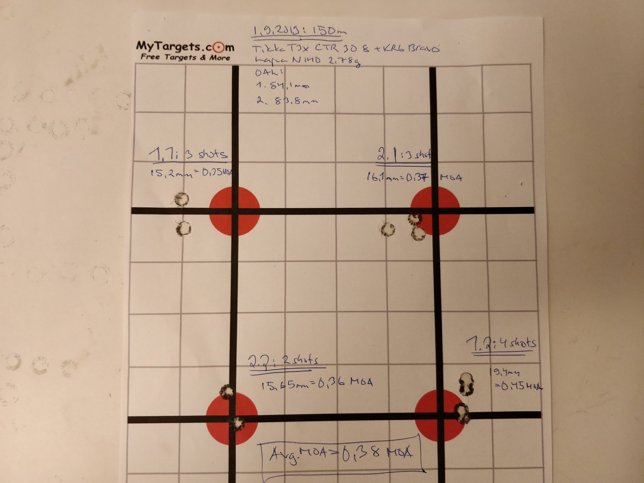

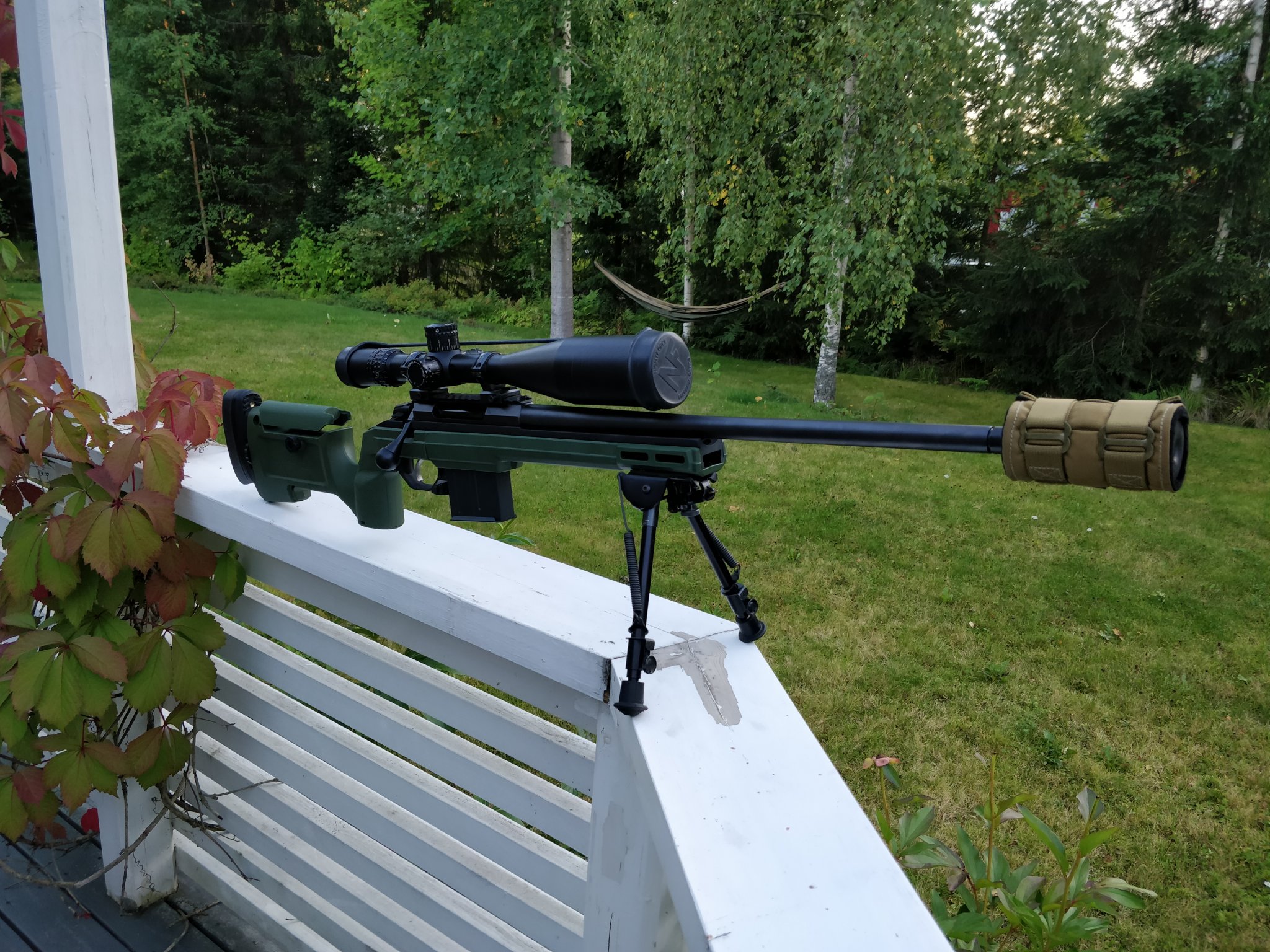

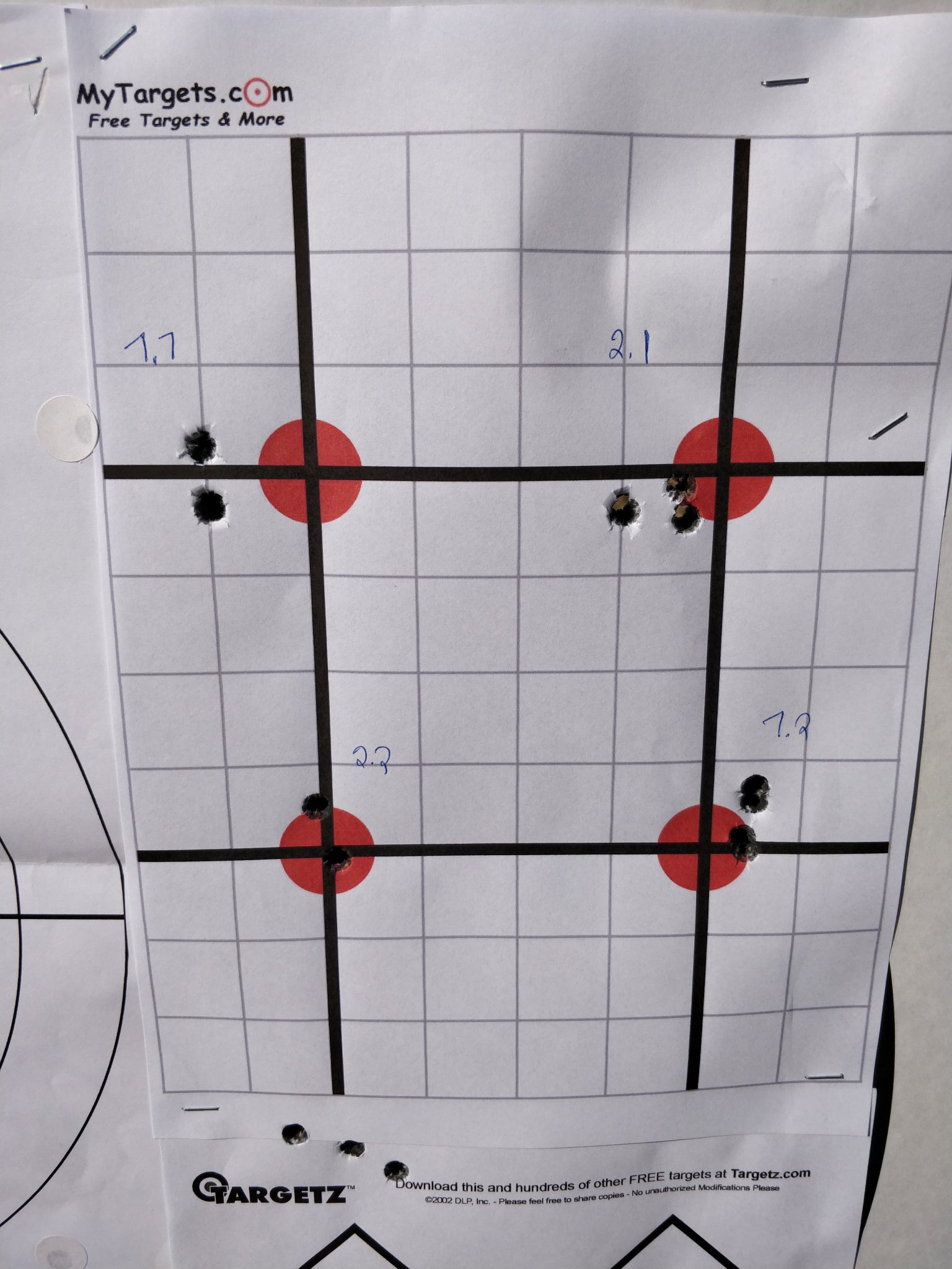

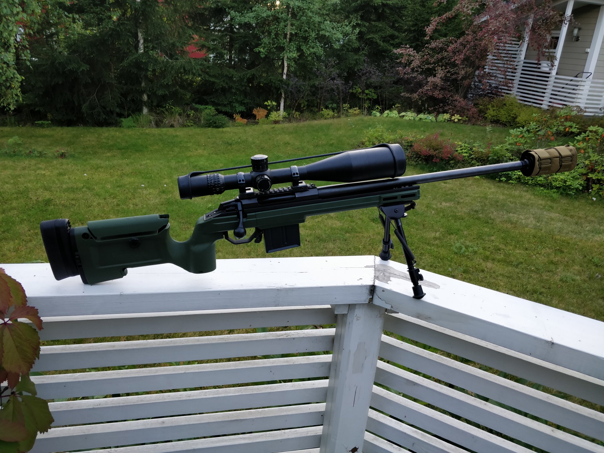

First time in the range with KRG Bravo chassis with Tikka T3x CTR 308 rem, AseUtra SL5i silencer, Harris bipod.
Shooting distance was 150 m. Reloading was Lapua Scenar 10,85 g, Lapua powder N140 2,78 g, CCI primer (Sorry about those metric values!!!)
What a great combo(y);)
Average groups was 0.38 MOA and I am not a sharp shooter…..

Not sure what’s nicer, but I’m leaning towards the Defender.

Let me know how you like that Spartan bipod. I have the Javelin and I love it. They let me play around with the one you have at the sportsmans expo here in Utah and it was awesome!

The chap in the pictures is a customer and friend... I took the pictures and we also made the stock. He was involved in the development of the heavy duty bipod /tripod range with Rob from Spartan as well as writing for gun magazines. We had also flush fitted a universal adapter into that stock just in front of the floor plate. Javelin/spartan 300 or tripod can fit into that.
For myself I use the Javelin /Spartan 300 bipods and one of their tripods mainly for the spotting scope .

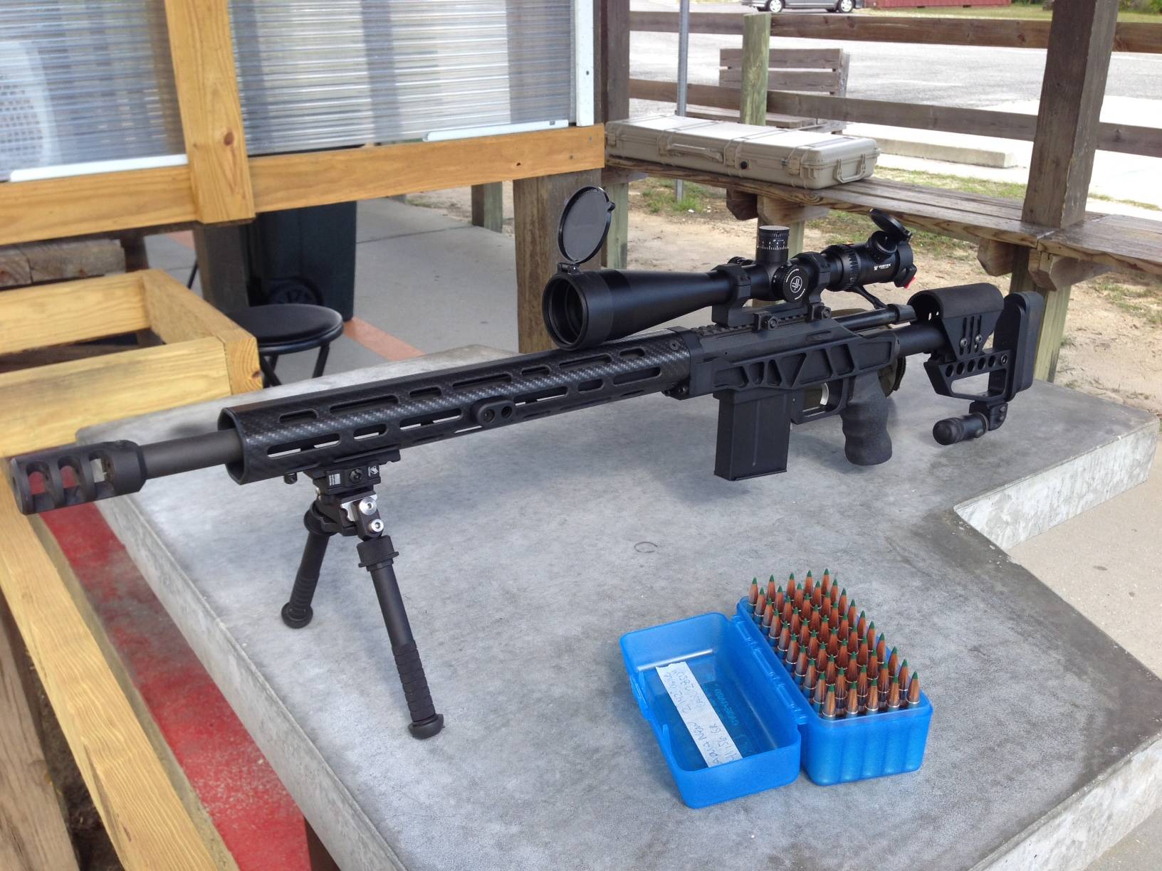

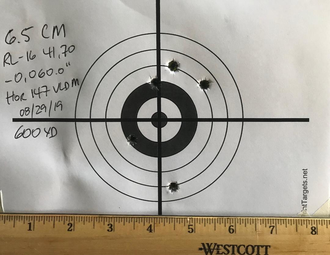

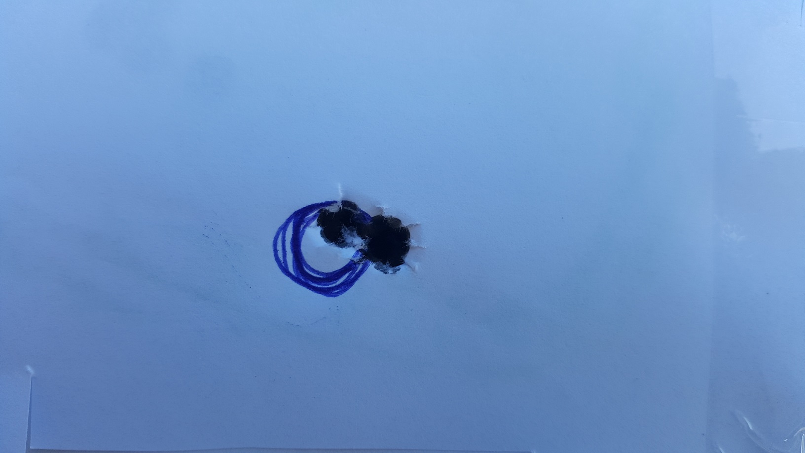

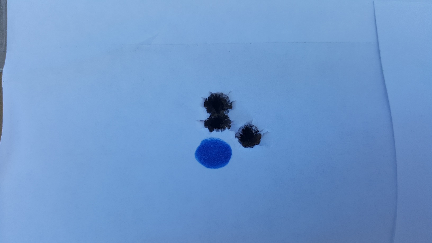

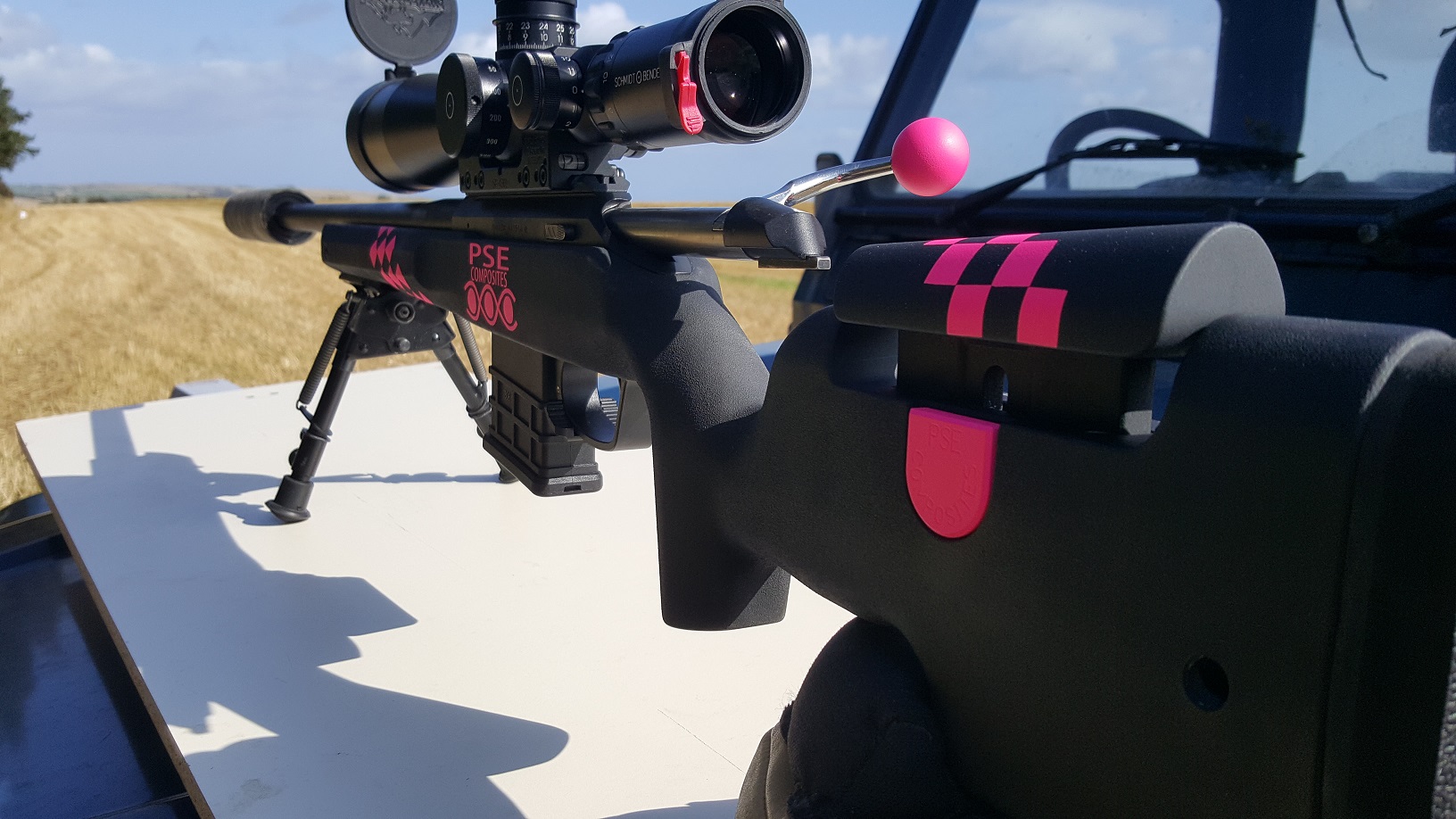

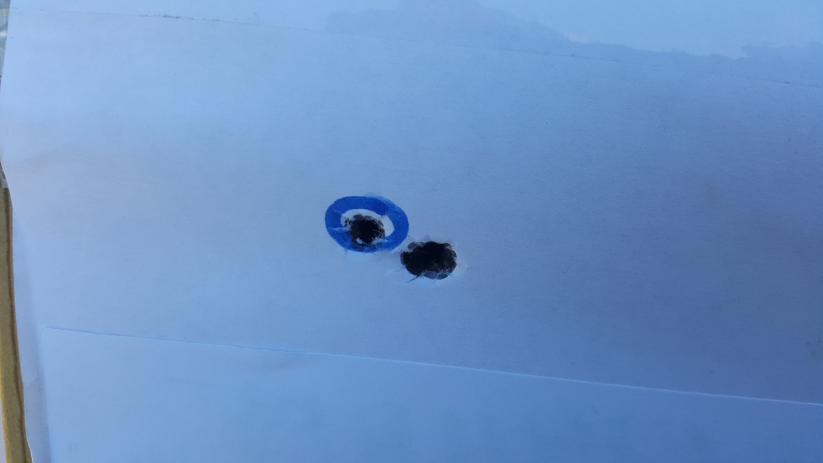

Now finally I finished my "Race Gun" . The project started in Feb when I flew over to Virginia and had a chance to visit Shawn at Hawk Hill Barrels. Decision was made to try a Marksman profile 24" in 6.5 to end up as a Creedmoor 6.5. I had also met the guys from Ultimatum Precision at the German IWA trade show and ordered a Deadline action. Import permits etc kept dragging on and I had to pull the plug, the Deadline will be used on the next project. We had an old T3 action in the workshop being used for beddings so that was robbed and sent off get the barrel fitted at Dom's Custom Rifles here in Ireland. Dom did me a favour and I had all back within a week. Stock was already bedded in our normal process so the rifle came together quick. I tried a slightly radical spray job, a colour combination I had in mind for a while. At least no one will pester me at the range.
Weather was very blustery with gusts over 20mph but I found a place behind a small tree line that wasn't too bad. Fired a few shots at 100m just to see rough speed indication, get a few down the new barrel , rough zero and try a few left over rounds.
Best three shot group was either Sako TRG 136 factory ammo or 140 ELDM, not sure which target was what. The 123gr Nos had opened a bit but still ~12mm. This rifle might just get me back into the odd comp....
btw. The 5-25PMII has the new Grid2 reticle, fantastic.

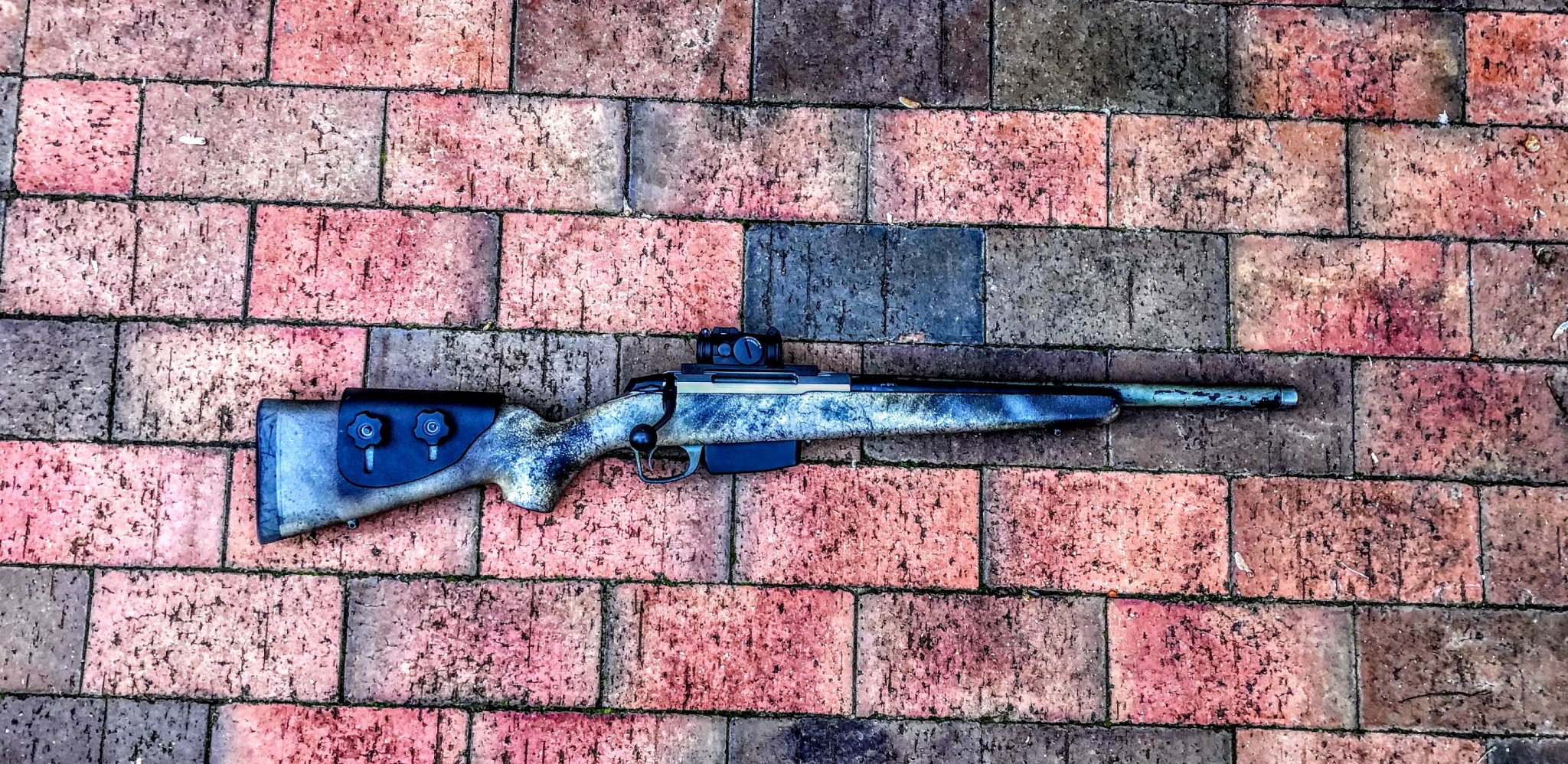

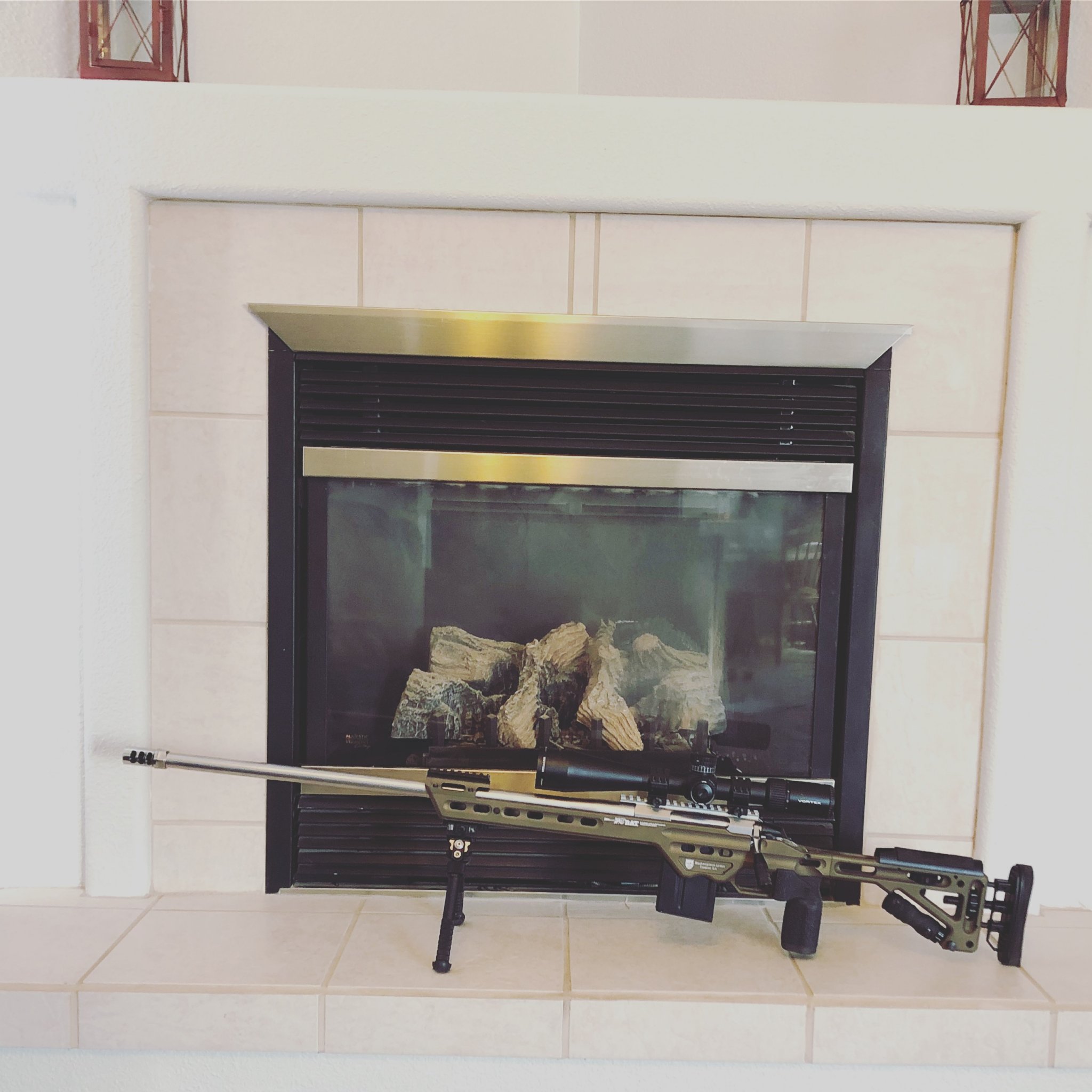

Tikka T3x
26" 1:8 Twist Bartlien Medium Palma chambered in 6.5 Creed
MPA Ba Chassis
APA Little Bastard Brake
This rifle was originally a T3x light chambered in 243 for my wife to learn to shoot and hunt with. After a couple months I found she wasn't too into it, (Lucky me) and I had come to really love the action and it became my first "race gun" if you will. This thing is a hammer. Only issue was when the bolt shroud cracked and smacked me in the face. A new shroud from Mountain Tactical and it is back to shooting lights out.

How do you like that bolt handle over the stock handle? Easier to operate?
I like it for sure, and yes it is easier to operate by a bunch, but it might be a little over sized. I think something in the middle of what is on my rifle and what comes stock would be ideal. It is just a little long when it comes to throwing the rifle in a pack or something similar. It can get caught pretty easy.

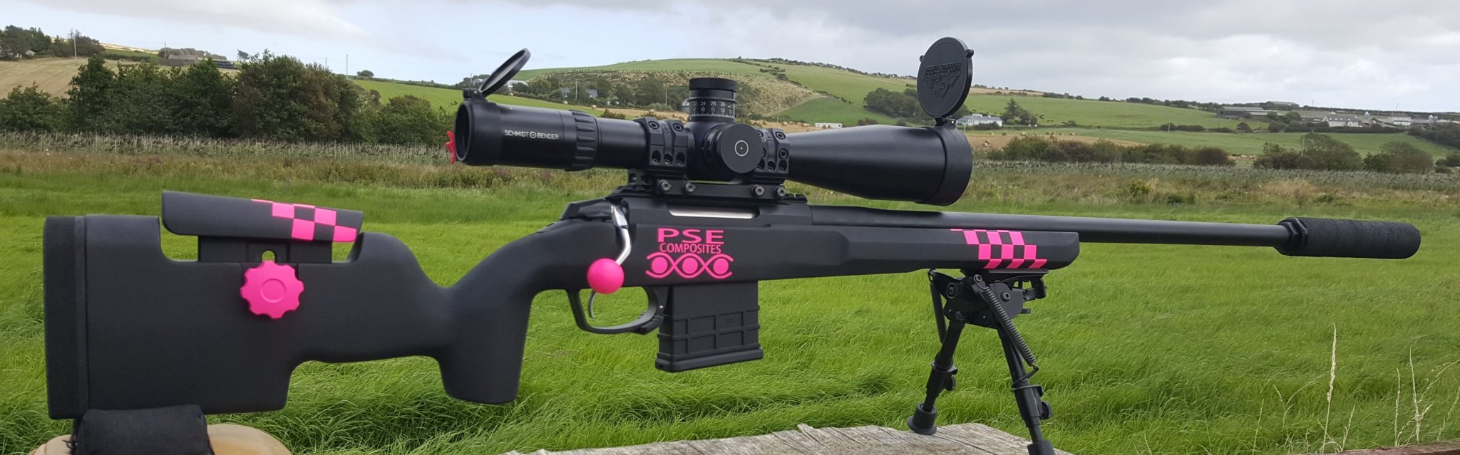

We fit Atlasworx mag systems almost daily however 300wm T3 AI type less than 10%. The T3 is a bit tight for the AI 300WM mag, some say mill 2mm off the trigger housing but we found that is not needed. Recently a picture was posted on this thread where the front bottom of the action had a V cut-out which could make good sense for longer loaded cartridges. I have not tried that yet.
I think it is important to first bed the action which means the position is fixed, then free float bed the floor plate in it's natural position with inserted magazine which sits in the best position and angle in the action. We start by having the mag inlet larger than needed.
One can simulate the best position by clicking the magazine in the atlasworx then sitting the mag in the action, (without the stock) fit the action screws very lightly tightened. Pillar height can be measured that way also.
Once fitted and bedded right the rifle feeds ultra reliably. pictured a 7RM with Hardy barrel, Atlasworx AI 300wm mag.
