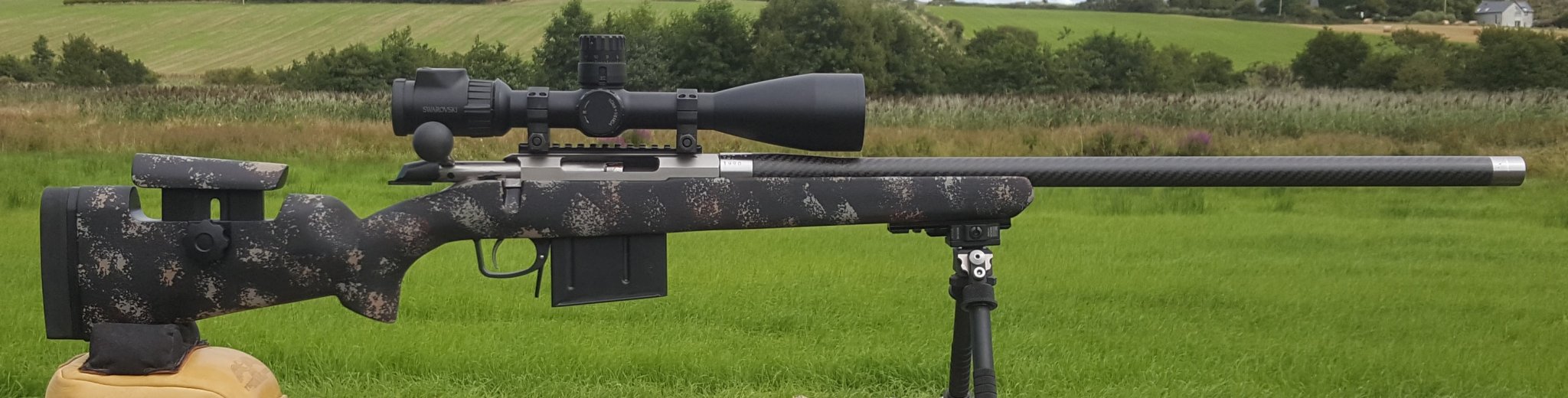

Once fitted and bedded right the rifle feeds ultra reliably. pictured a 7RM with Hardy barrel, Atlasworx AI 300wm mag.

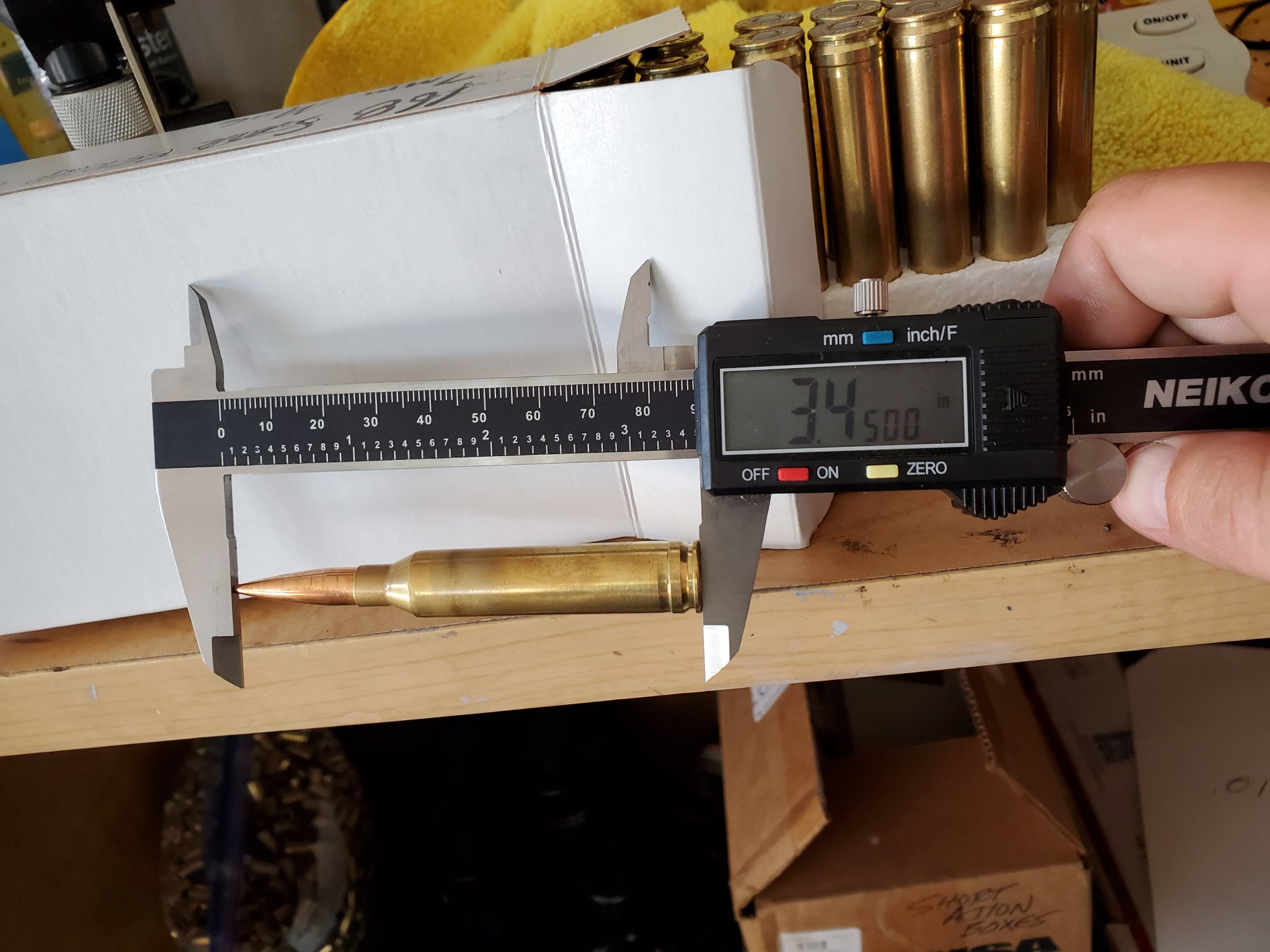

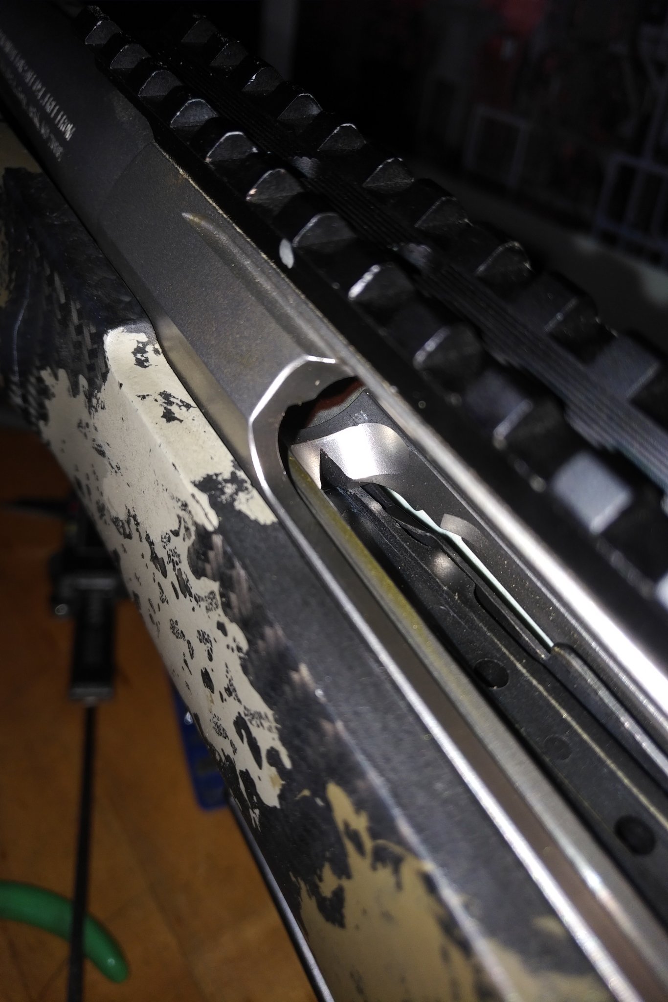

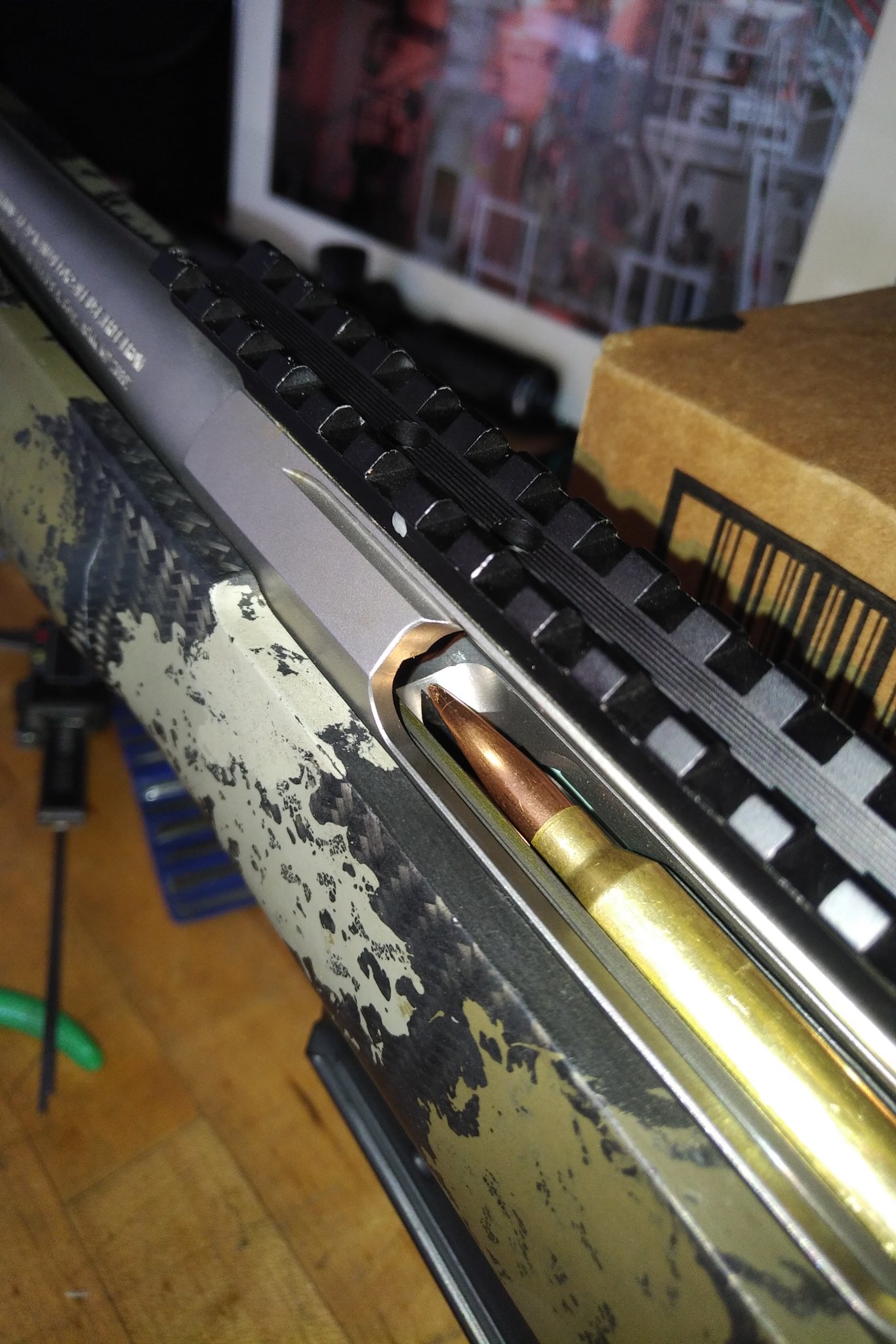

So, I don't know about you guys, but being limited to a 3.41" OAL for my 7mm RemMag was a real bummer. For me to have .020" jump for 175gr ELD-X's, which my Tikka shoots marvelously, I would need to single load them through the ejection port...
NOT ANYMORE!!!
Before....
After:
Now I can mag feed 183 Matchkings seated to .040" jump. 3.56" OAL. ??? as opposed to previous 3.40" and jumping them .20"!!!

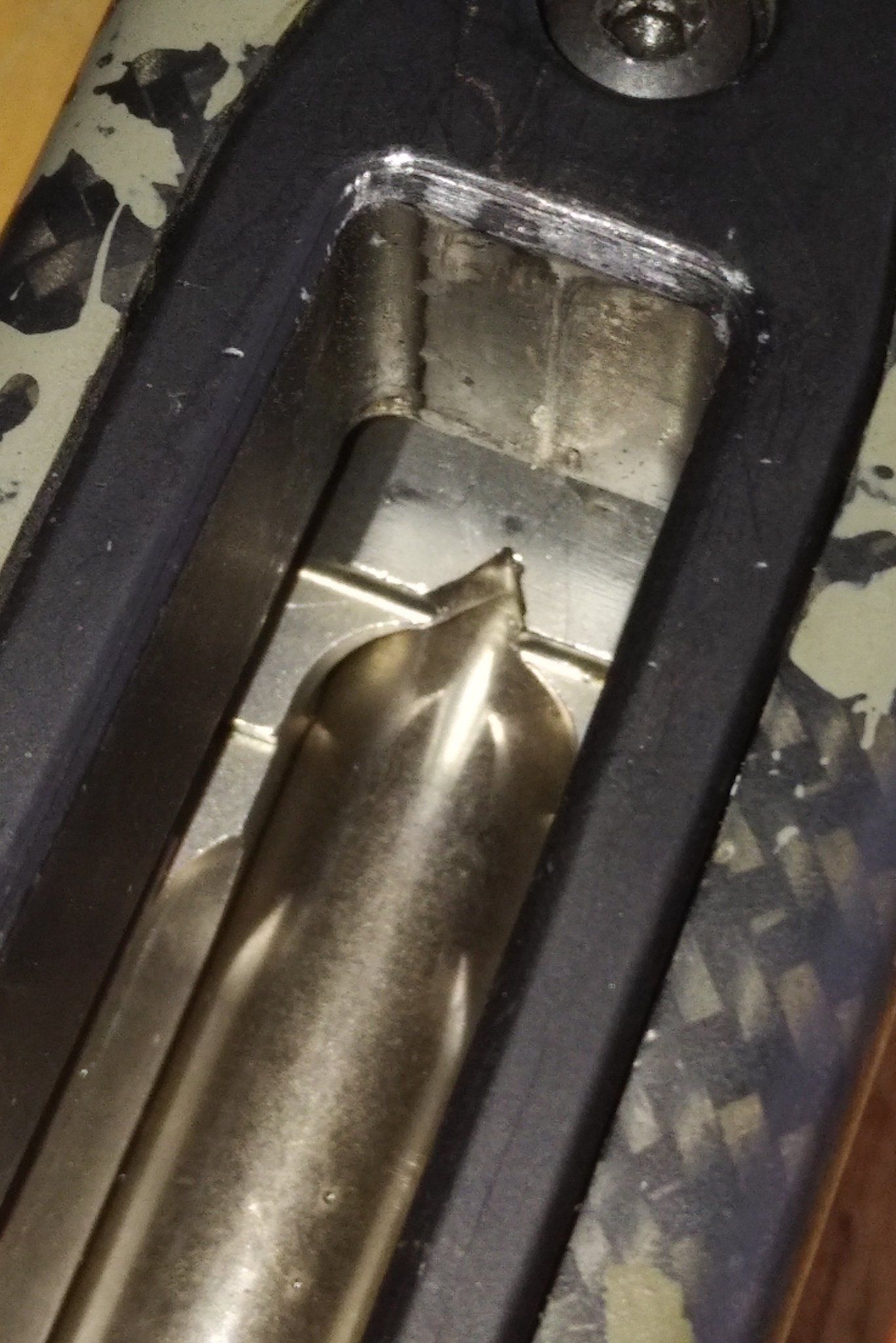

My Bottom Metal on my Tikka is CDI. Fits and feeds AI 300WM mags fabulously. I actually hand-cut a V groove in the bottom inlet of my receiver to accommodate rounds with OAL longer than 3.41", which was the max dimension. The bottom metal and magazine wasn't the issue, it was the actual length of the magazine inlet of the receiver.
Oh, by the way, Berger 168 VLD Target bullets shoot very well when seated at the lands (overall length 3.450", 87.63mm)in the 7mm RemMag T3x.

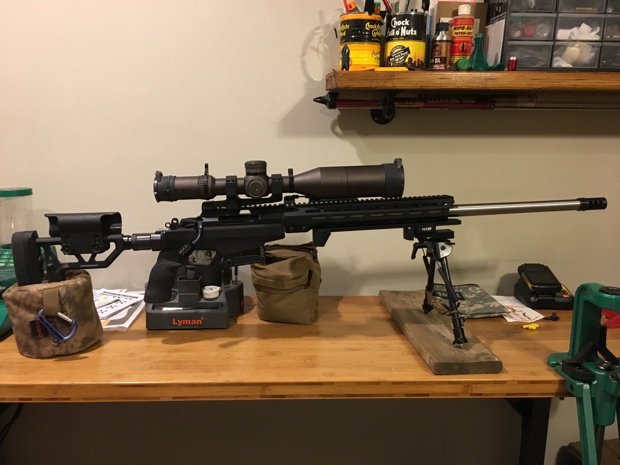

This is my Tac-A1 with a barrel from Patriot Valley Arms. It's a 26-inch Rock Creek prefit in 6.5 Creedmoor in m24 contour. The only issue that I ran into was that m-lok accessory screws were actually contacting the barrel when fully torqued down because the barrel is so thick. As per the instruction from Area 419, I used a belt sander to grind down the screws about 30 or 40 thousandths and they now have plenty of clearance.
Regarding the accuracy department, I only have 140 rounds down the barrel - all reloads, and it's a 1/2 MOA barrel so far. I don't have any groups to share, but I ran my Tikka in a PRS match last weekend and it was a hammer out to 730 yards.

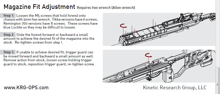

Those of you with a t3 tactical in a krg whiskey 3 gen 6 chassis, how do you get the forend to slide back or forwards? I loosened the 6 screws and even tried taking them out all the way but with no luck. Does the barreled action have to be out of the chassis to adjust it? Also using an accurate metal mag (.223) if that changes anything.
That forend has a little play on it, but it is not much, we are talking about few millimeters.
Trigger guard is the element you want to adjust, that how you can get the magazine to fit in to your chassis how like it it.
But to do that, you must take action out of the chassis.

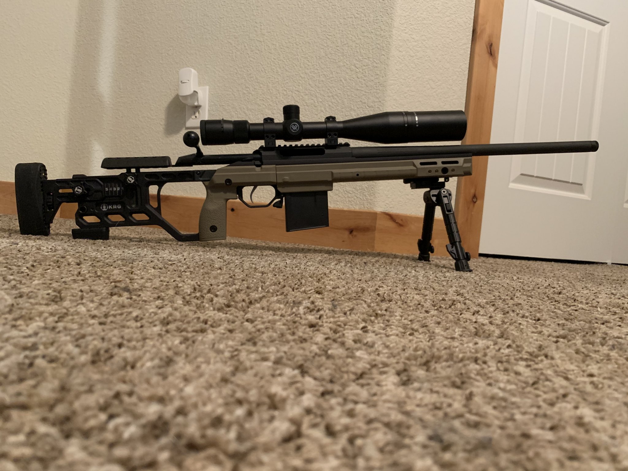

I use Whiskey 3 gen 6 on my CTR 223rem, i use MDT magazines.
The rifle with the green chassis.
Here´s the how do for the mag fitting.
Reactions: Krob95

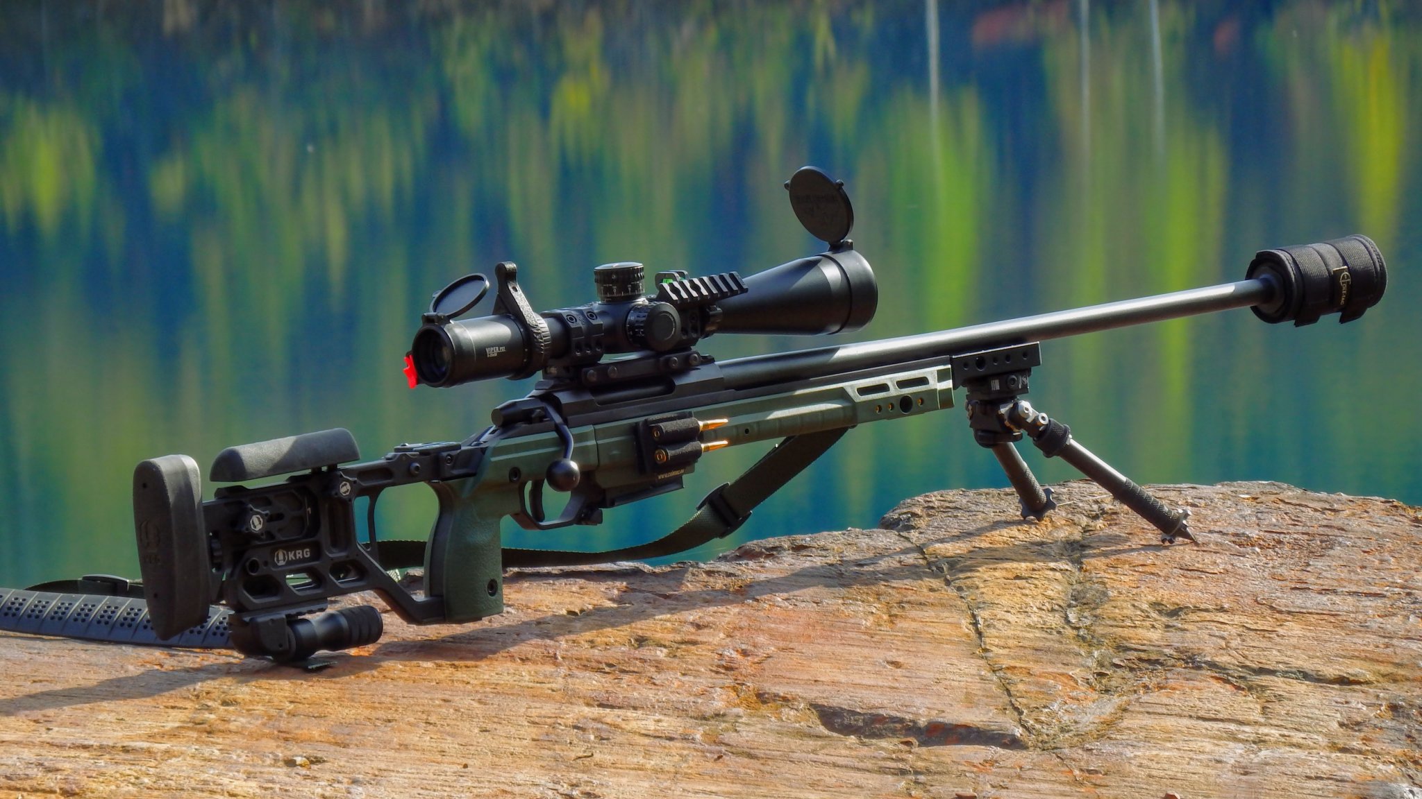

Well I got my Tikka T3 Tactical .233 into its new permanent home, a KRG Whiskey 3 Gen 6 chassis and boy howdy does it look and feel great! I just have a plain Jane Vortex Viper 6.5-20x with Vortex Pro rings and a UTG Pro bipod for now as this was what was on my old Remington 700. Will be upgrading to better glass and an atlas bipod eventually after I get a timney 2 stage trigger.
I too have one on a 260, they're work extremely well don't they.
Do you share suppressors between cals, or have dedicated ones?
For the size they are, they are amazing how so small can be so efective.
I have 3 of these SL5i suppressor.
I also have 2 JAKI suppressor, made in Finland too.

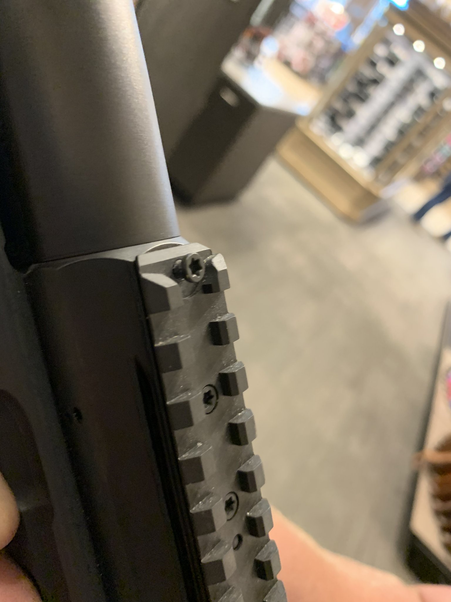

So this is on a Tikka in 260 at a local retailer but is also on my Tikka t3 tactical, what the hell is that screw at the front of the receiver for? It’s the one that’s sticking up for really no reason. It was also on another Tikka as well.
It's a screw to attach a mirage band.
The front screw comes on some factory and aftermarket muzzle brakes.
There is not a hole below it in the action so don't go screwing it in or you will lift the front of your rail up.
Some people use it to lift the rail up after heating and removing the screws when replacing the factory rail for another just to get a blade under the edge for some leverage cause Tikka epoxies the shit out of the factory rails...
Mirage shield?
Just speculating.
thank you guys! Never heard of that but it’s good to know you can use it to aid in getting the rail off.
My TSR-1 had that. Learned this 2 weeks ago when I went ahead and screwed it in. Low and behold the rail came up. Ended up replacing the rail with a Spuhr 20 moa and yes they epoxy the shit out of it. Heat gun took care of it though.
