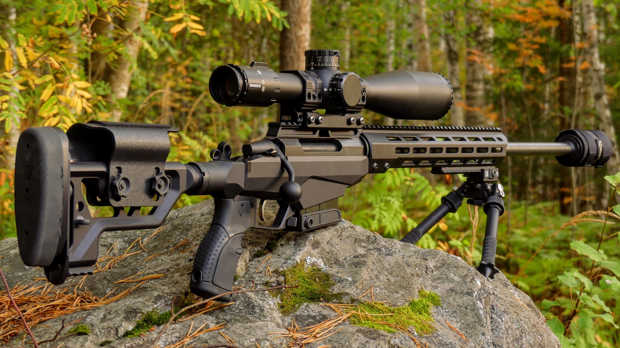

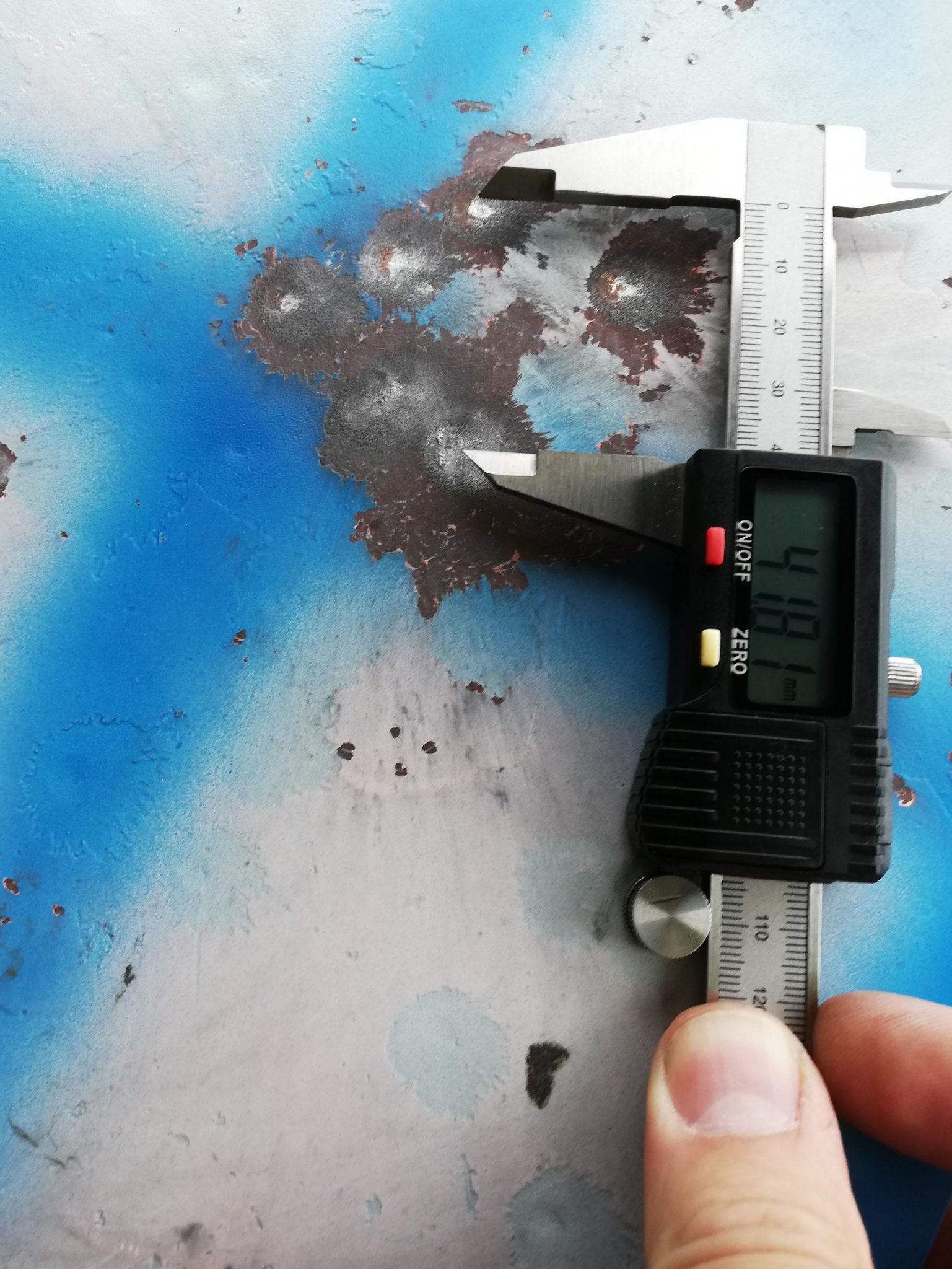

Got new scope to test.

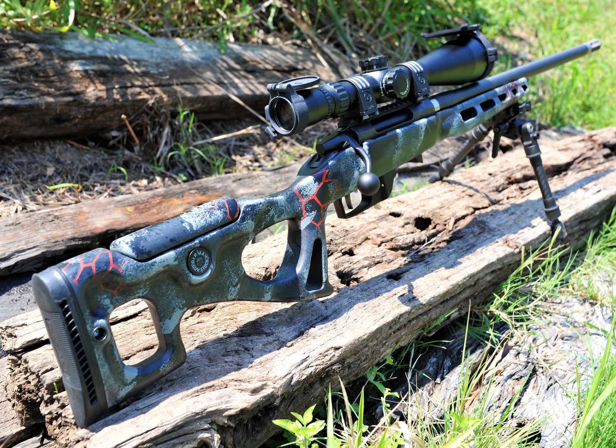

My GGS Ranger. 260 AI, Hardy CF barrel. I’ve changed the BM to an Atlasworks BM milled to accept a TRG trigger(sublime!)
Hey Anzac,
thanks for your response.
That´s a very nice looking combo there.
I´m interested in your experiences with that stock, and / or the Predator if someone has it.
How long do you use it and are you satisfied / would you buy it again?
How stable is it and how do you like the ergonomics?
Do you shoot it rested (bench or prone) only, or do you use it for hunting or tactical shooting, too?
As the Ranger is their lightest stock, and the Predator is somewhere between both worlds, do you miss something at the Ranger, I mean, would you like to have a bit more weight sometimes?
Any info you are willing to give me is appreciated.

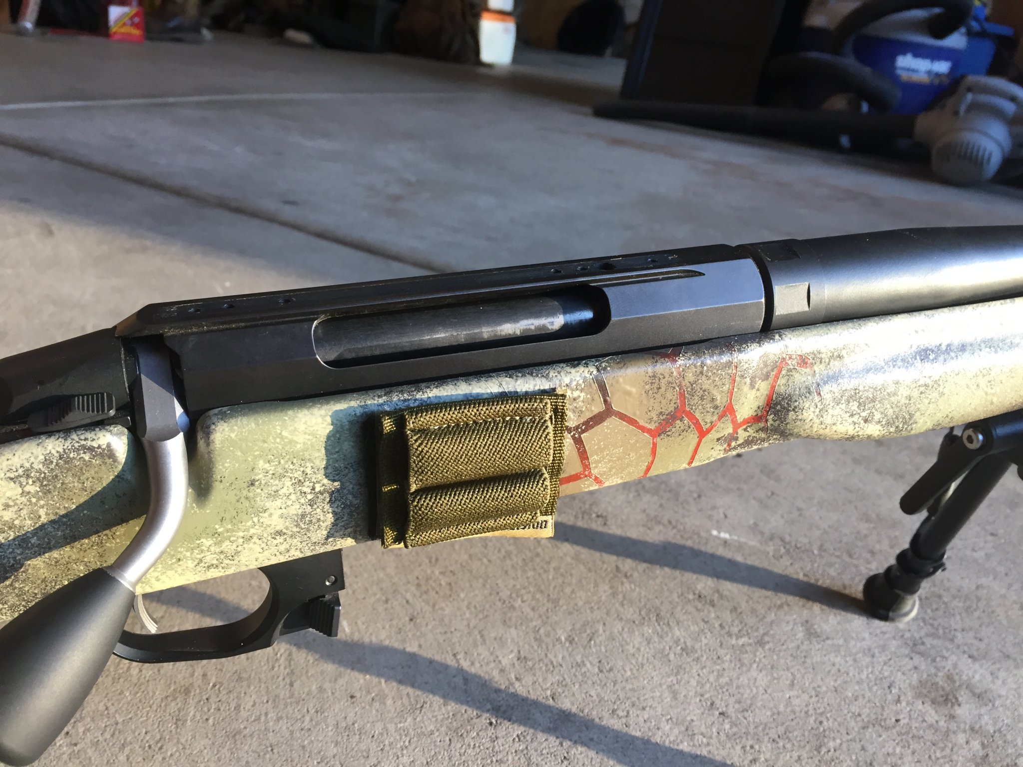

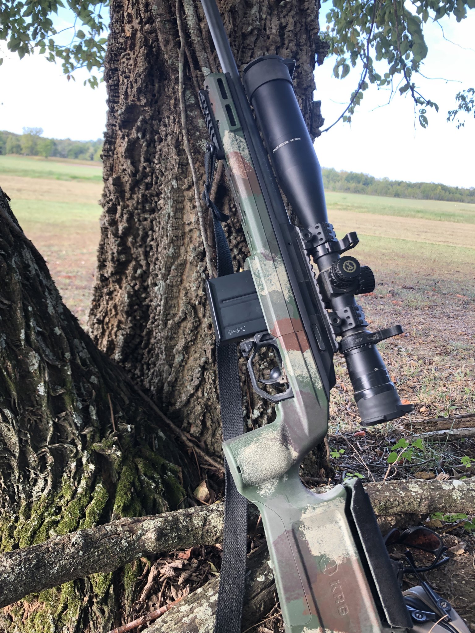

I have the first BugNut barrel that Greg at SPR did on a Tikka. He offers two sizes of nuts depending on the look you like. I have gone back to shouldered barrels on my other Tikkas though. You will need an action wrench and barrel vise. My son and I are going with the Carbonsix prefit barrels for our lightweight hunting Tikkas. I know of a few guys that have had good luck with them.
I have swapped barrels between two of my Tikkas and they headspace on the money. Shouldered barrels are easier and take less time than the barrel nut.

Apologies for the late reply.
I’d definitely buy again. The ergos are superb for me though I’ve now replaced the butt pad with a height adjustable AI unit.
I can very comfortably use both a traditional wrapped grip into the thumb hole and a rested grip. Weight balances well with the shouldered 24 inch Hardy CF barrel. I’ve another Hardy CF barrel for it in 22-250.
I did reseat the mini chassis. The original skewed mini chassis had the barrel canted off laterally some. It’s only secured by silicon so removing, taping the barrel and re-siliconing it had it squared up and away nicely. Added a Sterk recoil lug that required a V light honing to press fit into the mini chassis.
I’m still sorting a load with work constantly getting in the way..
