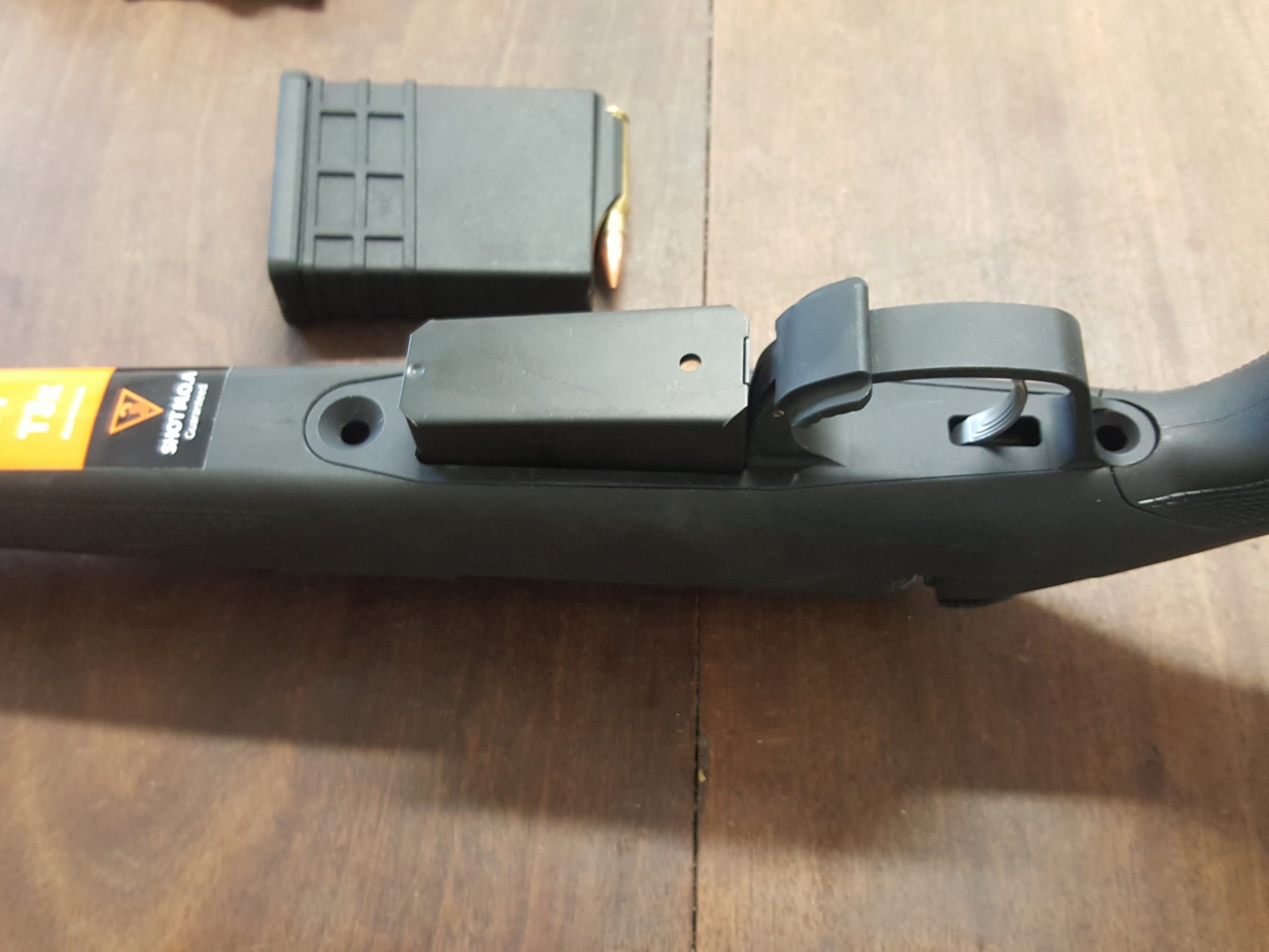

Anybody have an old pre x t3, something that started as a non ctr, and or a CTR? Take a picture of the bottom and post it. That should clear everything up.
Does anyone know if a t3 varmint will work ctr stock, and work with the ctr bottom metal? I know it seems counterintuitive, but I like the idea of running ctr mags over AICS again.
Hi.
Is your rifle T3, or T3X?
T3 will not work, since the action has not machined this part of the action.
Upper action is Tikka T3X TAC A1 and lower is Tikka T3.
That notch is because the CTR magazine has this dummy feed lip on the magazine.

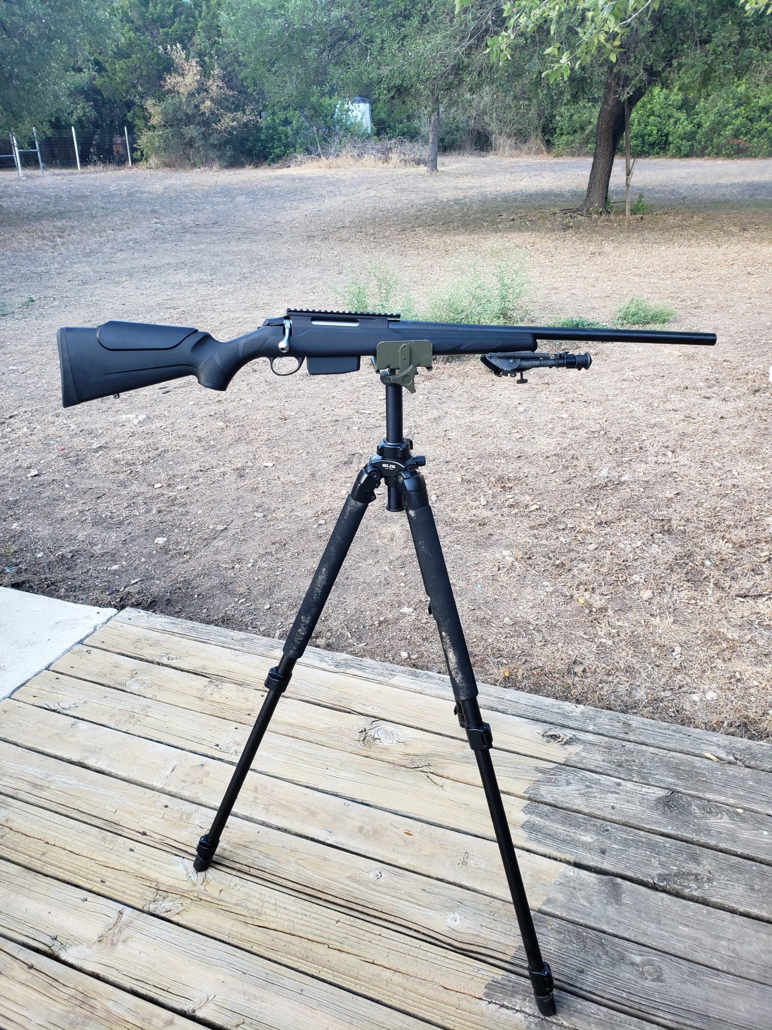

What barrel is this?
It looks quite fat.

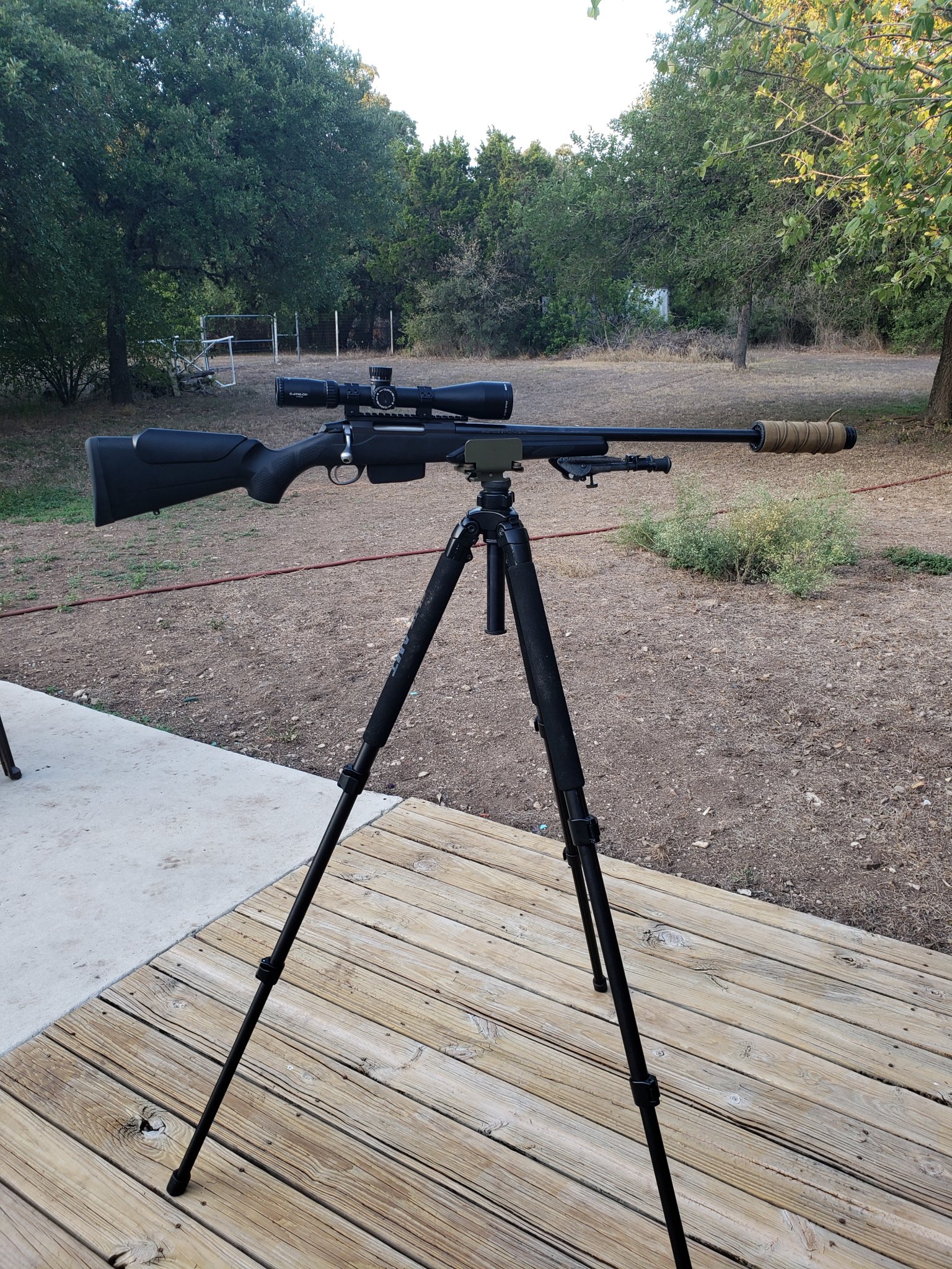

It's the factory varmint. Definitely an added bonus to a great rifle. Only downside is it's a 22-250 and their twist rate wont let me run heavier loads.
Scope rings should be on my door step today, and my smith will hopefully be able to thread it on Saturday. It's been a real conundrum deciding to shoot it without my suppressor, or wait and wait and wait for it to get threaded.
Oh, ok, so it is the 20" barrel.
I have the 24" which looks somewhat thinner.

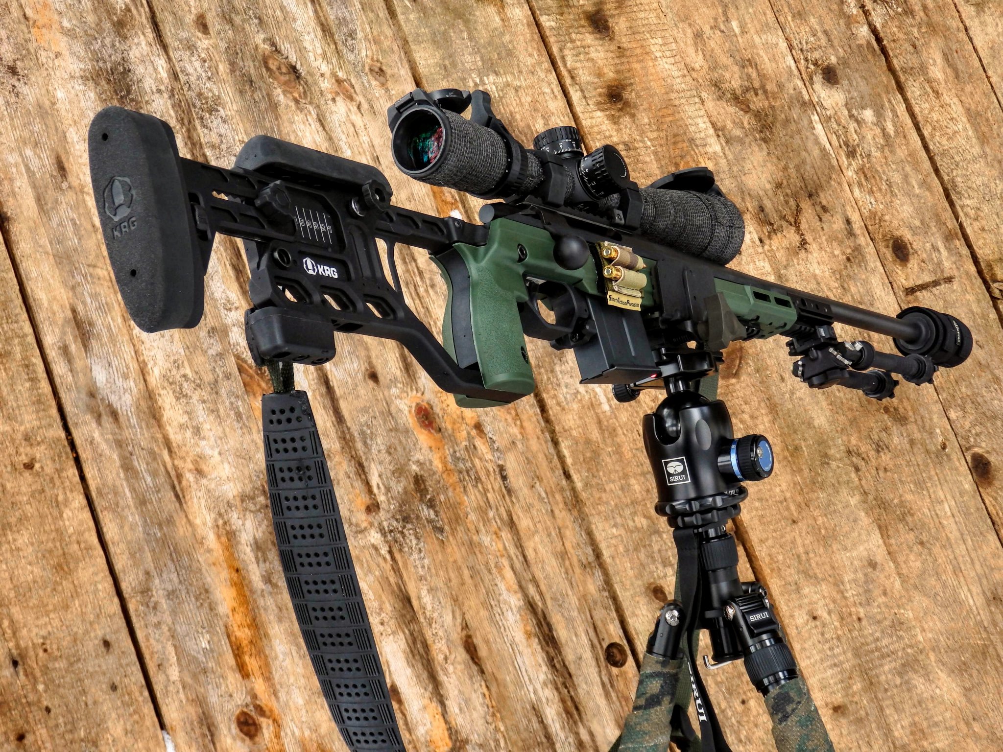

Here is how i did it.
I took the CTR bottom metal and put it to the magazine side.
Upside down.
Lock it plate with bolts.
I did with color pencil markings on the stock.
Then just use a dremel with cutting blade and let´s get to work.
Once in a while, check that the bottom metal is area is not opened too much.
This magwell area, my friend did it with a milling machine.
We had many nice shooting trips with this stock.
Like you may see, this Tikka T3X CTR was the latest model, but like so many of you guys do agree, that the CTR magazine is not working
well, i did find that out too.
In the early model Tikka T3, this magazine was the one and only, Sako TRG 22 magazine, so i get one too.
Trust my guys, if you get that TRG magazine, in any Tikka model they do these days with the Sako TRG magazine, you will love it.
That Sako TRG magazine is one of the best in the world, you can not to compare it to the Tikka CTR mag, metal thicknes, quality, everything is totally different.
Like if you have a Tikka T3X TAC A1, you like that chassis, but you hate that mag.
Do not sell the rifle, sell those mags, and buy one Sako TRG 22 mag, and you will love that gun again.
Trust me guys, i have been there and done that.
If they would just make this very nice stock with a stiffer frame, i might never change it.

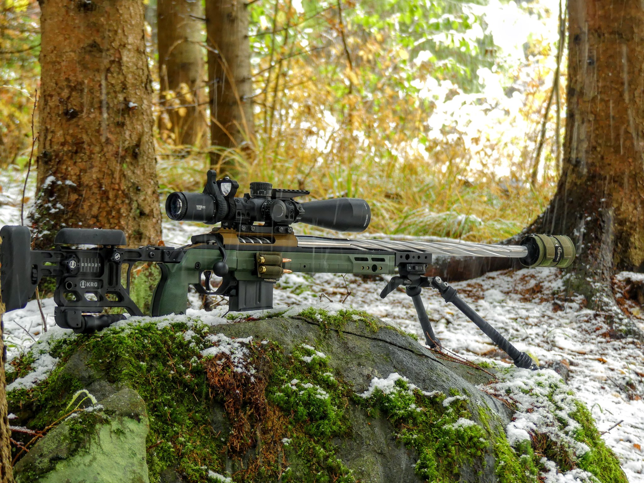

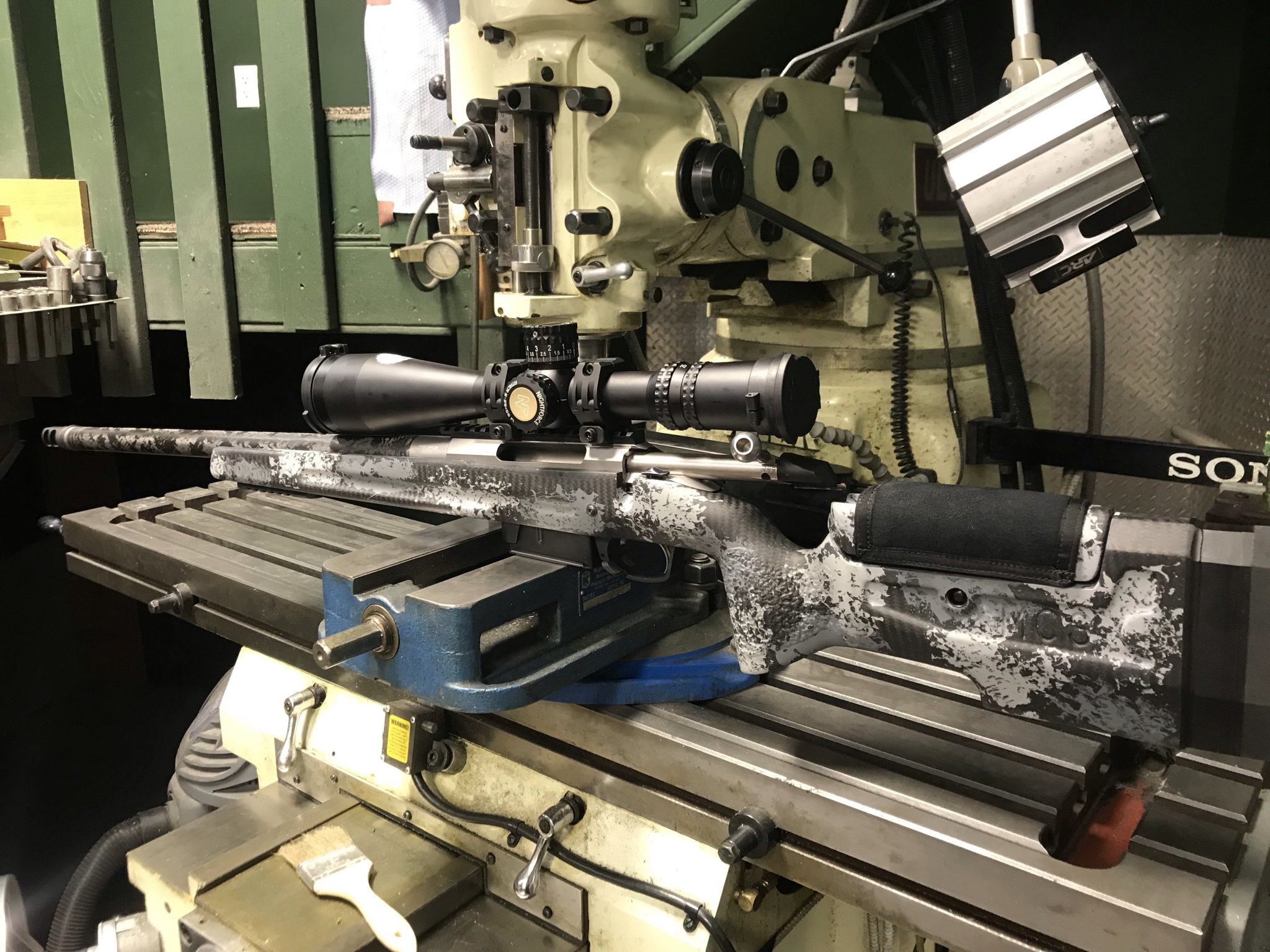

Custom Tikka :giggle:.
My first barrel change project, it did came out quite nicely.
Gunsmith company Ensio Firearms did all the job on the barrel.
Krieger SS 6,5mm 8"/4 barrel.
6.5 creedmoor.
Ensio Firearms seems to have a great reputation here, especially among people who want a modern precision rifle, made your way.
He (they?) has also taken over the JJ range of actions. Not sure if he has old stock from JJ or is making them new. I suppose the main advantage of those is you can have any configuration, length and weight.

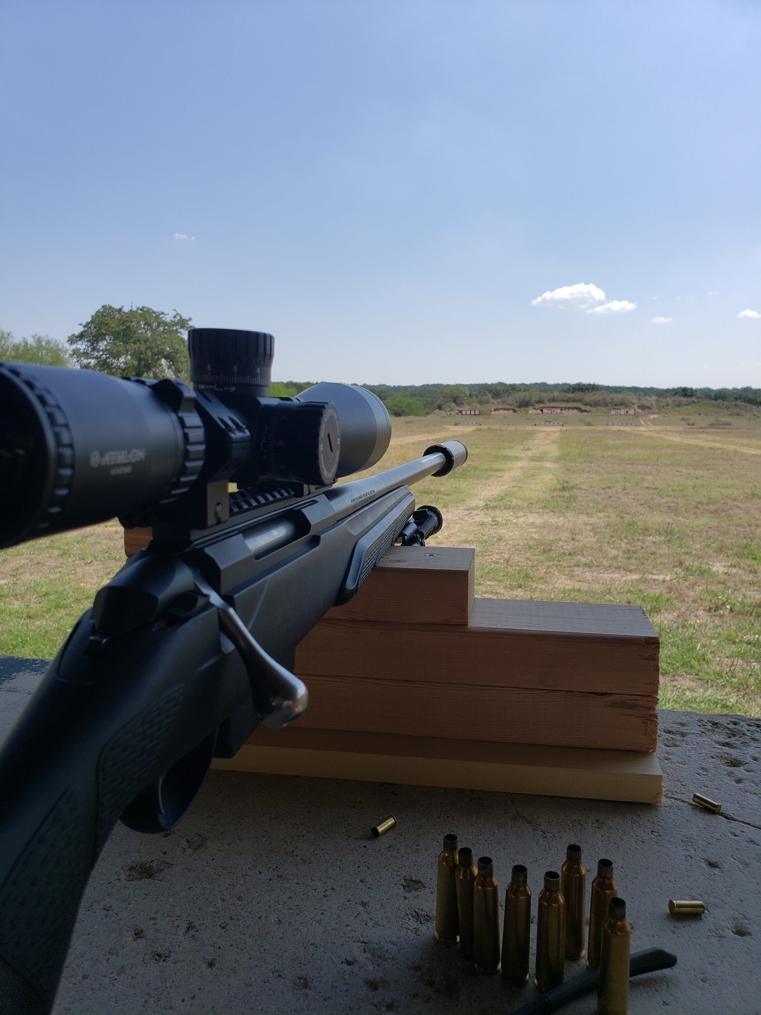

My gunsmith, @txfireguy2003 of Blackland Precision, threaded my t3 for me friday night and today was range day. Preferred 55 grain loads but I'll experiment some more.
T3 Varmint in 22-250, athlon ares btr 4.5x27 and silencerco omega 300.
Not the best groups, but I'm still learning the rifle. I'll go back out next weekend, hopefully they'll be closer to what tikkas are known for. Middle rounds were for zeroing.
