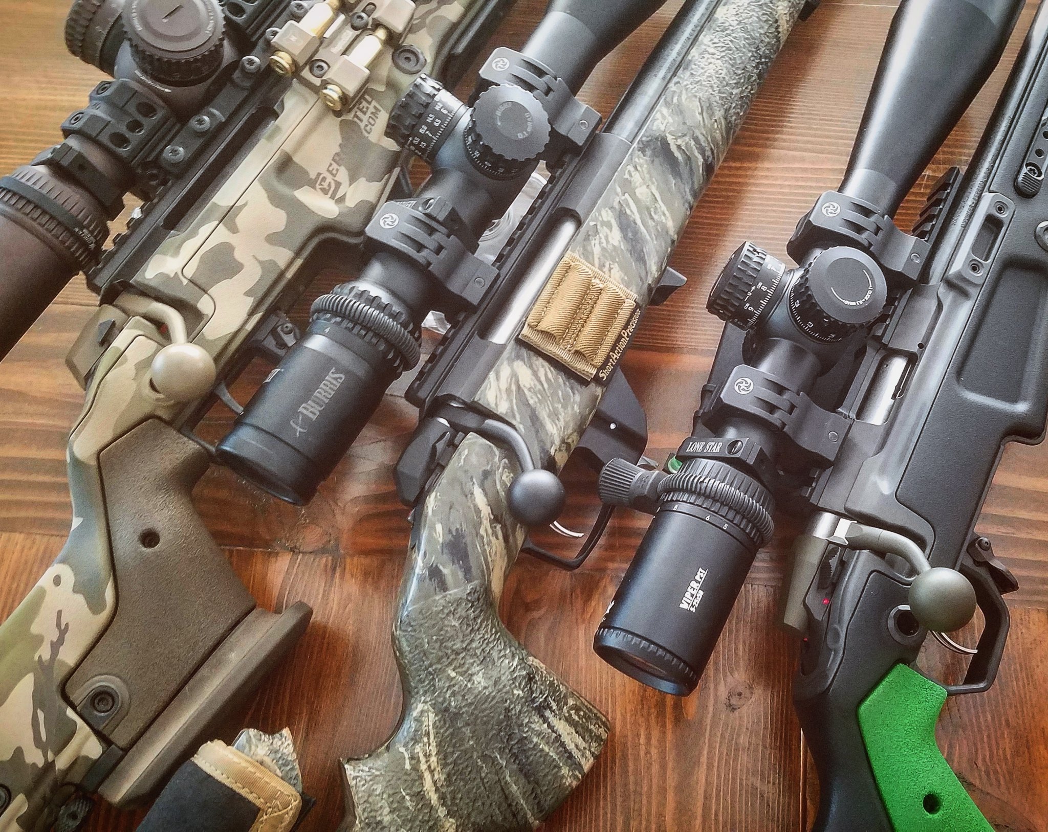

If you have big hands and are using a vertical grip a Sterk may well interfere with your hand placement. The Sterk parts exhibit much nicer craftsmanship than any of the other but in terms of functionality the Glades knob and handle are a better design unless you're hands smell like cabbage
While I have not tried the Glades, I had the stock CTR handle and the Sterk ball. The Sterk had significantly less perceived effort for bolt cycling compared to the factory CTR. For reference I have smaller hands (I wear medium gloves).
