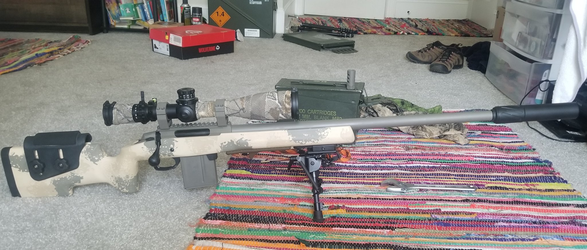

I've shot the Hornaday 140s before and found them to be a good load but these 147s are something else entirely. We were dialed in at 5.4 mils of elevation, and a full 1 mil left for wind, they would just sail right in to exactly where you pointed them.
Confirmed!
I have the exact same rifle and am using the same bullet for LR.
Only the 139 Lapua Scenar is a tad more precise, but unfortunately has a much lower BC, so the 147 ELD is the way to go for me too.
At which velocity do you run yours?

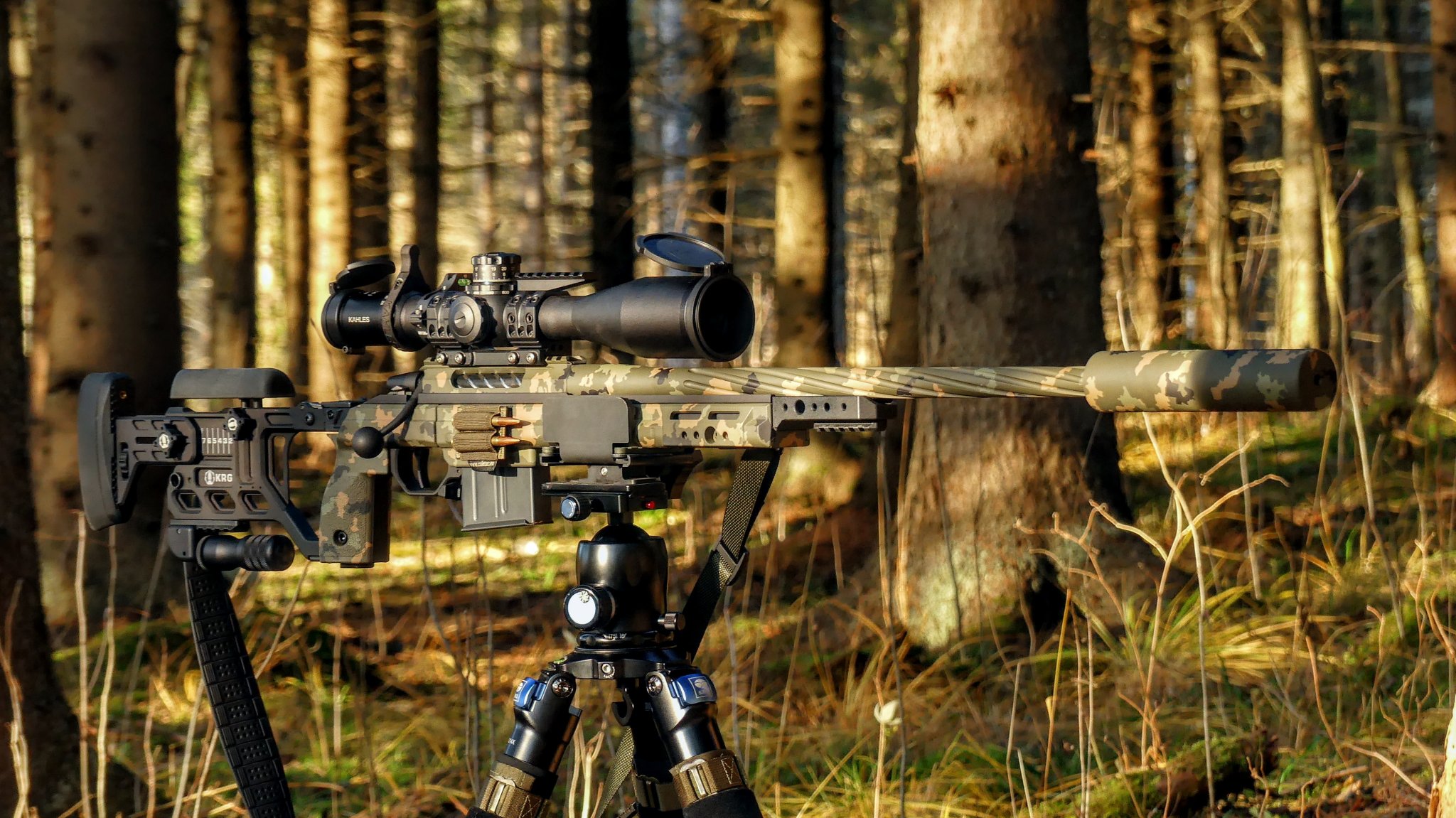

Now I'm really wanting a W3 on my tikka. You, jaredCo, and reubinski are probably going to get some thanks from KRG for being the best salesmen of the year soon.
I wish :)
But i would not say no, if they would sponsor me one.
I have one Whiskey.
One Bravo, that has Whiskey rear stock, so it is like a Whiskey and one Bravo.
That Whiskey i just amazing chassis, i love it more and more, the more i use it.
And here in Finland, full alloy chassis is not that great in winter, your fingers are frozen when you handle a metal chassis, but in KRG has only full alloy backbone, and polymer panels, so it is very nice to handle in winter too.
Of course the Whiskey has alloy rear stock, but that does not make any problems, since every one is carrying guns on the fronend.
One Bravo chassis is on custom care, cerakote guys ;).

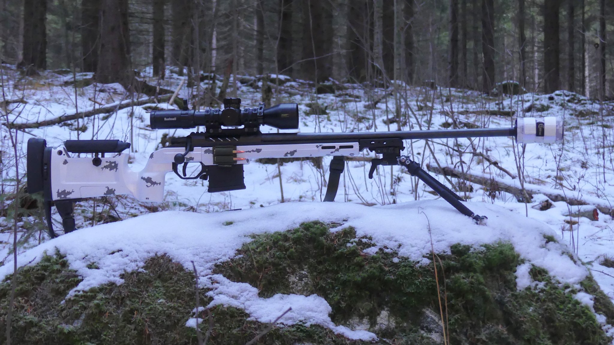

I can say that it might look good in a Finnish winter landscape, winter M05 pattern with cerakote is coming on that.
Winter M05 looks like this.

Not sure, but I was using Hornaday factory loads out of the factory Tikka 24" CTR barrel. So I'm sure the data is floating around somewhere. I am curious to see what kind of accuracy the factory barrel is capable of with a good hand load, but I assume you'd get into the realm of diminishing returns pretty quickly with how well the factory stuff is already performing.
That's interesting,
You're the first person that I have seen that posted that the T3x only comes with long action bolt stops.
My 6.5 T3x CTR which I bought when they first came out with the 24" barrel came with the mid size bolt stop.

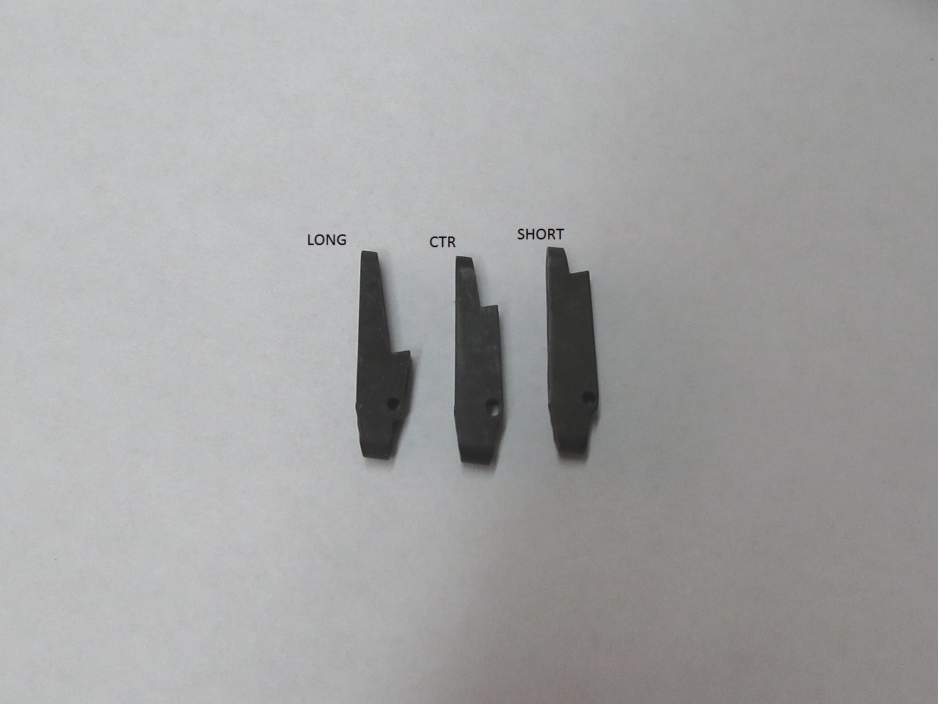

There is only 2 size bolt stop in the Tikka.
And what i have been looking, all the T3X rifles seem to be in the long stop version.
Like i had Tikka T3X TAC A1, it has the long bolt stop, and 100% sure that the bolt stop is long in your rifle too, since it use CTR magazine.

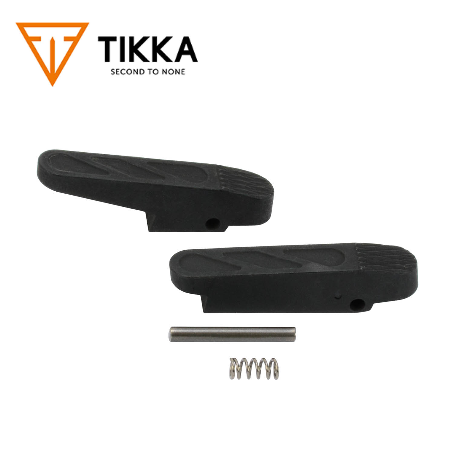

I have ordered from Sako, the factory that makes Tikka rifles too, a T3X bolt stop.
I ask that do you have it short action, they say that in T3X is only one model.
So that´s why i know that T3X has only one size bolt stop, and it is long.
Like i writed earlierl, i have orderd from Sako a T3 model short bolt stop, and i have those in all my T3X actions that use AICS magazines on my KRG chassies.
It´s not big, maybe 10mm the lenght on the short and lonf bolt stop movement, but it makes quite big result on the bolt action.

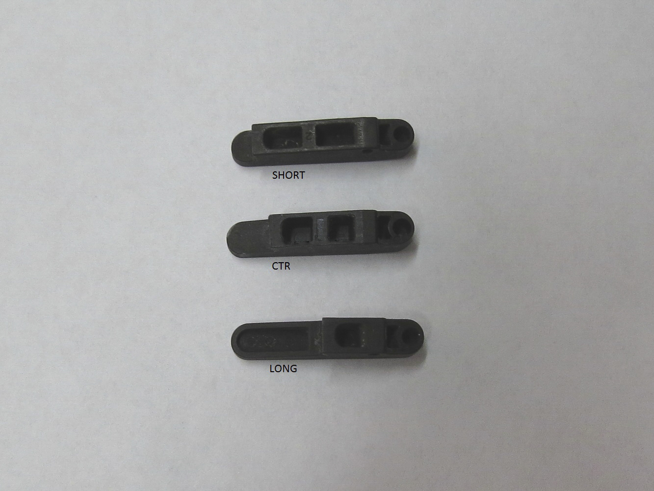

I can tell you 100% that my 6.5CM T3x CTR came with a mid length bolt stop.
Pictures I shot of my bolt stops including my CTR T3x.
Other people have confirmed that not only their T3 but also their T3x CTR came with the mid size stop.
Here is another Picture of the Mid size CTR stop....

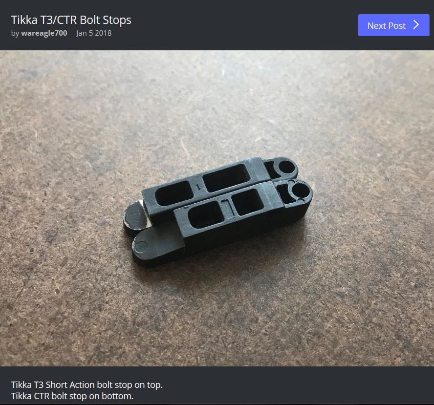

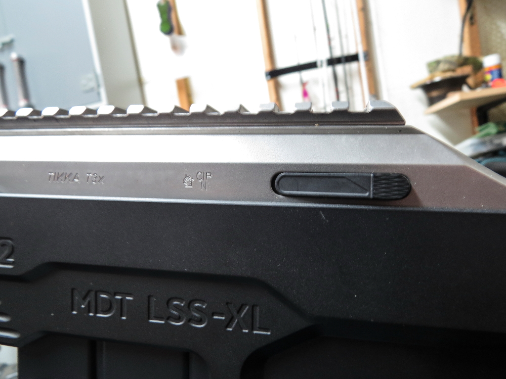

The long and the short stops are what came in the 2 piece package and yes the outer pattern is different on the T3x which is what I posted in the middle above.
Here is a shot of my T3x CTR showing the outer pattern.
Here is a 300WM T3Lite that I turned into a 6.5 PRC that shows the standard T3 outer pattern.

2 possible reasons why the CTR has a mid length bolt stop:
A) The CTR mag well needs this bolt stop to let the bolt come far enough to the rear to be able to pick up a cartridge. Remember that the plastic mags for the regular Tikkas are designed to be extremely size efficient, so that the receiver can be used for both .223 and .300 Win Mag.
B) The short stop is for .204 ruger and .223 remington, so all .308 has the mid length.
No need to switch out your bolt stop. My guess is that if you retract the bolt until it hits the bolt stop there will be no, or very very little, space between the face of the bolt and the base of the cartridge in the magazine.

Just received email from Sako.
Ok, i was wrong on that, Tikka does make 2 different bolt stop model in T3X, "CTR" model and long model for ammo like 300winmag, 93x62 and so on.
In the T3 they had 3 size, like JGR showed on the picture 1.

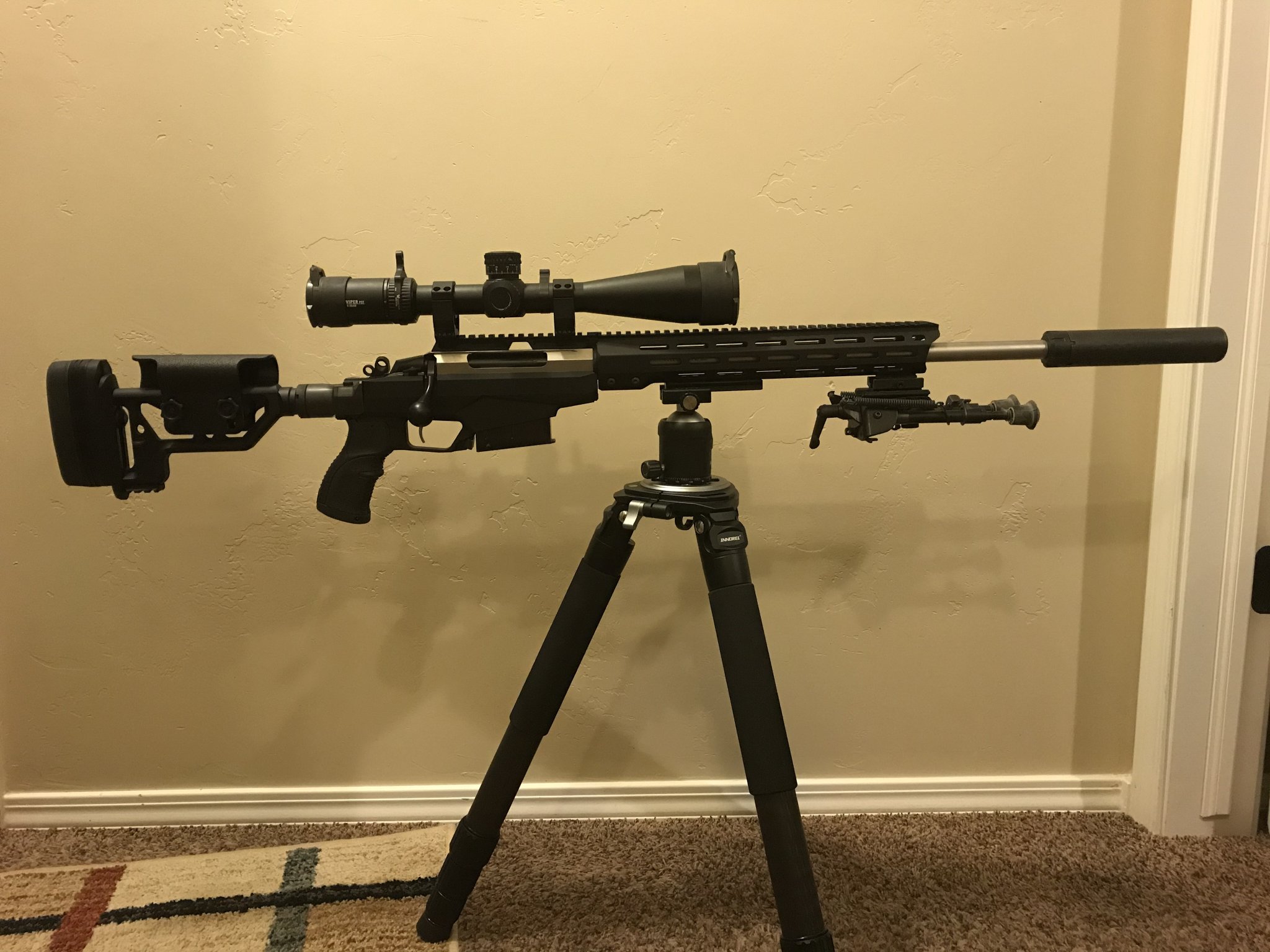

Oh shit, thats you? I follow your page. Love that camo tikka in the camo W3. Makes me want to buy another tikka again and do something similar. I regret selling mine.
Reactions: viking78
Exactly!
Thanks man.
No problem.
That is ColeTac Europe manufactured.
Im not sure does it have in US, but write message to Kaspars at ColeTac Europe, i bet hi can send to US too.

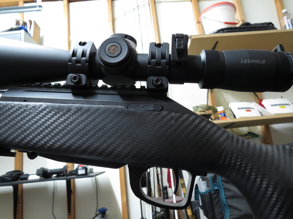

For anyone looking for a Tikka rail, Area 419 makes a great one. I just picked one up in 20 MOA this week and it is top notch at a fair price. It is 7075 aluminum (a bit harder than the cheaper grade), has a recoil lug built in, the finish is great with no rough edges, and machining was spot on so I didn't need to bed it. I'm not affiliated with them in any way but I appreciate it when others give feedback so thought I would share my experience.
