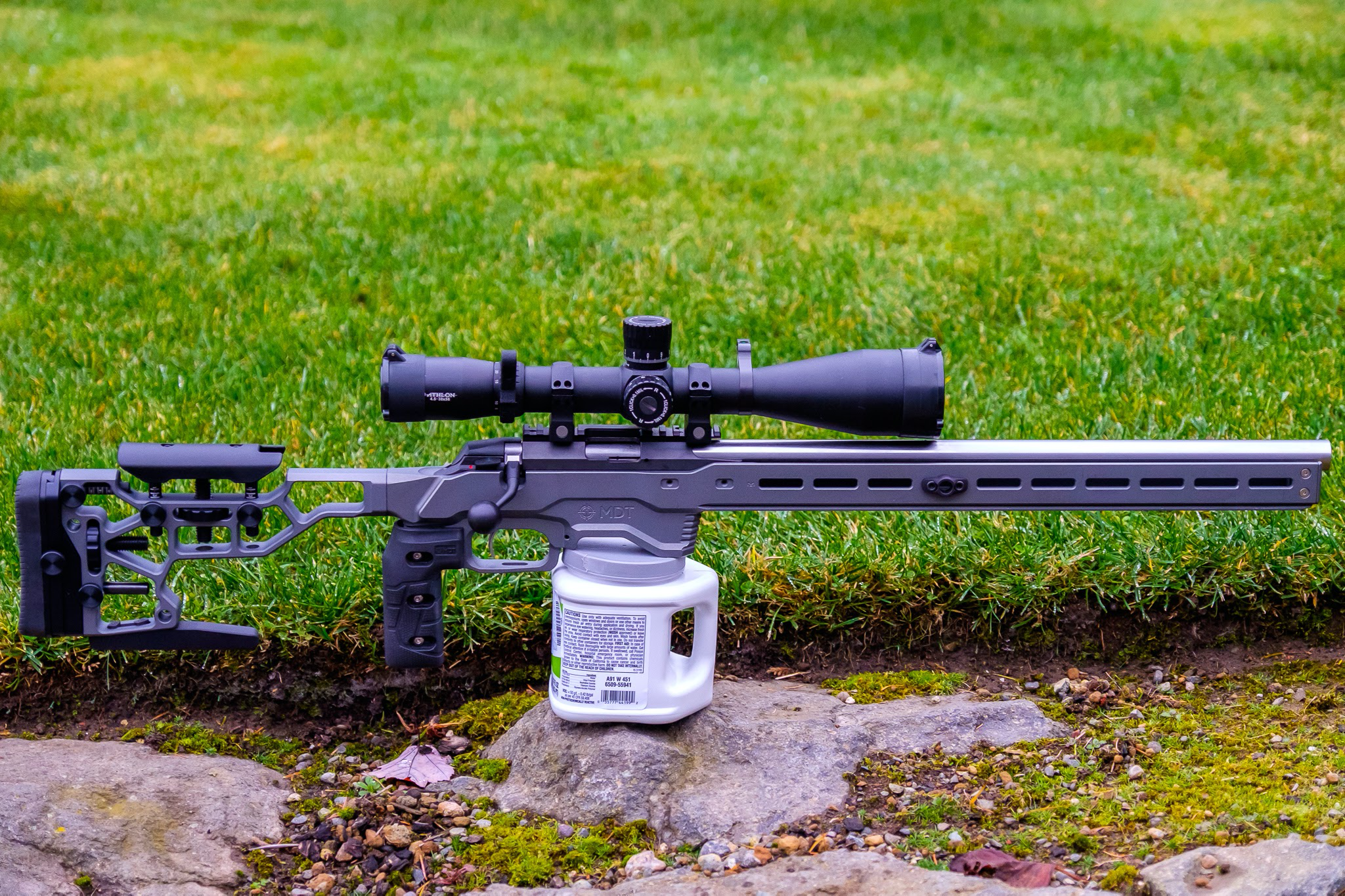

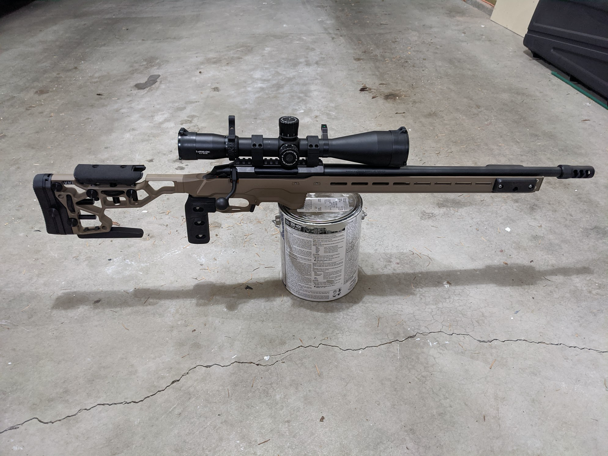

Moved my Tikka to a MDT ACC. Still haven't shot it yet, but I loved my T1X so much in it that I sold both my Bravos and went to MDT's. They're heavy, so only use if it's specifically for PRS. Would not take this hunting. I almost kept the Bravo as a backup Hunting stock.

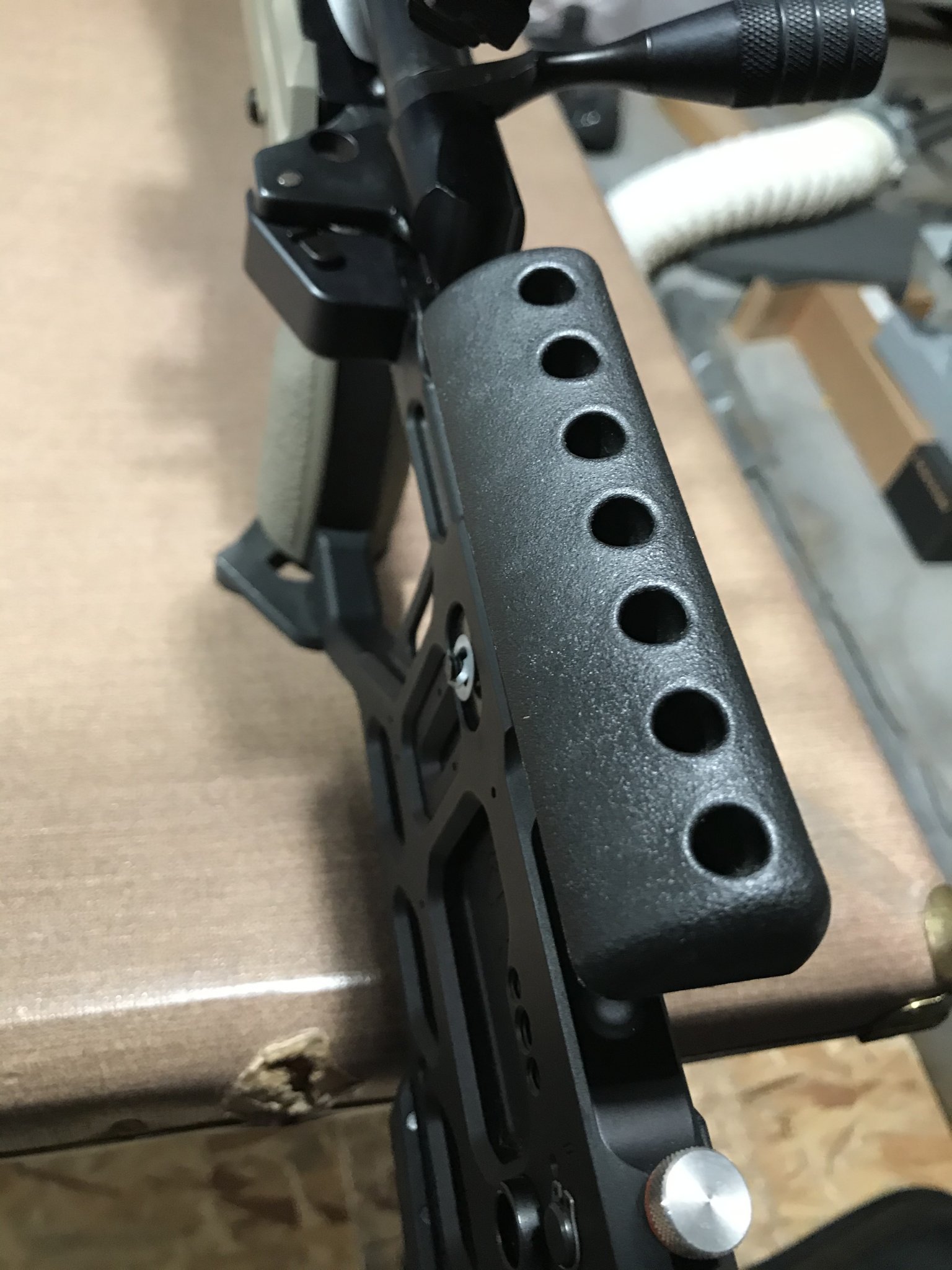

The main thing for me was around the grip. I really like the MDT vertical grip with a tiny thumb shelf. Makes it much more comfortable to grip for me than the Bravo. The more pronounced mag well / barricade stop is nice as well. That's really about it. Everything else about the Bravo can be modified to get there -
$68 for an arca rail
$68 for the adjustable buttpiece
But unless I file down the grip and make it fit me better, not much can be done there.
It matches my T1X as well.

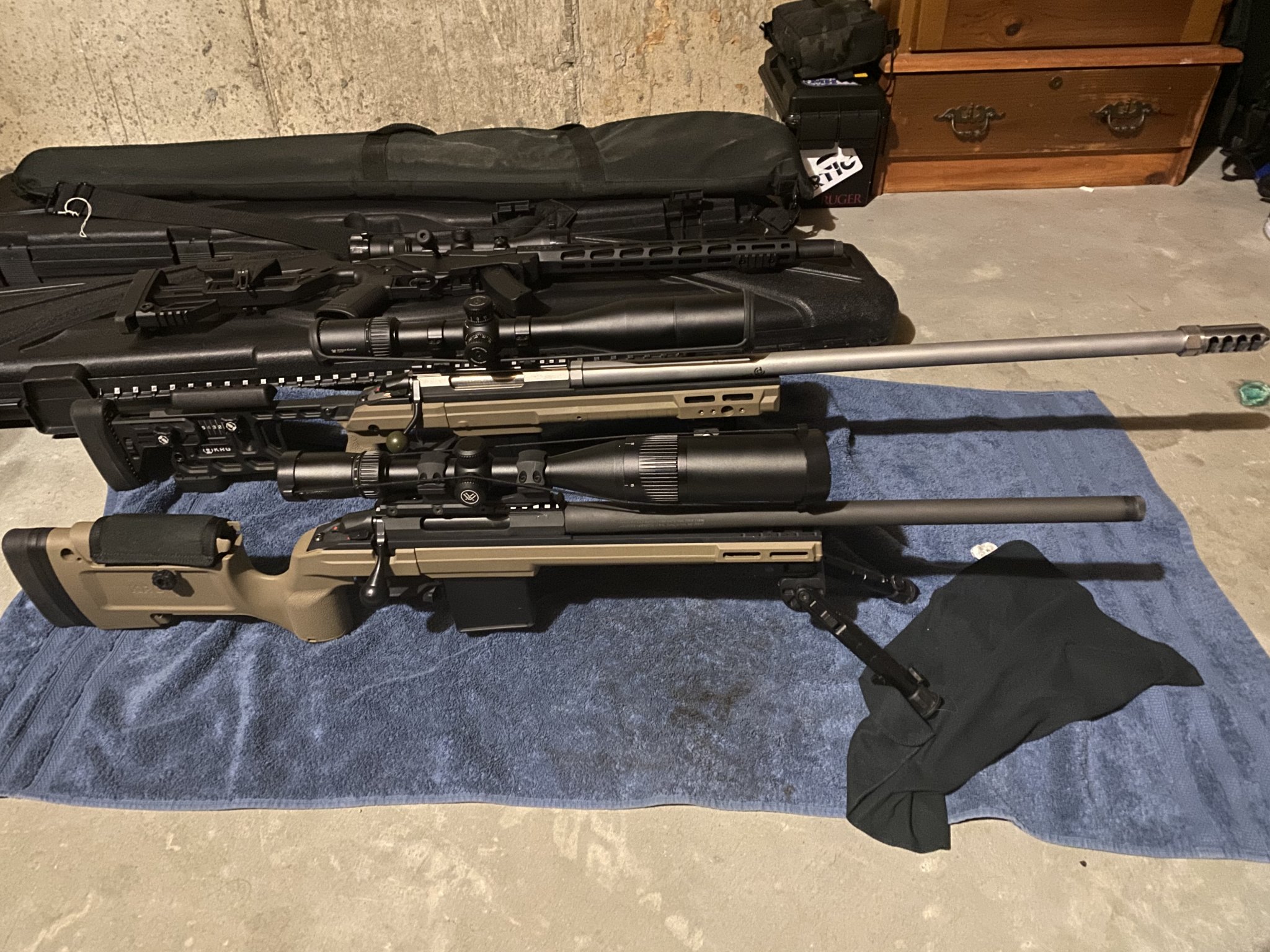

So I have now a bravo (thanks to @littlepod ??) and have had a whiskey 3 for a few months and either one of those is a great option depending on what you want to spend. Both offer adjustability, stability, look great, offer tons of mounting points for different things.

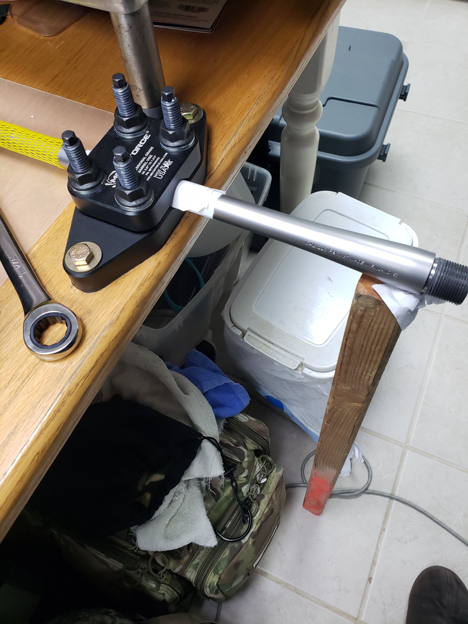

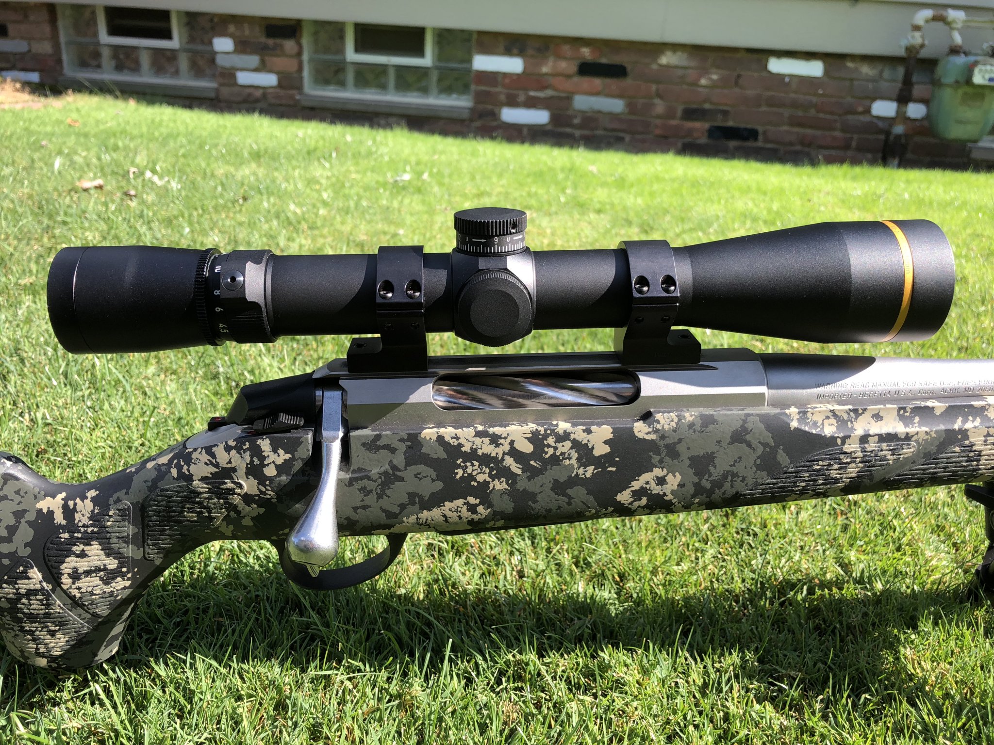

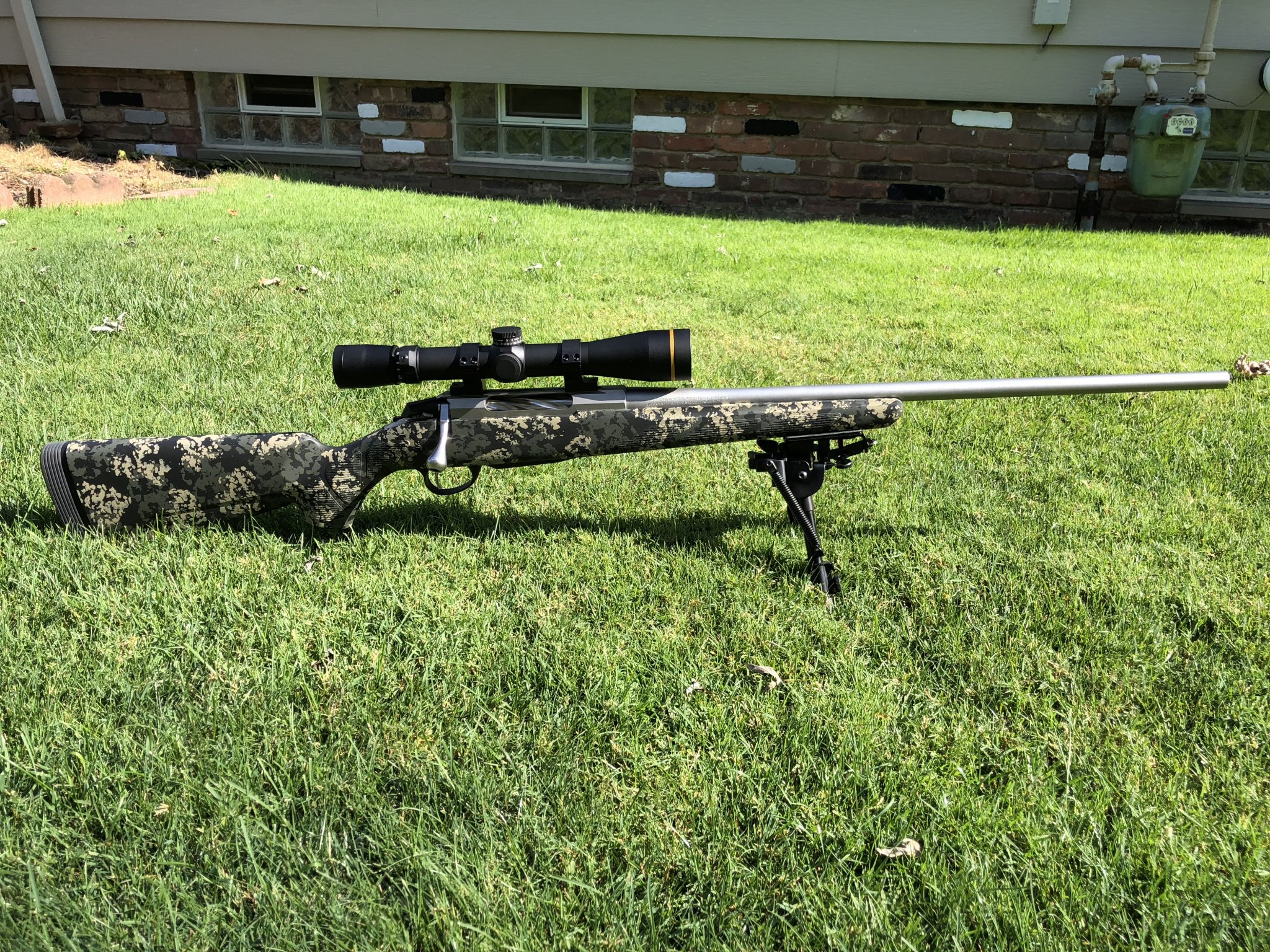

I assembled my first FrankenTikka today out of parts I had. Wanted to relay a few things:
1. Using a stainless .223 T3x Lite as a donor rifle, removing the barrel was a piece of cake. I was actually disappointed when the thing came off without any problems. Had my eye and ear protection on, 4 pound hammer in hand and was ready to give the action wrench a good smack. I did a half-assed test hit and the thing spun right off.
2. The threads were thoughtfully coated in some kind of anti-seize grease.
3. I spun on a spare 20" 7mm-08 Tikka barrel I had laying around. It tightened up with the caliber lettering landing in exactly the right spot. Checked witih Forster headspace gauges-- perfect. Bolt closed on the GO, wouldn't close on the NO-GO.
4. Dropped it in a CTR stock and torqued it up. Feeds and ejects perfectly.
This shit is Legos for adults. Stuff just snaps together and works great.
Below is how I remove the barrel. I grab the barrel where the taper flattens out and then support it with a 1x1. That takes the flex out of the system. Using a Wheeler #1 action wrench clamped on the flats, 90 degrees perpendicular to the 1x1, give a good whack (or half assed whack) with the hammer and it's done. Three sheets of copy paper grip the barrel and leave zero markings.
Build away, ladies and gents! It's fun!
(Anyone want the barrel?)
ETA: Yes, I had a spare 308 bolt as well. I'll keep the 223 one incase I want to make another 6.8 SPC Tikka.

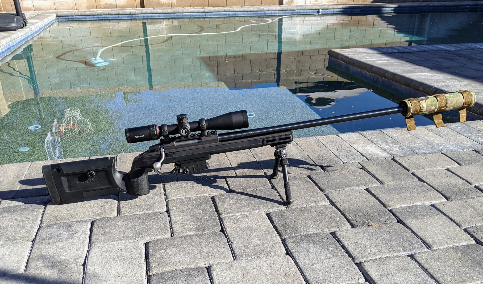

I just got around to checking the group sizes from my second outing with the 24" 6.5cm CTR. I didn't think the gun liked the Hornady 147gr ELD-M as much as either the 140gr ELD-M or the 140gr BTHP. My suspicions were confirmed by measuring the groups but, it is not as bad as I thought it would be; group sizes at 100 and 200 yards are about 1/8moa larger with the 147's. Since I just added Ballistic-X to my app collection, might as well post up best 200yd group from Sunday.

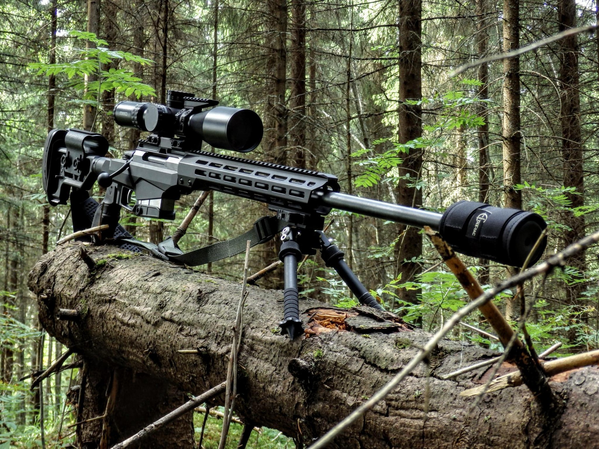

Tikka with Bravo chassis on, was a TAC A1, i sold the chassis and drop the action to the Bravo chassis.

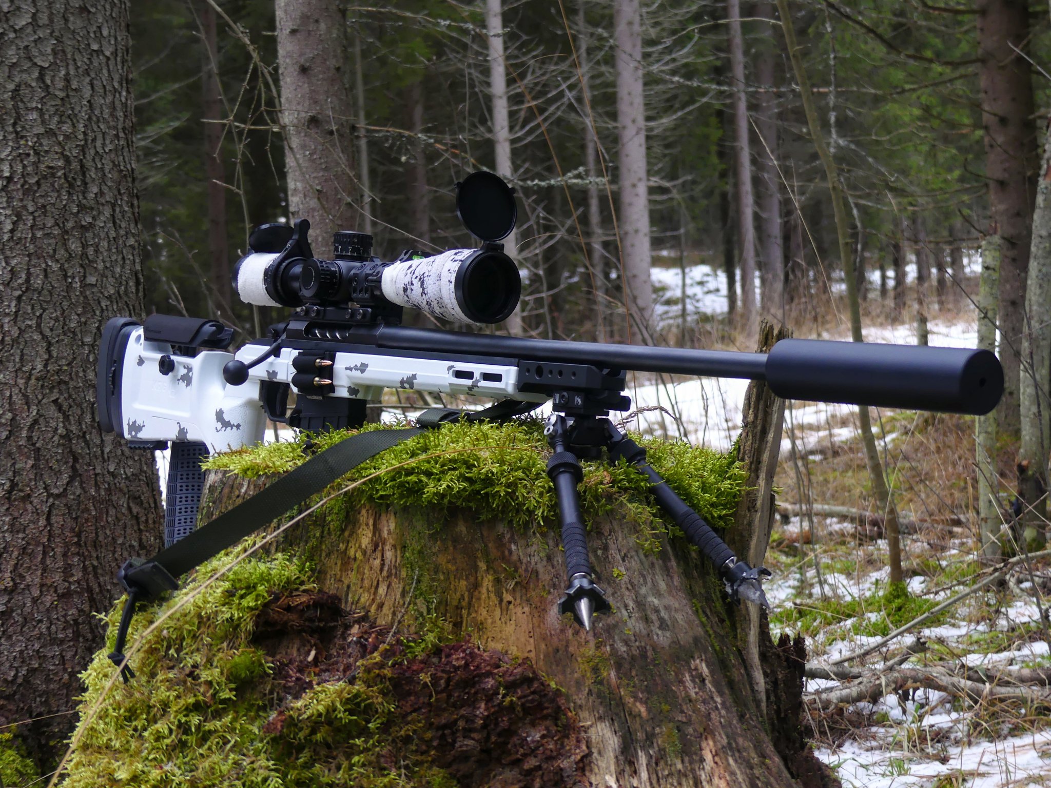

I have barrel changed, Krieger SS barrel on now, gunsmith told when i asked, was it any hard to get out, hi told me that nothing more than normal bolt action.
But if you have black action and naturally black barrel that is done in the factory, and if it has been there for a long time, it might get rust on the threads, and that might be pita to take of.
Mine was also rust on the barrel threads, since snow and s..t here in Finland.
Stainless i bet is easier to get of, since it does not have that much to rust, but Tikka SS will rust if you let it wet in your gun bag, have seen those rifles too :D
Here´s my Krieger Tikka, shoots like a dream.
6.5 Creedmoor.
Gunsmith in Finland was Ensio Firearms, they do custom rifles and custom jobs too.
