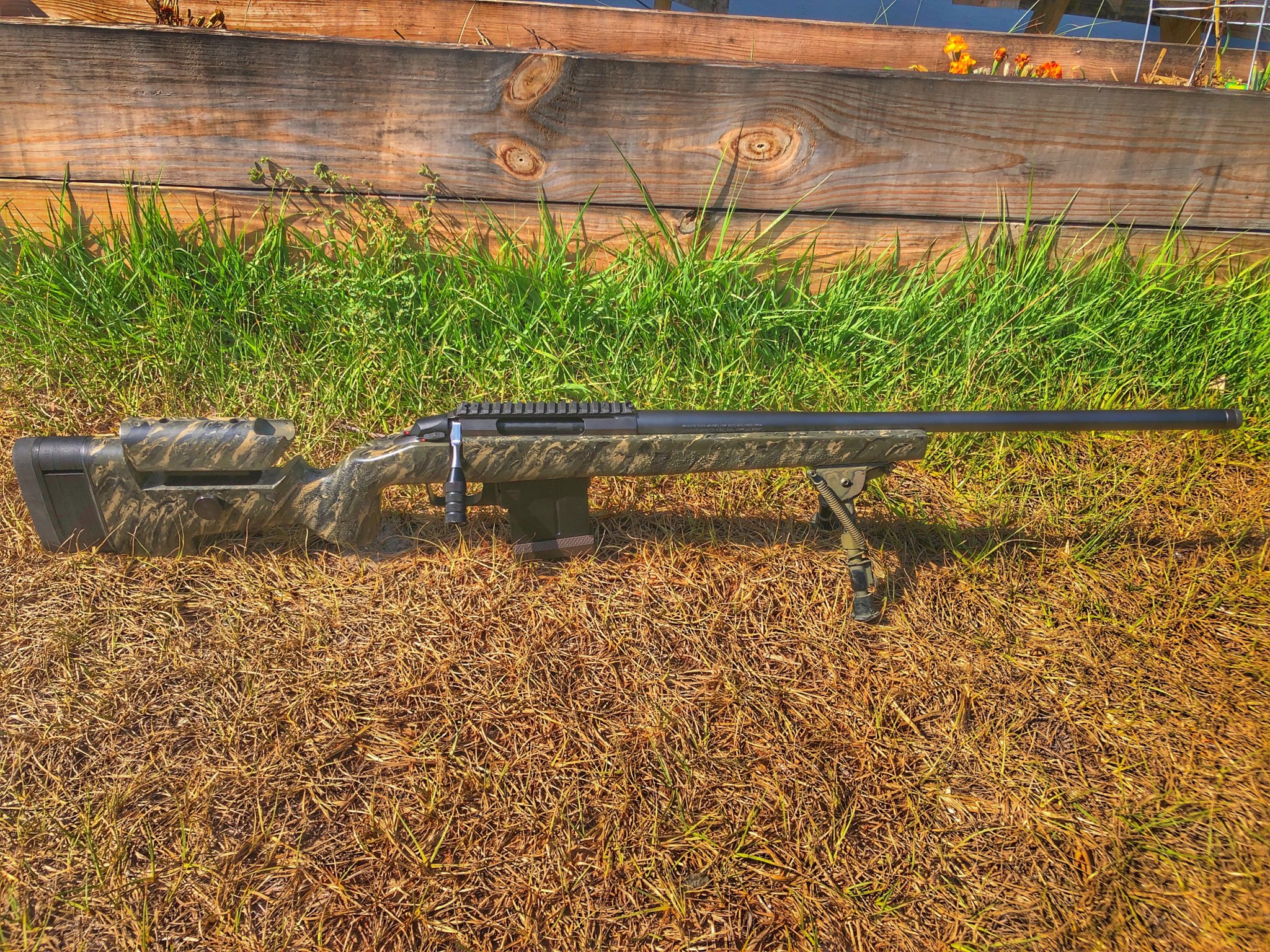

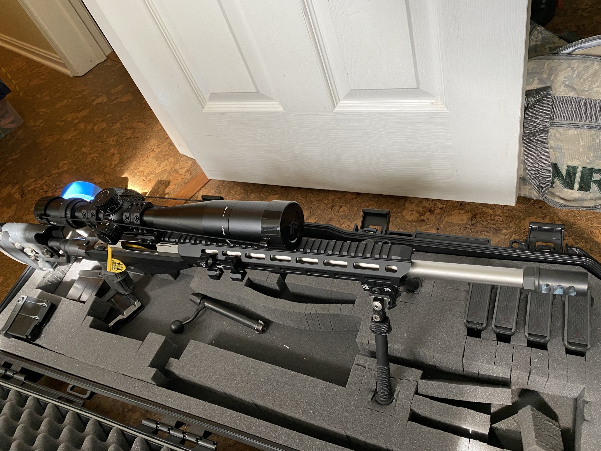

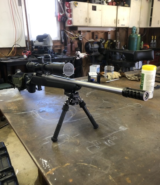

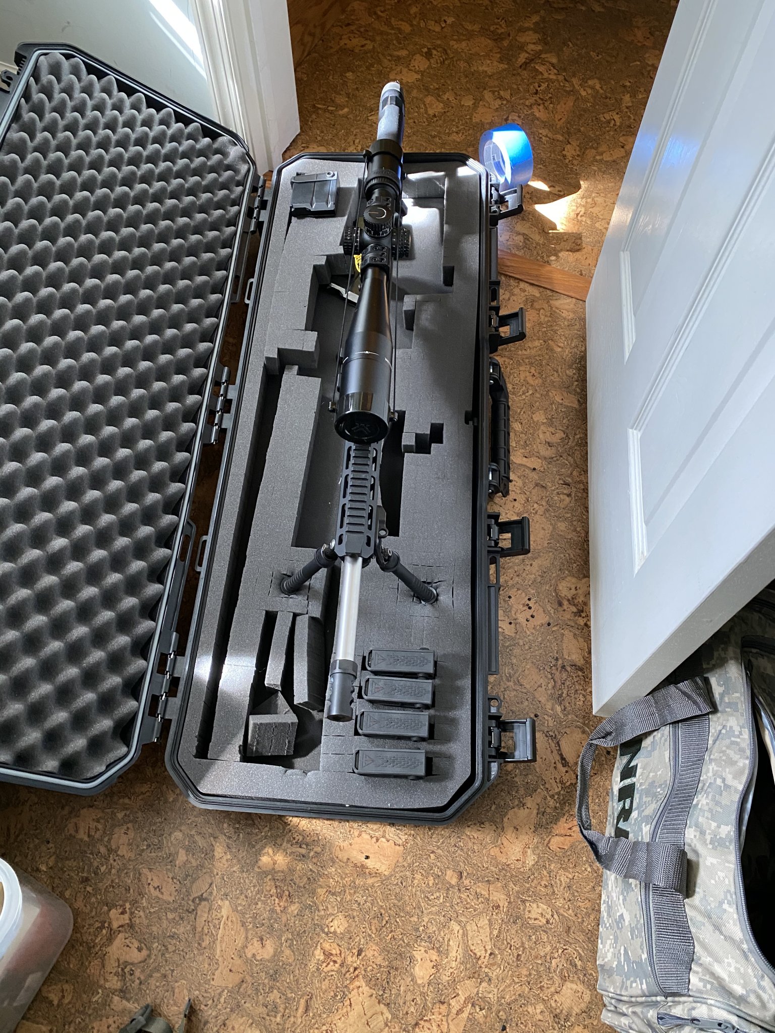

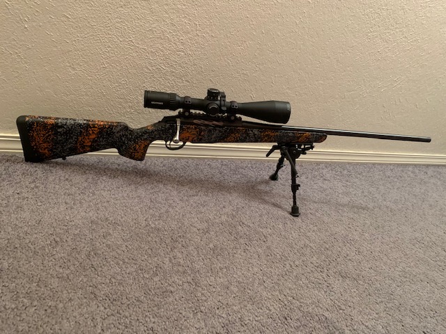

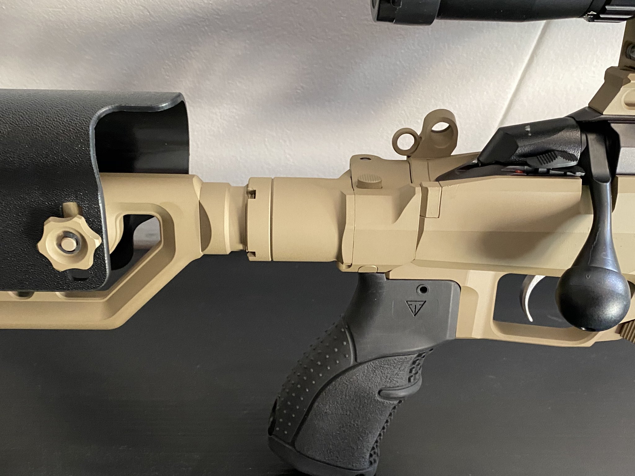

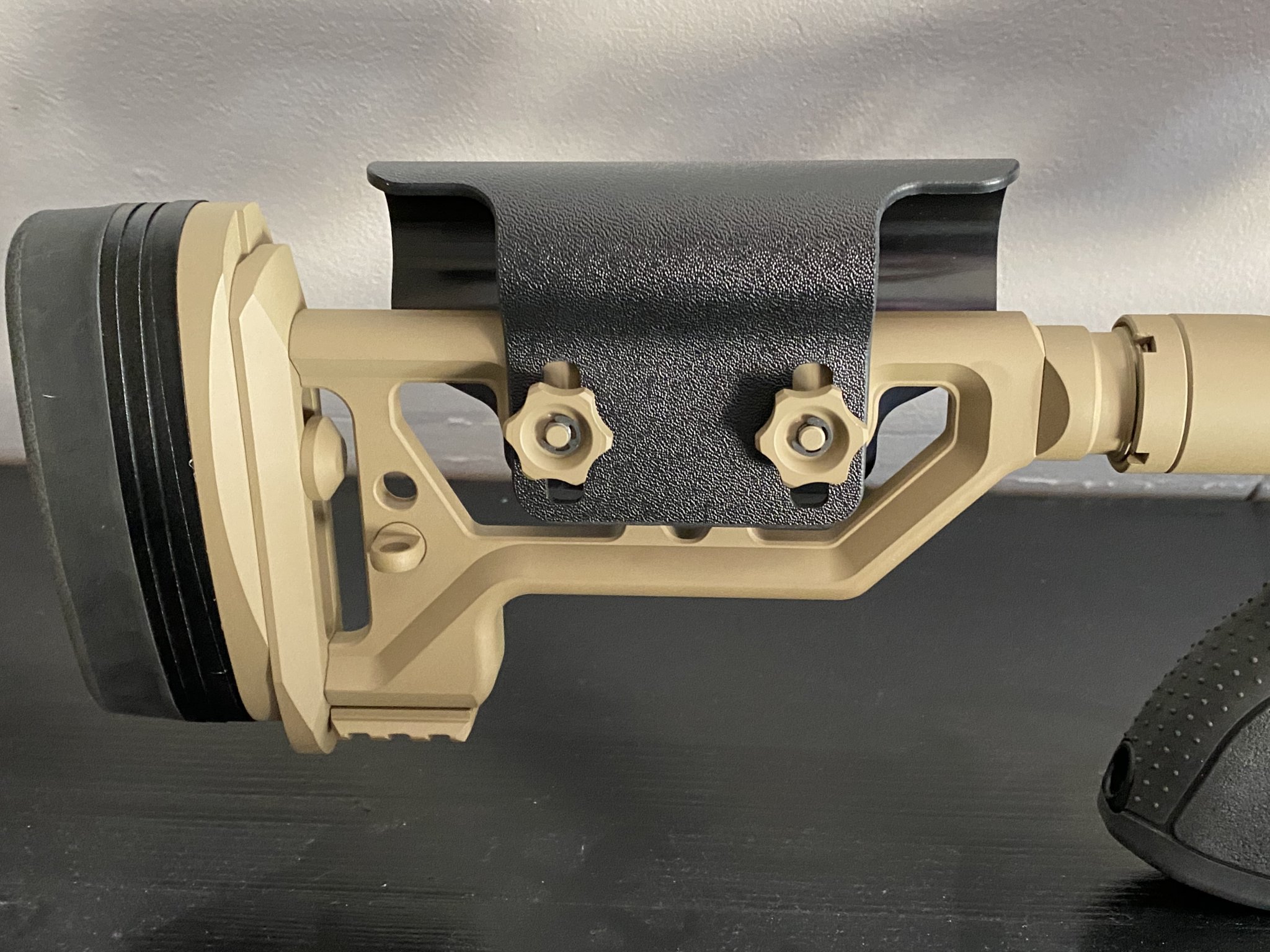

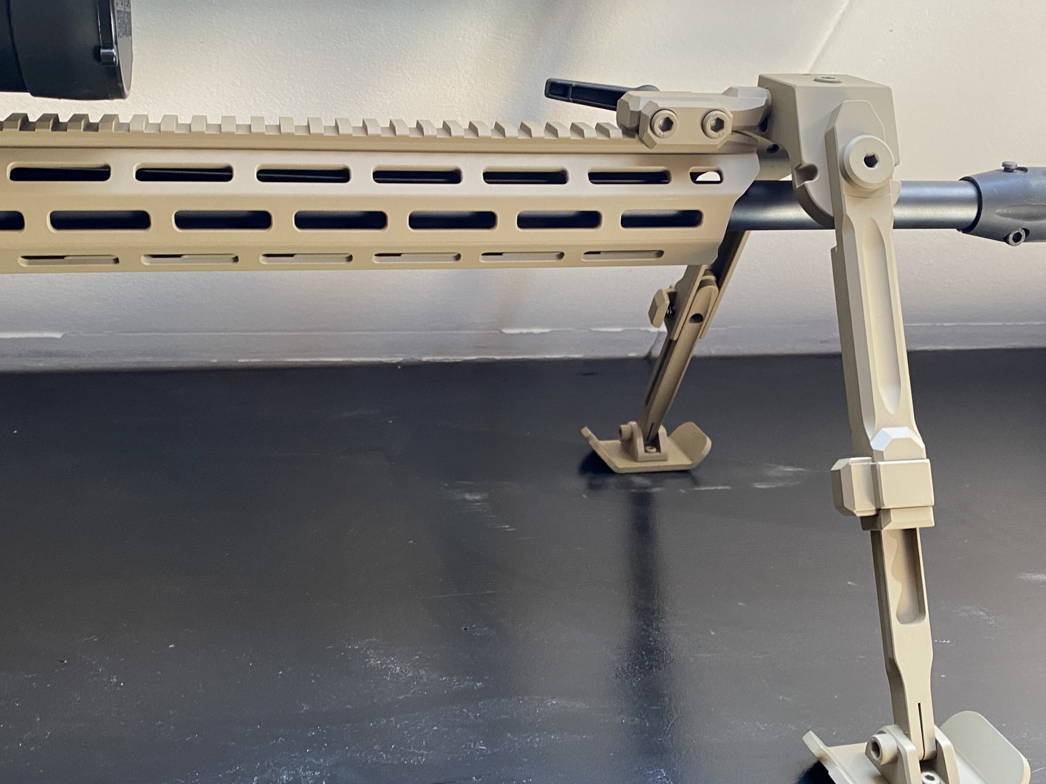

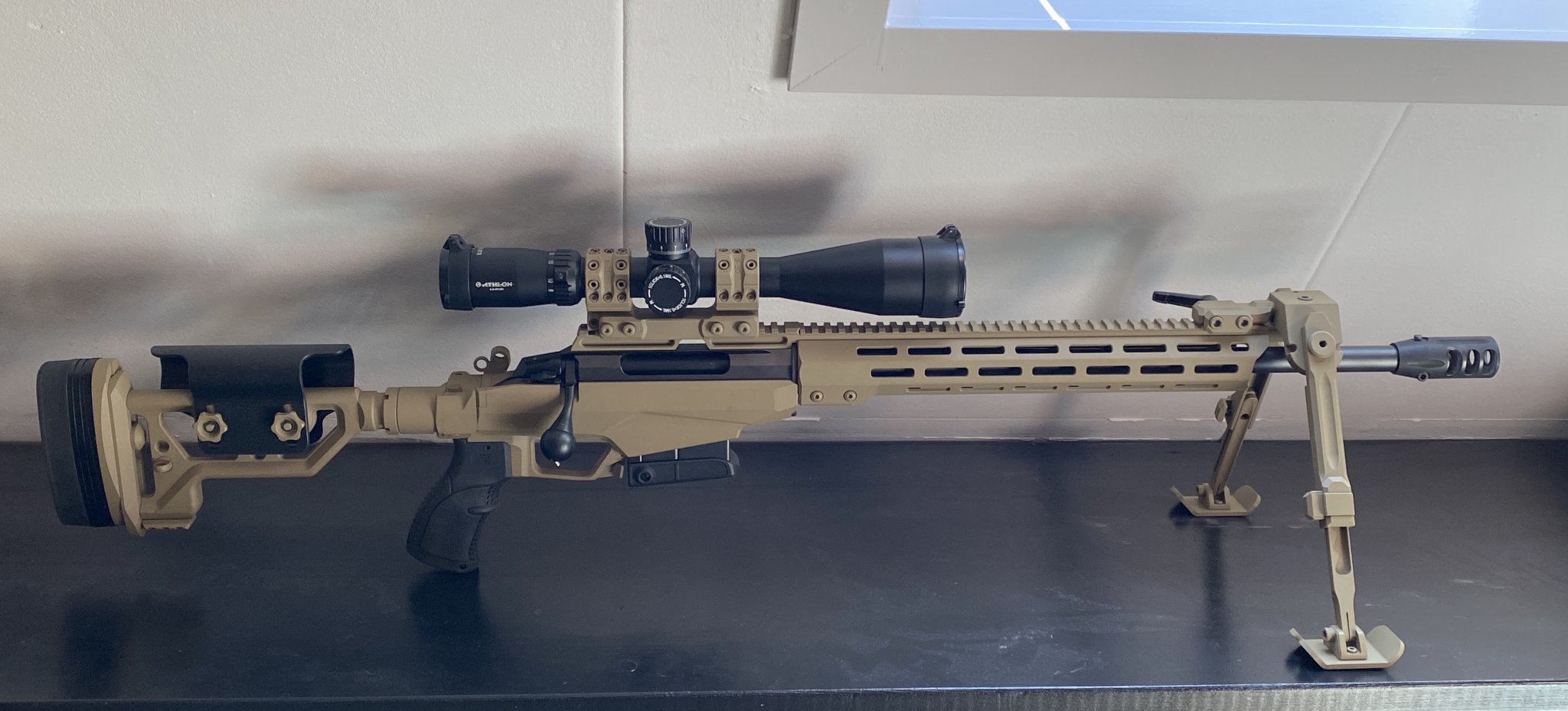

after some assembly ;-)
Tikka T3X Varmint- 6.5 Creedmoor
Oregon Mountain Rifle Co. Factory Carbon Barrel upgrade/bolt fluting/Cerakote
Leupold Mark 5 HD 3.6-18 TMR
Hawkins Precision 35mm low rings
Spuhr 20 MOA rail
Mesa Precision Altitude stock
RedSnake Tactical DBM
Sterk Titanium bolt handle/shroud
Tier One Tactical Bipod
Area 419 bipod rail
Elay Precision trigger spring
View attachment 7286915View attachment 7286916View attachment 7286917View attachment 7286918View attachment 7286919

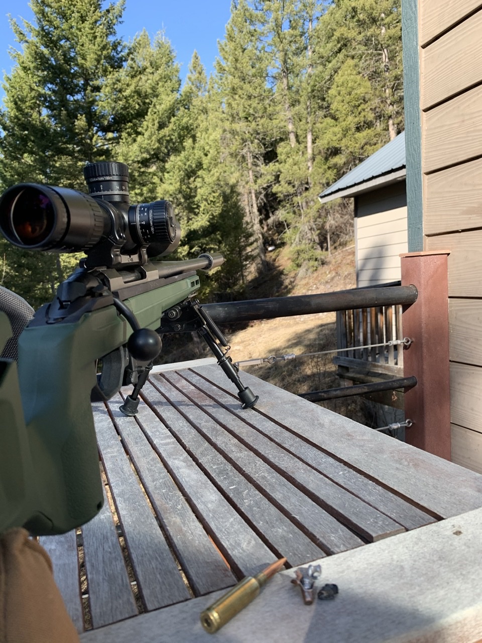

Nice looking setup! Waiting on a MP stock for my 28 Nosler.

Found a Tikka CTR (older discontinued version) .260 for cheap. Will be getting a KRG Bravo stock ASAP. Which is better, keep using the Tikka mags or use AICS mags?
Just got a new Bravo set up today. Subsonic suppressed 6.5 CM range right off my deck, pretty sweet. 1020 fps, zeroed at 50yd, 1.0 mil at 75, 2.0 mil at 100 with 140 gr Hornady BTHP. They go through three milk jugs at 50 and open up pretty well. View attachment 7294360
