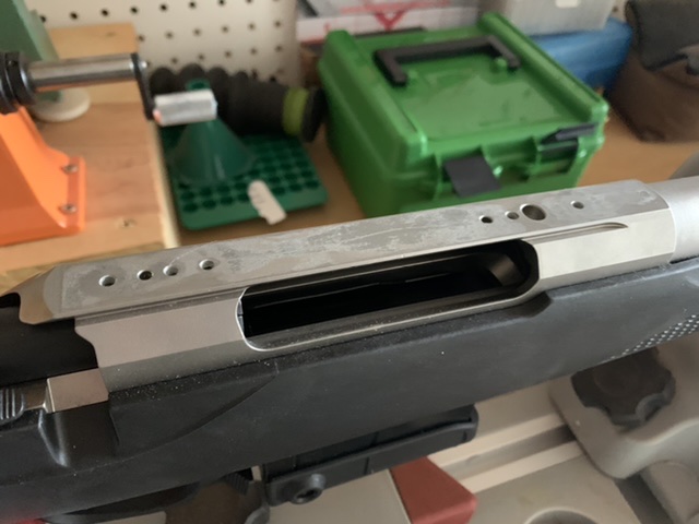

Got the factory rail off today. It took about 5-7 minutes with a heat gun at 800 degrees. A little wiggling with some vise grips and it came right up.
I’m not sure how to get the residue off. Gonna have to figure it out before the new Area 419 20 MOA rail shows up next week.
Use a razor blade

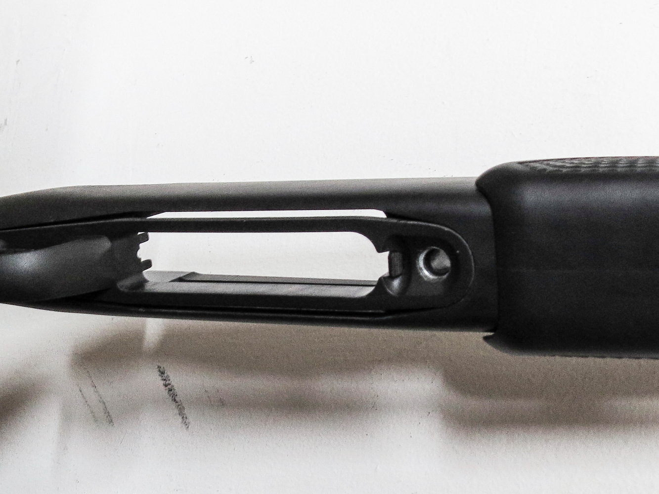

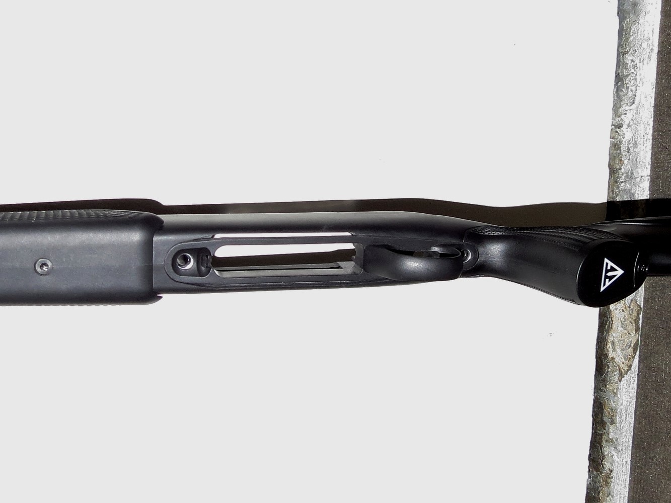

I sold my CTR bottom metal and magazine, so now I need some sort of bottom metal and mag, does the T3X Lite plastic bottom and magazine work in the CTR?
Thanks!
I’d just find a standard T3X stock and bottom metal, I’ve seen them for around $40. You would need to dremel the barrel channel a little and find a magazine retaining clip that screws onto the trigger assembly Or make one out of a sardine can top. Then you’d have the fine CTR action and barrel in a light compact package.
Nice! I'm looking to do this.. some people are saying its a total pain to get these off is it as bad as people are saying?
Not at all, if you have a heat gun. Could be a bit more difficult to use a torch or clothes iron.
My son had a heat gun that worked beautifully.
Thanks I just picked up a CTR bottom metal & mag... I'll get my old CTR stock up back and running pretty :)
I didn't use heat at all. The screws backed off and then used a rubber mallet to wiggle the rail off.
Reactions: Qwkcrss
It's funny because half the stories I hear are bad.. the other half there's no issue
