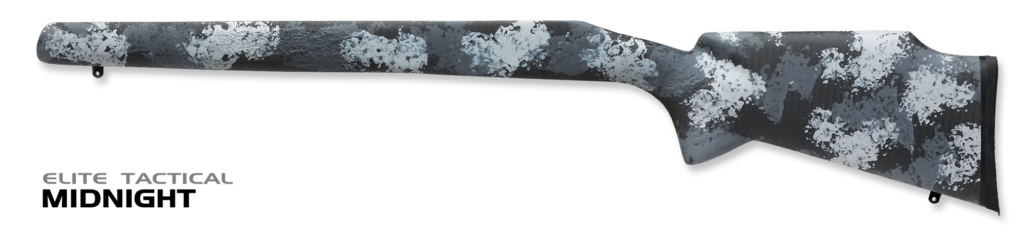

What do you all think a tikka ”Roughtech” stock (Tan with black spiderwebs) —Stock only — is worth on the exchange? This is the stock included on their new 2020 roughtech model.
Would guess somewhere between a regular stock and a Bravo. But not a lot of reviews yet. Could be about same as a Bravo. $2-350

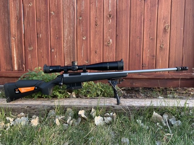

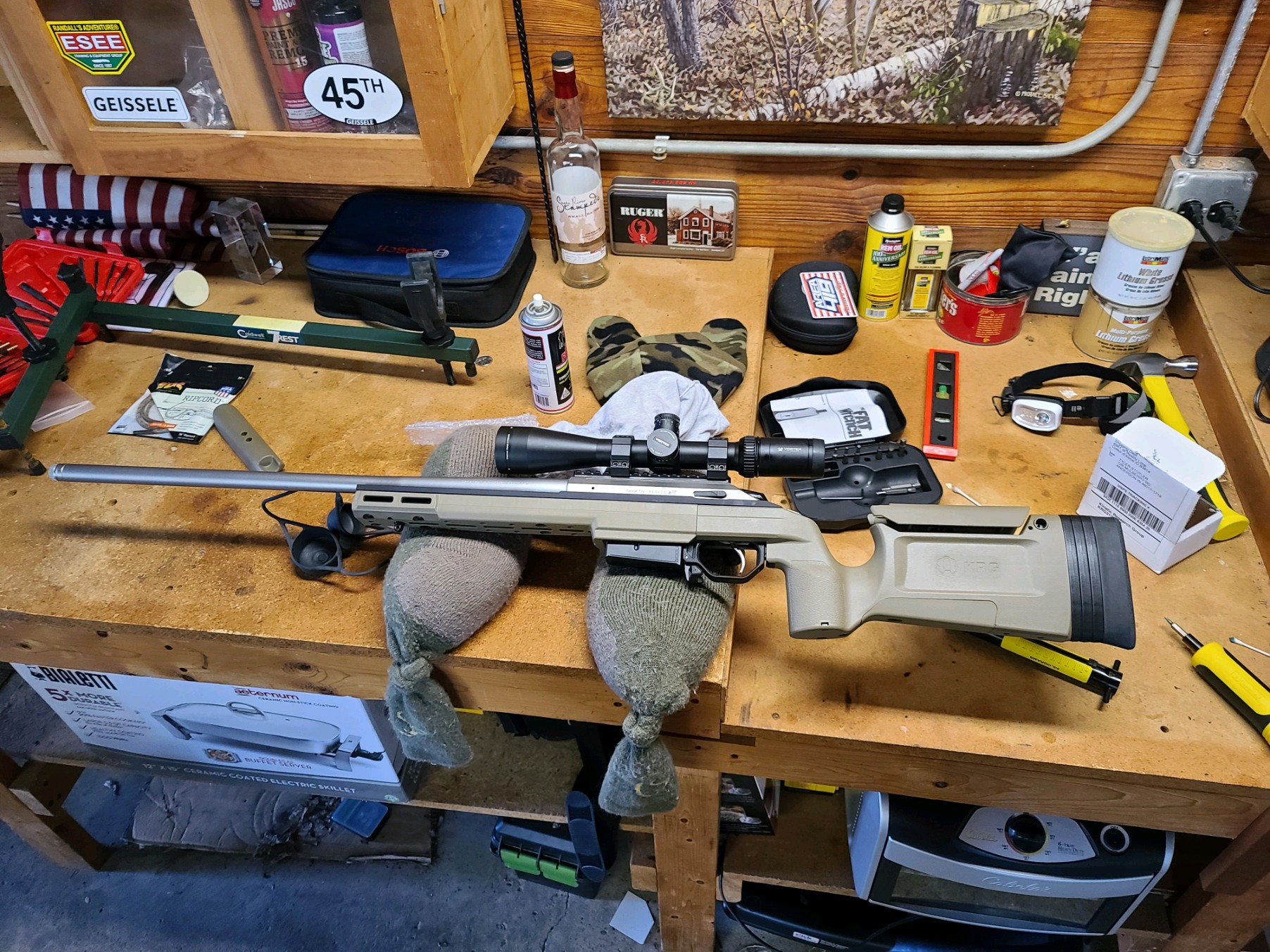

Getting close. Still got to bore sight it, and install a bubble level. Weighs 12 lbs like this.

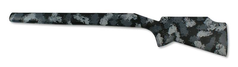

Looks like the new for 2020 Roughtech T3 I ordered is on its way to my FFL now so I should have it in hand next week. (Tikka T3 JRTXRT316 T3x Lite 308 Win 3+1 22.40" Tan w/Black Spider Webbing Roughtech Stock)
if anybody is interested in any particular measurements/dimensions let me know.
im most interested in their new “D18” barrel contour so I’ll definitely post some dimensions on that.

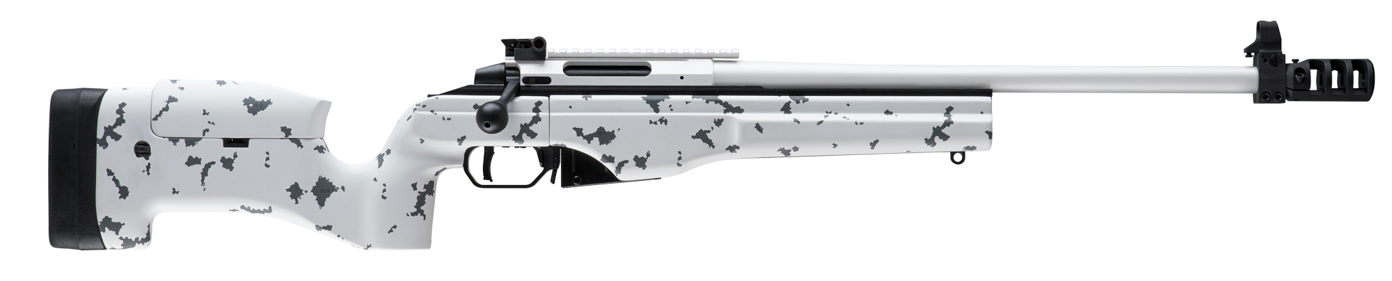

im looking at sponge application of some spray paint on mine. I’ve never done camo paint myself, any suggestions?
I have done sponge. It’s easy. Can replicate many of the manners type camo that way.
Currently looking for some digicam cutouts to try my take on the TRG 22 anniversary.

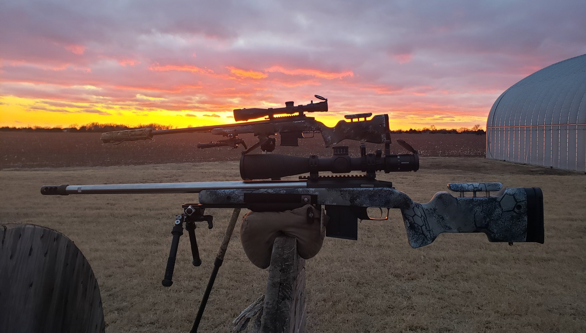

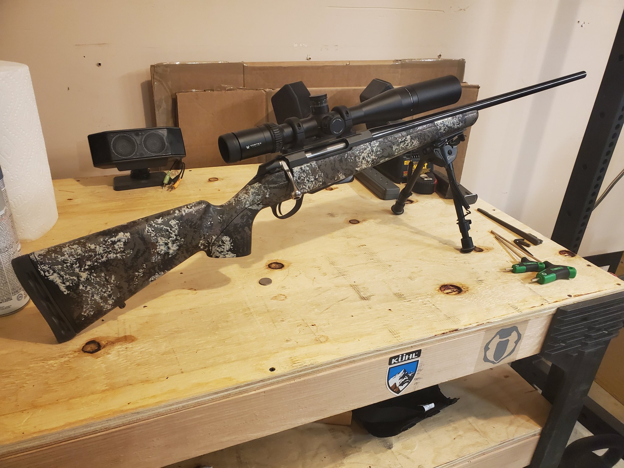

I have 3 German Gun Stocks that I ordered for the CTR inlet and I have two of the Mountain Tactical bottom metal for AICS magazines. I run the CTR bottom metal in one. Have whatever stock you buy inlet for the CTR bottom metal and that will give you more options. MT and Atlasworks both make the CTR inlet for AICS magazines. I have one CTR and two T3 action based builds, they are all interchangeable as far as footprint.
First picture is a 223 T3 Varmint with MT AICS/CTR
bottom metal, second is a T3 CTR with CTR bottom metal, third started as a T3 270 and is a 22BR/6.5 Creed switch barrel with MT AICS/CTR bottom metal.

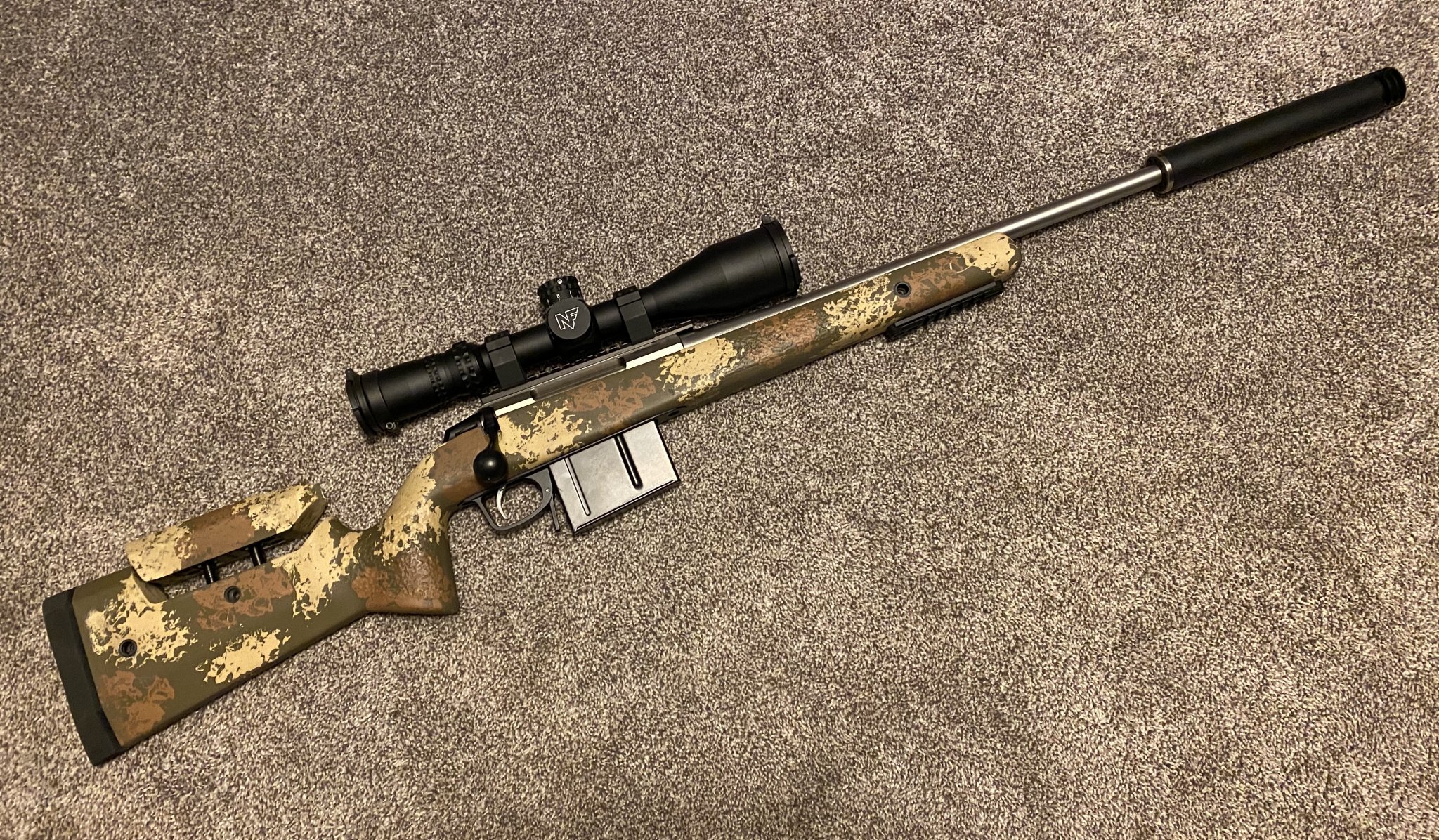

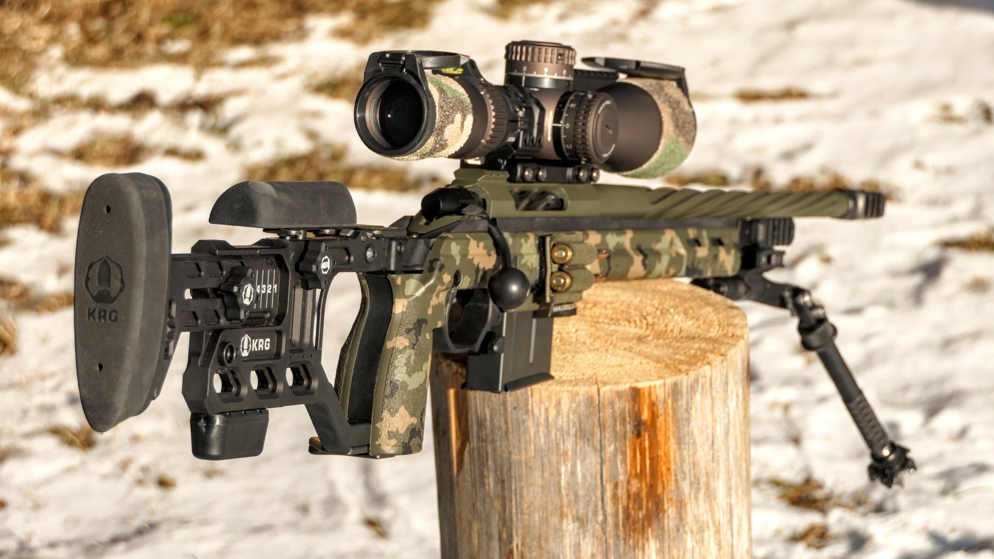

Just finished this beauty, so i would like to hear what do you think of it ;)
Tikka T3X CTR 260rem.
KRG Whiskey gen III
Spuhr
Vortex Razor HD2
BT bipod
MDT Elite brake
Barrel spiral flutend and custom cerakoted.

First, amazing-looking rifle! I'm thinking one day I just may upgrade my Tikka CTR to a Whiskey 3.
I have a Vortex Razor HD Gen2 4.5-27 (Mrad, of course...) on order. I want to mount it in a Spuhr, but not sure what height to order. Which Spuhr do you have your Razor in?
Thanks.
Reactions: viking78

viking78,
Thanks.
I think you could go with the same model i have, since i had Kahles K624i scope on that mount, and that Kahles had 56mm object on that scope, so get SP-4301 it has 6 MIL cant, about 20 MOA.

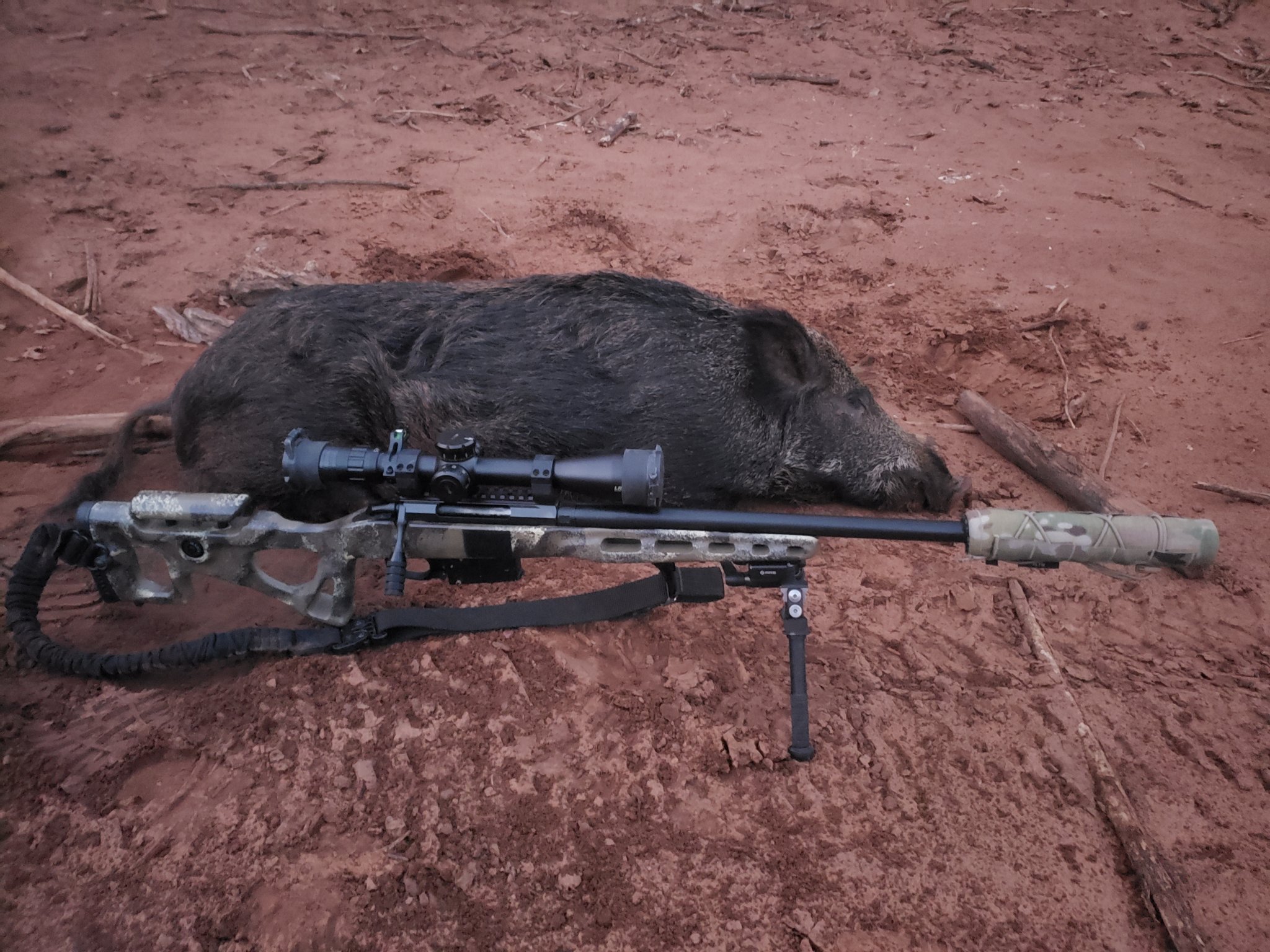

Still waiting on a 7mm blank but here it is with an 18” 300 WSM factory barrel installed.
That Harvester 300 is rated for a 20" barrel on magnum calibers.
With that said you might not ever have a problem with yours and all I can do is tell you about my experience.
I had a 18" barrel in 6.5 PRC that I was going to use hunting so spun it on not really thinking that 2" would make a difference.
Went to the range and after multiple shots my hits started going all over the place and I thought my scope was crapping out on me.
Picked my rifle up off the bench and it sounded like rocks rattling in a tin can so I unscrewed the thread adapter and about a half dozen pieces of baffle came falling out including the first baffle which had multiple bullet strikes which had evidently caused other strikes on down the can.
It knocked out pieces of the baffles the whole length inside including some hits on the anchor brake.
I'm lucky that the case stayed intact and didn't blow out the sides or it could have done some serious injury.
I called SiCo and they were great about the whole thing and since there was no damage to the outer case they were able to refurbish the whole can with all new baffles,brake and all free of charge including shipping both ways.
I had shot hundreds of rounds through my can on my 24" barrel with no problems and continue to do so now.
So was it the 18" barrel that caused it or just a fluke ?
Who the fuck knows but I won't push my luck again LOL !!!
