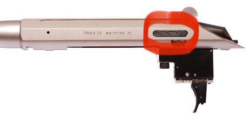

A bolt stop (release) would not cause that issue as it has nothing to do with the firing sequence. . Completely unrelated. Not closing the bolt all the way down against the action when chambering a round, or a dirty firing pin could cause it. The pin needs to be free of grease and oil. Check that.

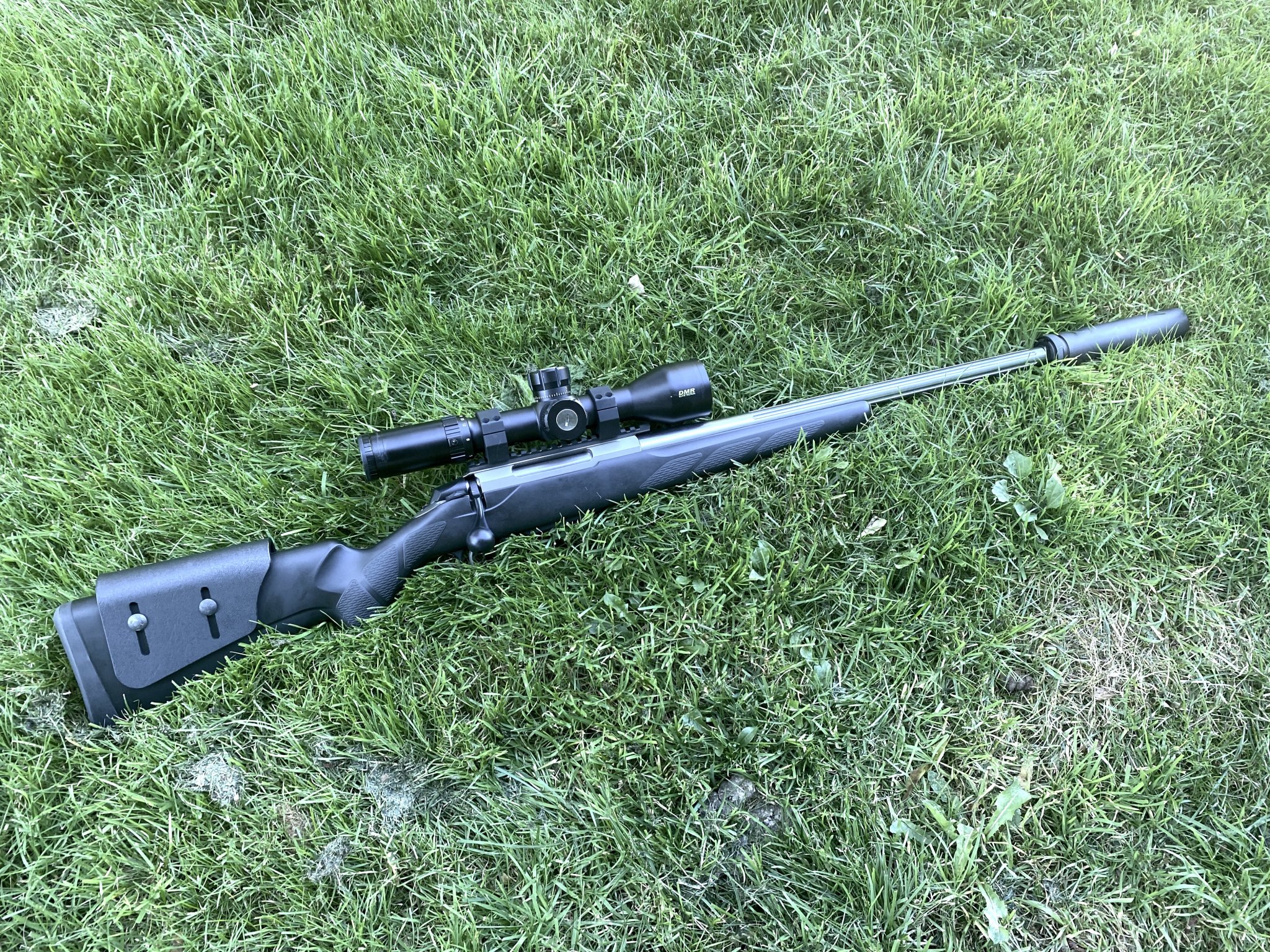

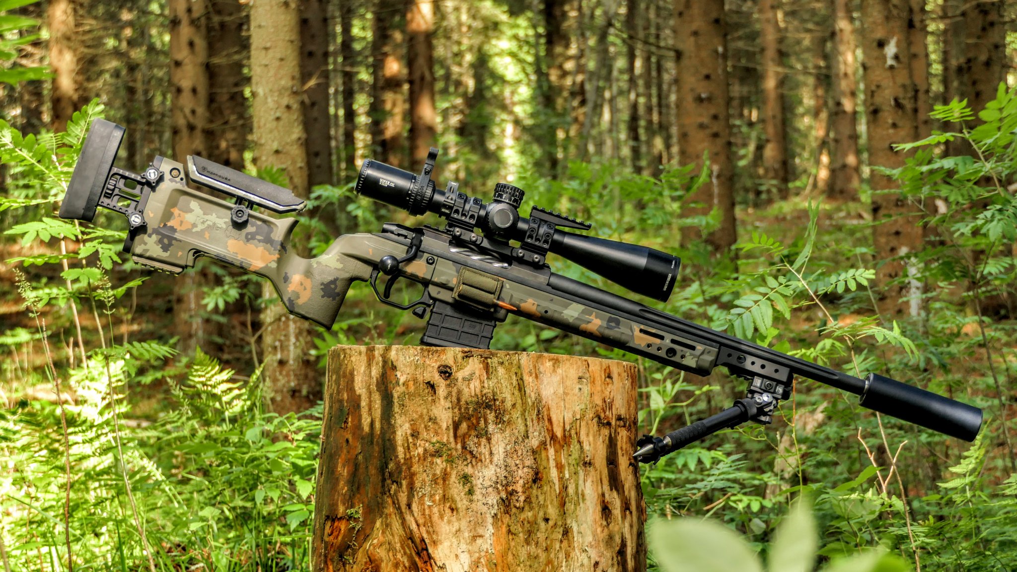

T3 30-06
VX5-HD 3-15x44
MPA Altitude stock
Another thing you could try is adjusting your trigger pull slightly heavier. I am not 100% sure this would help but worth trying.
It is at the pull weight it was delivered at, and functioned perfectly at for a solid 3 years at while in my Mcrees chassis, but, will investigate as well. Thanks.
Nice stock. Is the comb high enough for comfortable use with the scope? And do you know the weight of that setup?
The comb is higher than factory. It works well for my face and position, although another quarter inch would make it perfect. I may switch to a different scope mount to bring it down.
The total weight as pictured, minus bipod, is 7lbs 15oz.

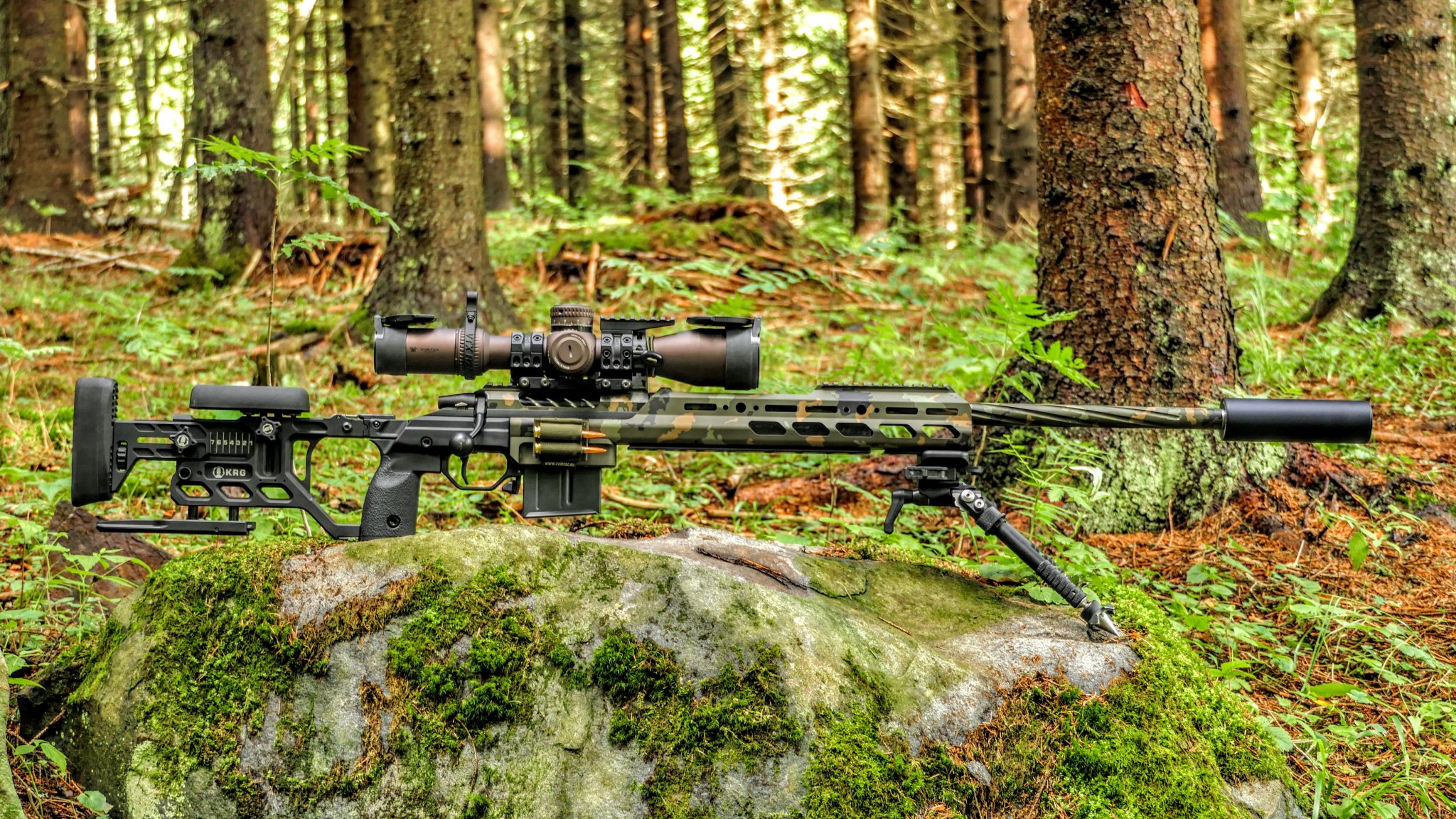

Thinking of a PRS-Hunting crossover build. Tikka 243 in an XRS chassis.
The alternative is a Lithgow LA102 but there aren't any hybrid style chassis systems available for them that I know of... and I don't want to go for a heavier setup like the ESS for use hunting.
