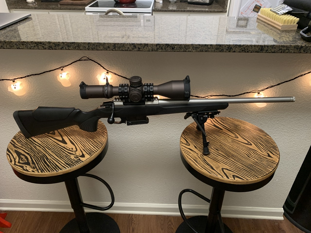

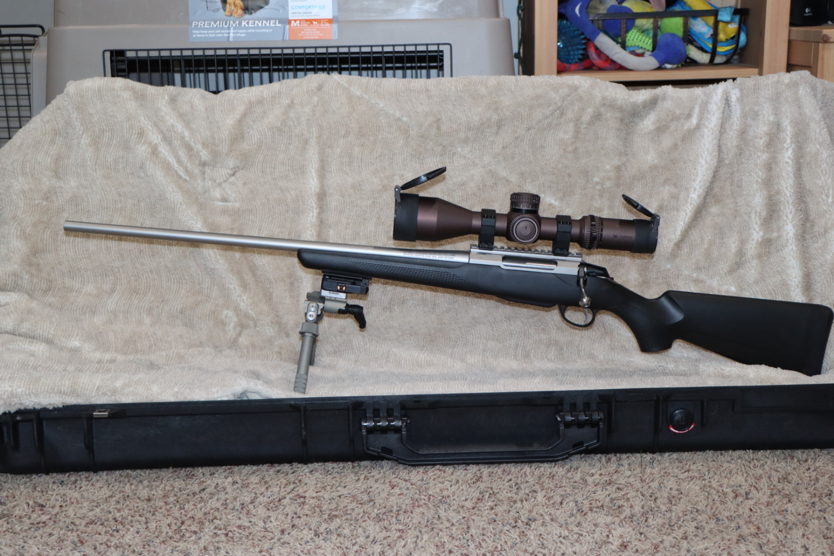

Finally got my Tikka! It's my first centerfire bolt gun. Bought it from Scheels on Saturday and got pictures of it today. Took me 3.5 years to get because I kept raiding my gun fund for other gun stuff (10/22, tbac22, razor 2, a better savage 22lr, atlas bipod). I even bought a case of prime 130's for it 11 months ago. Been nice to get the parts over the years cause I can now use it all together.
Tikka jrtxb482 lefty stainless t3x lite 6.5 creed
Vortex razor 2 4.5-27x56 7c mil in vortex precision rings (used off the hide)
Murphy tactical 20moa titanium rail
Caldwell sling adapter, rrs sc-lr, rrs atlas adapter spacer, atlas cal gen 2 no dye (thanks @Kasey)

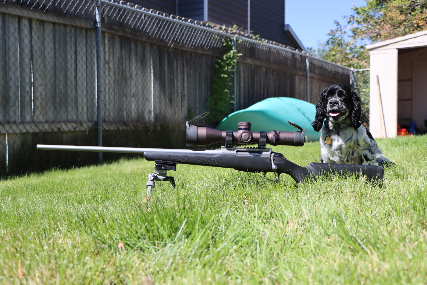

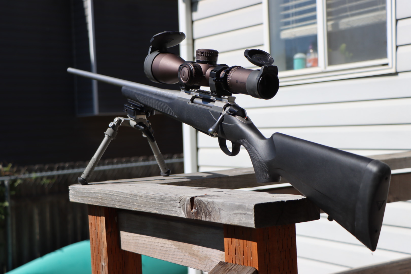

My dog Daisy decided to help with pictures.
Going to keep it in the tupperware for now til I can get a good chassis.
Haven't shot it yet but will soon.
Will also be upgrading it with a Sterk shroud at some point too. Probably a gen 2 or trg style. Haven't decided yet. Not sure what I want for bolt handle yet. Never tried anything with a swept handle or any other style of aftermarket handle.
I might as well go with Sterk after ating in @cannoncrossfire so much over the years. His are the best looking.

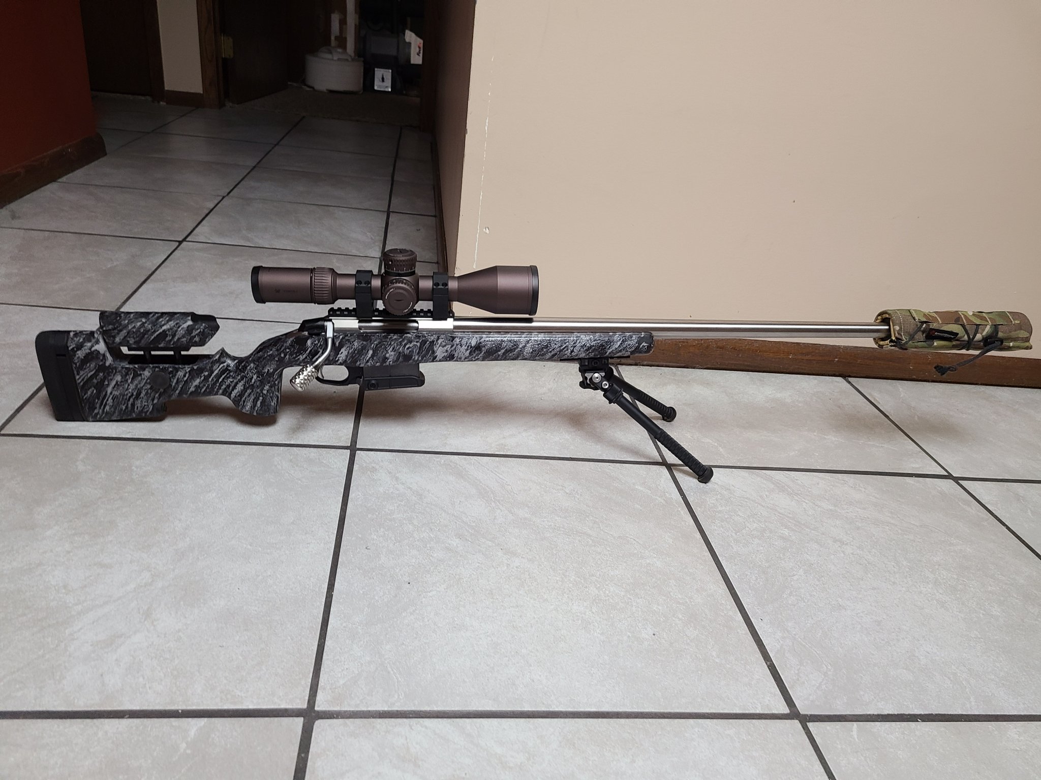

I’m apparently very late to join this Tikka T3 thread. I just got my Tikka T3x built this past Spring. And I do love this rifle. It started out as a new 6.5CM and was rebarreled with a light varmint 8.5 to 7.5 gain twist Bartlein 6.5 Creedmoor barrel. Then I dropped it into a McMillan A5 with CTR bottom metal. It shoots every kind of 140gr pill very well.
I have since added the Area 419 Arca Rail and changed over to a muzzle brake rather than the suppressor.
It is topped with a Gen II Razor in Vortex PMR rings and a 30 moa base.

That thing is absolutely beautiful. I actually just bought a Vortex Razor Gen II today and I have a T3x CTR SS arriving on Friday. I'm super excited. Hope it's a shooter.

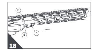

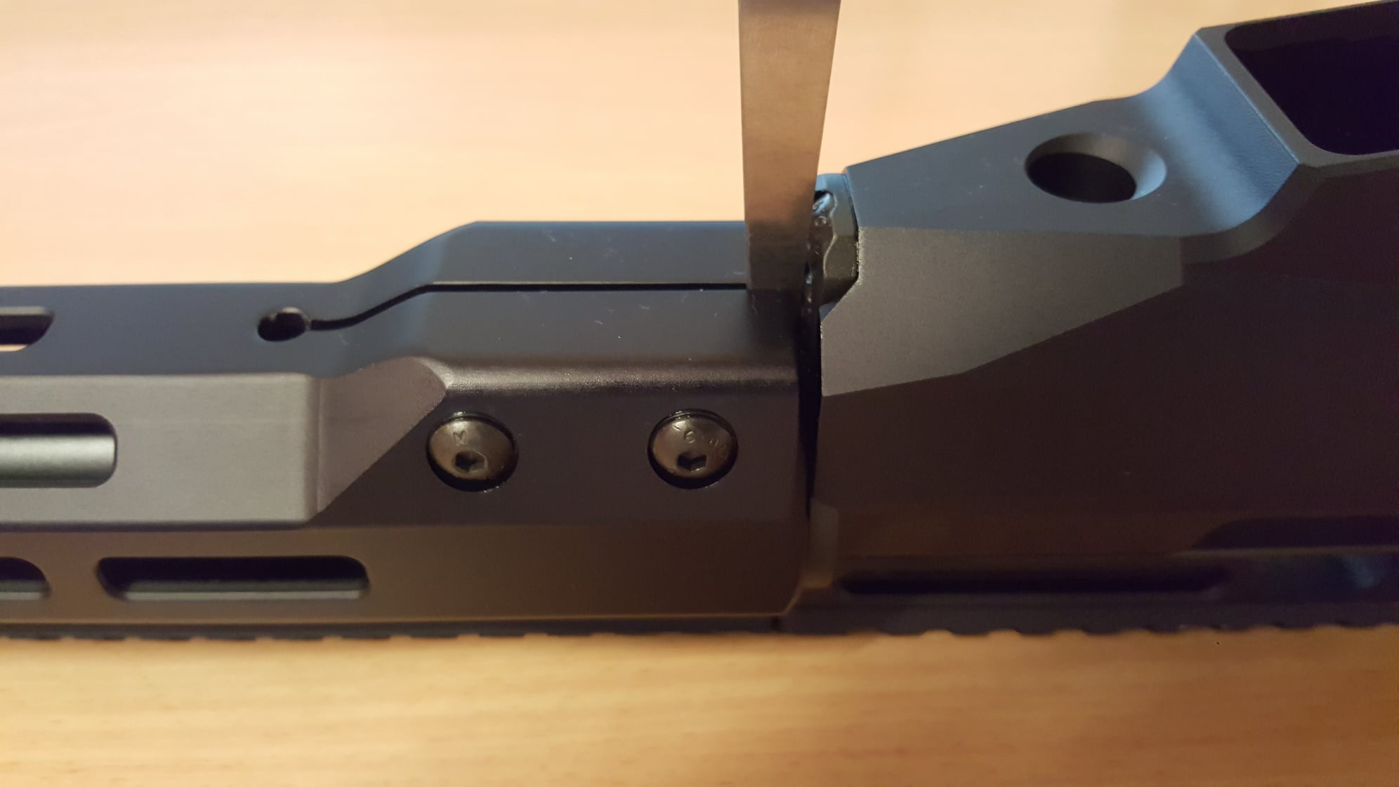

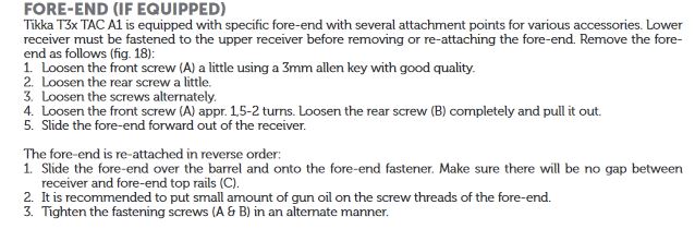

I have reinstalled the handguard on my Tikka T3x TAC A1 and do not know how much to tighten the two handguard screws. Could some of you owners of TAC A1 please take the measurement of the clamp gap at the utmost rear of the handguard and write it here?
Hopefully this will help - the gap I measured was 2.87 mm and torqued to 8-9 Nm / 70-80 in-lb
Note 1 - I have a Blk Lbl bipod
Note 2 - installation of the bipod repurposed the original hardware
Note I have a Blk Lbl bipod
Thanks, but the stock TAC A1 handguard is different. The gap before tightening is just 1.85 mm. I'm curious how much should it be after tightening. I don't want to deform the handguard.
Manual says to oil the screws and tighten alternately.
I guess whatever feels good to the user.....

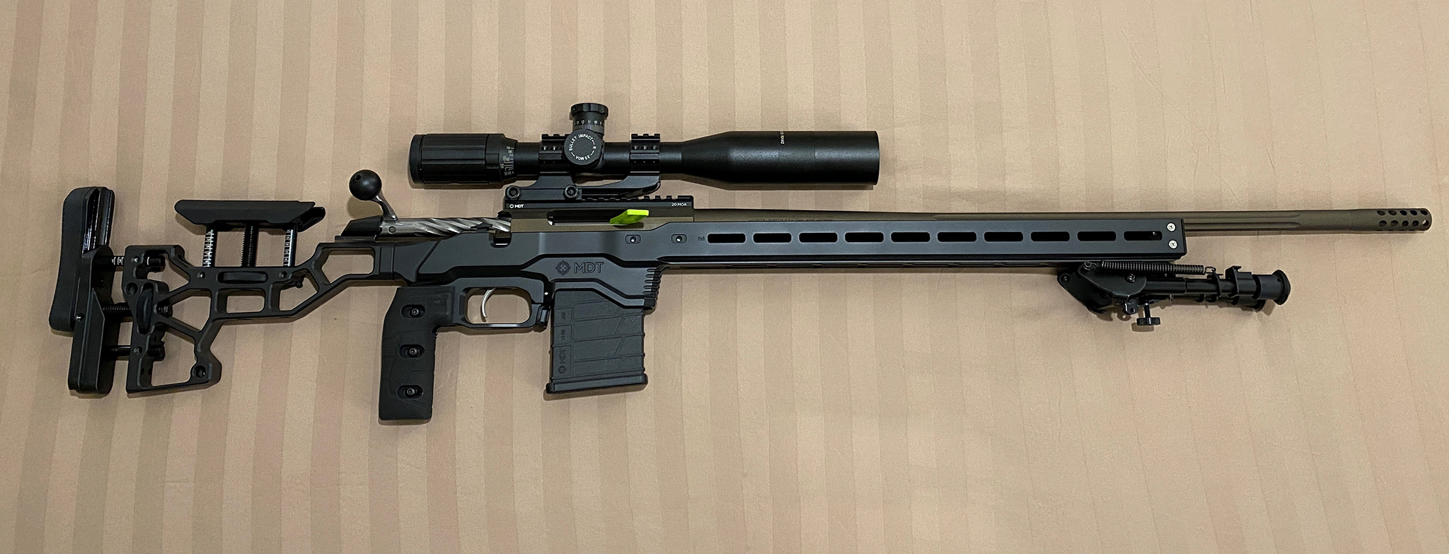

I just finished the chassis part of my first Tikka PRS PRoject, It started off as a T3x Lite veil wideland rifle to get the 24" threaded barrel, I was originally planning on going with the CTR for $100 less and getting the non fluted stainless barrel, but the availability recently has been horrible over the last few months.
I have installed it in the MDT ACC Chassis, while I was performing the changeover I upgraded the trigger spring to the M*Carbo Tikka T3 / T3x Trigger spring kit and I must say it is one of the lightest triggers I have ever felt on a rifle, I may adjust it up a bit from where it is at.
I ordered the MDT 20 MOA rail which I was pleased to find included the lug and then I mounted my 10x42 SWFA scope on it, I have new Vortex rings coming for the setup, and eventually the optics are going to be upgraded, but I should be able to have some good fun with it until I get to that point, I'll be waiting for the tract toric 4.5-30x56 in MOA which they are announcing next month and releasing in December, Unless someone knows of a radically better scope for the money?
Also the bipod will be getting upgraded to the CYKE-Pod down the road, the weaver is just there for the time being attached to a M-Lok mounting point.
Anyways Thought I'd show off my new rifle build, always looking for any feedback as this is my first PRS rifle build.
