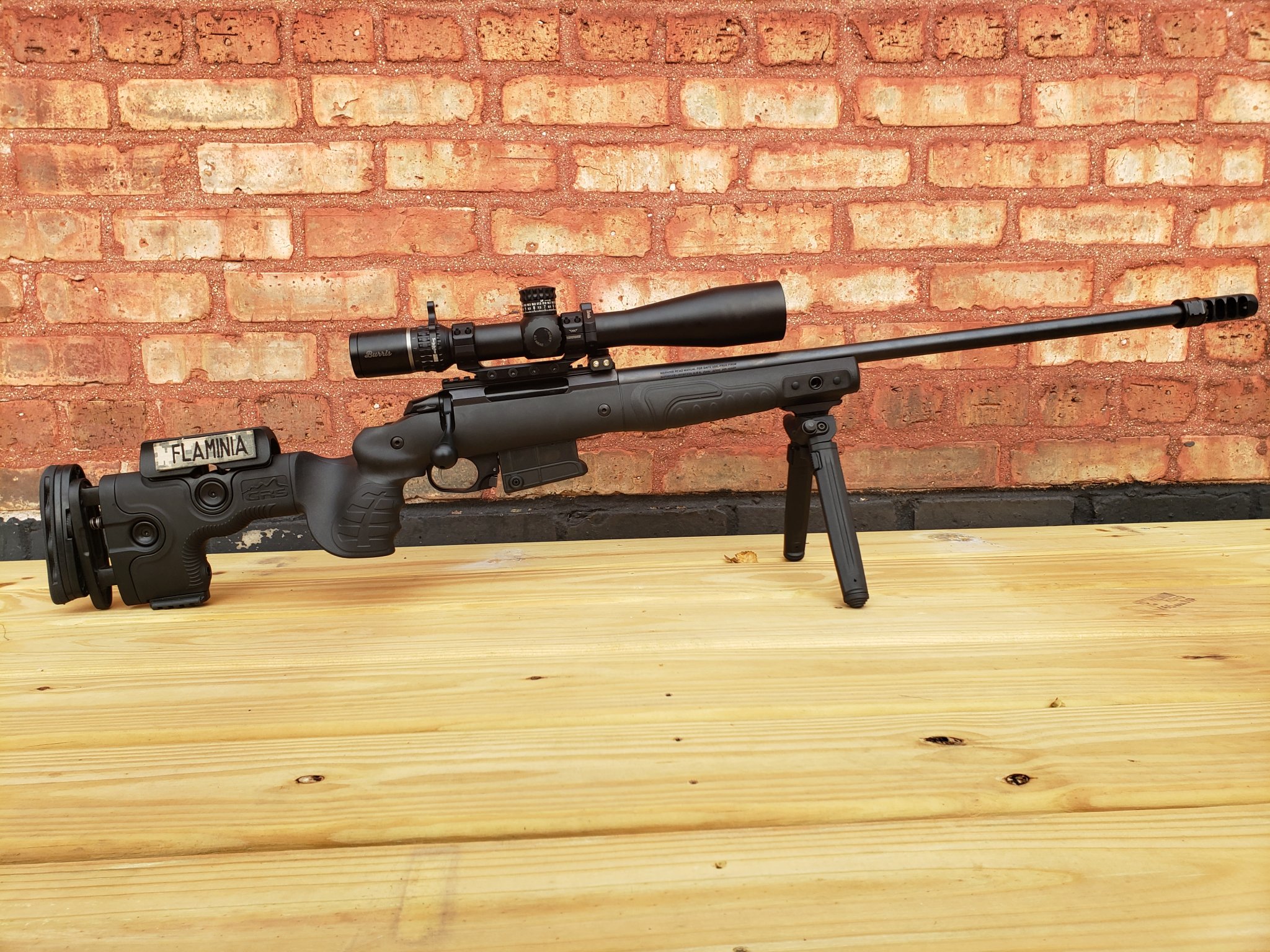

RRA LAR-8 out, T3X Tac A1 in.
First shooting was unbelivable, group sizes(5rnds)) were less than 0,45MOA. All of then.
Ammo was factory 168gr OTM.
Edit. Distance was 150m not 200m

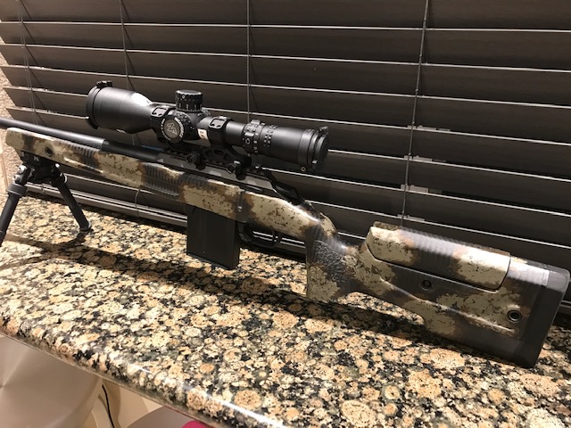

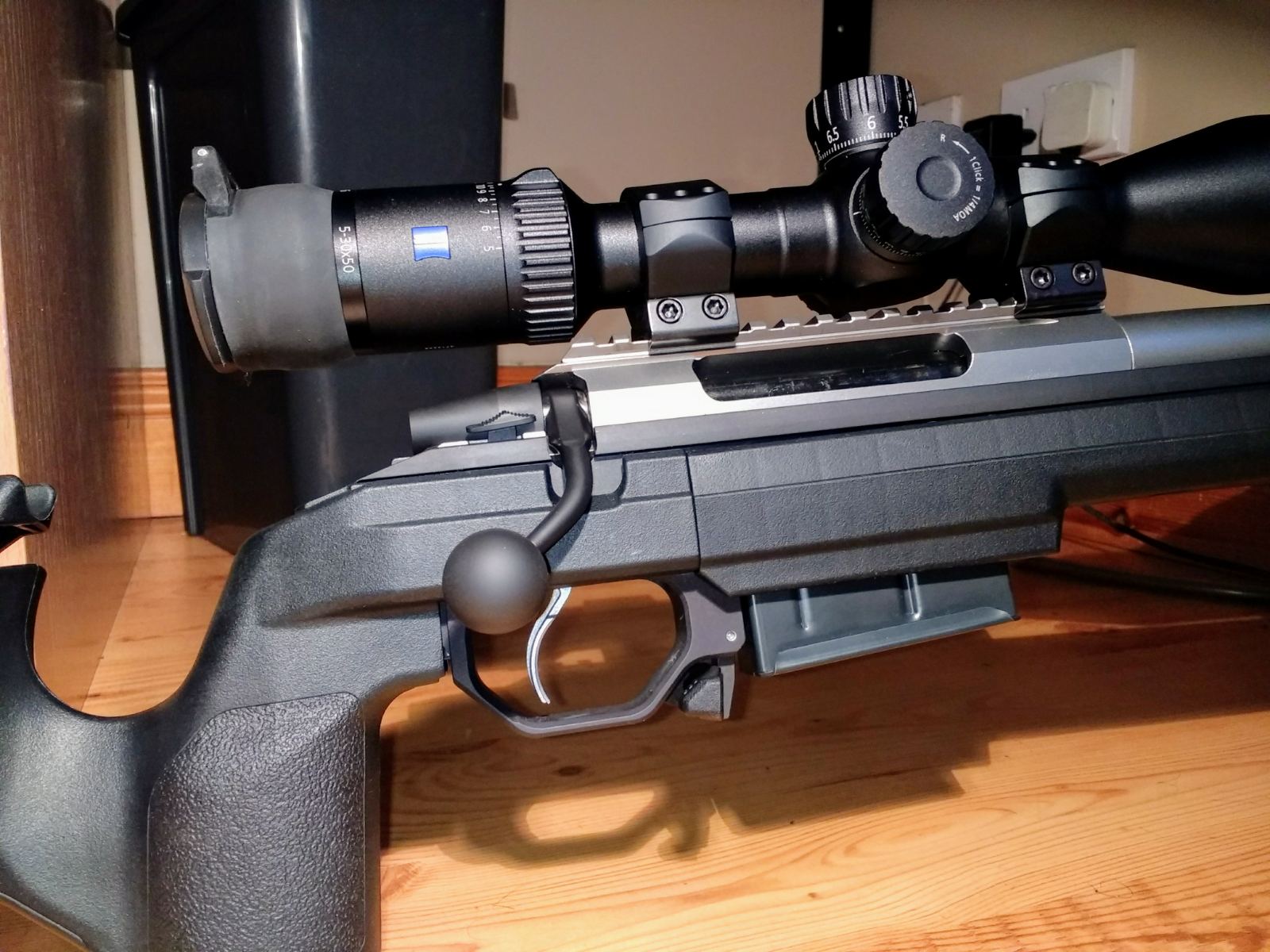

Got my Tikka T3X CTR all set up!
KRG Bravo Stock
Vortex Razor HD LHT 3-15x50 in Seekins Rings
Mountain Tactical Trigger Spring

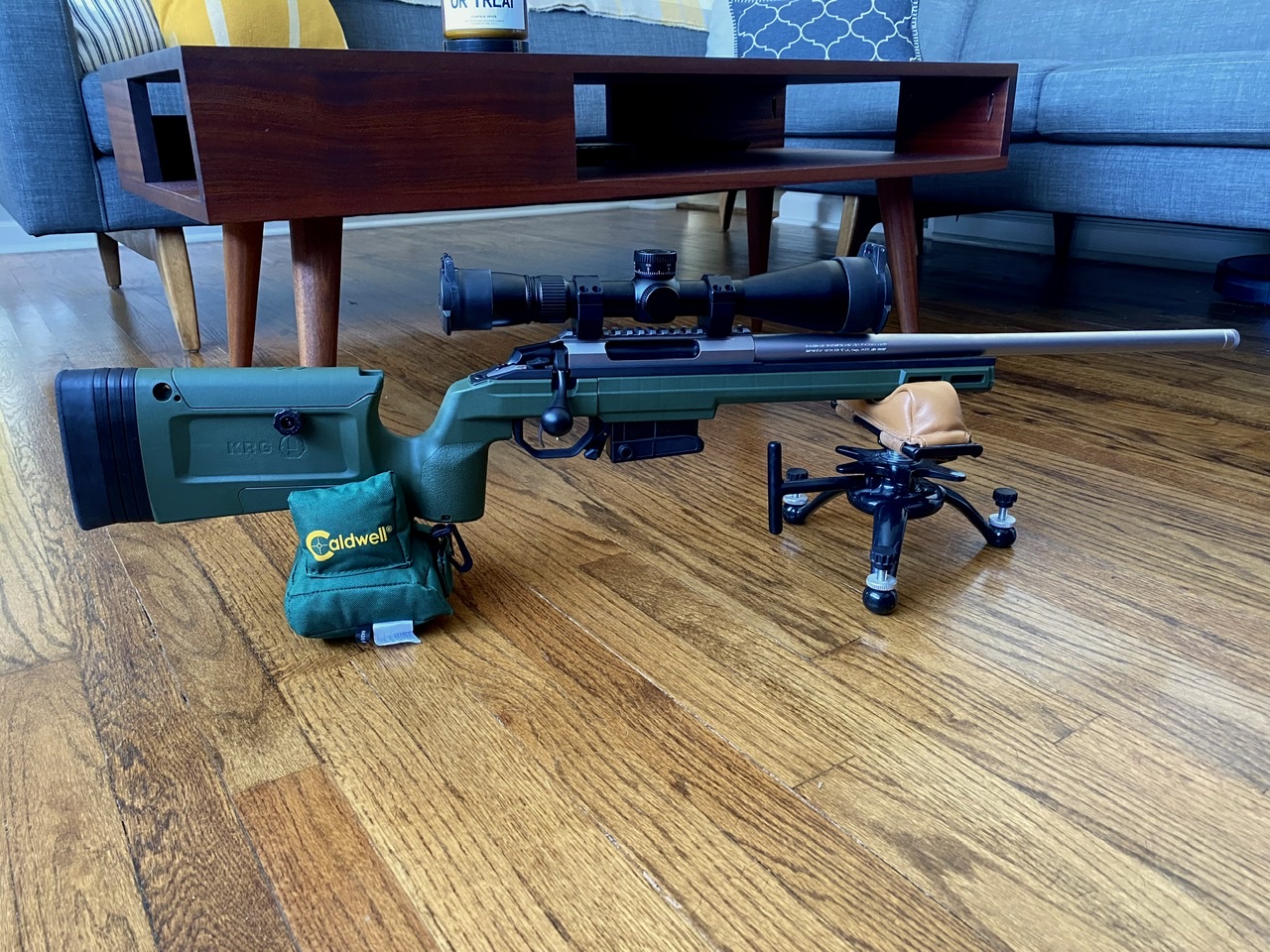

Just chrono’d my new CTR stainless 24” 6.5CM with a suppressor on. Shooting 140gr RDF at 2600ft/s with 41.7gr of RL-16. My previous CTR shot 2930ft/s, same barrel length except blued not stainless. Kind of pissed at how freaking slow this barrel is, and I only expect it to speed up maybe <100ft/s if it behaves like the previous. Might just pull it and sell it then spin on a PVA.
Wow, that's a huge difference. Both 24" barrels?
Sorry, it's a 6.5 Creedmoor.

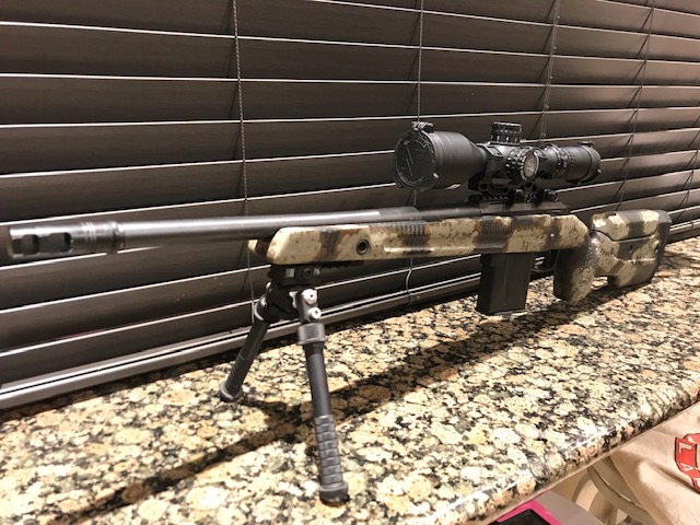

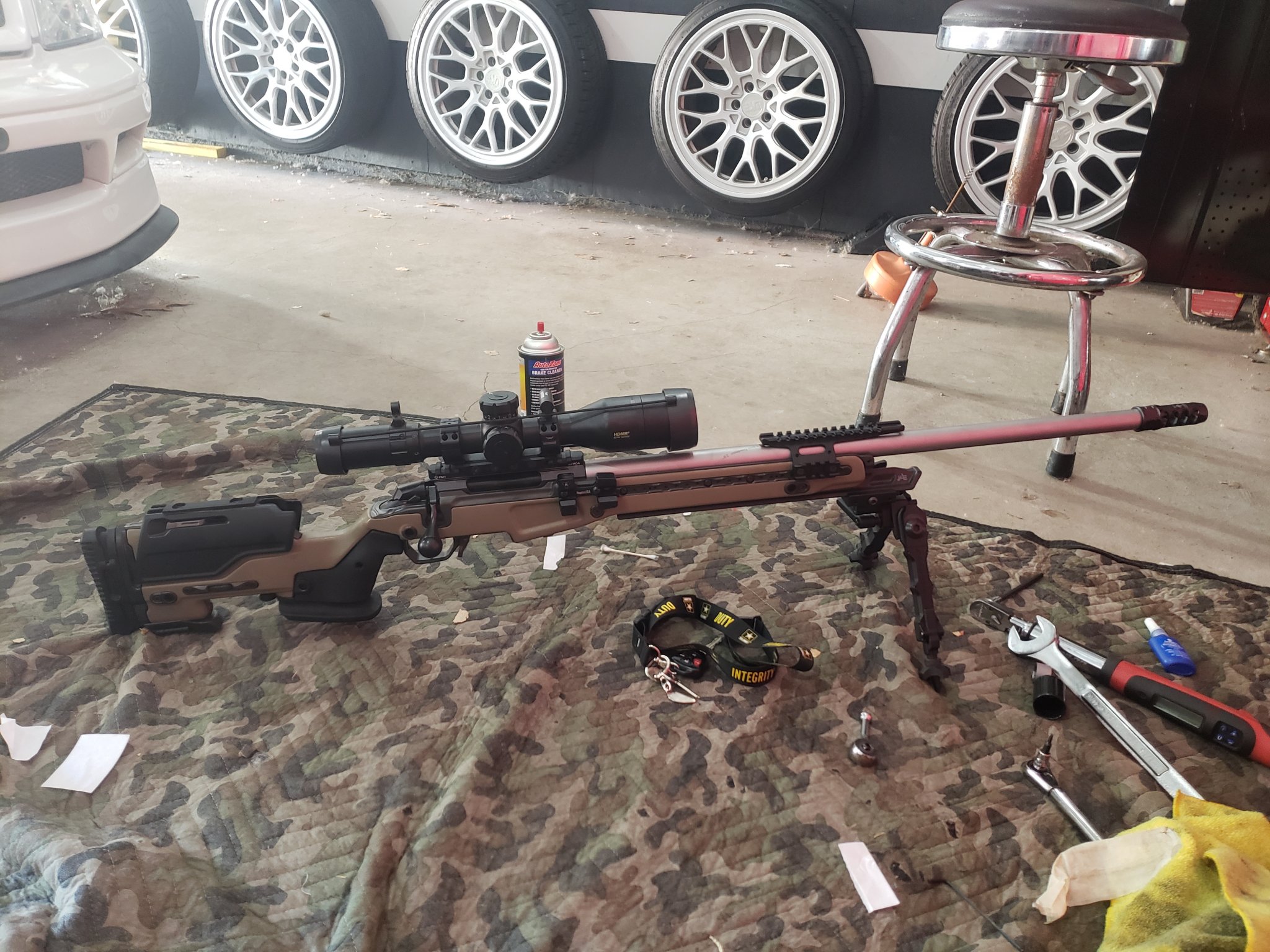

I also have the SJC Titan PRS en route for the muzzle brake, I am thinking of having the bolt and the brake TiN - Rose plated.
I am thinking that I will be ordering a custom barrel for this fairly soon, 27" to 28", I literally want the heaviest contour barrel I can, I want the weight. what's the closest to no contour you can get?
I have been looking into manufacturers, I know there is Proof, there is Bartline, Prefered Barrel Blanks,
Any opinions or input/experience/advice with any of those? any better for the money options?
I’m running berger 140, SP starline brass and 42.8gr H4350, I’ve chrono’d this load in 3 other rifles, a factory ruger, and 2 customs, all were 2795-2805 and shot the same .25-.4” groups.
Fast forward to my tikka, same groups, but running 2730.
not as slow as yours, but still slower. I seem to have less issues with pressure as well. My ruger Would flatten the primer just a hair but it doesn’t happen in the tikka. It’s not slow enough to make me want to change the barrel with it shooting so accurately

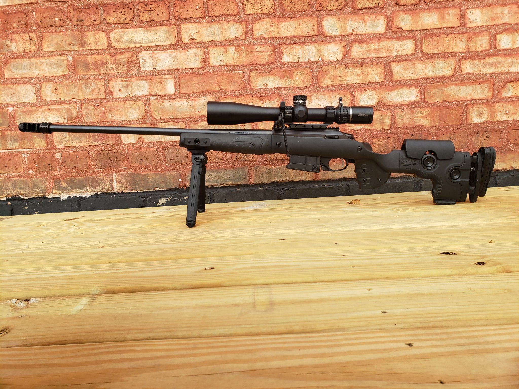

Ordered my first long range rifle. I had looked for a bit and decided I was going with a Finnish gun.
Ended up finding a great deal on a TAC A1 20” 308. I would have ordered a 24” 6.5 or 260 but figured for the savings, I could learn on this one and find a barrel later.
have a pretty good idea what scope I want. The bipod is an open question for me. After a quick look around, a Magpul with a MLOK mount seems the most graceful solution. I had originally thought I would get a Harris and make a few mods but the interface just adds another part I need and potential for issues.
the next issue is finding some match ammo in stock to start finding what it likes.
thanks for any input!

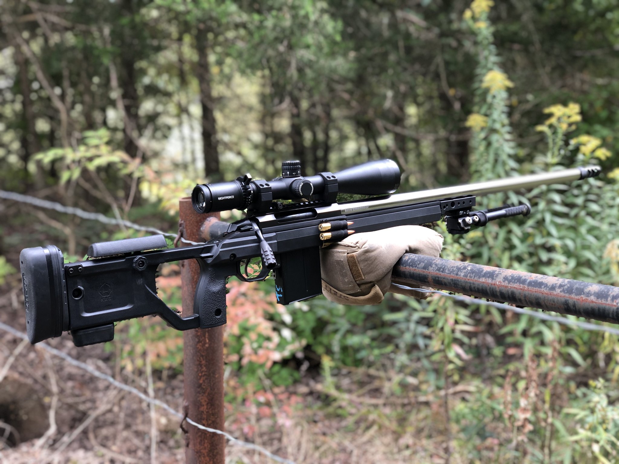

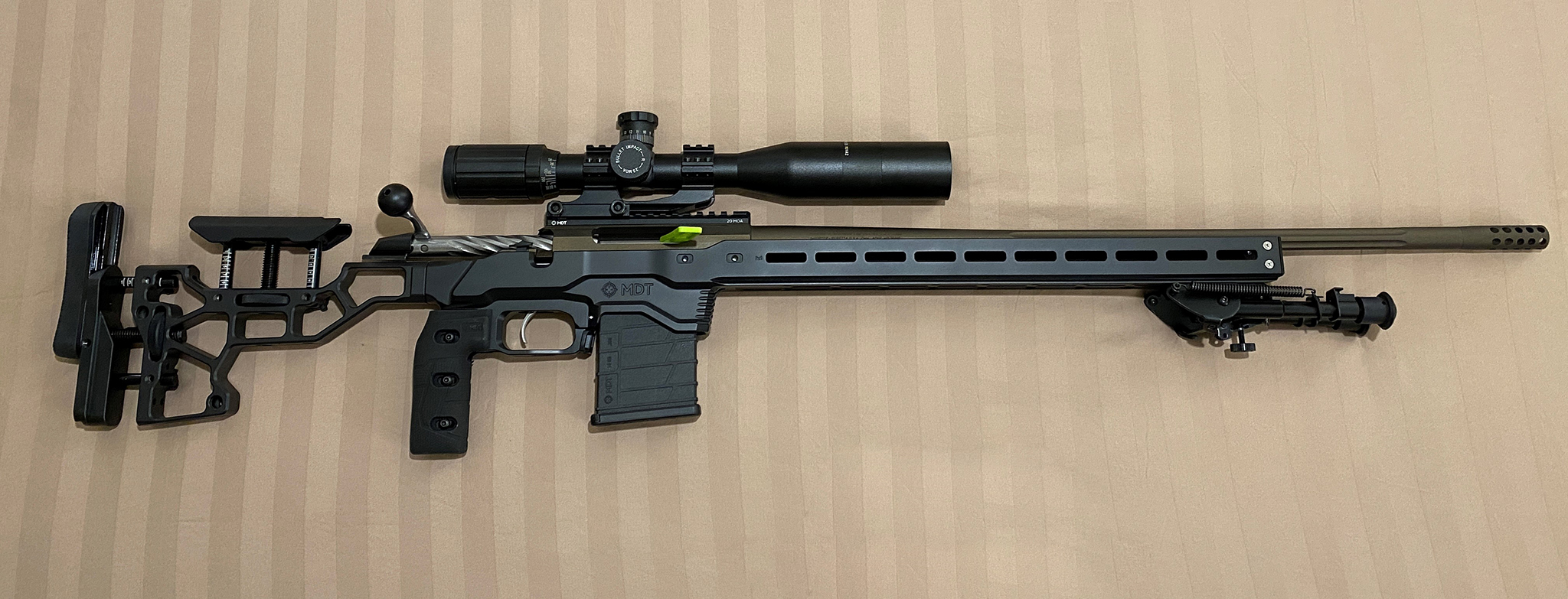

I just finished the chassis part of my first Tikka PRS PRoject, It started off as a T3x Lite veil wideland rifle to get the 24" threaded barrel, I was originally planning on going with the CTR for $100 less and getting the non fluted stainless barrel, but the availability recently has been horrible over the last few months.
I have installed it in the MDT ACC Chassis, while I was performing the changeover I upgraded the trigger spring to the M*Carbo Tikka T3 / T3x Trigger spring kit and I must say it is one of the lightest triggers I have ever felt on a rifle, I may adjust it up a bit from where it is at.
I ordered the MDT 20 MOA rail which I was pleased to find included the lug and then I mounted my 10x42 SWFA scope on it, I have new Vortex rings coming for the setup, and eventually the optics are going to be upgraded, but I should be able to have some good fun with it until I get to that point, I'll be waiting for the tract toric 4.5-30x56 in MOA which they are announcing next month and releasing in December, Unless someone knows of a radically better scope for the money?
Also the bipod will be getting upgraded to the CYKE-Pod down the road, the weaver is just there for the time being attached to a M-Lok mounting point.
Anyways Thought I'd show off my new rifle build, always looking for any feedback as this is my first PRS rifle build.
Any idea how much you got into that rifle without the scope and rings?

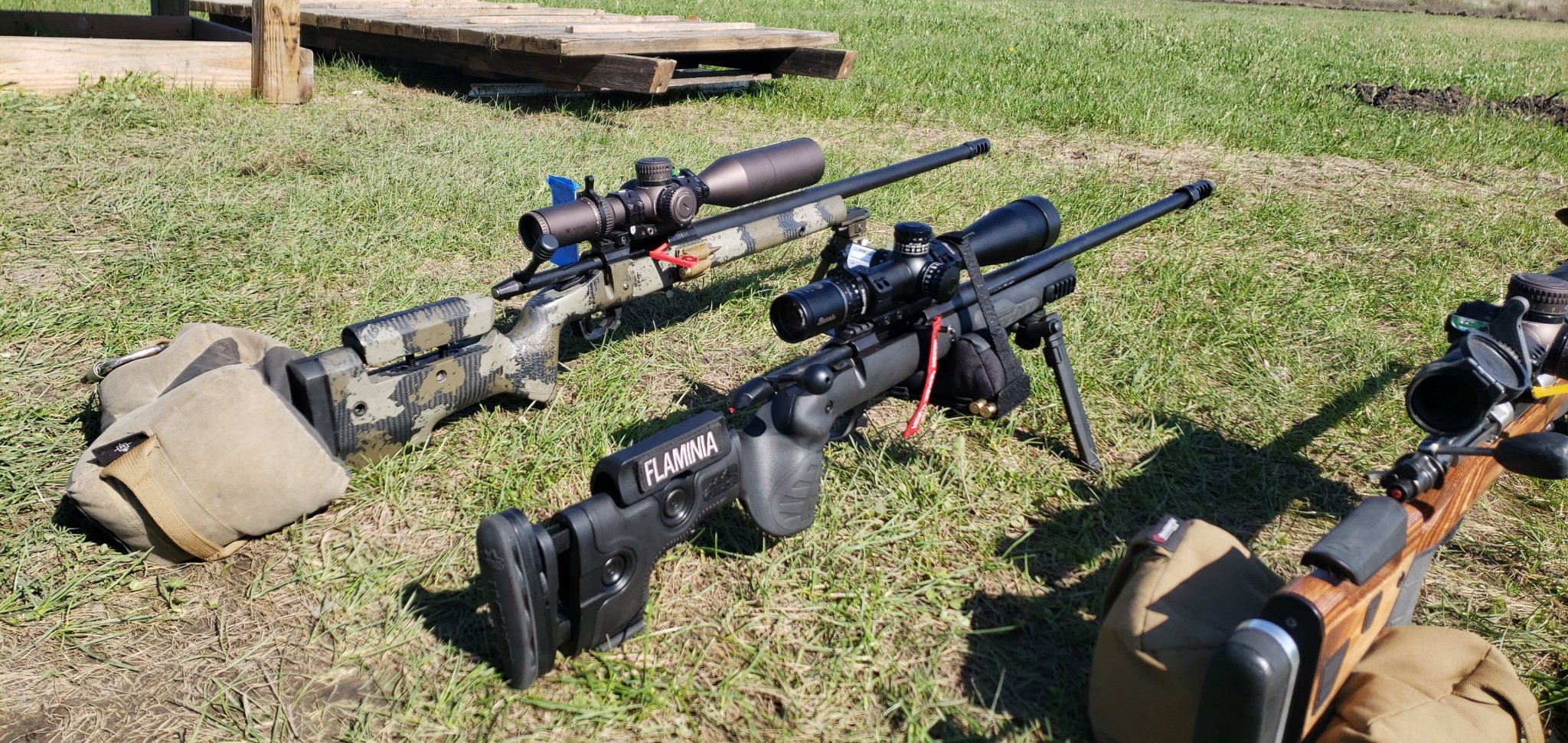

Very happy with my 20” 6.5 Creedmoor CTR. Today was my third time taking it out. Did one six shot group at 100 yards (.63”) then moved to steel. The range only goes to 800 yards and this rifle makes it too easy. Targets are 20x40 steel silhouettes.

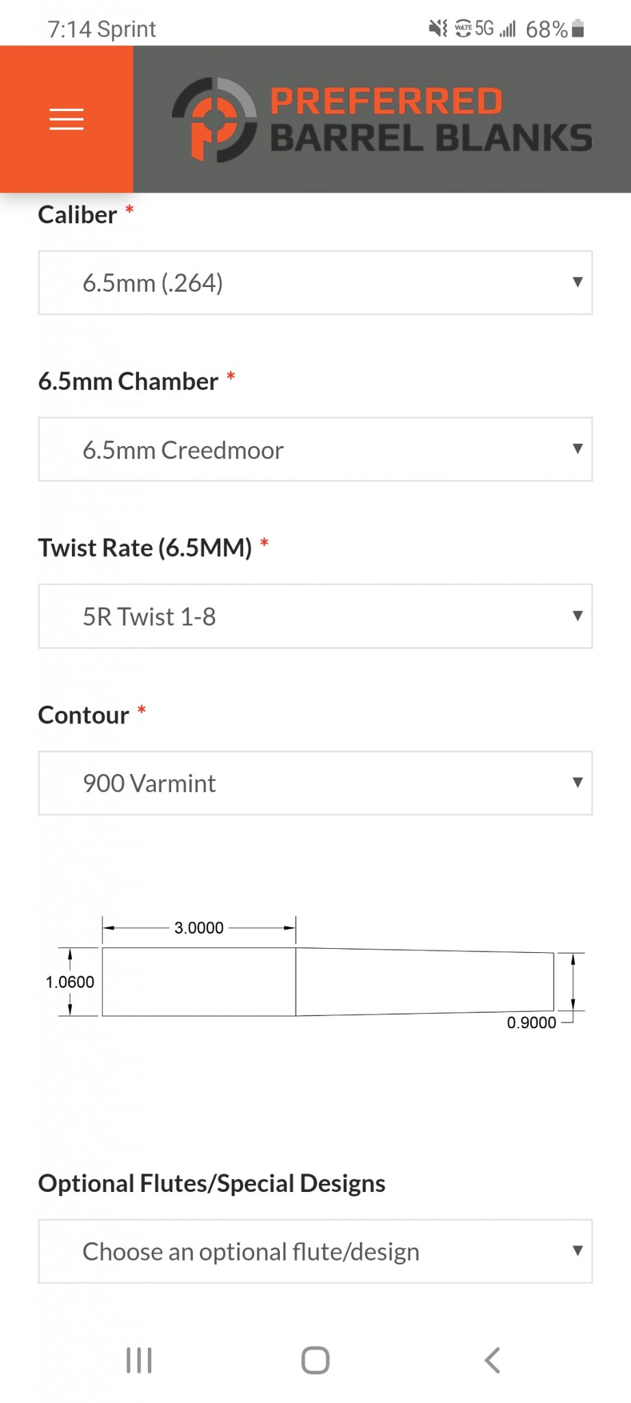

Question. What dimension barrel would I need to get for a T3x? Looking at Bartlein and see 1.250". Just want to make sure I don't go buy one and get the wrong size.
I don't know if this will help you, but this is the measurement from preferred barrel blanks with my current barrel directly from their site. I have not measure my own barrel, but the size of my barrel from them is a great fit to the Tikka
The size I have seen on my barrel is about 1.125. If you go 1.250 your barrel will have a larger diameter than you want and it will look weird with a gap between the action and the barrel due to the chamfered end of the action. IIRC carbon 6 and proof offer 1.15 and 1.135. I cant remeber which one is which, but probably anywhere in that range probably work. I would call and talk to a person on the phone to order if they dont specifically offer a Tikka contour on their website.
