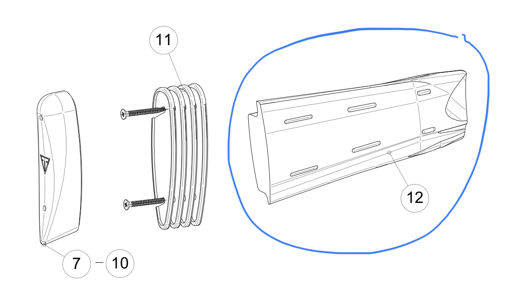

Has anyone had any luck removing the "silent stock foam" from a T3x/T1x? I have a Kalix Teknik CR1 Adjustable Cheek Rest to install in my T1x stock and I want to remove that foam without damaging it or the stock if possible.
I just took the plastic grate out and ran a screw into the foam to have something to pull on.
Took a pair of pliers and wiggled it out....

Good to know. I'll give it a go tonight then.
Reactions: JGR1953
Just in case, a picture of the foam : S54068540 silent stock foam (12)
Takken from the T3X spare parts catalog
For T1X
And for T3X Tac A1

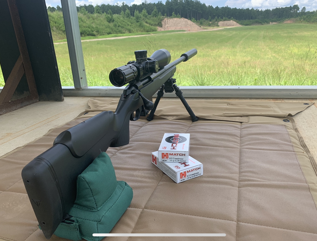

Basic stock ctr with barrel channel sanded shoots way better than it should for what I’ve got in it.
Factory 147s are 2580 with the 20” barrel
That SWFA is a nice match up with the 20” Tikka. I may have one just like it. ;)

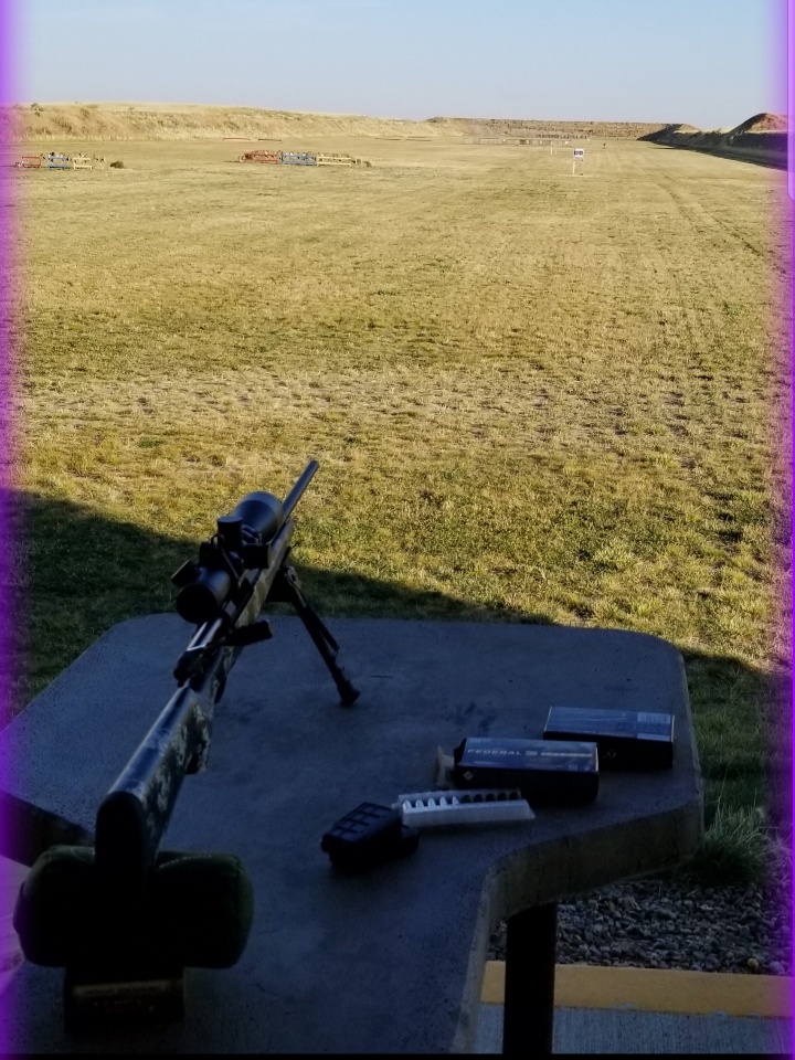

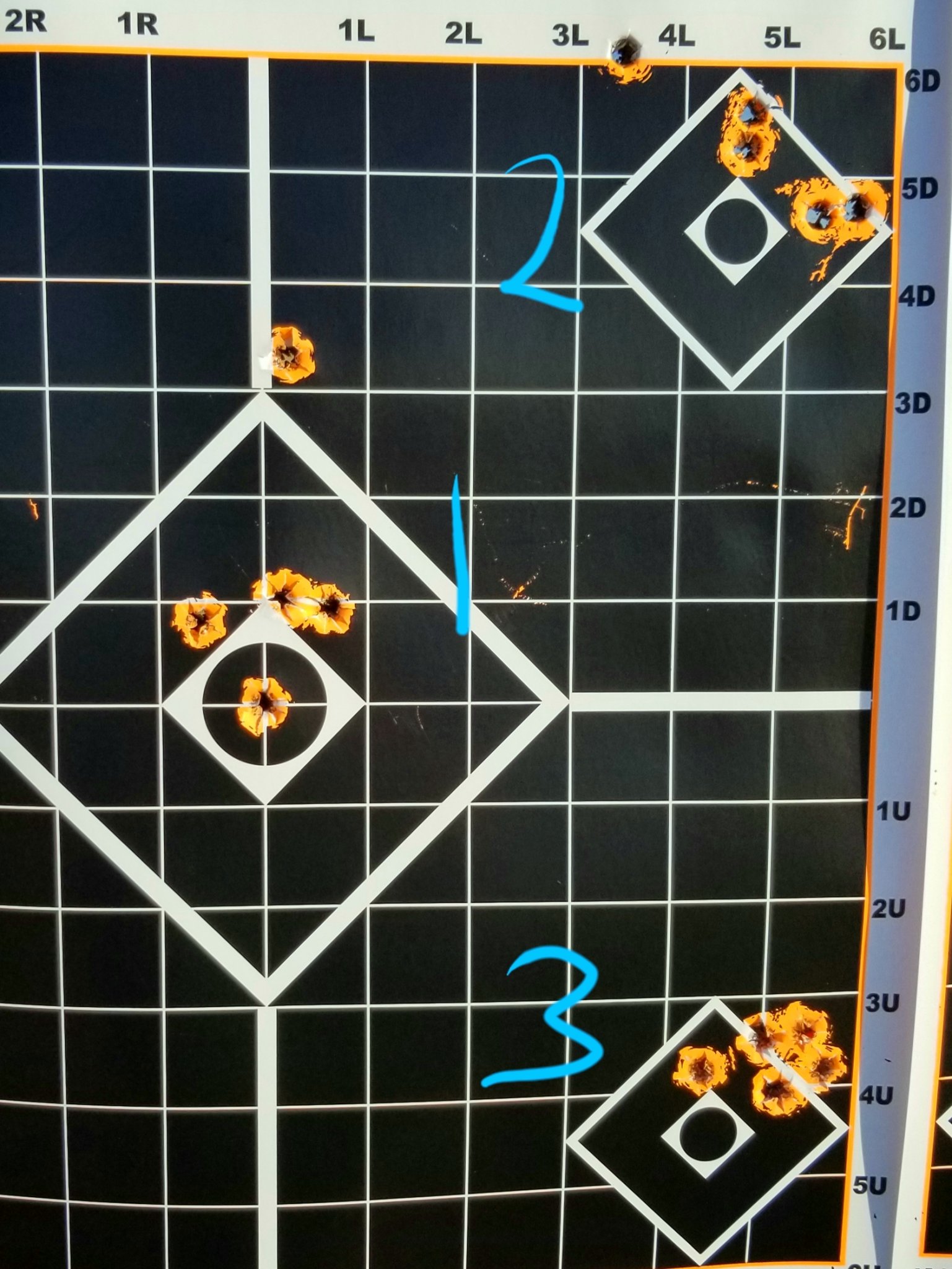

Took the .308 lite out before hunting season, only shot 20 rounds last year, 1 of which took down my Mule buck.
First shot was terrible, knew it as soon as i pulled the trigger. Not really a fan of our bench setups at the range, the seat thats built onto them puts me in an awkward position. Probably end up building something better, or just going prone next time.
Slowly tightened up the groups.

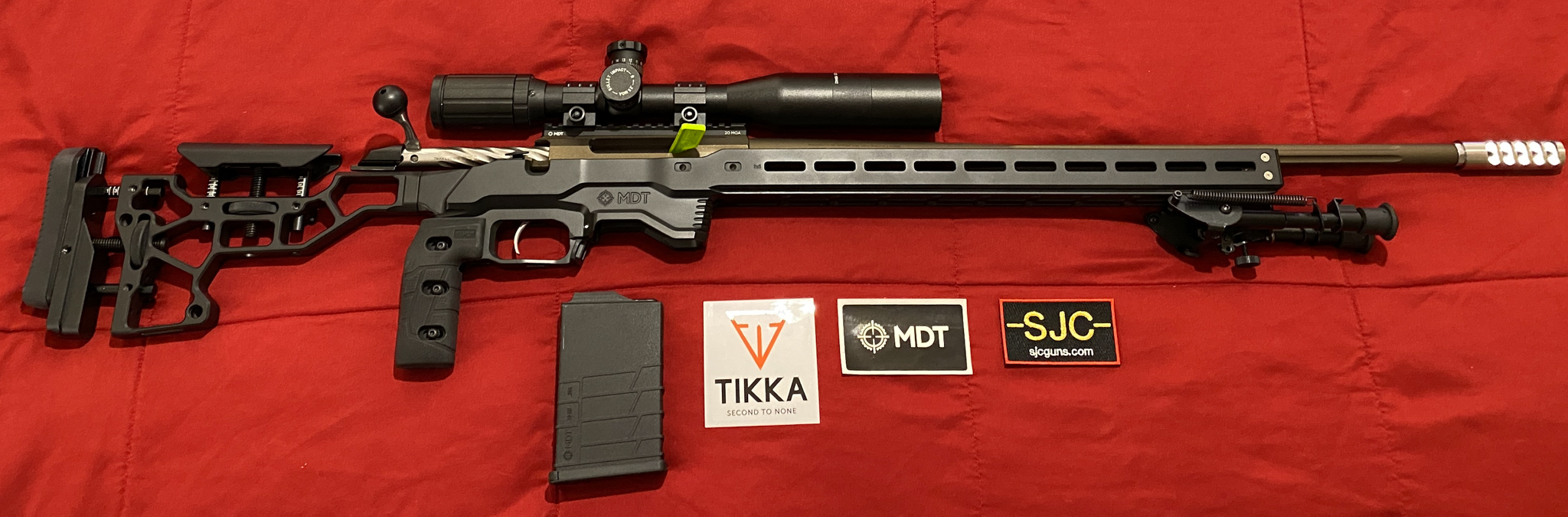

Anyways Thought I'd show off my new rifle build, always looking for any feedback as this is my first PRS rifle build.
My concern would be with how that barrel performs for PRS. My CTR which has a heavier barrel, drops off in accuracy fairly quickly once it heats up. The barrel you have there is really intended for hunting. I might be wrong, will be curious how you find the performance.

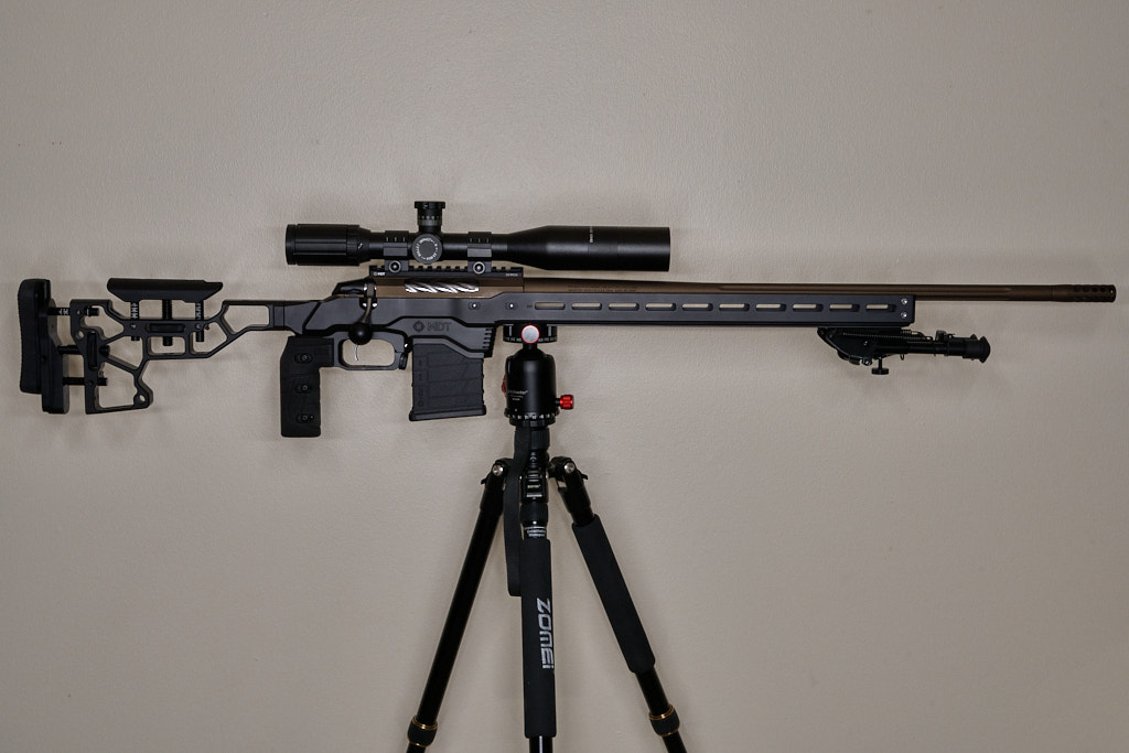

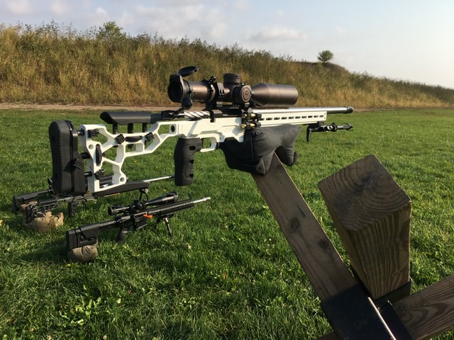

I just finished the chassis part of my first Tikka PRS PRoject, It started off as a T3x Lite veil wideland rifle to get the 24" threaded barrel, I was originally planning on going with the CTR for $100 less and getting the non fluted stainless barrel, but the availability recently has been horrible over the last few months.
I have installed it in the MDT ACC Chassis, while I was performing the changeover I upgraded the trigger spring to the M*Carbo Tikka T3 / T3x Trigger spring kit and I must say it is one of the lightest triggers I have ever felt on a rifle, I may adjust it up a bit from where it is at.
I ordered the MDT 20 MOA rail which I was pleased to find included the lug and then I mounted my 10x42 SWFA scope on it, I have new Vortex rings coming for the setup, and eventually the optics are going to be upgraded, but I should be able to have some good fun with it until I get to that point, I'll be waiting for the tract toric 4.5-30x56 in MOA which they are announcing next month and releasing in December, Unless someone knows of a radically better scope for the money?
Also the bipod will be getting upgraded to the CYKE-Pod down the road, the weaver is just there for the time being attached to a M-Lok mounting point.
Reactions: 260284

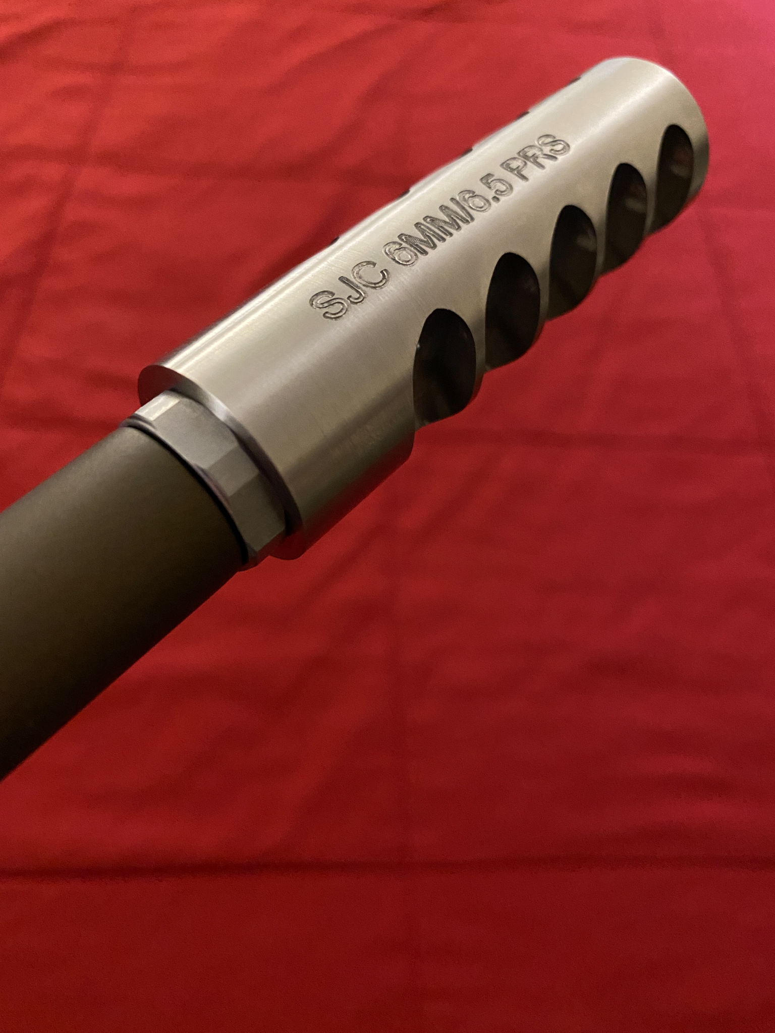

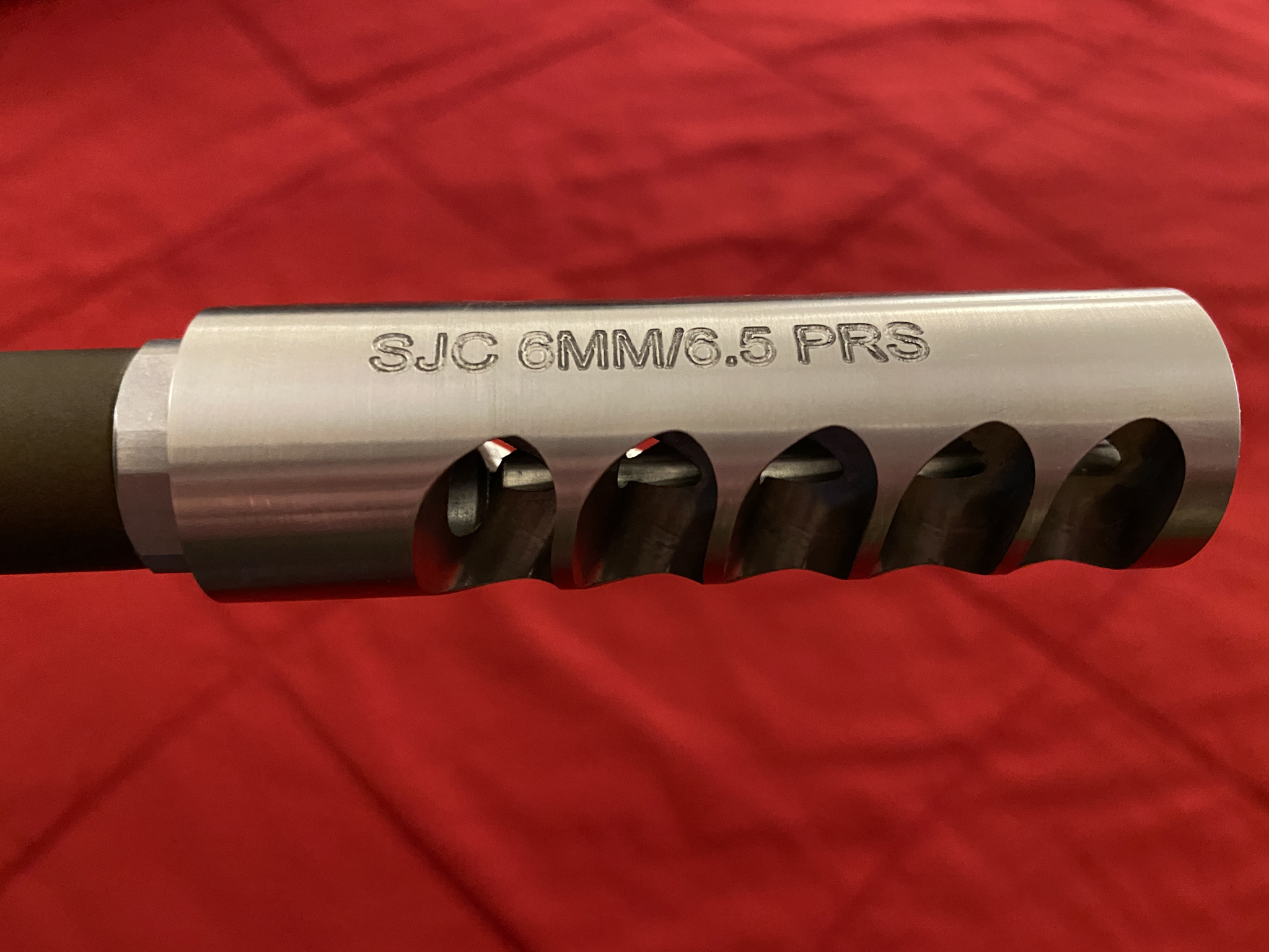

I also have the SJC Titan PRS en route for the muzzle brake, I am thinking of having the bolt and the brake TiN - Rose plated.

Chassis is an MDT ACC so the Arca rail is good, my photography tripod has a really good Arca Swiss ball-head that works amazingly well for mounting my gun (It's there right now) Got Bino's, the brother who i'll be shooting with has amazing range finder, Need Bags, Gamechanger? (To Google!) Barricade stop, That will be on the Cyke Pod.

Tripod is a Zomei Z888 Light Weight Heavy Duty Portable Magnesium Aluminium Travel Tripod and I put a Pro Master PRO BALL HEAD - SPECIALIST SPH-45P W/QUICK RELEASE PLATE (8097) on it replacing the POS ballhead that came with the Tripod.

My buddy has an ACC so I had the chance to try it out a bunch prior to making the switch. The ACC is noticeably more stable when shooting positional. Adding the weights certainly reduces felt recoil as well. If I could do it all over, I probably would've picked up a CTR and just dropped it in the ACC. But keep in mind, I'm using this rifle primarily as a PRS comp rifle. The Tac A1 is a great starting point, but if you shoot them back to back the ACC is just a more stable comfortable platform
