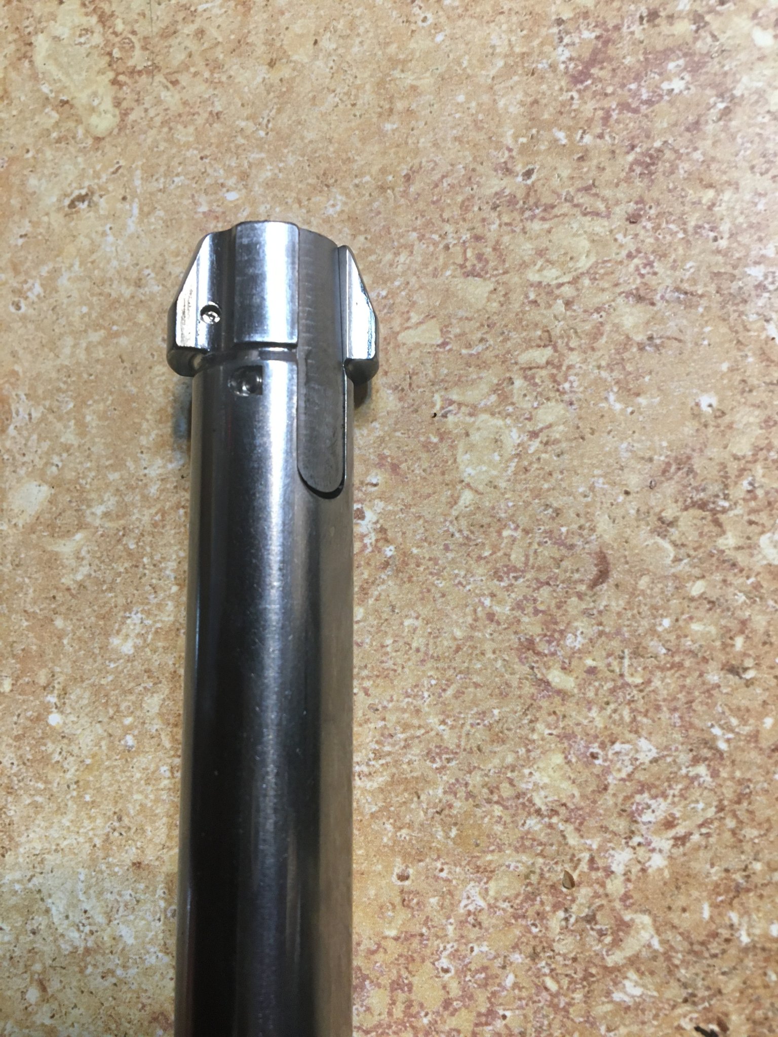

The extractor on the LRI edition is a lot longer then the factory one

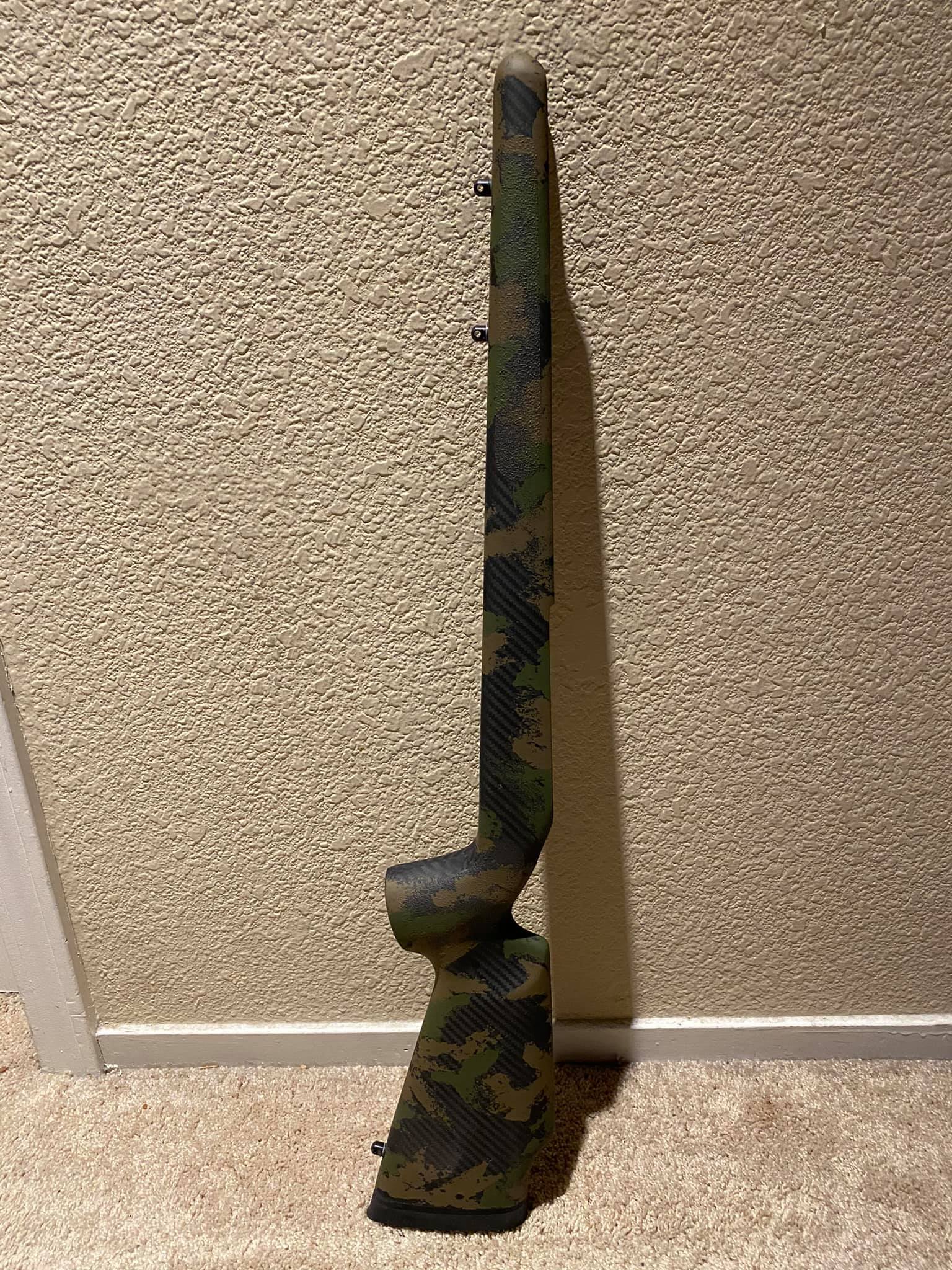

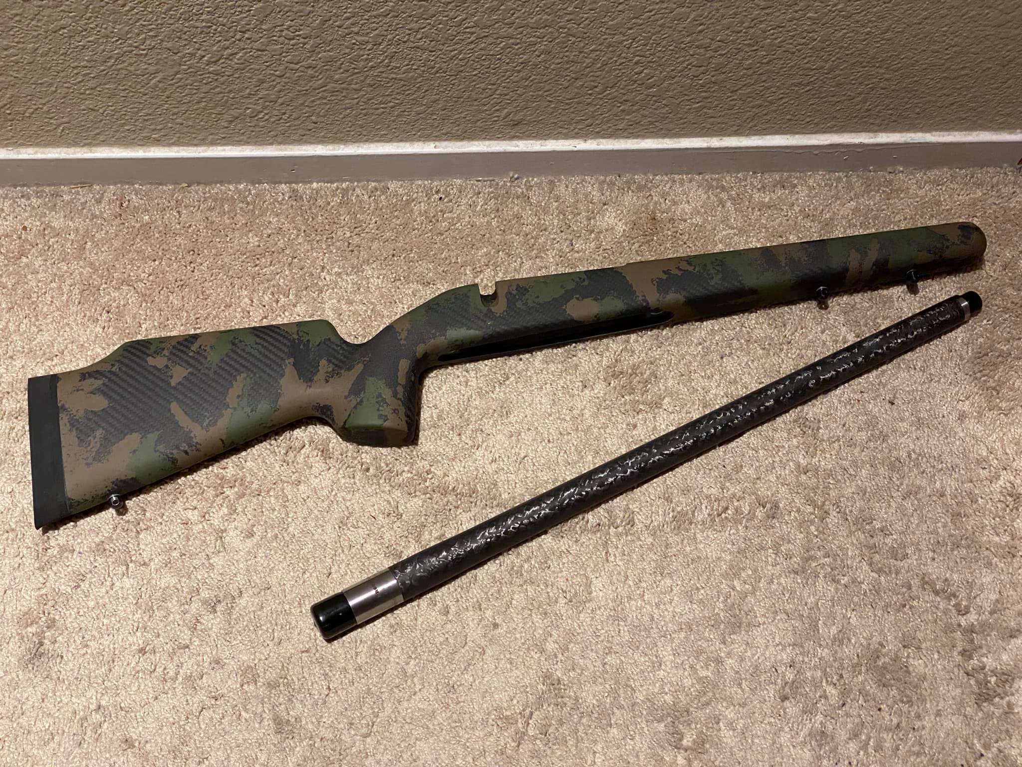

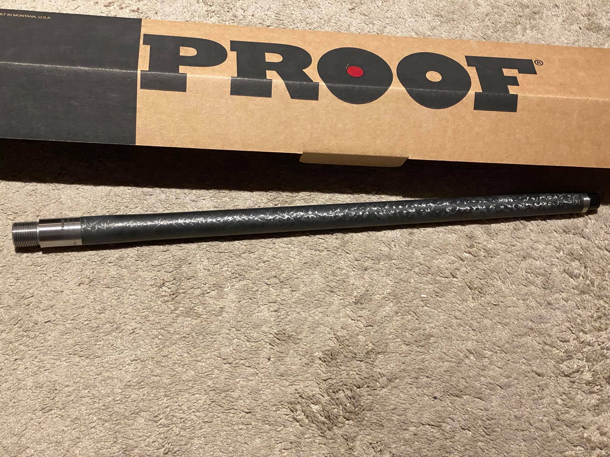

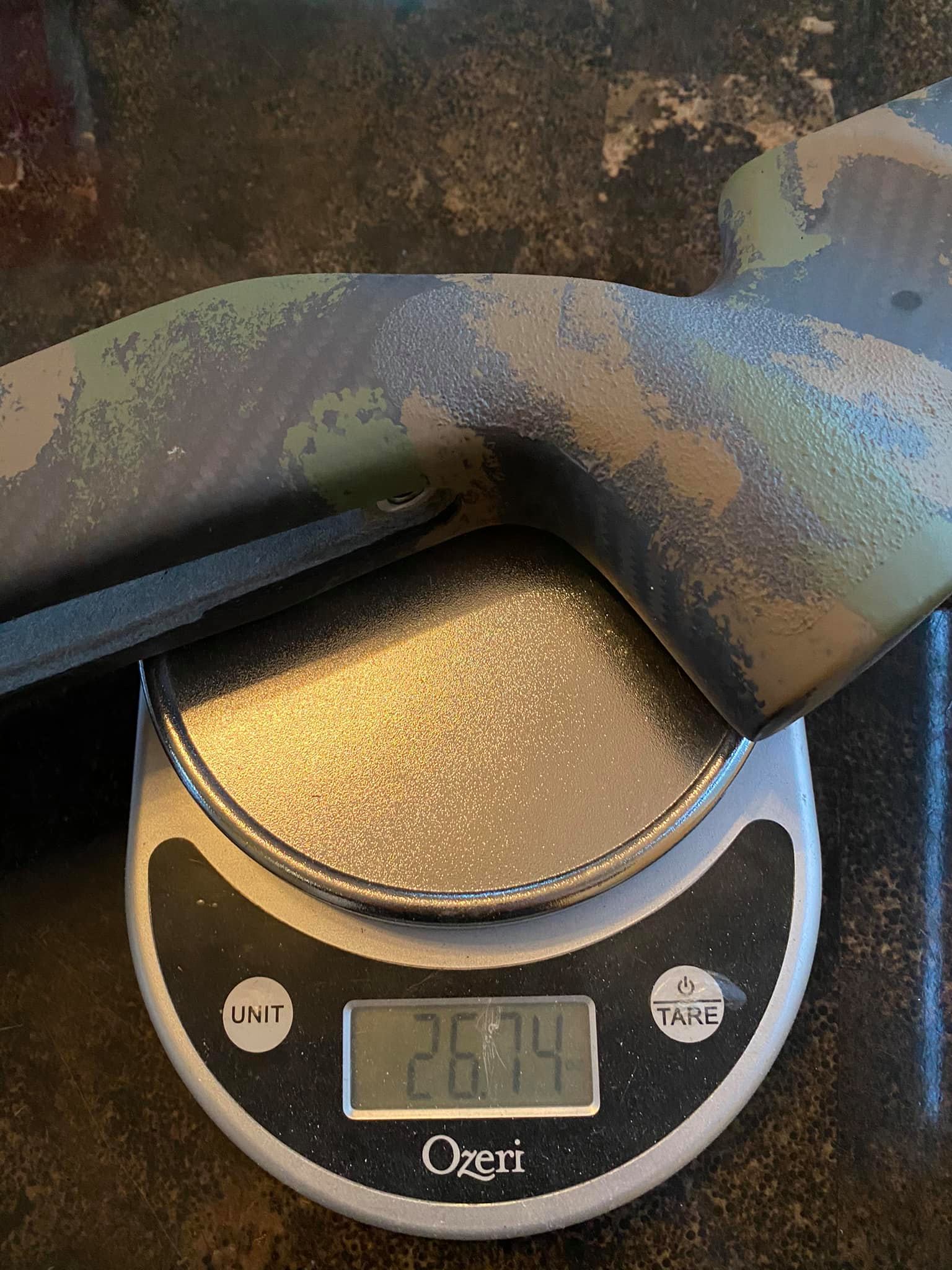

It's starting to look a lot like Christmas! Just received the Mesa Precision Arms - Altitude stock (26.74 oz) and Proof CF Pre-fit barrel chambered in 6.5 PRC (24" 1/7.5). Just waiting on @LongRifles Inc. to put magnum bolts on sale.. Maybe I'll post up my .308 bolt for sale afterwards!

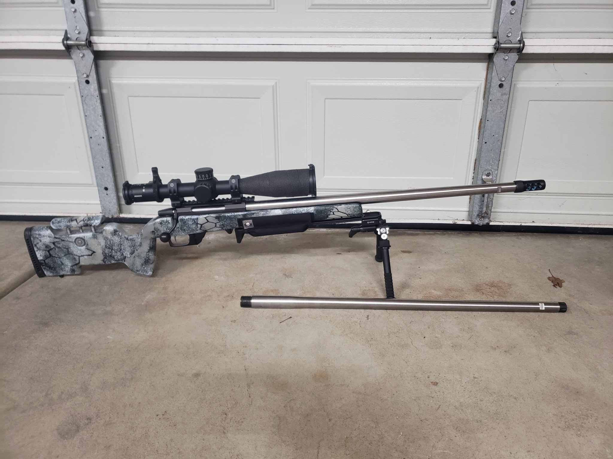

Ok guys, who here as actually done the Tikka switch barrel with shouldered barrels. Looking for feed back on how repeatable it really is and how much of an issue keeping track of 2 or more zeros are?
Current plan would be to swap between a 6.5 creed and .223. Really hoping LRI comes through with some reasonable .223 bolts because those things are impossible to find.
Main reason is that getting into a .223 as a separate rifle is going to be way more than a new barrel and bolt.

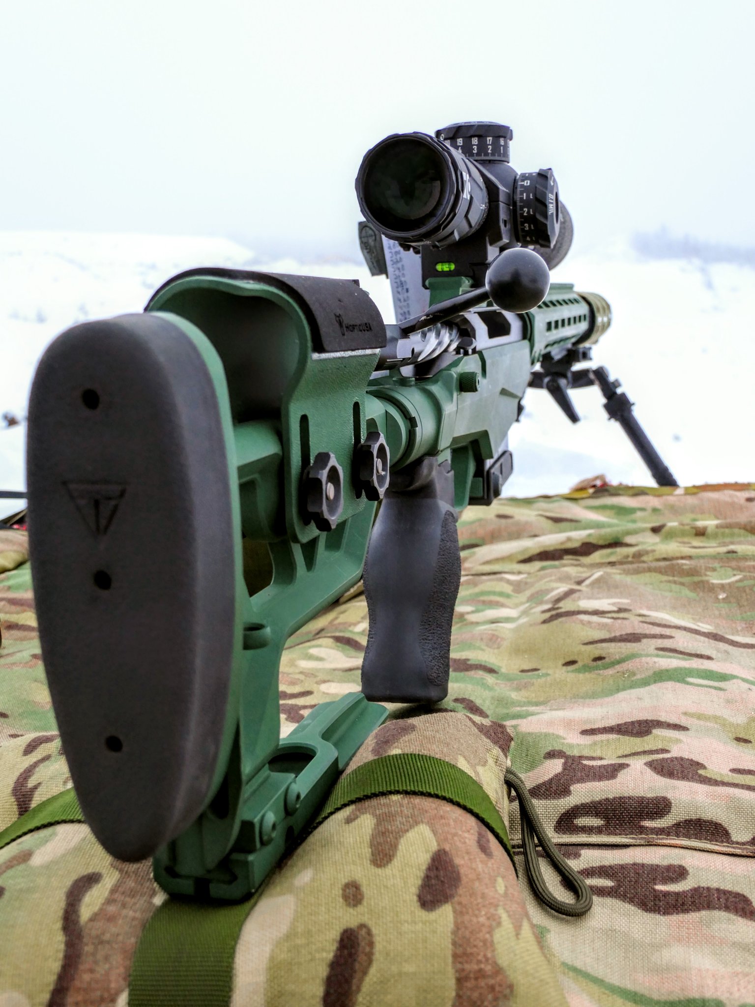

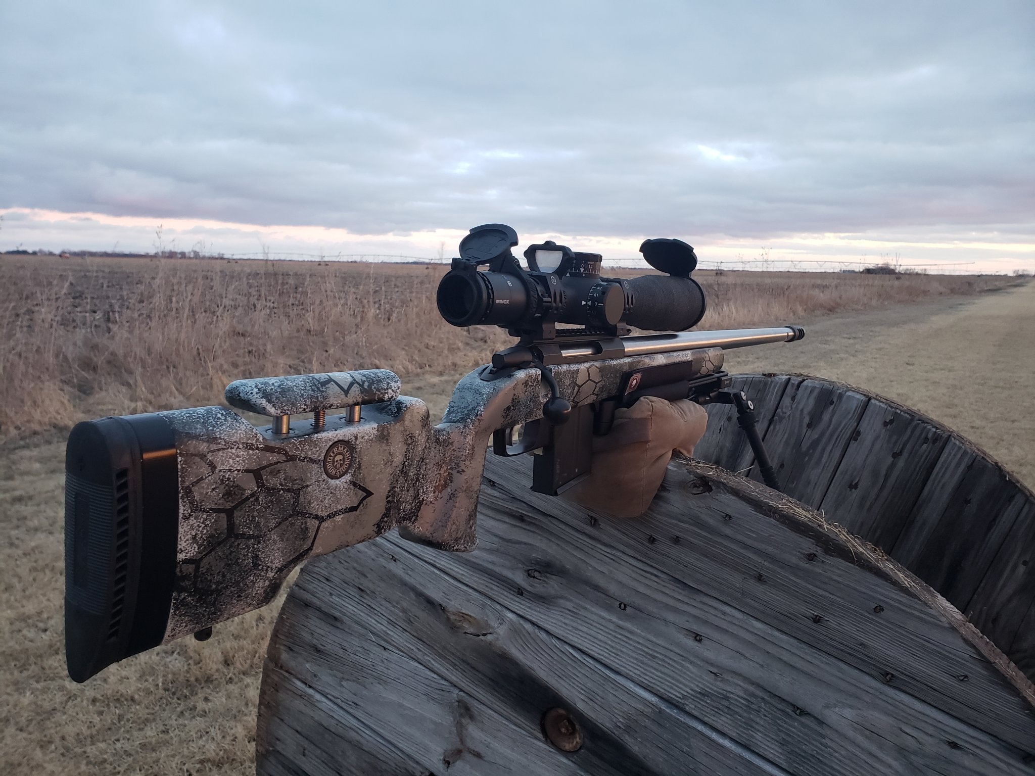

This is my Reaper with a Bartlein BugNut barrel in it. Had it in their Ranger before deer season.
I have done it with a 6.5 Creedmoor and a 22 BR. I used 3/4" flats and can swap them with a torque wrench and a crows foot holding the rifle between my legs. I use 40 ft/lbs. I make the same changes to my scope everytime.
