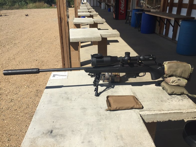

I am thoroughly impressed with my Tac A1 in .308. Zero'ed it two weeks ago and this past weekend too it out to 1,000 yards. I was having a bit of trouble with my Steiner Military 4-16 to get the parallax right. Just couldn't get the image to stop being fuzzy. Either way, I was able to make contact with steel at 1,000 yards multiple times. We lucked out and there was virtually no wind.
Prior or to this I've only to to 700 with my OBR and on only one occasion so I am a total noob. Can't believe how accurate that rifle was.
Here is is the target from when I zero'ed it, and a view through the scope of the 1,000yard target.

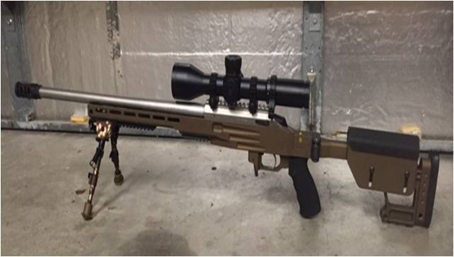

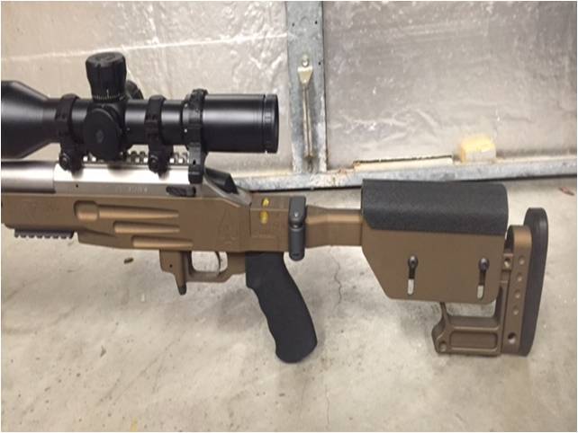

The Tikka TSR-1 that I picked up as a limited run through Eurotech has an action with an integral 20 moa rail on it. That is not their standard short action, so it appears that maybe they are willing to do limited runs if it meets a target audience.
Please excuse the shortened picture. Something in the translation of this picture compressed things side-to-side.
When I bought my TSR-1 from them, I picked up two extra 10-round CTR style mags at $70 and change each. That is the cheapest that I have ever paid for an AIAW magazine. So their mag price for these is roughly equal to AI mag prices in my experience.

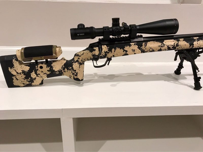

Just got my Manners stock. Anyone have issues getting their recoil lug in? This thing is VERY TIGHT. Gonna need a hammer to get it in but before I jump to that wanted to check and see if there is any other way

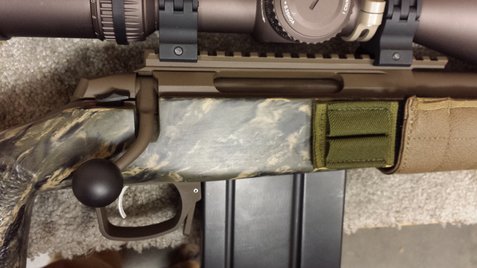

Just received my glades armory swept handle and rounded knob. It's not as swept back as I'd like, but the knob is bigger then the PTG which I prefer. More to come once I get the sterk in.
Sent from my SM-G930V using Tapatalk
Looks good for my needs/wants. I am not looking for any more sweep than that. Ordered one yesterday from Glades after seeing your pics.
You can't go wrong with it. I just didn't much care for it since it wasn't to different from the factory handle. However, the size of the rounded knob is what I prefer, it gives plenty to get ahold of.

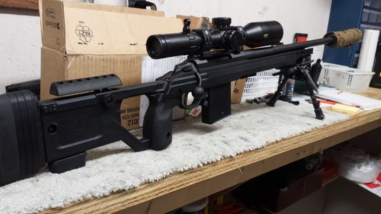

Here is a pic of my new rifle. Got it last Saturday, posted a pic earlier of my group but not of the rifle. Anyway was at the range again today. Getting it dialed in better. Love the rifle, the reticle on the Cronus is so fine it washes out on the target so I run illumination but also found when doing the ladder test that putting a bigger red dot helped. Anyway this will work for 2017 deer and 2018 plates and hopefully a match or two. Very excited
Lol, thats how shit works! Ahhh thats the same one i have. Must be the angle, yours looks more like the glades.
The glades was very disappointing when I got it. I ended up ditching the handle and throwing they're knob on the anarchy handle instead of the PTG knob.
