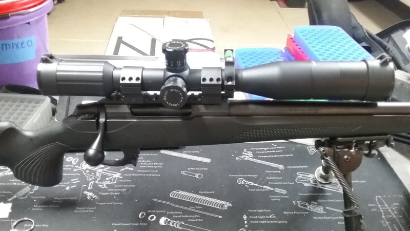

Got my TSR-1 in from Europtic, put it together and took it out yesterday. I really like the package and do not think that one could do much better for the price. I like the McRee G10 stock and all of the M-Lok slots for add-ons. I think that it even has spots for QD swivels, but I did not get a chance to check up and verify if that is true or not. The stock pack by Tactical Tailor is very well made, but I will have to replace it since I plan on trying this out in local matches, where we often have weak side shots under time and pressure. The stock pack will interfere with that, so I think I'll glue on some thin neoprene padding instead.
The 20" barrel gives it a nice balance and it is pounds lighter than my regular match rifle. Very handy. I did not think to adjust the trigger pull before going out, so it was at a nice, crisp, heavy 4 lbs. Nonetheless, the first 10 shots down the tube made it clear that this is a shooter. I used a box of factory Prime .260 with the 130g golden match for it's first firing.
Shots #1 and 2 were my sighters as I adjusted the scope for zero. Shots 3-5 were close for a zero, so I just kept the same POA to see what the rifle did. The next five shots were not bad, only marred by my poor fundamentals yesterday. I then finished setting and refining zero.
My barrel break-in consisted of a cleaning patch followed by a dry patch before firing the 1st round.
It was a pretty meticulous build. But a lot of it was about patience... and getting some great products from some of the best vendors on SH. So a team effort and a bit of a showcase. Since here and in another thread, I've gotten some great questions about sub-caliber shooting... here are a couple of resources:

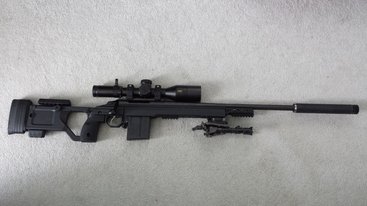

Great project and nice work! That is some perserverance, haha, the chassis you have there is about 3 generations old! Too bad the Sako didn't work out, such a nice action.
Justin
Yup, but it was state of the art when I started the project! And I still think it's a fantastic chassis. The new ones must be works of art!

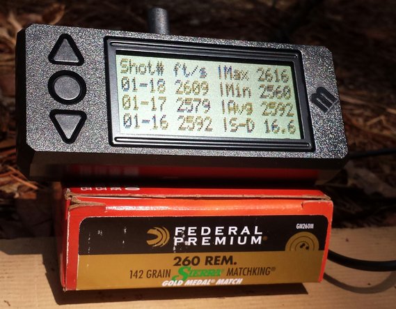

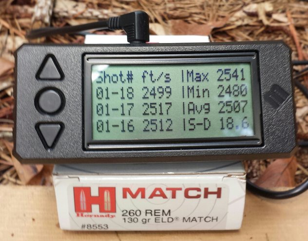

Finally got some rounds down, with FGMM 142 SMKs and Hor. 130 ELDMs.
Center target is one bore sighted rd and a group with FGMM. Bottom 3 targets on left are also 142 FGMM. Bottom 4 targets on the right are Hor. 130 ELDMs. Numbers are:
142gr FGMM SMK- Av 2592fps, 16.6SD, ES 56.
130 ELDM- 2507fps, 18.6SD, ES of 61.
Sample size was 20rds of each.
my gun liked the fgmm til it got broke in then sd and es opened up. but I know fgmm is same from box to box. A gun my gunsmith built runs only fgmm and has taken to a mile and shown sd of 1. yes one, its crazy for factory ammo. the best I seen over a 10 shot string was 13 but the es was over 30. I found some imr4451 cheap on gun broker and got it. my new load is crazy accurate 2794fps 3sd/7es (26' rock creek barrel 1/8)
Yeah, I don't know what to think, I was hoping for a little lower SD/ES than what's showing. The 130s are grouping better than the 142s for now, but there's only 80rds downrange yet. Another thing about the FGMM, I was seeing ejector swipe and had some sticky bolt lifts. So I got a case of Hor 130 ELDMs on the way, I'll try that out. This was the one rifle I was hoping I didn't have to handload for, it'll be a PRS match gun only. It's sure not breaking any speed records either, but if it's shooting well I don't care..
