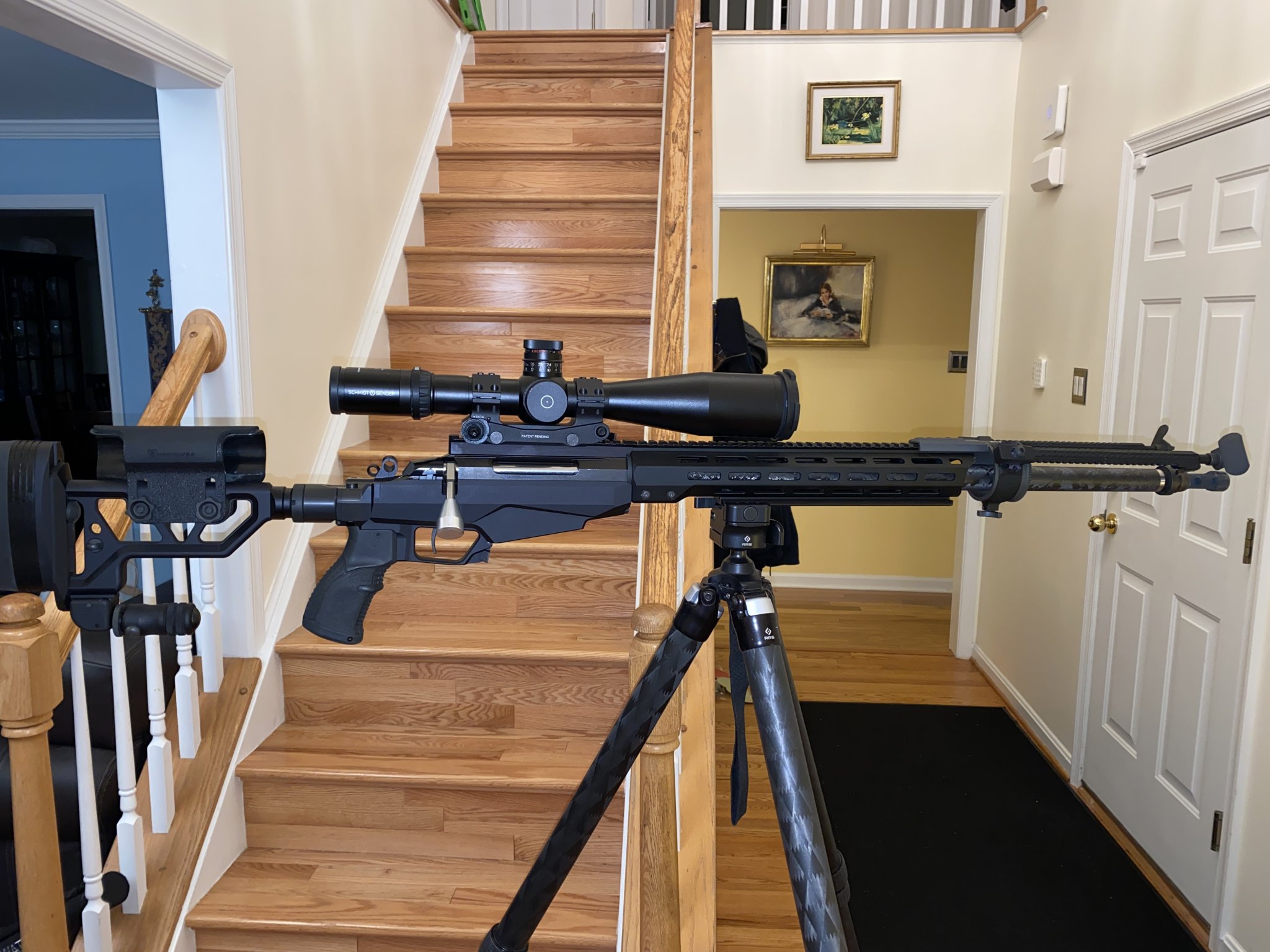

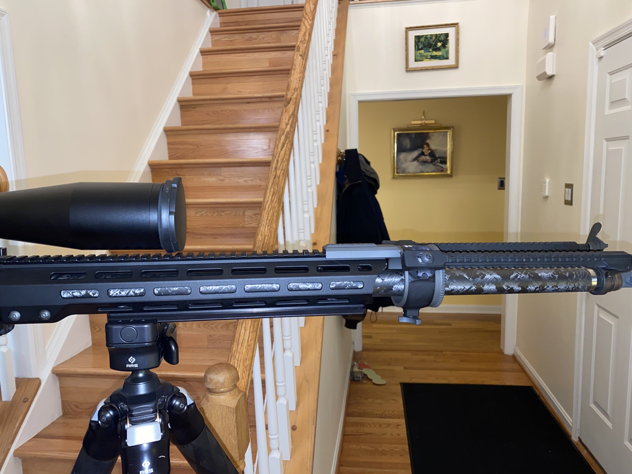

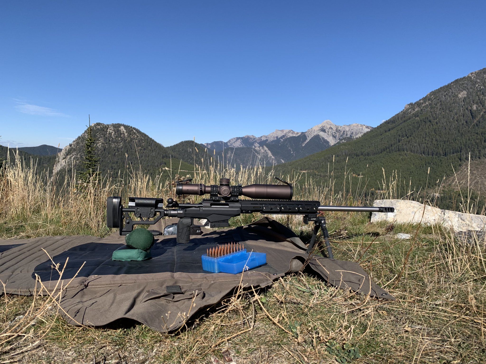

Mine just got an upgrade courtesy of @thesmellyperro
Tikka T3X CTR .308
KRG X-Ray chassis, ARCA rail, extended mag release, and magazine
Bushnell Elite LRHSi 4.5-18x44 in Warne mount
Mountain Tactical trigger spring
Harris S-BRM 9-13 with S lock
SiCo brake/mount with F1 can
Looks great!

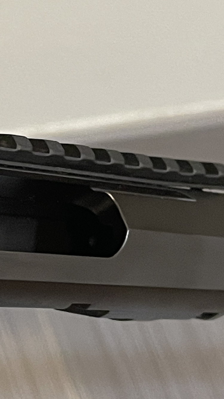

Hello all,

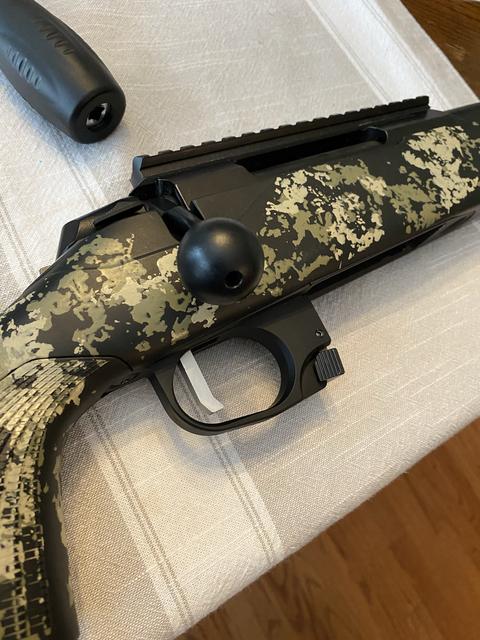

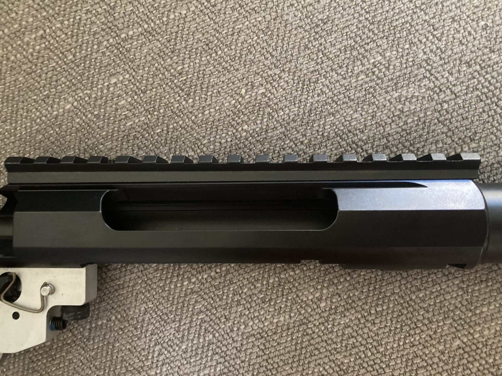

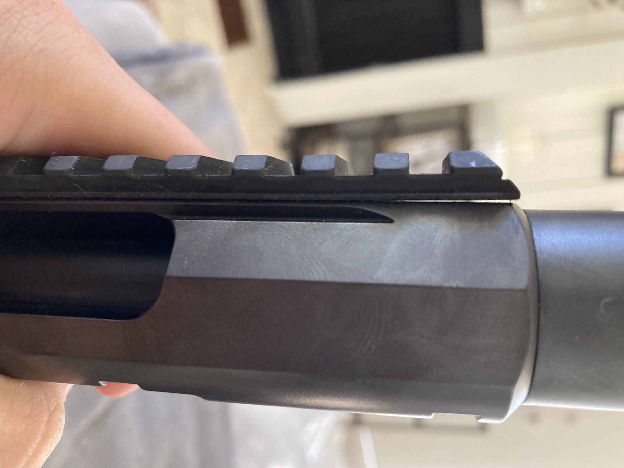

I recently just purchased my first bolt action. It’s a Tikka T3X CTR. I bought it used from a gentleman who got it years ago but never got around to shooting it much due to prioritizing life events.
I picked it up today and realized that he did what many others have done and tightened the dreaded mirage front screw. The first photo is the angle it looked like before. Perhaps this was also just a QC issue that some worker mistakenly torqued it down.
After I noticed this, i got my wheeler wrench and loosened it. The bend decreased a bit but it still exists. I would assume I have to decide between these three options:
-apply enough pressure/force to bend it back flat
-use the rail as is and my scope further back where there is no bend
-or replace it all together
lookinf for some perspective from owners who have experience with this. I would prefer to not replace it all together since I hear that requires a heat gun which I don’t have.
it’s not the end of the world as I got it for a great price so if I need to take it to a gunsmith and use the opportunity to install a 20MOA rail then so be it.
thanks in advance!

+1 Replace the rail, there is no point in fighting it.
Noted. I read a lot of people stripped their screws in the process of removing the rail on the CTR specifically.
I don’t have a heat gun so that means I’ll likely need to take it to a gunsmith for removal.
are there CTR specific rails or will any T3X rail do the trick?
Get a new rail.
Another trick is to heat with a lighter or other heat source, then once a little bit warm, pour cup of cold water over it.
Twist the screw, and it should come out.
Or just take to the gunsmith.
Personally, I'd get a Tikka rail for it.

Thanks for the advice. The Leupold 20 MOA Mark 4 rail looks sturdy and a perfect fit for the action so im going to go with it.
I’ll just use this as an opportunity to upgrade to a 20MOA base since I’m shooting 308 anyways

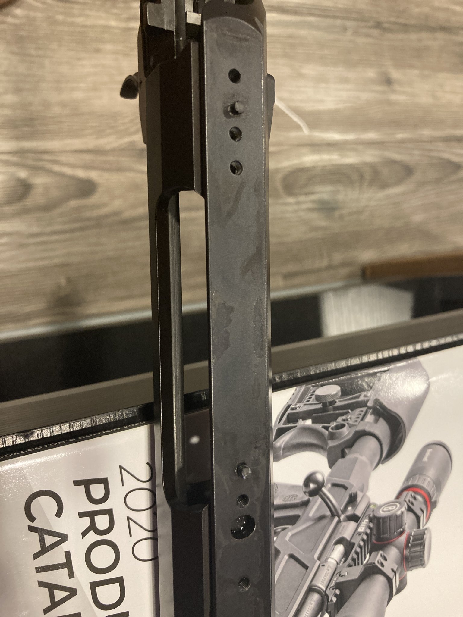

Gunsmith said the pins were removable so that did the trick. Barreled action is now installed with the 20MOA rail. Thanks everyone for the help and advice.
next up is waiting for the MDT BF sale to score a chassis!
So you have replaced a high quality machined rail secured by epoxy and pins and screws with a cast rail that is higher, and only held down by a couple of screws
mmmm
mmmm
Did you not see that the rail was bent? You were one of the folks that reccomended removing it to begin with. I bought a made in America high quality 20MOA rail base and had it professionally installed. Not sure what else I could have done

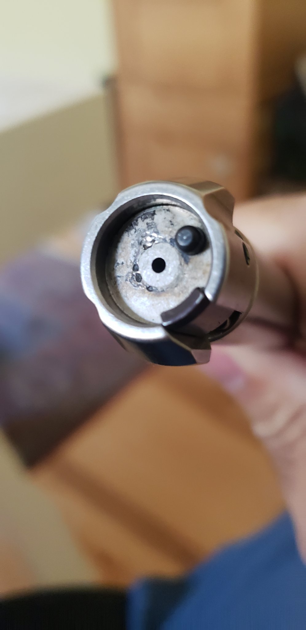

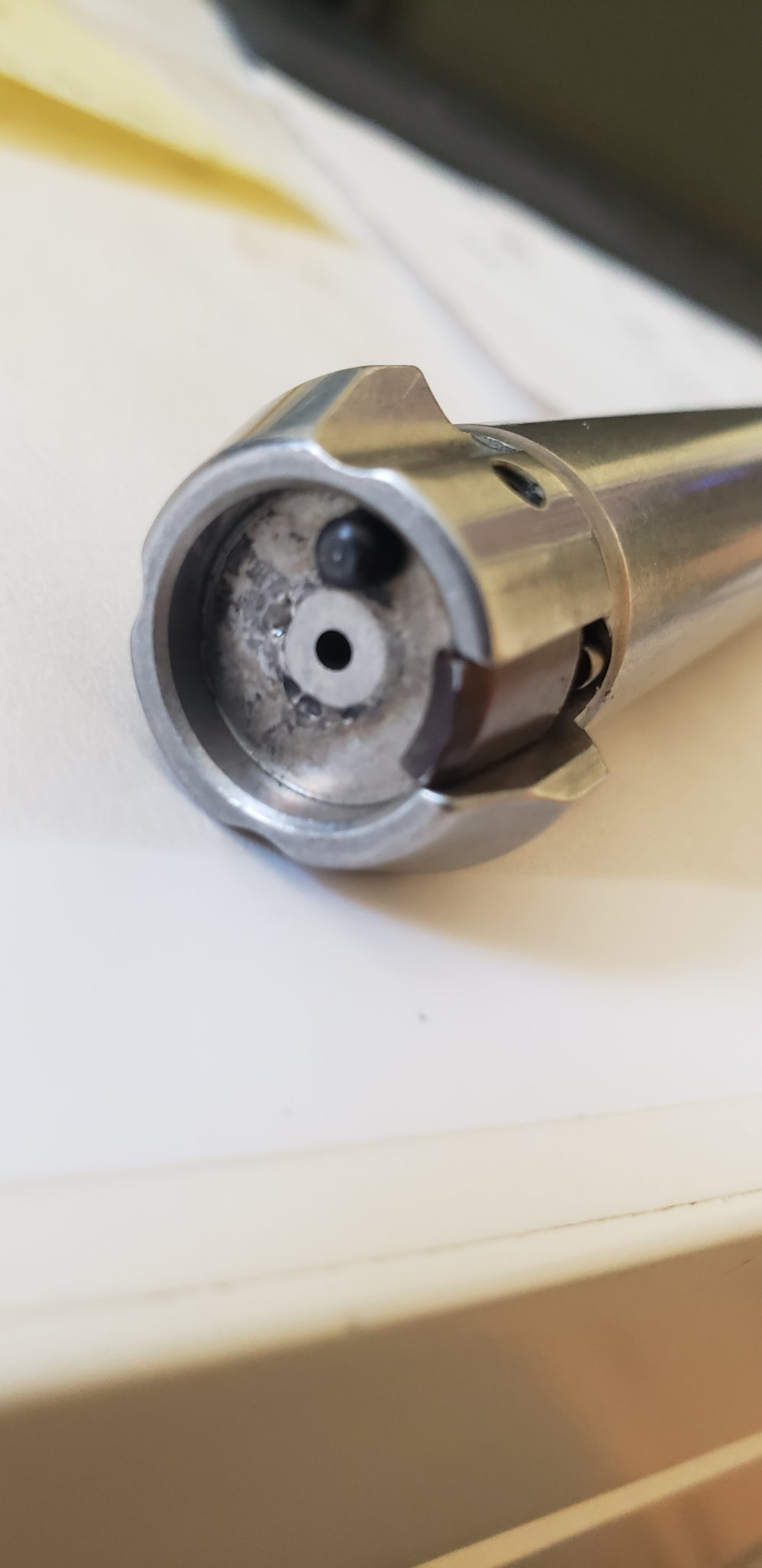

Hello Folks,

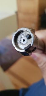

I love Tikka rifles, have had a sporter in 308 that I bought used, it is 0.5MOA all day long. I recently bought a brand new T3 in 7mm rem mag. After taking it to the range and firing only 40 rounds out of it (factory Hornady stuff), I saw that my bolt face is quite pitted. Very strange. Please see the pics. My 308 that has had ~1500 rds through it and although it shows a faint ring on the bolt face, it is not pitted like this- and that's after 1,500 or so rounds.
I sent the rifle to Beretta back at the beginning of July, but they've not gotten to it yet (btw, when it comes to customer service, they could do a lot better job- good luck getting anyone on the phone!).
I'm thinking if factory ammo did this, then what can a hot reload do? I am looking to purchase a spare left hand bolt with magnum face, but it is difficult to find as Midwest gun works and Brownell's do not have one at this time.
In the meantime, have any of you had an experience like mine? What did you do? I would appreciate any feedback if you have had this problem.
Stay safe,
HK Shahidi

Thank you for responding. I did not chrono the loads, but didn't think factory ammo did this.
Something is not right, sometimes speed will tell you if you are in the right ball park. Anyway if any black comes out of the primer seal I would not use the ammo anymore. Wouldn't use the ammo anyway until you know what the reason for the damage on the bolt face is.
Got any pictures of the empties or pictures of the case head, new & fired?
edi
Despite what manufacturers claim, their QA standards can be poor.They also run some hot loads.
That's a lot of blowback on your bolt face.
Not the end of the world though.
Check the fired cases and primers for signs of overpressure.
If you are concerned about the bolt, take it to a reputable gunsmith.
What were you groups like?

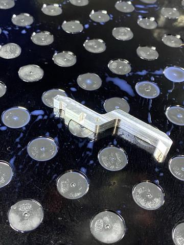

For those interested, we just dropped out flat trigger shoes! They are made for your factory trigger pack, a very easy install and a nice upgrade to an already nice trigger! https://rustynutsdesigns.com/products/tikka-flat-trigger-shoe
*Chassis in 3rd picture is currently in development, hoping to be released by the end of the year!

Looks great. Steps to install it? or better yet a video?
I’ll put out a video this weekend, but the quick rundown of it:
Remove action from stock
Remove trigger pack from action
Remove adjustment screw, spring, and plunger for trigger
Punch out pivot pin and remove existing shoe
Install new shoe, punch pin back in
Reinstall plunger, spring, and adjustment screw
Reinstall trigger pack to action
Adjust trigger to your liking
Reinstall action in to stock/chassis

Ordered one. Can't wait to try it out.
