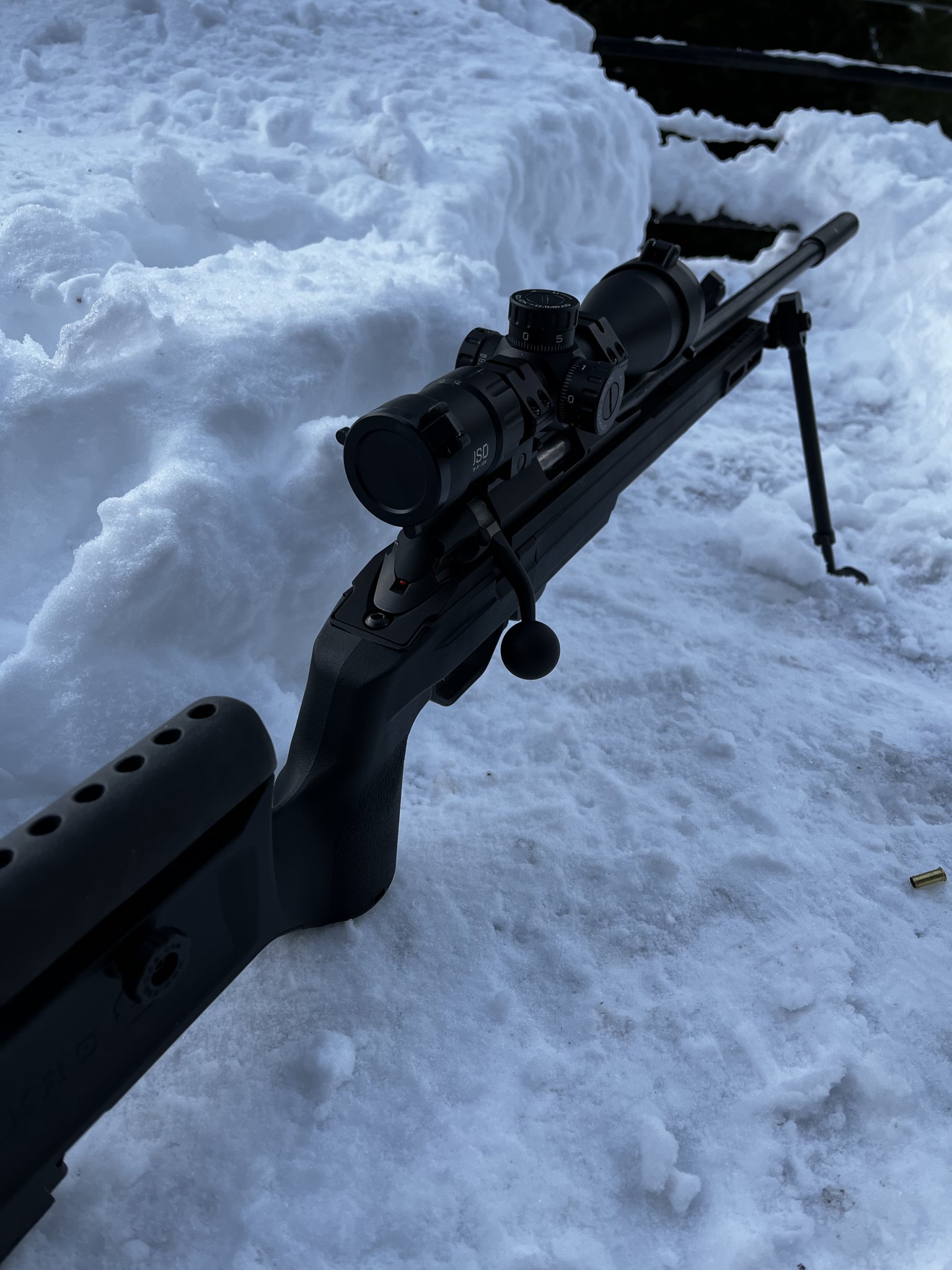

If I cant make weight with my 3-18, I will be using the new scope and not using a bipod...should be fun.
I just put a 10" arca rail on it. Maybe shouldnt have. Bare rifle with brake and rail is 8 lb 6 oz. I ordered a new lightweight double pull MDT bipod so gotta wait to see what it weighs then decide on which scope to use. I have a 3-15 scope that weighs 1lb 10 oz with rings I may have to use... the 3-18 with rings is over 2 lbs...leaving less than 1.5 lb for bipod to make the 12 lb limit. should be fun.

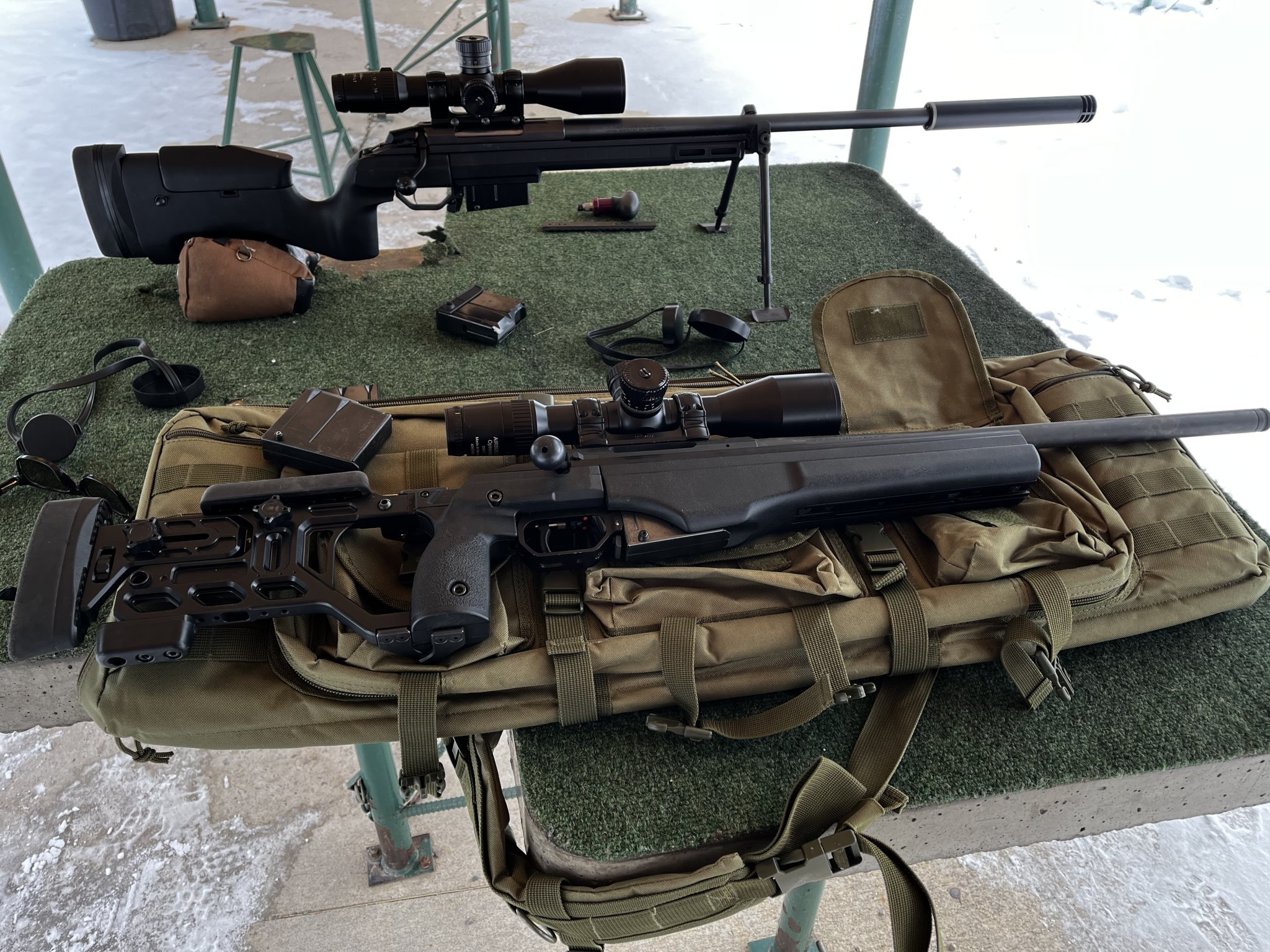

Sterk on the TRG/KRG chimera. Brothers from a different mother.

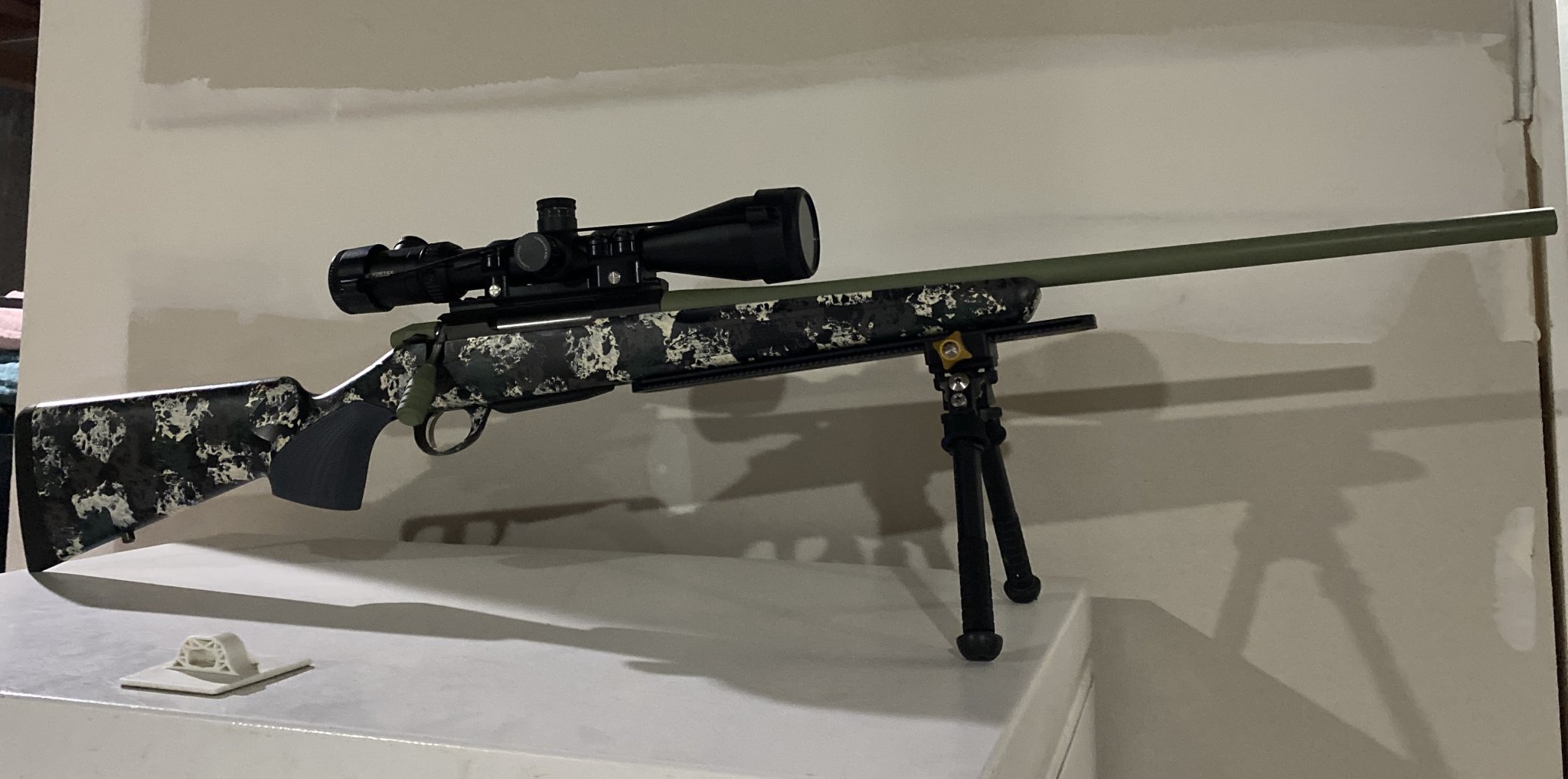

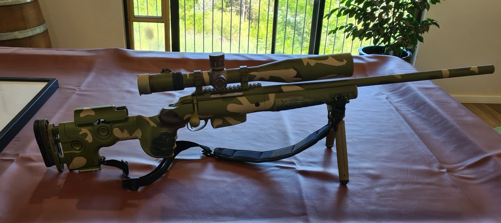

I pulled the pencil 7-08 barrel off the donor Tikka I bought and put two 6.5 SST barrels on. One CF, one steel. Dropped it in a KRG W3. It weighs 15lbs. It's my antelope rifle. I walk and stalk with it.
View attachment 7773492View attachment 7773500
It shoots pretty good at that weight to.
Good looking rig. I like how you have your bipod setup. Is that a spigot with an arca adapter for the Harris? I have an arca rail on my chassis and I’m trying to figure out how I want to run the bipod.

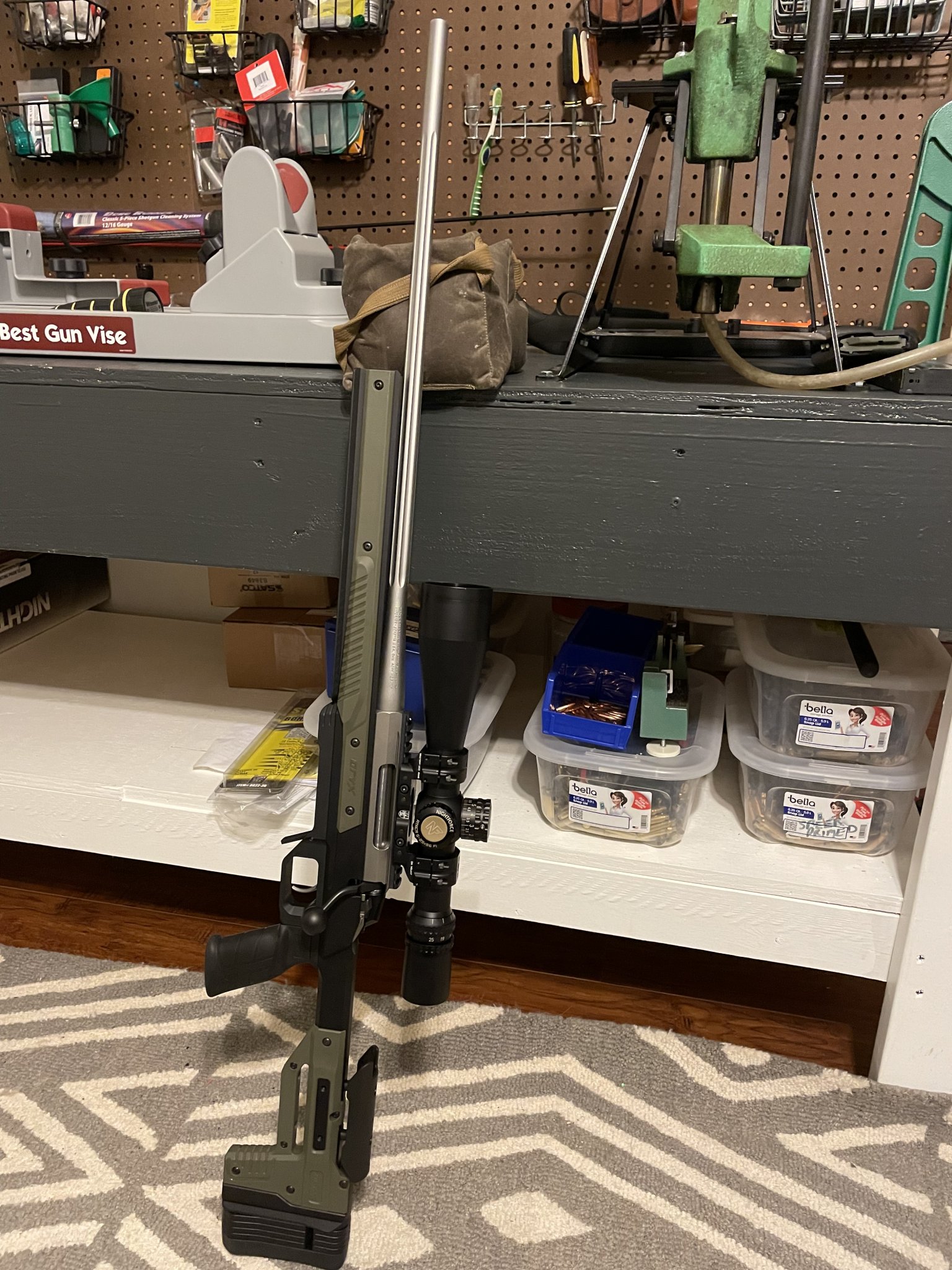

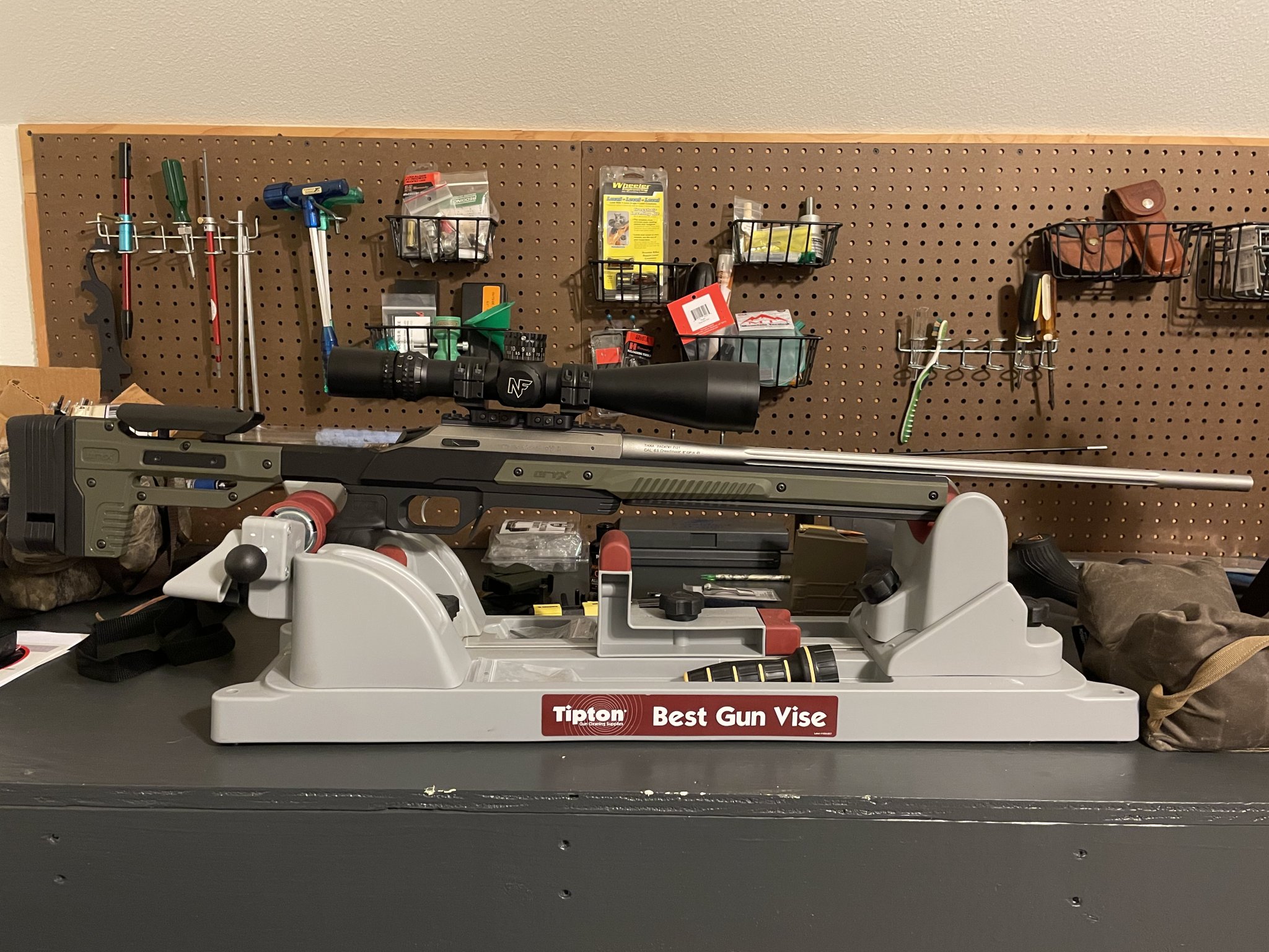

Well boys, behold the Anteater…as per reubenski. Thank you, sir. I’m gonna roll with that one.
I think tomorrow I’ll run a few wet patches and dry patches down the tube. Load 25 rounds and see what it’s got. I’ll post the results later.

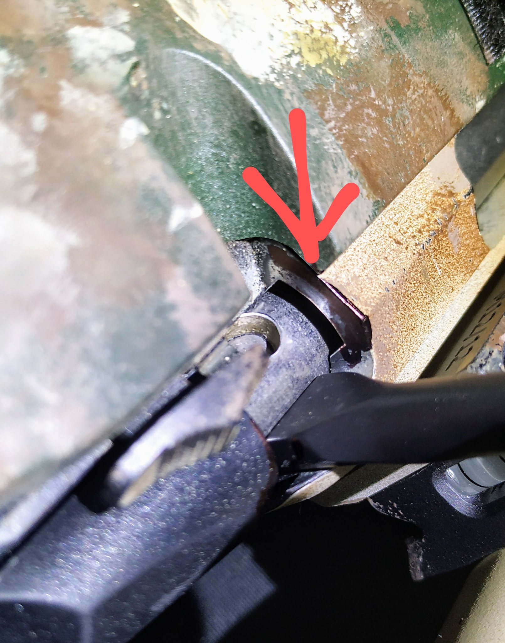

So i updated status, but doesn't look like it posted...
10 rounds at the range and the problem was back.
New examination found that the bolt knob seems to be touching the metal frame...?

Yes, it will touch. The dovetail of the handle is the same width as the cut out in the bolt body - look into remington bolt handle timing if you are curious, you will also notice the action matches the angle of the dovetail on the bolt handle to guide this camming action.
