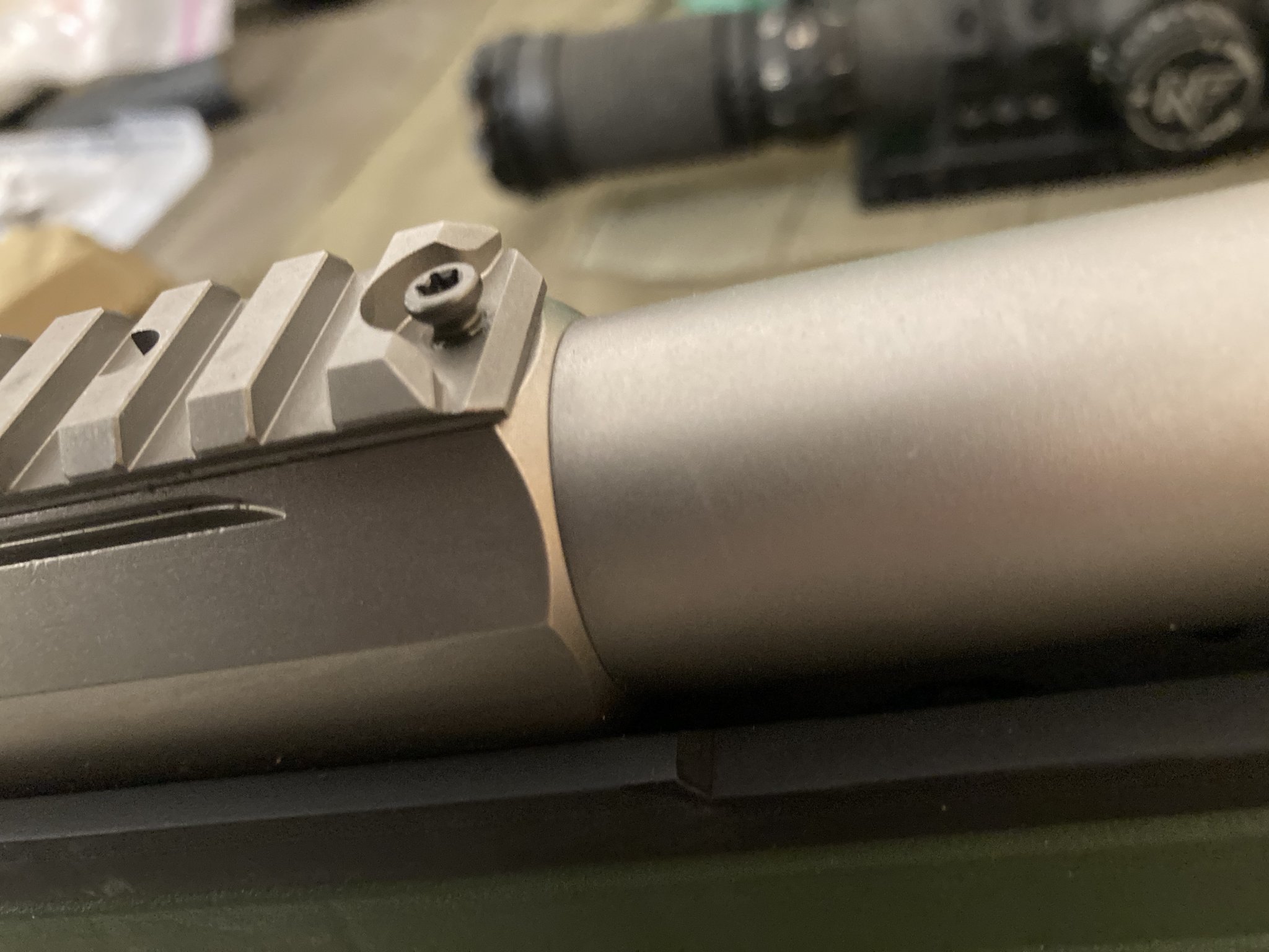

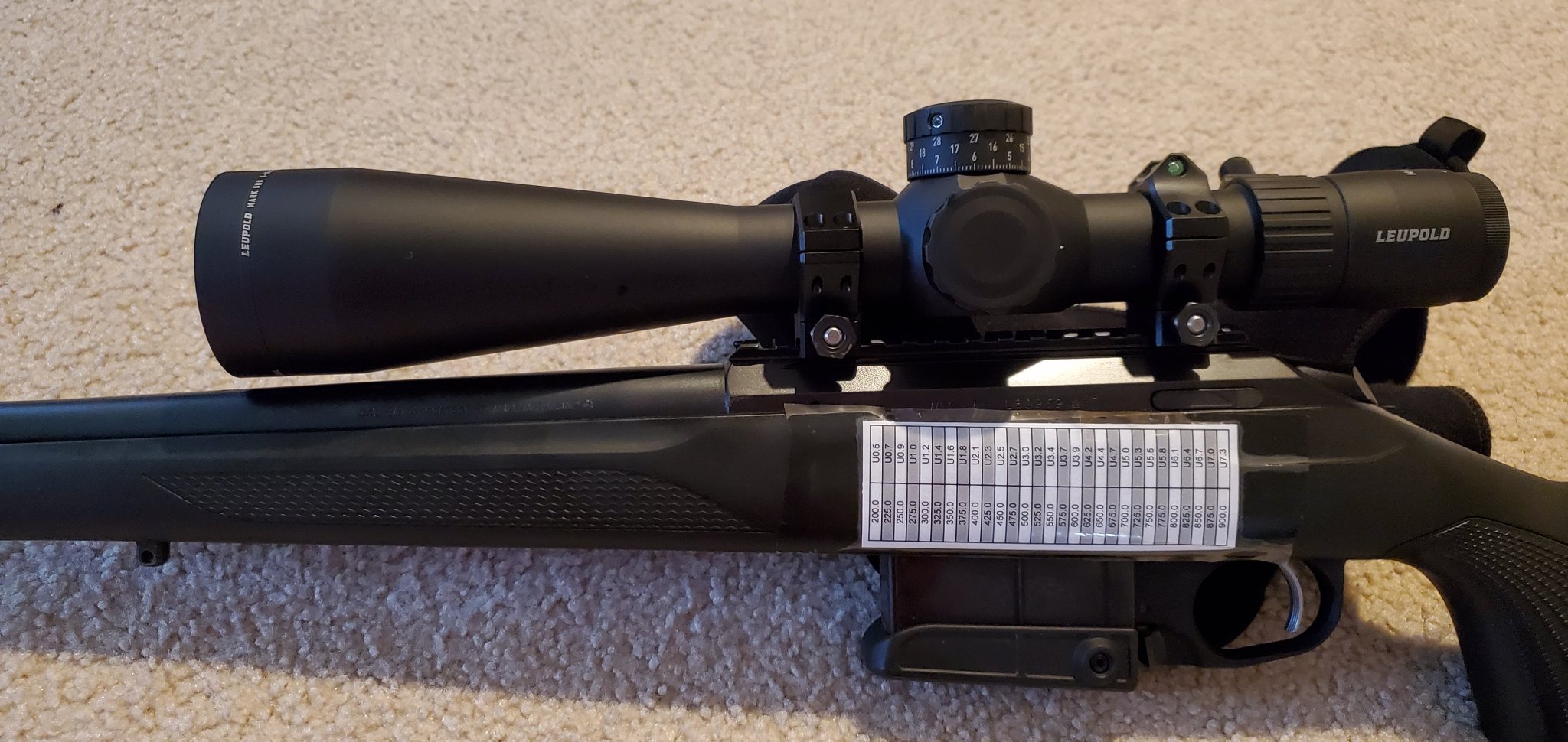

dumb question, just noticed the last screw toward the barrel end of my ctr rail is not tightened down flush, pic attached.
it's not "loose", as in, it takes a fair bit of effort to turn it, is this in the process of working its way out? should i go ahead and screw it down, maybe with blue loctite? sorry, drawing a blank on how this used to be
Do not screw it down. It is used to attach a mirage band that would extend to the sako brake. Other than that it has no function. If you screw it in and tighten it too much it will press off the action and warp your rail upwards.
That screw is an attachment point for the optional Tikka/Sako mirage band. Don't screw it in any further. I guess you can remove it ft you want. It doesn't secure the rail to the receiver.

I wish I had been smart enough to ask that question several years back -- I screwed it in and ended up with a bowed rail.
Smart thing to ask.
Smart thing to ask.
I started to do the same but fortunately noticed the rail start to pick up and reversed course.
Reactions: Jcarpenter223
I also tried to reverse course -- But I had gone a bit too far. It was not noticeable to most people, but I could always see that stupid little space between the rail and the action.

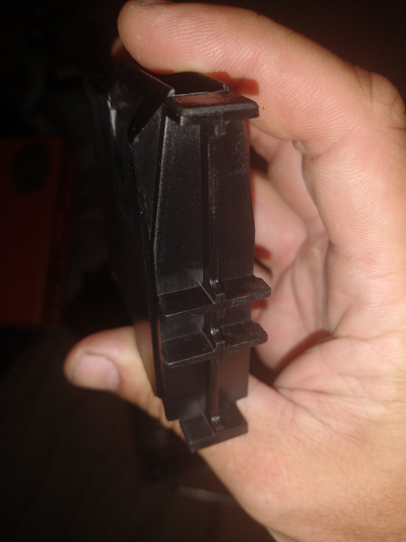

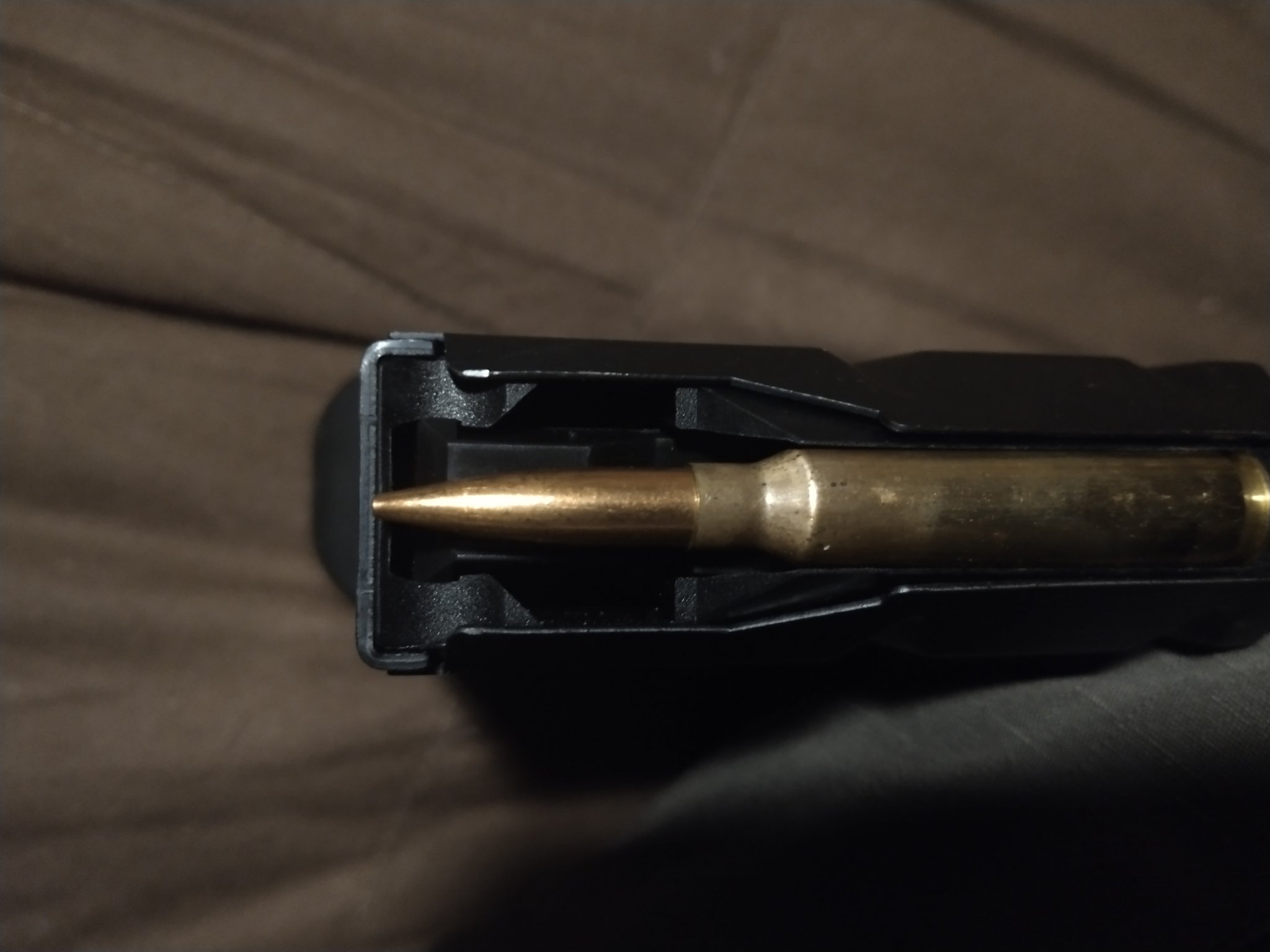

Possible ways to lengthen the 223 CTR mag to accept longer oal?
These use the plastic liner in what I assume is the .308 mag body, just looking for ideas to modify the liner and resecuring it to the mag body, and if any follower modifications will be needed. Have some 90gr SMK'S loaded to 2.6"
