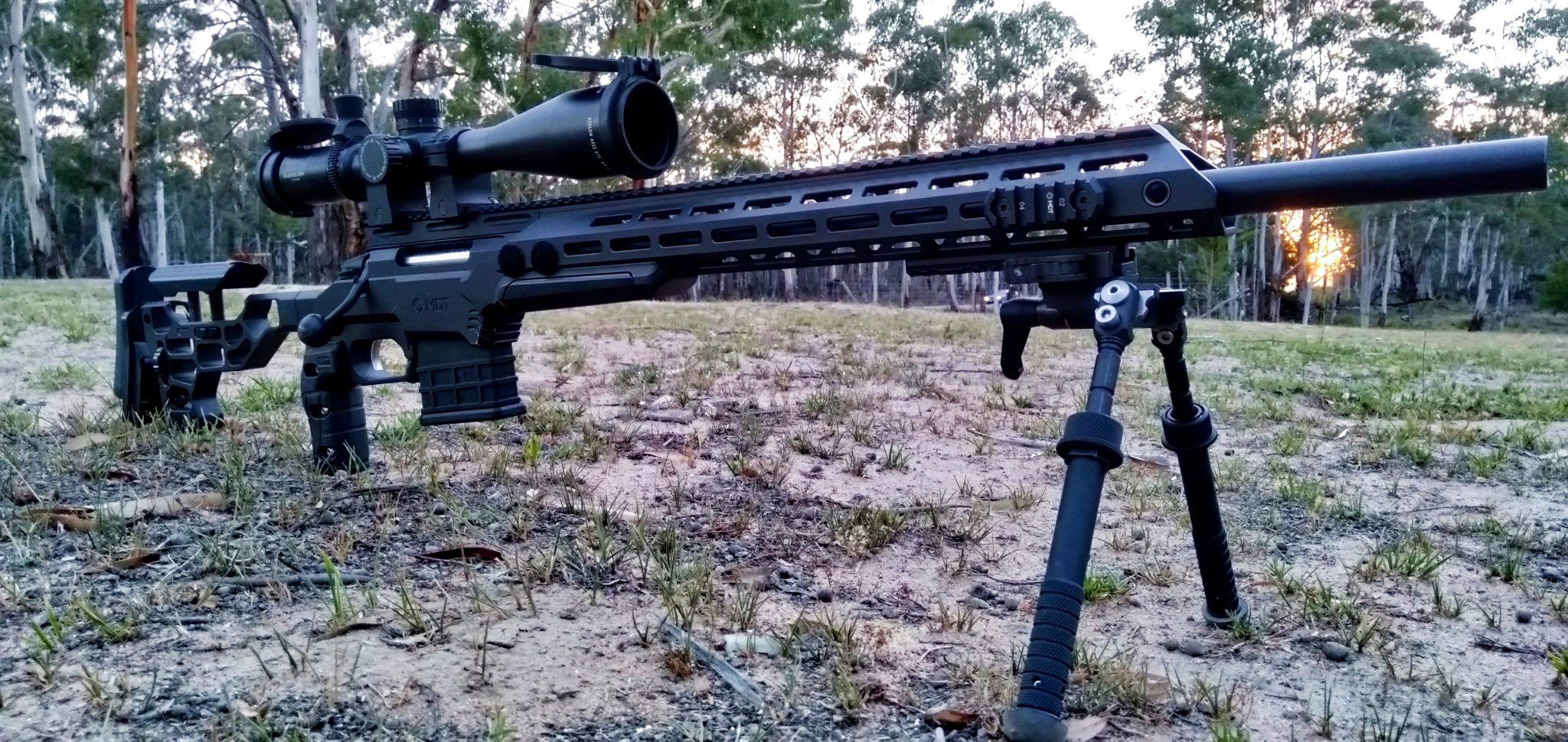

Anyone put a Tikka in an ESS or sim AR type chassis with AR style fore end/stock? Wondering how the high bore axis relative to butt pad shoots and looks.
old pic, only slight changes to this pic in the way of arca rail, longer pic rail and scope, and got it threaded for a brake, but will have the same scope back on it when i get some time. sorry i dont have it right now to take more pics. have a pic on my phone that i will upload shortly, but strapped in a bag.
Dude...sweet 😄 I'm thinking about piecing together something like that with an AR style collapsible folder!
word of warning if not using a pencil thin barrel, mine is not light. its between 17-18 pounds (merican weight), thats why i use a monopod to shoot when i go hunting. in my current physical condition with work related injuries, i cant shoulder it.

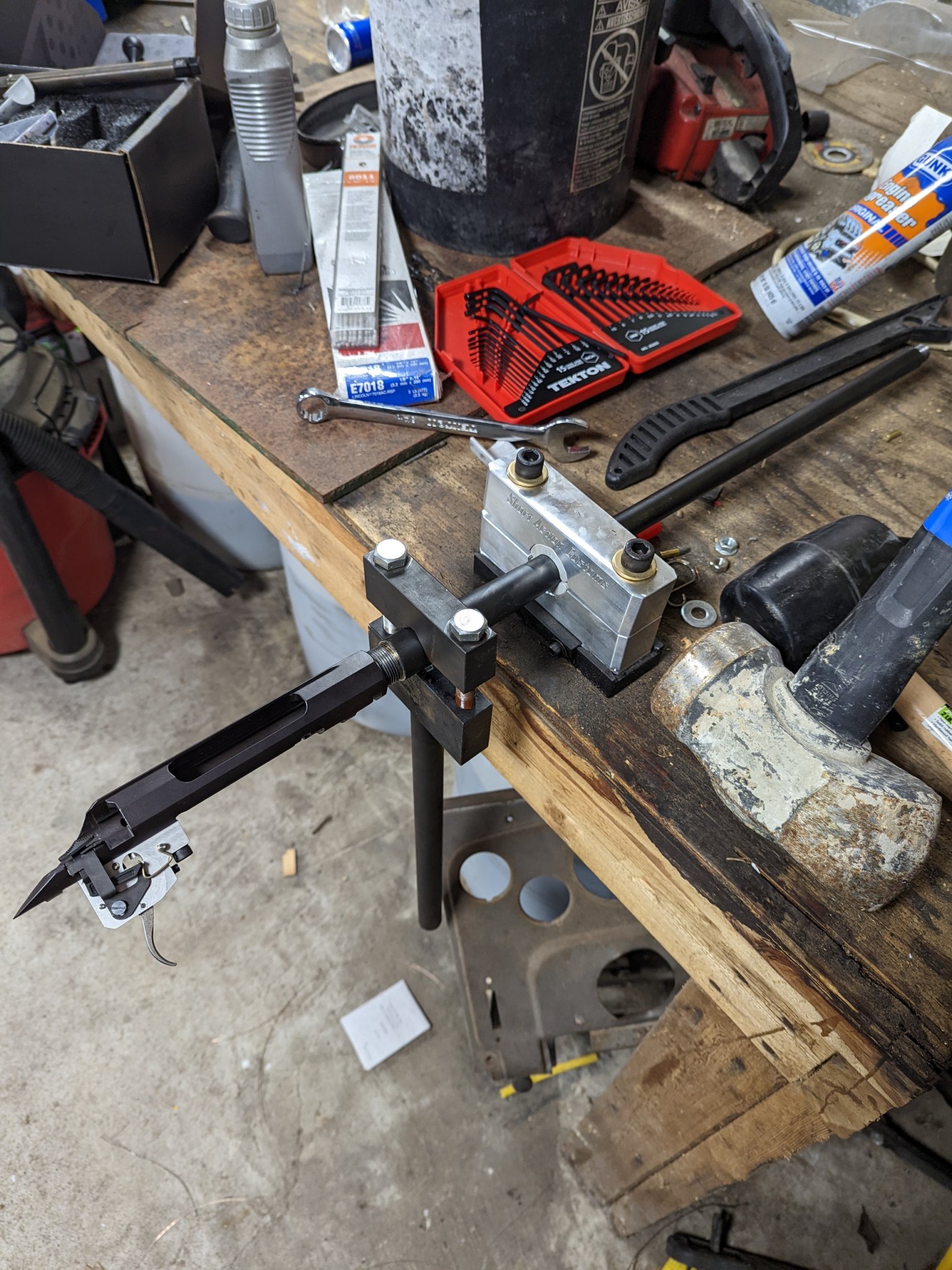

I actually just popped a factory Tikka barrel for the first time last night using my sac vise with a wheeler #1.
Super easy, took 10 minutes.
Didn't have to flip the wrench cap upside down? I flipped mine over onto the flat side but had to buy longer bolts. BTW if that CTR barrel is a 308 and you want to sell let me know.

I didn't flip it, no.
The v fit the top of the receiver perfectly - didn't marr it at all.
I didn't heat it at all either, just a big whack with the hammer and it popped right off.

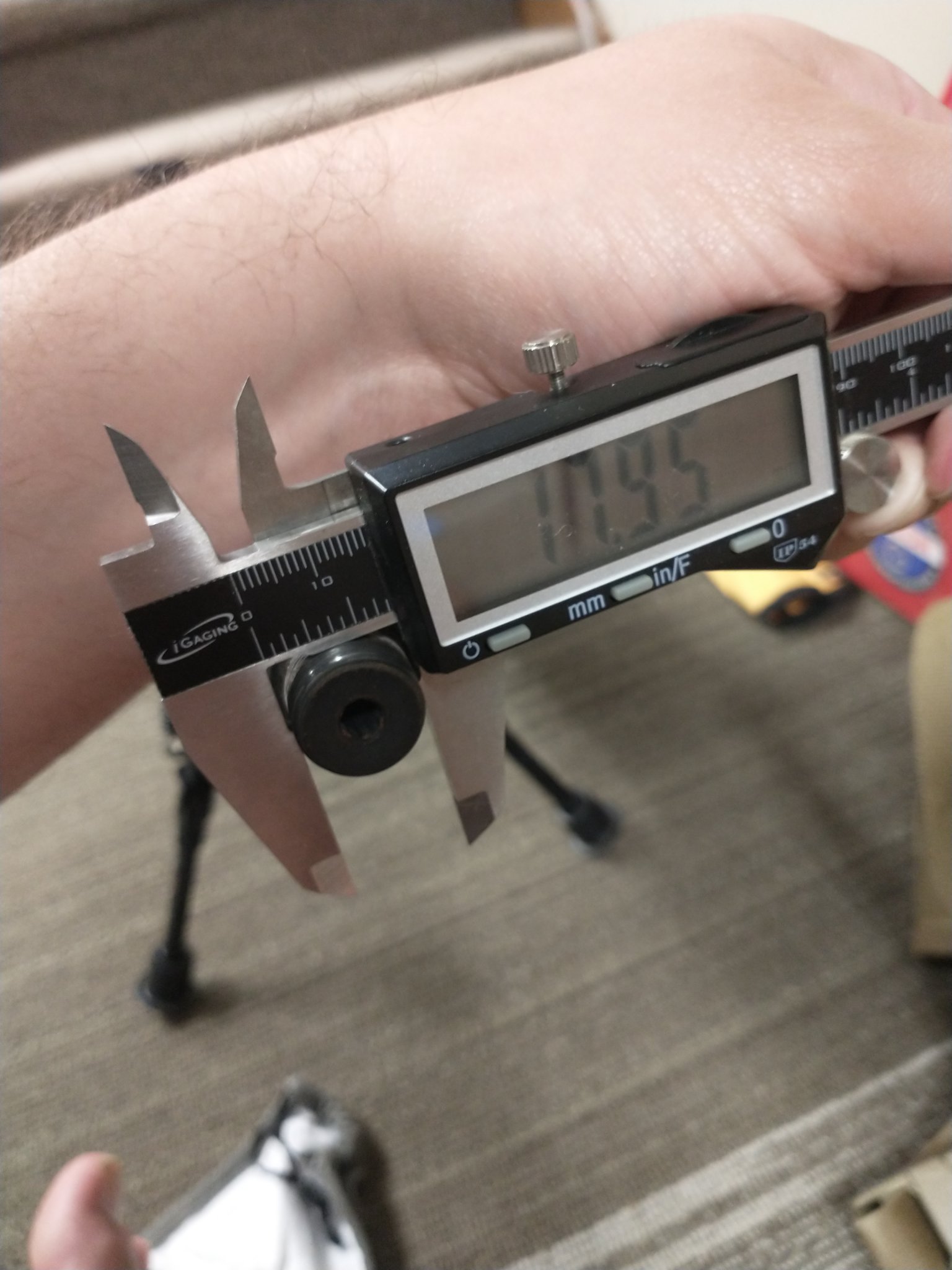

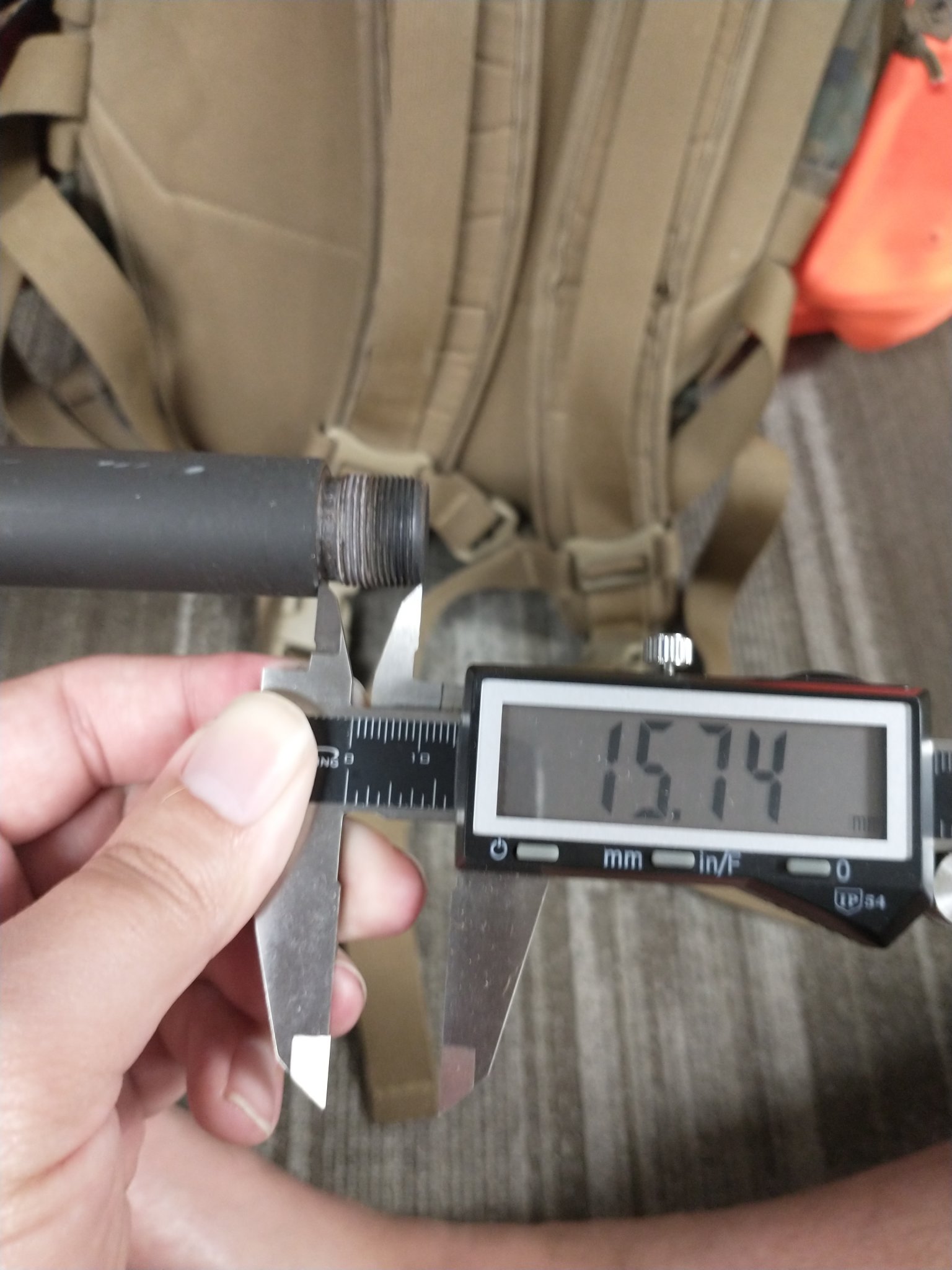

I have an older T3 .223. 20" threaded barrel. Can anyone confirm what thread that is?
M18x1 I'm thinking, but Google Fu has been inconclusive and I'd rather not 'screw' this up.
Any barrel thread adapters to avoid? I'd like to get this to 1/2x28 to then get a KeyMo Flash hider on if possible.

1/2x28 is usually 223 and 9mm.
Yours is either m18x1 or 5/8x24.
Probably 5/8x24
For rifle cases bigger than 223, you typically want 5/8x24 unless you're doing something weird for a lightweight Sporter.

I vote 5/8x24 your calipers read 17.95mm or .70" on the thread majors so it'd appear to calculate.

Found some more posts on other forums to make me pretty positive its M18x1 now. May take the thread protector to the hardware as @category_theory suggested and double check though.
And the more that I think about it, no reason to be married to 1/2x28 in this instance. .223 or not.

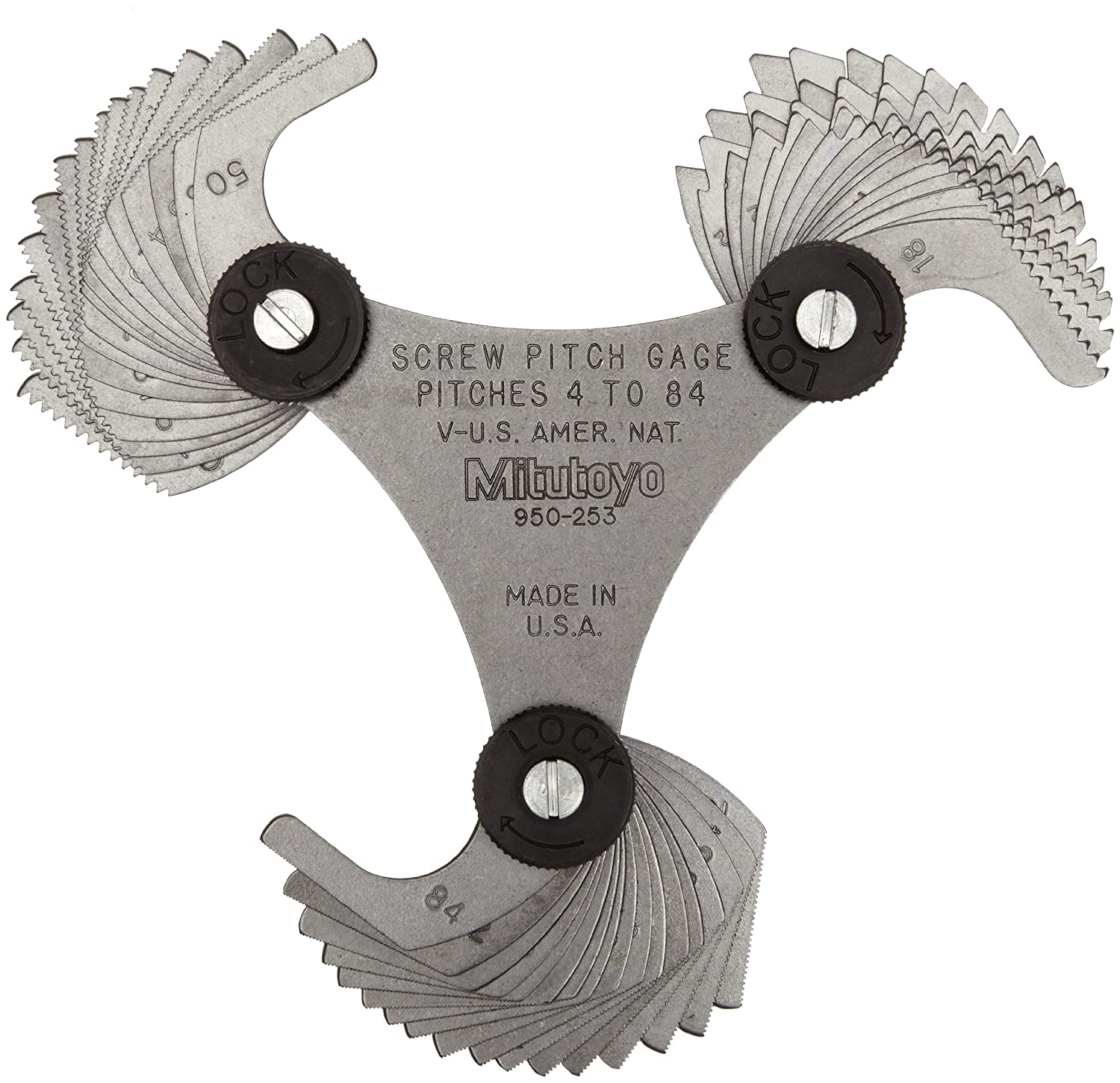

Single bolts in the tpi you think it is. So any metric x1 or imperial-24. This works for any size thread. If you're ever trying to check a 1/2-28 you will never find one in a big box store but you might find 1/4-28.
Or get a set like this.
