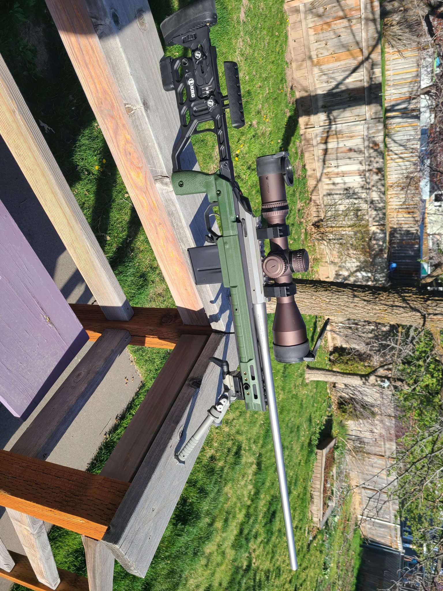

Update again!
Tikka JRTXB482 lefty stainless t3x lite 6.5 creed
Vortex razor 2 4.5-27x56 7c mil in vortex precision rings (used off the hide)
Murphy tactical 20moa titanium rail (just cause I could)
RRS sc-lr, RRS atlas adapter spacer, Atlas CAL gen 2 no dye with Atlas spike FEET (thanks @Kasey )
KRG whiskey 3 with arca rail. Krg branded accurate mags.
Sterk titanium bolt shroud gen 2 and Sterk left handed swept ball (thanks @cannoncrossfire)
Precision Underground bag and suppressor cover (thanks @Precision Underground)
Thunderbeast Ultra 7 30 cal CB on a TBAC CB face mount brake installed by TBAC. Stamp came in today. 385 days from cashed to approved.
Update again!

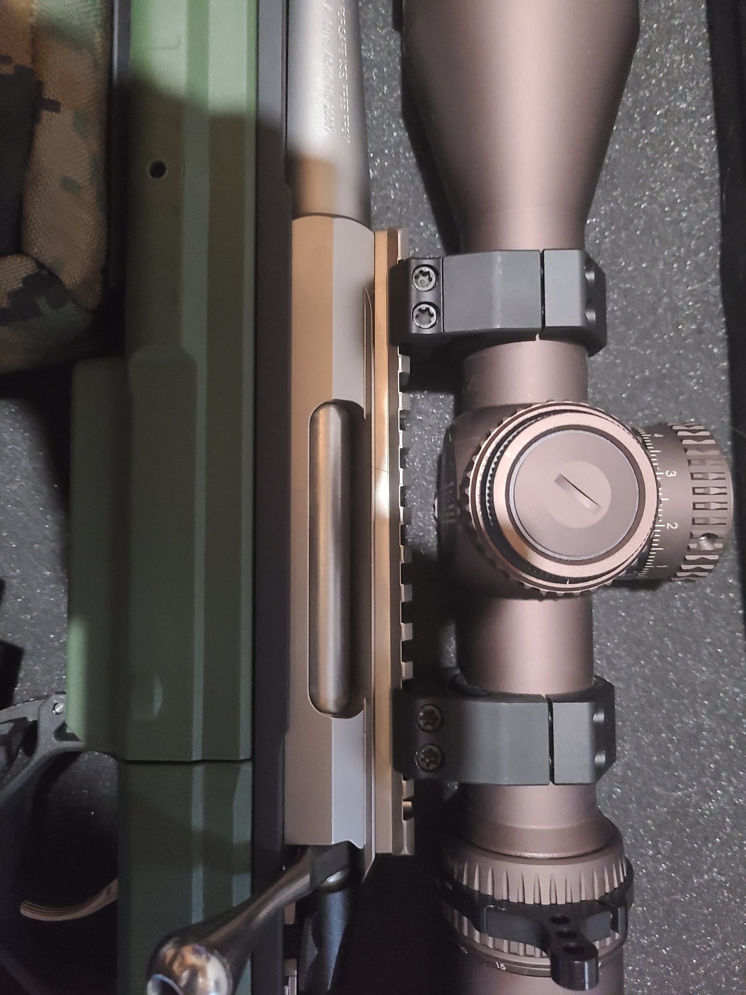

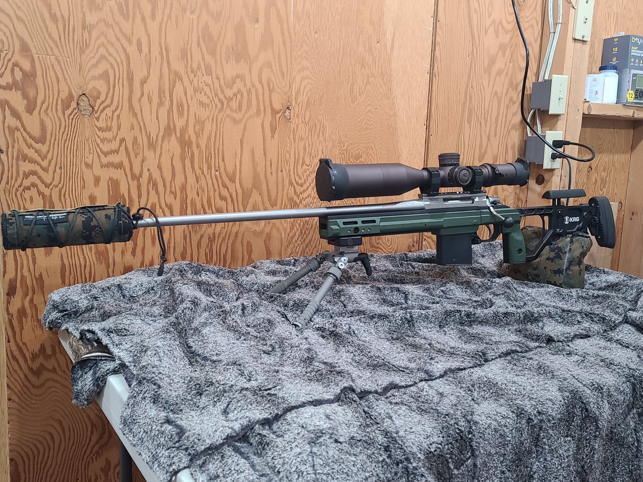

View attachment 7906280View attachment 7906281
What is your barrel length? Did you have to cut any off to thread it?

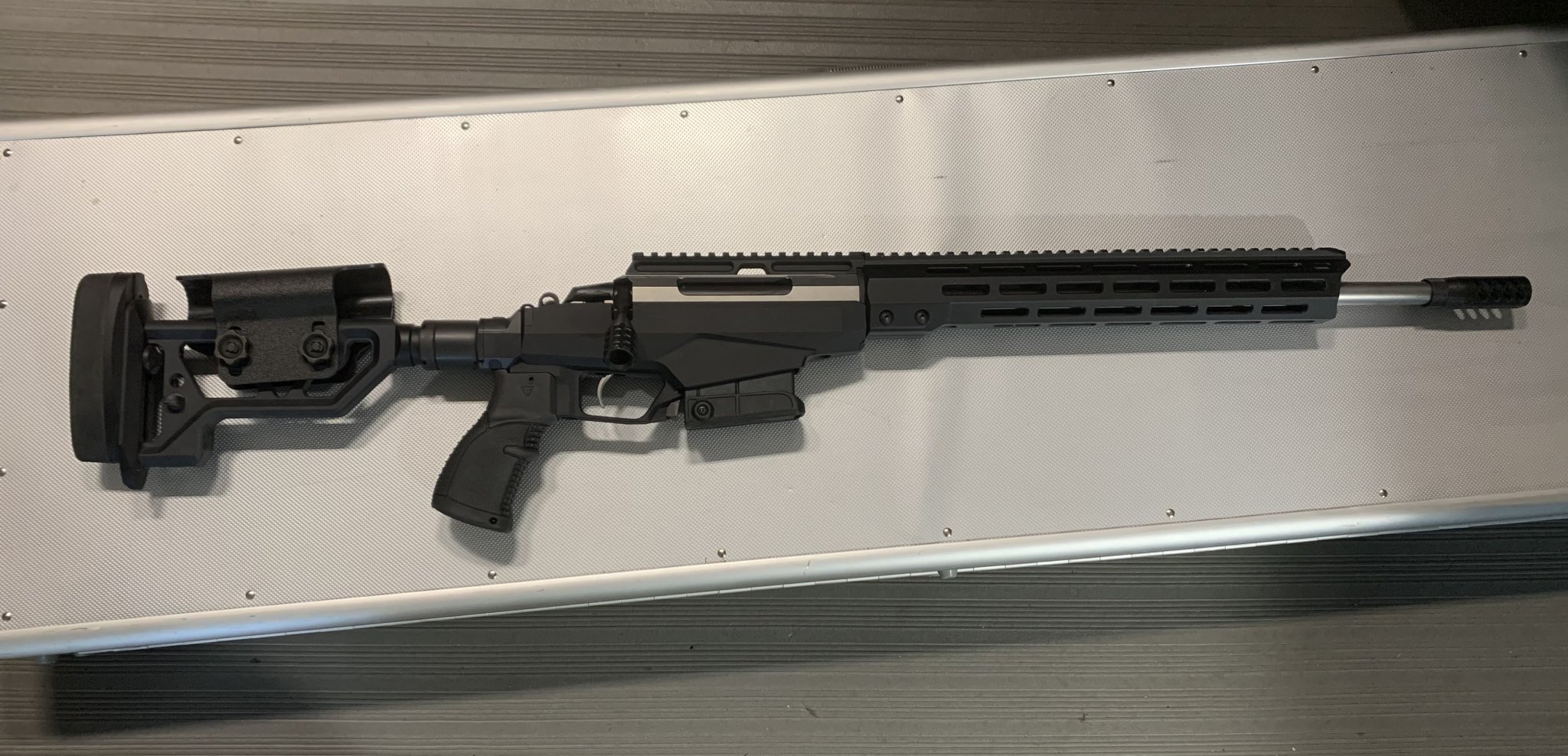

I want to see if someone can confirm if a TRG22/42 buttstock can fit on the Tikka CTR KRG chassis?
It can but you’ll need to do a little bit of milling on the inside surface of the stock to allow it to mate snugly on the bravo otherwise there’s a small gap between the tang. This doesn’t affect the buttstock attachment to the TRG forestock if you want to switch it back. The only downside is you can’t use the 10mm TRG cheek spacer because the Tikka SA bolt will hit.

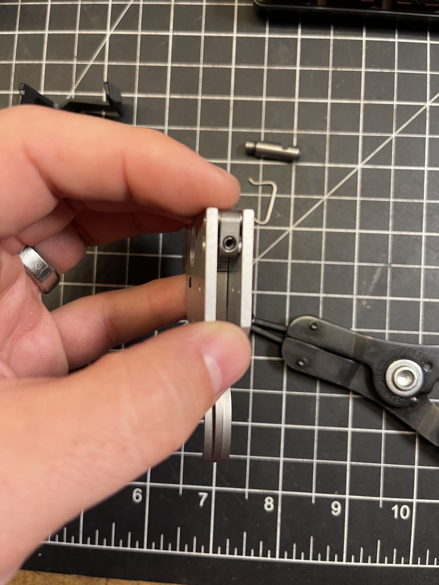

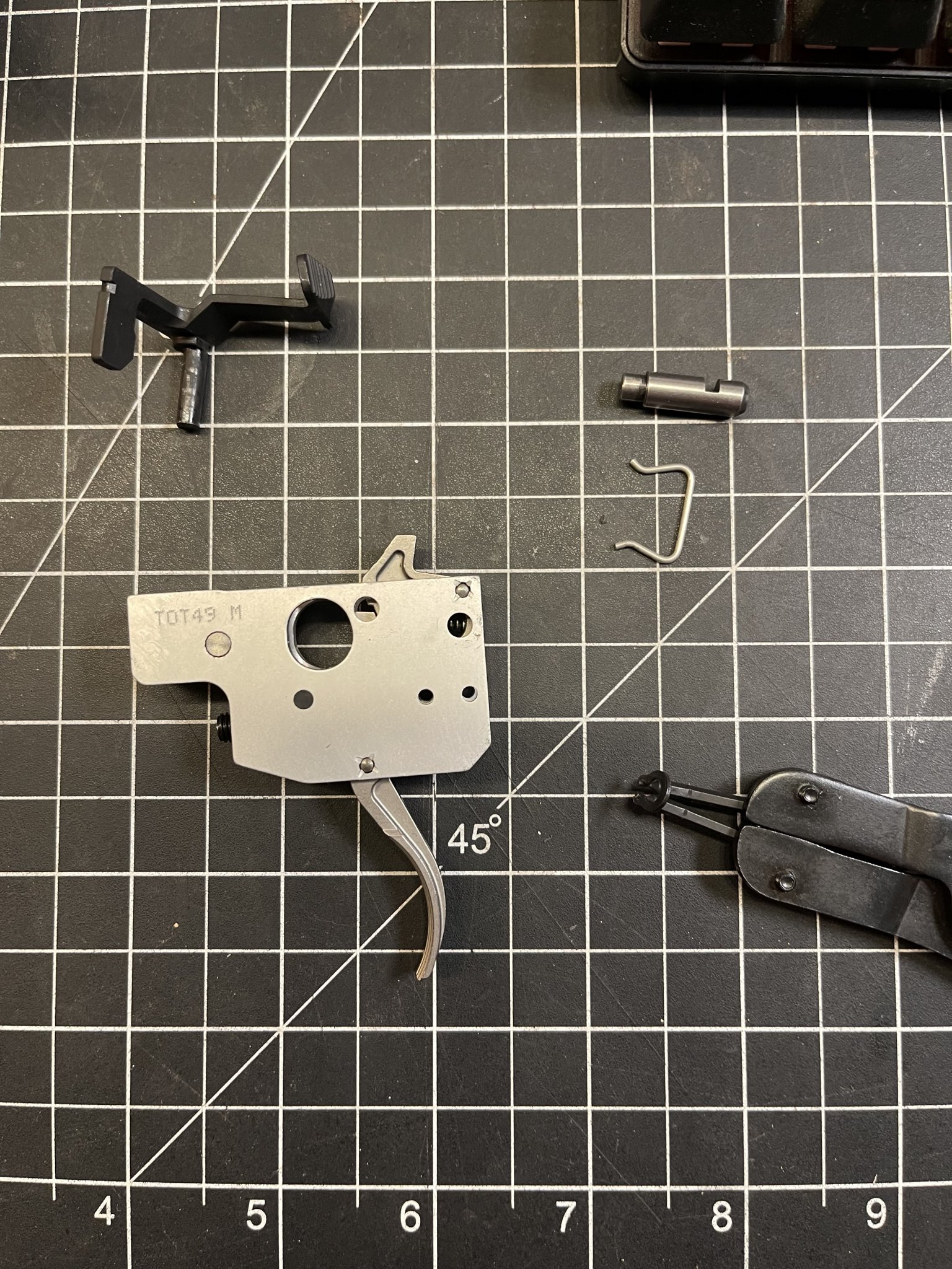

Hey y'all, serious question here. While I was replacing my barrel (I should have taken the trigger off, I know!) my safety's retention e-clip popped off. When it did the sear spring popped out. How in the hell do I get it back in!? How does it install?! Thanks! I can post pics as well...
Please post pics. I've got a possible project someday messing with trigger stuff.
Since I haven't been able to find anything on the internets, nor here, and almost no one Ive found even sells Tikka Sear springs (or I guess trigger return springs). Ill update here for the other poor sap that makes the same mistake I did....
So the first image below is the mess... the black piece at the top is the safety mechanism, the black stud / rod is what goes through the hole at the rear (this sounds gross already) of the trigger assembly and through the rear of the sear. The sear is pinned to pivot at the top right of the trigger but also has a hole that the safety mechanism rod can pass through and then is held in please by an e-clip on the other side.
The bottom image is where the sear spring is inserted into... it took me a second to figure this out... The spring is compressed in this hole and held IN PLACE by the safety rod that passes through the sear... THIS IS A PAIN IN THE ASS TO PUT BACK! you have to compress the spring, which is fairly strong given its size... THEN pass the rod through both the trigger housing and the sear and keep the spring compressed enough to allow it to pass through. Hands, mouths, my wife's hands, small screw drivers, etc were all used to get it back in... (again sorry for the sexy images... ;).
So for any poor sap that finds themself in the same place hopefully this helps. net net the sear spring is hidden IN the sear. If the e-clip comes off and you pull the safety it WILL come out and be a pain in the ass to get in.
